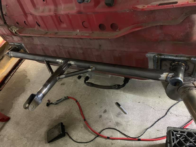

should have some updates this week on the cage progress. talked to eric over the weekend and he told me he should have the cage pretty much whipped this week.

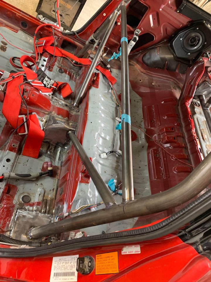

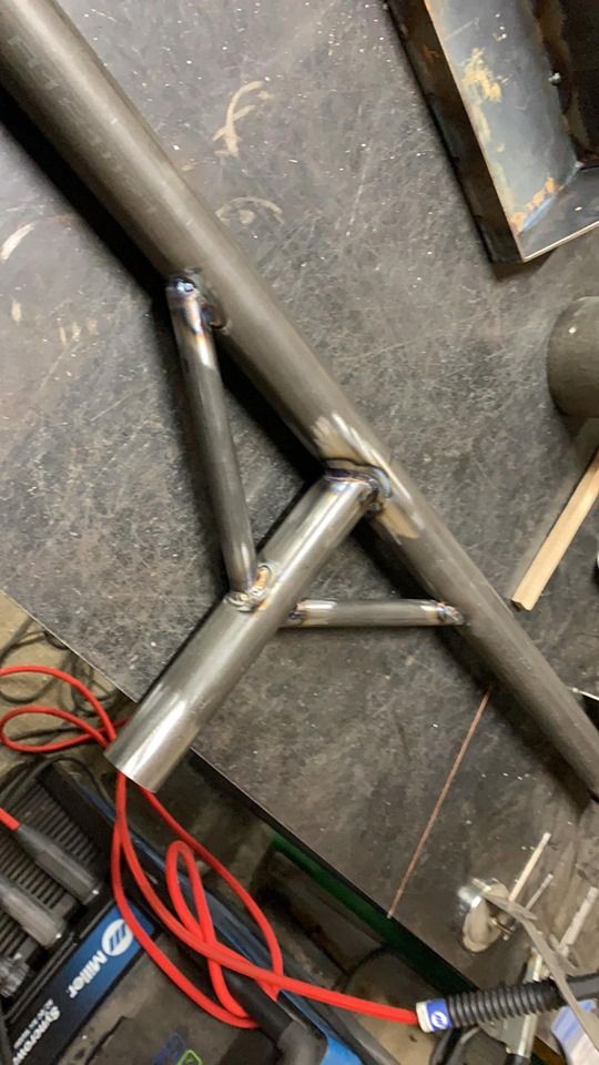

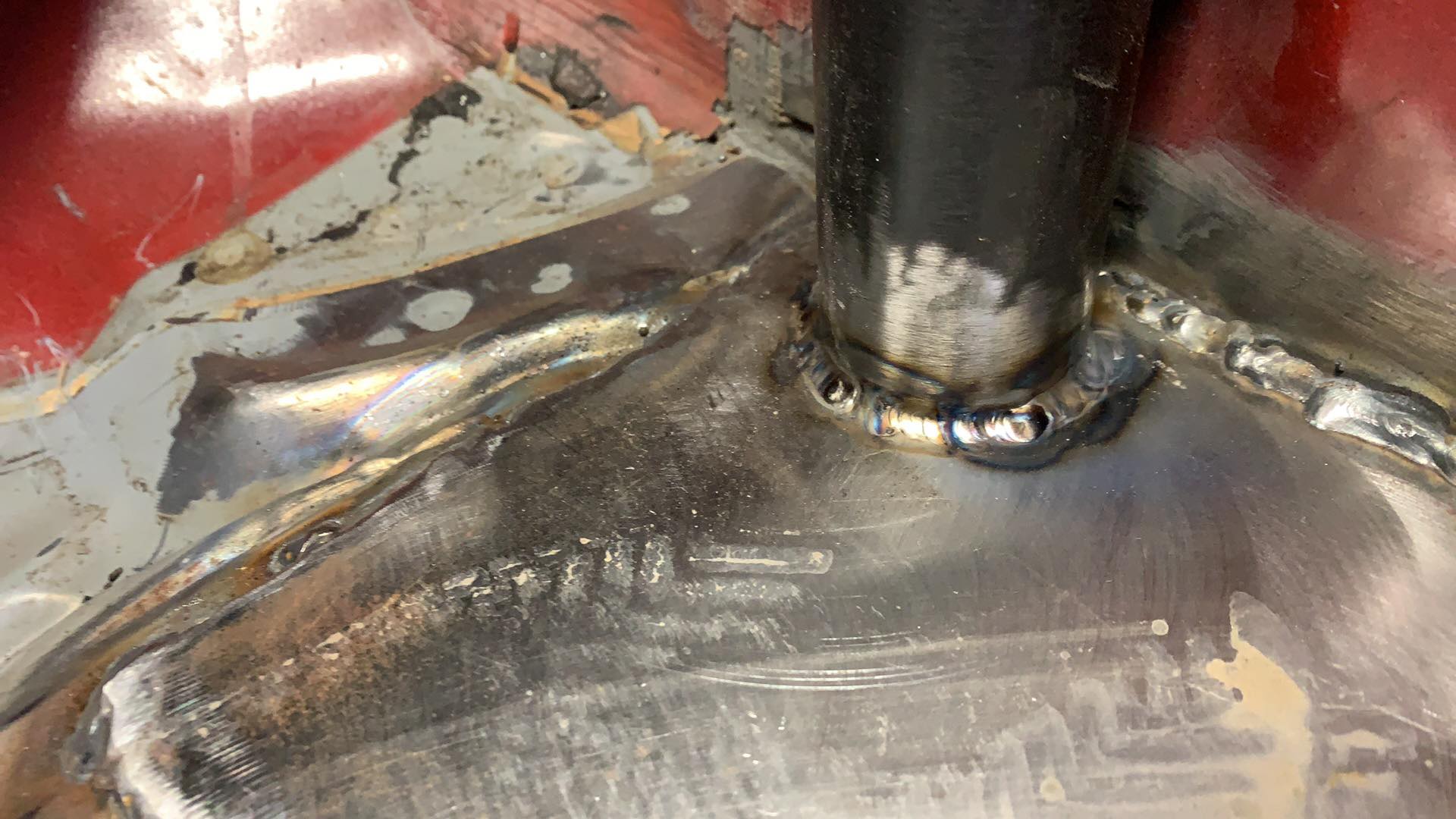

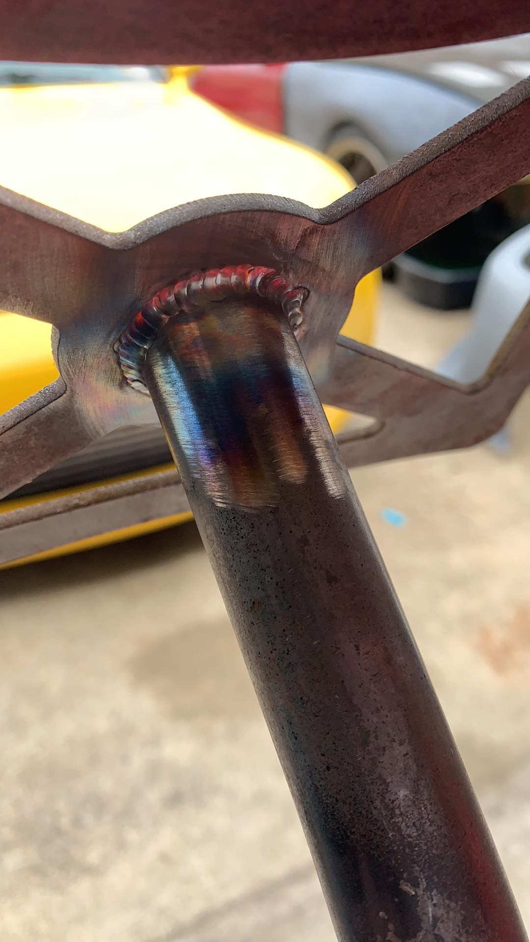

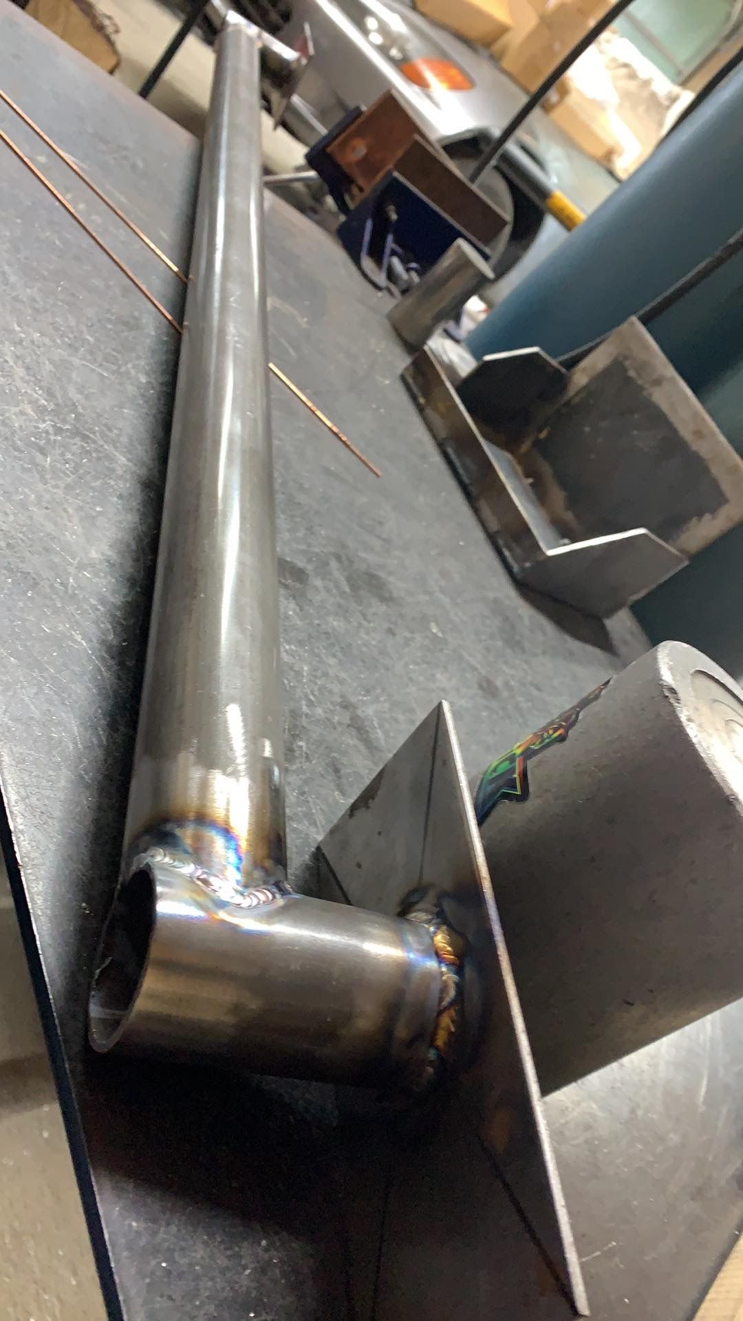

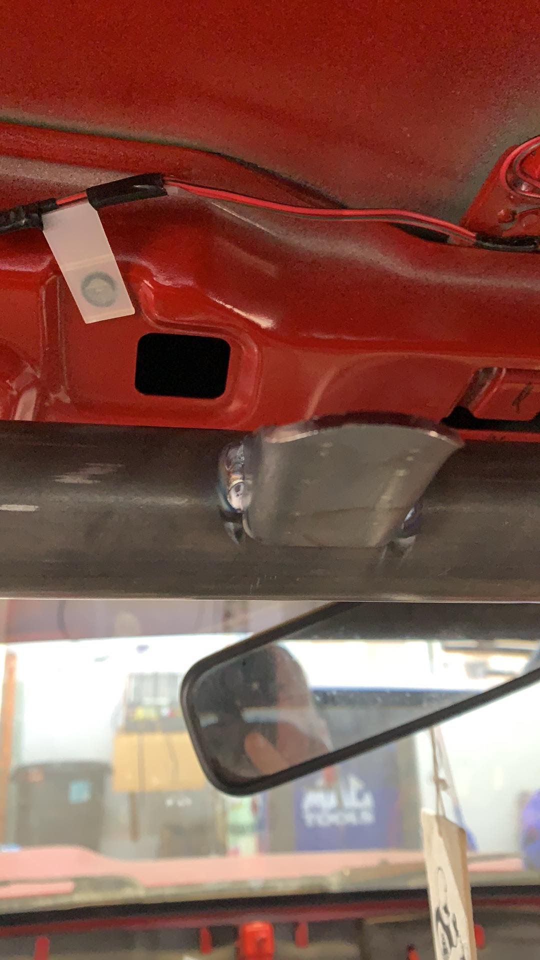

no pics yet but eric has started welding on the back half of the cage. plan is to get that welded, start fitting/ welding the front bars/door bars, then finally get the chute mount built and welded up.

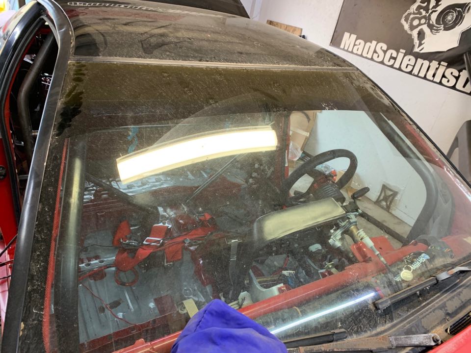

update time:

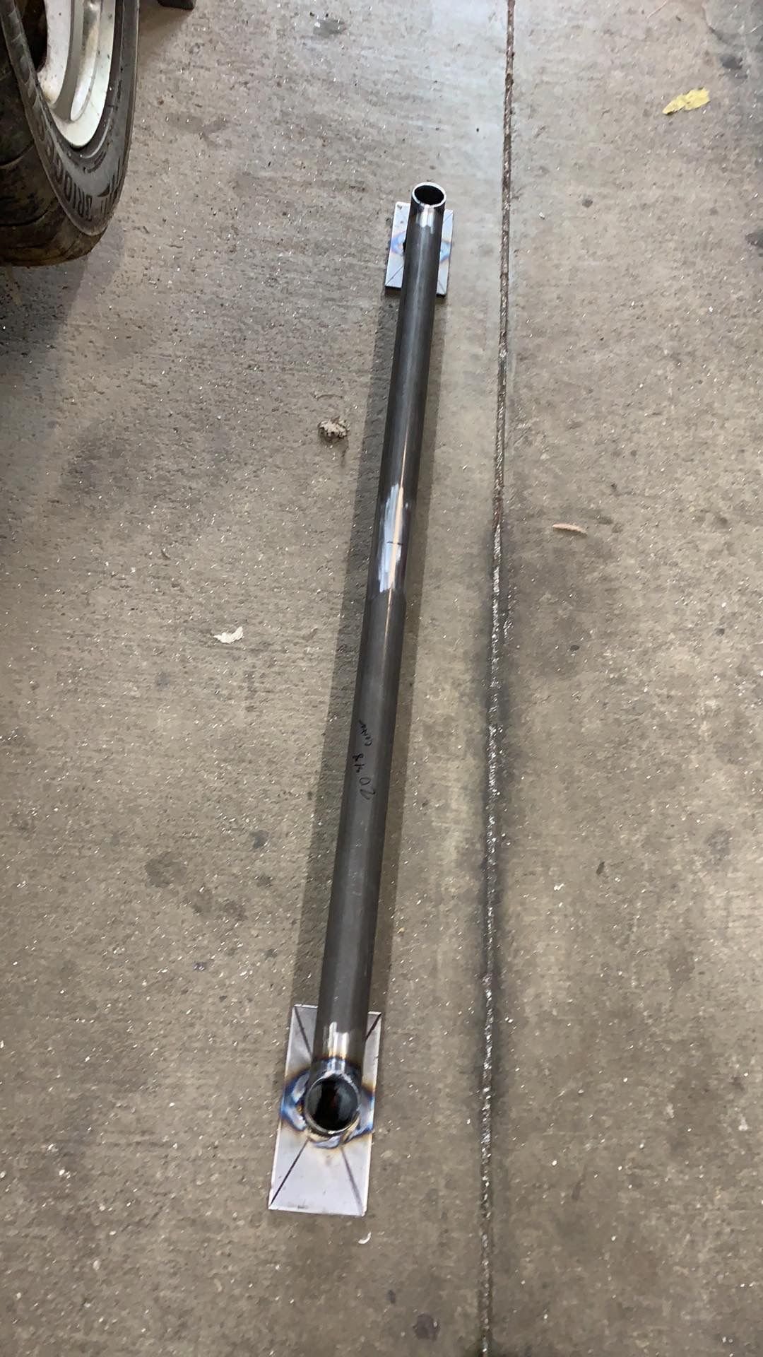

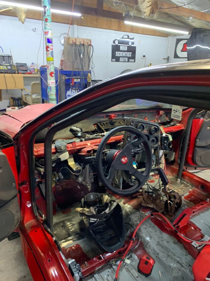

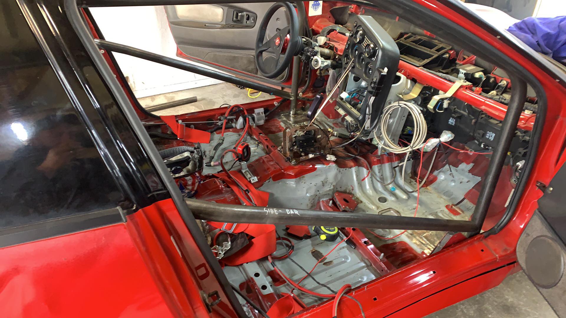

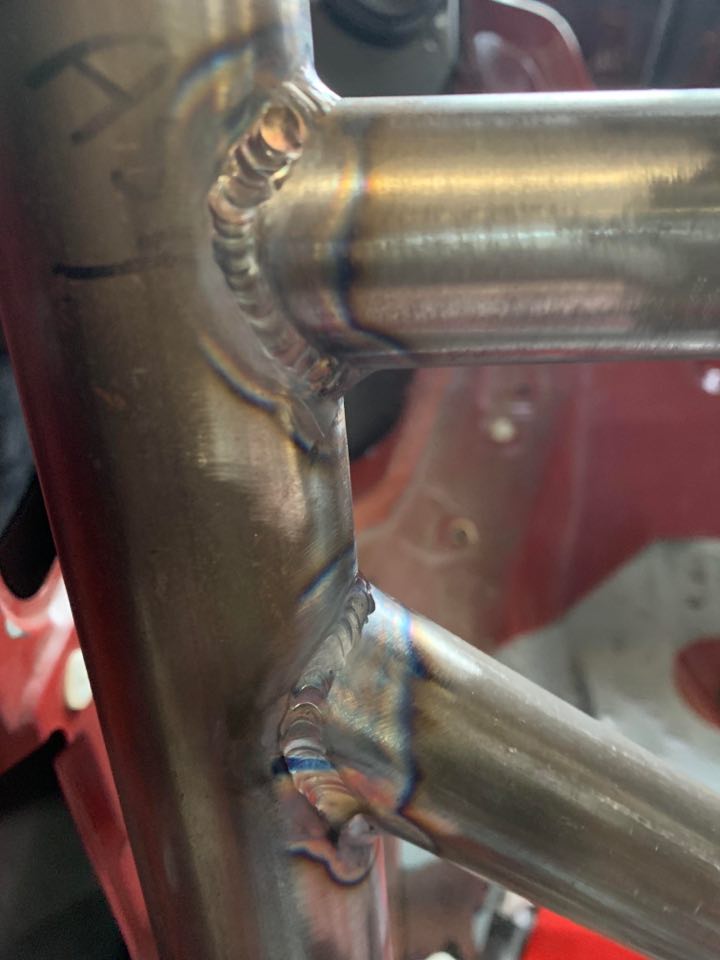

pillar bars and windshield bar are done. all thats left for the cage is the door bars and gussets. then going to finally tackle the chute mount. originally we were doing to run it kind of high and tie it to the cage but we are rethinking that idea.

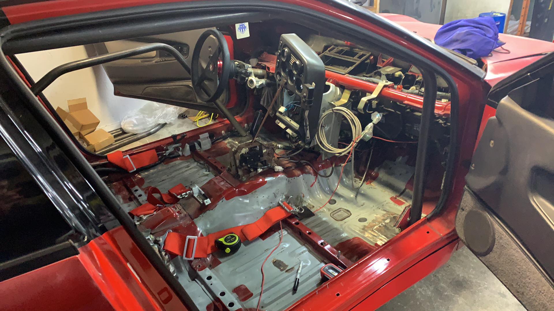

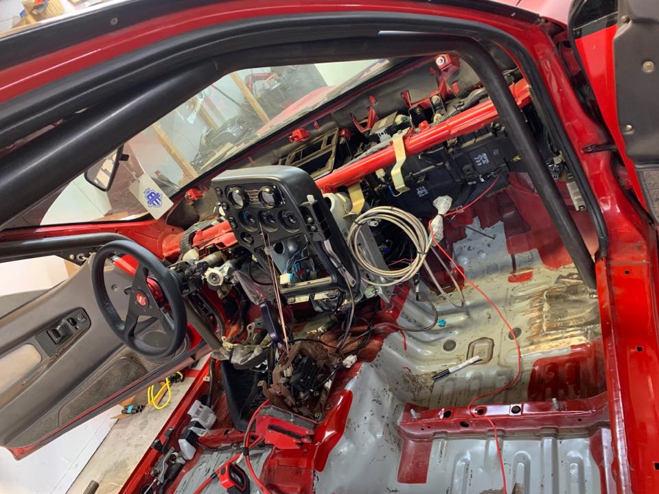

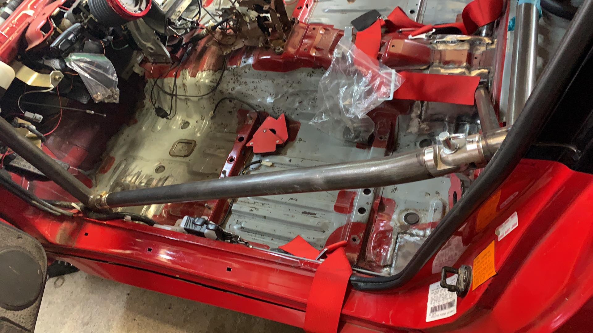

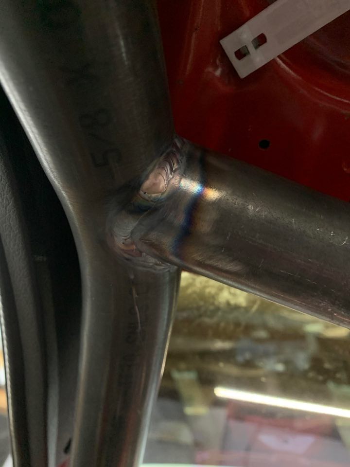

now for some progress pics. everyone likes those.
more to come on this. i should be picking the car up the 23rd of this month as long as all things go well.

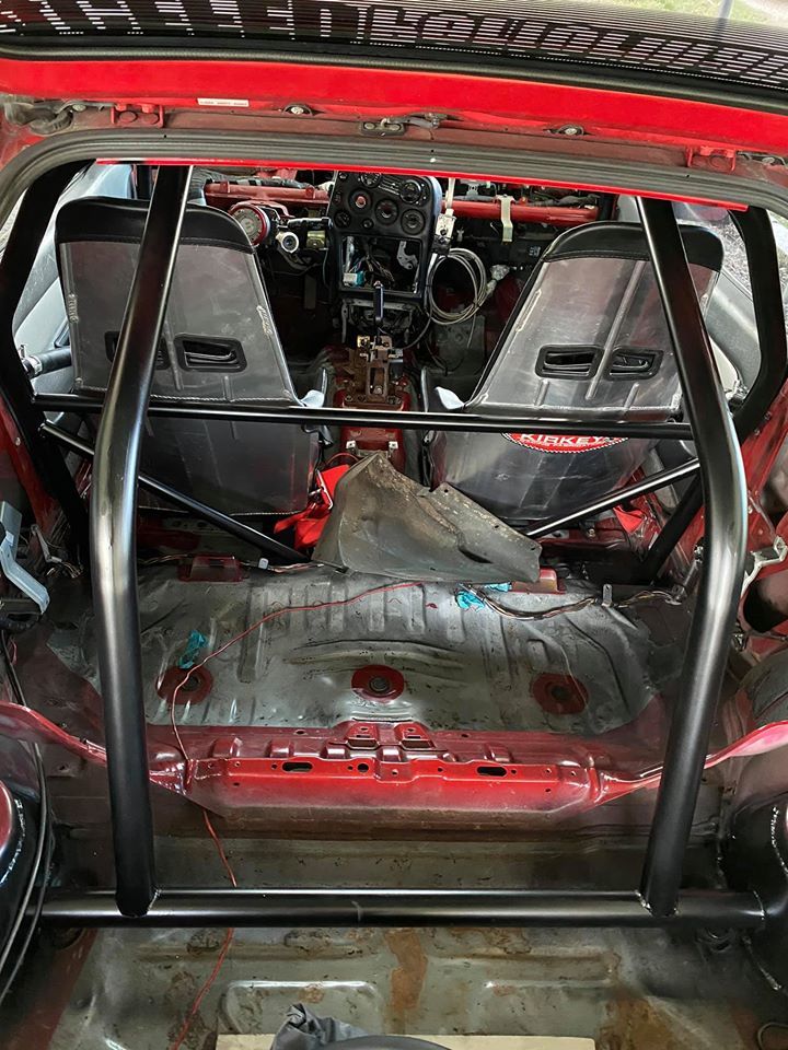

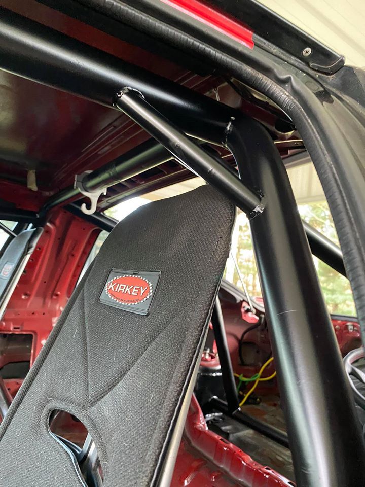

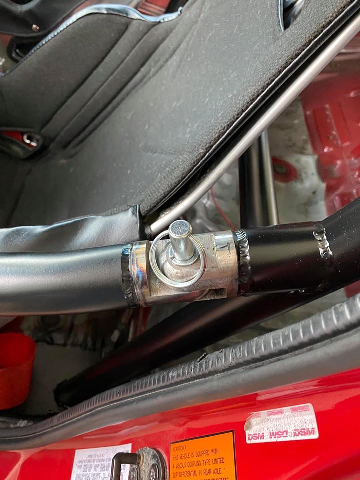

update: shes home!!!!
so happy with how the cage turned out. going to try to get some assembly stuff done this coming weekend.
next is to cut the dash to fit, going to have to heat the door panels to try to form them to fit the door bars better, get the chute and all its stuff installed, then re assemble the interior pieces back in.
Came out nice man. I like that swing out so much nicer/modern than the one I had.
thanks tony! yea it came out alot better than i expected. if i could go back i wouldve had him bend the cage to the car but he made it work well with what i had given him. i fit well too so that was a big plus for me.

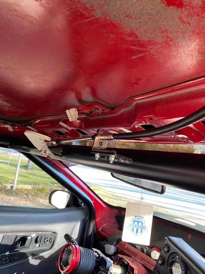

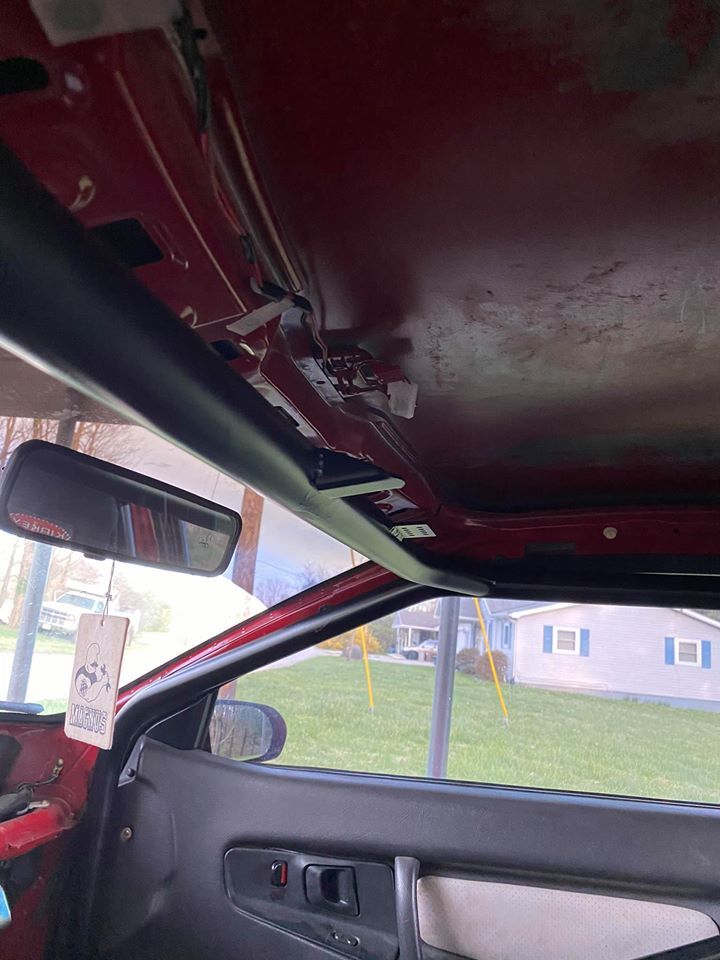

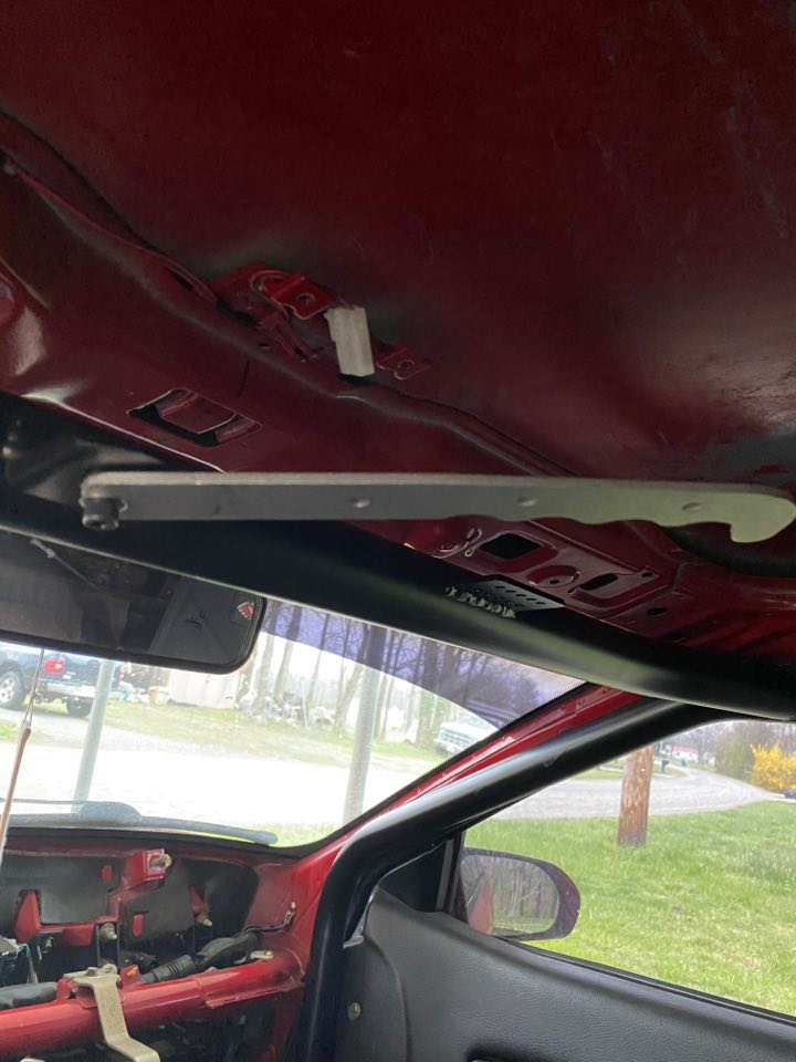

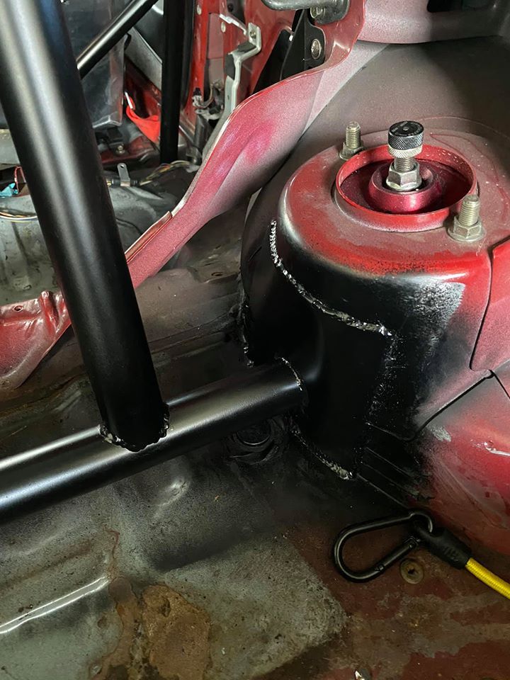

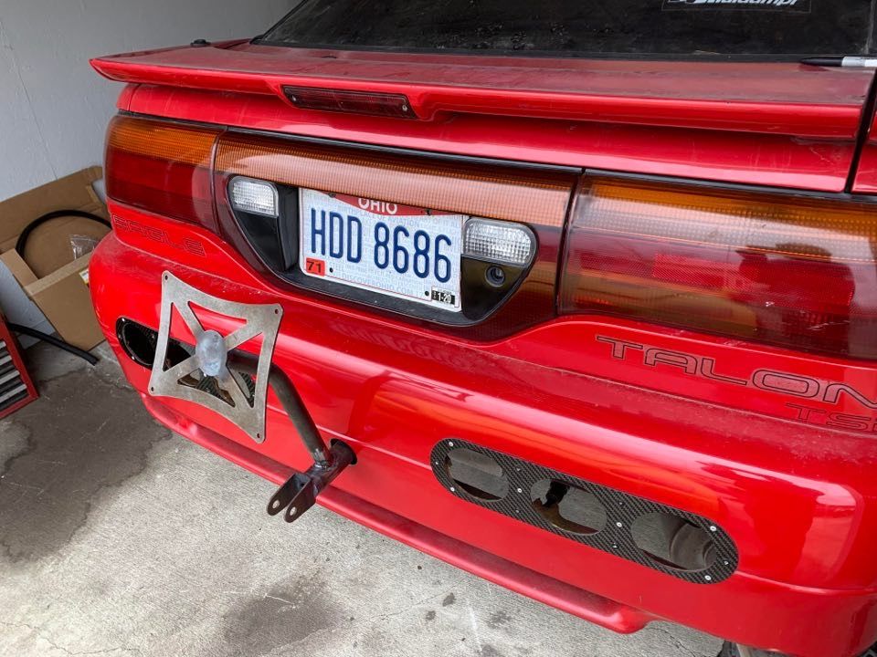

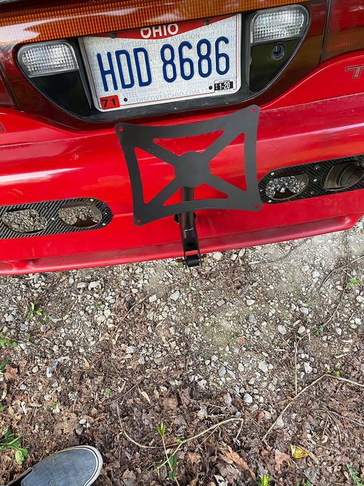

did a little tinkering this morning on the car

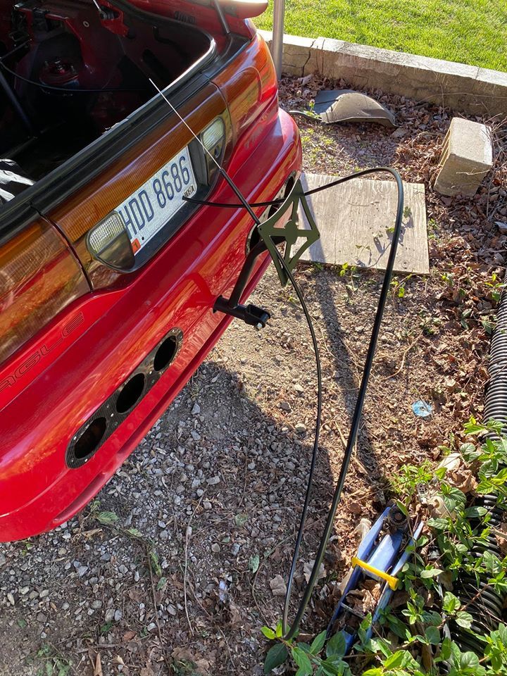

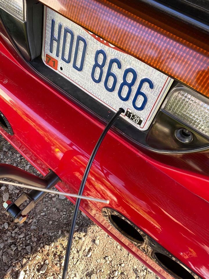

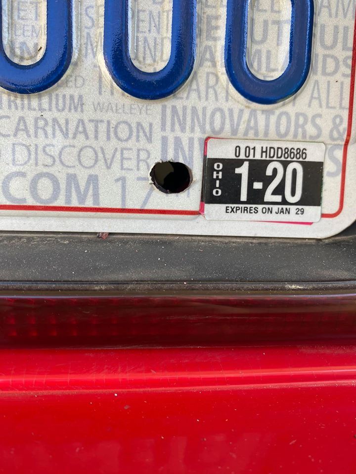

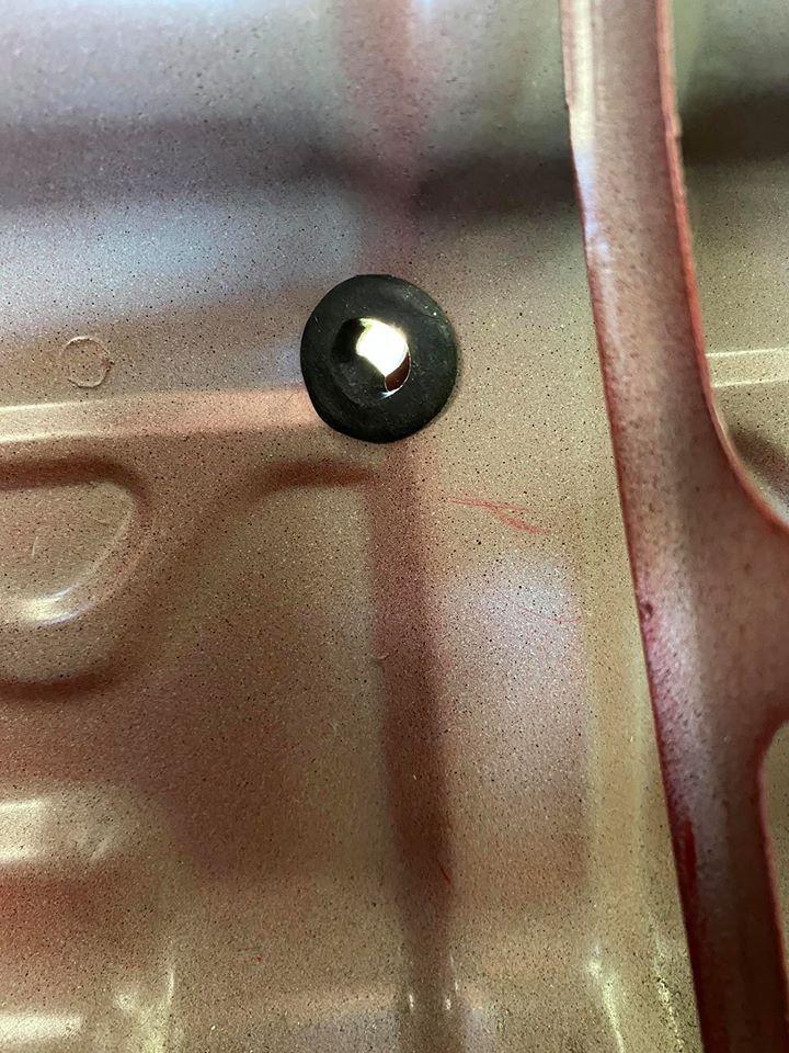

also got the hole drilled in the back where the cable is going to go through. it will come through the bottom bolt hole on the passenger side of the license plate.
realized that the chute mount kit i got didnt have the bolts to bolt the cable mount on so stopped here LOL. going to get some nice bolts to use. i need to pick a body saw up so i can get things ready to cut the dash and get it put in. then its downhill from there.
