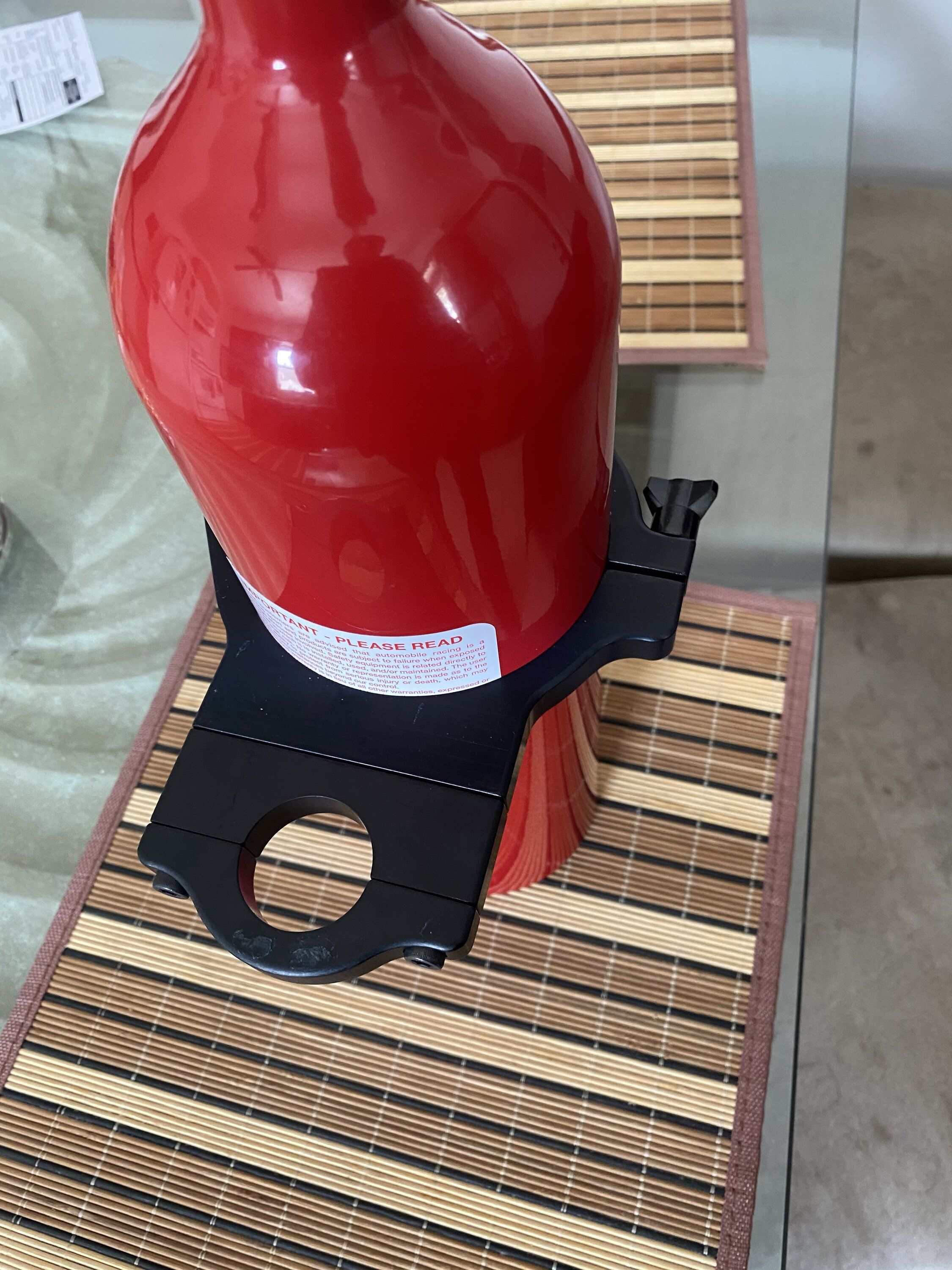

One half of my bracket showed up. Just waiting on the roll bar mount and I’ll start getting lines ran for this thing
planning on mounting the engine bay release in the center console where the cigarette lighter port is. The kit I’m going to get for the cabin area I’m thinking of making a bracket to come through where the vent by the drivers door is in this position.
might make this one a bolt on to the cage in case I decide to move it later on. Still undecided on it

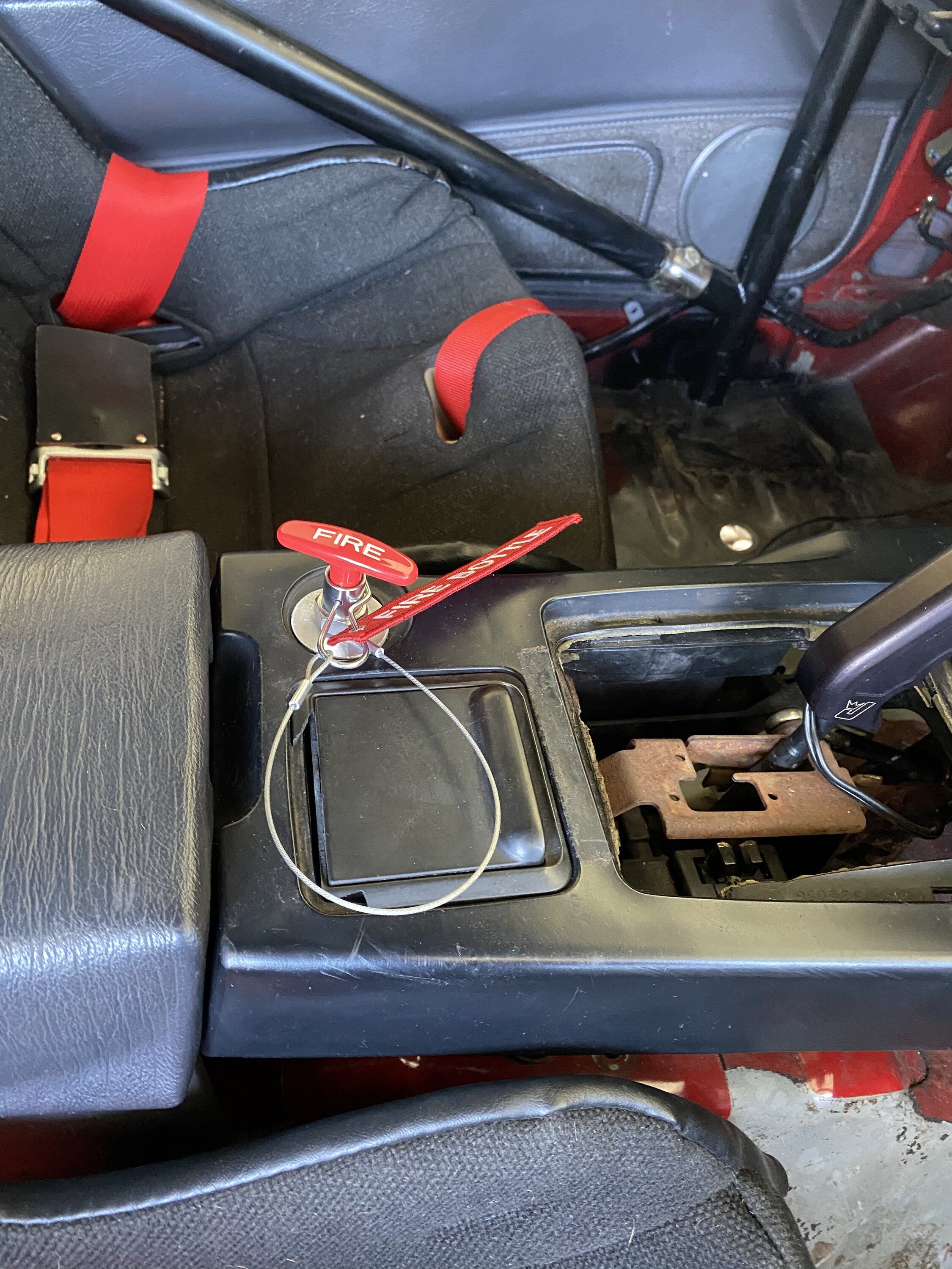

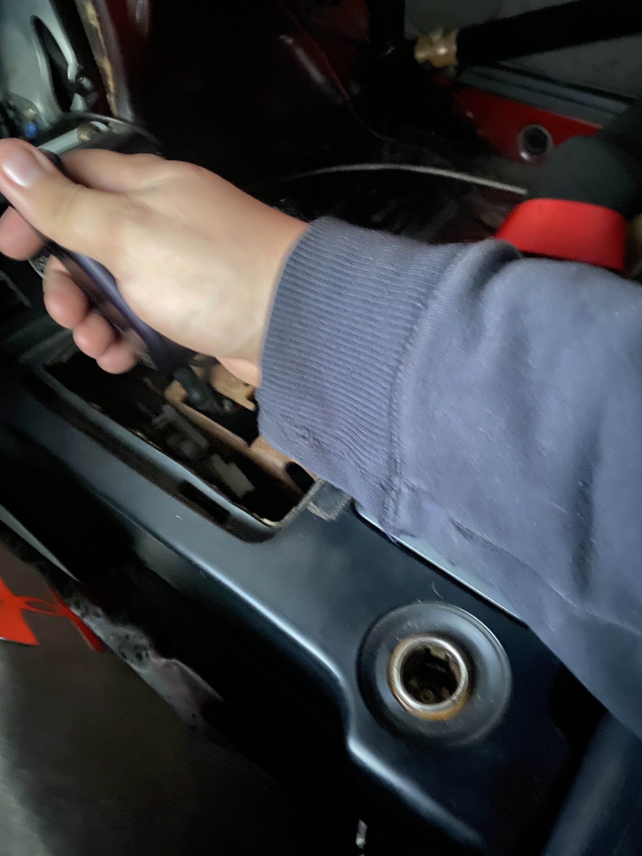

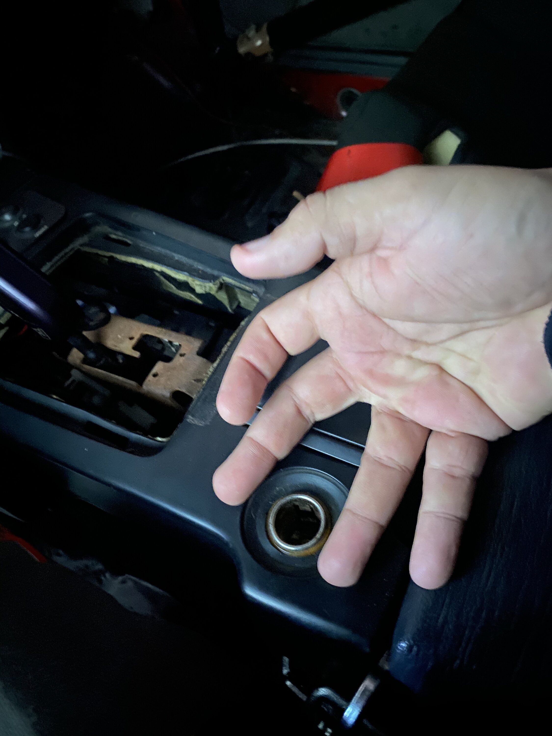

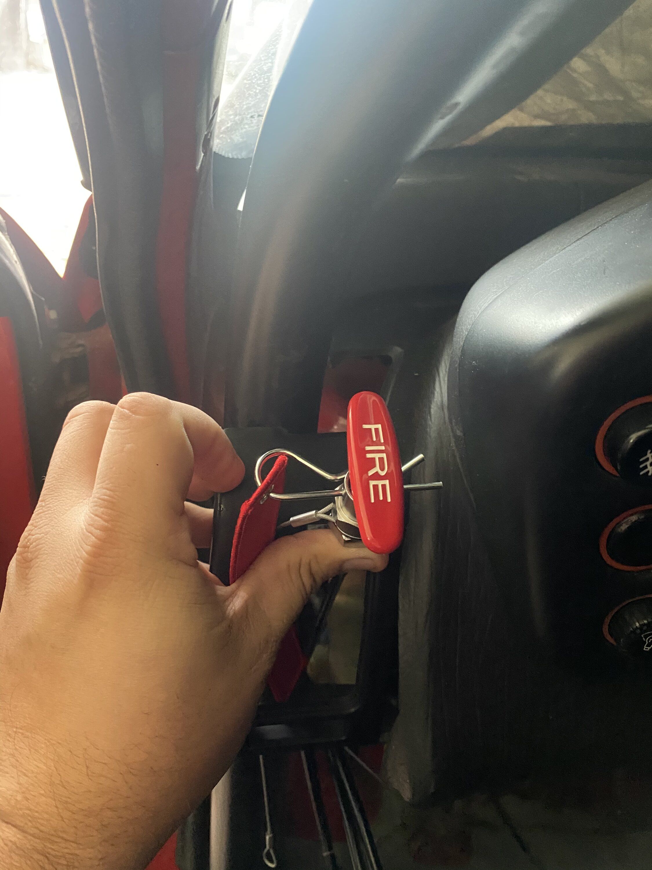

Little update. So decided the engine bay firebottle release cable was going to be on the center console. Looking around the hole where the cigarette lighter seemed to be the best choice. So I decided to strap myself in the car and see if it would actually work with me in position.
this is with my hand on the shifter in the drive position. I then pulled my hand back to see how comfortable it was to grab in that area

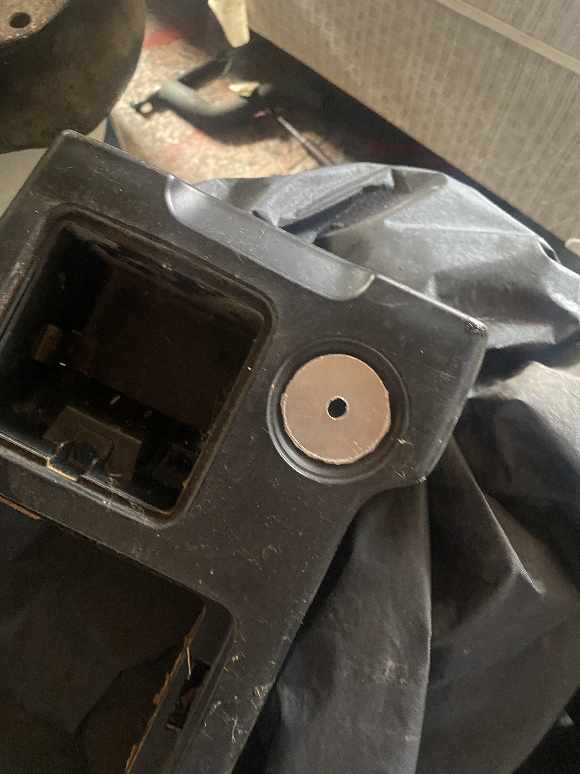

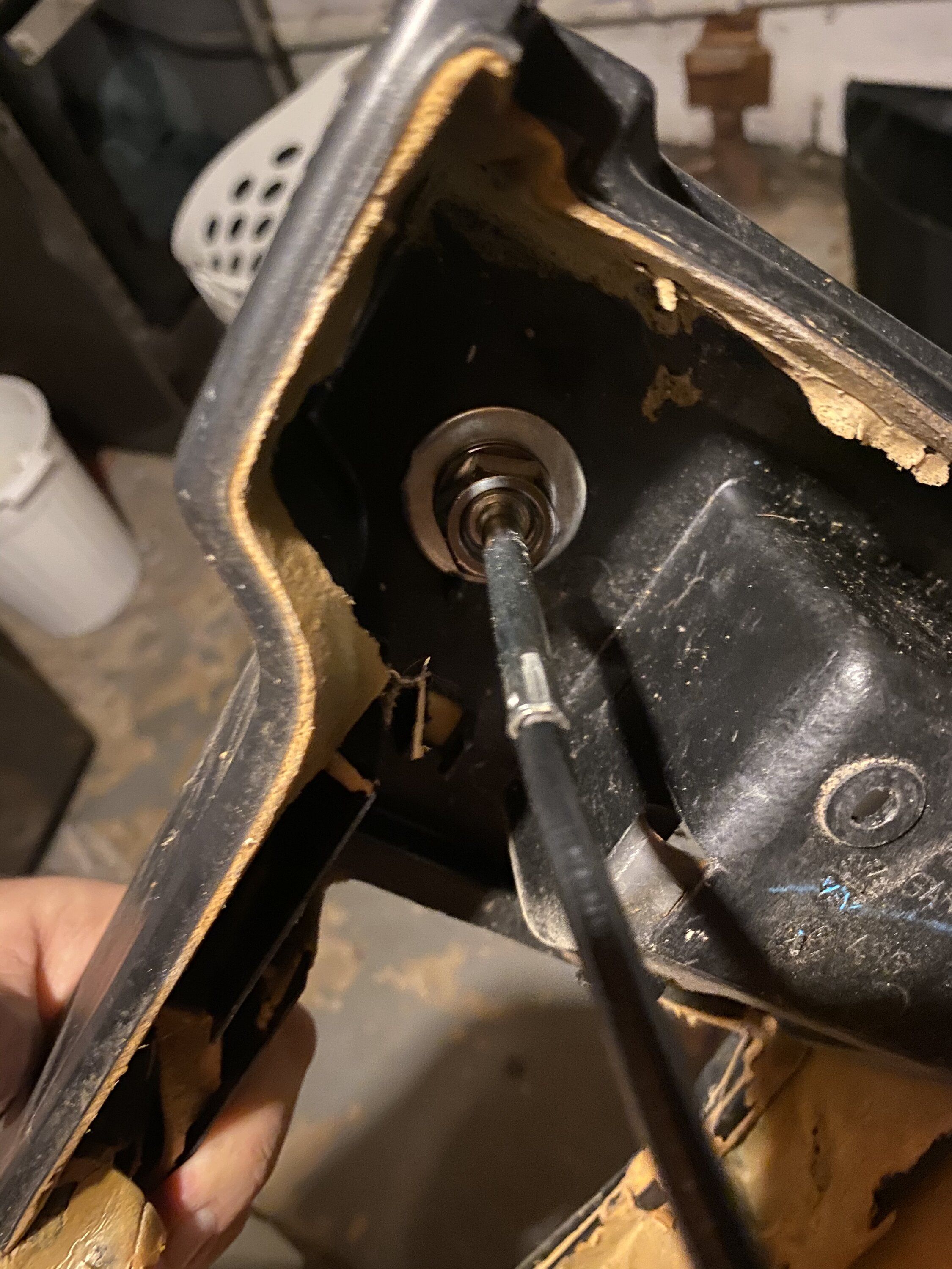

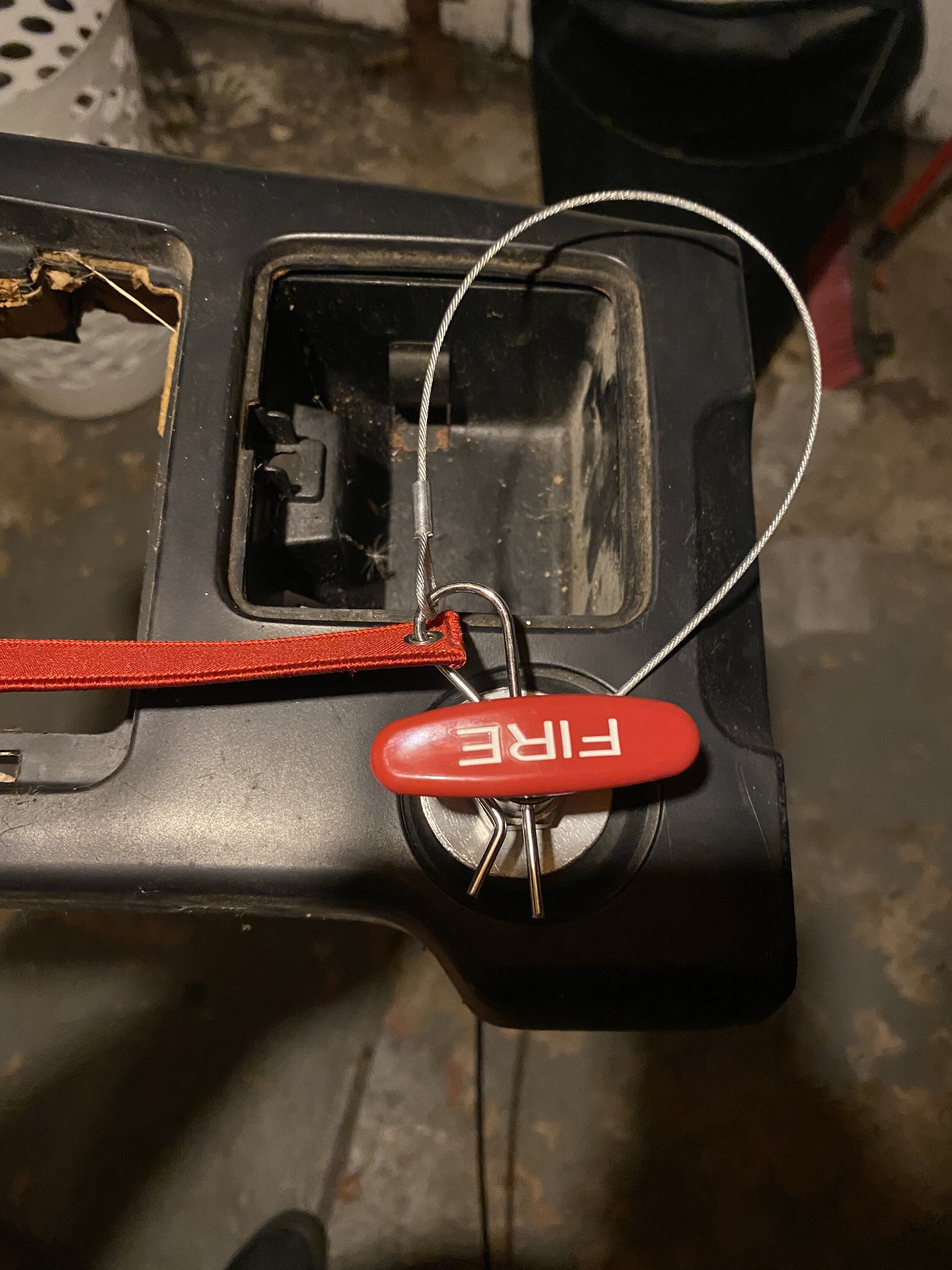

felt pretty good to me so it was time to make things work. Obviously that hole there was way to big for the handle to bolt into. I had a sheet of aluminum laying around so I took a hole saw and cut out a washer to fit
cleaned it up a little to test fit and this is what I came up with
little washer on the backside to help hold everything I place. Still need to clean the washer I cut out up a little more and I’ll probably paint it black so it blends in.
It looks like a good spot aesthetically, but might it make sense to keep it in reach of a track worker/safety worker in the event you're incapacitated? Not that we ever want to think that way, but the more options we give safety crew members to help us at the scene, the better, right? Just a thought.
I’ve been back and forth on where these should go. My thought was have the one for the cabin where anyone could reach it and the one for the engine bay where I could. I may change it again as nothing is set in stone right now

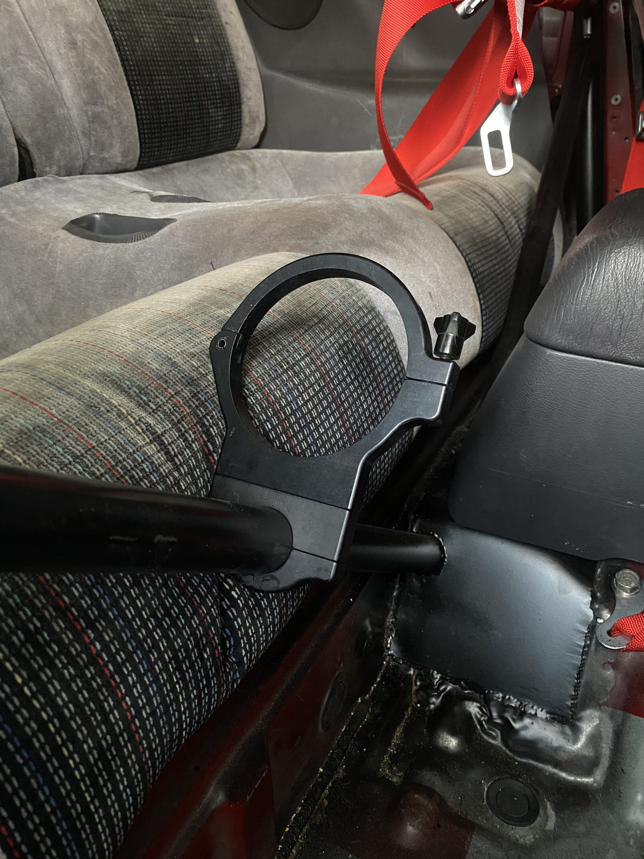

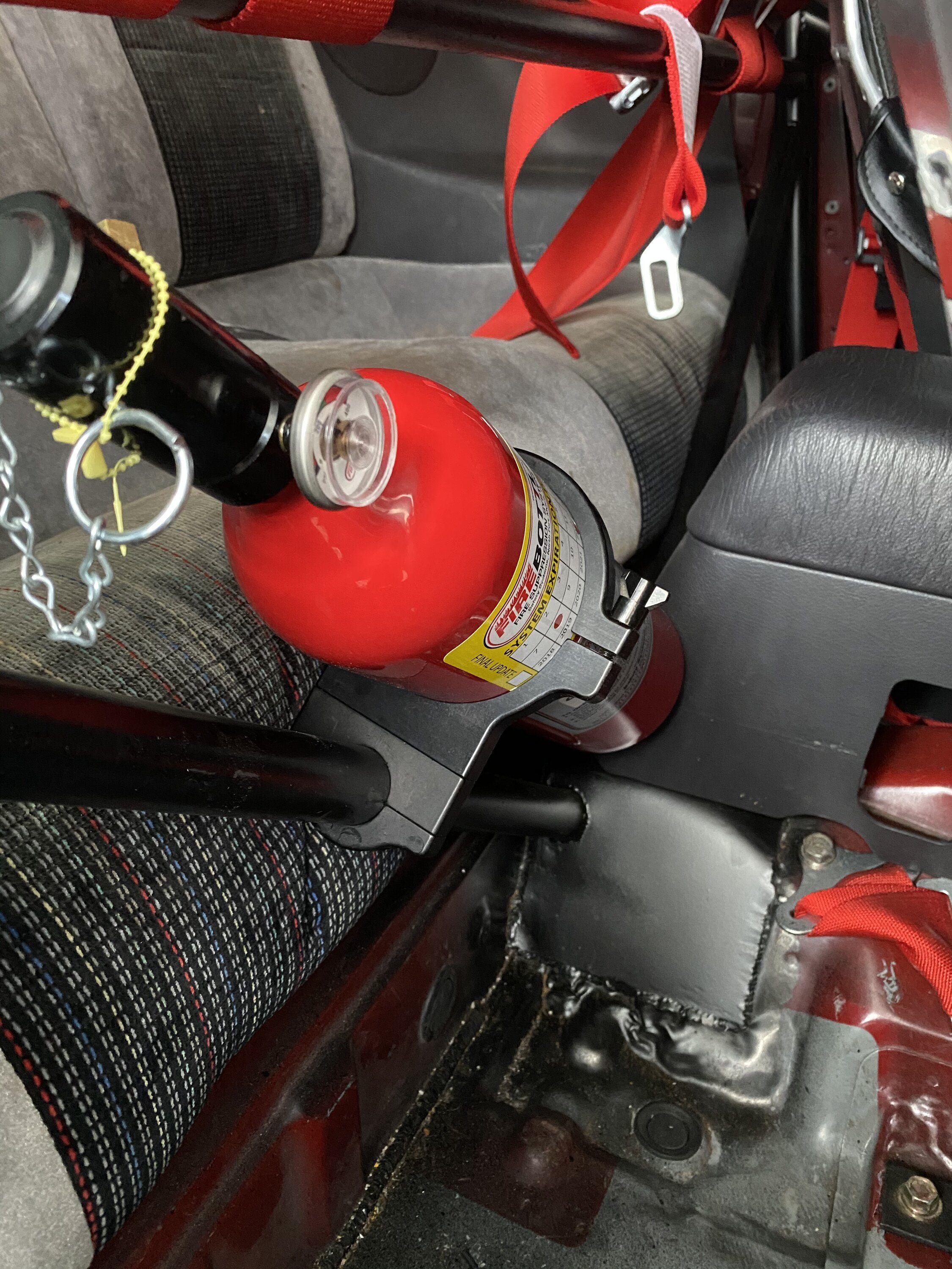

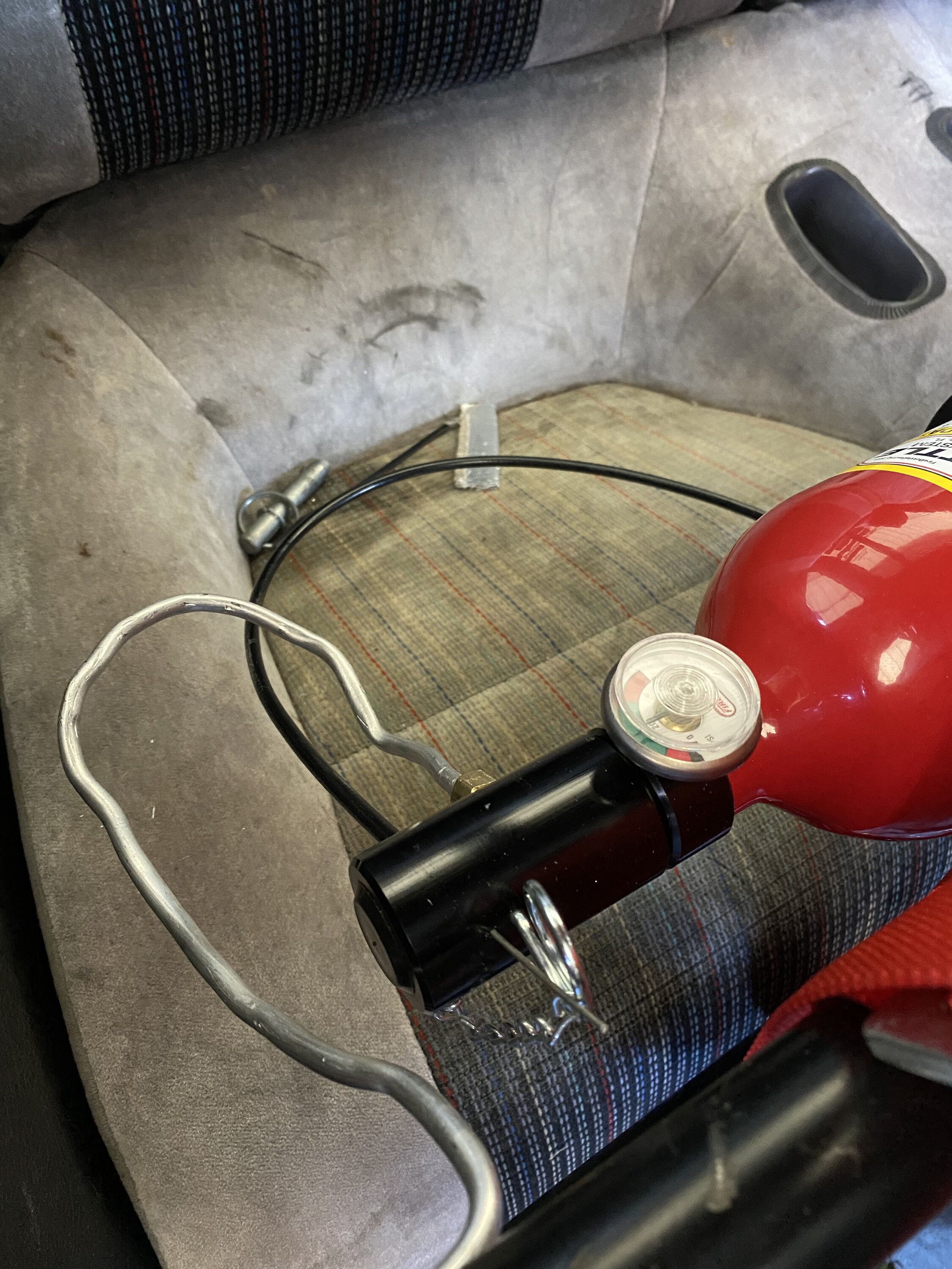

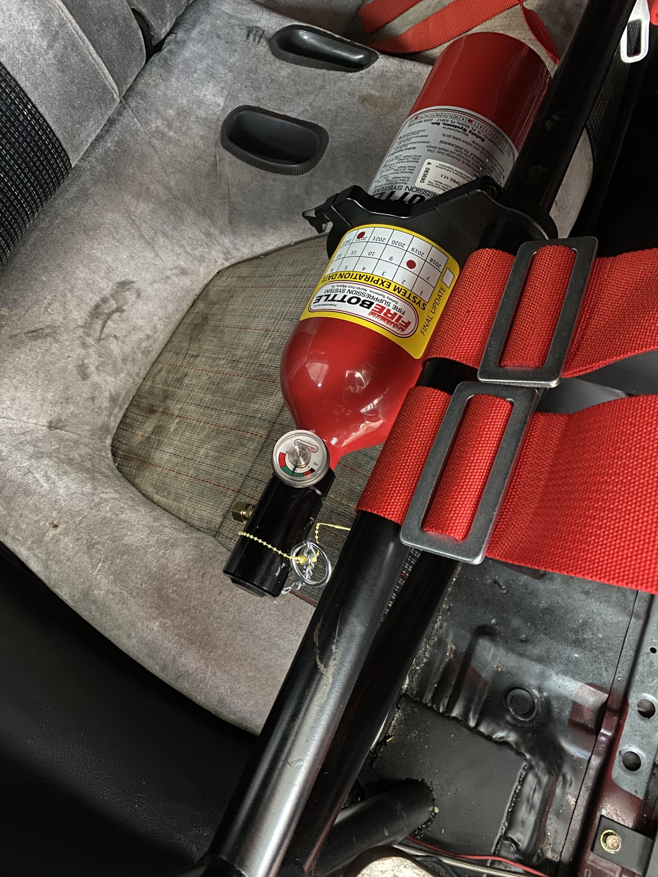

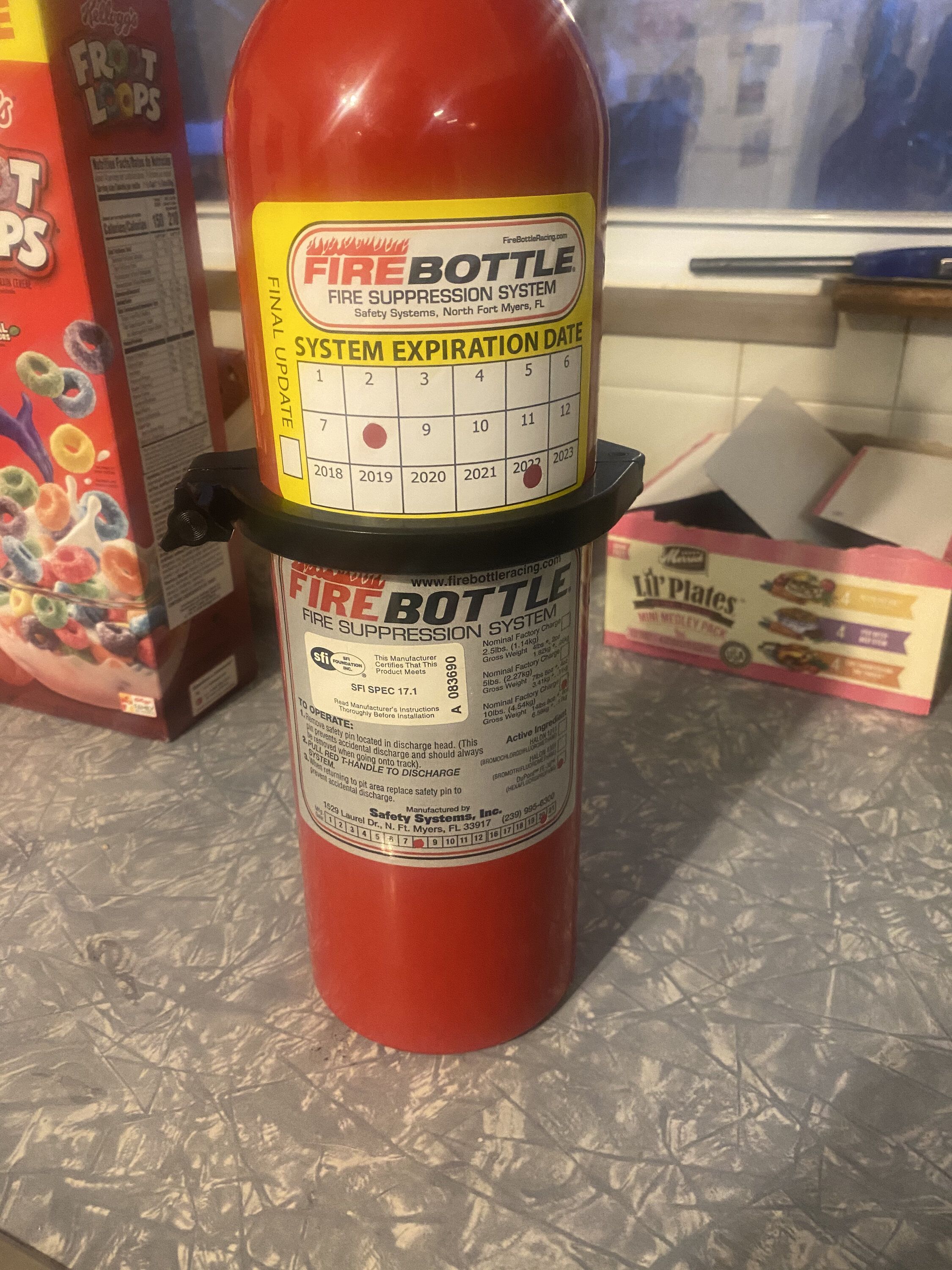

Decide to mess around with bottle mounting after work tonight.. the original plan was to mount it on the d bar but since I’m running a rear seat it doesn’t look like it’ll work out well. Next option is the harness bar. The harness bar location seems to be the best option as far as being out of the way and being able to see the gauge to monitor bottle health
This was taken with me kneeling outside or the door. Kind of hard to see the gauge this way. Rotating the bottle helped some but was still a chore LOL
The more I look at this one the more I like where it’s at. I’m open to any opinions or suggestions. More to come

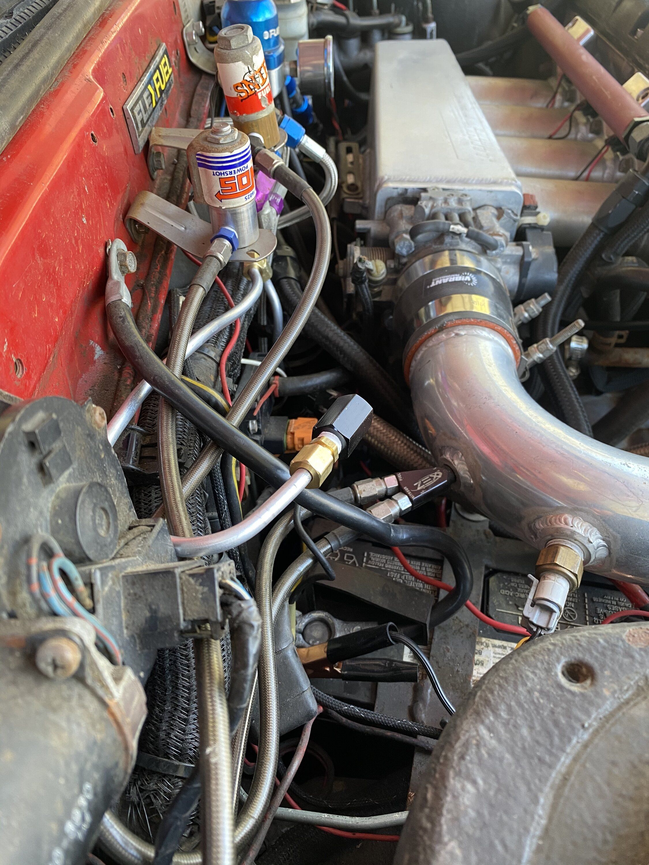

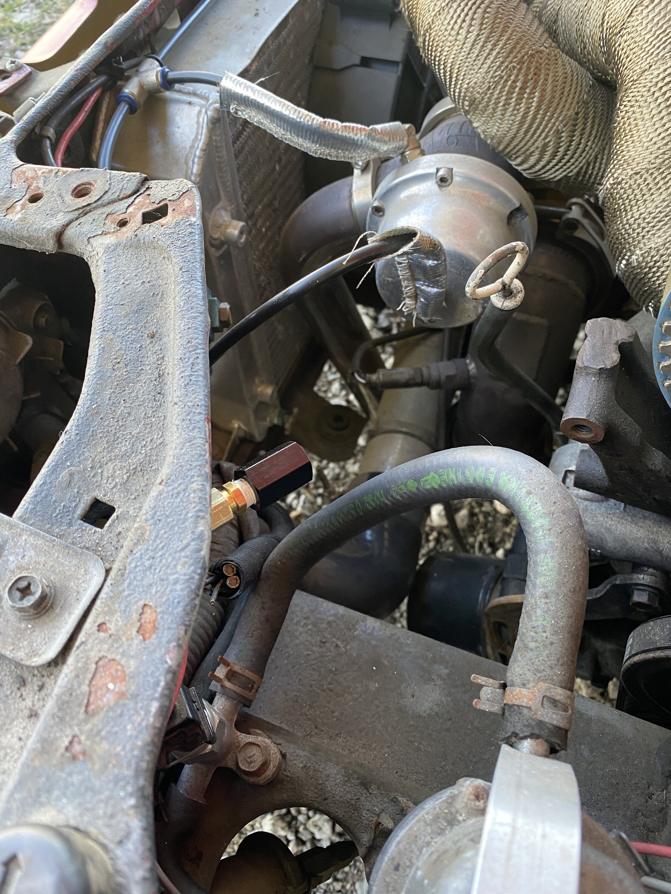

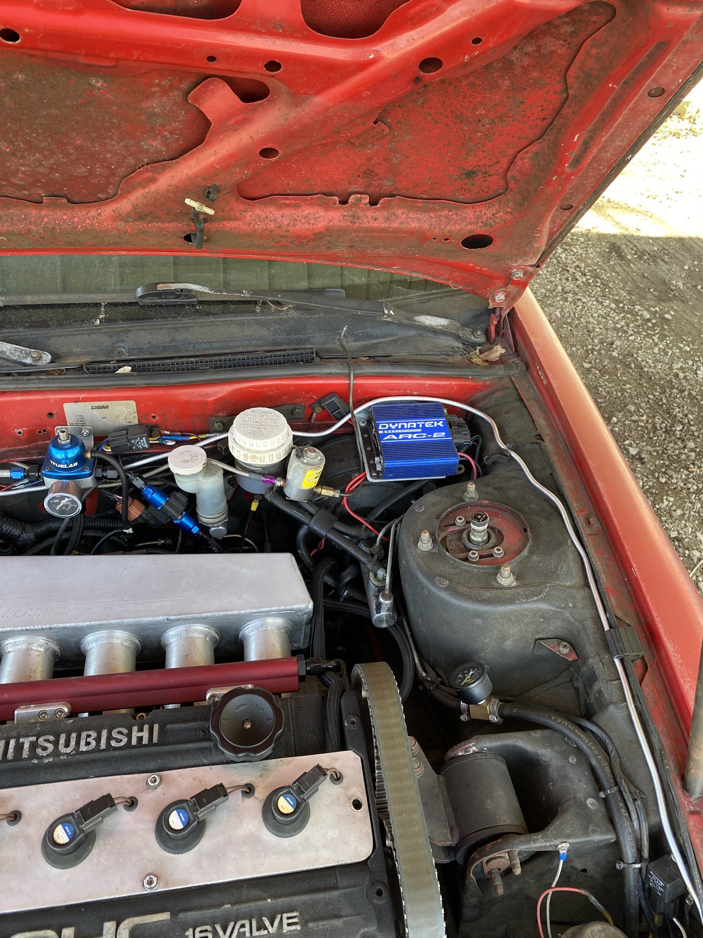

So I finally got the first fire suppression kit installed. I have to say I’m not super thrilled with myself and how it turned out. Functionally it’ll work great but esthetics wise I’m not too happy LOL I spent the better part of two hours figuring out where to bring the line through on the firewall. I’ll probably re run it once I swap engines. But this is basically the under hood layout for now.
Not sure how I feel about running it this way either.
Few things I’d like to change later but it will serve its purpose for the time being.
Then came the bottle and line up to it. Super annoyed with this one. Had a good bend to it with one slight hiccup and it just went downhill from there imo. Gave up so I didn’t destroy the line in the process
The tubing bender I had and the position I was in made for a rough time LOL. May cut this section and do a 4an tube nut and run a short soft line here.
Easiest part was the handle mounting. Especially since I had it all Planned out previously LOL
all in all I’m ok with it. It’ll do it’s job for now and I’ll make some adjustments later to make it more appealing.
Those tubing benders can get tricky if you're limited on space to maneuver. It works! Dress it up with some wire loom if you get self conscious :)
I never thought of that but that would work perfect! Yea it was a total pain LOL. I may get a couple fittings and some 4an and attach it that way too at the bottle that way it would make servicing the system easier.

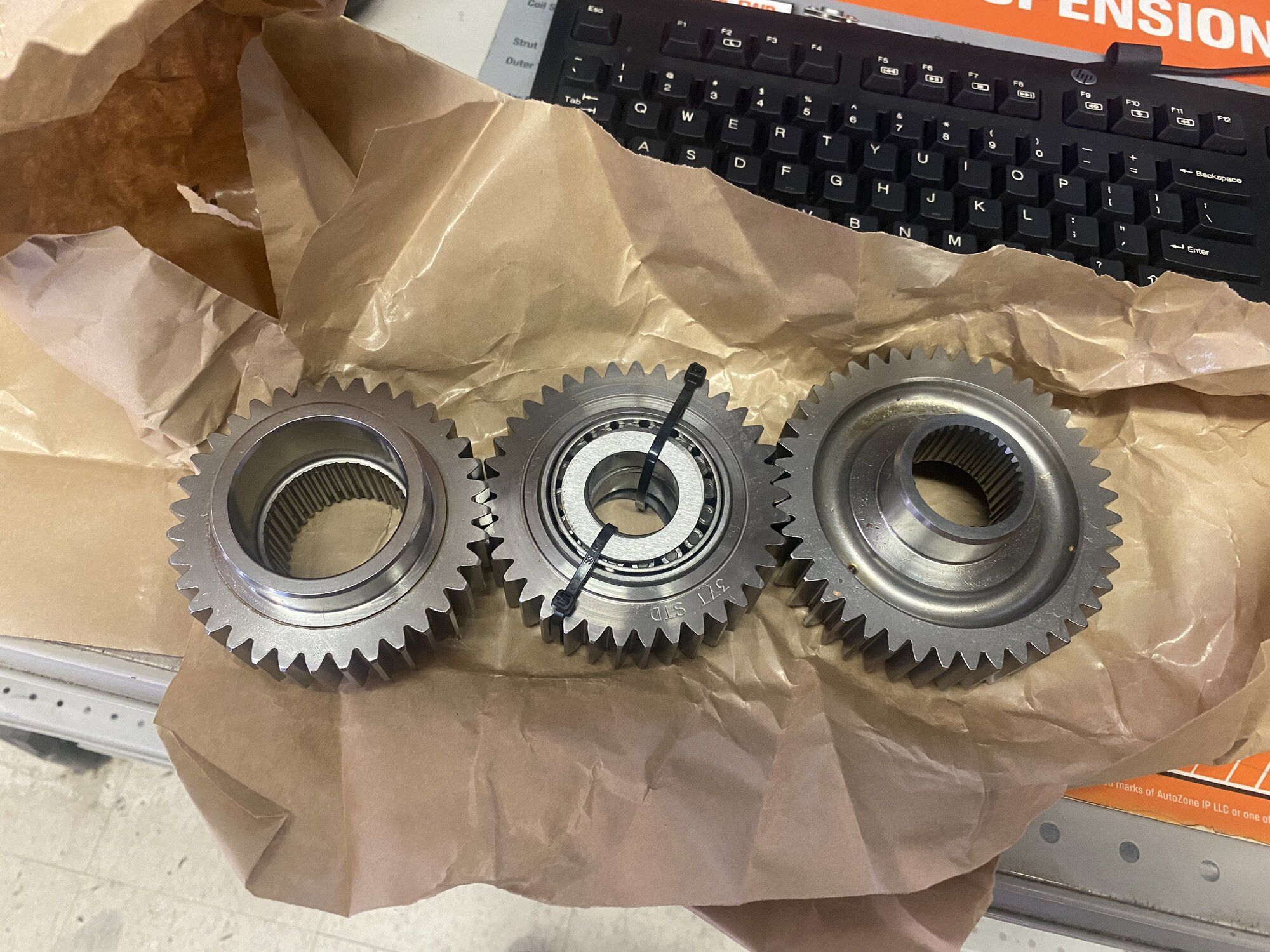

Not much of an update. I’ve had to focus more on our new house so the car has been on the back burner. Still gets drove but hasn’t been to the track yet. Did get the green light from the wife on ordering the billet transfer gears from libertys gear. Here’s some new pics that were taken of the ole girl
Toss them "GENTLY"!!!!
Aren't they PRETTY??? ;)
I hear "good" things (all might have something bad) about Xona. Adriana Noonan likes them. She has nice car!
Got one of the tapered bearings ordered today to get these billet gears put in. Had to pull one of the gears out of my spare trans to rob the bearings off of so that I can swap to the new gears so it’ll be a quick (knock on wood) job to just swap out.
