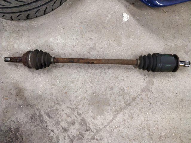

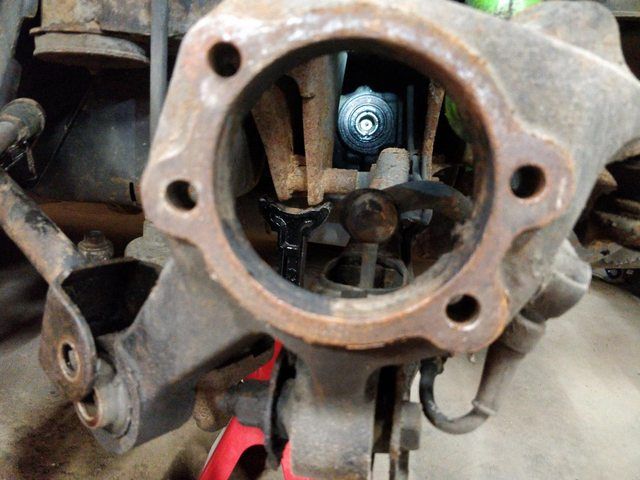

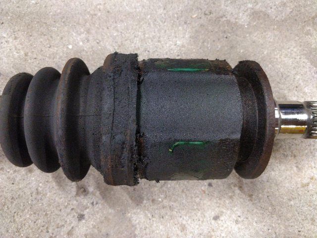

While checking out the exhaust situation I noticed that the left rear half shaft inner CV boot was leaking. After confirmation that my local axle shop can have it rebuilt this week I pulled it today.
I pulled it out through the knuckle opening. It probably would have been easier to pull it through just enough to clear the differential then slide it back out, but whatever. It is done now. It's a REALLY good thing that I replaced this whole hub last year because it came apart very easily. Also I pulled off way more than I needed to. Ignore the disconnected trailing (?) arm.
Missing the CV boot clamp. Surprisingly there is still grease inside in spite of how much clearly leaked onto the differential and subframe.

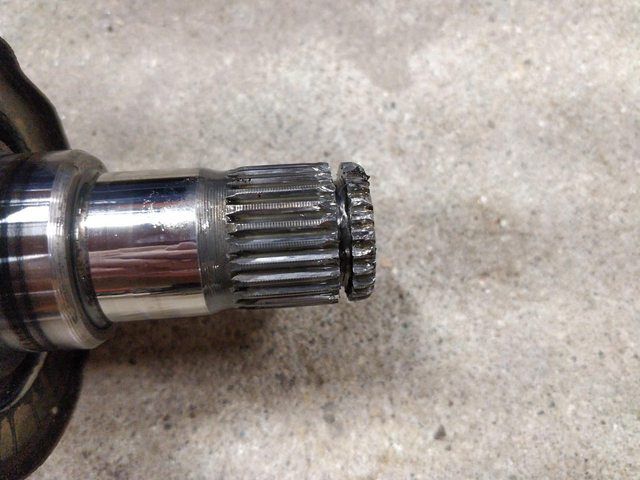

But this is no bueno. The c clip is completely missing, and the shaft has slipped out of the differential at some point in the past and damaged the threads as a result. God, the previous owner of this car was a real piece of shit.
This all needs to be back together because I've got help coming this weekend to install the sway bars with me.

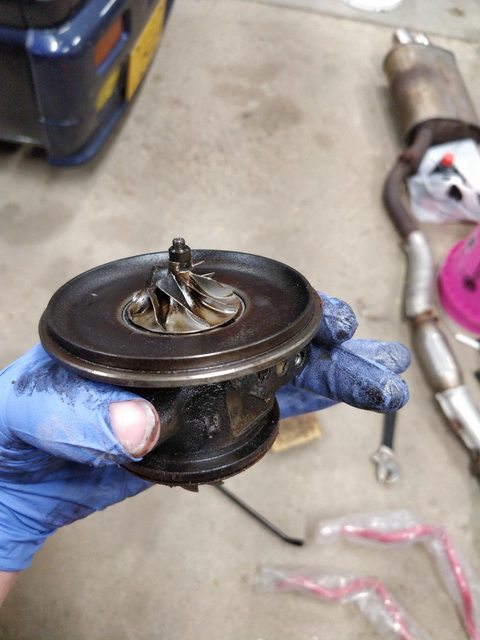

In unrelated news, I am rebuilding my first turbo! This was the celebratory picture when I finally got the turbine housing off. It's a 60hp turbo from my van and it's so tiny! Unfortunately that only makes it more difficult to rebuild. I bought the ONLY RHB3 rebuild kit in the entirety of the US according to GPopShop. And I accidentally destroyed one of the components so they're drop shipping me a ~10mm "piston ring" from the manufacturer today. I'm bad at this.

EDIT: After 30 seconds of researching, it looks like I might have non-LSD axles with LSD inner cups, hence them not matching. And also possibly explaining why the boot clamp is missing in the first place. What I don't know is why (allegedly LSD was standard on 98+ Eclipses) or if the passenger side is also using a non-LSD axle.
A lot has happened this week. The axle came back from the shop. It is confirmed to be a non-LSD axle with an LSD inner cup. It has a fair amount of play, but it works. For now. I will, in the future, either buy a set of used non-LSD axles or buy a set of these (https://www.rockauto.com/en/moreinfo.php?pk=5468055) and then toss in an EVO clutched LSD.

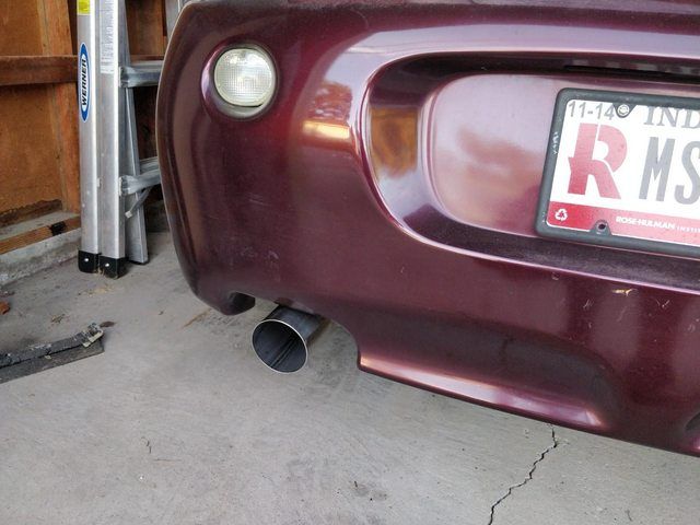

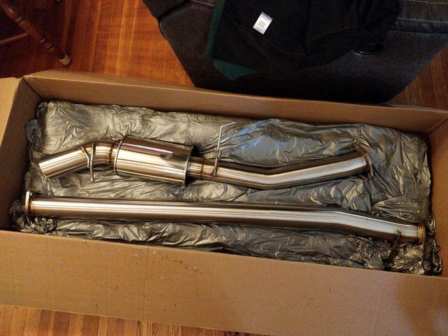

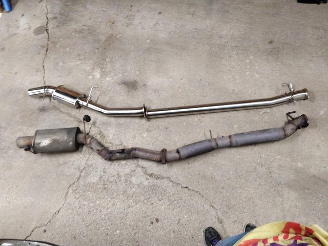

I ordered the STM catback Sunday. It arrived Thursday. I will post a review of it once I get some videos of it. Until then, I'll start with the pictures.
This thing is beautiful. The quality is absolutely amazing. I can't believe that this went for only $500 two years ago. I went with the catback option because I already have a decent 3" downpipe, and I had a cat welded into said downpipe less than two years ago. Of course, I installed this same day.

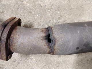

I probably don't need to add a description to this picture, but I will anyway. At least part of this started off life as a 2g catback, but it has been cut up and rewelded so many times since then that I have no idea what it was. And it is heavy! It has to weigh at least 35 lbs. It is a lot heavier than the OEM GSX catback that I have laying around my garage. It used all of the factory hangers and it needed to, because it stretched that rubber a lot under its weight.

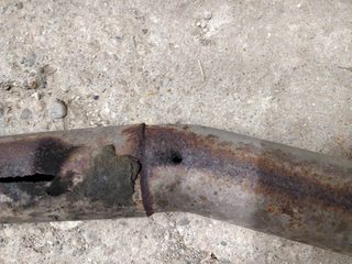

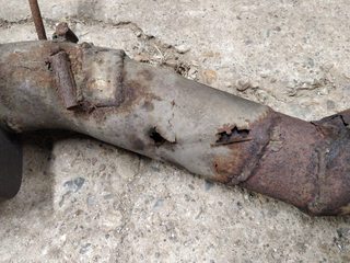

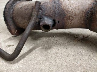

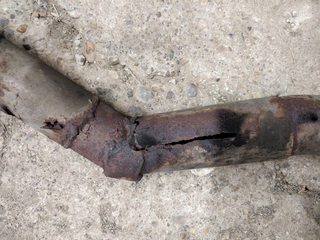

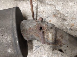

Here are some close ups of the spots of interest on the old catback, starting at the cat flange and moving rearward.
If it looks like a perforation, it is. Some of this is corrosion. A lot of this is an incompetent welder burning through the mild steel. At least now I know why it was so loud and sounded so bad. Also!

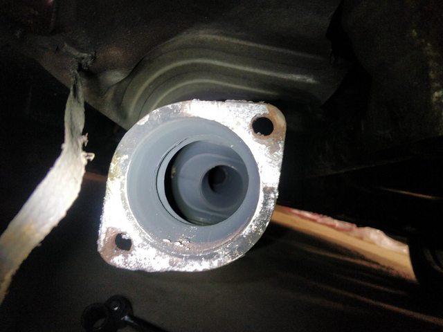

This is the inside of my catalytic converter. It is just under two years old and has less than 1000 miles on it.....and it's gone. So, another reason why it was so loud and sounded so bad. Now I get to decide if I want to have another cat welded to my current downpipe or if I want to buy the STM downpipe, have a cat welded into that removable test pipe, and risk the fitment with my current O2 housing, which is a common complaint with that downpipe.
But anyway, I got the catback installed without further issue and went on a quick test drive. People claim that catbacks will "mellow out" as they break in, but here are my initial impressions.
Aesthetics: this review doesn't get off to a good start. The tip looks dumb. I'm very glad that it's not bigger, but it looks really out of place in the wide, rectangular factory cutout. It needs to be maybe a half inch bigger or, preferably, a dual tip. I spoke to STM before ordering about making a dual tip version for me. They said they absolutely could but it would be at least 8 weeks before they could take on any new projects. Since I needed the old catback off ASAP, I made do with the single tip. For now. I'm shopping for dual offset rolled tips to fix this.
Sound quality: I'm very impressed. My car went from sounding like a pathetic SOHC Honda to half of a V8, if that makes sense. The few videos online that exist of this catback capture the quality of the sound well enough, but it does sound a little better in person. On startup it has a certain quality that's almost to a growl, and at WOT it has a nice deep scream. The sound of this car is no longer embarrassing!

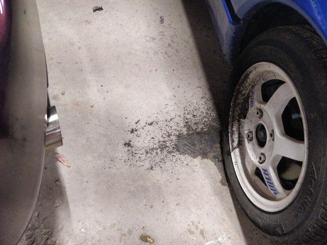

Volume: It's bad. Like, really bad. This is by far the worst part of this exhaust. On cold start, this unit is exactly as loud as the swiss cheese abomination dump-after-the-cat that I took off. It does quiet down as the engine warms up and the revs get more stable, but at that point I've already woken the entire block. Cruising around town it's ever so slightly quieter than the previous unit but I still get just as many angry stares from pedestrians angry about the ridiculous noise coming from my car. Under load and WOT this exhaust is WAY louder than the old unit to the point that it's unbearable. The sound quality can be amazing all it wants but if I can't handle how loud it is, I'm still just as unhappy with it. This car is a DD and the volume of this exhaust without a cat is absolutely unacceptable to the point where I don't consider it an overall improvement over the pile of rust and holes that it replaced.
Performance: Wow. The old exhaust was a straight through setup with holes everywhere and yet there is a significant torque jump with the STM catback. Off-boost torque is FINALLY what I remember from my three previous DSMs. I guess this somehow explains why a 9:1 compression build didn't improve things. Somehow, it was the exhaust. The 16g still hits 500RPM later than it did on my Spyder and Talon, but at least now it hits just as hard and keeps pulling. I've already confirmed that there wasn't anything clogging the old exhaust, but it really does feel like I just removed a massive exhaust restriction and the engine/turbo can finally breathe properly. Note to self to confirm that the boost controller is still set at 21 psi. I'm no longer looking forward to imminently upgrading the turbo to 68HTA spec, although that will happen eventually.
The top priority at this point is to get a cat installed. If it's still too loud I guess I'll start installing mufflers and/or resonators into the catback as necessary, which would be really disappointing since I haven't found any competent welders in Indy yet. I just keep finding places to which I will not return, and I really don't want to mess up the excellent build quality of this unit. Also, as previously mentioned, it really is time to have this tune touched by a professional. I have taken it as far as I can.

I ordered a second Magnaflow 99009HM cat and replaced the burnt out one. It is quieter, yes, and thankfully the smells are gone, but it's still too loud. Driving a rear engined car behind my Eclipse and sticking my head out the window, it doesn't seem that loud to other cars on the road. But driving through empty streets it reverberates off the houses a lot, and unpleasantly loud inside the car. I'm looking at a Vibrant 1119 to put somewhere in the exhaust. And if I'm going down that route then I might as well have twin tips installed at the same time.

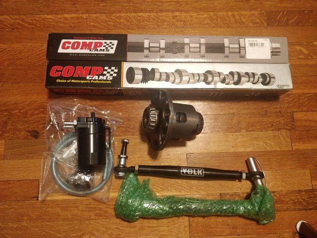

In unrelated news, I have an EVO 3 clutched LSD waiting to get installed. I need a set of non-LSD axles to run it. Rock Auto sells them for $57 each if I can't find a decent OE set.

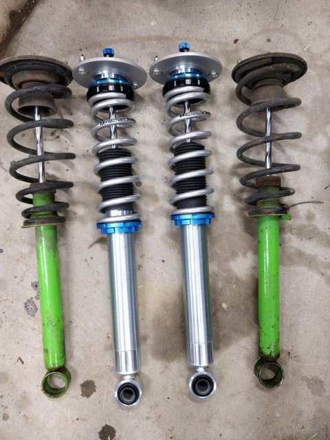

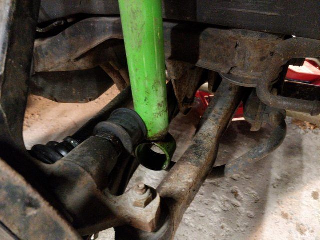

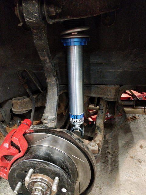

In other unrelated news, I have a coilover set on the way. I got in on Flatout Suspension's offer for a review set and am very excited to replace these OE-replacement struts. Handling is quite disappointing at the moment. And related to that, I still have the RM sway bars to install. I'm getting a new impact for Christmas and that's what I have been waiting for.

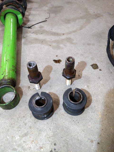

The Eclipse has been down for two weeks now. I started on the sway bar and steering rack install and it has been a disaster. An impact couldn't get the end links off and I had to use an angle grinder. Not terribly surprising, but inconvenient. In my removal I found that the steering rack boots were torn so I decided to order new inner tie rods and boots. The outer tie rods are brand new.

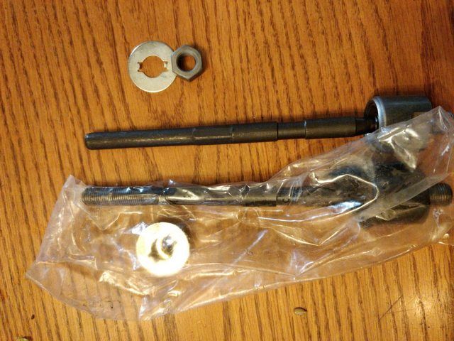

My box arrives from RockAuto and I discover that I had only ordered one boot instead of two. But that didn't matter because one of the tie rods that I got was defective and completely missing threads.
So I initiated a return but since they estimated that a new order for the missing boot would arrive a week after the replacement tie rod, I picked one up at the O'Reilly distribution center in town, which is a story of its own. I took the truck and the fuel gauge hit empty as I arrived there, so I stopped for gas. But the fuel door was stuck closed. It has a lock that opens with the key and the lock was not accepting my key. No amount of impact or jiggling could get it to open, so I called the husband and told him that I would be running out of gas on the way home and he should be ready to come pick me up with his own truck key. I made it the 45 minutes back on fumes but haven't bothered to look into the fuel door lock because.
The replacement tie rod arrived today and I sat down to install it. The new one went on just fine. No defects. No problems. But then I installed the second old one only to have the included nut seize on the shaft maybe 1/4" on. It was seized so intensely that I had to use my impact to remove it and I am baffled as to how that could possibly happen. But some of the threads are mangled, and when comparing the two tie rods I found that this damaged one is also missing 1 1/4" of thread down the shaft so it might not have worked anyway.
I initiated a warranty return (again) and this time it gave me the option to order a part and they would issue a refund when they receive my returned unit. I placed the order, noticing but not thinking about how it was more expensive than it should have been. Then I go to start uninstalling the tie rod from this steering rack and realize that the boot clamp is one time use and I will damage it by removing it, so I need a new clamp. I go back to RockAuto and find that I had still had one of the boot kits in my cart that managed to get included in my RMA purchase so at least I will be getting a new clamp, but I don't need (and didn't intend to order) a whole new boot kit. RockAuto doesn't have phone numbers for customer service so Idk what I'm going to do about it but I should probably wait until tomorrow because right now I am just pissed off.

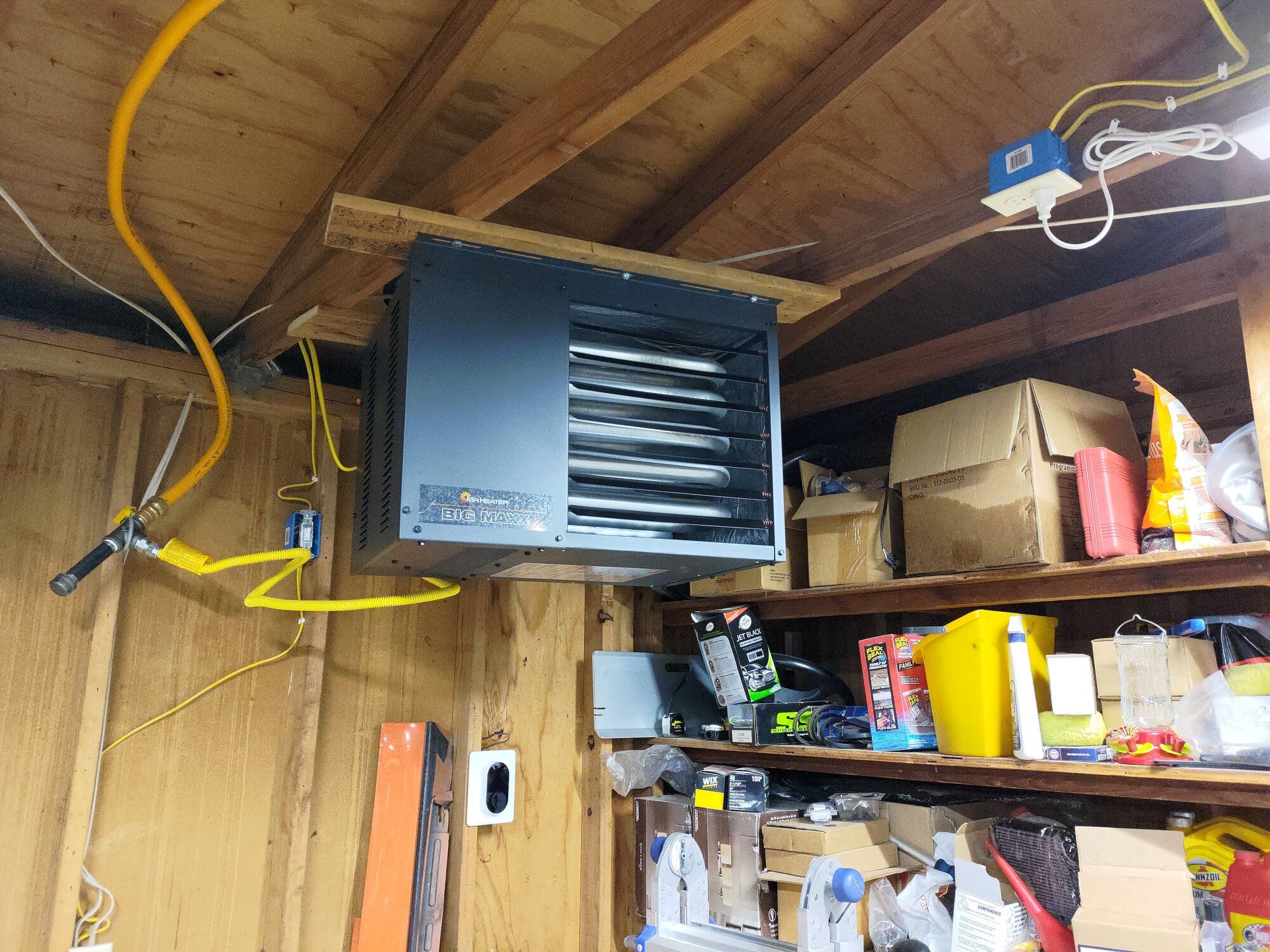

In better news, I got a garage heater installed last week. I'm glad that we no longer need to use propane when working out there, but this heater kind of sucks. It's the same BTU rating as the propane unit but it doesn't seem to do much. I supplement it with an electric heater and if it's really cold I STILL have to use the propane heater. At least this one was super cheap and I won't feel bad about throwing it away in the fall when I get a nicer one.

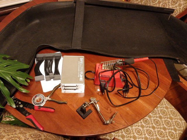

I've been avoiding this for a whole week, but today's the day that I get started on this harness and MS3X install. I guess the first step is to get this tonneau cover out of here...
The Megasquirt has been in the car for almost two months now and idle tuning is......going. I'm still finding small things to fix, which is why I haven't created a "Megasquirting a 2g" thread yet, but rest assured it will come. I've had a few wires that I accidentally ran to the wrong pins (like ISC being wired backwards) but the latest issue was that I ran the active high AC switch to a switched ground input on the Megasquirt. Moved that wire from Tableswitch to Nitrous In and suddenly AC works now! I've also found a bunch of settings that have helped smooth out idle, but I'm going to have to start over again on the VE table once I get the cams installed. I guess this is a good time to post my MSQ while I'm still on the stock cams, but I've got a few other small changes to make to the tune before calling it a good 4G63 base tune.

I've got all of these to install. The cams are FP1s and the diff is an EVO clutched LSD which is waiting for a set of non-LSD axles to materialize. The plan was to install the cams yesterday but as I started pulling things apart I realized I don't have replacement cam seals and mine are leaking. I have no idea where to install the RTM catch can since I still have the battery in the original location. The only place I can find on the passenger side of the engine bay is under the intake pipe where the boost control solenoid used to be. Toe arms will go on this week once I can convince myself to cut the old ones off. This car needs an alignment so badly.

I also installed a garage heater after the pipes froze last week. Securing the gas supply and tidying up the electrical stuff is my project for tonight. The thermostat is giving the MegaSquirt a run for its money in being my most hated electronic item and I modified a Wifi Smart Switch using pieces of Suzuki Alto chassis components in order to try to get the thermostat to function below 50 degrees.
