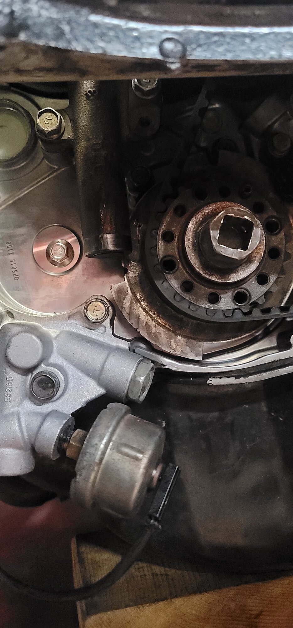

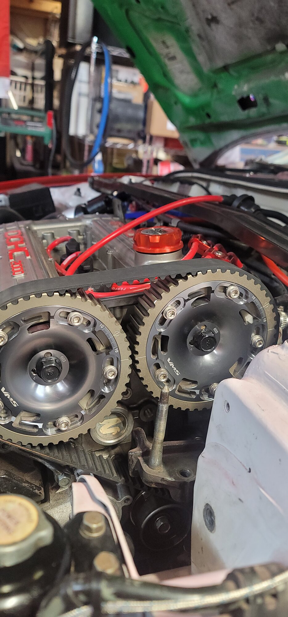

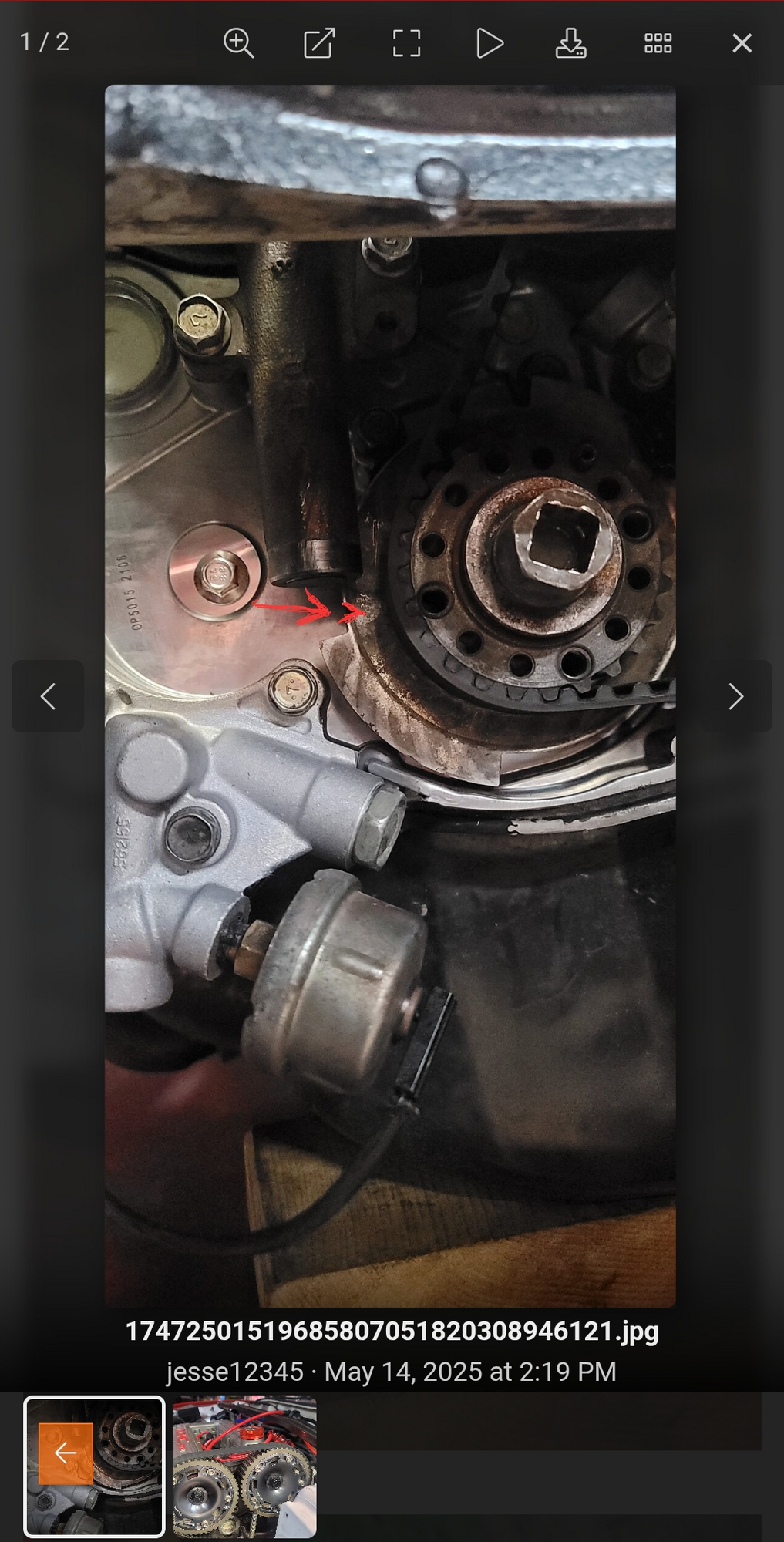

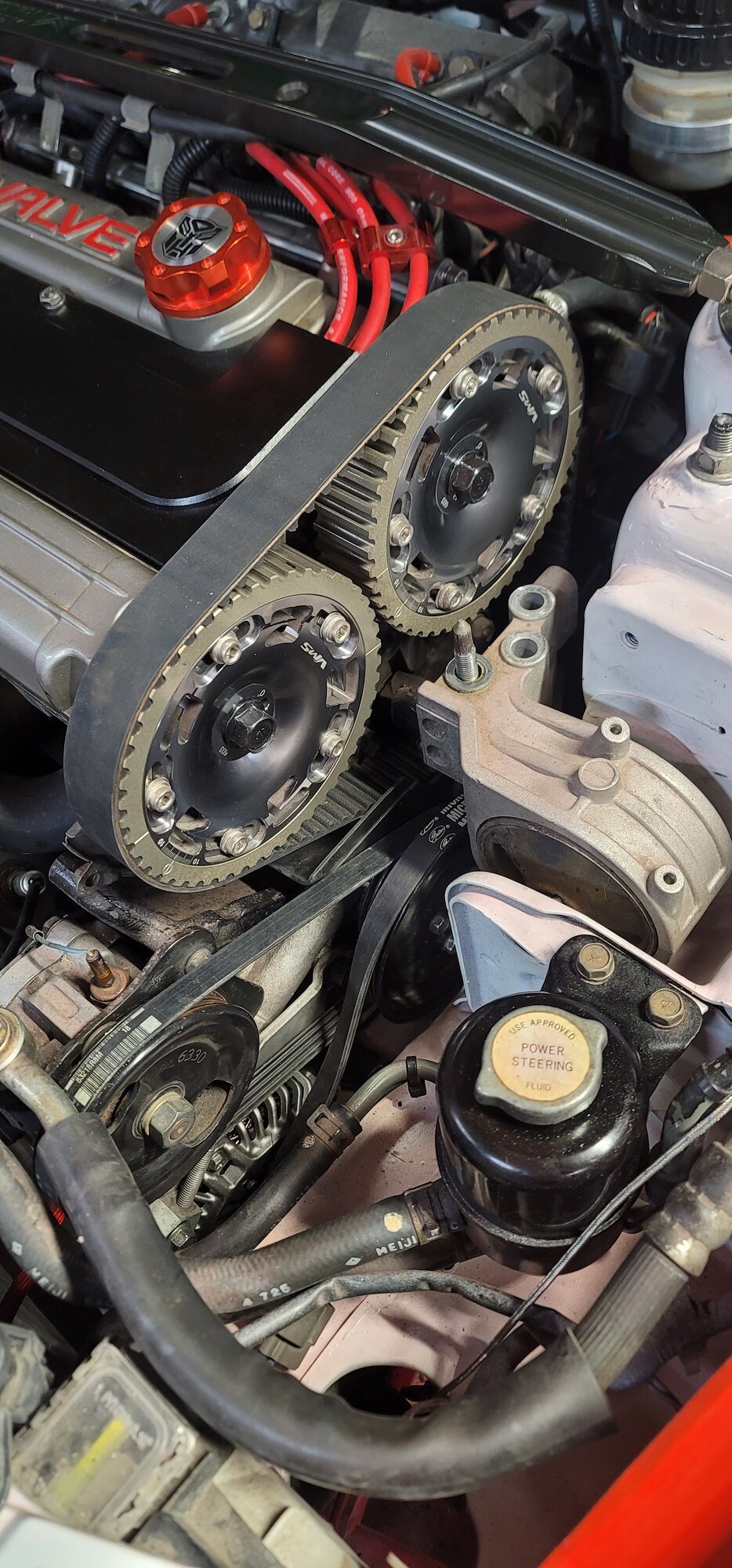

Now I'm a little worried, my timing is off and by a fair amount. The cams stayed in time with eachother but the crank is a bit off, so I guess I'm crossing my fingers at this point.
Cams turn half speed of crank. How many teeth are the cams off. I prefer to line cams relative to crank. So to me in time is crank on mark. Then look where cams are.
It's possible to slip a tooth on the crank and not damage valves. In my case it was still running (like hot garbage). Hopefully the same result for you.
Yes - it is possible to be one tooth off and not bend valves - re-do the timing belt making sure the marks are all aligned, then test your compression. Maybe you got lucky

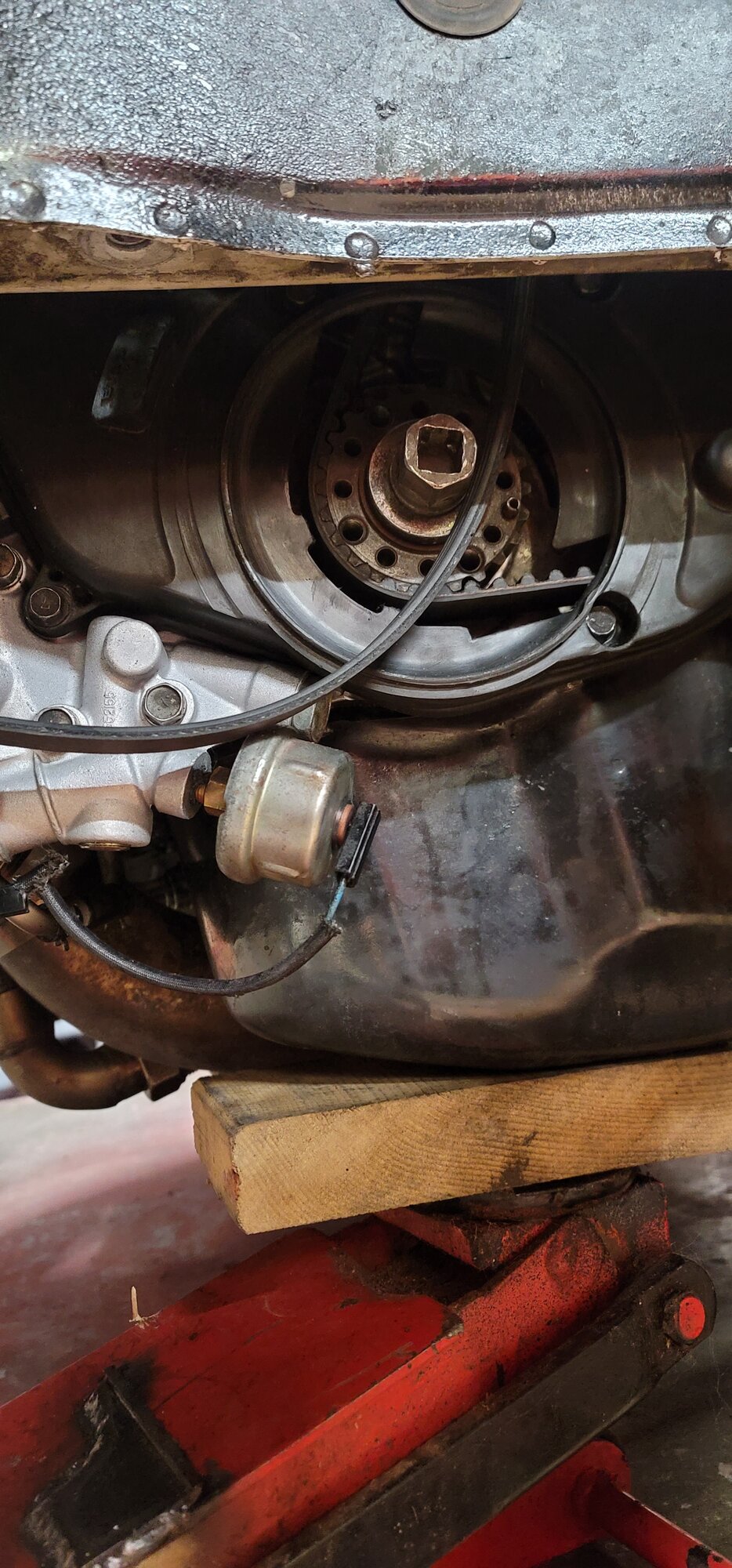

I dont know how it was off but it seemed like it was off more than a couple teeth. I put my new belt on and it's running fine. I have it all apart still and I'll show a picture of how it was.

Came here to say the same thing. I've had the crank slip ~90 degrees when a loose washer got into the works and suffered no damage. Compression tested good and it never had problems.
I'm going to be doing a compression test on all 4 right now, but that's how far off it was. The cams stayed in time of eachother which is weird. I didn't even try to fire the car after it died. Crossing my fingers.
I can't see the crank pointer. It's not weird for the cams to stay together. You jumped time at crank due to the balancer failure. Cams weren't involved, so they stay the same relative to each other.

I'm currently running vms adjustable cam gears and they seem to be very good quality. I have Tomei cam gears but the vms ones just seemed to be better to me with a side by side comparison. I'm not saying Tomei is junk or anything, because I really did want to run them, but when I got them and they hand no lock washer or torque specs it kind of turned me away. The vms just felt better to me personally. I couldn't find many people running that brand on their car so I was the guinea pig. I'll continue to be the guinea pig.
