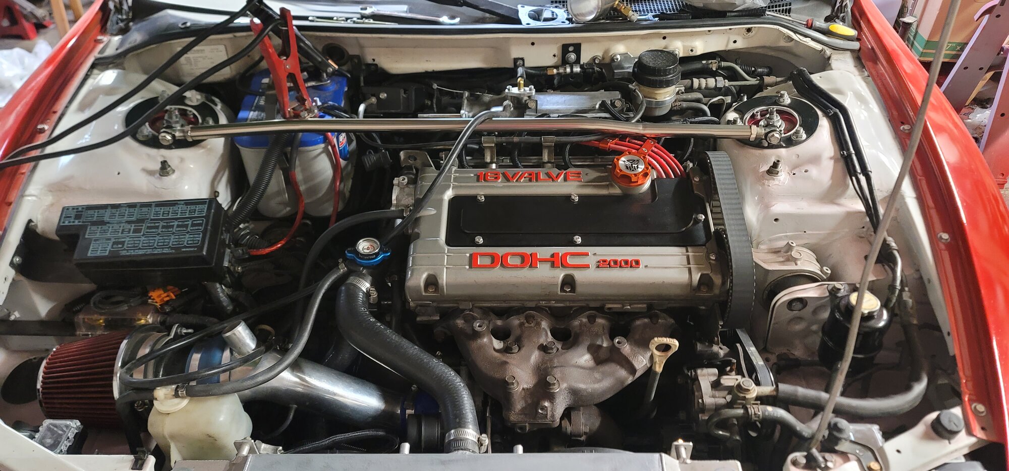

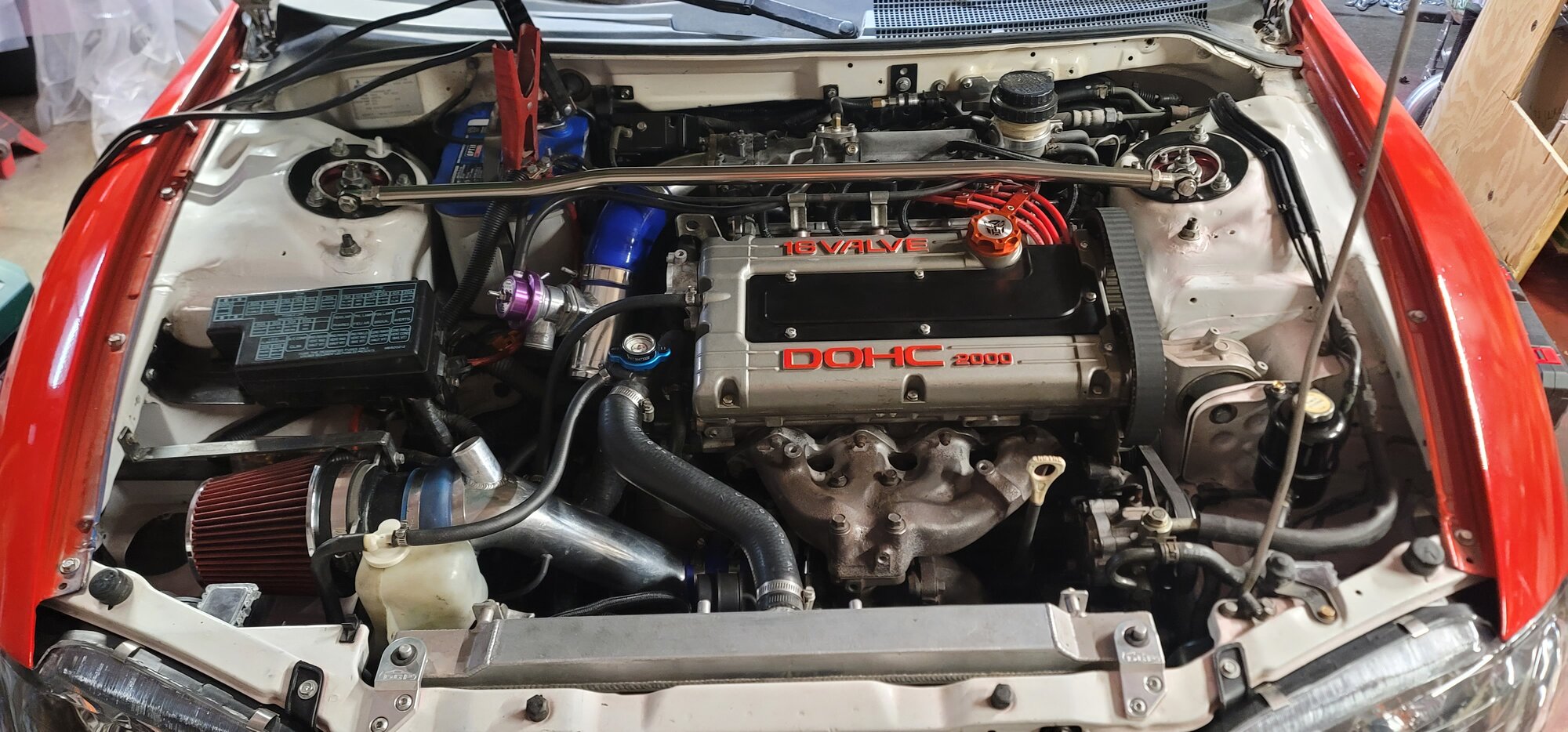

What RPM are you spooling the turbo at? I have an Evo 16g here lying around waiting for speed density, FMIC and injectors. I was told a small 16g would be better for response and similar flow to the Evo 16g, but I got a good deal on it at the shootout.
It's spools at or just a hair above 3k rpm. I just got it all tuned and man does it rip nice. I actually do love it and I'll probably stay with it. I'm on speed density and the whole setup I'm running I really do like. Im beyond happy with everything. I also like how quiet the exhaust is so when you do take off from a stop all you hear is the turbo. I love the looks going through town if I'm being honest.
I did have an ebay exhaust header on the car but I was so tired of how warped the junk was. It consistently would blow out gaskets so I'm back to the uglier stock manifold I had laying around. I'm starting to mature and go for function over looks now days.

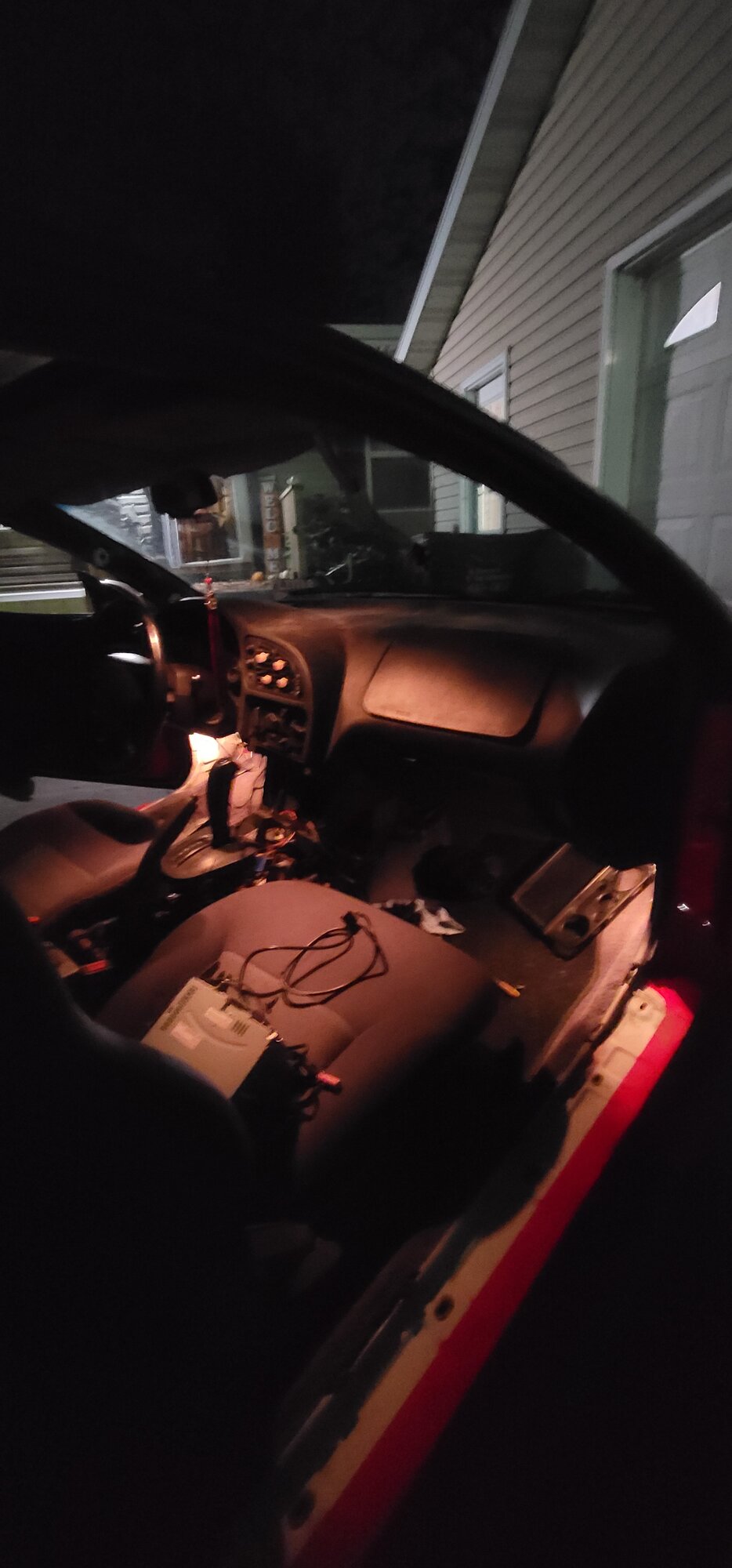

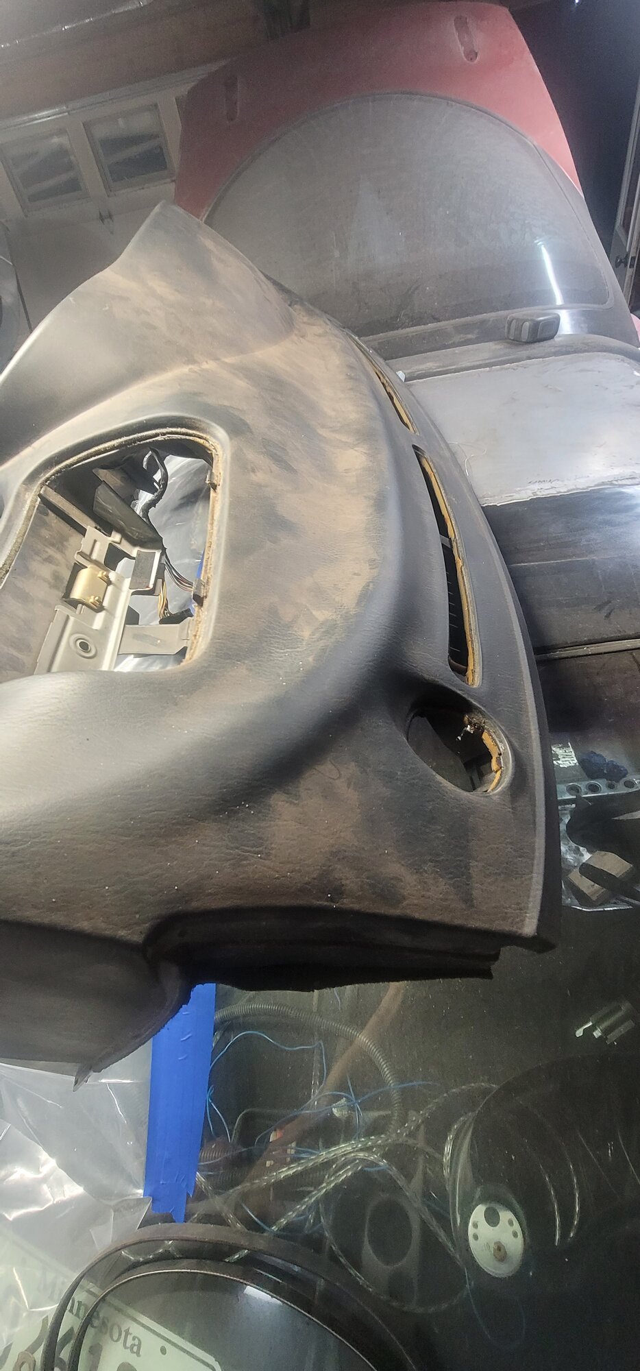

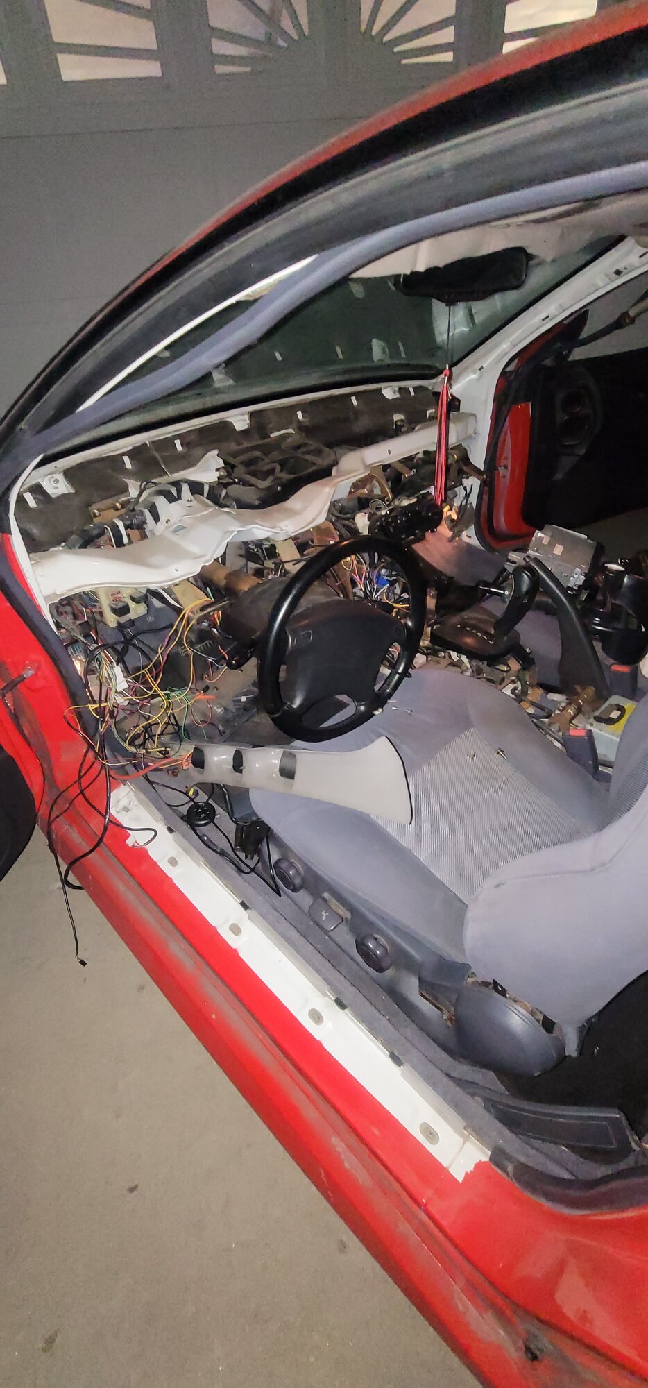

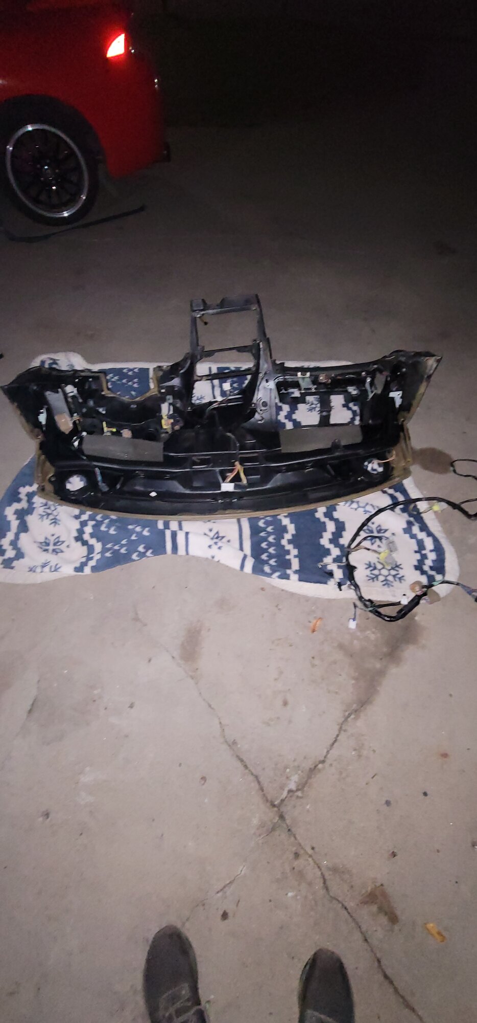

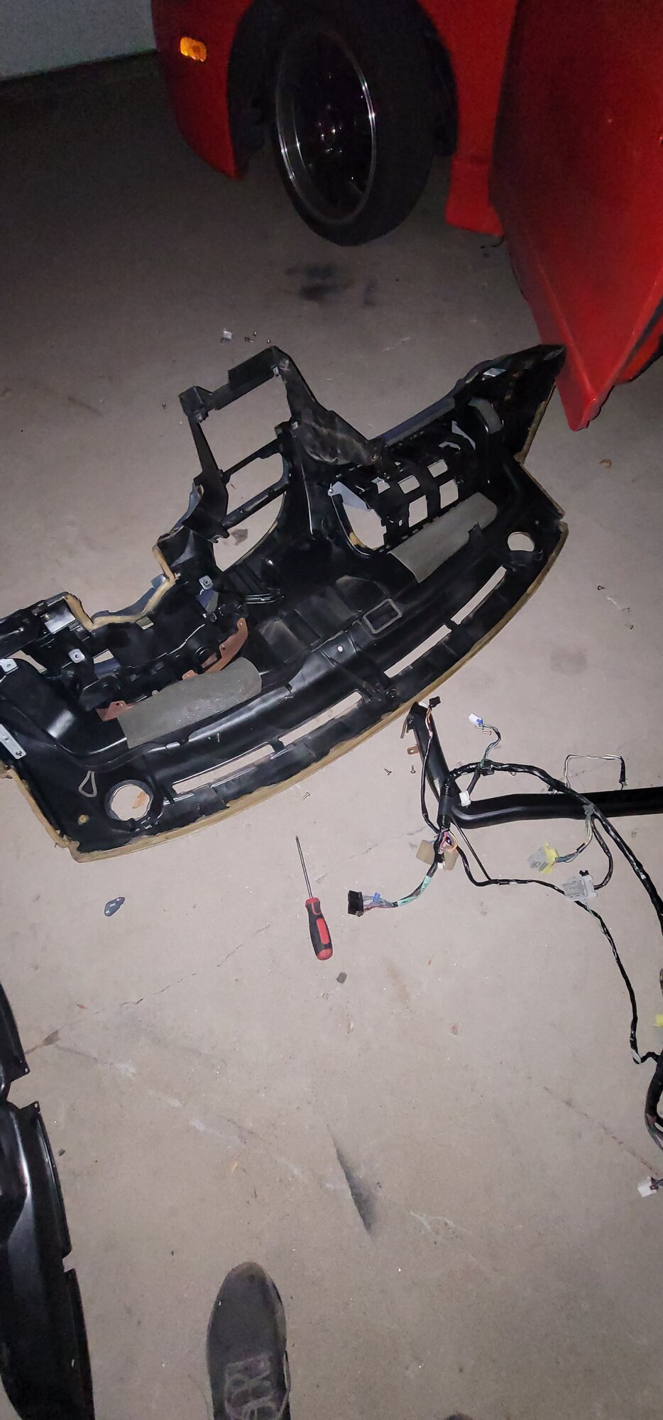

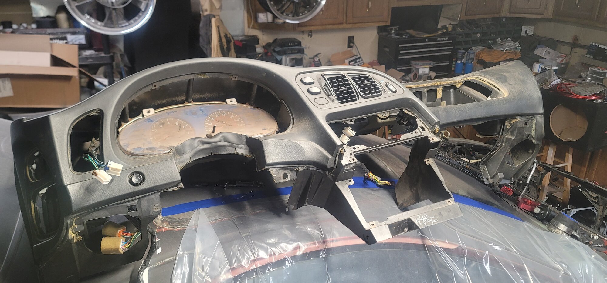

I was bored tonight so I just swapped my eclipse dash out and I must say these dashes are so simple to swap. I even swapped the dash harness just so I wouldn't have to rewire some things. It got way to late so I'll have to finish it up tomorrow but not much left at all. The car and dash all need a wash bad since it does alot of sitting. I'm almost done stripping my talon down so I can finally park the car back in the garage.
If I can find an airbag delete that might be next on the list unless I can find a mint black airbag.

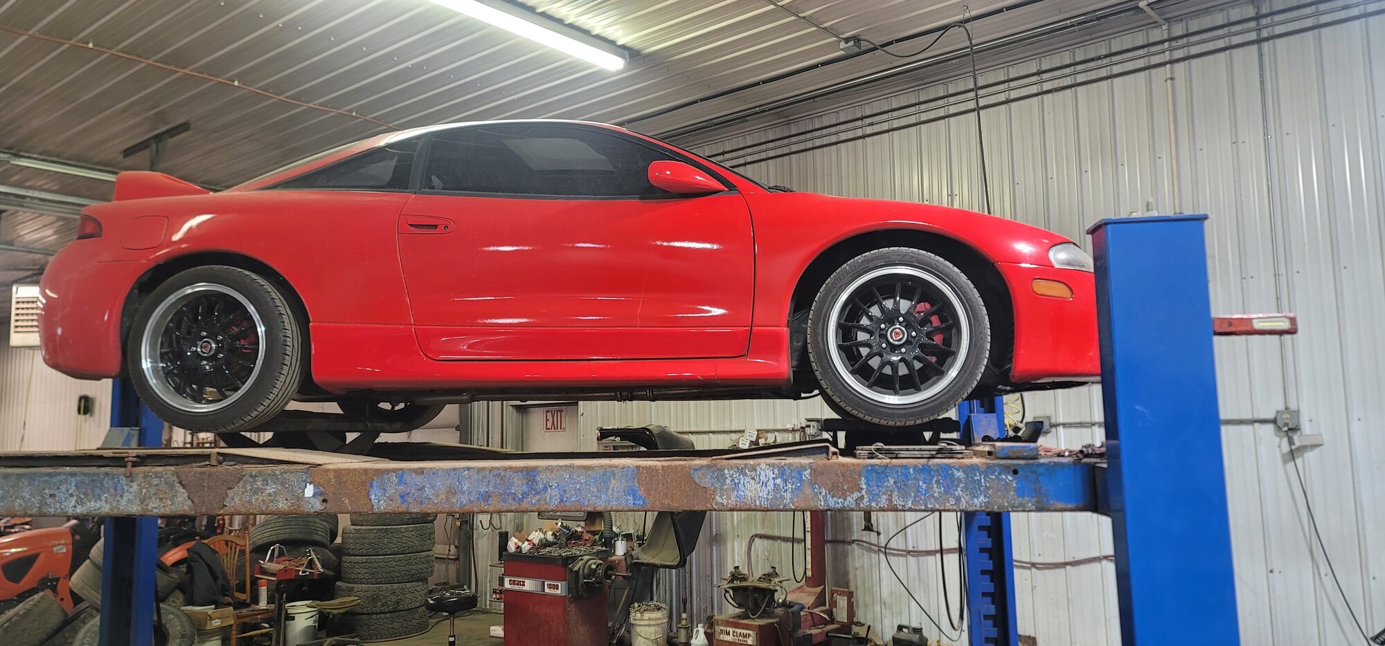

Well I scrubbed off the inside of 3 tires this summer so my dad and I aligned the car again. I remember awhile back I adjusted my camber quite a bit in the front and back so that threw the toe off. I just want the car to be turn key ready for next spring. I am also going to re paint areas of the car I wasn't exactly happy with this winter. The front bumper is chipping pretty bad from my lack of prepping.

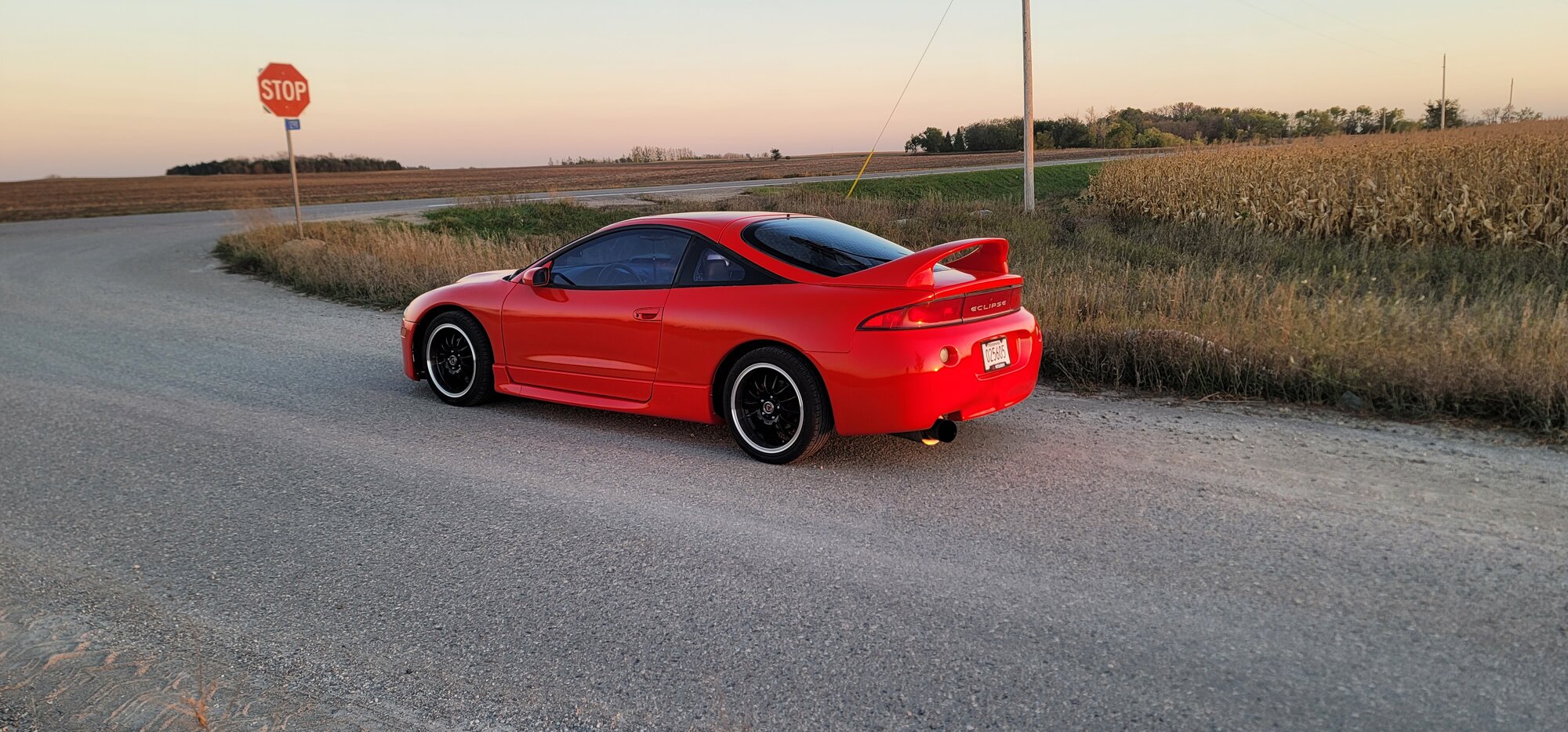

I washed the car inside and out tonight before my evening 65 mile drive. I ended up taking some pictures along the way which I don't think look to bad, i am by no means a picture guy.
I also dialed in the tune a hair more and it just keeps getting better and better.

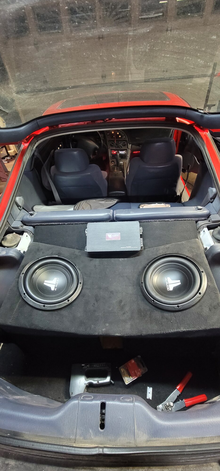

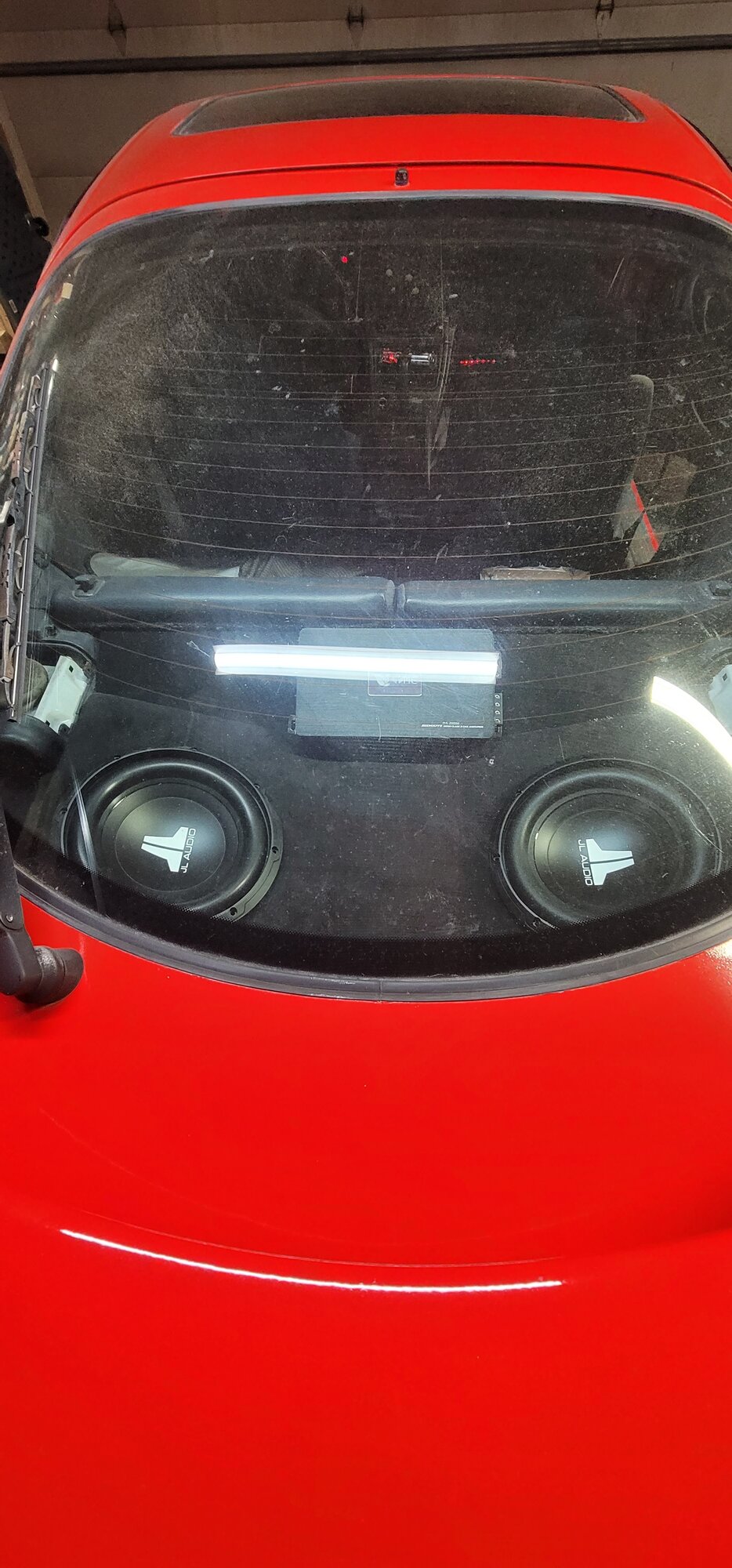

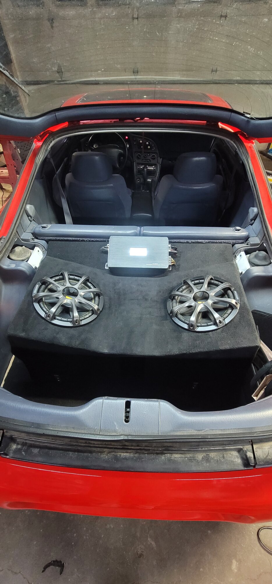

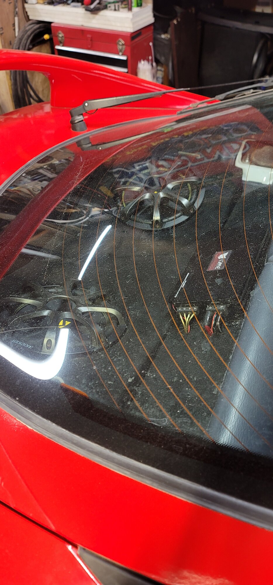

I grabbed my old stereo equipment that I had in highschool and tossed it in this car. I did build the box last winter and I wanted it to be kind of flashy so thats what im using. I did have multiple enclosures from way back but they didn't really meet the "show" type quality for me. My days of loud music is pretty much gone but for looks this will definitely do. It's far from finished but what I have so far I'm liking it. I don't want to go to overboard with fiberglass or anything crazy since this car isn't the one I want to do that kinds of stuff to.

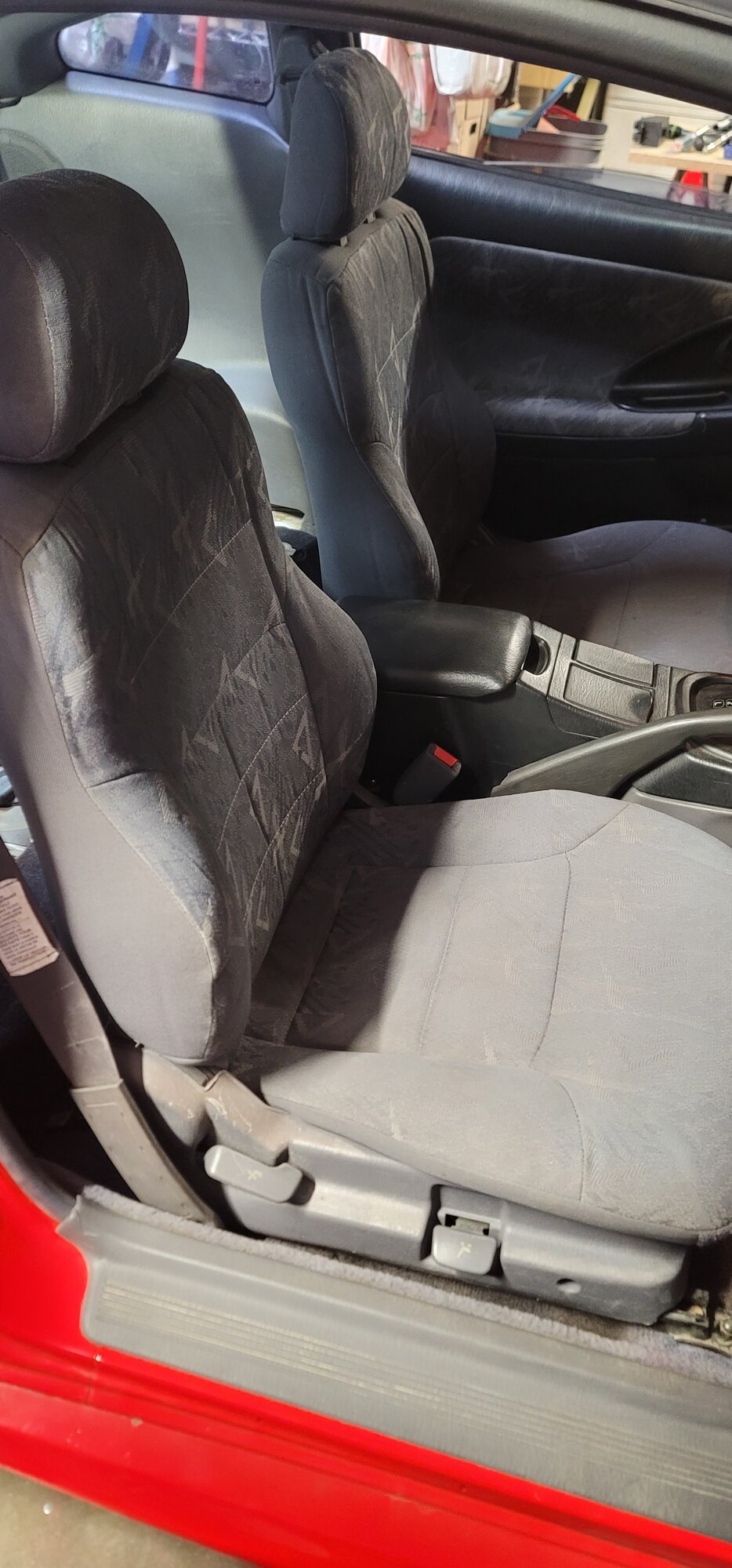

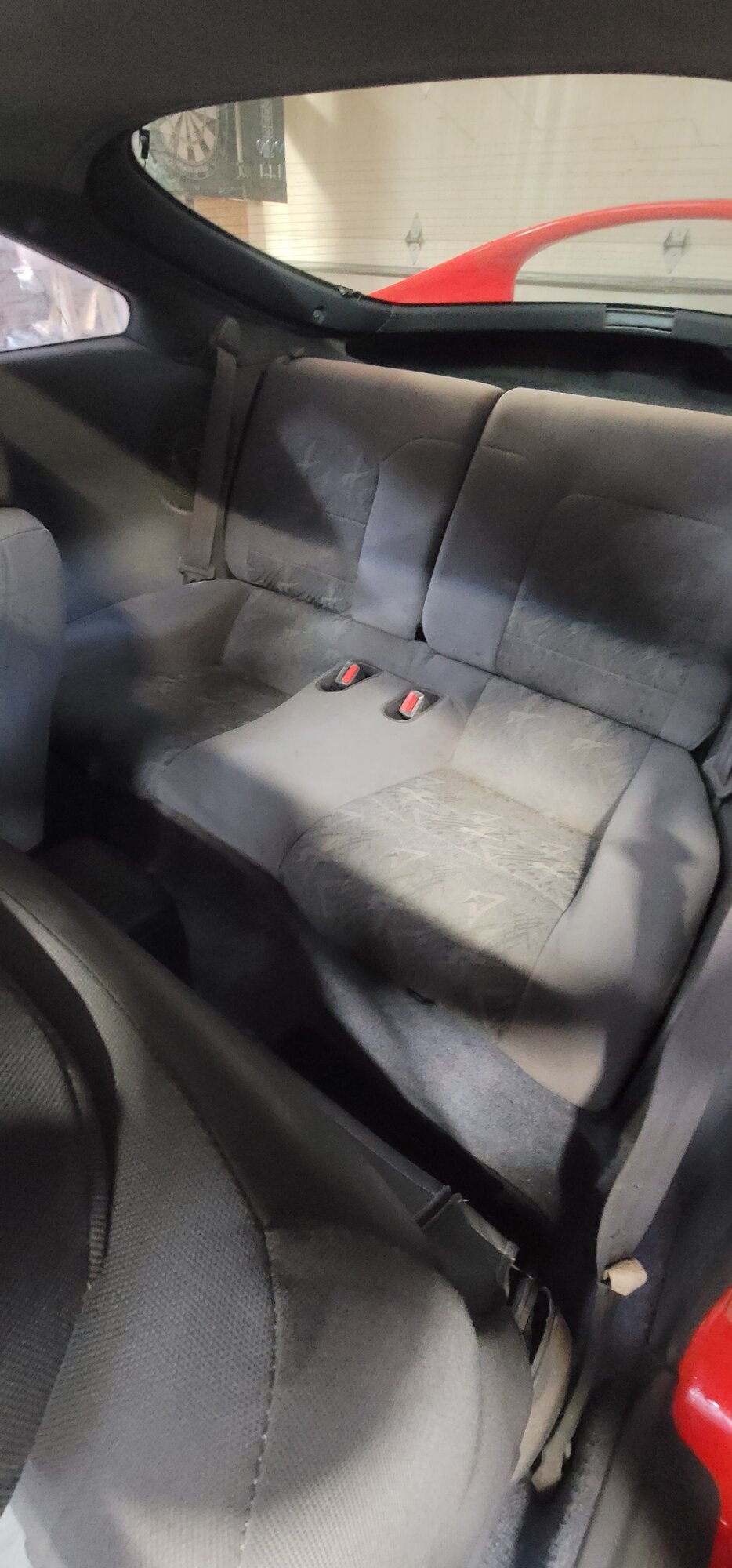

I did purchase some stock seats that match my door panels that will go in once I receive them. I'm pretty excited about that. Hopefully now that winter is just about here I can finally start getting things done.

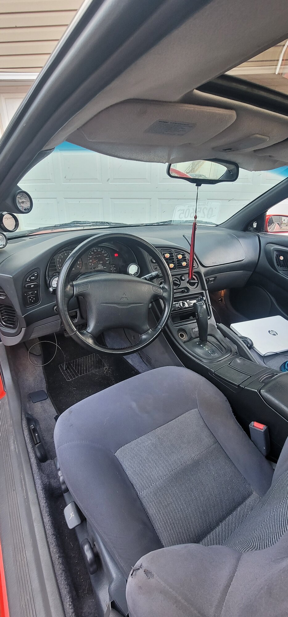

The seats I ordered finally arrived and they are in even better shape than I thought. The very last thing I'll have to hunt down are the rear seats to match, but for now I'm very happy with everything. While I was swapping the seats I also swapped the rear plastics from blue to gray. I'm going for the gray and black theme, the only blue left is in the actual trunk which I'll swap soon.

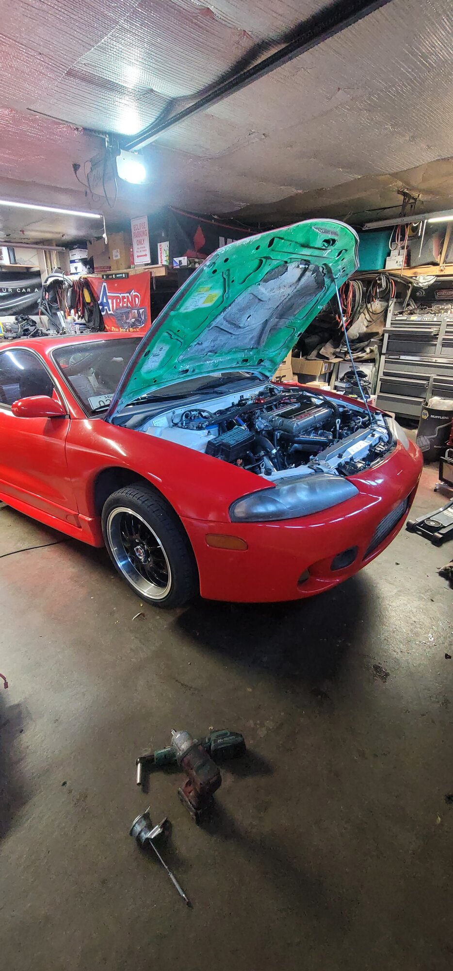

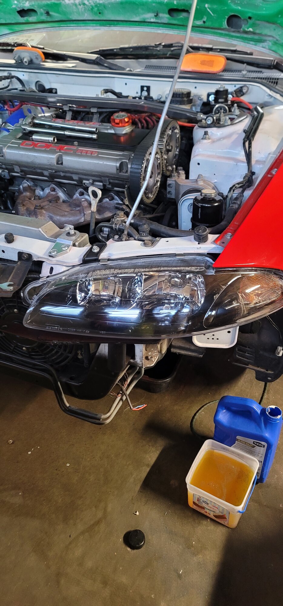

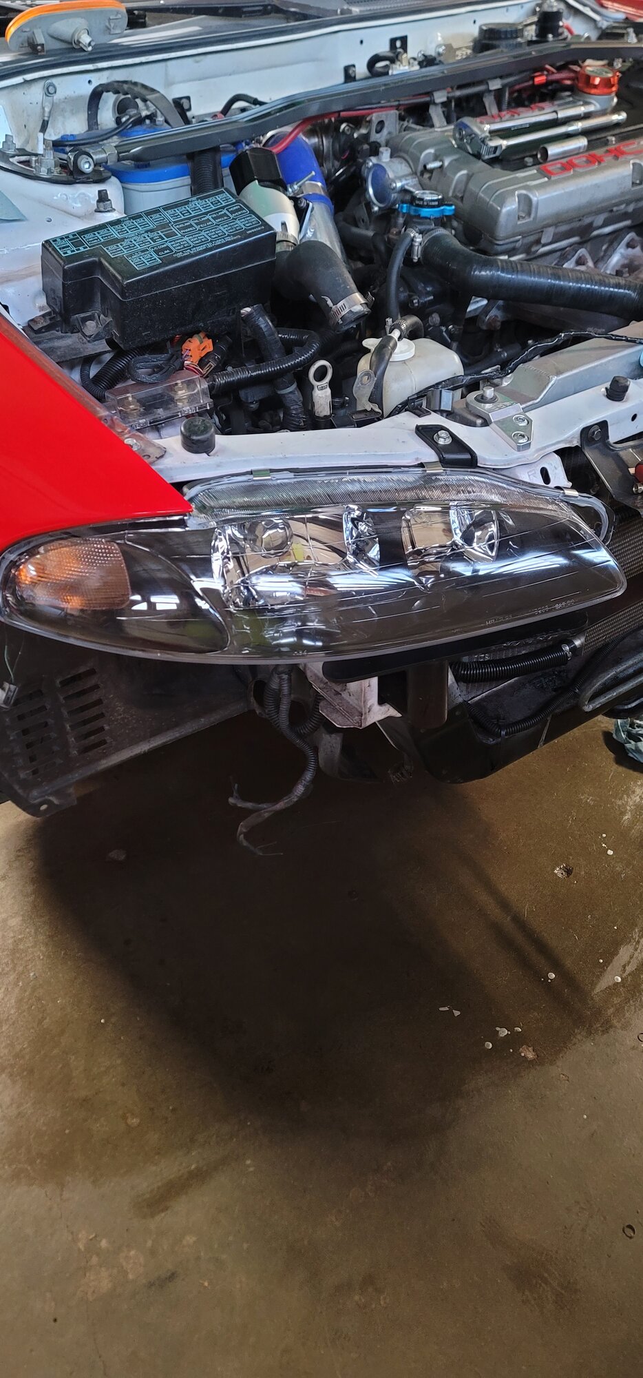

Today I swapped out those old foggy headlights with a set I got for my birthday this summer. These were originally supposed to go on my 95 rs when it's finished but I got tired of my ugly ones. These aftermarket ones actually fit very well.

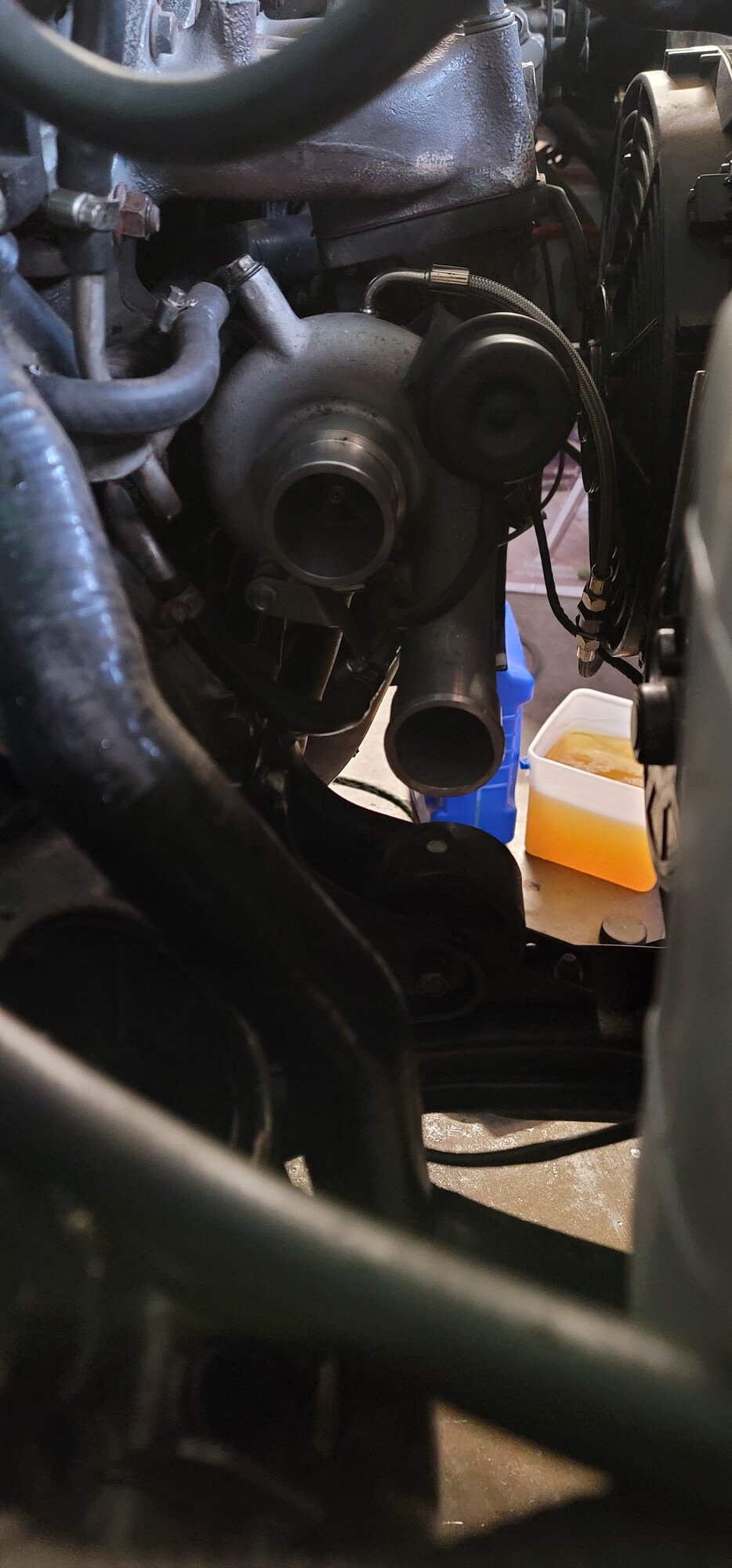

The next thing I swapped was the turbo and im sort of glad I did because that coolant was extra nasty. I'll be ordering a front mount that works with the t25 next. The 16g was fun but I think I'm looking for a more oem plus type of setup. I'm still going to keep ecmlink just in case for future fun.

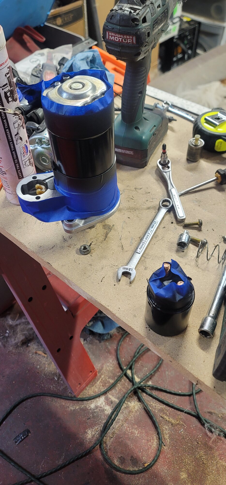

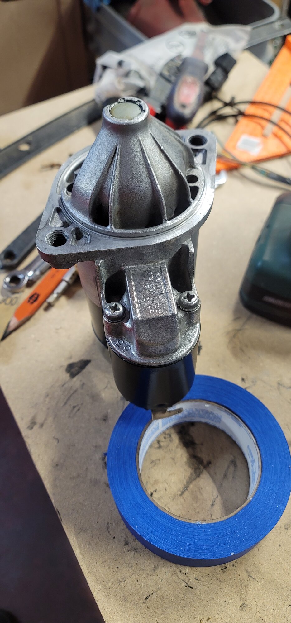

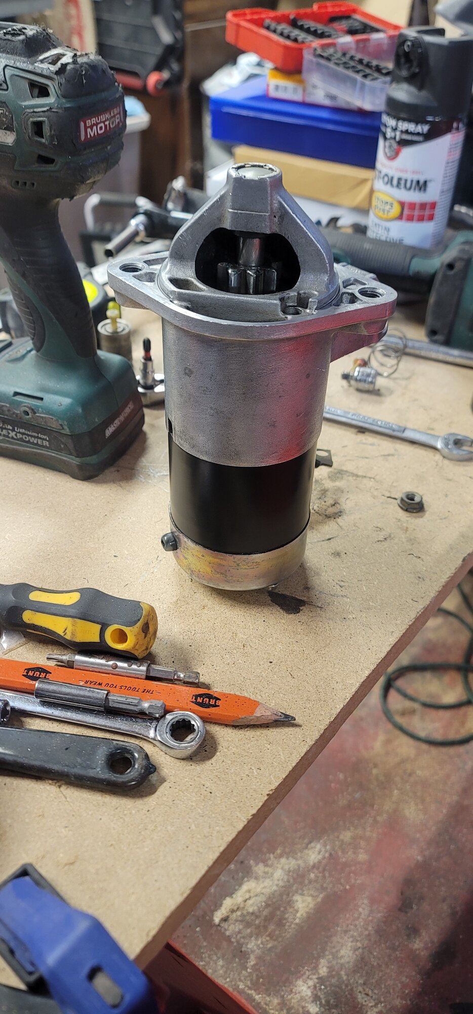

Today I got a little free time to finally take out the starter and address that random no crank. I disassembled the whole thing and cleaned it out, the inside was super gummed up and nasty. I painted some of it to make it look decent even though you can't see it. The thing works like a charm now.

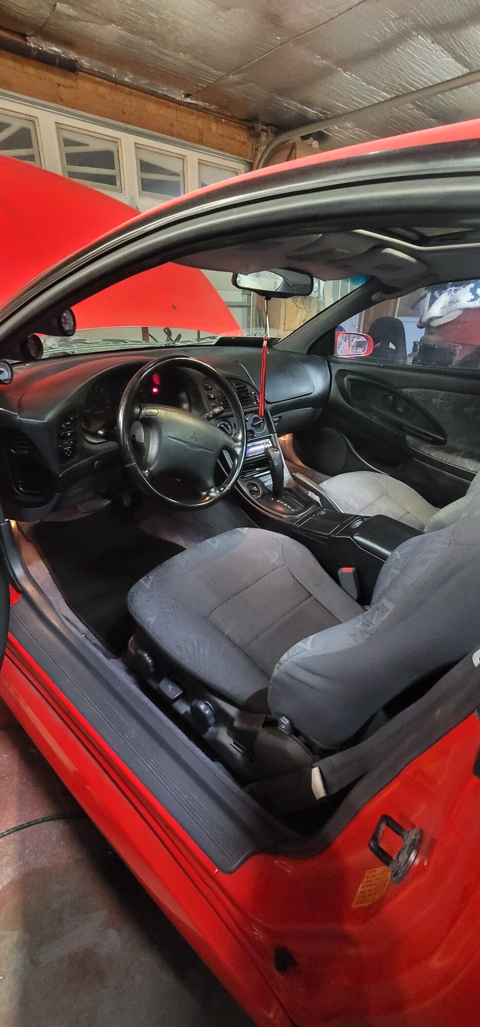

Well today I had a lot of free time and I was pretty bored so I super cleaned the interior and I actually decided to take out the aftermarket gauge cluster pod. The only thing it was housing was the transmission temperature gauge and I know the temp stays cool so that had to go. So now the interior is as clean and simple as I want it. I also was able to get my brother over to sit in the car and the first thing he said was he needs one. He said it brought him straight back to highschool, I replied with mission accomplished. That was probably the high light of my night. To just reminisce about the good old days.

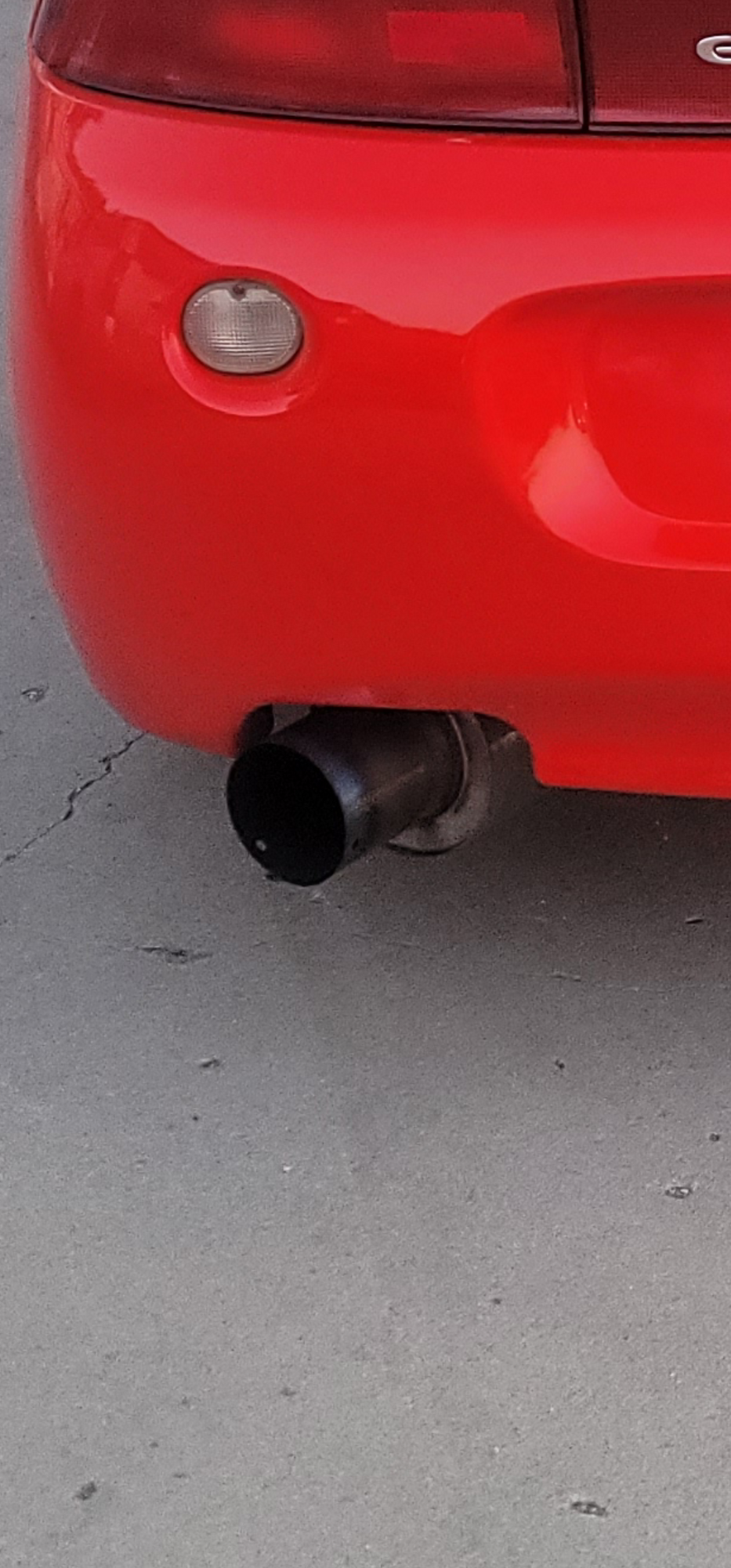

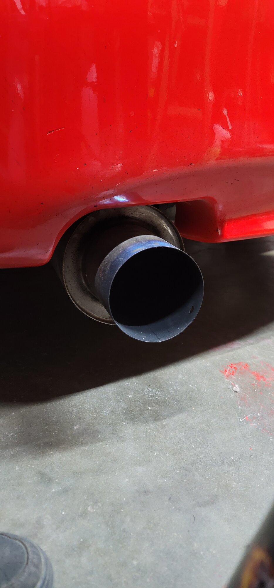

The next big step on my list was to fix that megan racing exhaust that came with the car. I'm not trying to throw shade but that thing was just down right awful. The down pipe was literally rubbing against the oil pan, and a little further back it had so much tension that the rubber hanger was rubbing against the drive shaft. I honestly didn't like the way it looked and how it wasn't centered with the bumper so I cut up the whole thing and got it about as perfect as I could. It used to clank on the rear subframe but at last, no more. While I was in there I cut out one of the small mufflers and put all new gaskets in. It sounds alot meaner and nothing rubs or hits anymore.

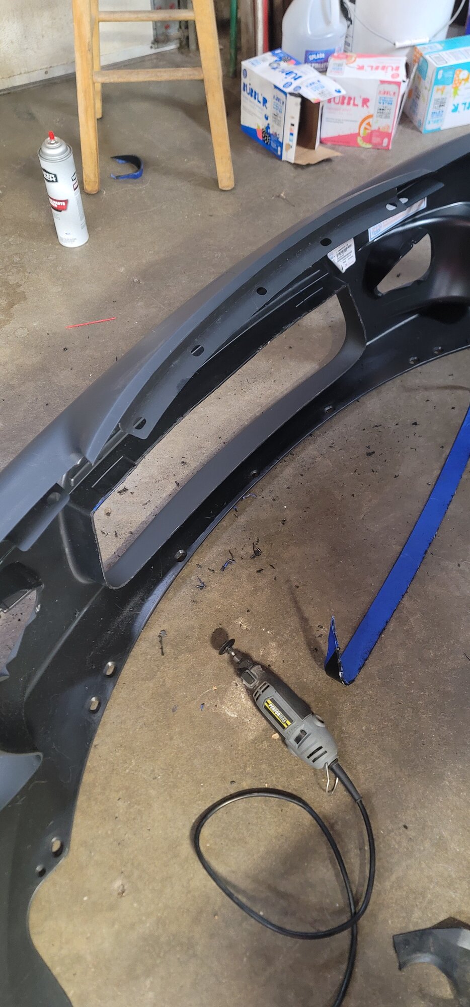

So for how cheap these aftermarket front bumpers are I decided to buy one. I don't have it bolted in or anything and it fits pretty good just hanging out there. The main reason I bought another bumper was because I want to keep it as stock as I can. I cut up my other one alot to fit that big fmic. I will obviously have to trim a little off to fit this other fmic but I shouldn't have to take off much.

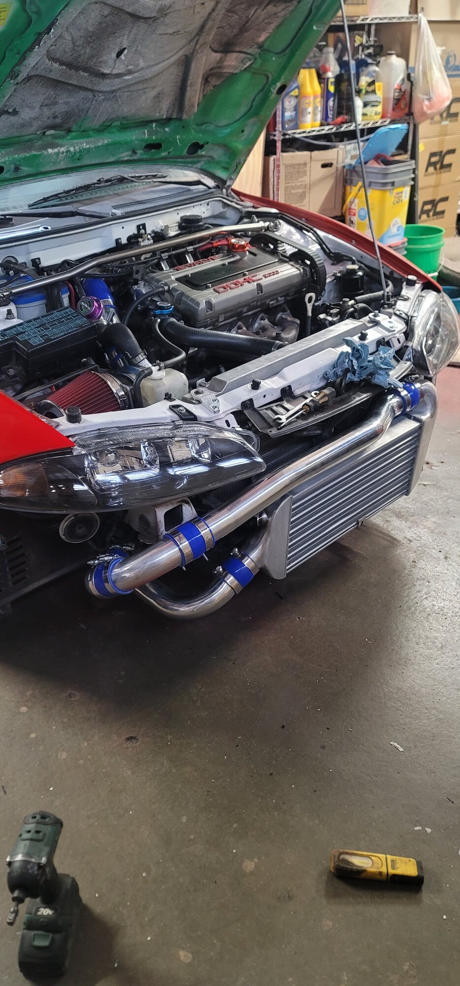

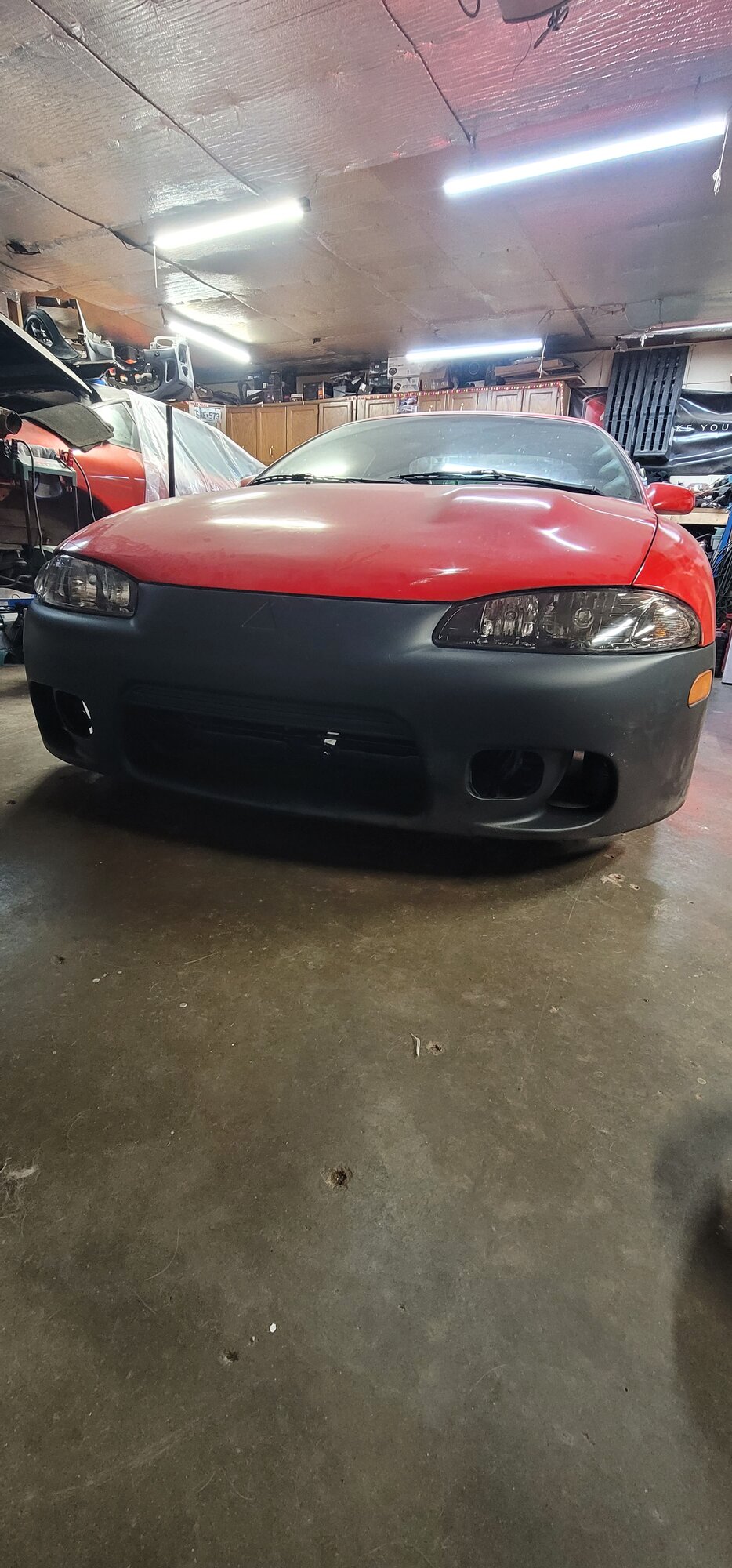

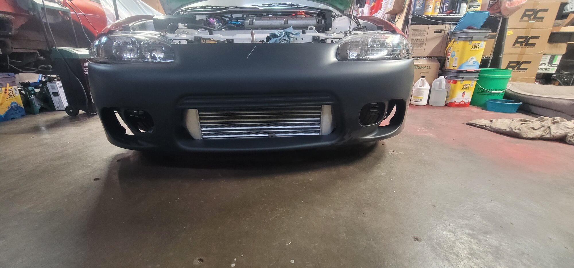

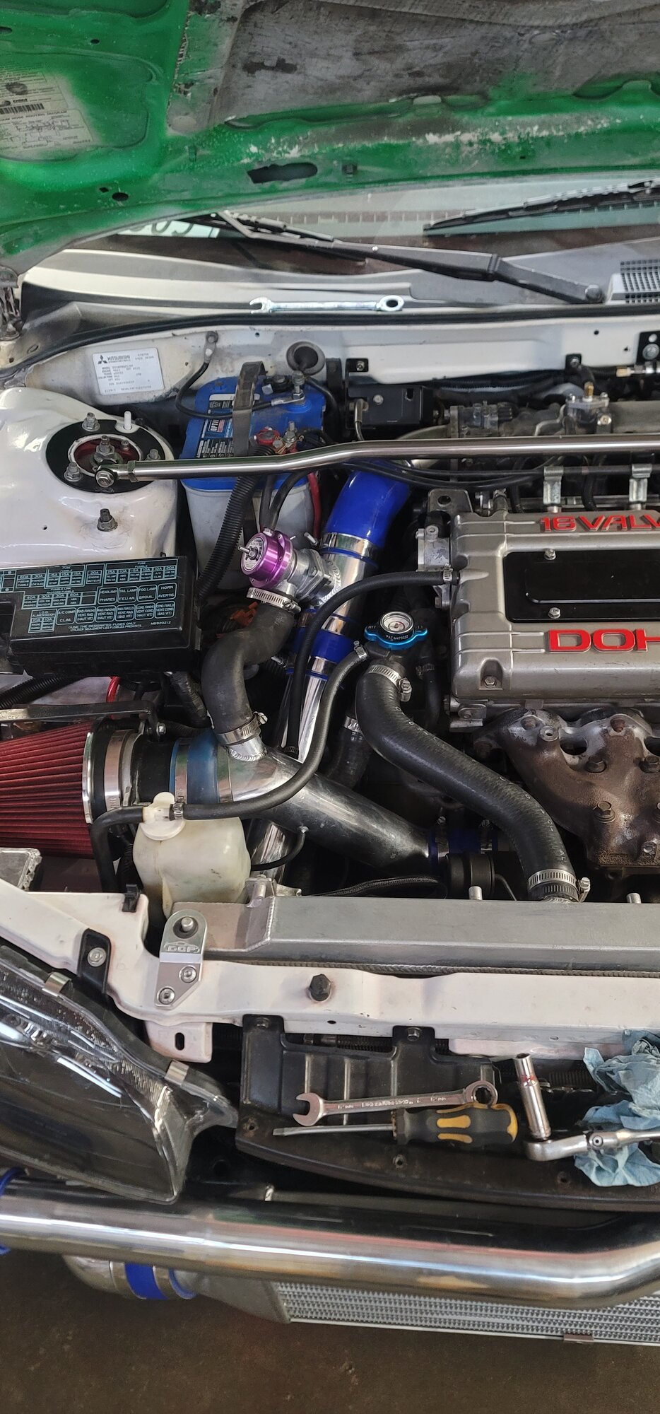

I finally got my intercooler installed and what a pain that was. I had a lot of piping laying around and somehow I got the throttle body side plumbed in dang near perfect. I have no idea why they make it go through the stock intercooler hole. I for one had zero room to utilize that hole, so I just ran it up the way it was before. I am running the baby t25 and if I do decide to upgrade to the t28 I wanted to have this intercooler. I'm going for oem plus so that's my upgrade path if I decide to take it one day.
The next thing I did was trim the bumper as perfect as I could. I am extremely happy with how straight and even I cut it. I only had to take off about an inch or so. I have some steel mesh I'm going to be using to keep the intercooler from collecting insects. My other intercooler I drove one summer with is just caked with bugs. The bumper fits flawless on the drivers side but of course on the passenger side things aren't real happy with all the piping. I'll have to see if I can't fit things a little nicer even if I have to cut up some pipes. I'm trying to leave as much of it alone as I can.

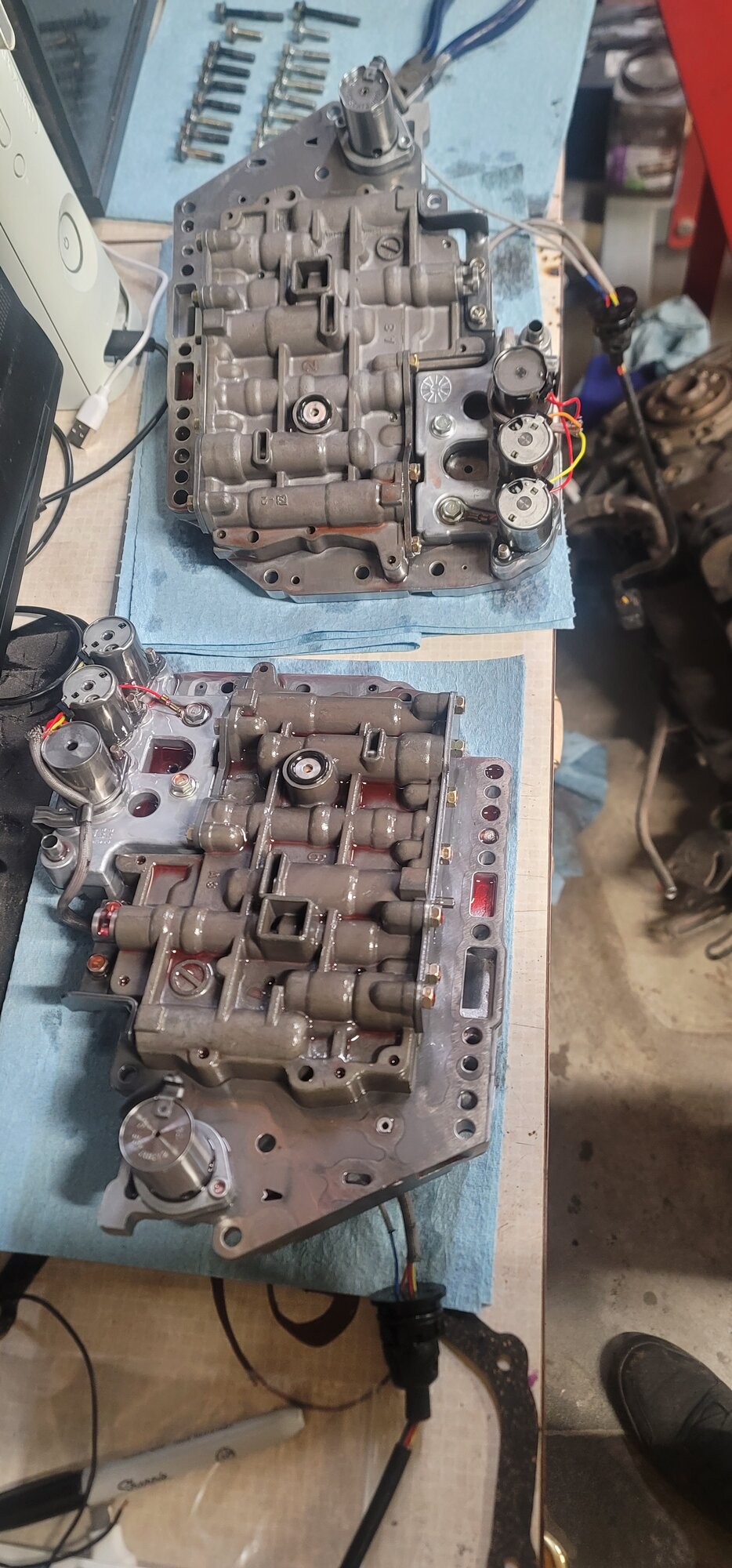

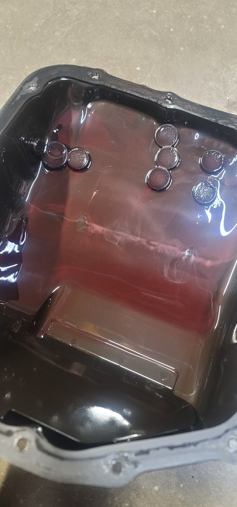

So I dropped the trans pan today and I see some concerning glitter sitting in there. I pulled the valve body from my spare auto I had laying around to see if maybe that fixes some things. I tested all the solenoids on both and even a spare set and they all tested the same so I'm hoping by throwing in the spare it'll shape up. It's a bone stock auto from a 97 so I'm crossing my fingers.

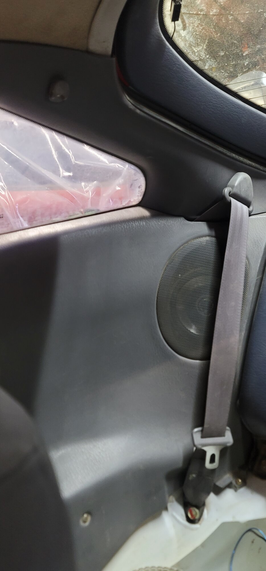

They need a little bit of a clean up but now my interior is 100 percent complete. This interior was the hardest to track down for some reason. I'm super pumped to have this thing exactly how my brother and I had it back in 2009. To sit in it is such a trip now. I literally can not wait for summer to cruise this thing again. The one last thing that I don't necessarily have to change but I might is the 3 piece spoiler. The one we had was a 98 gs and to make it a 1:1 replica, that would need to be changed. Thats up in the air though, I might change it and I might not I'm not sure yet.
Man the interior has been terrible for us to track down too. Luckily we just got ahold of 2 spare cars, another 95 gsx and a 98 gst. We got rid of the 3 peice spoiler and I ended up having to fiberglass the inside of the trunk on the mounting holes in order to apply bondo over the outside. I wish I could have welded them but i didnt have a welder at the time.
The interior seems to be pretty tough to hunt down these days. I'm just super pumped I got the exact stuff that I wanted in pretty good shape too. I paid a good chunk for the seats but was definitely worth it.
