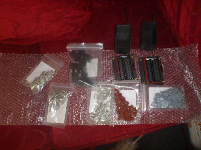

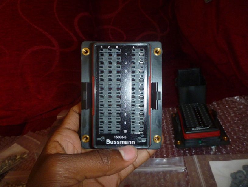

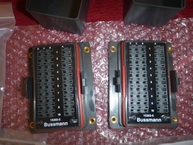

Thanks to evo1rice I've come up with a fairly good solution and much easier setup for my switch panel setup, just ordered the parts last week and hoping they will arrive by the end of the month. I'll be using Bussmann 15303-5-2-4 fuse boxes (2) and 10 relays to control power to the following: ECU, Engine Sensors, Fuel Pumps (in-tank/inline), Radiator Fans (ECU controlled), and possibly a radiator fan override or just a spare relay - might map to something else but for now it's just going to sit there. These boxes hold 5 relays each and the two of them can fit perfectly inside the arm rest of the centre console. Will post pictures of the progress, keep posted!

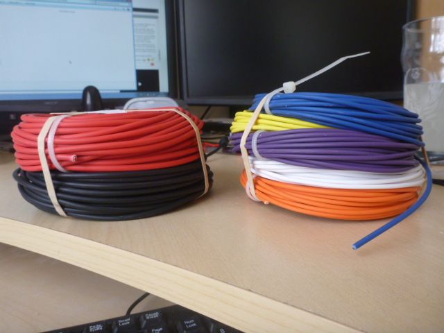

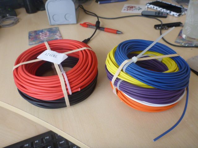

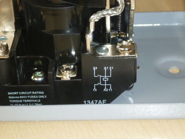

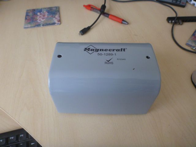

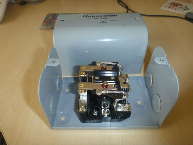

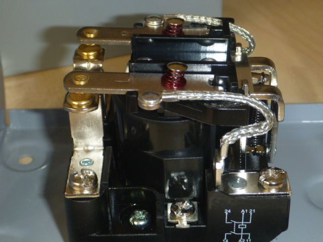

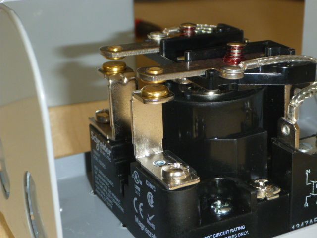

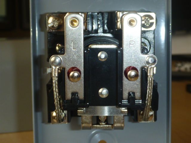

Building has started again, below are the pictures for the 100ft of 12GA-GXL, 125ft of 16GA-GXL, and my Magnecraft metal casing with their associated 40A DPST (double pole-single throw) relay that will be the connection for my ignition coils. The controller for the relay will be inside the switch panel fuse boxes, along with the fuel pumps, ECU power, and radiator control/power (ECU control). So far so good, just waiting on the Bussmann 15303-5-2-4 fuse panels, contacts, plugs, and relays... pics to be posted.
Yea..... HEAVY duty relays. They'd take a hundred amps @ 12v LOL. At least!
Funny you say that, it actually can only withstand up to, but not to exceed, 600V @ 40A, could probably withstand more if I were to run a larger gauge wire from the input contact to the output (14AWG braided line). A bit overkill but they weren't too expensive, the casing was a bit high but it's not bad, should withstand a lot of on/off switching before going bad so I think it wasn't too bad; just need to find a place to install old girl.
The biggest upside of that style(and capacity!) relay is that you can always get in there with a mini file and clean contacts. The may not get "pitted" as fast as a normal, higher voltage application, but in the event they do get dirty, its an easy clean.
So those are 24 KiloWatt relays? Yea, I was guessing low but ive never seen that style used in a 12v application. P=I*E so, if everything held true that would handle not 100 but 2000 amps at 12v!!!
Those "perfect" numbers dont really exist when factoring in heat. Heat=resistance, which drops E, which increases I, its a cyclical loop... haha

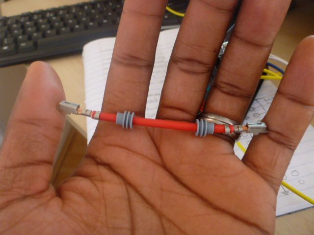

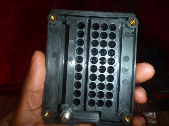

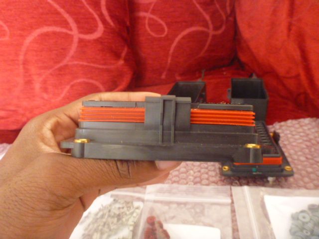

evo1rice, so I took your advice... well modified. Instead of that giant 40 fuse/10 relay bank that you mentioned I went with the smaller (as stated above). With that being said I did think about using that giant one but then realized that the fuse box relocation would/will be much easier by just removing wire rather than trying to reinvent the wheel and create my own batch of wiring with my own colours... anyways below are the pictures from a new shipment of parts - time to start building again!

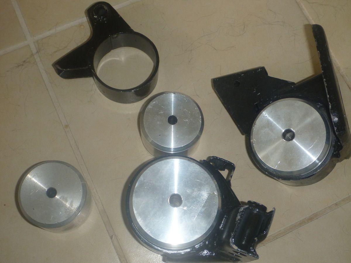

I've had these for a while but forgot to post them, can't wait to get these installed! I plan to swap them over to my 2G mounts, they are a about 1-3mm smaller than mine so hopefully they will still fit snug and if not I'll have to have mine slightly modified to accommodate them.

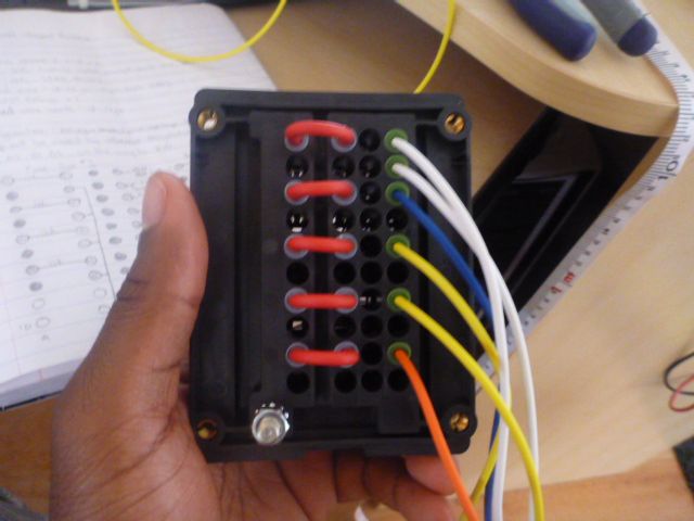

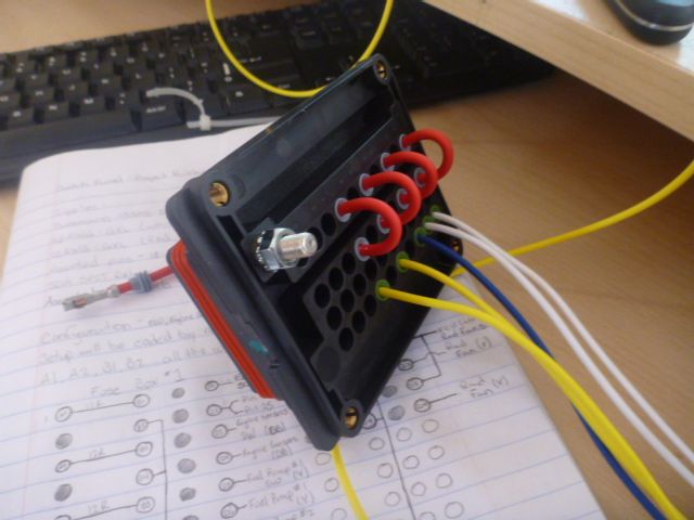

Started wiring up the fuse box for the switch panel, red wires are jumper for the bus bar and the coloured wires are roughly 3.5 ft in length which should be able to reach the location of the switch panel - currently using a mock-up.

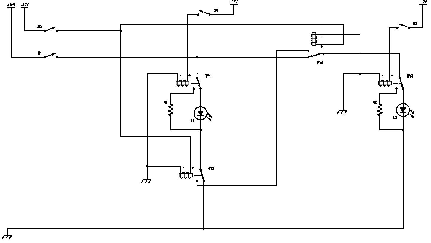

I've decided to redo three of the main harnesses in the car: front, control, and rear. As seen in the previous pictures [I believe] I'm switching to HIDs, although I'm not much of a cosmetic person and have reasons behind most of the things I decide on I've decided to also add in DRLs since the cars that came with this were the ones from Canada... unfortunately I don't have one so I've made my own schematic to how I want these to work. Anyway, here's the schematic for that, hopefully I'll have everything planned out so that I can do a near-full rewire of my car (well at leas the main components).
