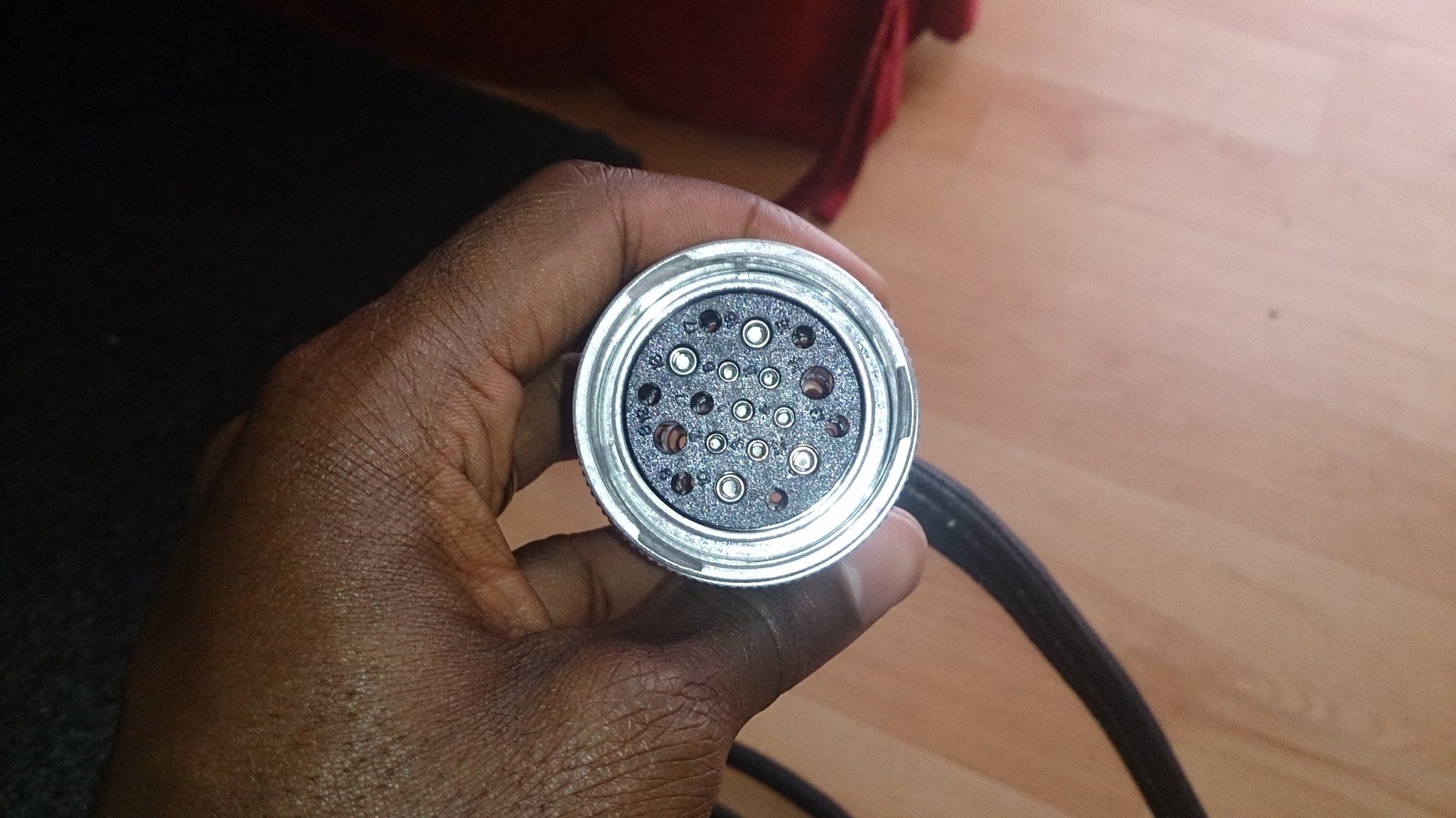

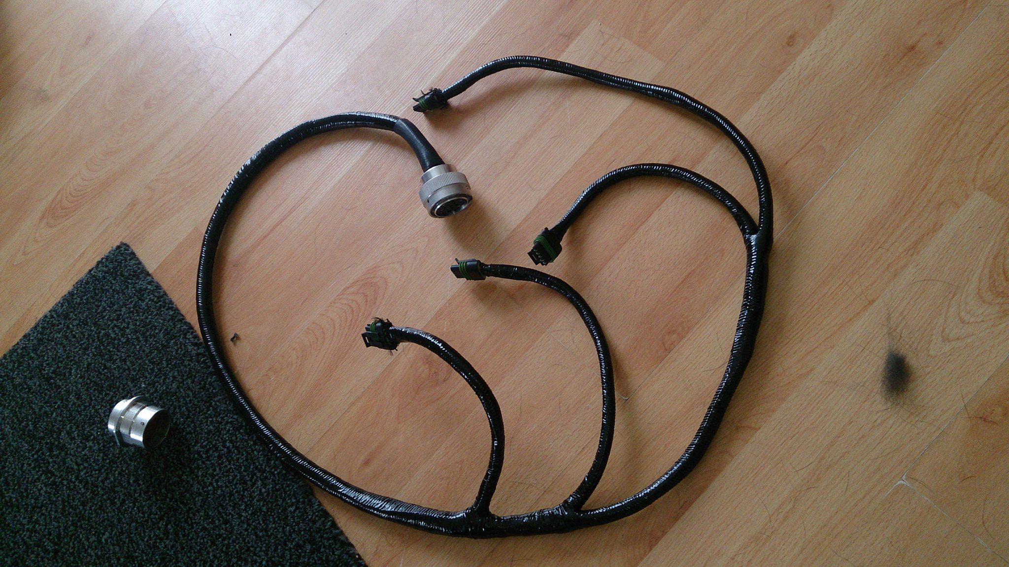

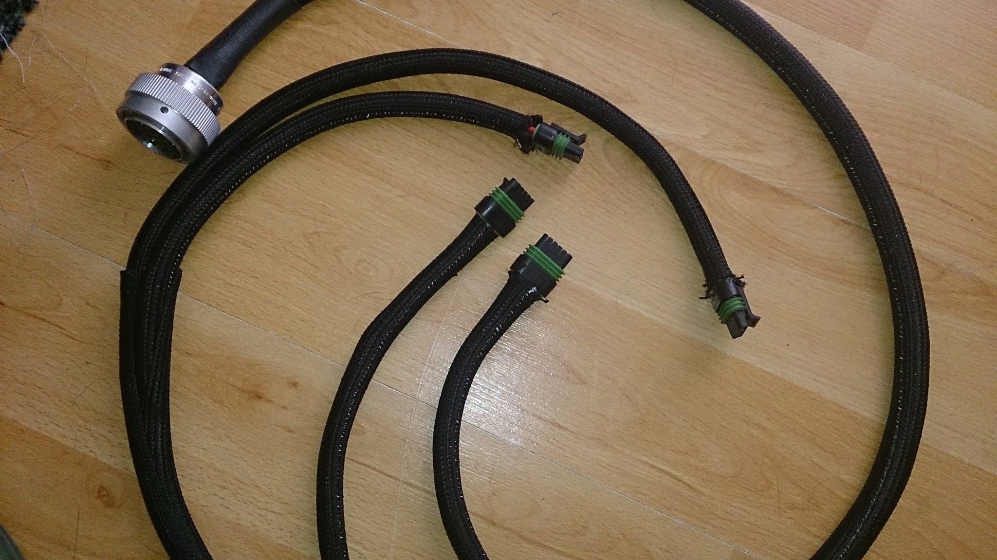

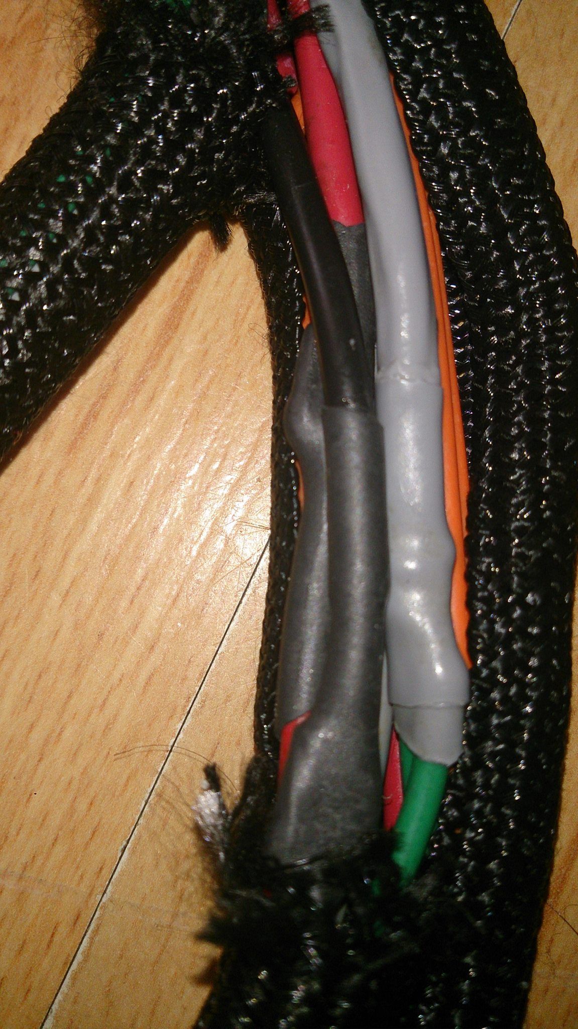

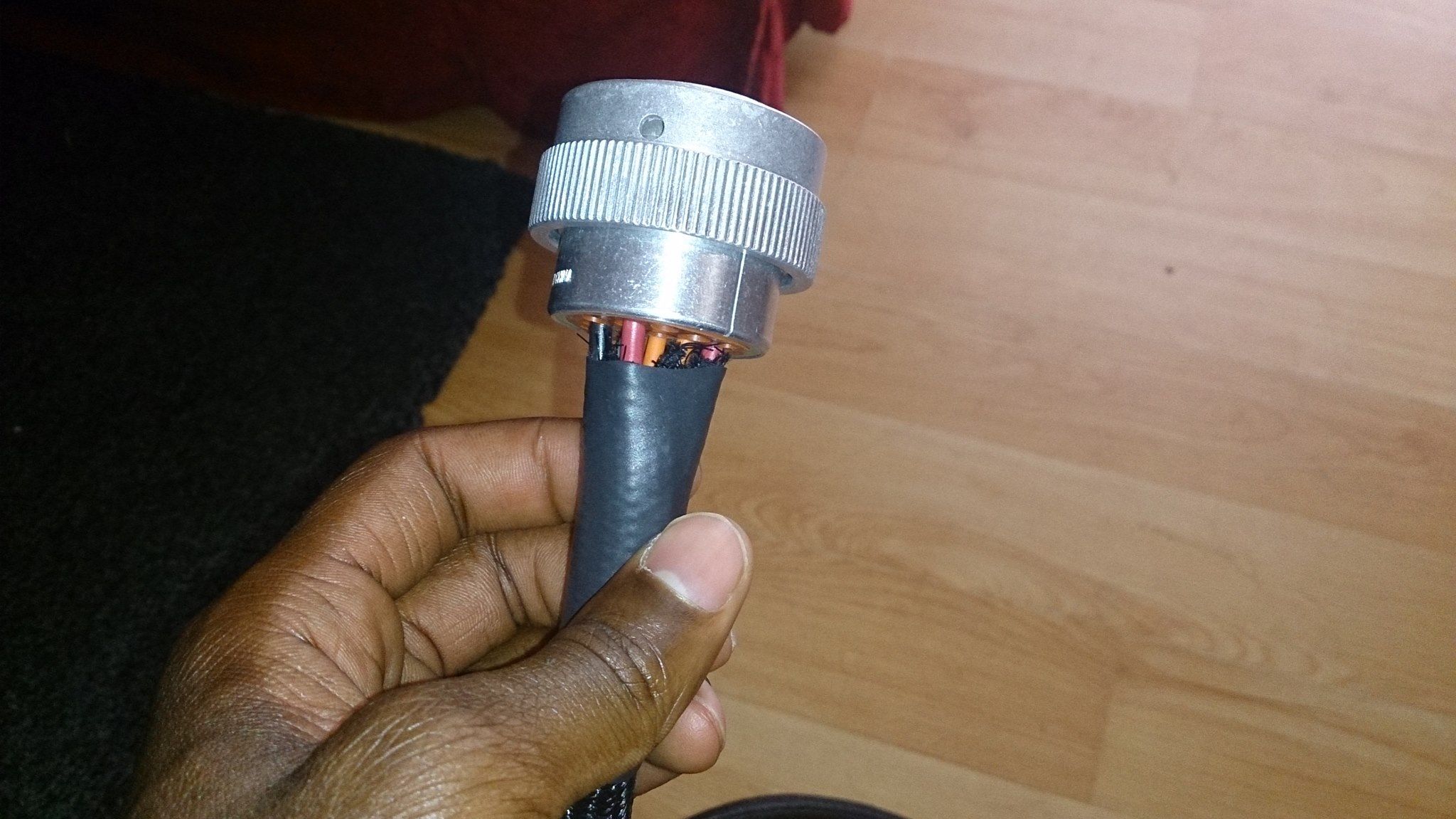

Finished the ignition harness, took long enough - will have pictures posted once I find the wall adapter for my camera... still also needing to wrap the wire loom to look neater. I've also begun work on the engine harness, currently in the planning phase so I have all the right wires and connectors needed to complete the project successfully (considering this is my "second" harness), this one is looking to be a bit more complicated and mainly because I had forgotten about the MPI relay located in the centre console. But that's all been resolved just need to make the wiring diagram so that all mistakes are ironed out prior to building - more than likely once I'm done I'll make a write-up that is picture in-depth so everyone will have all questions answered (this one is going to get nasty).
The finished product, just need to snip a few strings and then burn the edges (nylon) to prevent fraying.

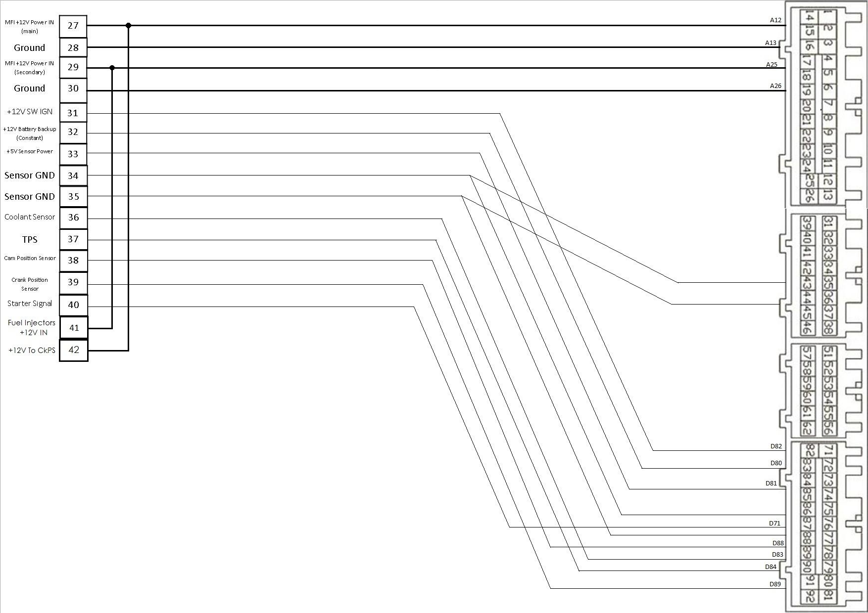

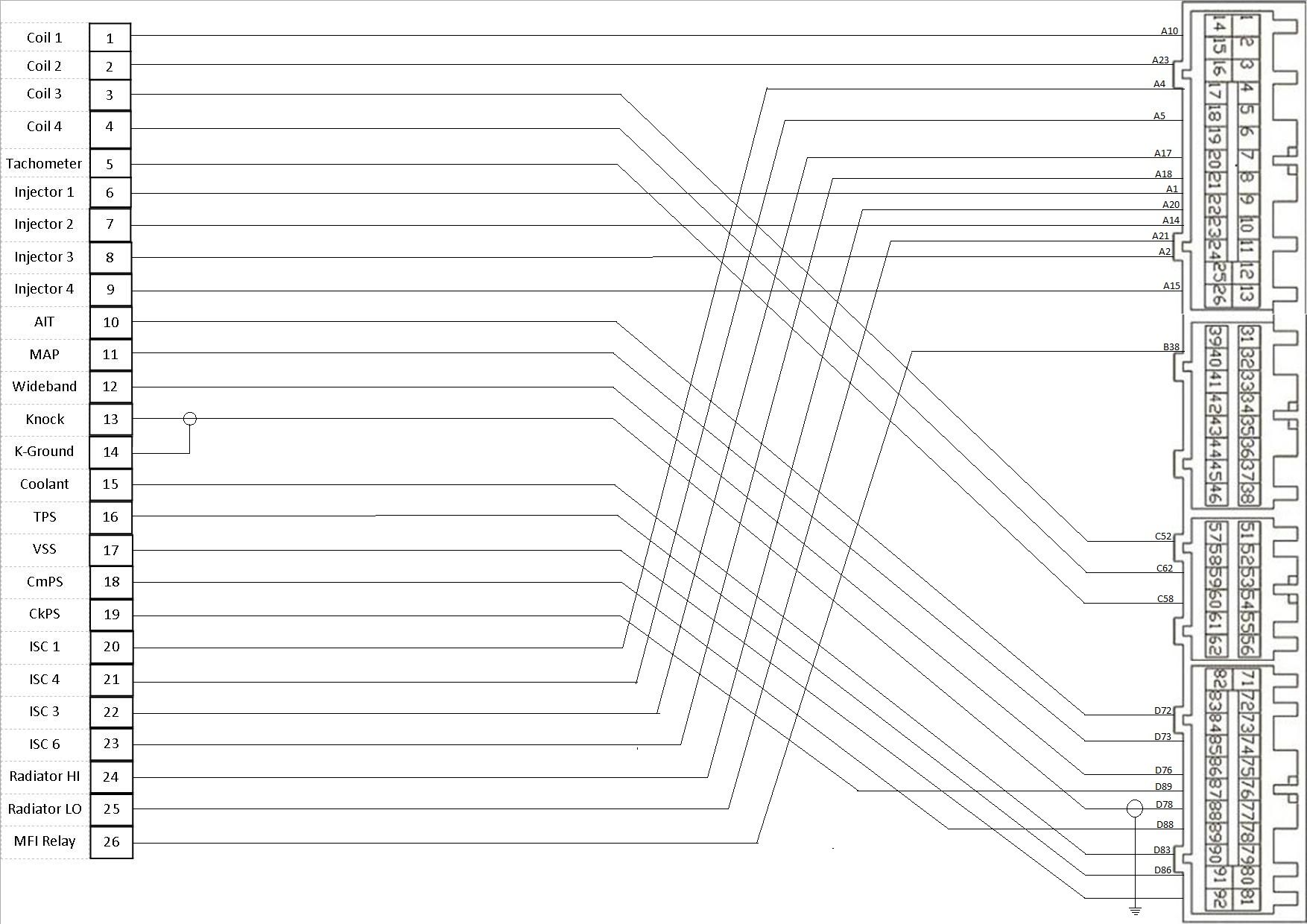

The below harness is a very ROUGH schematic for what the engine harness will be wired to, similar to the ignition above it too will be mil-spec. With that being said and the ECU being converted to an AEM EMS Series II (for better control of the coils) I'm having to re-pin and relocate some of the pins and create my own harness. For now I'm doing 1/2 of the "control harness" due to the car not being with me at the moment - basically the half inside the car. Pictures to be posted during build and after completion. Keep posted!
That is some of the best wiring i've seen. i wish i wasn't a poor college student so i could own a DSM and do stuff like this! Anyways, keep up the great stuff man.
Thanks! I'm sure if you find the right dealers and whatnot you'd be able to make these too, luckily most of the tools needed (crimping tools, solder irons, etc) are available at my job so it makes it A LOT easier/cheaper.
Anyways, here is the other half of the harness, the sensor grounds aren't going to be split like that as they will be divided respectfully to what size pin is located in that spot. (Pins not labeled yet)
This is a very nice schematic and build you have going! Do you mind sharing the guage wire you are using as well? also how do you determine what guage wire to use where?
I plan, once I've completed it, to do a proper tech write-up to the forum (a lot of the others are vague - IMO). But to answer you questions there are two sizes that are used on the ECU connections: 18ga and 16ga. Looking at the connectors I'm sure you can figure out which ones are which. I've actually changed the second schematic because I left out something (posted below - power to sensors/fuel injectors), the larger and thicker wire may extend up to 14ga to 12ga just to ensure current capabilities.
If you're looking at the wiring harness I've created recently, the ignition coil (AEM Smart Coils) harness, the power and grounds are 12ga through the harness itself and then become 16ga at the connections, the remaining lines are all 16ga; green, and grey are tapped into one line and the power and grounds are paired due to current capabilities.
To determine wire gauge you should know the amount of amperage that most wire can flow, for the most part if you use the electrical FSM it'll tell you in mm^2 so just convert and stay with the stock wire size, even with my AEM coils they didn't need too much of an upgrade other than the power/ground wires for safety purposes.
Go to http://evoecu.logic.net/wiki/Plugs,_Pins,_and_Connectors and you'll find the connector part numbers then go to http://uk.mouser.com/ and type in the part number (they have a US site too), they should have all the pins you need, you can reuse your connectors as required. As for the connector used on the built harness I went to www.wirecare.com to get what I needed, and they have a lot (Mouser has much more and mil-spec).
