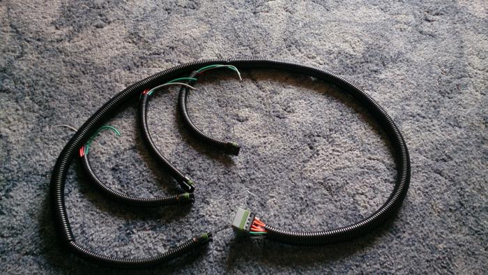

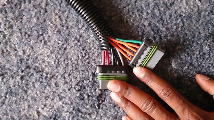

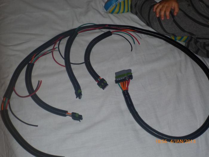

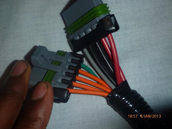

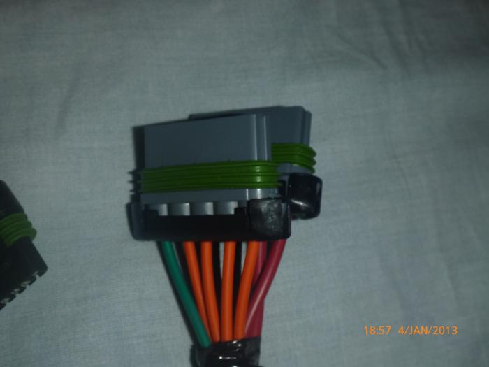

So having to upgrade to a bigger wire due to current being excessive on the primary side of the coils. Looking into running 2 pairs of +12V and Battery Neg runs to keep current below 20A on 12GA wire, I then plan to tie this in on the other end (engine harness side) in to either 10GA or 8GA don't think I need to change that really as it'll be connected to the ignition switch for it's +12V constant.
