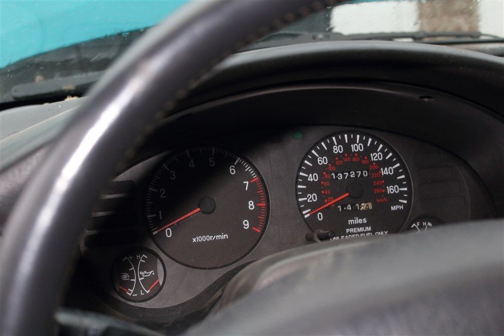

Decided to completely rewire the car from the ground up, by doing this it'll allow me to clean up the chassis and put wires where I want/need them. Also, I'm doing a custom gauge cluster similar to that of the one written up in the forums; it'll look legit hopefully. And to start this off I've just ordered a used gauge cluster that will be hopefully the first and only victim subject to rebuild.

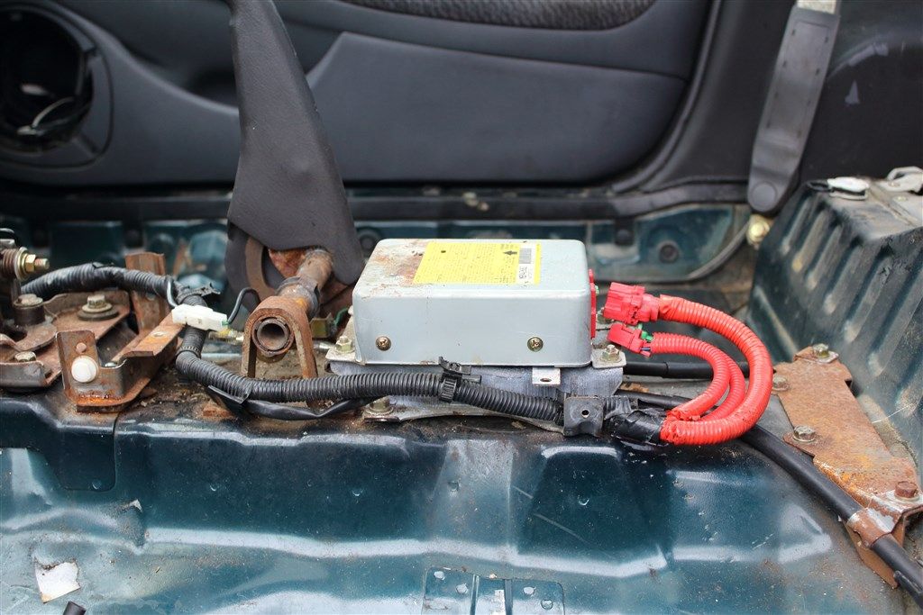

Currently working the details of the battery relocation, since I'm completely rewiring the car I've had to sample and modify a few relocation projects that have been done previously on the forum... that said here is a block diagram of what I came up with; descriptions are very generic and will be specified when the build is underway.

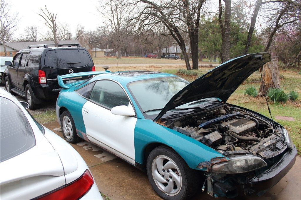

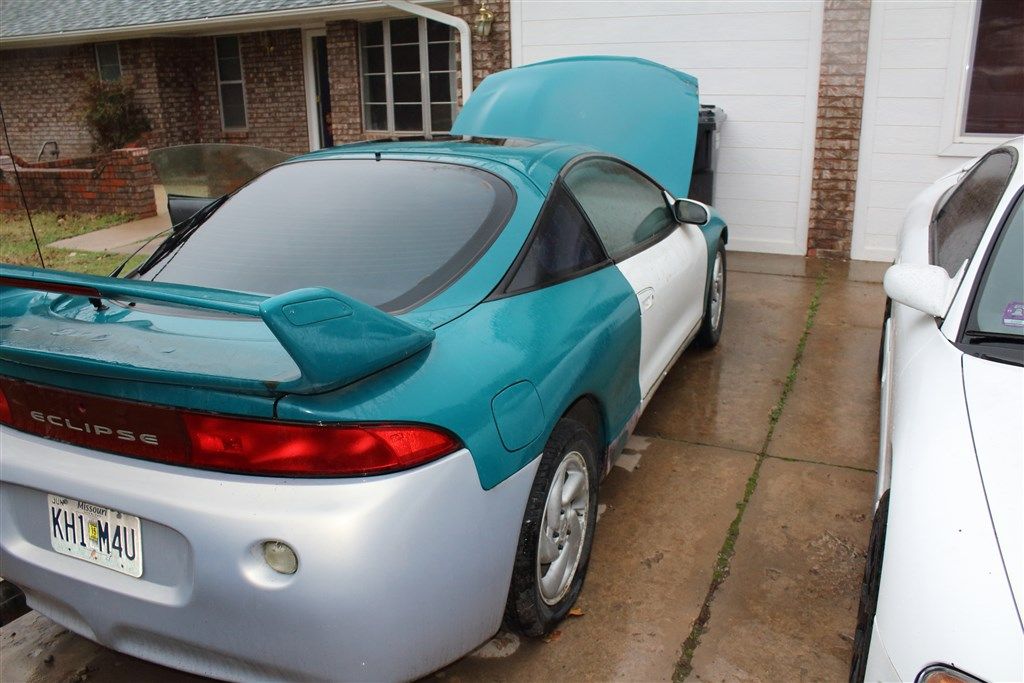

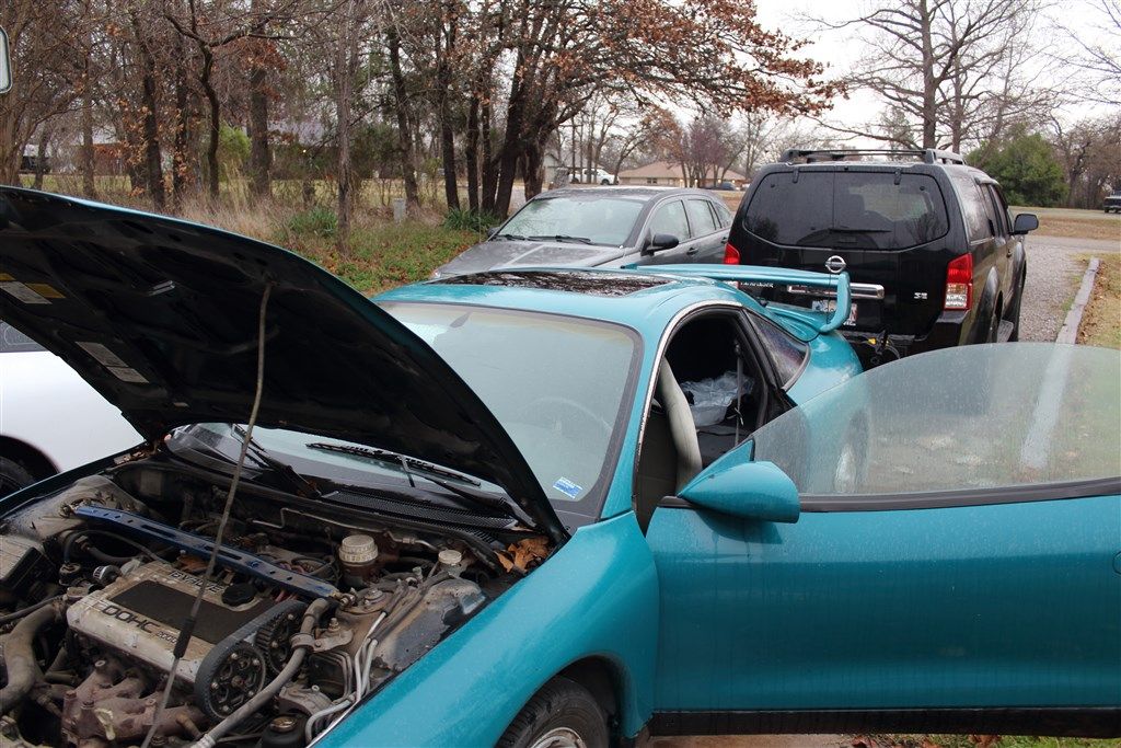

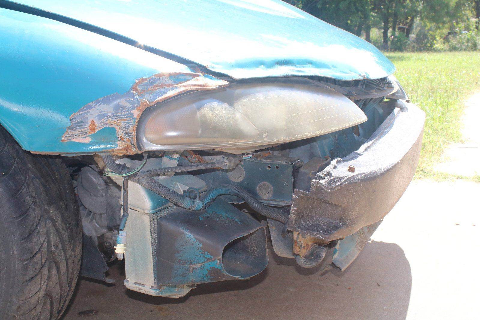

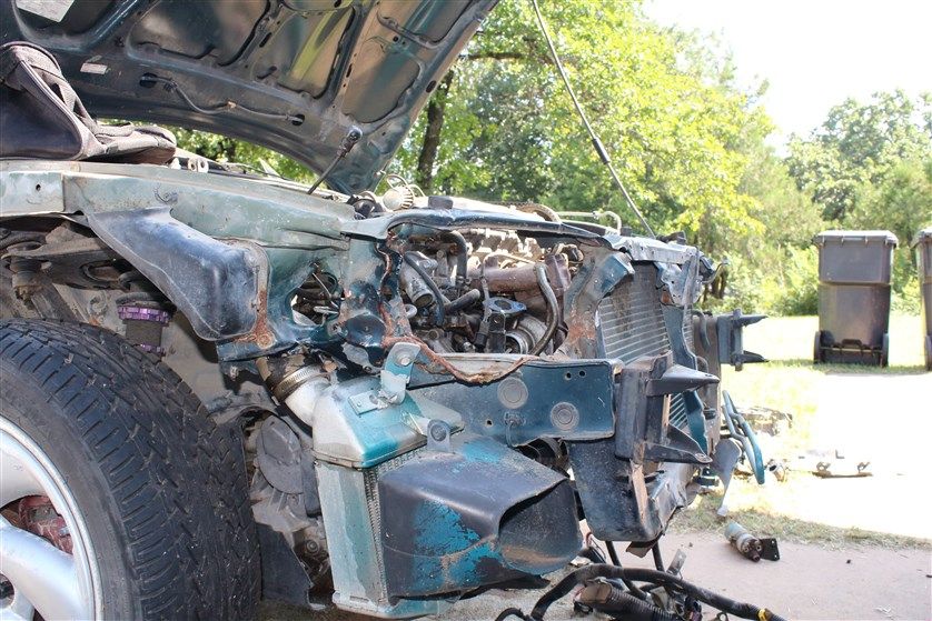

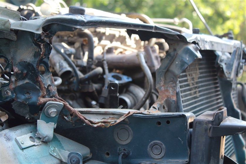

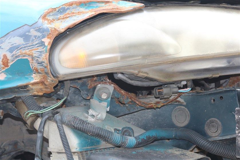

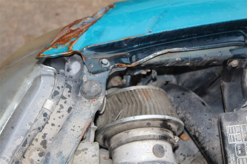

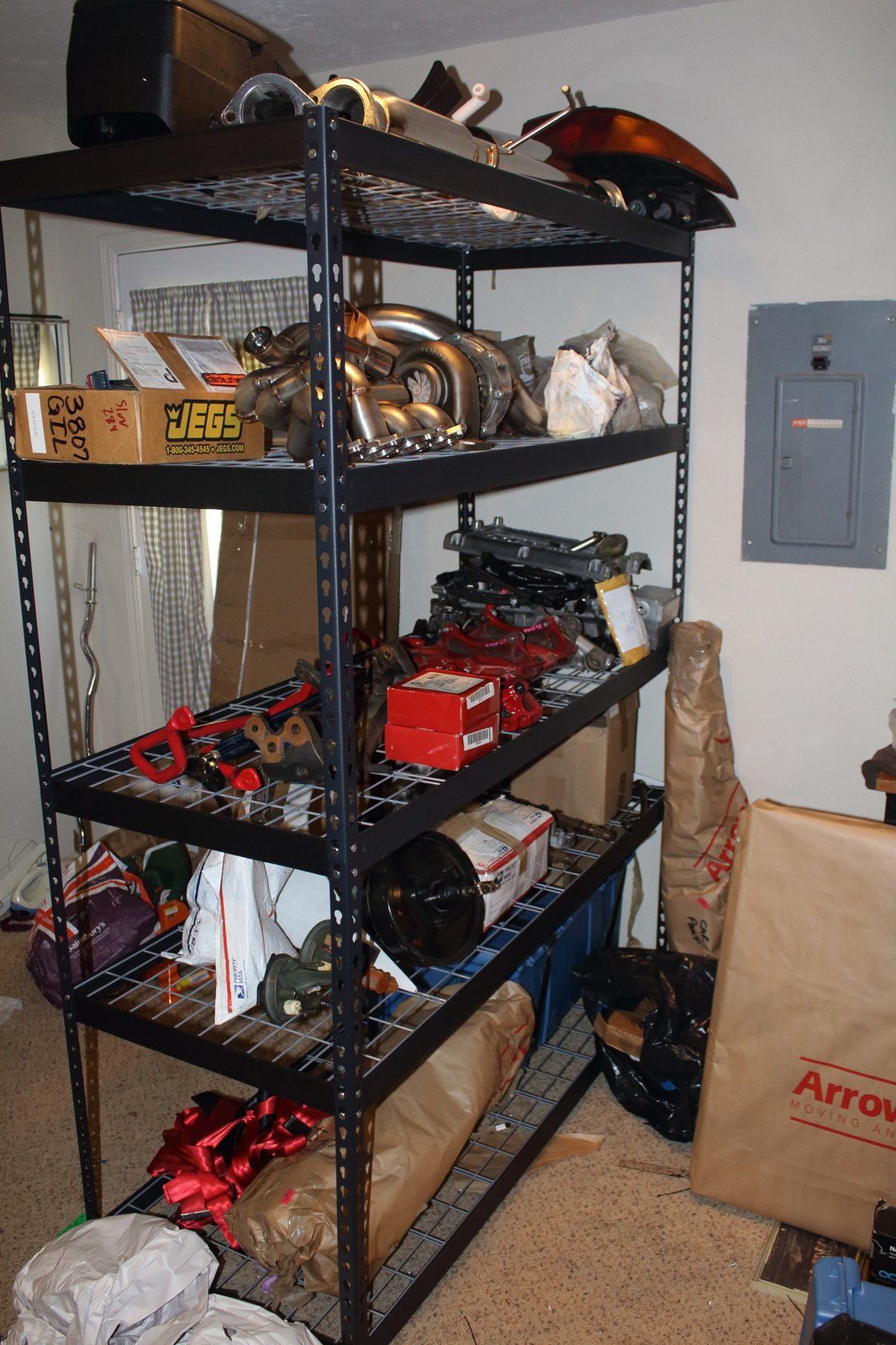

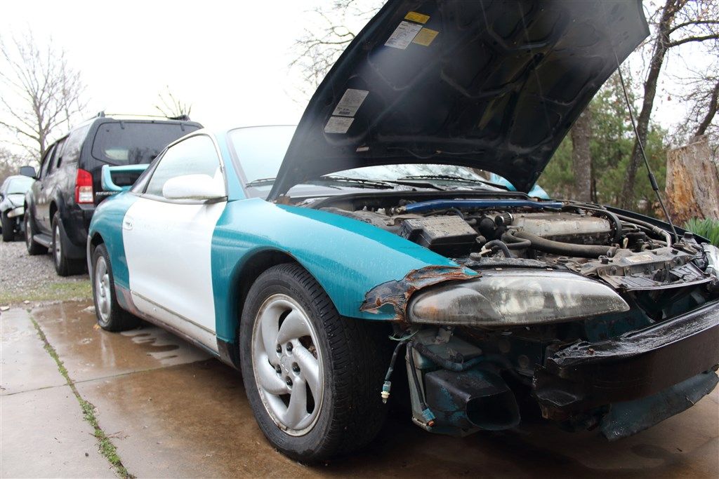

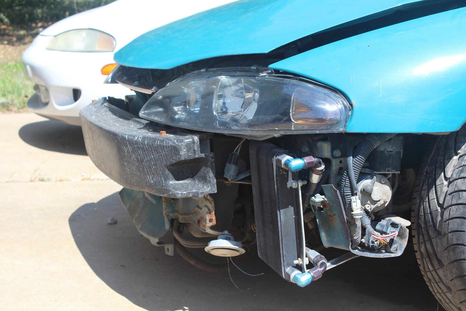

Finally took some pictures of the damage that occurred... just need to replace the front radiator support and I'll be good to go. Of course, I've also got to install the shelved items...

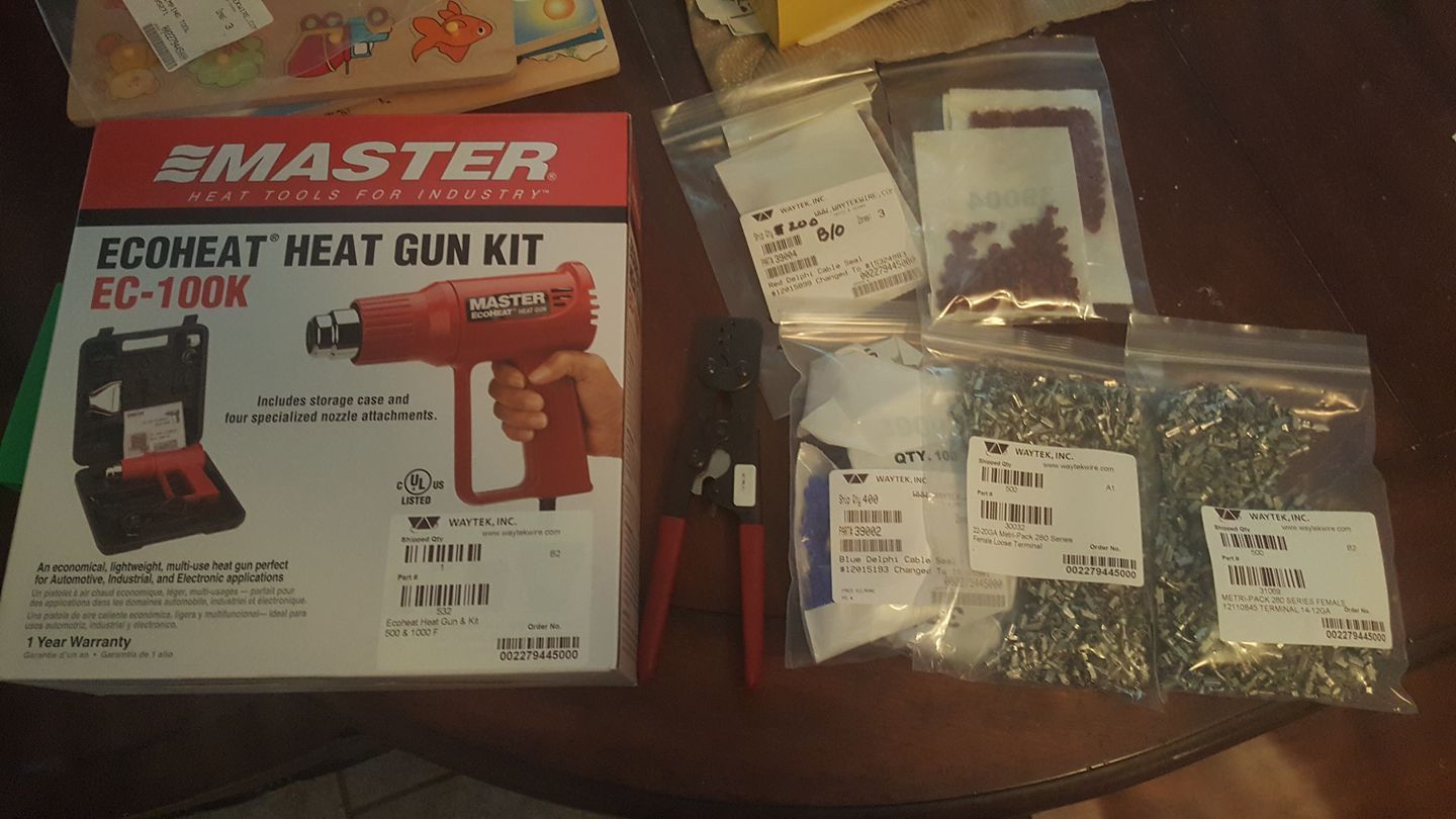

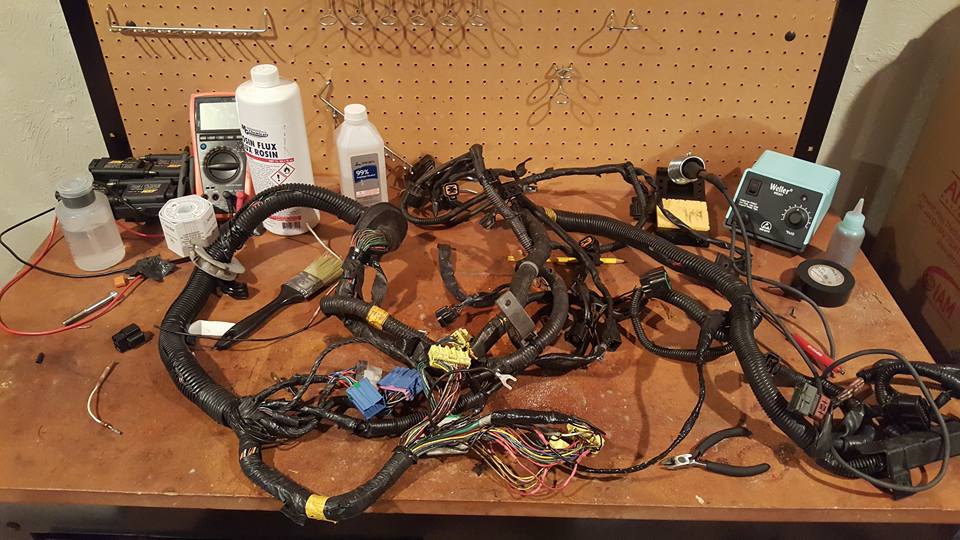

Well everything has been finalized with the wiring block diagram, I will post a new diagram for those who may want to consider a similar setup. Anyways with that said, I'm proud to say that I've begun acquiring all the necessary equipment to start the build of my harnesses from scratch. In addition to that, not only have I finalized the build I've got all the boxes in places that aren't going to interfere with stock body panels or the modifying of anything; having a brand new harness is a lot better than trying to search for scraps or a mint-gone-tomorrow wiring harness... anyways keep posted.
Photo below shows the newly acquired equipment, the harness is one I'm repairing for a buyer. I'm now working on trying to get DMC and Delphi crimpers along with a heat gun for shrink tubing.

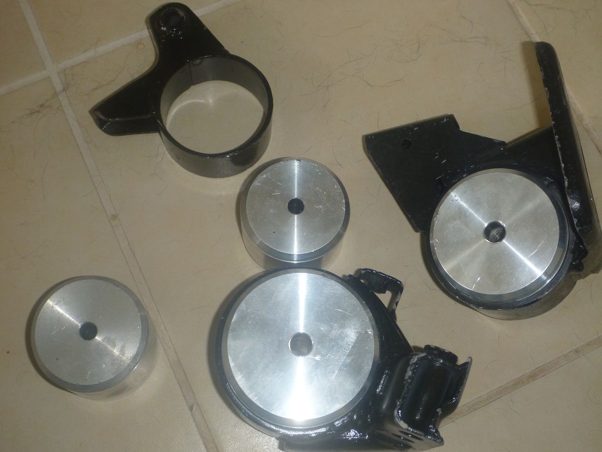

I've had these for a while but forgot to post them, can't wait to get these installed! I plan to swap them over to my 2G mounts, they are a about 1-3mm smaller than mine so hopefully they will still fit snug and if not I'll have to have mine slightly modified to accommodate them.
Wow, hope I'm not wrong about this but didn't I make thouse for you years ago? when I lived in Omaha?? I could be wrong but they look just like the ones I was making and I might be imagining this but I swear I remember selling themto you LOL If so that's awesome feeling
can't wait to see more of the build
Can't remember I know I got them from somewhere but they were pre-built when I bought them.

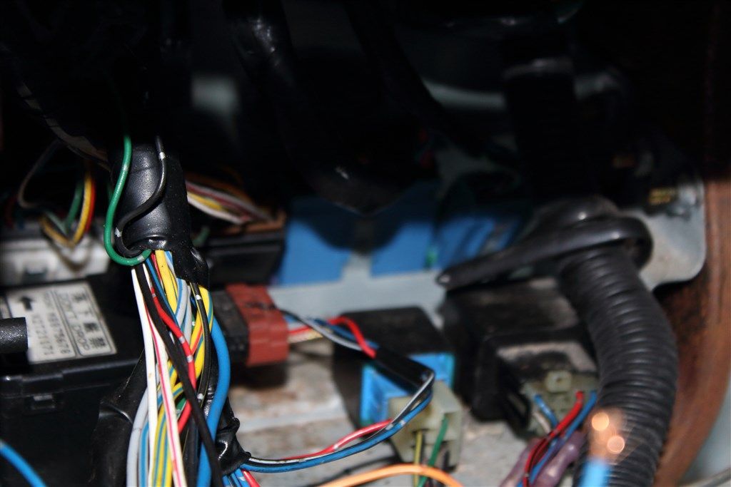

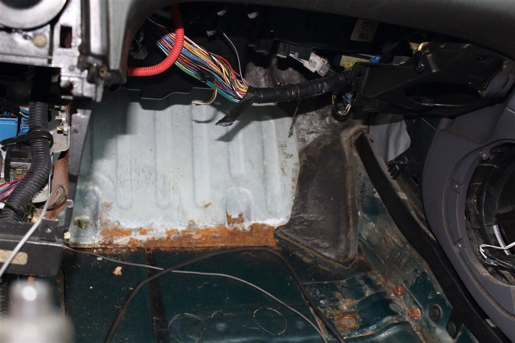

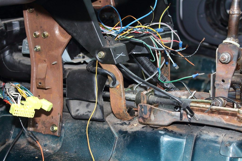

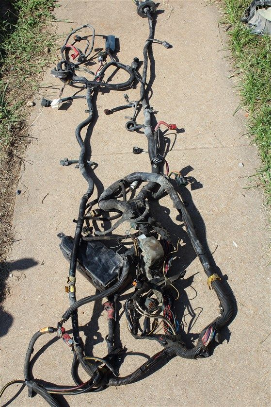

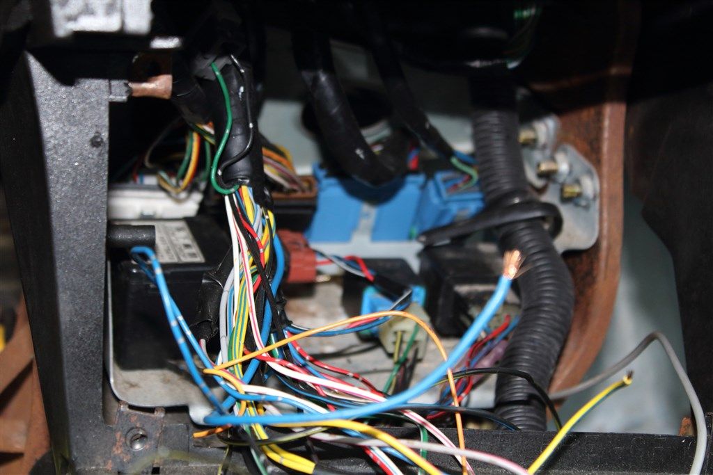

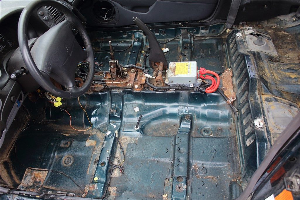

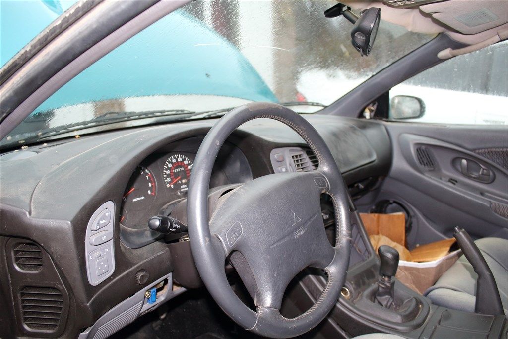

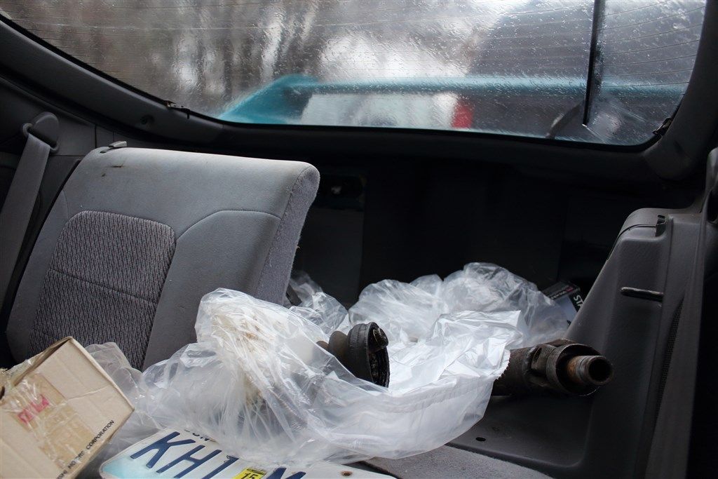

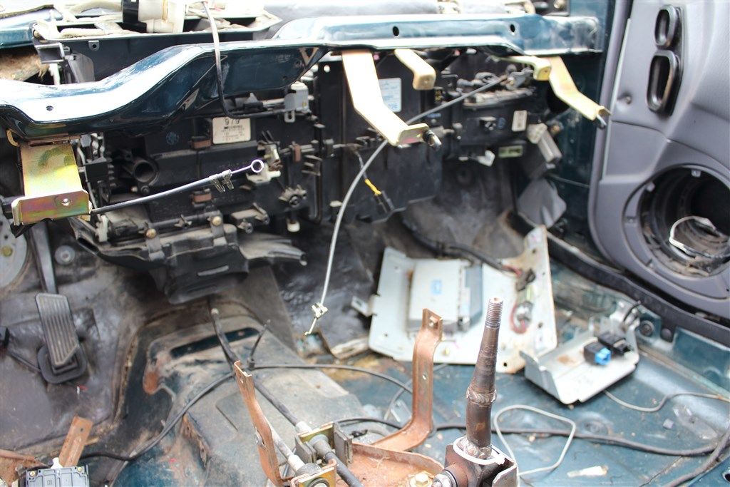

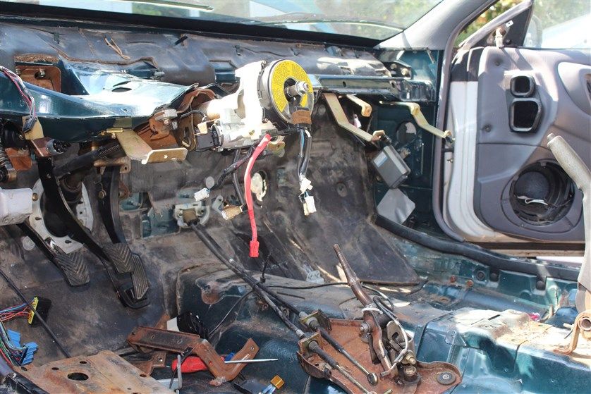

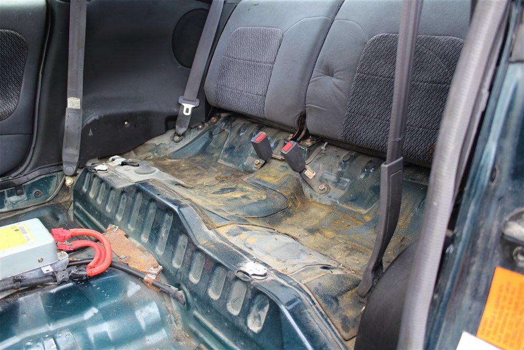

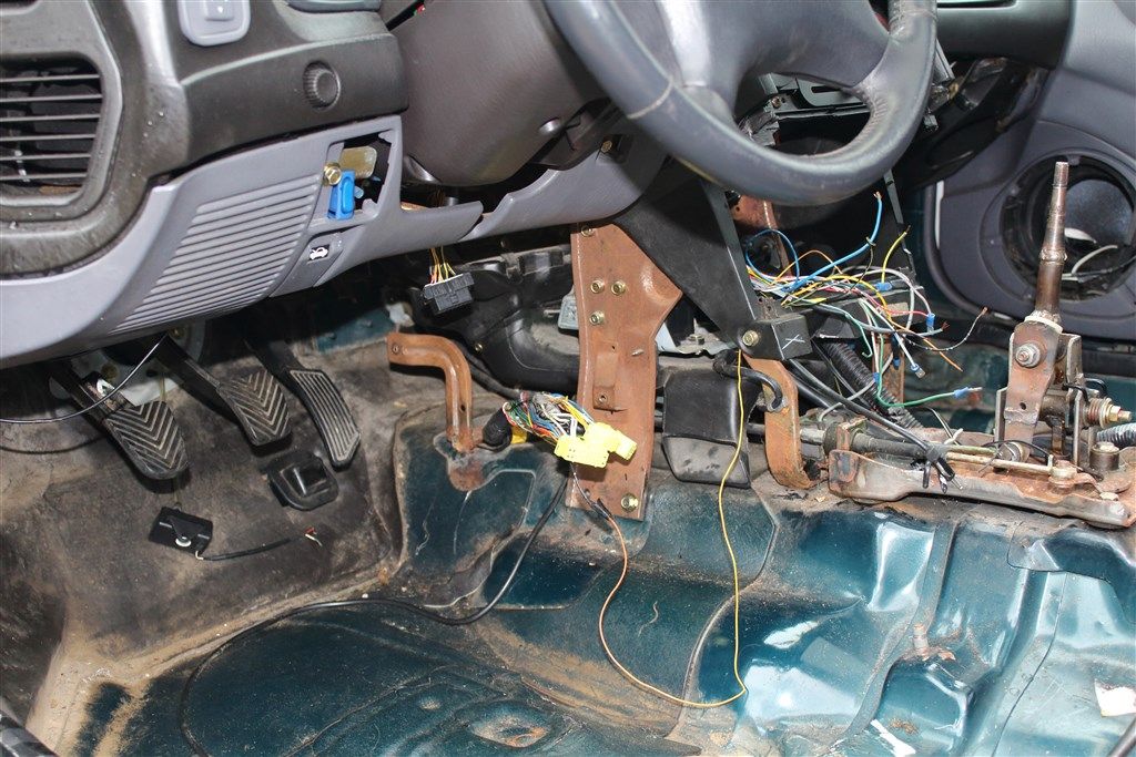

Made some purchases today, I'll post up the details when they come in... finally ripped ol' girl apart again - dash, seats, carpet, and steering wheel have all been removed, I plan to remove the wiring harness this week or the following week and then get the new "pre-harness" fitted for final build and installation.
Anyways figured I'd "start from scratch" as if I just bought the car; added pictures may or may not be a re-post (sorry if they are).

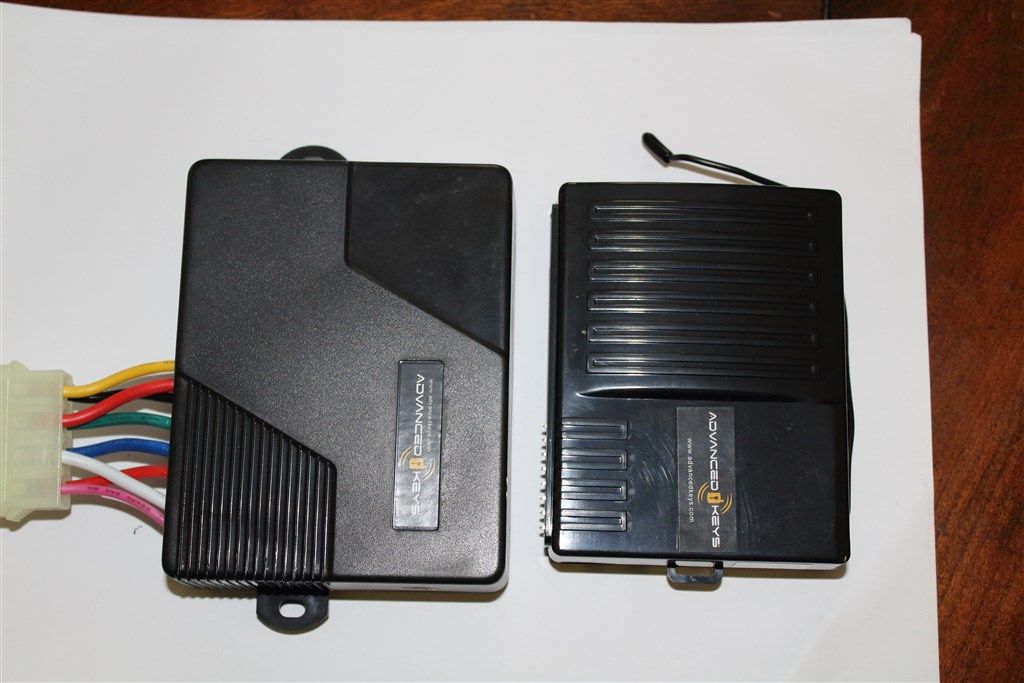

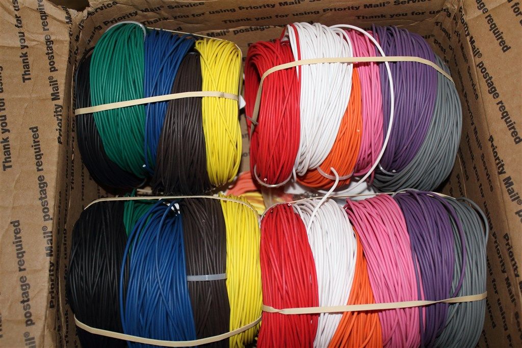

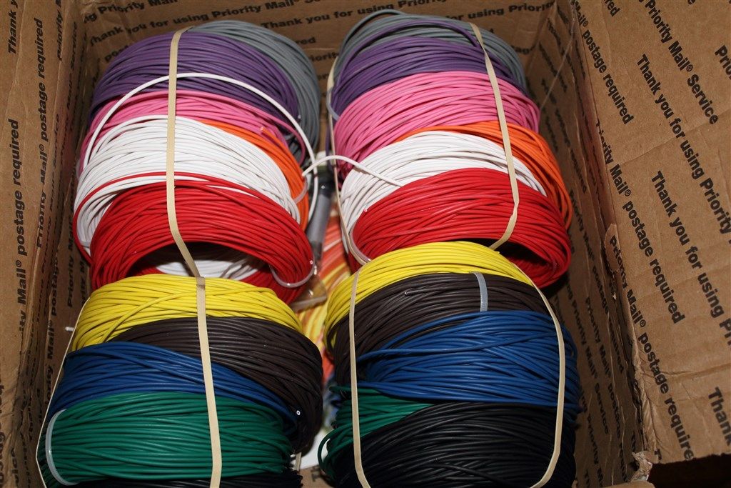

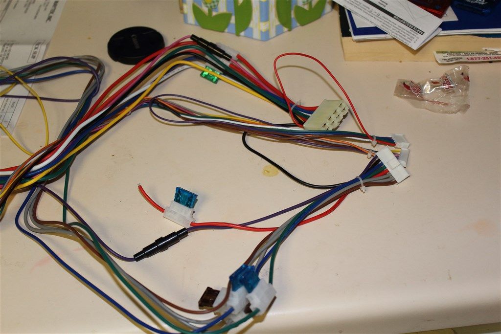

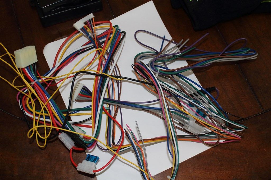

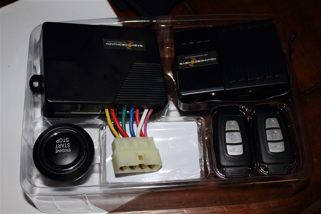

Security and Push-Start system have arrived, the system looks great and looks stout... except the harness - so many things I want to say about it words truly wouldn't come out right. Anyways, for your viewing pleasure, and mine, here is what came today; forgot to mention my 2200 ft of wiring also came in on Monday.
All of this for a fuel pump rewire???
If you read the last 10 to 15 posts prior to the recent pictures it'll explain why, in short since our harnesses aren't manufactured anymore I'm removing mine and making my own with an updated security system; I'm not using the stock ECU, I'll be using an AEM EMS-4.
Cool build, so do you plan to rewire your alarm system? The reason I ask is because I'm thinking of doing the same thing.
You could say that, less rewire more fabricate due to all of the factory wiring being removed. I'd say what I'm doing is similar to yours only I'm not using any of the original harnesses, connectors will even be brand new too.
If you do decide to rewire it go with Advanced Keys, the kit looks solid except the harness they supply which personally could use some work which is why I'm fixing it to meet a standard.

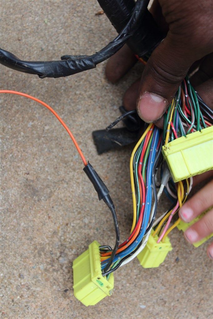

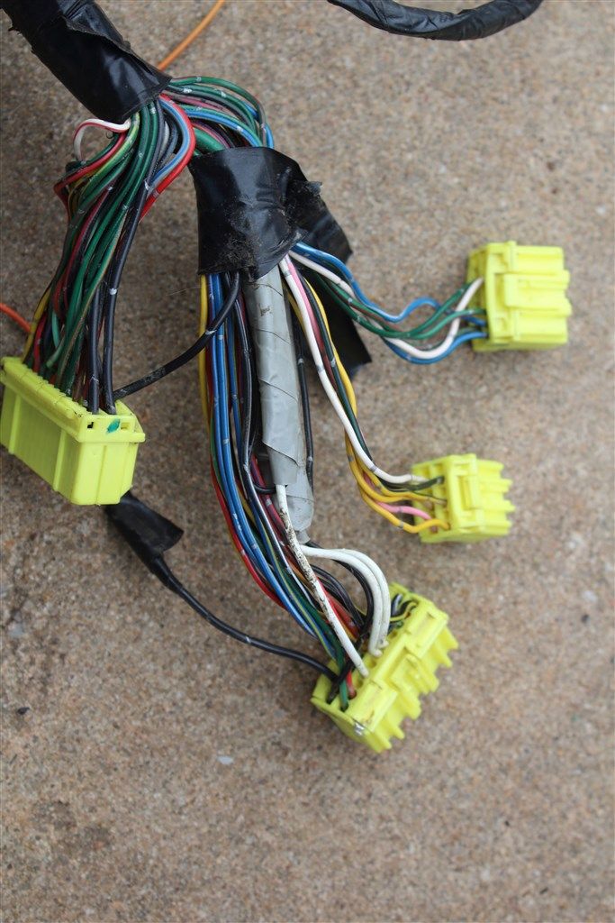

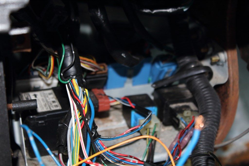

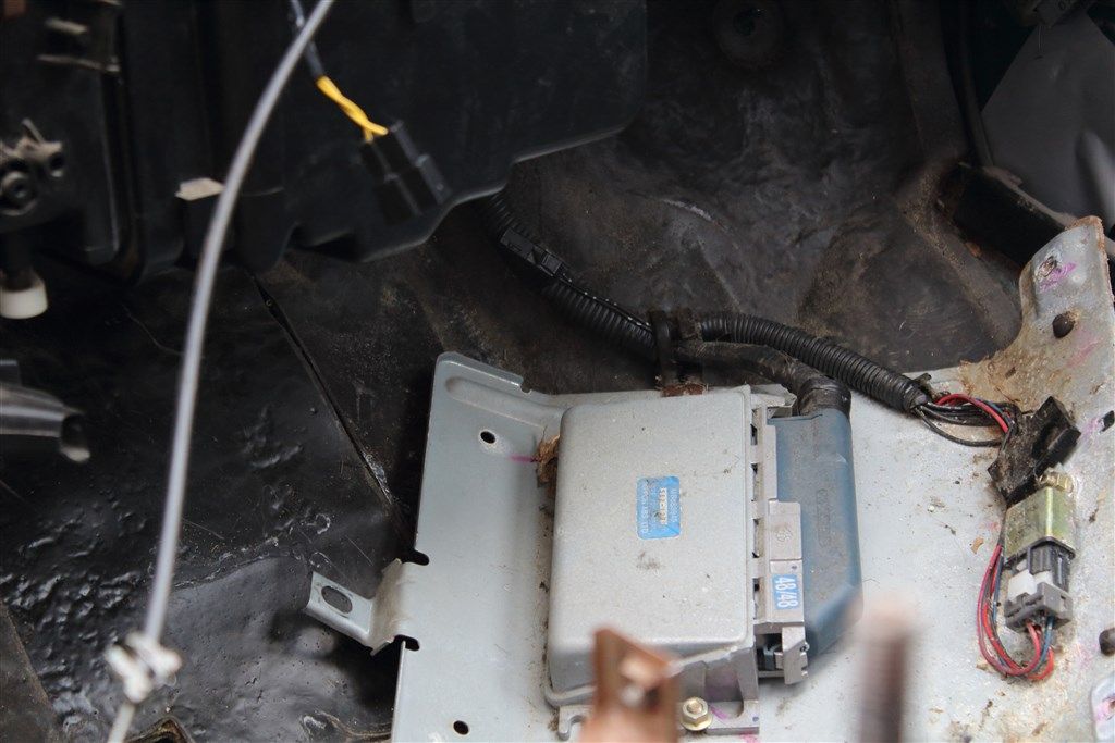

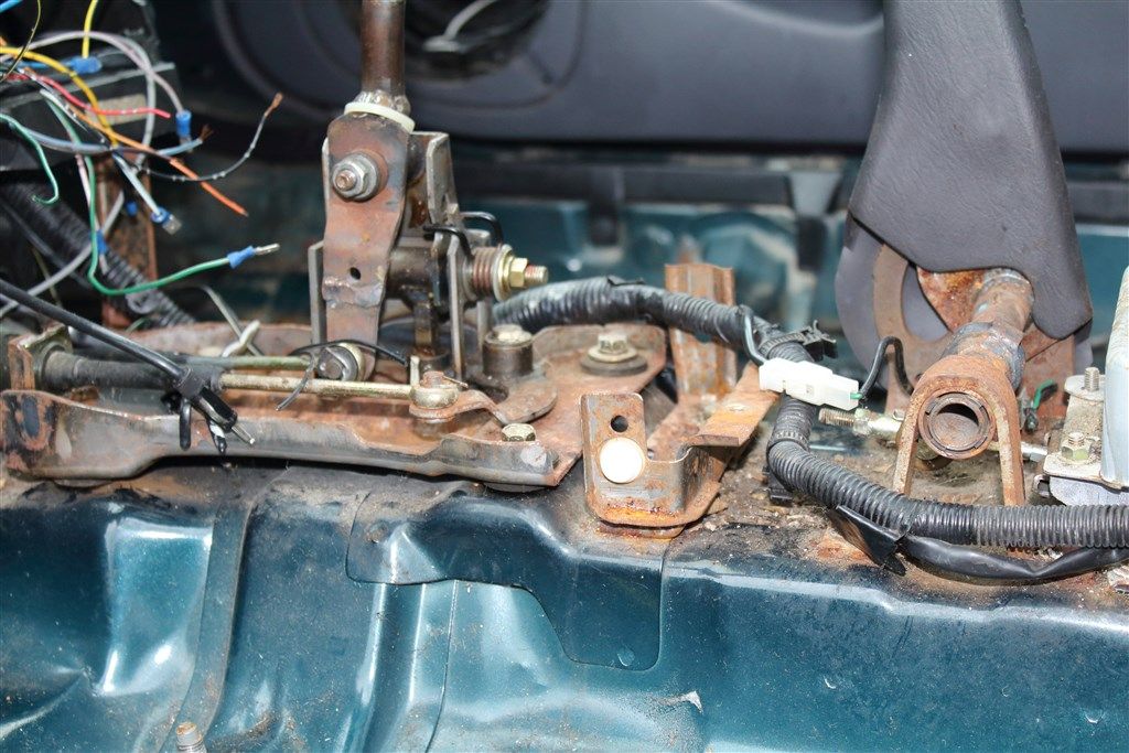

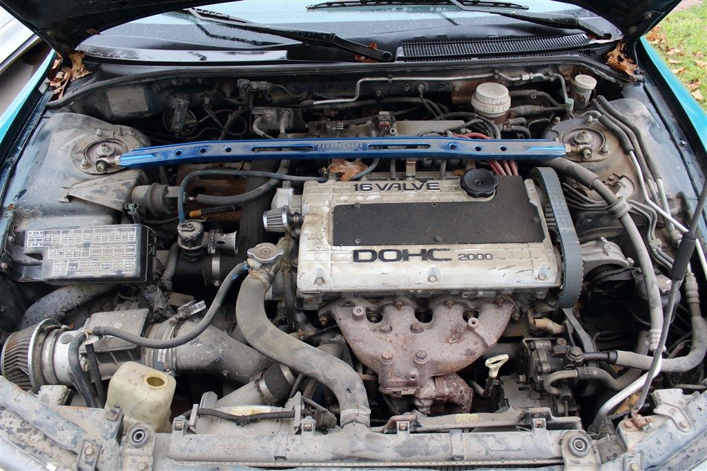

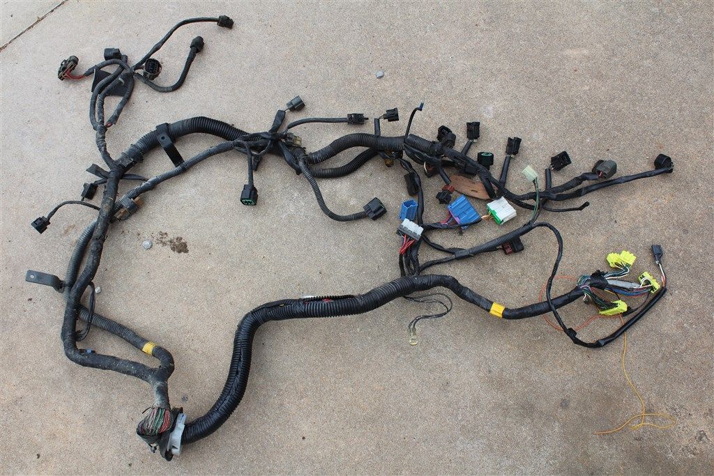

Engine harness removed, now just to remove the engine and front chassis, reinstall said engine, and then have the custom front end built so I can fabricate the engine harness. The interior chassis harness, in the meantime, will be built as I'm doing a circular connector at the firewall where the engine harness originally went and will be routing all components into that connector including the headlamps, turn signals, radiator and anything else in the front; everything is coming along nicely.
So I didn't think my engine harness could look so good... apparently I was wrong; it looks immaculate!

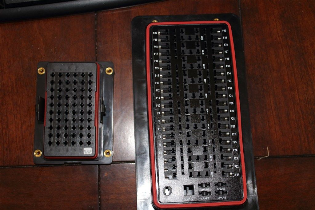

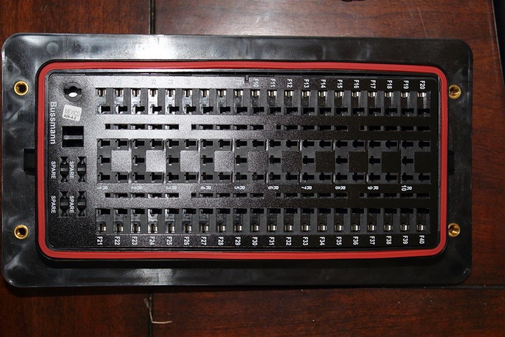

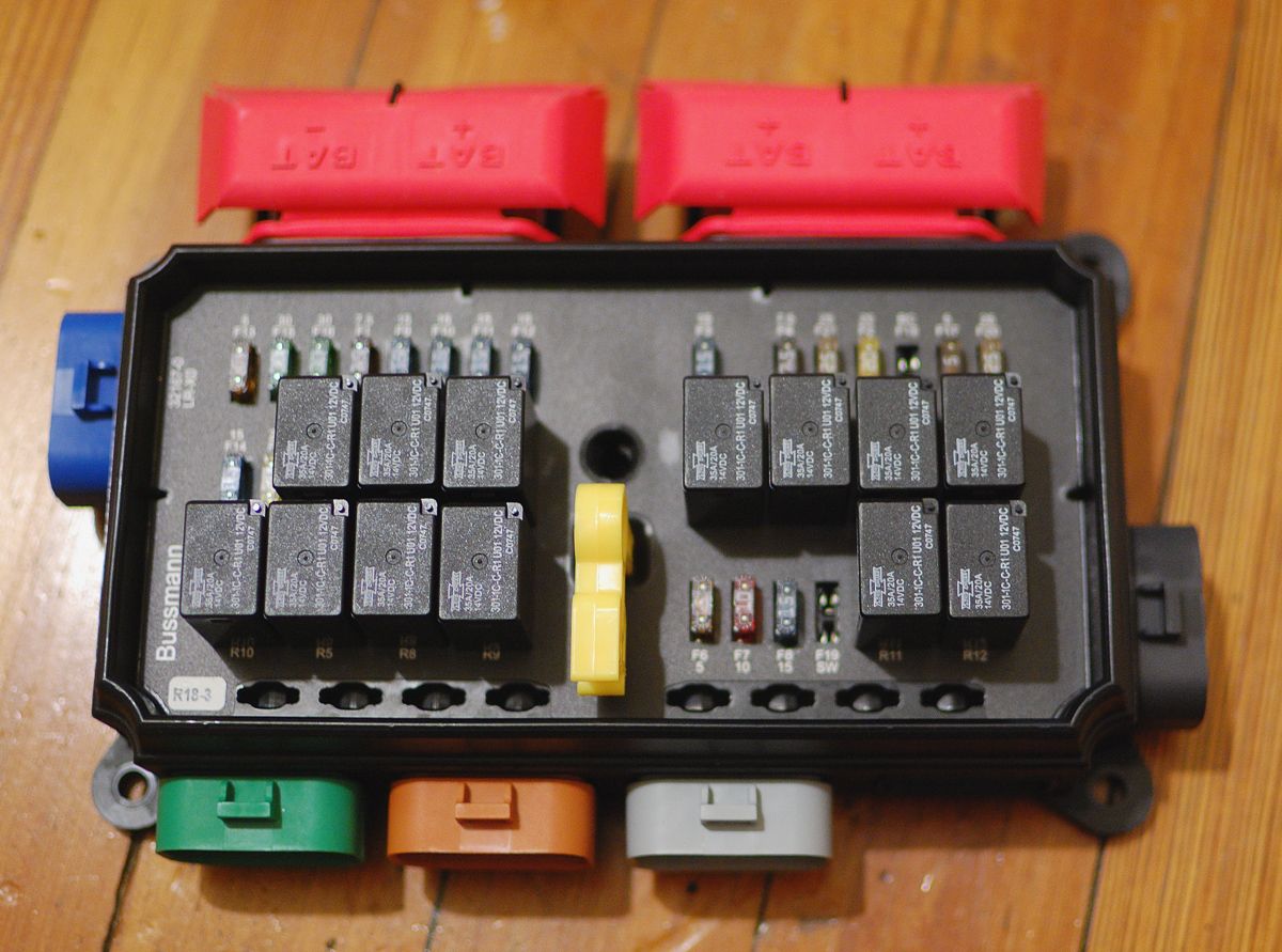

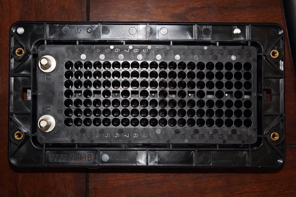

Been working with Connector Concepts on the building of an Eaton Bussmann DVEC fuse box, with that said in order to do so they state I had to create my own schematic for it as it is most likely printed on PCB or internally wired; this is what I came up with.

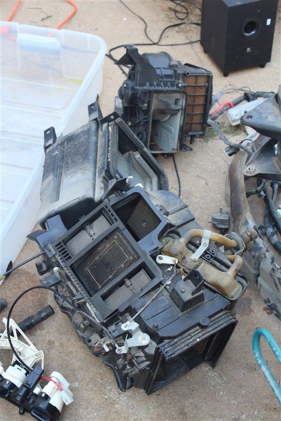

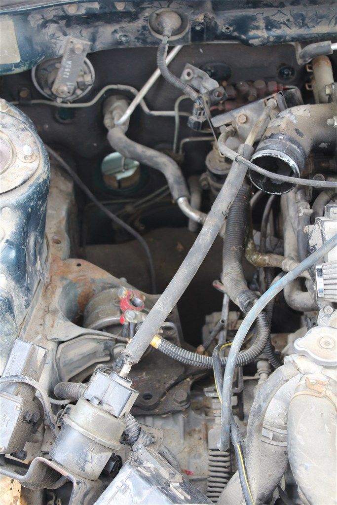

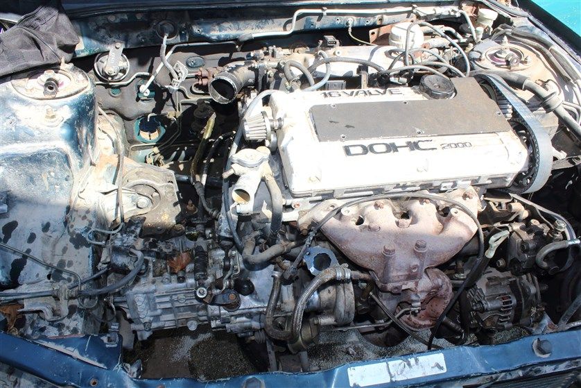

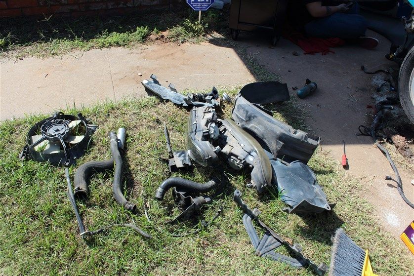

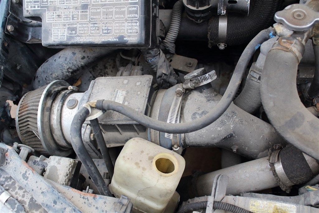

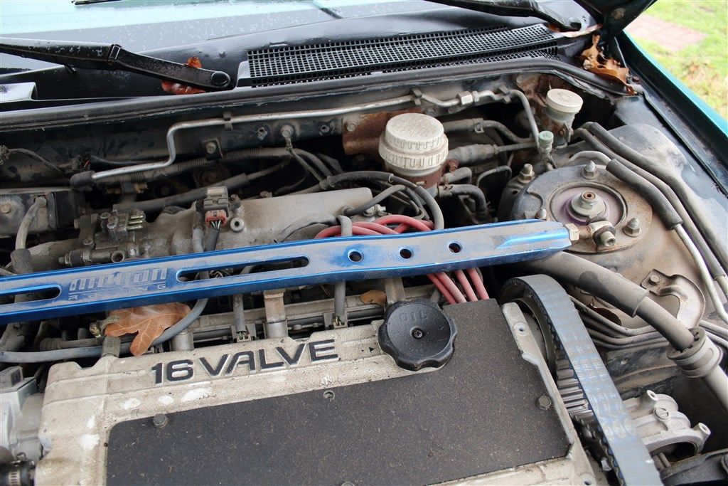

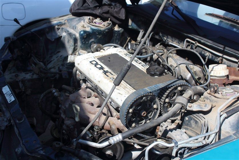

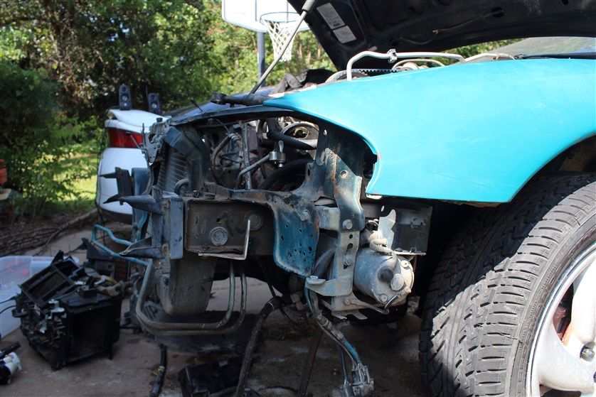

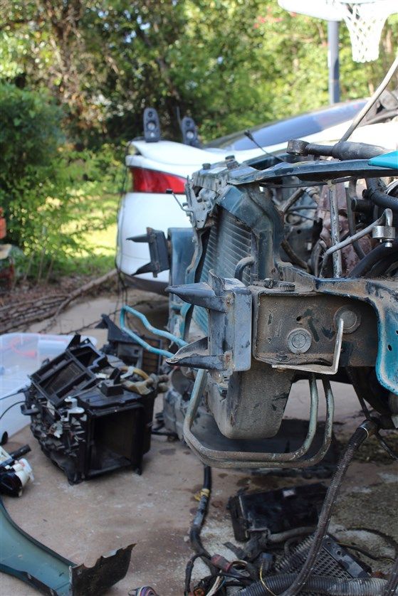

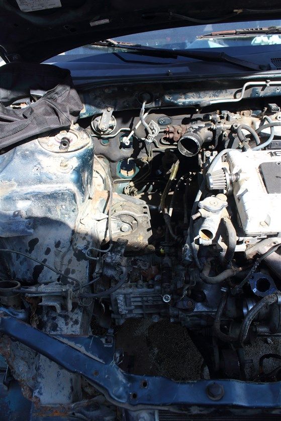

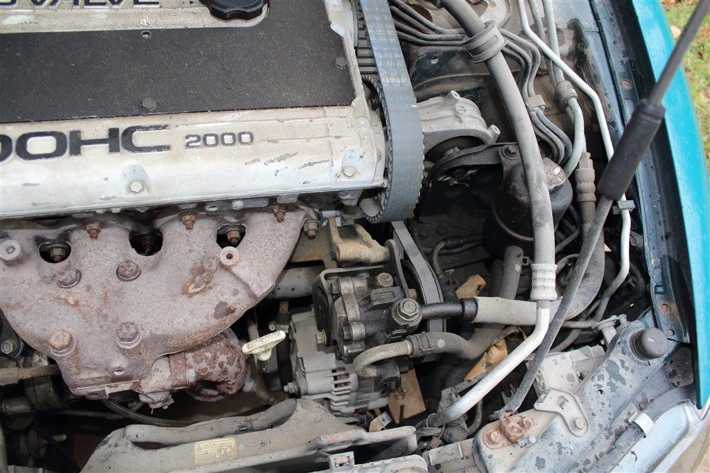

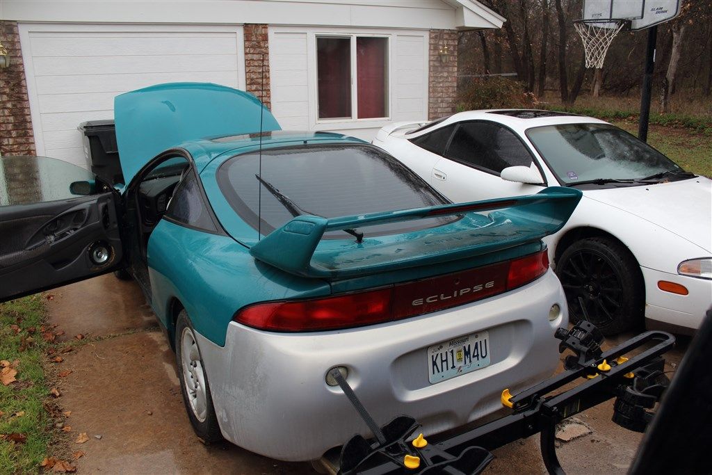

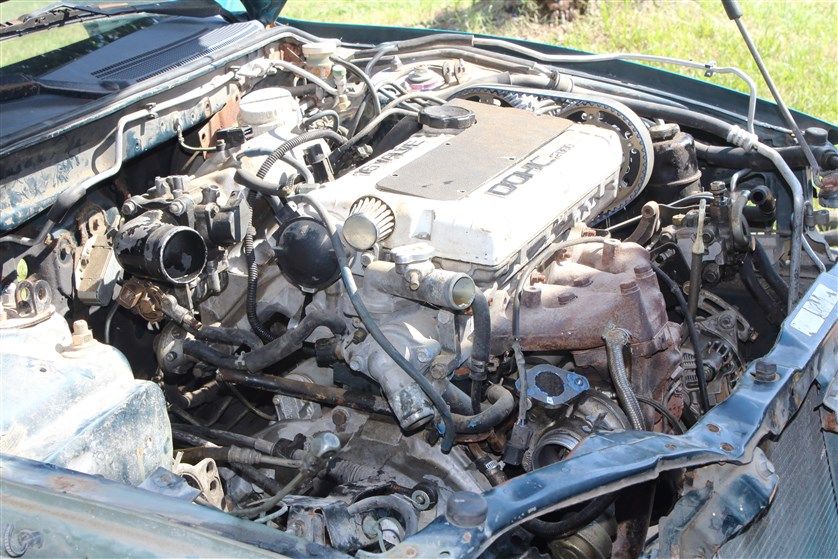

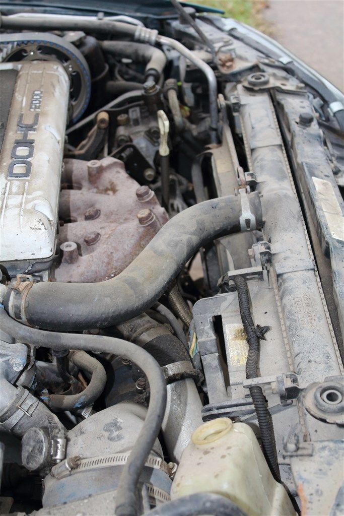

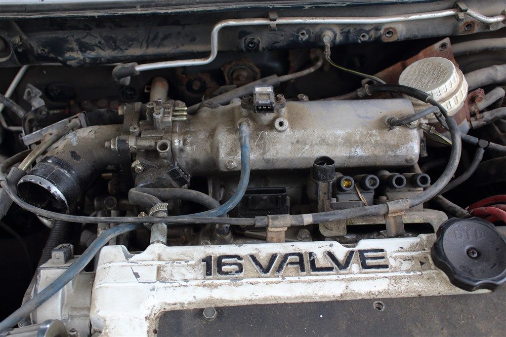

Did some additional work today, got some help from the wife as well. We've begun tear down so that the engine can be polished up with new components, the engine bay cleaned up and holes sealed, removed the HVAC system and debating about putting it back in since this may or may not be a daily driver but more of a weekend-warrior... enough talking here are some pictures for your viewing pleasure. More to come, stay tuned (sorry for the wait).
Might also note you will see a better view of the damage from the accident two years ago.

Although not created yet, I'm currently in the works of having a custom built fuse box from Eaton. Below is a picture of the box but not how it will lay out in terms of my specific/unique requirements. Depending on how this goes I may have them make a few extras for the community as well... keep posted!

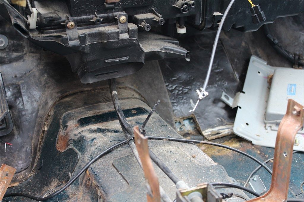

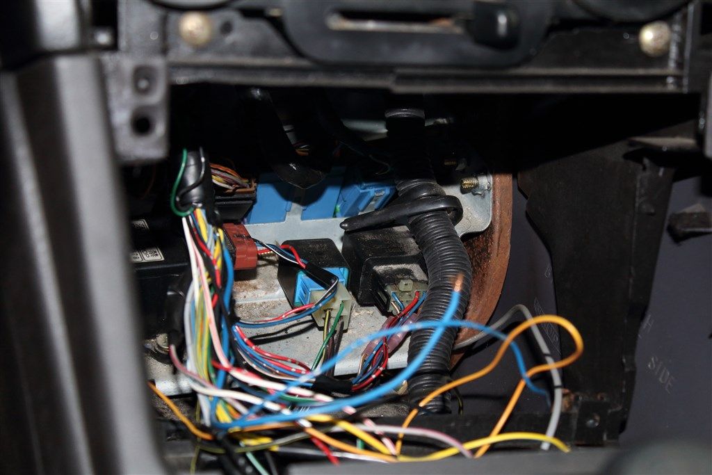

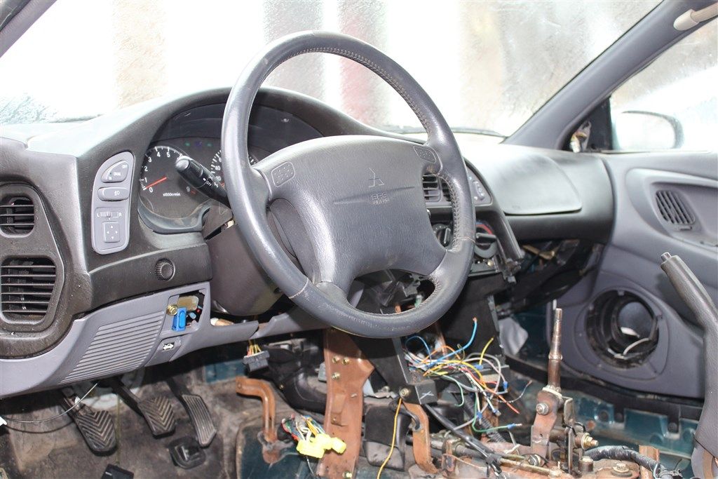

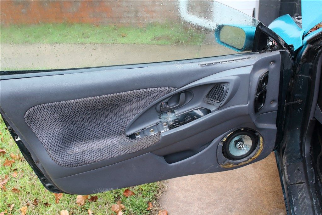

Been almost 3 years since I have posted here... and it is still at the same place where I left it.

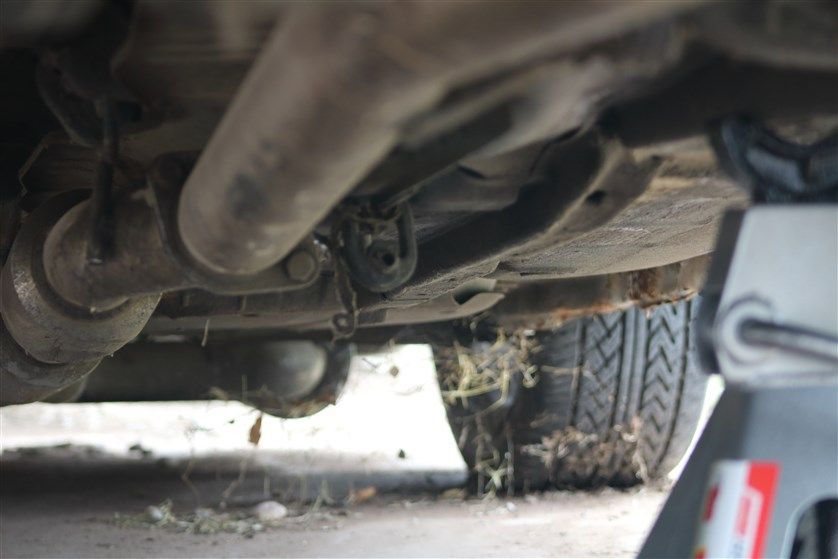

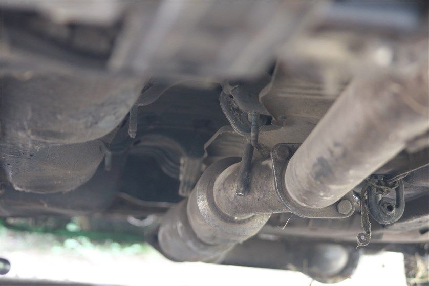

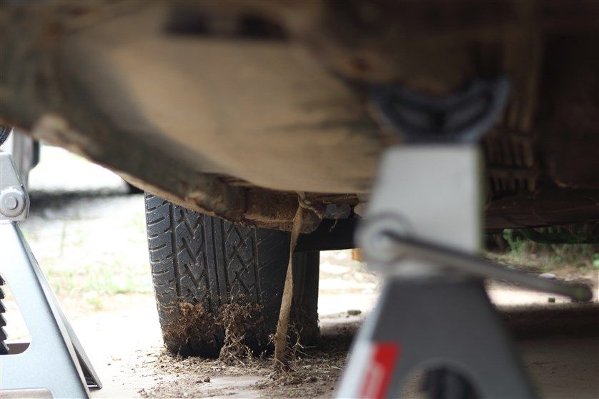

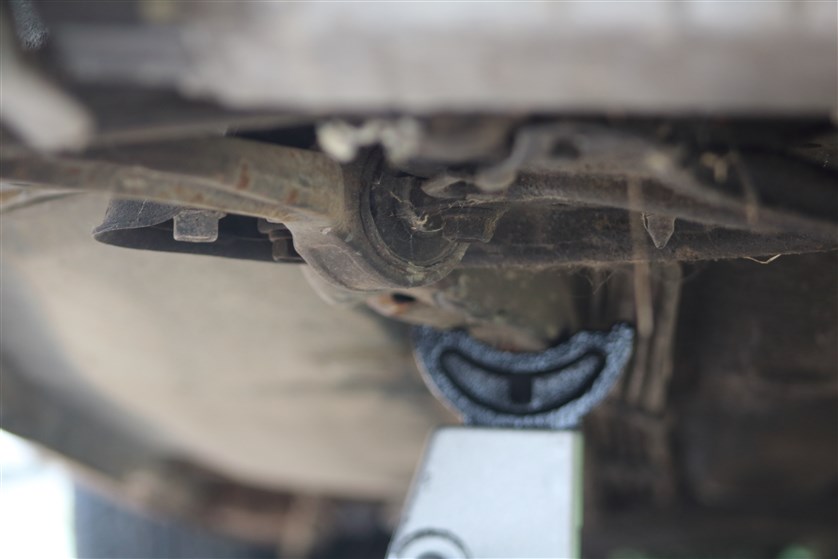

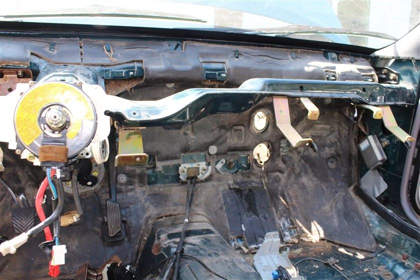

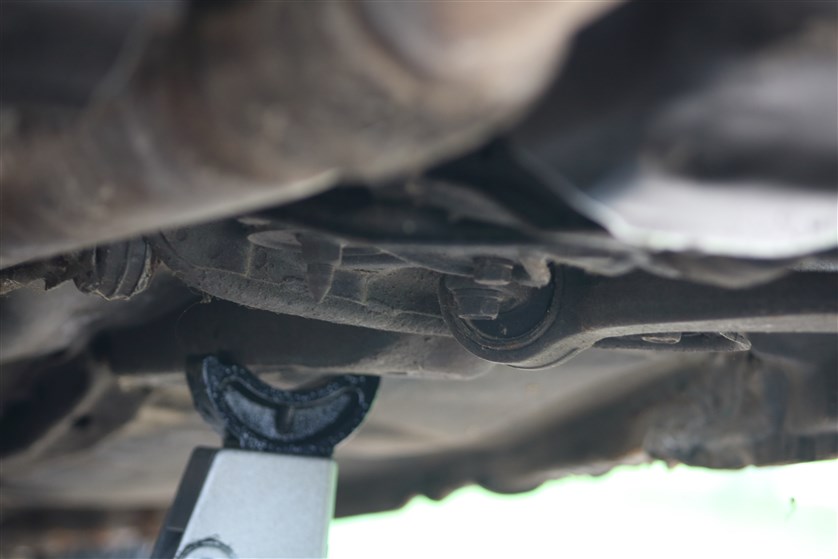

As of right now all interior items have been removed except for the steering wheel. As of right now I am still in the process of dropping the rear subframe so that I may be able to drop the fuel tank for the larger sump-type fuel cell that will replace it. Although, I am still on the fence of either running solid subframe bushings or switching over to a tubular subframe, honestly I do not forsee truly racing it and thus I may just opt for the solid bushings... more to come - I'm back.
