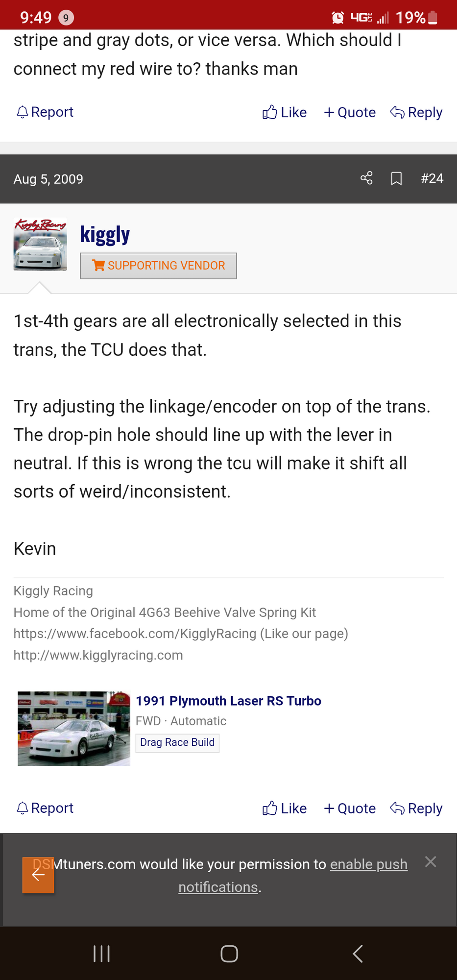

I've been testing sensors for a few hours now and all of mine check out. The one thing I found that I had to dig pretty deep for was something about the pin dropping in while in neutral for the shifter. Mine was off a pretty big amount so ill have to test this theory, but this is literally the last thing I found. I checked my tcu and nothing looked bad or nasty and the transmission still shifts it would just hunt in lower gears. My pulse generators and solenoids both checked out perfect so I'm hoping this was my cause, I'm being hopeful at this point. I did find spare solenoids but before I drop the pan for the 5th time I'd like to see how this goes.

1) it doesn’t really increase line pressure it just limits the slippage of clutches in between gear changes. So, should be fine. Line pressure is controlled in the valve body.
2) Steve would be better at explaining why the diodes are necessary. I assume it’s voltage regulation or something similar.
3) if you trace the wires for the OD switch on the shifter you can use it in place of the toggle switch. I did it on my auto using the Kiggly mod and it was nice and OEM.
4) unplug the TCU or it’ll throw it into limp mode or it’ll try to shift itself.

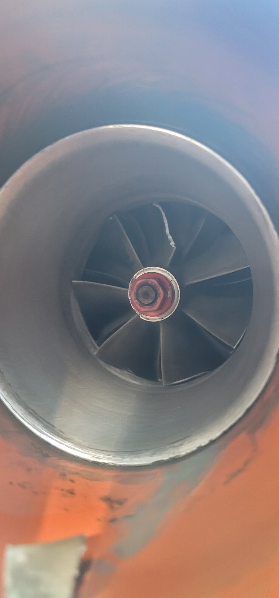

So im not sure how this happened. I was ripping around with my buddy and all of a sudden I get zero boost. I was pulling about 25 psi and as soon as I let off the gas and back on that's when I noticed. I pulled over and found this, so I limped it home. I guess I'm going to have to try to figure out what I need to rebuild this Frankenstein. This is the second time something has happened with one of my certain buddies in the car on the same road. Either the road or my friend is cursed. I'm sort of guessing from when I let of the gas maybe my blow off valve didn't open or open all the way? I'm not sure, I'm just happy it didn't blow up.
What is the intake and filter setup you are using? Your comment about "the same road" brought to mind debris or stones getting through the intake.
It's a paved road it was more of a joke with my buddy since the last time we went out the intercooler pipe also blew off. I had to also limp it back to his house. The intake setup I have is an fp that's recirculated to my synapse blow off valve. I've got very minimal shaft play so my buddy is going to help me source a wheel and ill hopefully have it back up and running soon.
