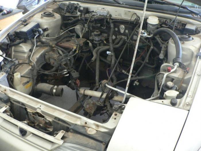

Alright so as the title says, I have a 1g that I am beginning to piece together after a 1 year break. I believe this is one of the cleanest if not the cleanest in the country. Anyways the story goes like this, I found this car crammed in somebodies poll barn with literally 5 years worth of dirt and junk piled on it. The car had dropped a valve back in 1998 and was not driven since. The mileage is at a measly 53k. Anyways. I have decided to restore the car back to the beauty it once had. Stock block and nearly a fully stock build. Once the car is running I plan to slowly upgrade to a 16g for a nice somewhat quick DD. Long story short, there will be more money invested in suspension than the engine.

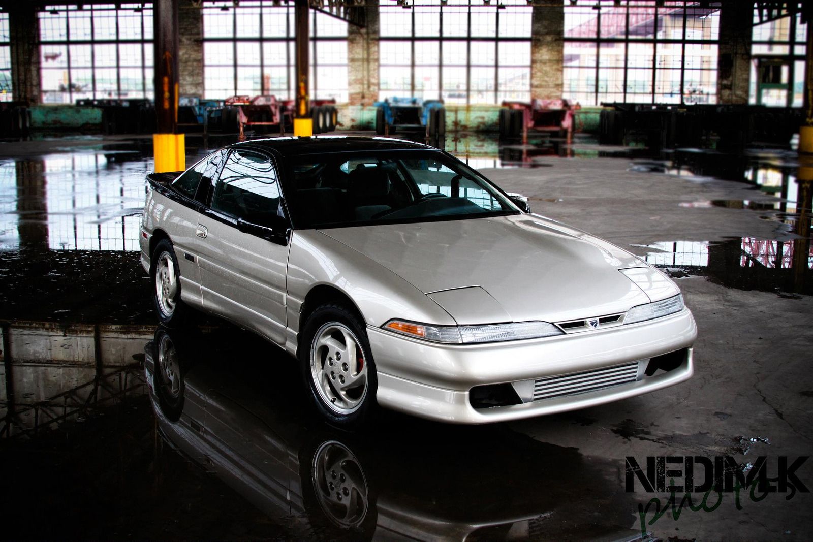

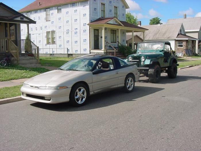

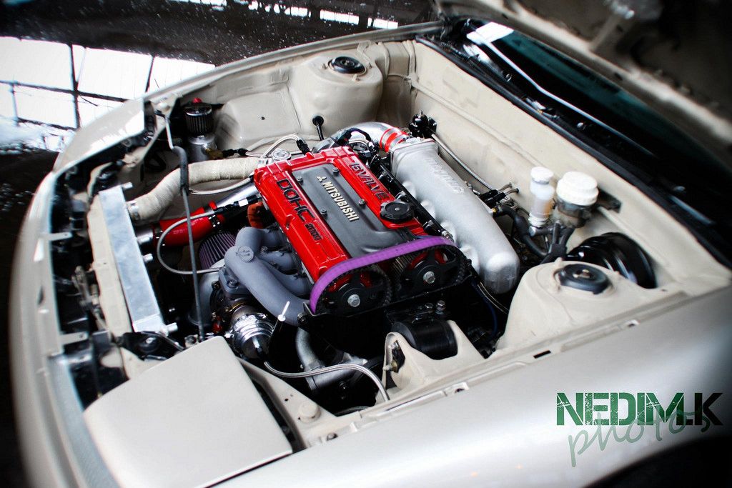

Also, Thought I would add this. These are pictures of the EXACT car I own now, when the original owner had it. Yes, I will be the second owner that ever got to drive it out of the 5 who have owned it!

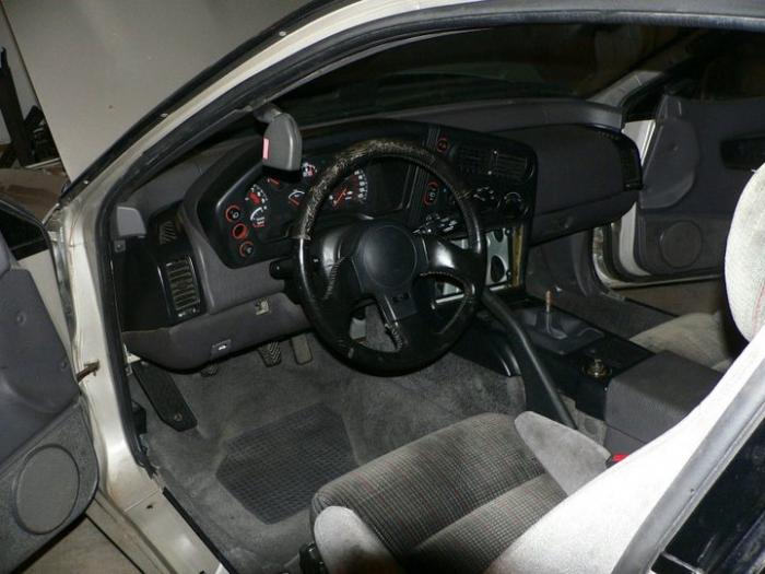

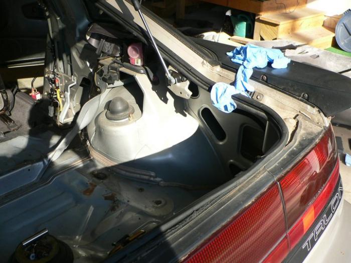

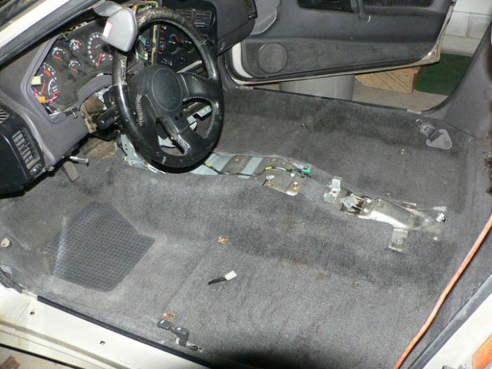

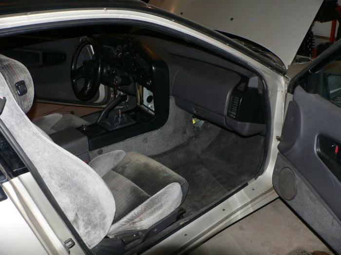

Actually I am quite sure it is one of the cleanest. All of the factory bolts even still have the zinc coating on them. There has not been a single bolt to break. Zero rust whatsoever and no sunfade in the interior.

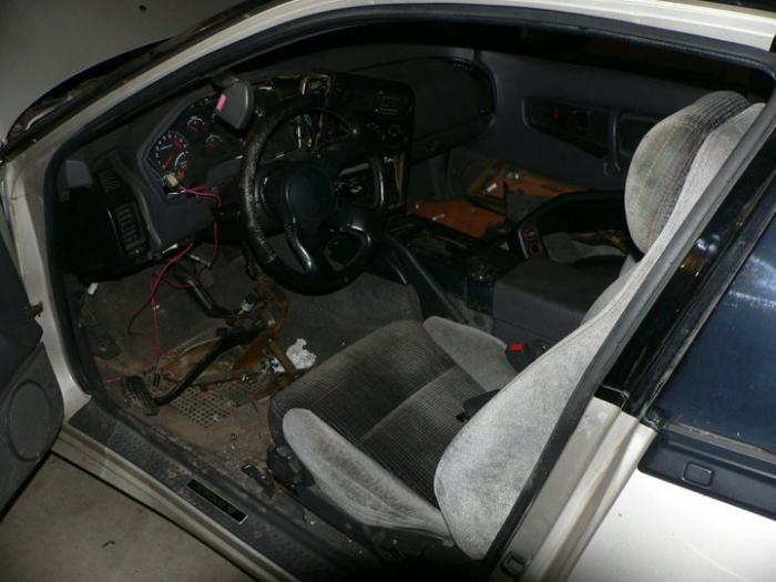

Steering wheel is all cracked up i can see dirt in the vents, and gauges, plus no radio. Anyone can clean carpet, just my 2cents.
I dont feel like arguing this, because its a never ending battle. I will say however, This car has never had an aftermarket part installed nor has it had ANYTHING messed with. I think that makes it clean, because no dumba##s have had their hand on it. To me its the cleanest their is, because I know ill never find another even close.
I get what your saying, Its basically a blank canvas that you can do whatever you want to and know that its done right. But its certainly not the cleanest 1g I have ever seen. It will be great to see updates as you go along. Best of luck on the build.

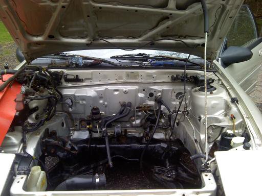

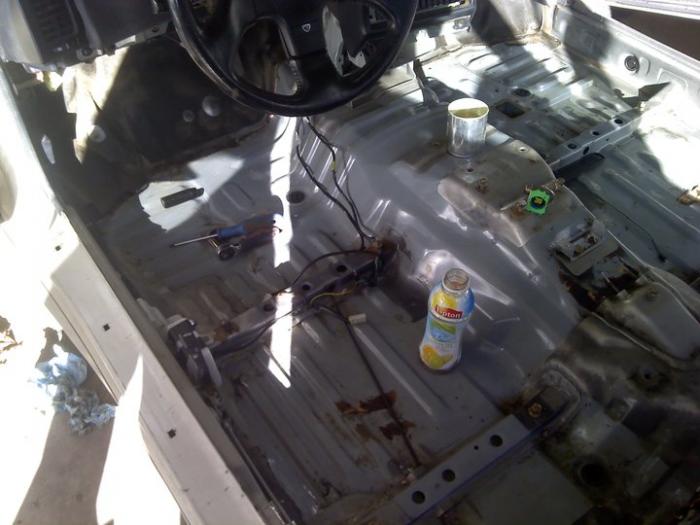

LOL to everyone. This is all in good fun. Anyways, the car IS going through a color change. I finally started working on it heavily again, got all of my energy bushings installed. Now working on how to tighten up the rear a bit to get rid of that weird roll these things have. I plan to make this car dominate corners, but we will see as we all know how 1g's handle....
