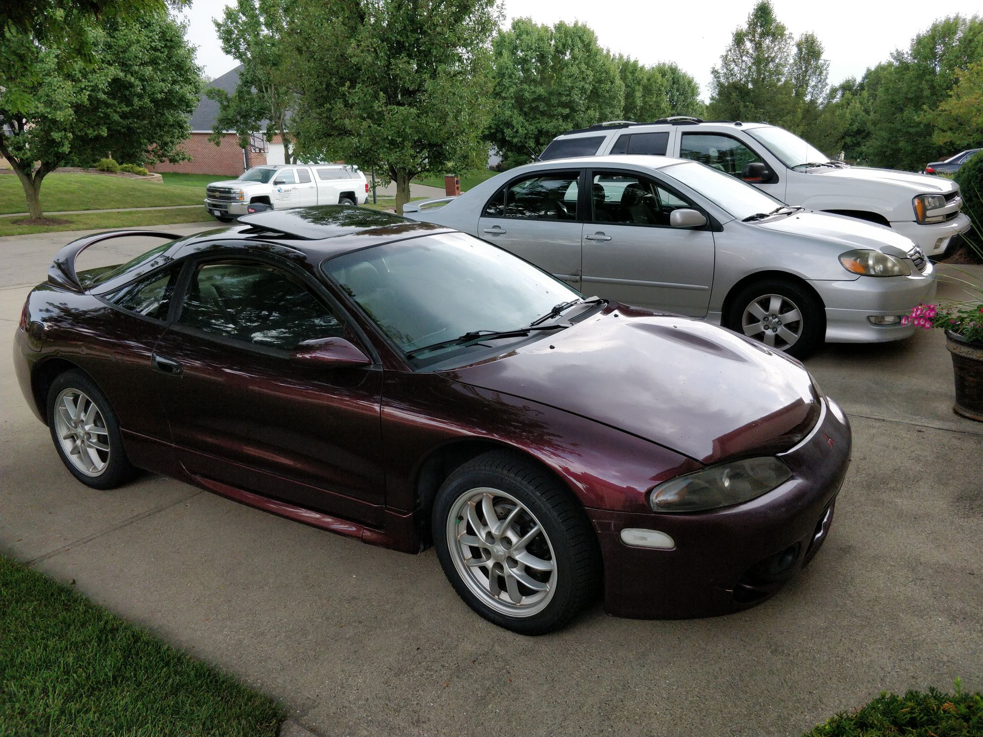

Using my inheritance from the death of my grandfather, I bought a 1998 GSX and listed the Focus for sale. This brings everything up to January of this year.

There's the background. That's why I'm frustrated. Bitter, angry, exhausted. Broke. But I think it's time to actually get into this build!
I am not one to implement temporary solutions, nor am I one to do things halfway, so the hope is to address all of my potential future needs from this engine in this one build. It centers around a set of Mahle 9:1 pistons to be mounted on Manley H-beam rods. Aside from the standard slew of gaskets, bearings, and ARP hardware, the engine will be supported by a 255lph HP in-tank Walbro pushing 93 octane through 1000cc Deatschwerks high impedance injectors and kept in check via an Aeromotive A1000 FPR. The aftermarket underdrive crank pulley (hopefully it hasn't been on there long) is being replaced by a Fluidampr unit. The balance shaft delete will be completed by installing rotated bearings. A Gates Racing timing belt and OE timing component kit will prevent this issue from returning.

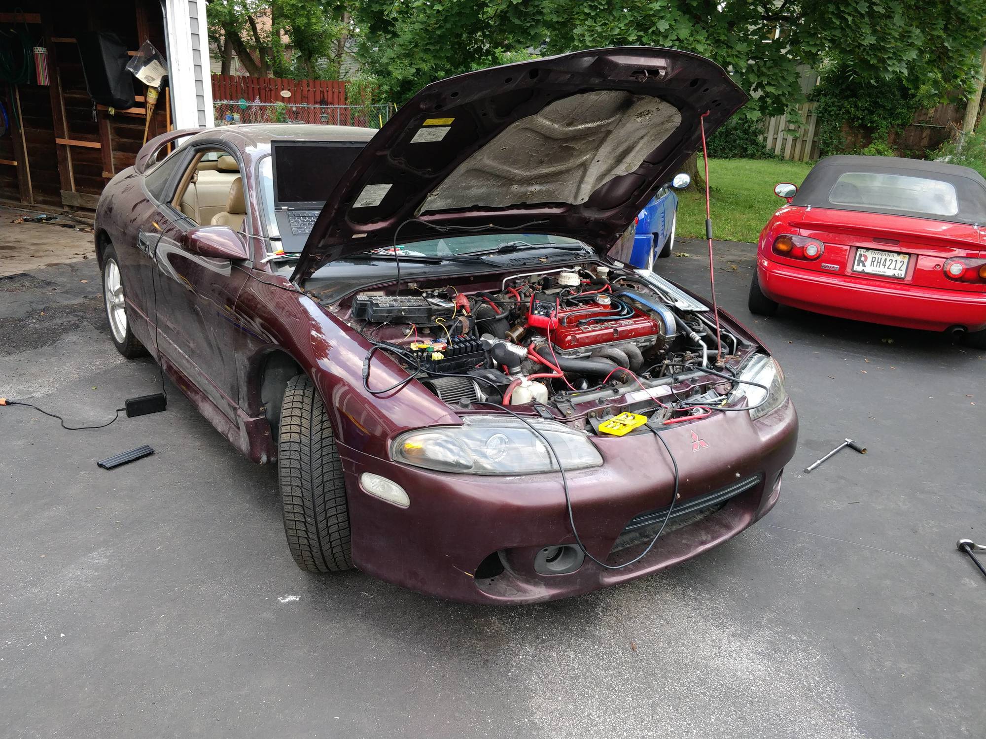

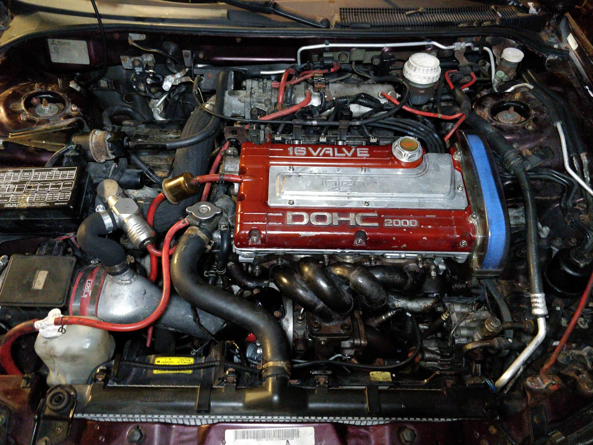

External to the block, the 16G is going back on. The car came with a tubular steel equal length header which will be reused and an OE cast manifold which will be stored. It also came with the lowest quality turbo-back exhaust that I have ever seen (Megan Racing) which will be reused until I have time to assess what I want to do with the exhaust. Inserting a high flow cat into the existing downpipe is the current priority.
Brakes are the stock dual piston calipers and the world's worst drilled and slotted aftermarket eBay rotors and pads. They work, so they will be staying until I get some free cash to replace them with some quality non-drilled rotors and grippy pads.
Suspension seems to be stock to me. Not original, but not upgraded either. It desperately needs stiffer springs. I am contemplating coilovers but haven't done any research into the matter yet. The only aftermarket suspension on any of my previous DSMs came on the Talon when I bought it. I have no idea what it was, but it was definitely comprised of lowering springs and some kind of non-adjustable aftermarket struts. It was very soft. They were definitely installed for aesthetic purposes. Since the existing suspension is in good shape, upgrades are a low priority.
The car came with the OE 17" GSX wheels. One wheel is bent at the lip enough to slowly leak air, but not enough to prevent balancing. They are wearing some new winter tires and will remain my winter set. I will need to purchase a set of lighter and more robust wheels for summer duty to support some yet-undecided Extreme Performance Summer rubber. Everything else in my garage is running ZII Star Specs, so the GSX may end up on ZIIIs. I will revisit this need once the car is running.
The car is currently running the factory sidemount intercooler and original cloth charge pipes with a (possibly knockoff) TurboXS recirculated BOV. All of this will be replaced with an ETS 7" street intercooler, proper aluminum charge pipes, and a yet-undecided BOV. Given that this is a street car that will not see competitive use for the remainder of the year, I don't feel uncomfortable about leaving the useless intercooler on the car for now. I don't yet have a boost controller picked out either, so I won't be pushing it hard for quite a while.
So with all of this, you may be wondering what I intend to use the car for. That hasn't completely been decided, to be honest. The original plan for the car was just for transportation when driving the Autozam or Miata is impractical. Snow and times when I need a hatchback are pretty much the two use cases that I have planned for. The Autozam and Miata both fulfill DD and autocross duties, so if the Eclipse does see competition it will be a one-off thing just to do something different. I have no plans in the works to upgrade to something larger than the EIII 16G nor to make the jump to E85, but I wouldn't rule out that possibility in the future. I am well aware that forged internals are way overkill for what the 16G can put out. If the pistons didn't need to be replaced I would have kept the stock bottom end, but I am seizing the opportunity to bump up the compression ratio.
In addition to this build, there is a small list of maintenance items to be addressed. The steering rack leaks. The cracked windshield needs to be replaced. The cheap aftermarket headlights need to be upgraded back to stock. One tail light is cracked. The driver seat needs to be upgraded to a manual seat. The fiberboard trunk floor became waterlogged and ripped into several pieces in the past. The rear wiper was deleted. I have the parts to fix all of the above issues except for the trunk floor, the windshield, and the steering rack.

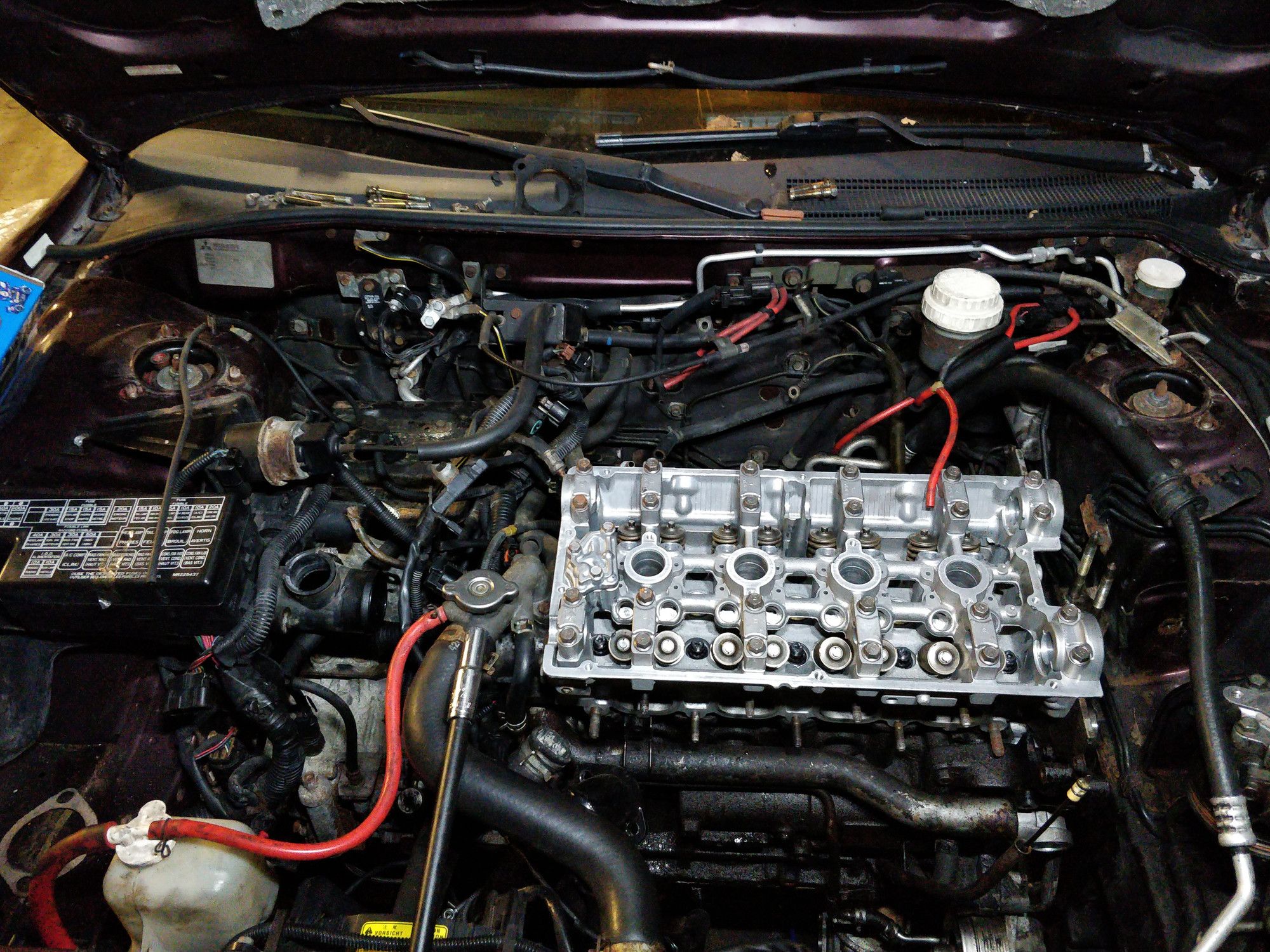

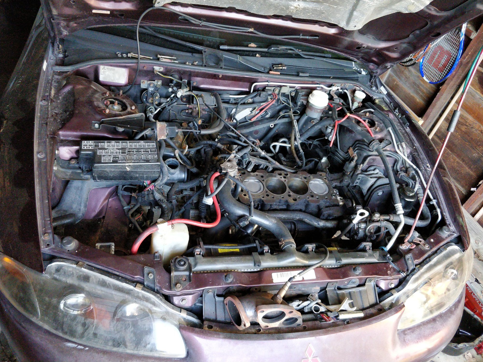

Both balance shafts are out and the new bearings are in. Now I get to deal with my favorite part of this job, paper gaskets! The front cover is clean and I'm working on the oil filter housing now. This gasket is putting up much more of a fight. I removed the fuel injector resistor pack while I was in there today. I have amassed quite the pile of removed parts and I'm excited to weigh it all to see how much I have removed.
I've imposed an arbitrary deadline for this car. I will have it running by Friday night so that I can drive it to Ohio Saturday morning. I have done a whole piston ring job in three days, so I know that it can be done. Once these gaskets are done progress should be swift.
Let me know how you manage to get that front case gasket off. I've been fighting with mine for about 4 hours total now, thing is practically fossilized to the aluminum. :banghead:

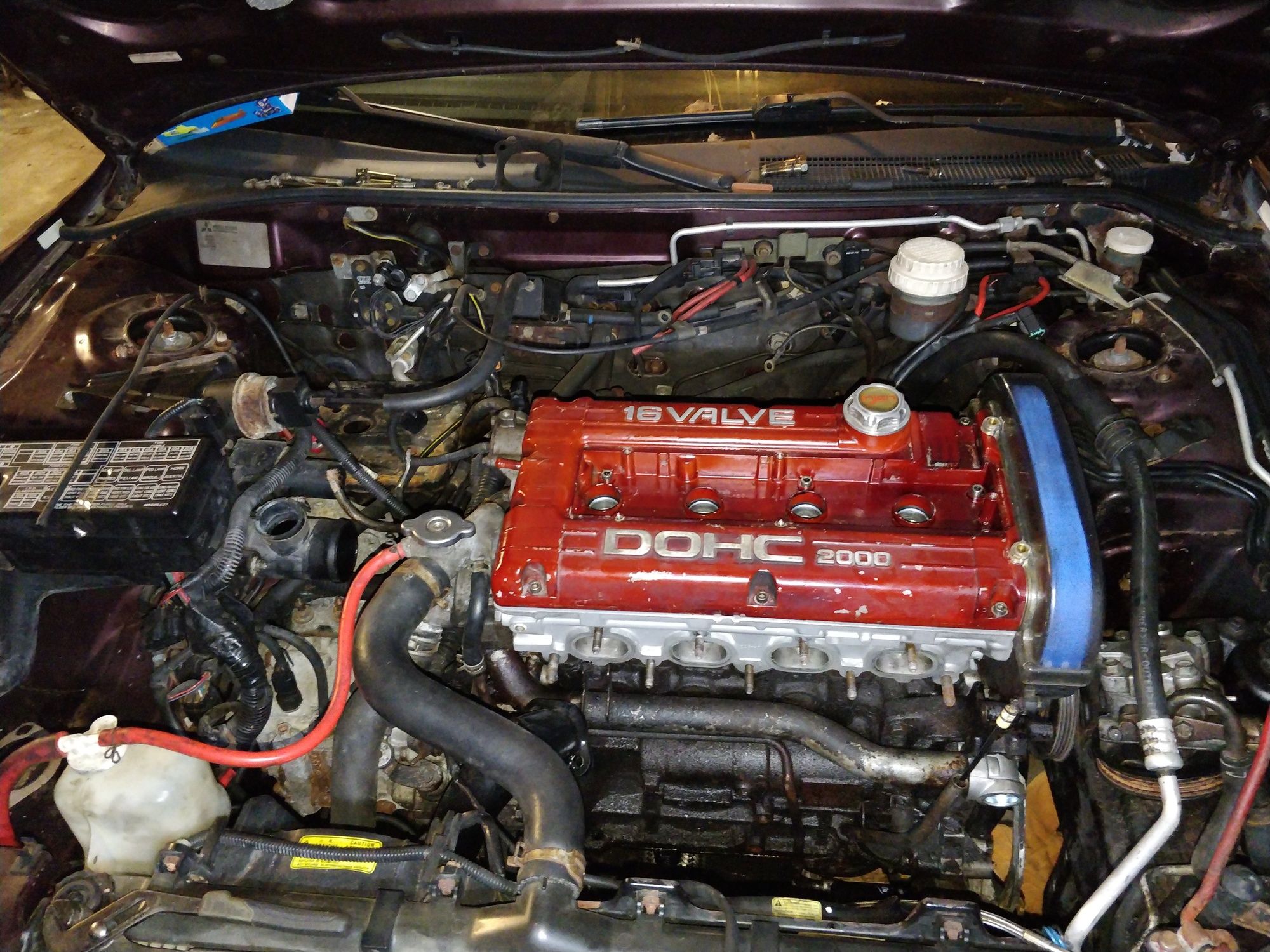

The head is installed and torqued!
For the parts that didn't break off in one piece, I'd soak it in WD-40 just to soften up the outer layer and keep scraping. Eventually you get down to a really thin layer of paper and the WD-40 will make the gasket swell. The you take your razor blade and hold it almost vertical and scrape that last little bit off one millimeter at a time. Holding the blade vertically greatly reduces your chance of scratching the soft aluminum and also makes the gasket easier to grab because the blade can't bend out out of the way and jump over the gasket. I spent about six hours on the front case and the same amount of time on the oil filter housing. I found the housing to be MUCH more difficult. If I had time I would have soaked the parts for a day or so.

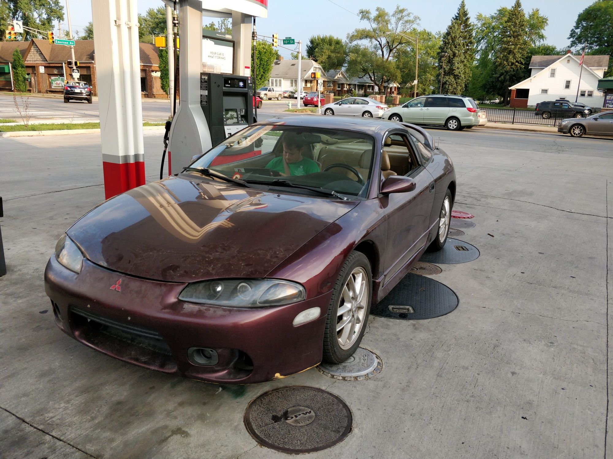

I will tell this story in a series of pictures.
Leaving the garage for the first time in 7 months. Having tuning issues.
This is the first tank of gas that I have ever put in this car.
It made it 44 miles toward Cincinnati before the alternator died. Fitting license plate.
I finally got to Cincinnati for my sister's birthday and an FC Cincinnati match!
