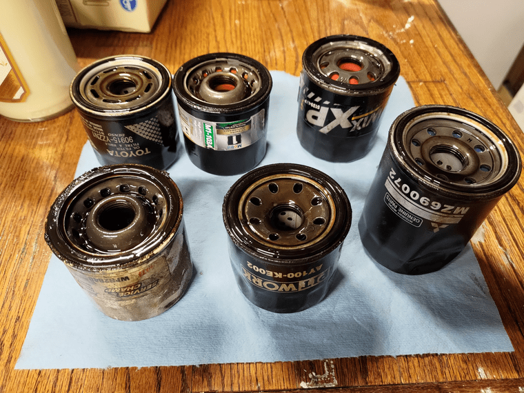

Then I realized that I've been a bit delinquent on my oil changes. And, uh, it was bad. Like really bad.
It took me 3.5 hours to do all 6 oil changes, and the DSM put up by far the biggest fight. I couldn't get my filter socket onto the filter because the downpipe was in the way. The strap wrench couldn't get a grip. I ended up having to drop the exhaust to get to the filter, and then it was stuck on there so tightly that it broke my filter socket. It bent all of the faces outward so that the socket could spin freely over the end of the filter. I did manage to get it off eventually, but the Eclipse was the second car I did, so it made things much less pleasant for the other four cars. Now I have a billet socket on the way...
- Van: 13,950, 2 years 4 months
- AZ-1: 5,050, 1 year 7 months
- MR-2: >6,500, >1 year 3 months (not since I bought it)
- Eclipse: 6,100, 2 years 7 months
- Jimny: 4,600, 1 year 10 months (not since I bought it)
- Cappuccino: >1000, >5 months (not since I bought it)
