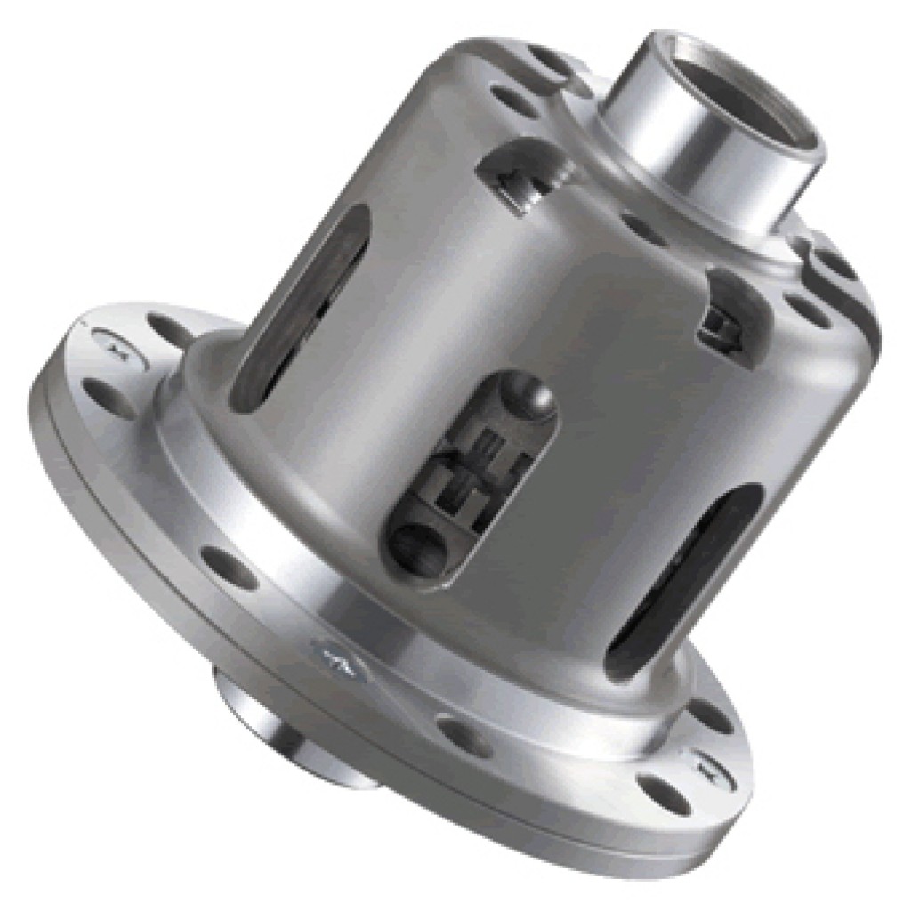

Hey all,
It's summer 2023, thus another season of struggles when it comes to parts.
Today's topic, rear diffs for a 2g.What are our options nowadays?
I currently have an LSD pumpkin and axles set, and a non-lsd pumpkin and axles set.
I'm not particularly stoked about installing my LSD unit even though it's an *increase* in performance but the options seem to be running quite thin.
Kaaz and cusco are no longer produced.
And any evo8 diff will also require evo8 cups for the axles as the stock 2g non-lsd axles are too short.
Thay being said, evo8 diffs aren't easy to find, but I'm guessing the general idea here is that you can purchase an aftermarket evo8 and slap that in a 2g non-lsd pumpkin... granted u got the rear cups for it. Can anybody confirm?
3gkt isn't a straight built on either, if memory serves... and are rare as well.
And while the Ford 8.8 (?) is a sexy option with the new rear subframe from boostin(?), it's not wallet friendly by a long shot.
Evo8 being the MR166619 (evo2 to evoX)
Does that sum up 2g rear diffs in 2023? I spent hours the past few days searching this topic, and that's my summary.
Any inputs appreciated. Thanks

I know this has been debated a lot but 2GB non lsd axles can work with the Evo plate diff. TRE told me that 2ga have the shorter axles and 2gb are long enough. I haven't personally verified differences between 2ga and 2gb but I can tell you that the Evo 3 rear cups I have are the same as the rear cups in my 98 tsi non lsd. So again no guarantees but there's options. Evo axles also aren't that hard to source
THANK YOU for clearing that up. I was tearing my hair up trying to decipher everyone's claims with all the forums posts throughout the decade. So 2GB rear non lsd axles COULD work? An OS Super Lock would be a direct drop in for a 2g non lsd WITH 2gb non-lsd axless??? Anyone can confirm??
Personally for a 400whp car you don't need anything more than a stock viscous rear diff, unless maybe if you are doing road racing or AutoX.
OS Giken takes a while to get from Japan, and that is they are interested in making one for you. What I did for the last customer that needed one and didn't want to wait 4 months to get a diff, we went with a Cusco LSD rear differential, and they made it to order and shipped it out in less than 3 weeks. I can still get these.
If you go the route of the stock Evo clutch type LSD diff, I would just flip the plates, and then use a TRE Ninja billet side cover on it with longer fastening machine screws to attach the cover to the diff. This would utilize 1x MD710663 bearing on the cover, and 1x MN168441 bearing on the housing. Debur the housing grooves where the clutch plates rest as they like to get beaten up over time and galled. A bit of cleanup with a die grinder and sanding drum will make everything smooth to move around.
The Cusco and OS Giken work with the non-LSD inner cups, or with the Evo inner cups, or DSS Stage 5 axles with Evo inner cups. As for the 2g DSM rear axles, I have never seen a difference between 2ga and 2gb inner non-LSD axle cups. They are the same part number.
You would use 2x MN168441 bearings to do the install then. If you need the shim kit for adjusting backlash, it is MB241903.

You can message Jon @ TRE directly about the ninja side cover, or I can get it myself. The part is considerably thicker and stronger than the stock Evo clutch type side cover that is prone to elongating the bearing bore causing failure. He still makes them, and I have one received here currently for another customer that needed one. They also are clearanced to fit the Frontline Fabrication billet rear diff cover without modification. The cover uses longer machine screws to attach the diff housing to the cover. The factory screws are M5 x 10mm, and if I recall, I used 18mm or 20mm long ones during assembly.
As for Evo cups vs 2G DSM non-LSD cups, yes there is a difference in length of the splined portion. I have personally used Evo inner cups for my DSS axles with the Evo clutch type diff, as well as 2G non-LSD inner cups, and I had issues using the 2G non-LSD cups in my application with them not being long enough and not locking in. I have none here anymore to measure against to give you concrete measurements.
With the Cusco, I have not had issues using either axle cup from experience. I have sold, and installed KAAZ, Cusco and OS Giken rear diffs in the past, but I am unable to give you measurements as again, I no longer have these components here to measure against with an Evo axle up and a 2G axle cup.

This definitely clears up the confusion regarding the axle cups.
Simple recap for those looking for the same information.
When rebuilding a 2g non-lsd rear diff with an evo LSD, 2g non-lsd cups won't work
However, when opting for aftermarket evo LSDs ( Gikens, kaaz, Cusco), the 2g non-lsd cups WILL work.

I messaged my last Cusco diff customer, and he responded that he is using DSS stage 5 axles with evo inner axle cups.
The big thing is that the axle circlip fully pushes past the pinion gears and locks into place.
Personally I would recommend evo inner axle cups or DSS axles made with the Evo style 300m stub inner cups.

Appreciate the efforts. I'll put the rear LSD project aside for now. Perhaps next year I'll splurge on the DSS axle/evo cup combo with the Cusco LSD - total piece of mind. I just cant commit to all of that atm. I under estimated the project thinking I could Frankenstein a cost effective solution but the Evo cups are proving futile atm.
