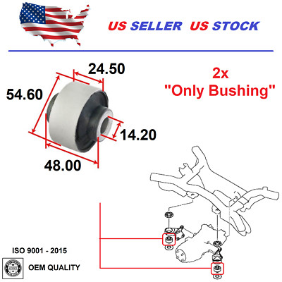

I found an experimental option for anyone interested in an OEM equivalent alternative .
They are from the Mitsubishi lancer / outlander / Jeep patriot / compass all for the same years (2009-2017).
They are not exact.
They are not a 100% solution
They are what I call a 90% solution
They require cutting and shims to work
Shim stock is 0.2mm-0.4mm depending on your application.
I am aware that this is not what many would consider an appropriate solution.
I respect that, I had blown bushings and for me this was an acceptable solution. And I will gladly update with time.
These are intended as an option, I’m confident the community will improve on this project and make it more successful.
The Quick How to
The back two bushings are cut like this
Please ignore the bolt direction
And the 3rd mount is cut like this
And you add your needed shims
That’s it.
this is the reference for my claim.
Hope it helps.
* this is experimental and currently in testing *
