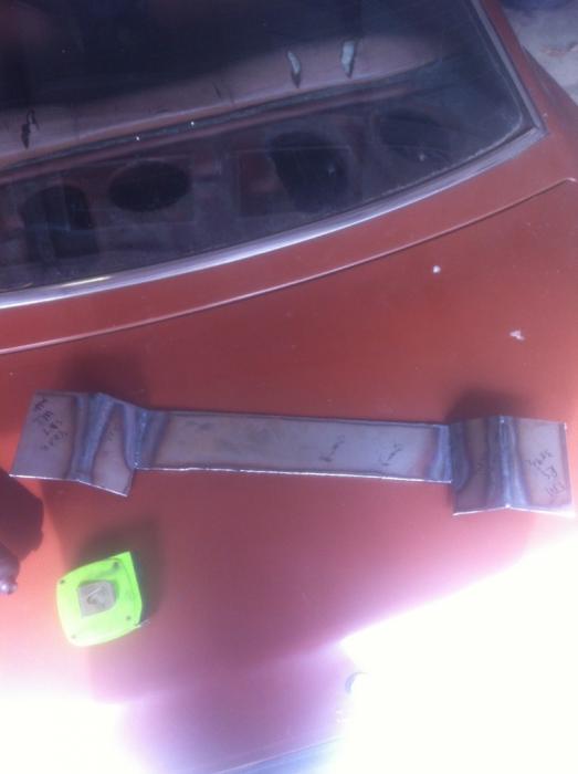

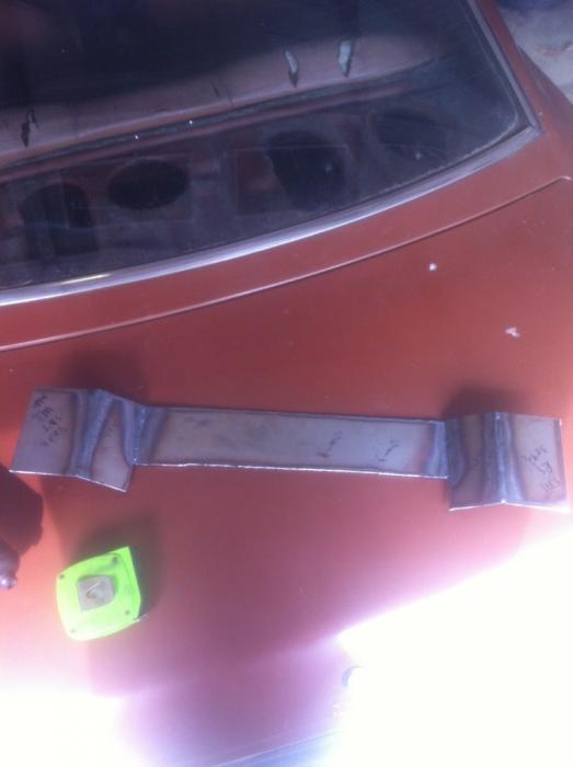

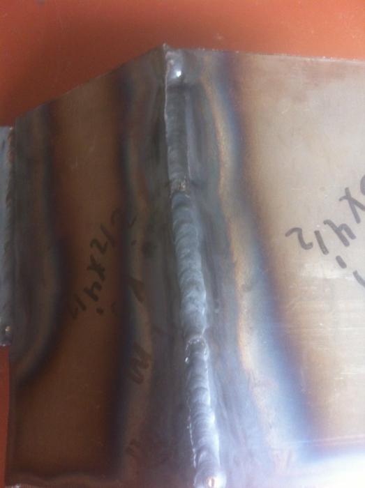

I just finished cutting the metal for the trans mounts. I hope to tig them when I get a chance. If not I'll mig them at my house.

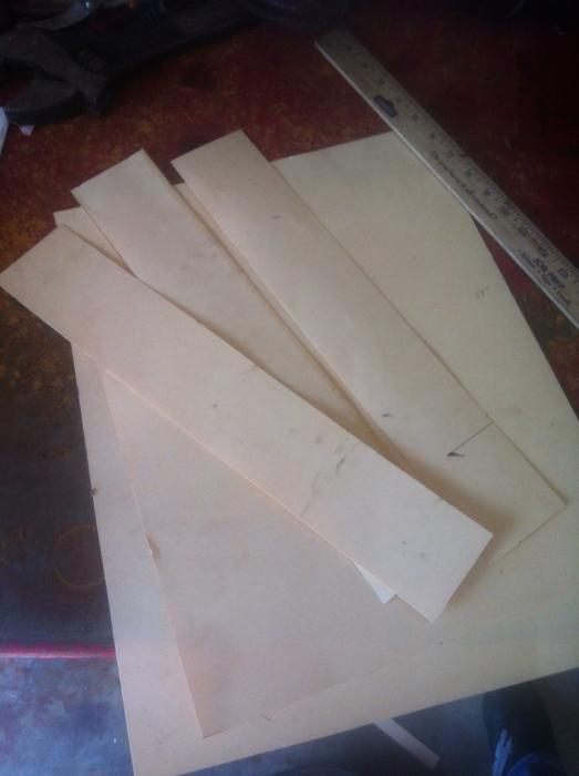

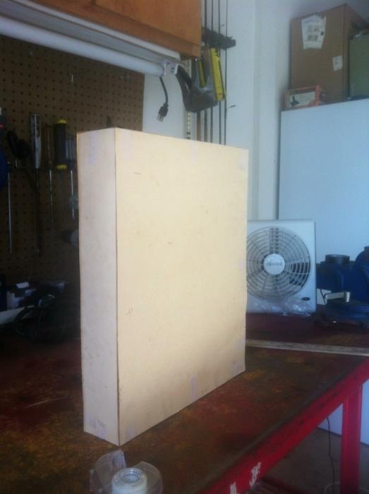

Make radiator template
Make pedal box template
Weld/install transmission mount

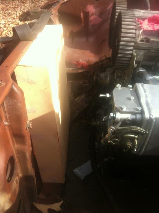

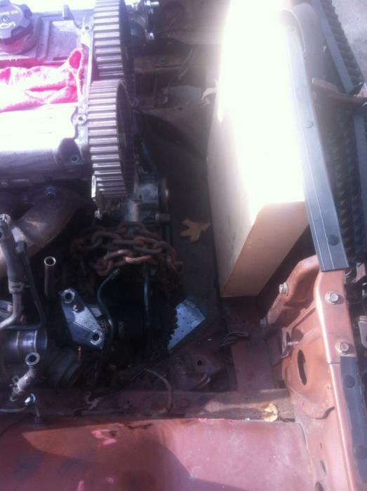

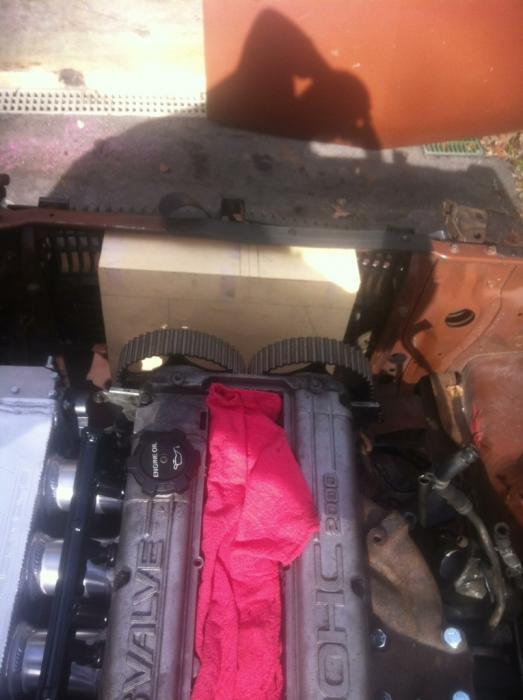

Made the radiator template to get an idea of what I want.

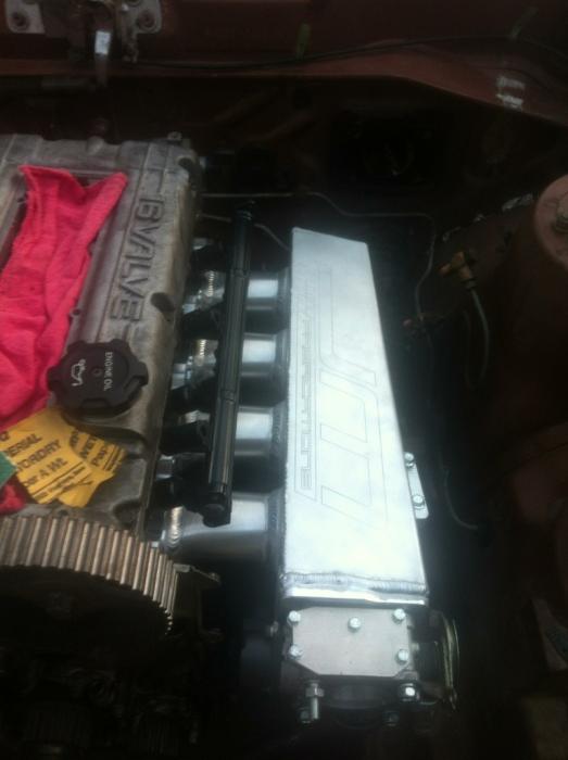

Set up the fuel rail. Didn't have long enough bolts for it though.

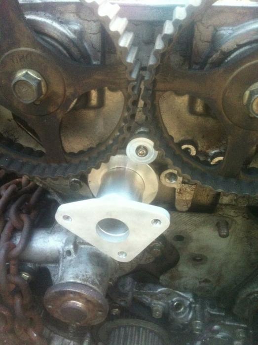

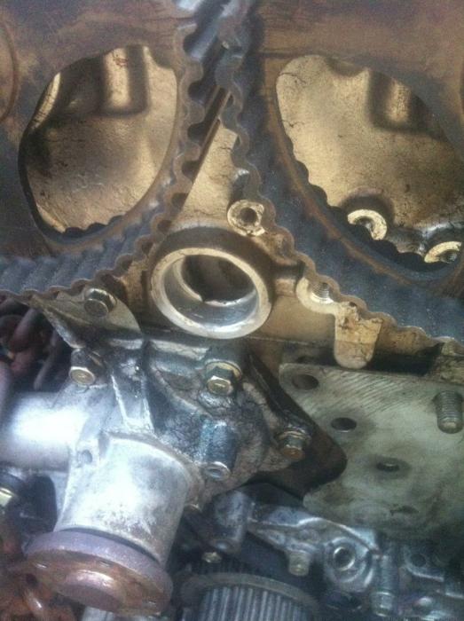

Finally got that friggin core plug removed. Only took an act of congress. Got a little chewed up but I cleaned it up and installed my thermostat relocate kit.

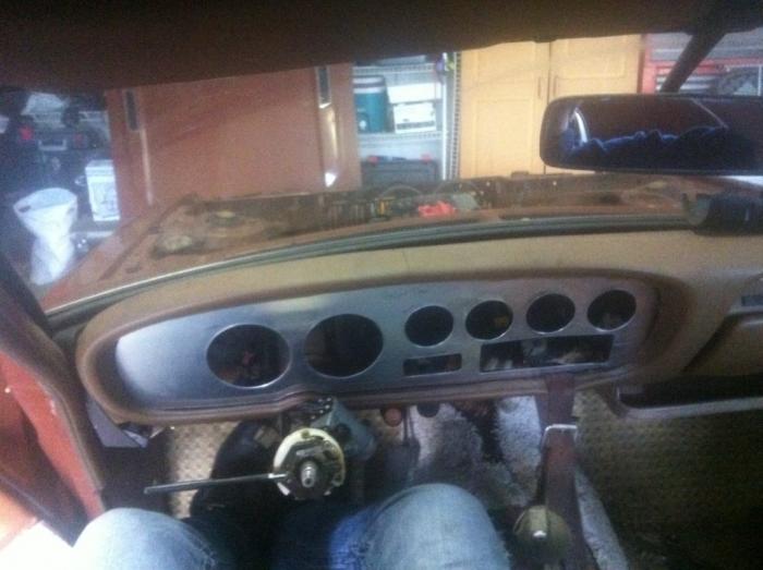

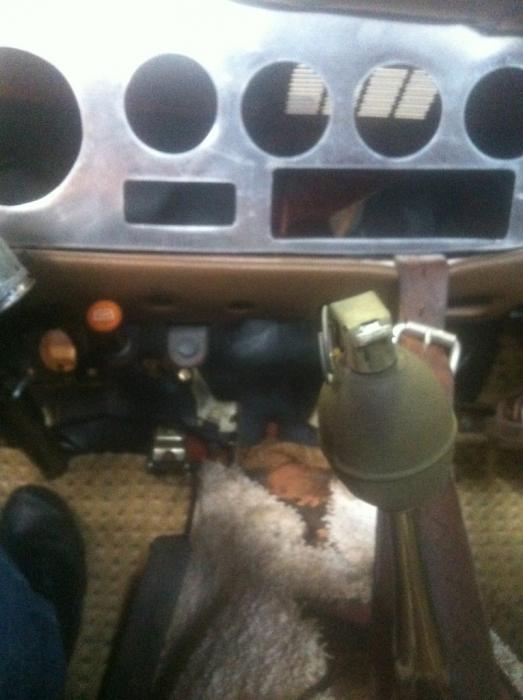

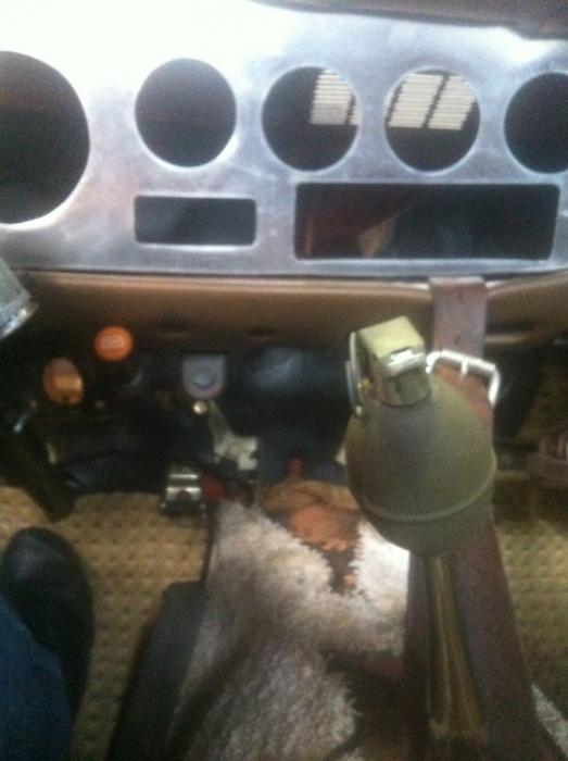

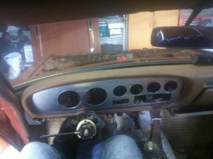

how did you make that plate? im looking to do something similar in my hot rod:hellyeah:
Are you speaking of the gauge panel?
I took some .040" aluminum, tin snips, knock out punches and a file.
Made a template and cut it out. Used the knock out punches in a manner as to not "roll" the metal, which is what they normally do. Tin snipped the other holes or excess material and filed it down.
they look like damn near perfect circles
The two large holes were cut out by hand. The smaller holes I used the knock out punches. Generally the punch will "roll" the metal back, the are mostly used specifically for gauges. It rolls the metal so the gauge fits in the hole better. But I wanted to do something different. So instead of tightening the knock out punch all the way, I only tightened it to the point of shearing the metal.
I did however take it through an English wheel to insure flatness.
