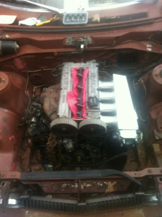

Finally got a little bit of money to blow on the car. I ordered a bunch of parts last night, timing kit, thermostat relocate, boost gauge (I ordered that so I can finish my gauge panel) and a turbo. Nothing fancy with any of this. I'm trying to get the car running. No point to spend thousands of dollars yet.
I need to finish up the motor mount bracing and then the trans mount and that will all be done.
I mainly just need engine essentials. Starter, alternator, injectors, clutch kit etc. I have an intercooler I can use for the time being. I'm shooting to drive the thing before I graduate, which is March 22nd. But, we'll see how things go.

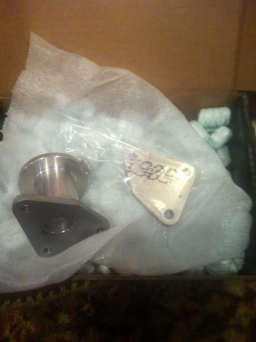

Thermostat relocate from Jay Racing. (Side note. Every time I order something I ask them to "ship with love". ECM tuning and jay racing are the only ones who have actually done this haha)

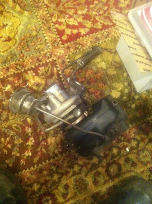

Baby little turbo haha. I only got this cause it was cheap and will allow me to drive the car.

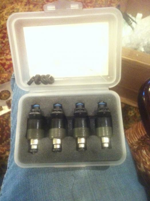

PTE 780's

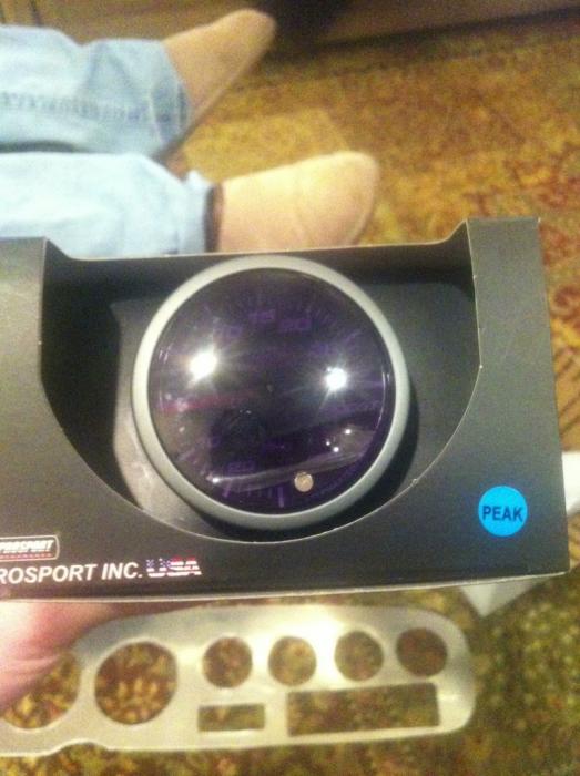

Prosport 60mm peak warning boost gauge.

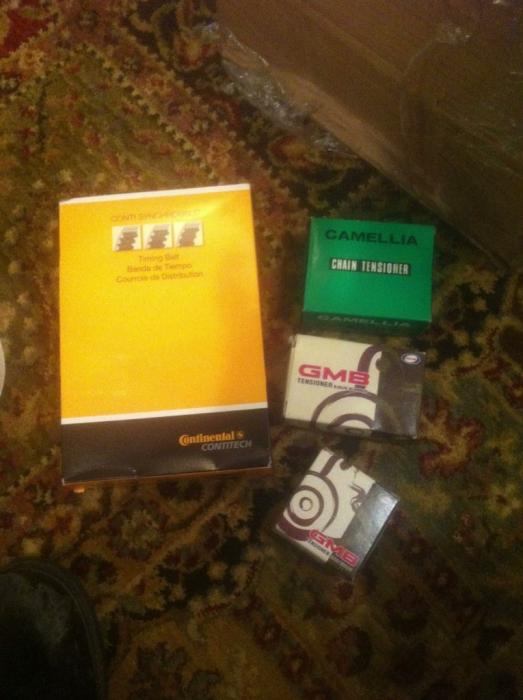

Timing kit

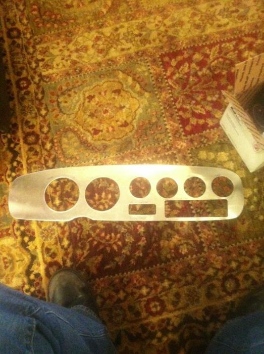

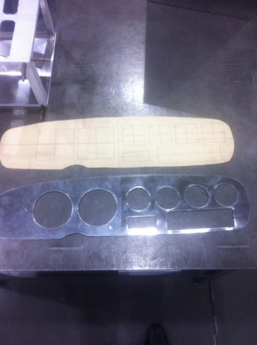

The gauge panel I made.

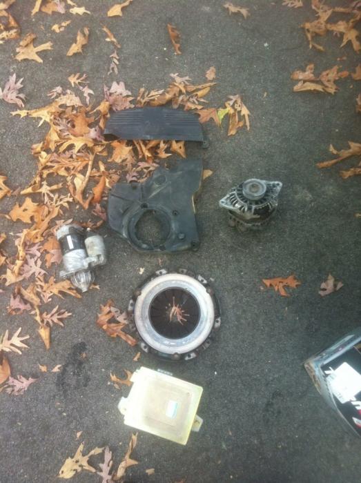

PP, alternator, eprom ECU, starter, and timing covers

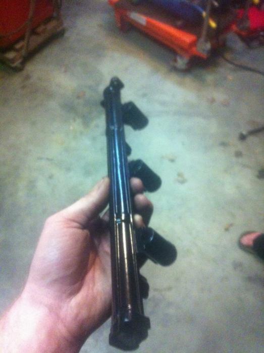

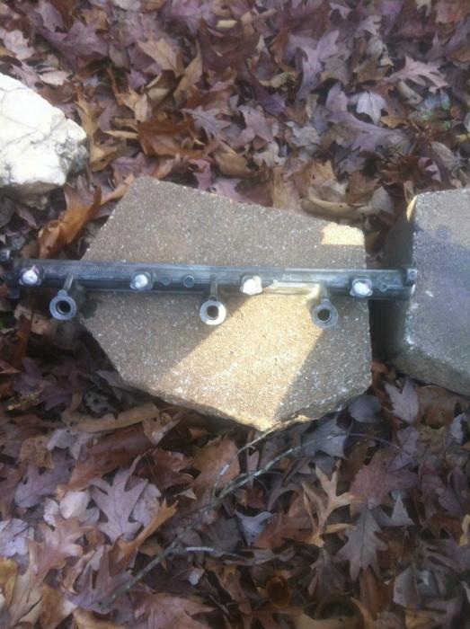

Decided to clean up my fuel rail

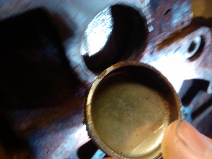

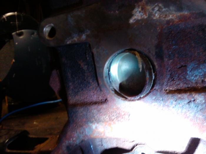

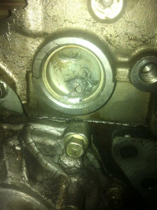

And the first problem I ran into. I have to remove the core plug from the head for the thermostat relocation. And this happened upon "removal"

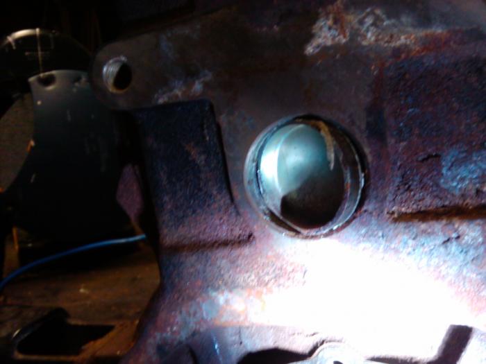

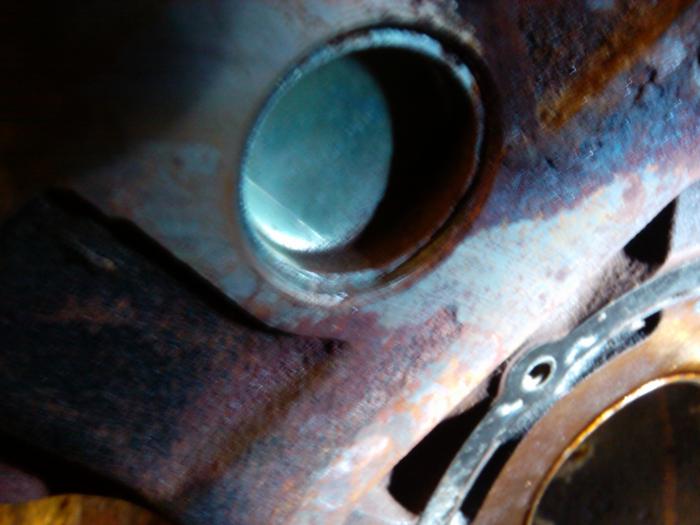

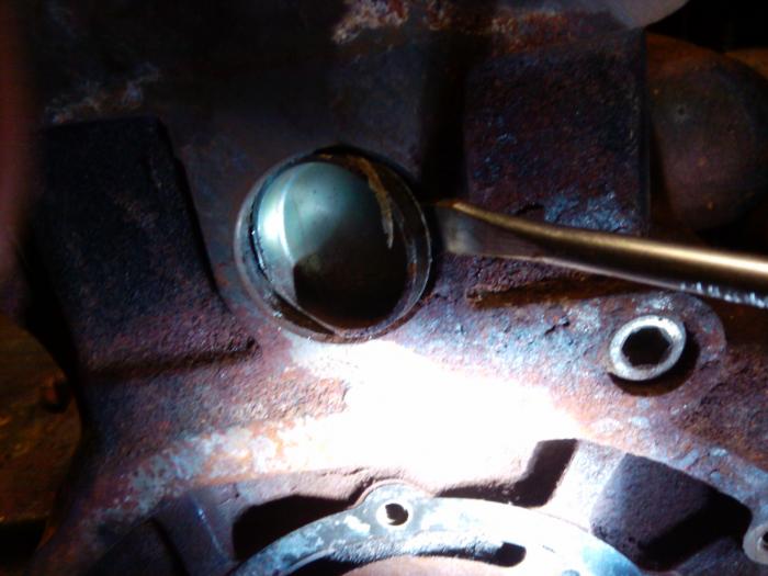

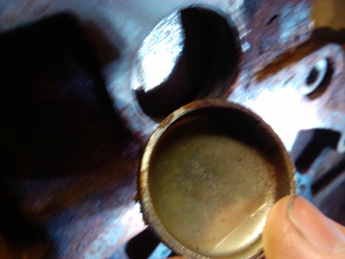

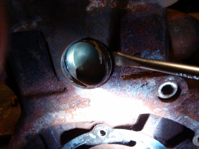

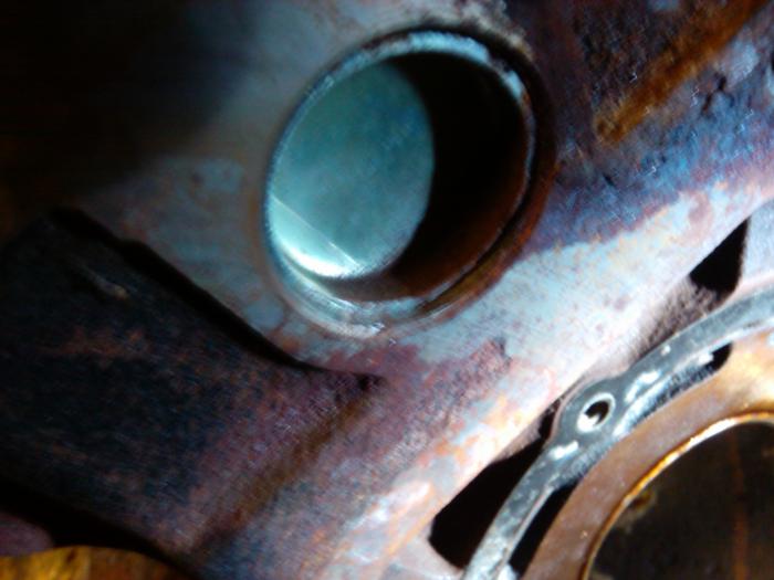

For that freeze plug you should NEVER hit it on the dome, always hit it on the edges. Some times it might take a little bit of force as I found out when I was cleaning out me EGR system on my supra.
I ran out and removed one so I could take pics of the process for you.
Took 2 decent hits before it finally bugged
Keep hitting it in roughly the same spot and when it starts to spin like so your golden.
just simply gently pry it out and don't be forceful
Hope this helps a little, also since aluminum and steal react chemically corrosion could be making it harder to get it out. Try using a small propane torch and heating the area around the plug, should help a lot. Tomorrow I'll go try and remove the same plug on one of my spare heads so I can see how much harder it is then removing a block one.

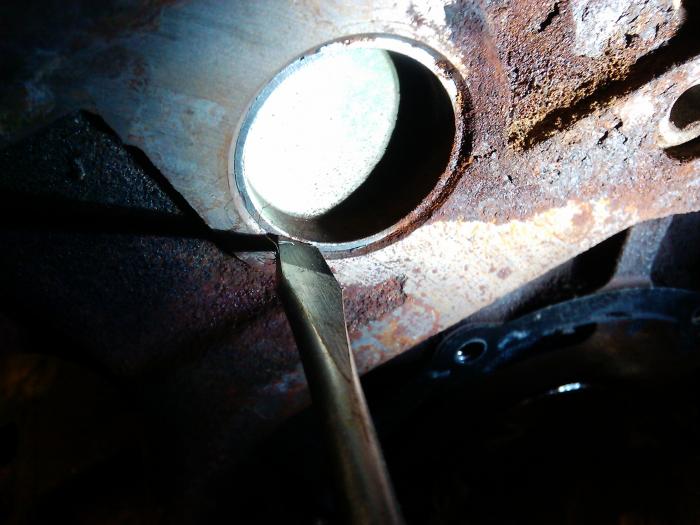

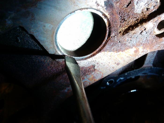

Thanks man. Yeah I had smacked it several times right on the edge. She didn't move at all. I would have used a torch right off the bat. But I don't have a torch LOL.
I'll eventually get it out. It isn't terribly necessary at the moment. Not until I'm ready to fill the thing up with coolant

Yeah this one is proving to be a pain. I'll eventually get it out. I may not be pretty, but whatever LOL.
