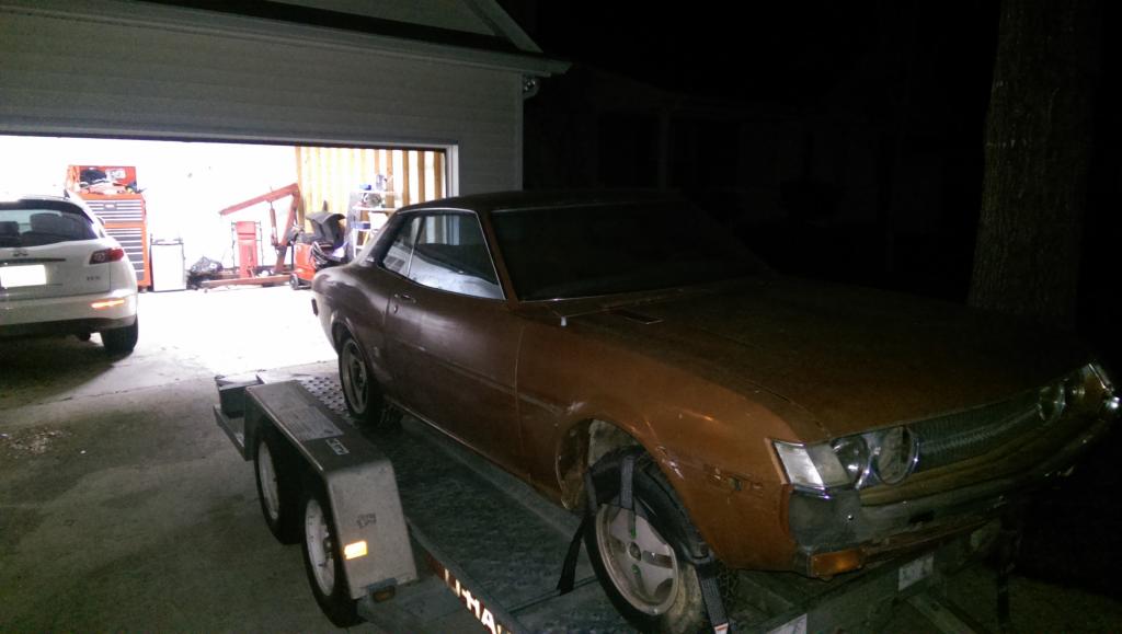

Long drive today, about 760 miles, about 11 hours round trip. So worth it.
Oh, and I got the car back with all that stuff, for $200 :D (besides the trailer and gas LOL)

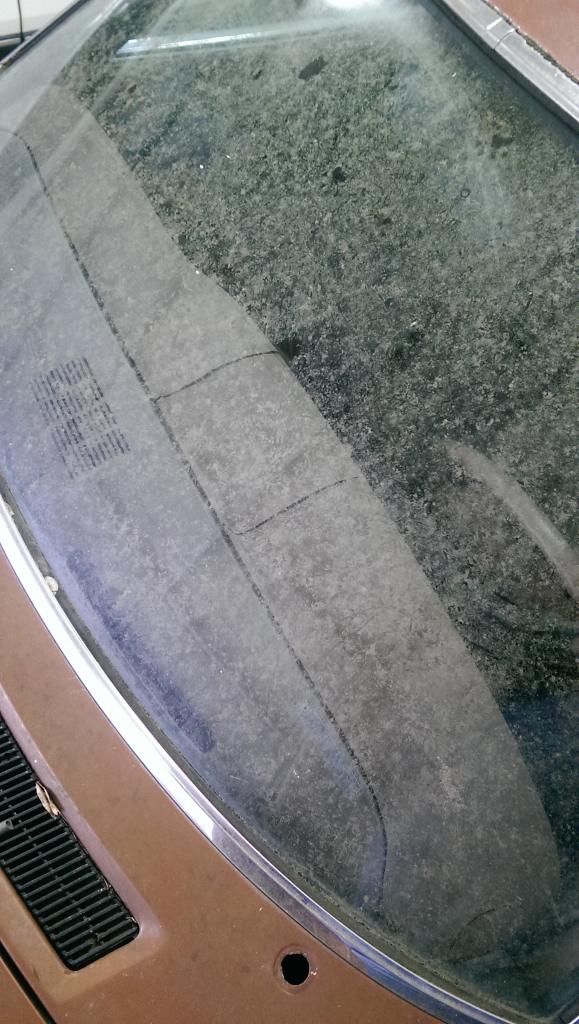

My crackless dash isn't so crackless anymore :(

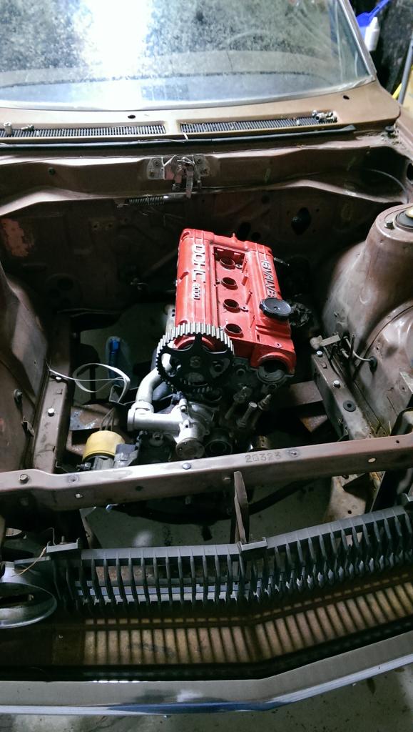

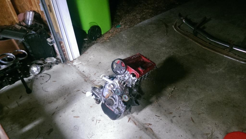

The (complete) 6bolt wasn't as complete as he lead on. I knew it didn't have the manifolds. But, it doesn't have the intake camshaft or gear, (initially i thought just the cam gear was gone as it wasn't bolted to the engine) then i noticed no valve cover bolts, so I pulled it off and saw the crap missing. Also it wasn't mounted at all, so after a large bump on the highway at 90 MPH, it shifted and fell a bit haha.
Also, an exhaust manifold bolt appears to have been stripped at one point, and they tried to re-drill it, and suck balls at drilling. So I am not sure how easily repairable that will be.

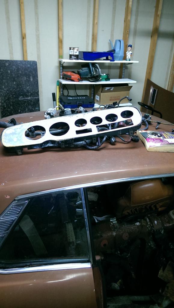

I am glad however that my gauge cluster was still there. I hand made it to what I wan't to use for gauges.

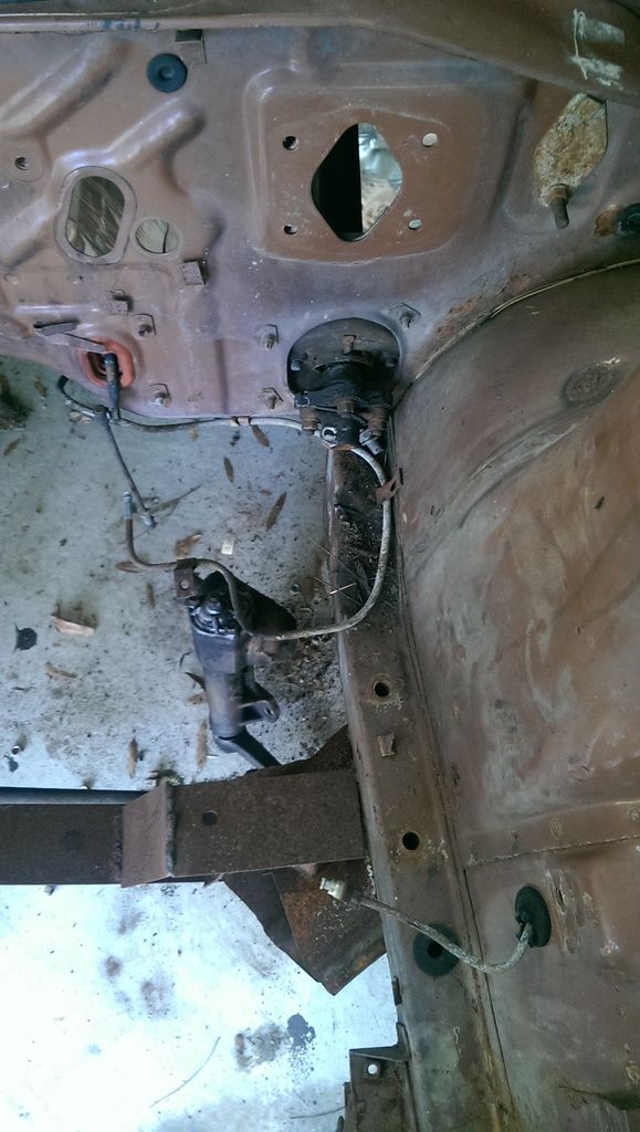

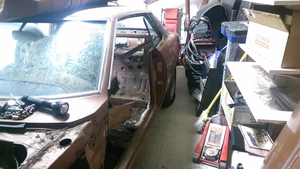

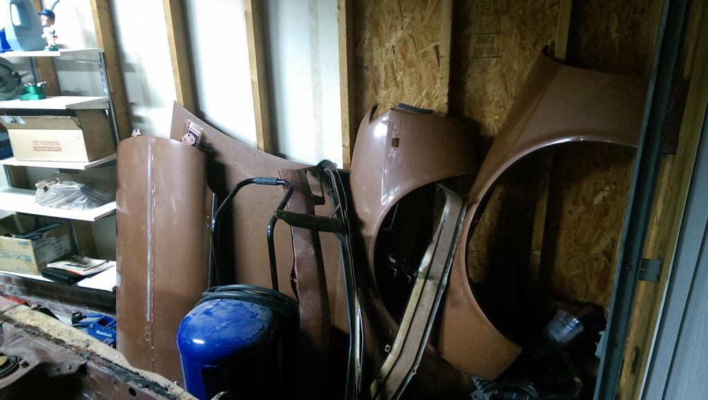

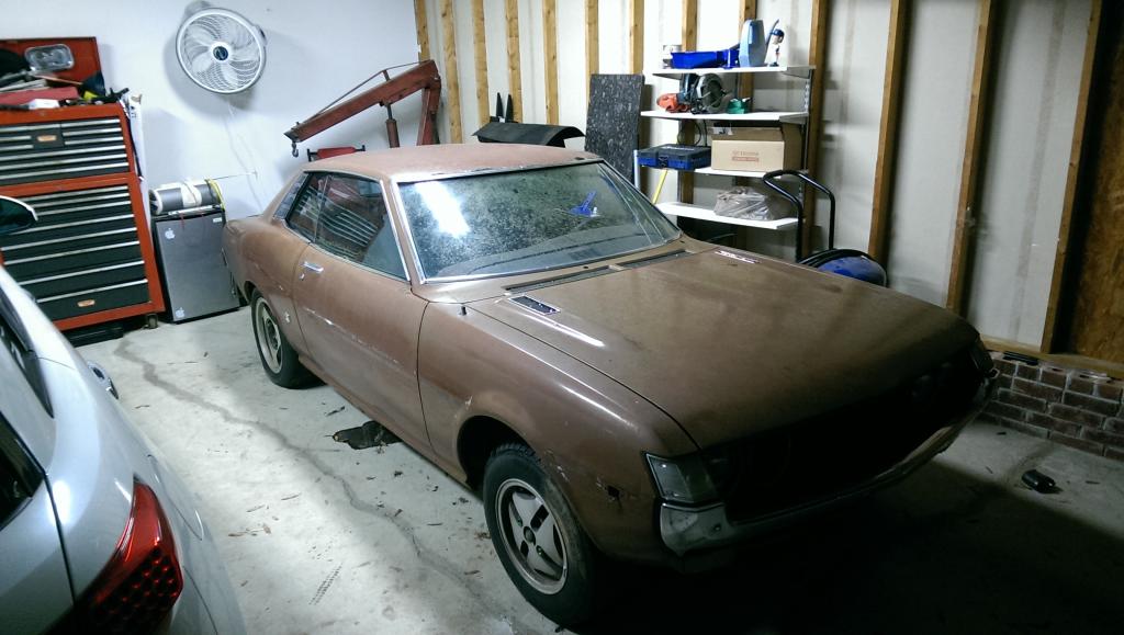

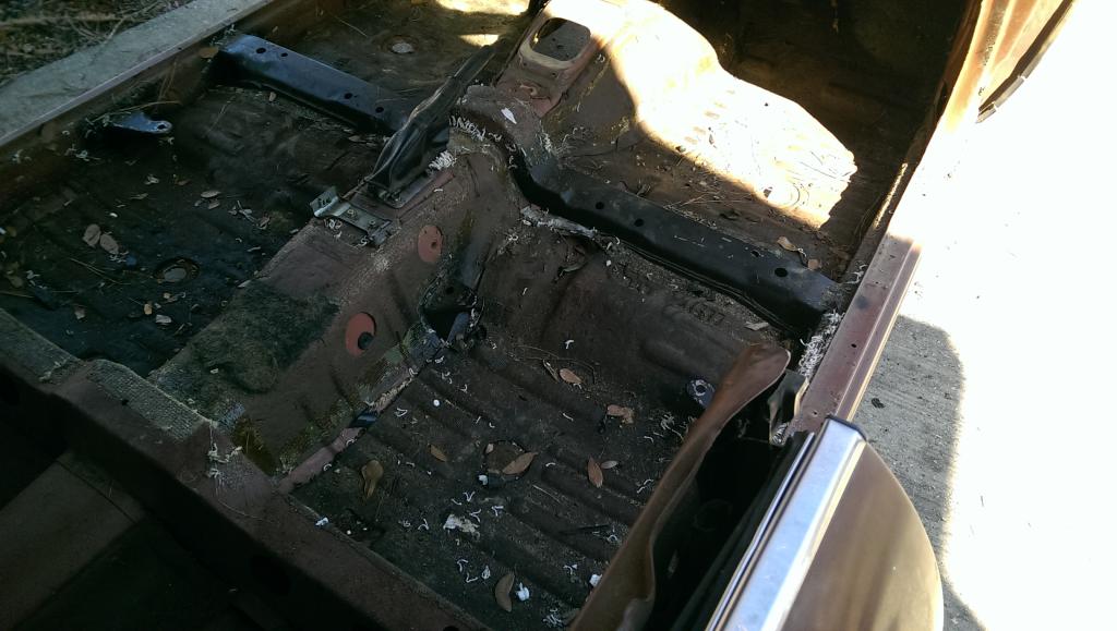

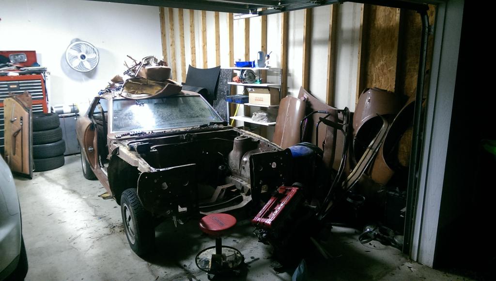

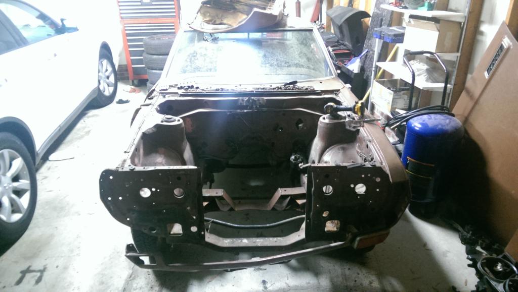

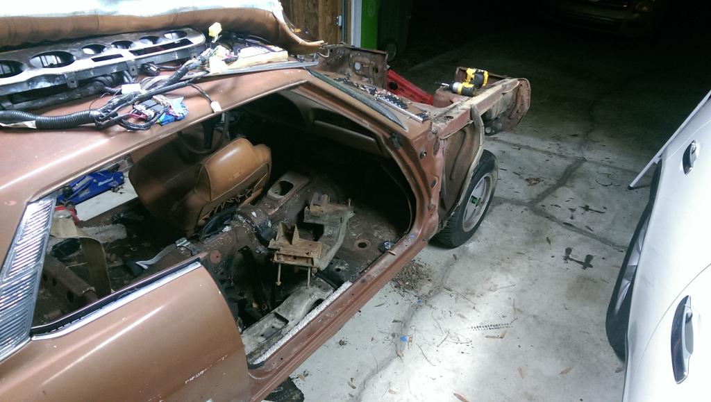

I have started tear down of the car. I am pulling all the body parts, fenders, grill, doors etc, and am going to pressure wash the car top to bottom and get it ready for primer and under body coating along with interior sound deadening and such.

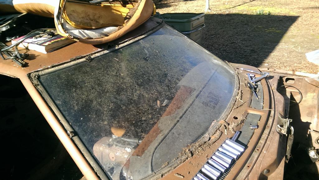

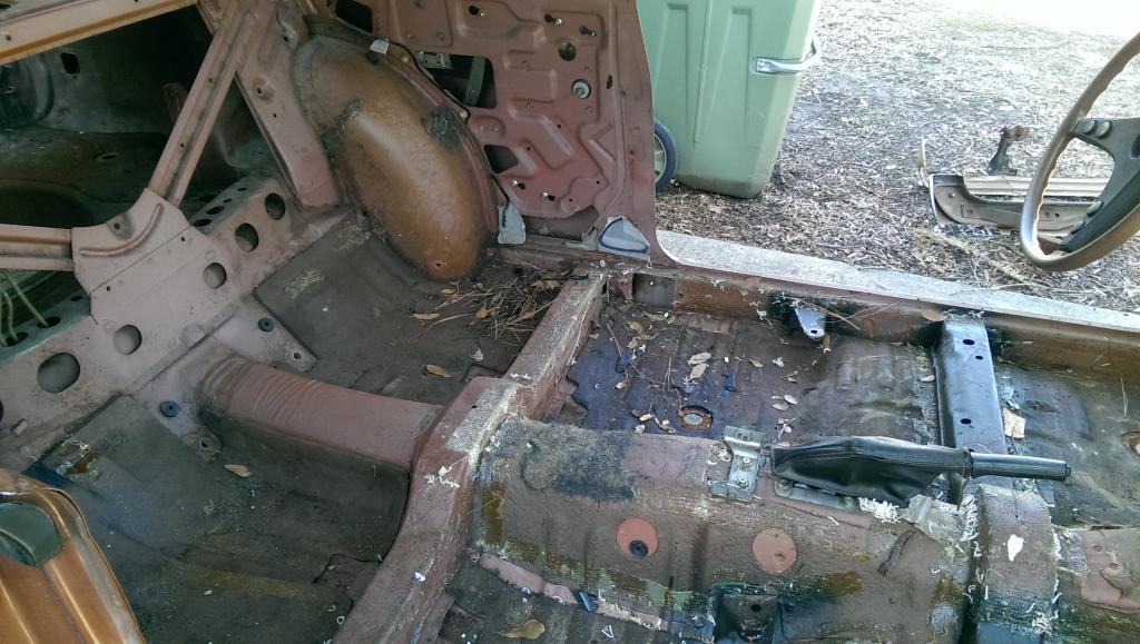

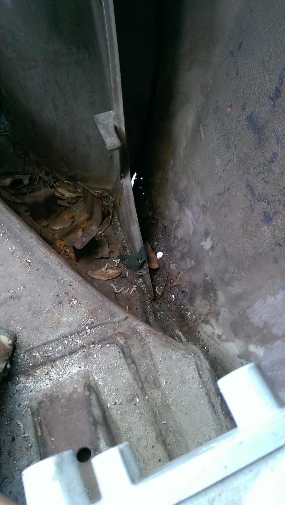

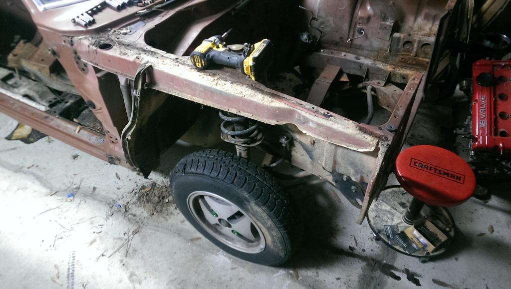

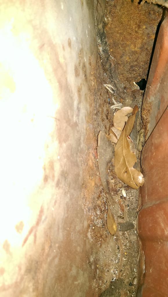

Last night I got the passenger fender off, which I had never done the first time around. Rust is very common to be hiding under there on these. I must be lucky because other than 41 year old sands, there was nothing!
I have also changed up my suspension plans. I will be using full front and rear 240sx S13 suspension. The rear will be modified to use pushrod coilovers. I am excited to get the swap started. After the body work and such, that is what is next. SO if anyone has a spare S13 laying around and wants to donate, let me know ;)

My goal is to get the car all torn apart by Saturday morning and then I'll pressure wash it and get it all cleaned up. I have an S13 front crossmember lined up, just trying to settle on a fair price.

WELLLLLL. Some more progress.

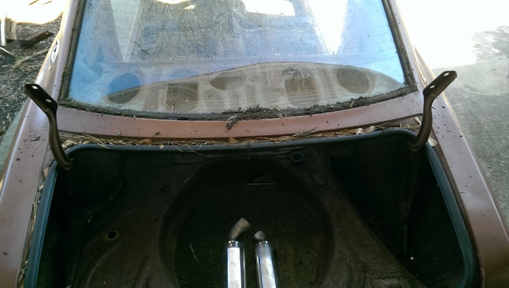

I removed all the chrome around the car, I am not a huge fan of it anyways.

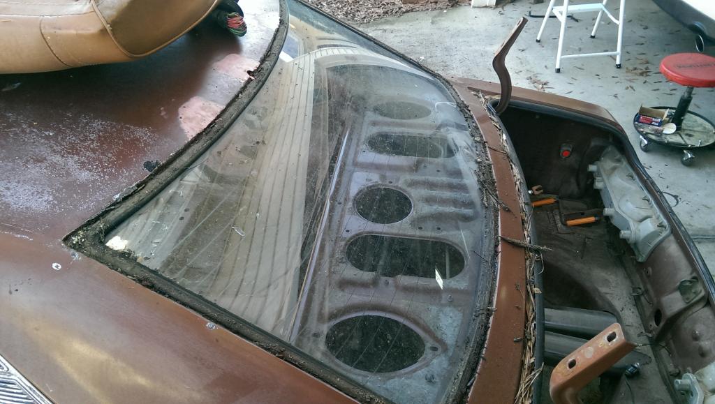

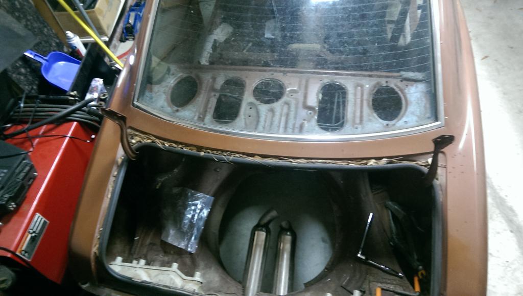

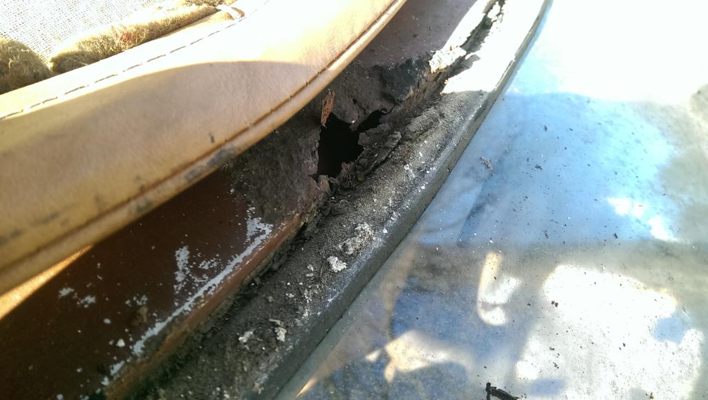

A little bit of rust needs some attention.
Some rusted out places in the lower rear fenders. Nothing too serious at least.
Dirty interior.

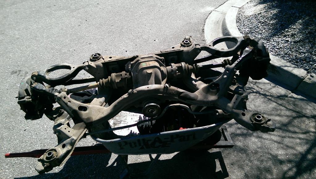

AND! As I was incapacitated on the john this morning, I got a text from pull-a-part that an S13 had shown up on the lot! So I jumped up, loaded up, and got there asap! (yes, I washed my hands). When I got there, there were already 2 other guys there pulling parts, one kid had to leave early since he got a massive chunk of flesh ripped from his wrist on the cut exhaust. Anyways. For $180 I scored this whole thing!

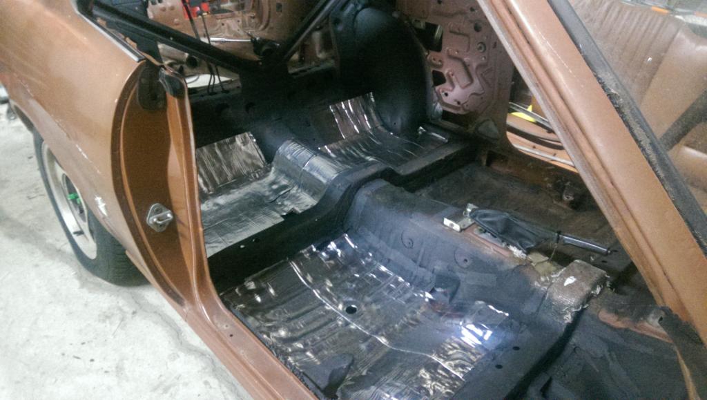

Staying busy! Shoutout to the wife for supporting the build LOL.

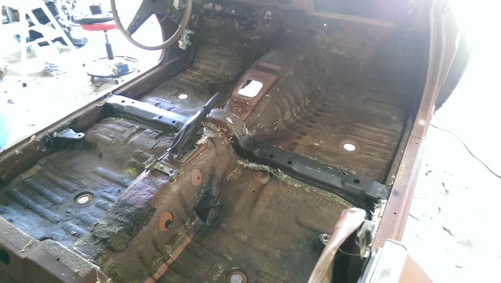

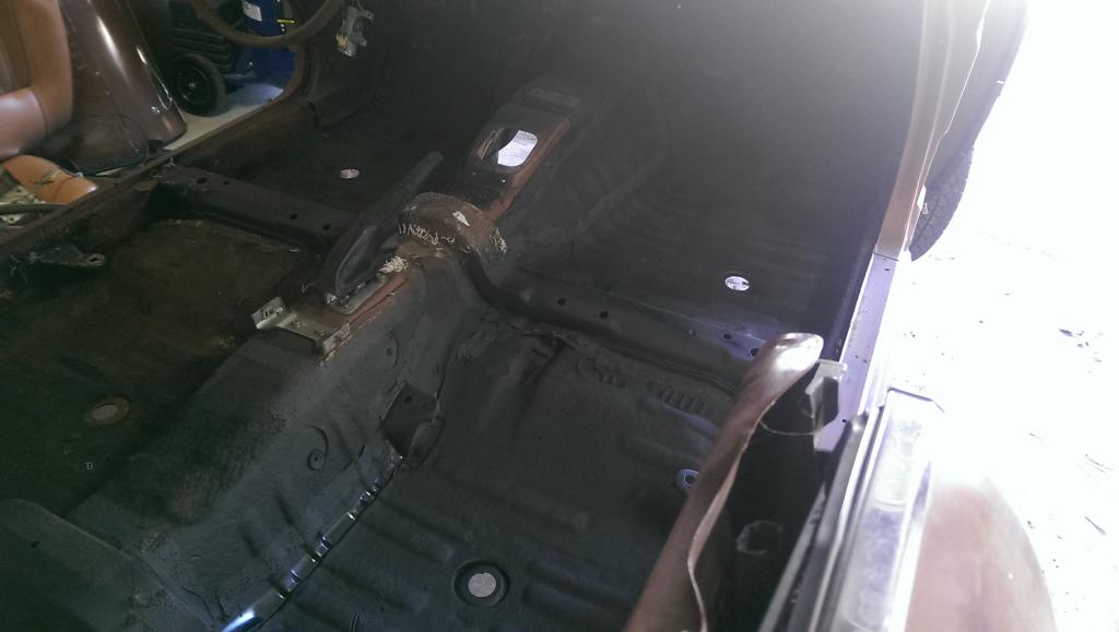

All cleaned up interior!

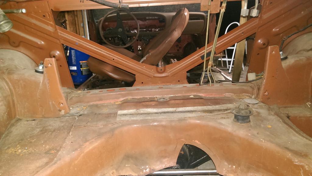

I got some rust prevention primer for the floors. I used a full can, just a spray can, and I will need one, maybe 2 more.
And it was 72• and sunny out, so I took a break to make us some awesome dinner!

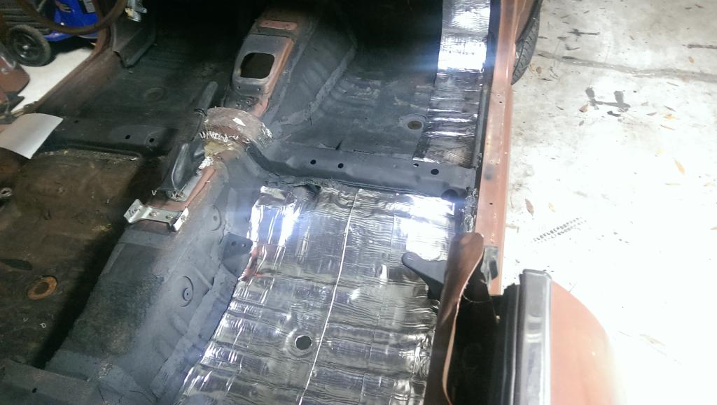

If anyone is doing some interior sound deadening. This is some of the best stuff. It works so so well. It isn't quite as thick as Dynamat. But it is stupid cheap. 6" wide by 25' long. Less than $17 per roll. This is how much coverage I got with 1 roll. I will probably need 2-3 more.

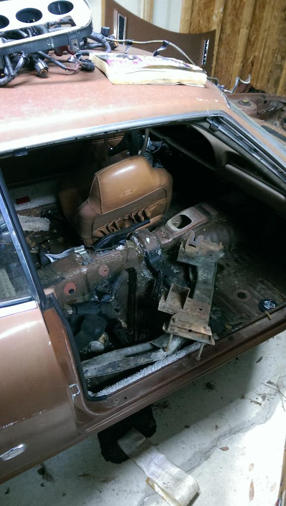

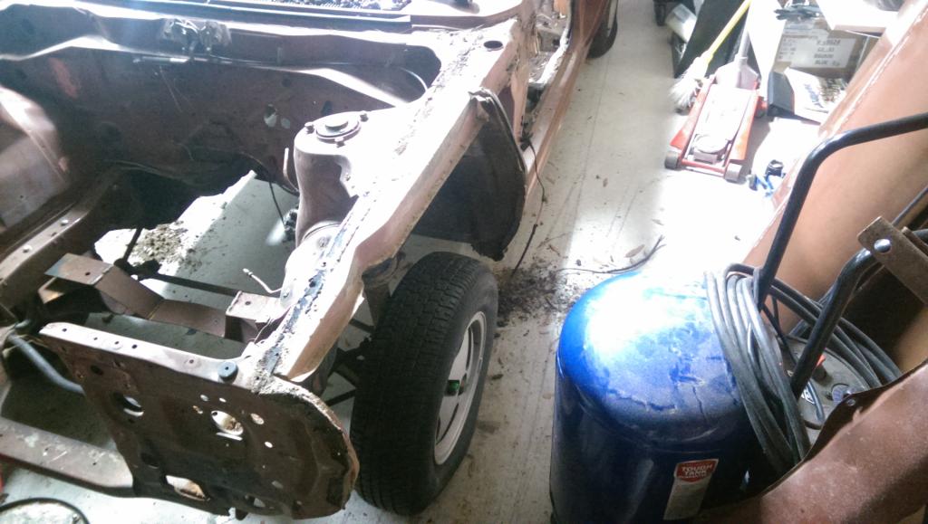

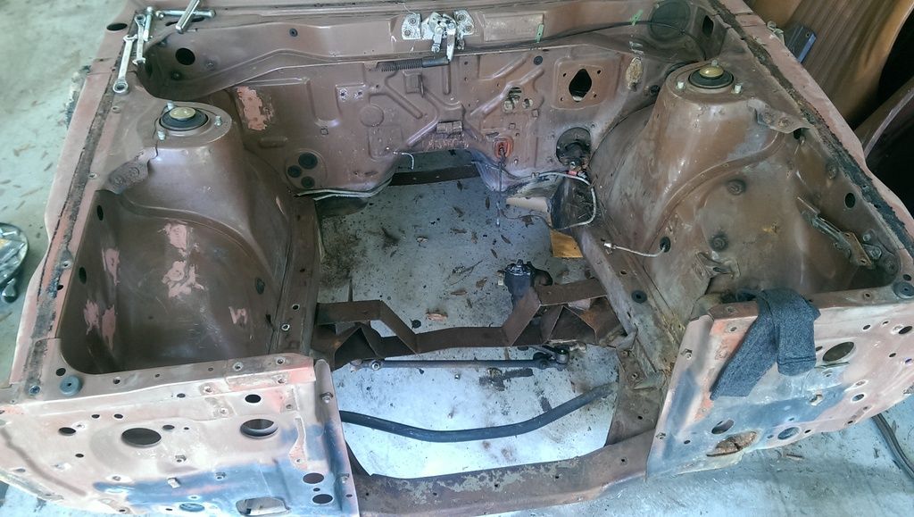

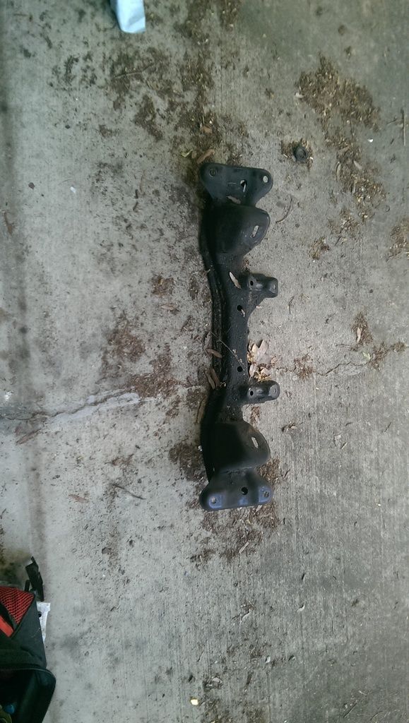

I have been rather busy lately with work and home reno and such so it has been hard to do a lot on the car. I was able to get more interior work done and lay more sound deadening. Also, went to pull-a-part and got the front crossmember from the s13 that I need. I did find out thought that this crossmember is not a bolt in piece as I was lead to believe. Thats okay though. Nothing some cutoff wheels and a welder cant fix. I pulled out all of the front end stuff in preparation for the new setup :)
The S13 crossmember is about 2" too wide. Easy fix though. I should have the welder up and running this weekend after I get the 220v run into the garage.
