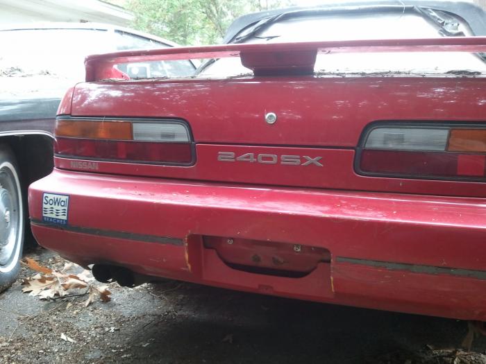

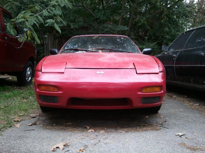

Hello everyone, my name is Bobby and this is the beginning of a very long build. It started as an anniversary gift from my wife as a project car (by the way, I have a awesome wife)
I am building a ’92 240sx convertible, I started with the intentions of building a KA-T but after some debate I wanted to build another mild ~300hp 4g63. I do not expect this to be a quick build, I like to take my time and make things right the first time. It’s a project car, I have a family and a life beyond my garage. I enjoy the build so I don’t rush through the build and miss the details, building cars is good therapy for me.

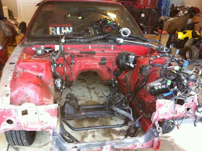

Progress has been slow, I get a few minuets on it here and there. Removing all the harnesses from the front of the car and preparing to start work on the bay.
Planning to shave/clean up the bay? Is this going to be a function over form build? Looking good so far. :)

I prefer a the (KIS) Keep It Simple approach; it will be function over form.
I do plan to shave and clean up the bay but I am not removing anything that's needed. I plan to fill unused holes and simplify the wiring. I will keep essential components to make the car run correctly and to be street legal (horn, lights). The A/C will not be used and I'm also debating a manual rack steering.
My vision is a fun to drive weekend car that is at home on the street or track.
