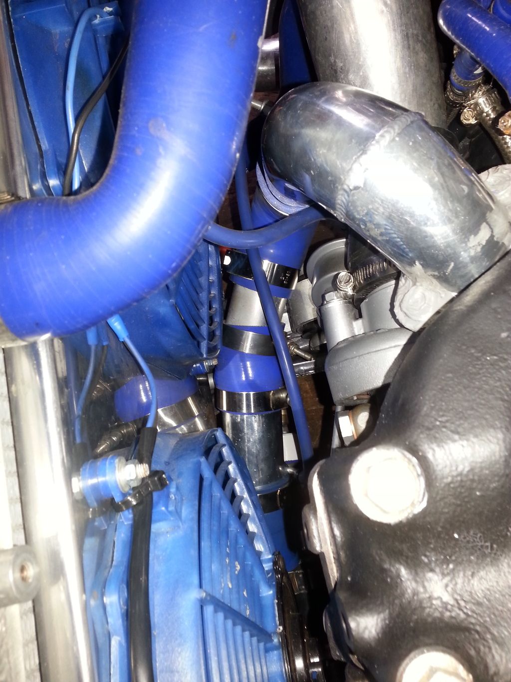

Right now when it hits 15lbs boost its blowing off the coupler on the end of the second pipe off the J pipe in this pic because I had to cut the tubing up to go over the crossmember so it does not have a beaded end. Making a pipe beading tool out of wire cutter crimpers and going to get this thing to 20psi!
