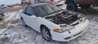

Well it was a bit of luck, a buddy of mine was in the yard Friday afternoon and the car was just placed on the yard that day.
It stormed all day Saturday so the chances was it wasn’t getting touched.
Yesterday, I hit the yard early with it misting rain and 38 degrees and got started on it before people started grabbing parts off it.
I have not looked into it yet but its clean, no major oil leaks that I could tell. Fingers crossed it is a late build 97 and it has the revised split thrust bearing. To be honest I am not concerned either way.

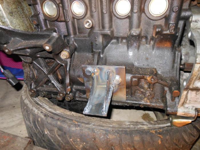

How are you going to mount the engine? 2G's have 3 trans mounts and one motor mount on the T-belt side. 6-bolt 1G's have 3 motor mounts and 1 trans mount. That's one of the reasons you never see a 2G motor in a 1G.
Thought about it?
I won't be using the existing mount.
To go rwd I will be using motor mounts from a mighty max truck. It's a bolt on part to the 4g63.
Right. But the 2G block has no provisions to bolt motor mounts to....at all.
So unless you plan on drilling into the block to tap holes you need a 6-bolt motor. The reason for this is because the 6-bolt motor has the provisions on the block to bolt motor mounts to.
Am I describing it clearly?
Hmmm interesting problem, if there are not provisions for engine mounts what about utilizing a mount mount plate like they tend to use on fox body mustangs to stablize the engine and solidify everything instead? Still not sure where you could mount various mounts but if you are removing the A/C, eliminating the need for the rear carrier baring for the driver side axle, and potentially eliminating the power steering there could be a pontential set of bolt holds that will stablize the engine enough to utilize successfully. As for the might max transmission you are going to use, does it have any mount locations other than the rear support?
There are plenty of places to mount the motor mount… Its not quite like the 6 bolt but its nothing that cant easily be fabricated.
I haven't got the mounts yet but I believe the mighty max mounts will bolt to the two holes vertically aligned with the 2 and 3 cylinders.

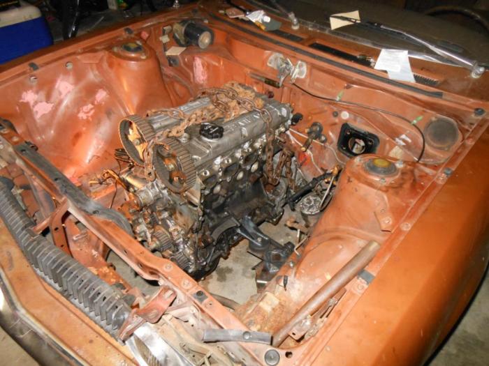

TSIflyer95 has a build on this site doing the same thing. He is further along than me but he is also using a 2g 7 bolt.
http://www.dsmtuners.com/forums/dsm-build-journals/447380-flyers-4g63-powered-74-celica.html
Awesome, looks like a viable solution using that mount plate. I just saw that as a sticking point on a 2G motor, looks like you're on the right track!
