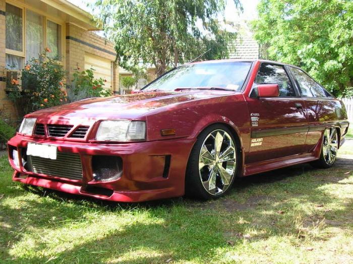

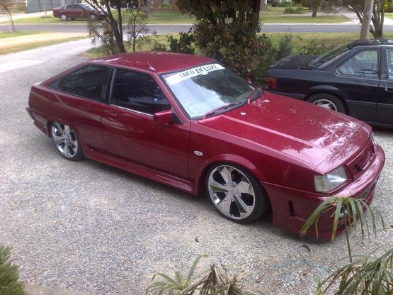

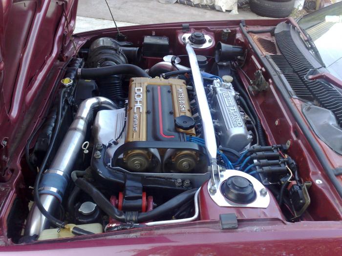

Just a few pics or my beast, comments are very welcome.
Running gear specs:
-Forged VR-4 RS
-9:1 comp 85.5mm Wiseco's on Manley rods
-Fully balanced rotating assembly
-Ported TDO5-16G with 28mm wastegate
-Ported and polished head with 3 angle valve grind
-ARP Head, Main and Rod bolts
-ACL race gaskets
-ACL race bearings
-ACL race MLS head gasket
-Gates racing belt
-BSE kit
-Microtech LT8s
-Rs/EVO 3 injectors
-Bosch 044 pump
-HKS front mount
-3inch mandrel bend exhaust, with varex.
-Xtreme 6 puck brass button clutch with M/S PP
-Blitz plumb back BOV with 18 Psi spring
-20 row oil cooler
-In cab Hi-ratio switch
-Kaaz 1.5way LSD :D
Wheels, brakes and suspension:
-Front BC coilovers, fully adjustable with camber tops
-Ralliart rear shocks with shitty kings
-Grumbly front strut brace
-Selby's front swaybar
-Polyurethane bushes threwout
-Solid engine mounts
-VR4 front twin pot calipers and discs with EBC Redstuff ceramic pads
-TP Magna rear Disk conversion
-Evo 3 Master cylinder and booster
-18" vault savanna rims
-Goodyear Eagle F1 (Front) / Pirelli P-zero (rear) treads
Body:
-Full Respray Nov.2007
-Evo 3 phillcomrally bumper
-Fibremaster sideskirts and rear lip
-Deleted door locks, badges, stickers, etc.
-Clear indicators
-Colour coded bumpers
Interior:
-EL dials
-Autometer boost guage
-Dvd head unit with screen
-2x12 inch subs
-Alpine type R's in rear storage thingy, kenwood 6x9's on rear parcel shelf
-New carpet
-Electric windows
-4wd battery in boot

Thanks for the kind comments guys,
here are some pictures of the build.
Rewired the Microtech loom, nice and neat now.
Wiseco pistons
Manley rods
ACL race bearings
Gates racing belt
ARP studs threwout
Bosh 044 fuel pump
Front coilovers with camber tops (Very stiff shocks and heavy spring rates)
Ralliart rear shocks (Haha cool as) plus there very very stiff.
New zaklee cover
Here we have the pistons and rods
ACL race gasket kit for the rebuild and BC coilovers which are fully adjustable.
Evo TME steering wheel (With no airbag :) ) (These are so hard to get a hold of)
Ralliart gear knob which has 6 gearboxes to work its way through.
Here are some shots of the block:
Bores after torque plate hone
Mmmmmm Torque plate.
Blueprinted and assembled
Forged goodness
So.......what's in the box, what's in the box, what's in the box today?
Is that a Kaaz 1.5way mechanical lsd?........................ I think it might be :D
