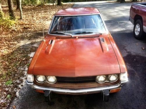

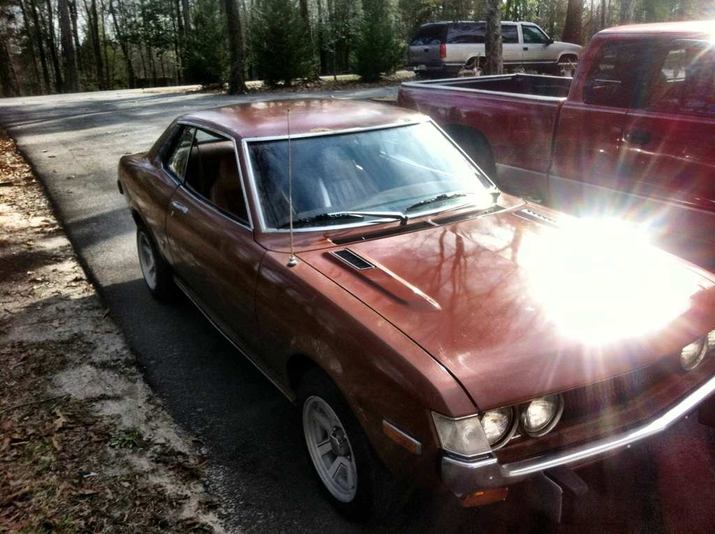

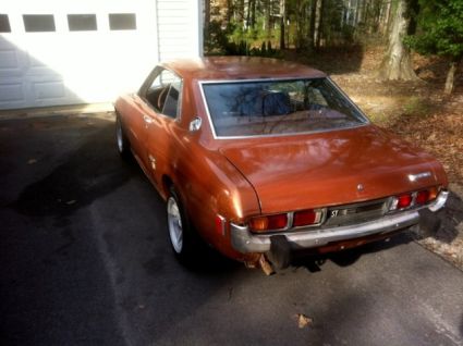

Without further ado. a 1974 Toyota Celica ST! 7 bolt 4G63 from a 98 gst eclipse. I know crank walk was an issue with some 7 bolts, this isn't a concern for me as I will be fully building the motor at one point.

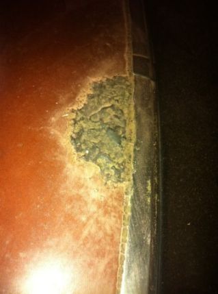

The rust I spoke of. There are spots like these around the roof line. This is probably the worst. I believe the car used to be a vinyl top, and the was from water collection and such.

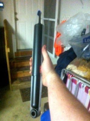

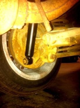

Amazon came through for me. I was able to get one day shipping on these ladies for like 7 bucks so I didn't say no.

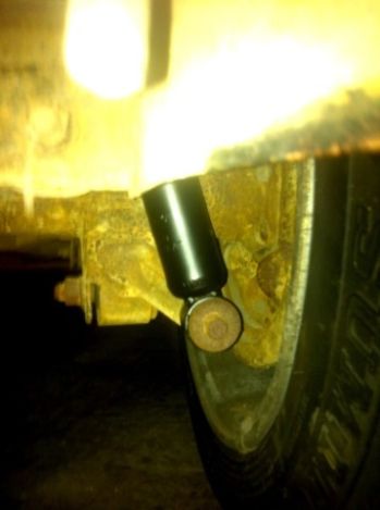

I was able to get both the rear shocks installed. Easy, easy job.

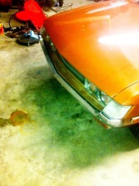

All in all I can't complain. I did have a mishap whilst changing my oil, I didn't realize the gasket had come off, so I checked later and there was a puddle under the car, tried to remove the drain plug and recycle the new oil I had just put in, and, well, spilled about 1 1/2 qts on the ground haha. So first thing tomorrow is to find a gasket that will work.

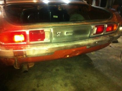

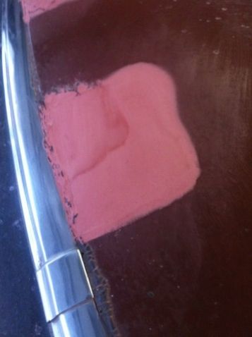

Here is what I did with the rust that was on the roof. Most of it has been cleaned up. Still have some to go.
Needs to be painted but it's smooth and solid now. Much better than before.

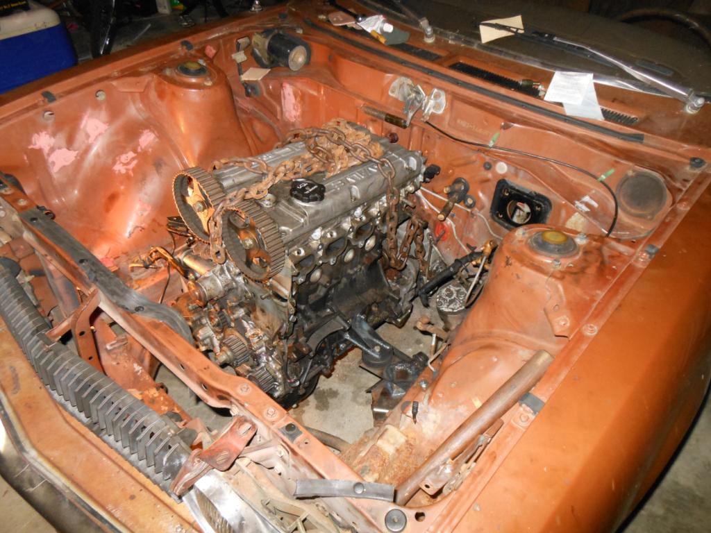

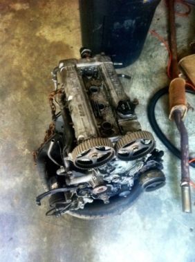

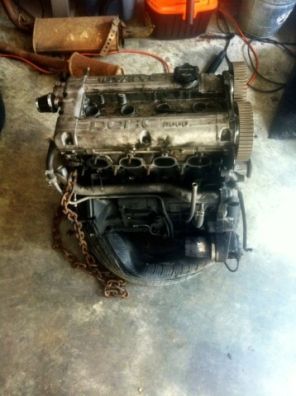

Well, here it is. The new heart for the celica. This is going to be a very slow process as it will be rather pricey, but, it will eventually get there.
Without further await, Mitsubishi 4g63 2.0L turbo engine.

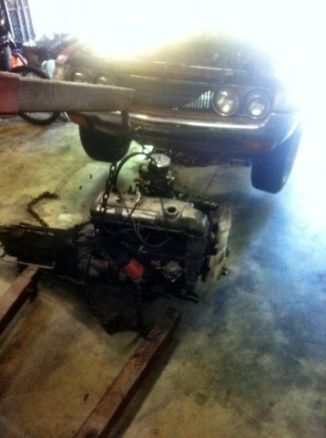

First off: out with the old to make room for the new.

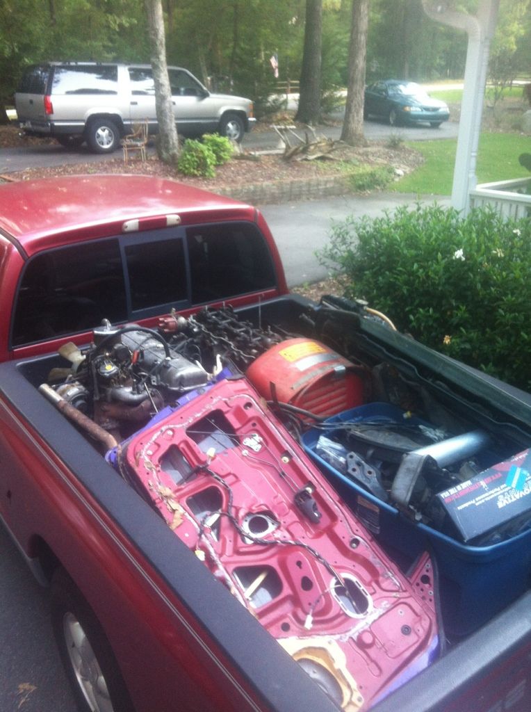

I don't have the time to try to post all this stuff for sale an my parents need the space, so, I loade all the random car parts into the truck and I'm just going to take it all to the scrap yard. I probably won't get but $100 bucks for all of it. But there is close to 1,000 lbs of stuff in there.

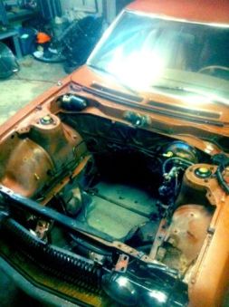

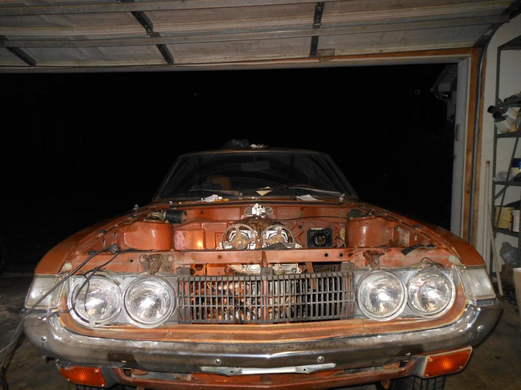

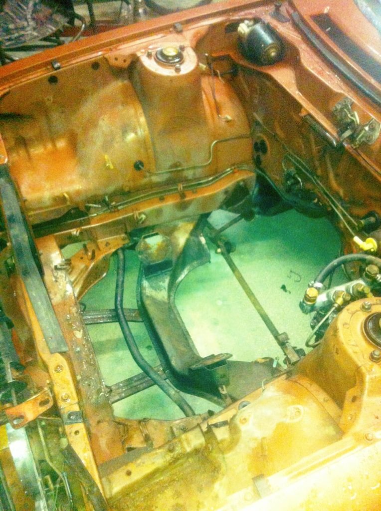

I worked a little longer today and was able to clean up the engine bay a little. Tomorrow I will be pressure washing it to get the the stuck gunk off.

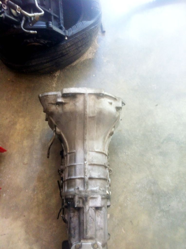

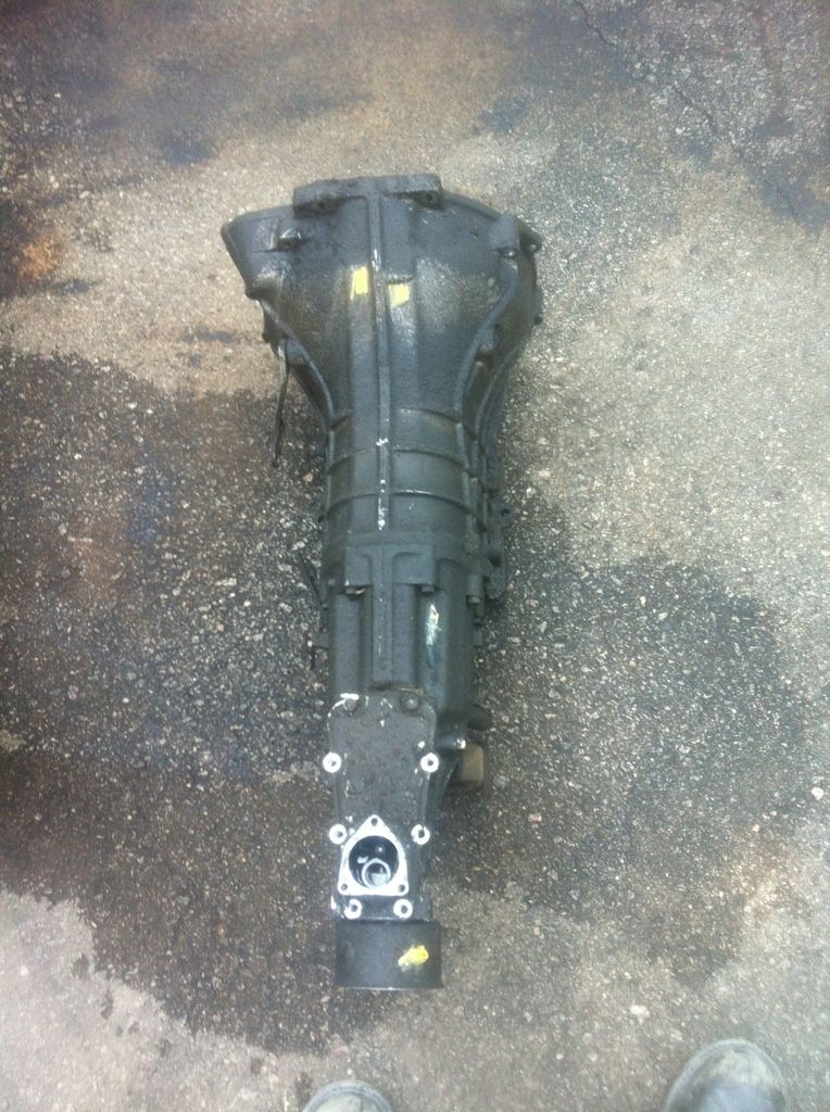

I was able to pick up a transmission on the lows from the junkyard! I was very fortunate that they actually had the one I needed.
This is how it looked when I bought it.
After some cleaning.

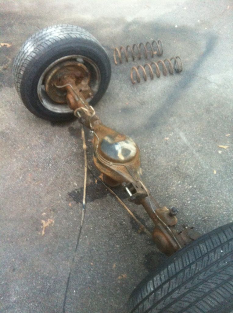

I then decided to pull out the rear end and clean it up, along with some of the other suspension components. While I was under there I also cut the coil springs to lower the car a little. I cut 1 1/3 coils out of it.
Before.
http://i601.photobucket.com/albums/tt95/SVTflyer03/3fcc3db8.jpg[/im
After. Also re-installed

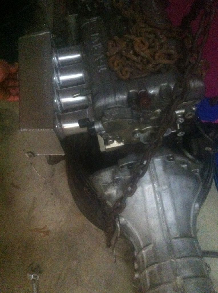

I was able to bolt the transmission to the block. There is no clutch or flywheel yet but that will come in due time. The transmission fits well, minus one bolt hole doesn't line up. No big deal though. And this is the trans from a mighty max. I know it isn't the strongest, but I'm poor lol. And this is all I can do right now.
[ATTACH=full]488790[/ATTACH]
[ATTACH=full]488791[/ATTACH]

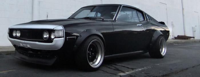

very nice celica man, my favorite toyota by far. See you have mk2 supra rims on it, look better on your celica then they do on my supra!
Wondering why you went with the mighty max tranny? A w58 or r154 would have been a better choice in my opinion, would be more flex-able power wise then the mighty max tran.
But either way, your doing a hell of a good job, I'm excited to see your finished product! :thumb:

Thanks man!
The main reason I chose the Max trans was because of cost. Finding an r-154 for less than $600 was proving difficult, plus I would then have to buy a bellhousing for an additional $450.
Ultimately I want to use a T-56, but again, cost. With the max trans I will be able to at least drive the car for awhile. Besides, I won't be over 300 whp for quite a long time LOL.

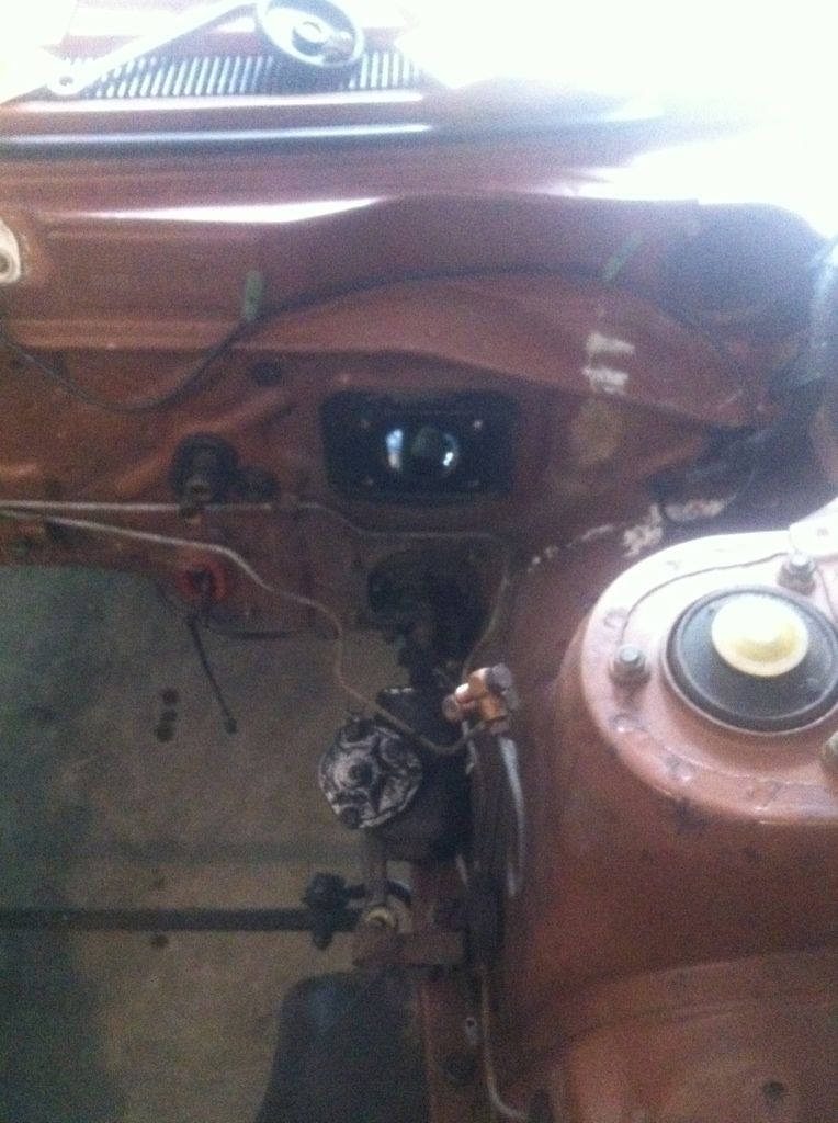

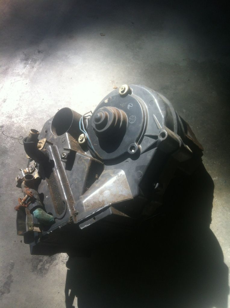

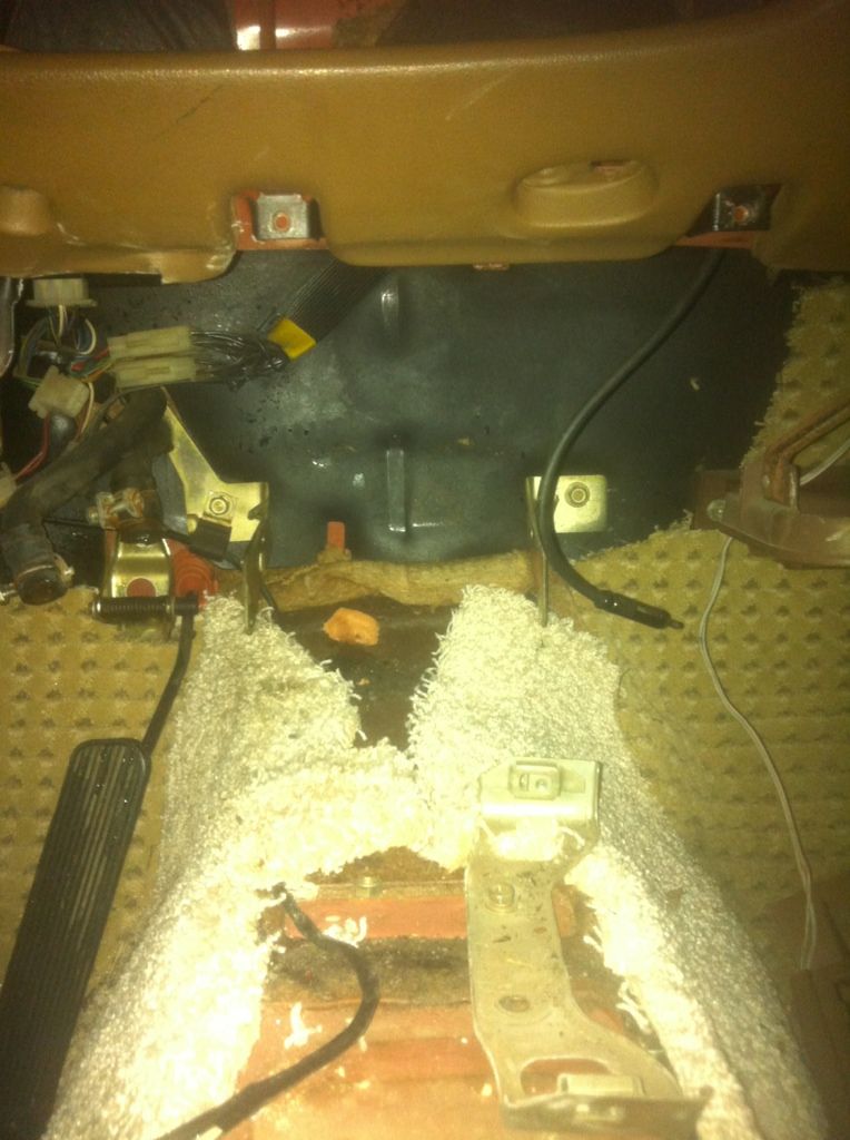

Well I got bored last night at about 1 a.m so I decided to pull out the heater core and blower motor to get it out of the way. The blower motor was going bad anyways so I figured I'd just get rid of it altogether. I plan to make a new center console to fit in its place. The old center console was cracked to pieces.

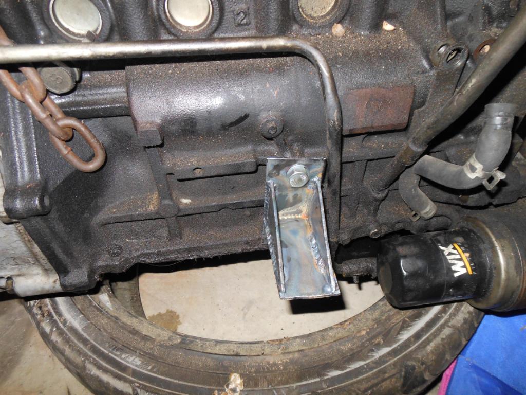

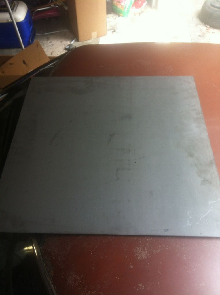

Bought the steel I will be using for the mounts yesterday. 24x24 11 gauge hot rolled. Pretty high tensile strength.

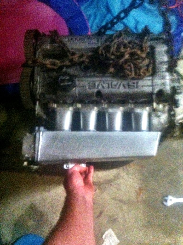

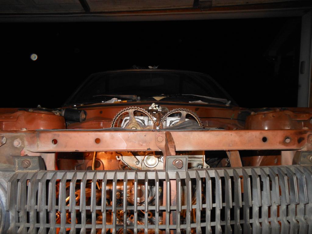

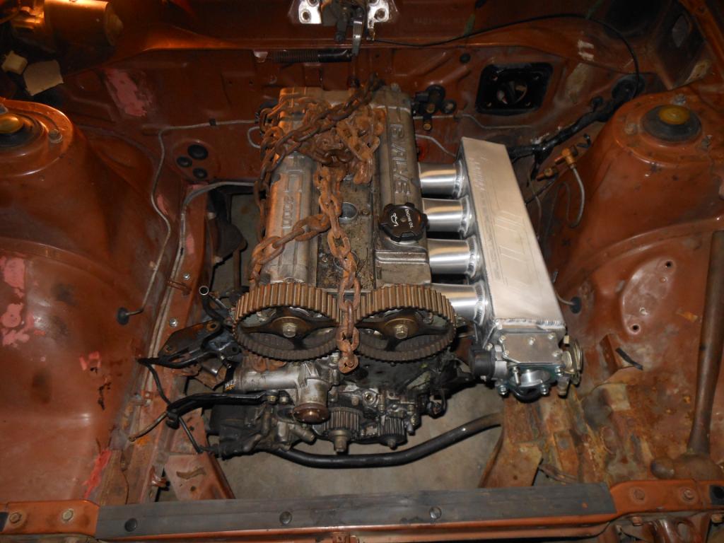

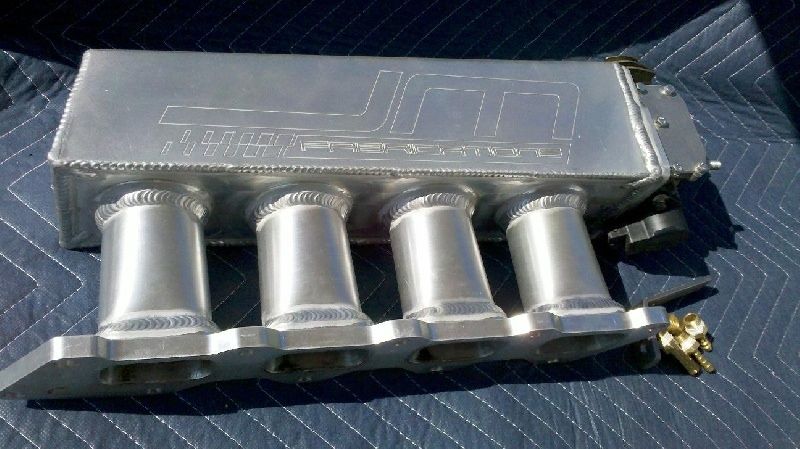

I received the JMFabrication manifold the other day and just had to see how it fits and looks! I love it.

This weekend was a complete success! I am very happy that I have already gotten this far with the build!!!

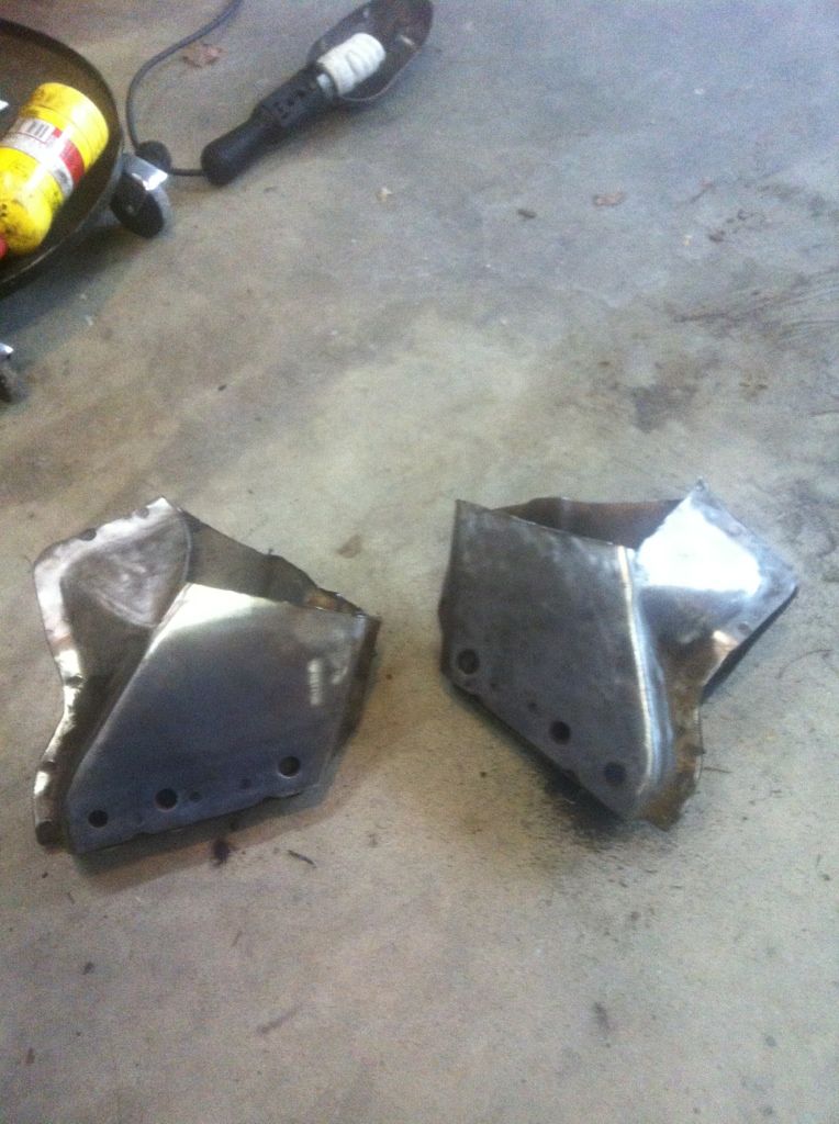

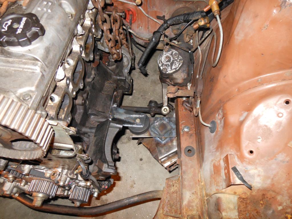

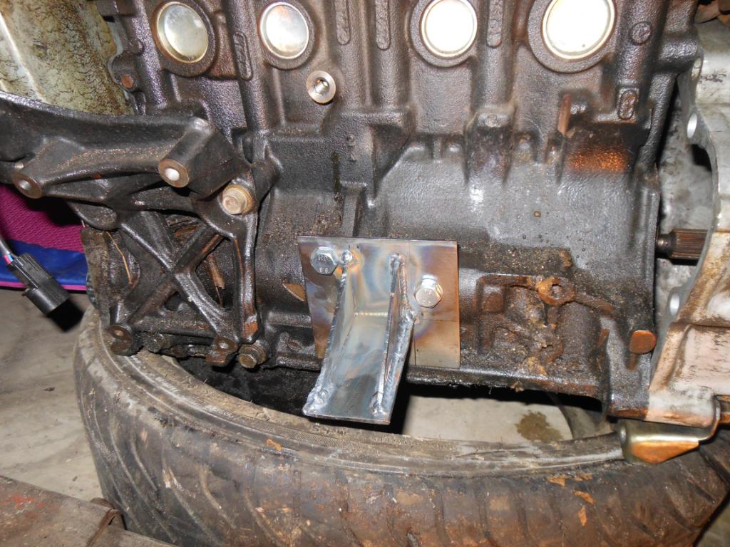

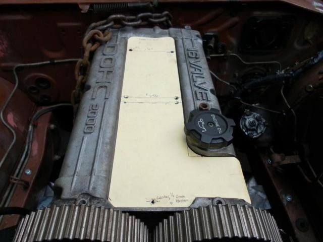

To start, I was able to get the sheet metal I wanted to use for the motor mounts. I also finished cutting up the stock crossmember to make room for the oil pan and such.
Here is where the good part comes!

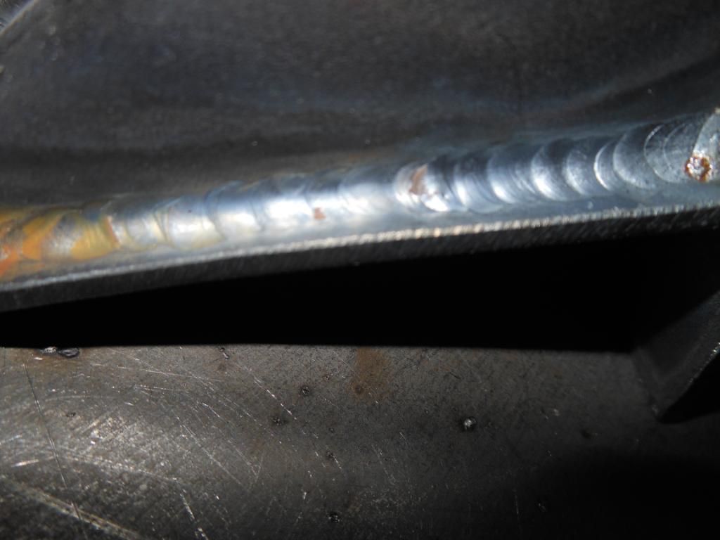

I was able to finish tig welding the mounts Friday. Not the best welds, but I've only been tig welding for 3 weeks. So don't critique to seriously LOL.

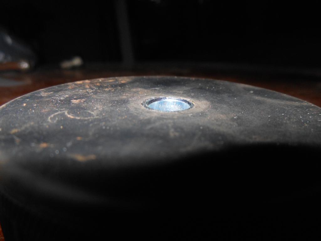

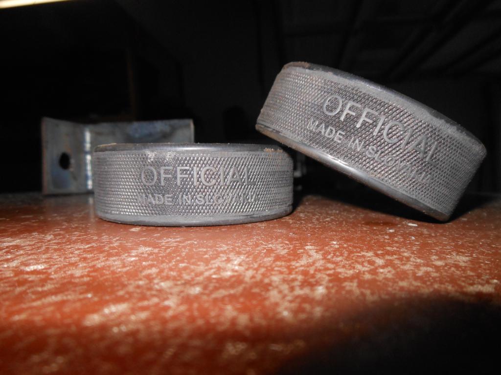

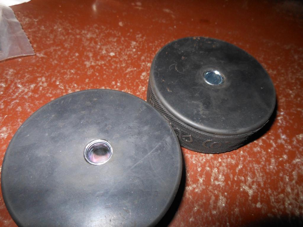

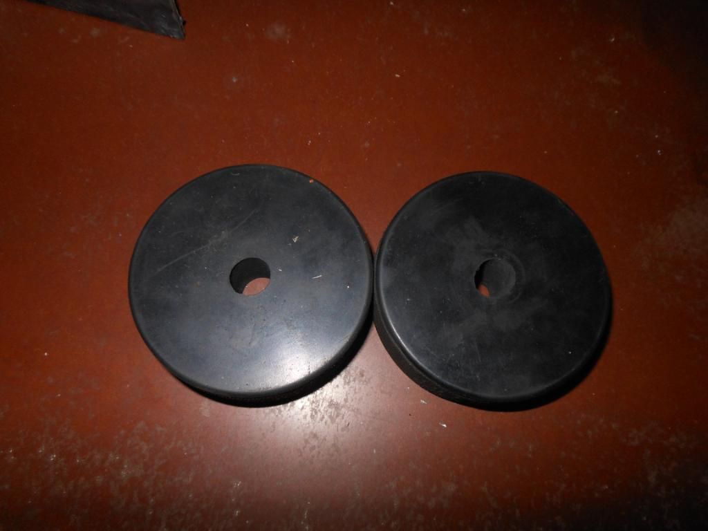

For the "rubbers", I chose hockey pucks. Dense. Strong. And only 2 bucks a piece.
Drilled 1/2" holes through the middle.
Bought some 1/2" OD spacers and pressed them into the hockey puck.

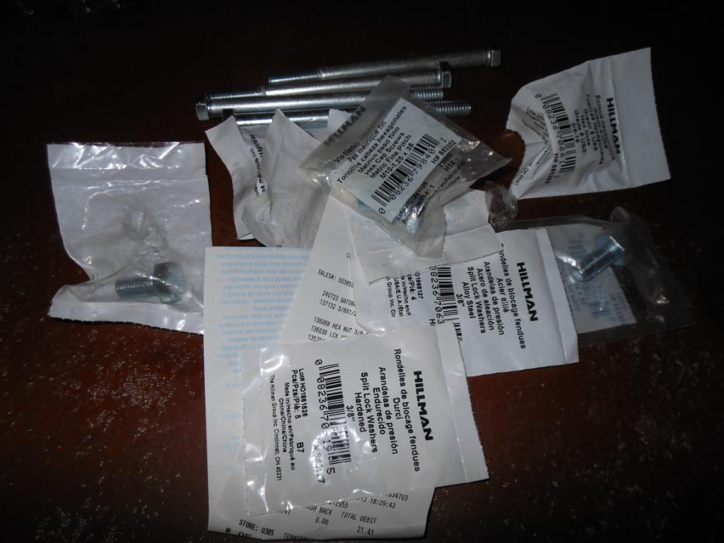

Bought all the nuts and bolts I needed.
And here is my favorite part!!
My favorite pic! :)
My goal for the year was to have the motor mounted. I didn't plan on getting it some until December. Here it is the end of the first week October and the motor is mounted!! All in all I spent $35 on these motor mounts. A lot cheap than what any shop would want. Sit back and think, you might just save some money.
