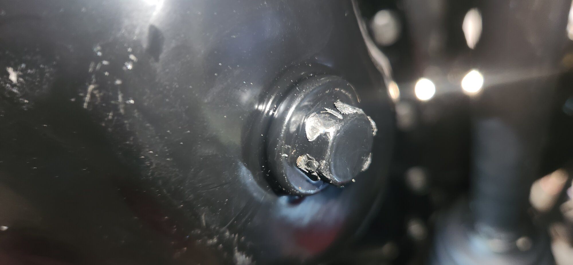

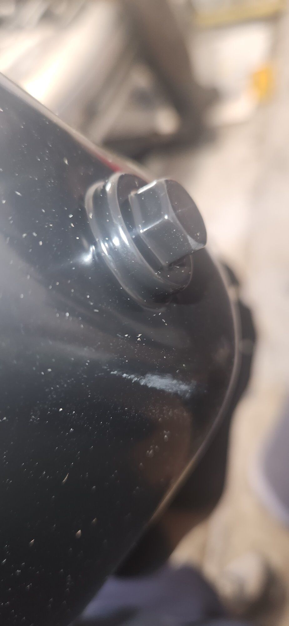

Same shyt. The bolt has the over spray which didn't allow me to remove the drain. I'm not sure if I should try again. The last pan got stripped. This is the replacement pan. It just came in over the weekend.
If you have the tools, it might just be easier to drill and tap a new drain plug 🤷‍♂️
I have the tools and all but damn dawg, I be paying a lot to not do custom stuff. My brother said the same. To go ahead and wire brush it off. I just imagine if it continues to leak from the new tap then I'm screwed out of another 90. Ima see bro, I need to sleep on it. I just want to fix this mf leak.
Why not just use some paint stripper and strip the paint off the bolt and the surrounding area? Then you can just respray/touch up the areas with new paint.

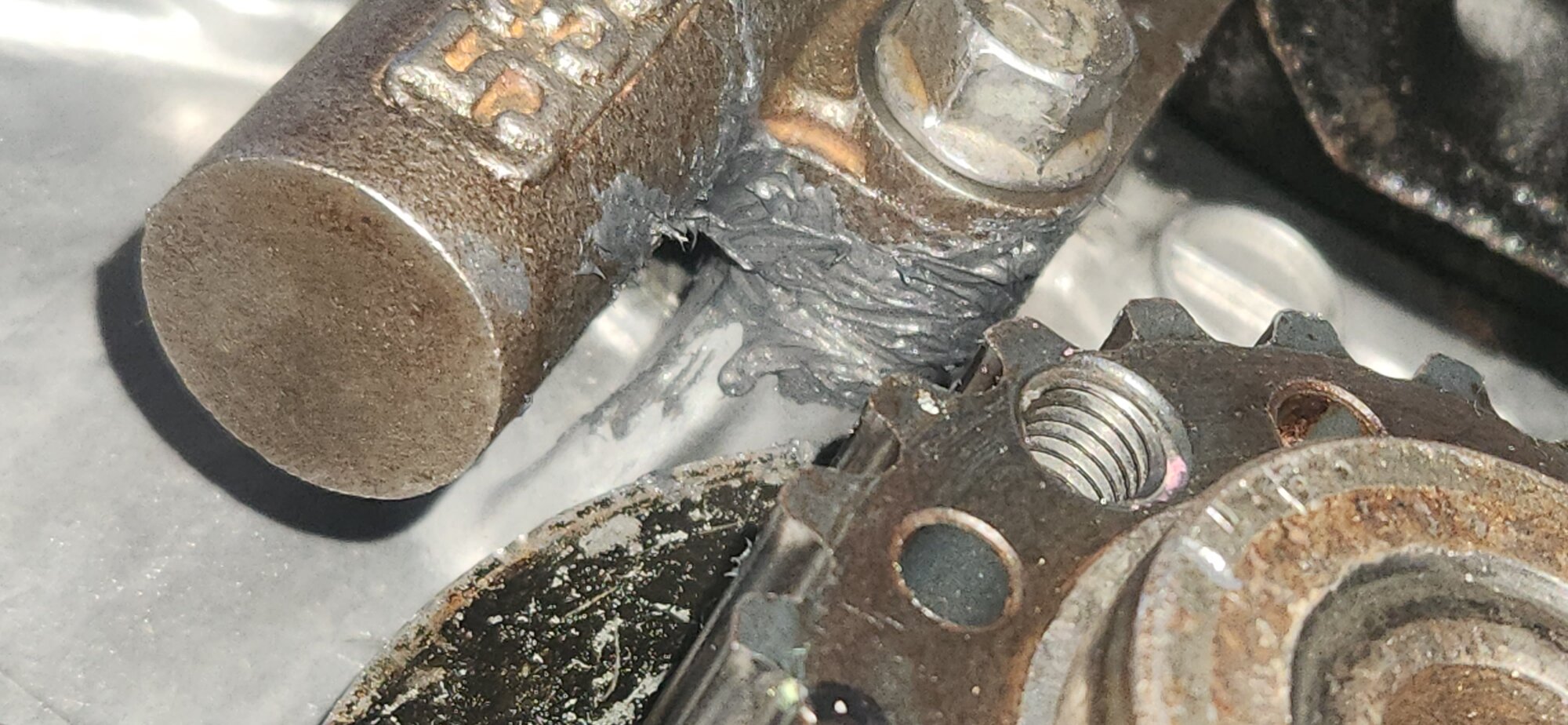

I got out to the garage again this weekend. I was able to get the oil return line to seal by getting rid of the gasket and using a small amount of rtv (not my preference) I also added a bit of thread sealant to the bolts.
As for the plug, I removed the paint from the nut and used a 1/2 inch socket to loosen the plug.
It will do.

I didn't have thread sealant so I used the yellow tape for oils and gas along with a touch of "the right stuff" on the outer edge. I primed the pump again for a while and I don't see anything bleeding.

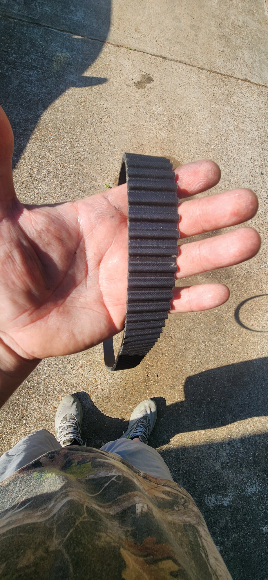

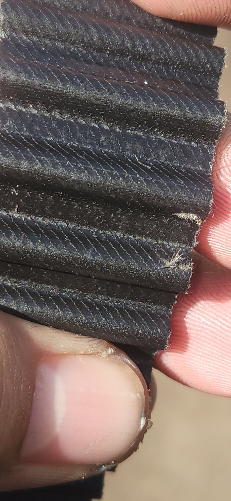

While drying my belt I noticed these threads coming loose. I don't want to take any chances. I believe this is a gates belt. Maybe I'll upgrade or try to find an oem but I don't feel safe with this on. Thank you guys again

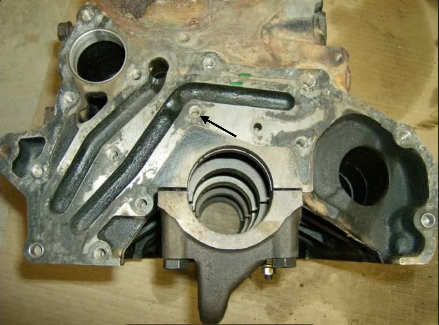

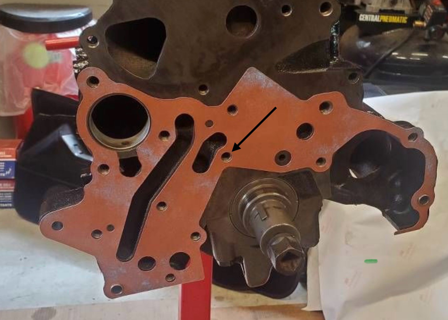

The front case gasket is bad / not sealed if it’s leaking from that hole. Maybe you’ve sealed it well enough now to pacify yourself, but that would be the root cause.
Photo borrowed from @techboy , but the indicated hole is the lower tensioner bolt hole.
It does not go to an oil passage. It leaks from the passage above it (which is straight from the pump) into that bolt hole when the front case gasket is not sealed around it.
Not trying to be a Debbie-Downer or Negative Nancy but figured it should be mentioned.
