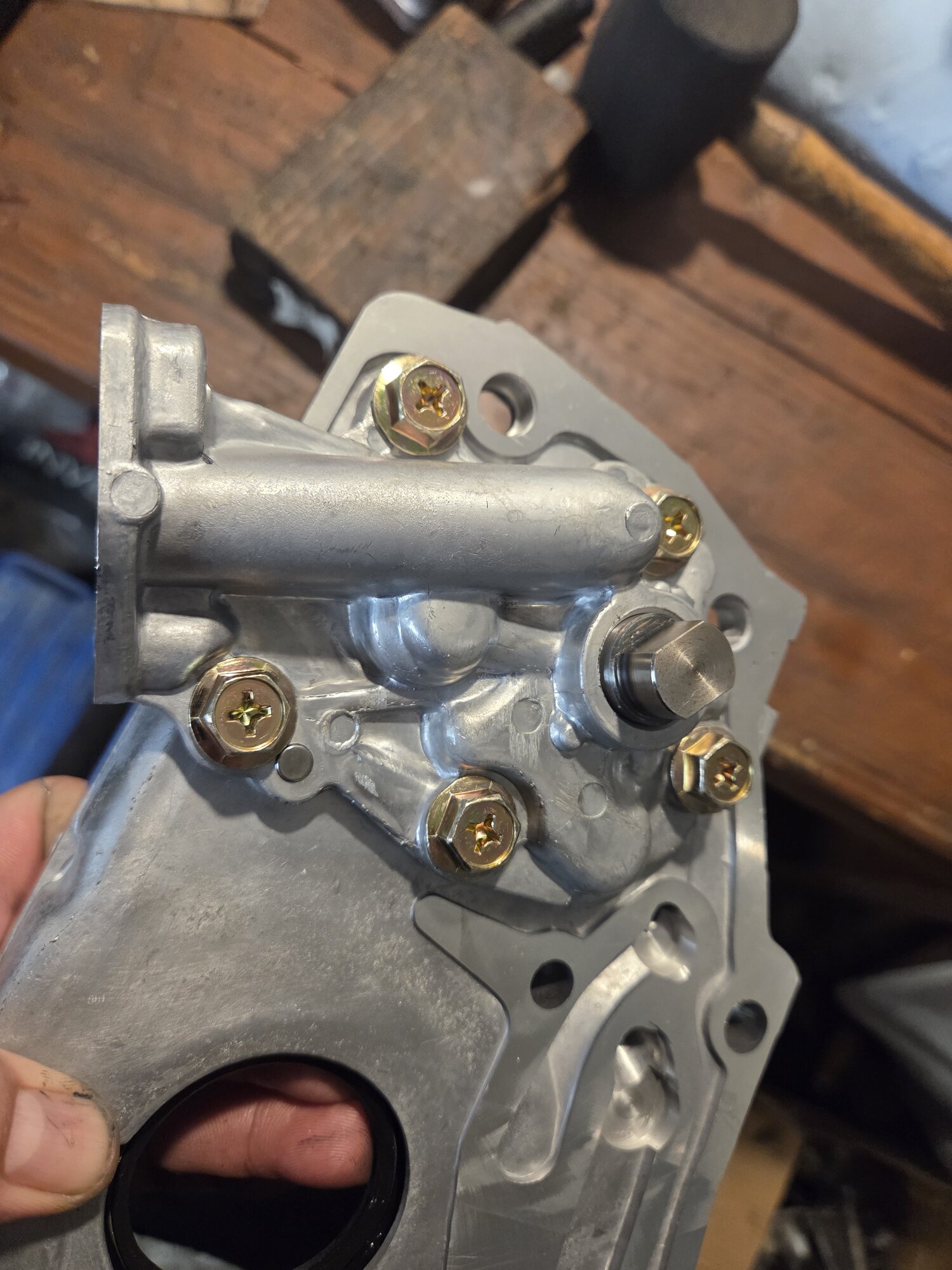

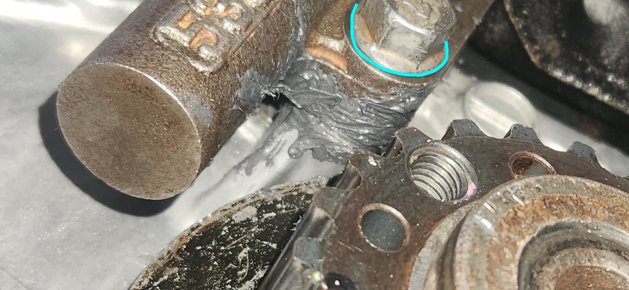

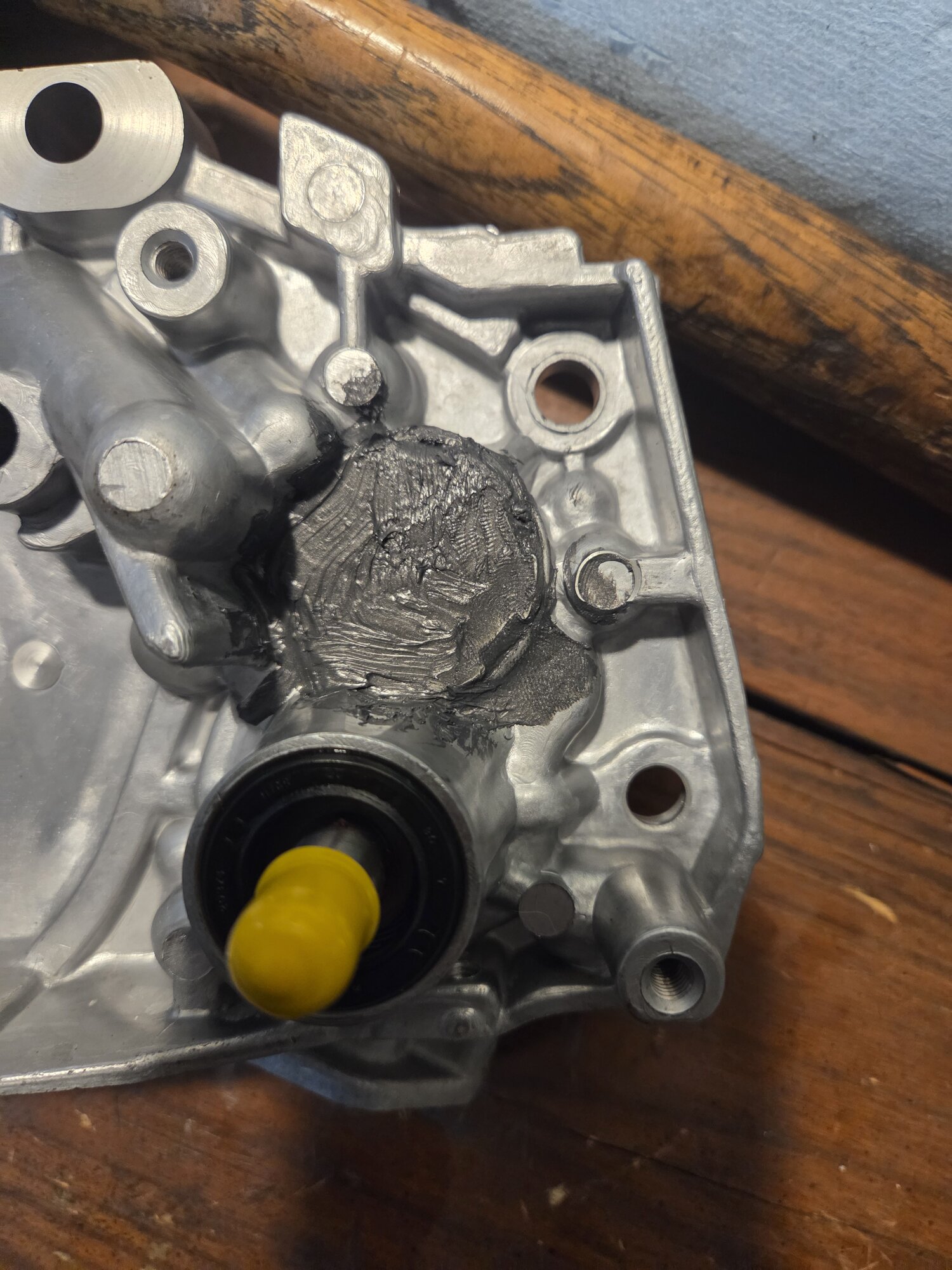

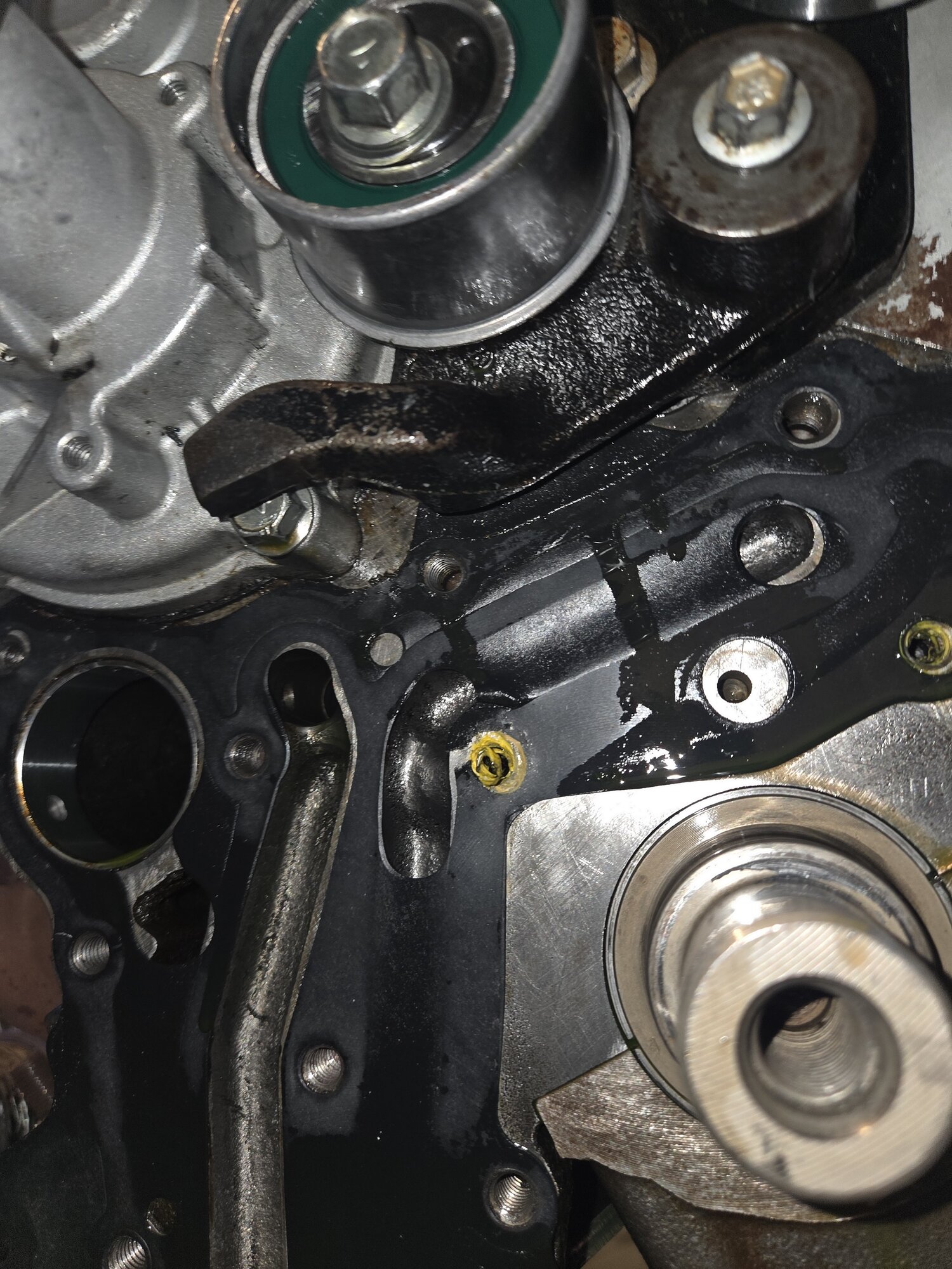

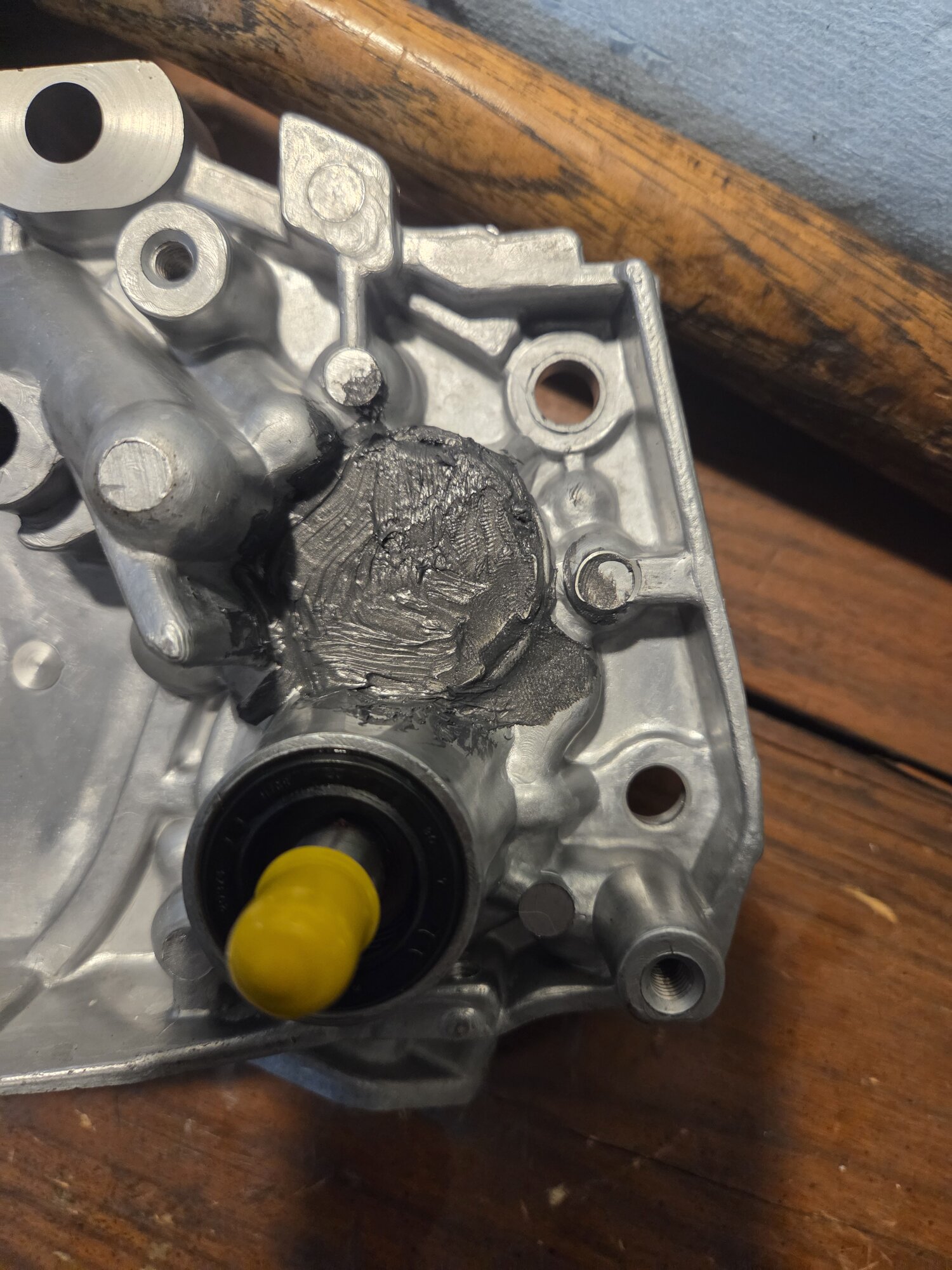

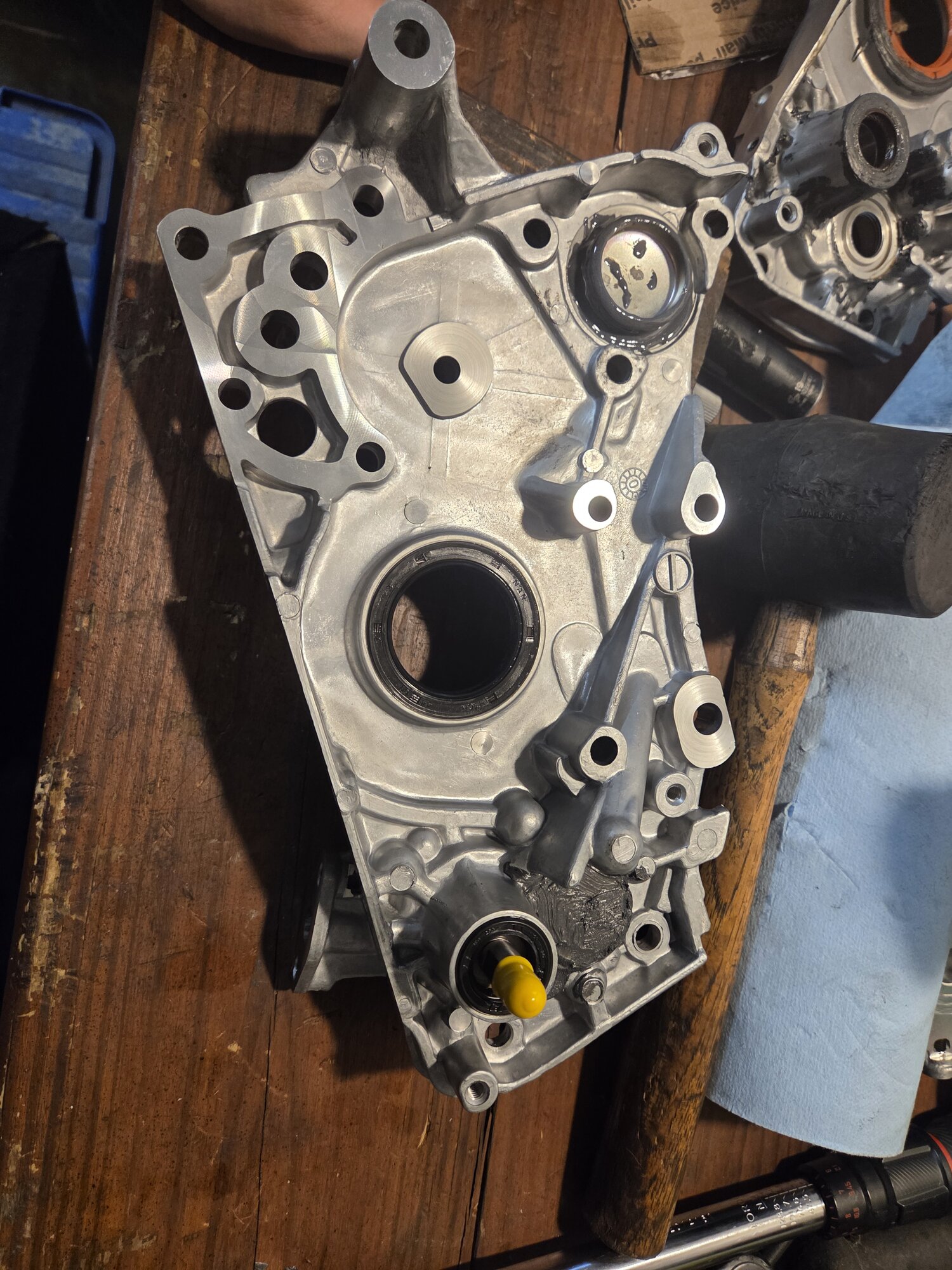

Perfect! Thanks for clarifying. I'll add a gasket to the checkout.

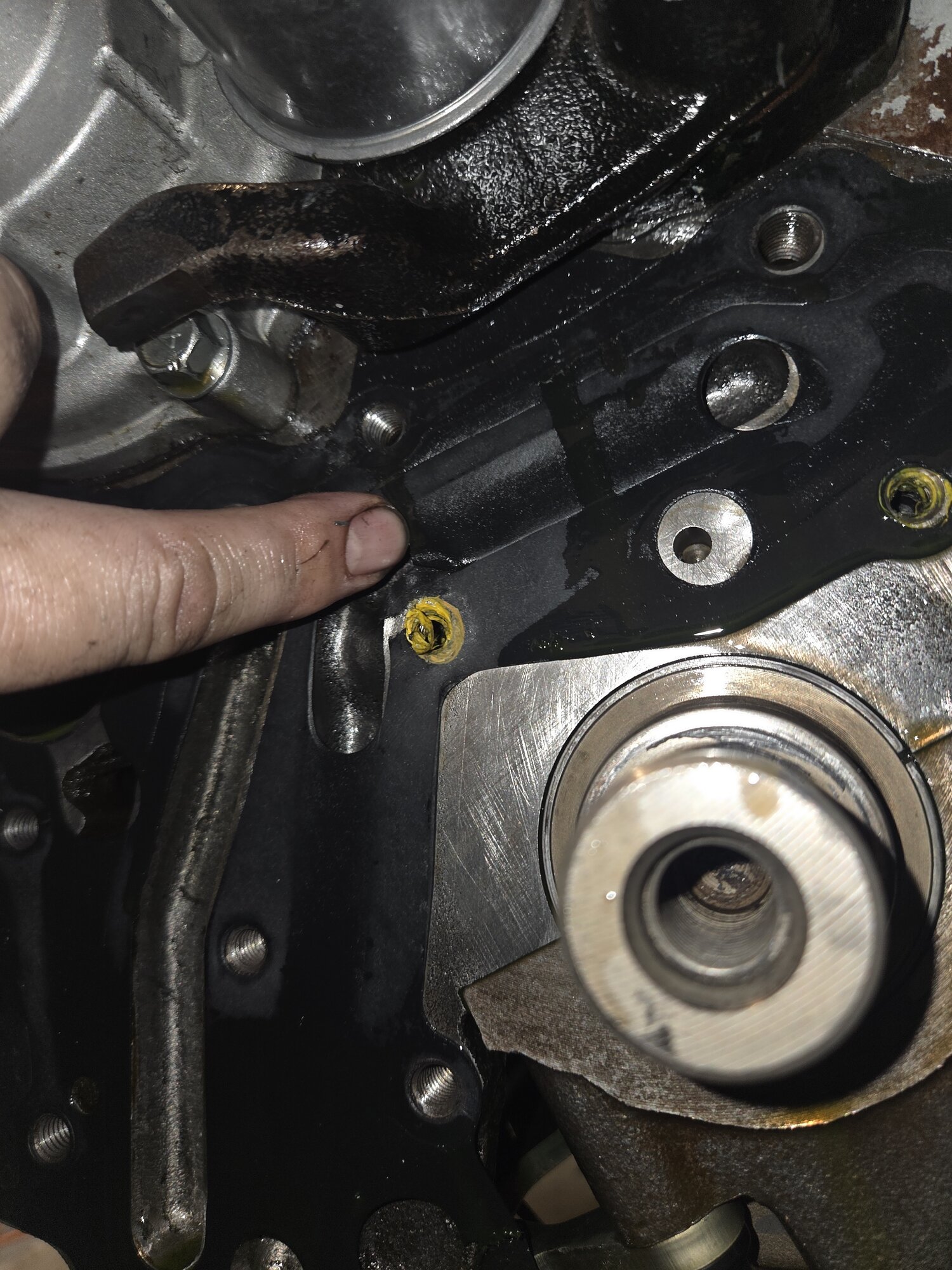

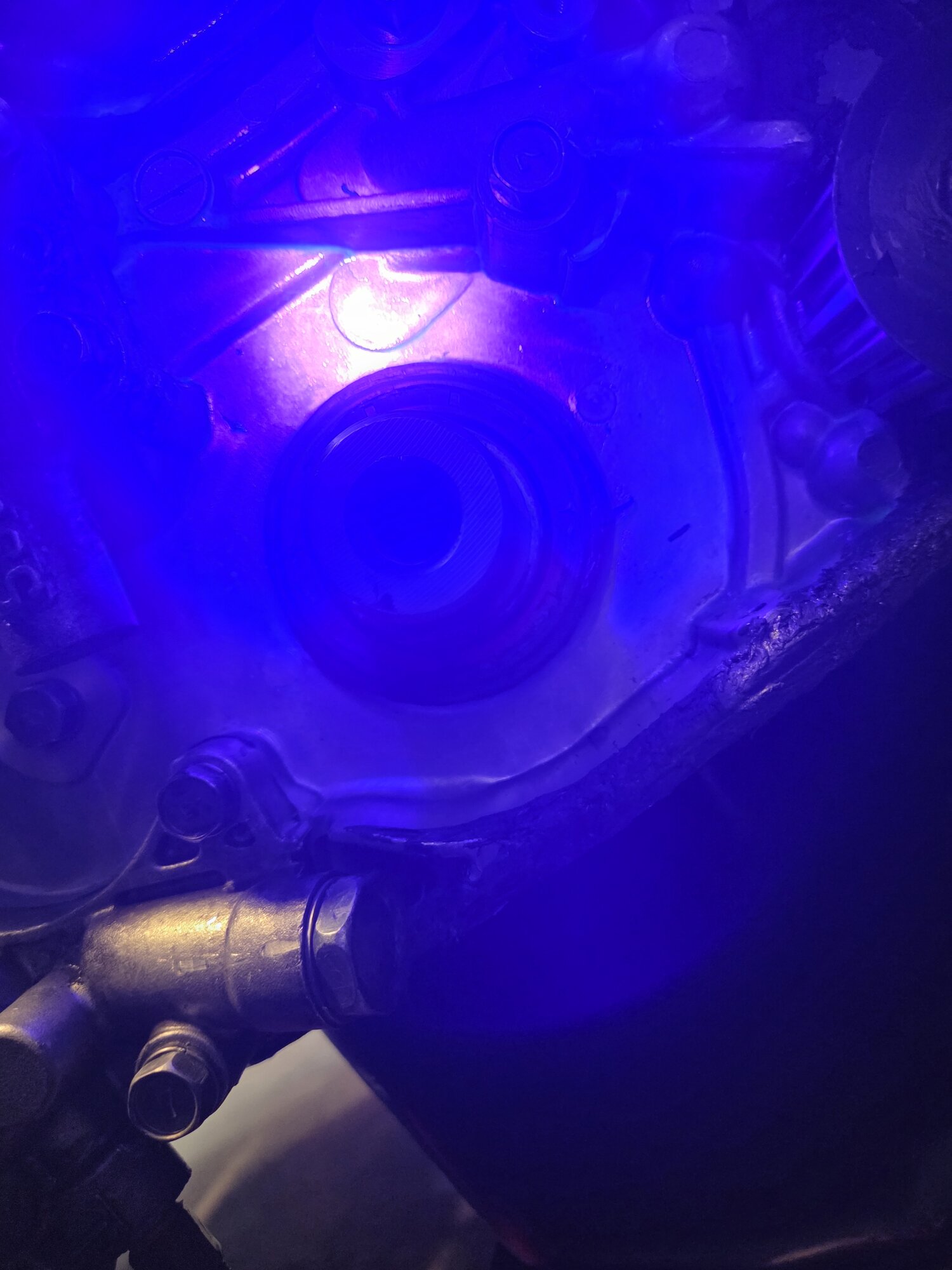

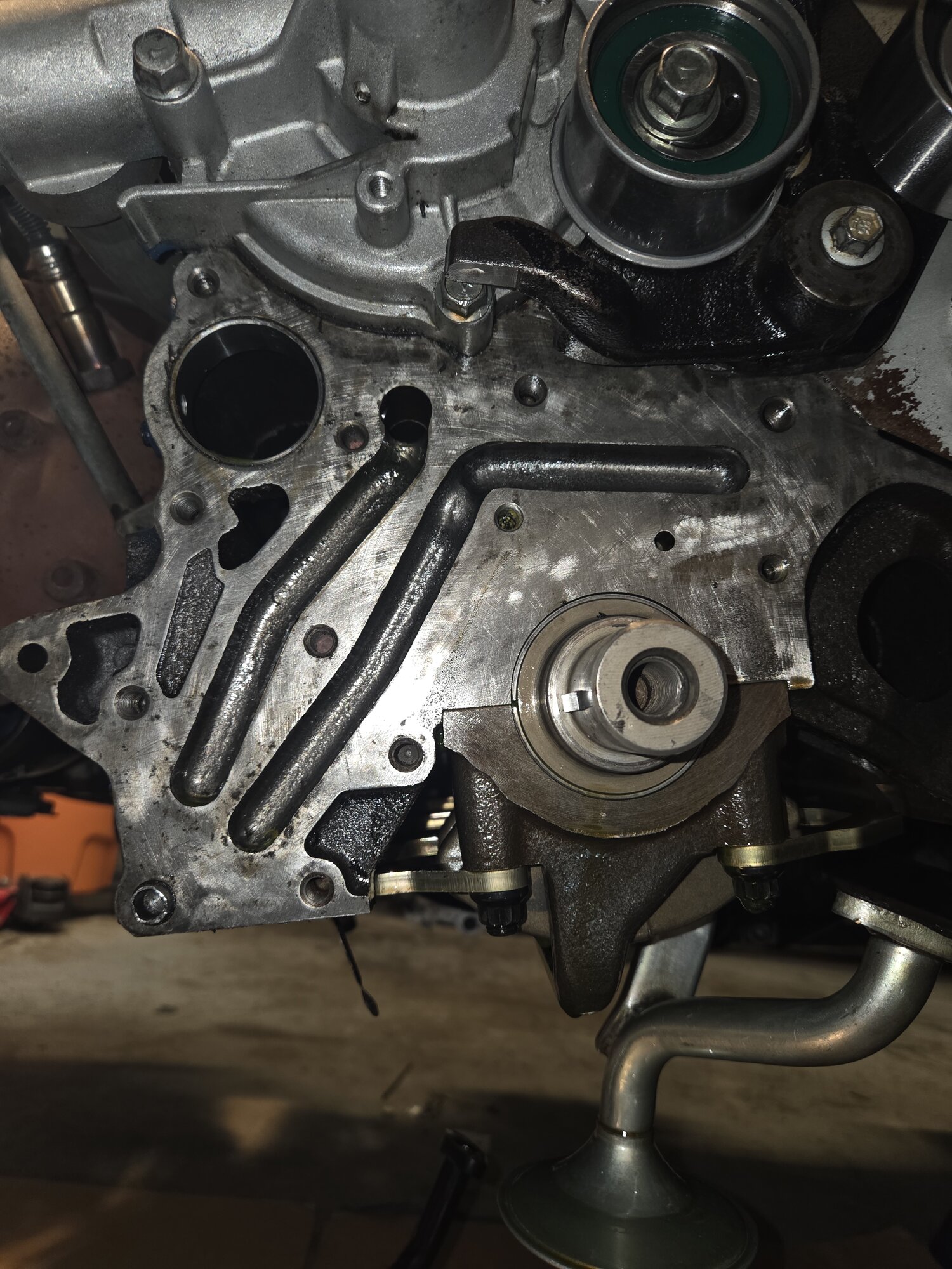

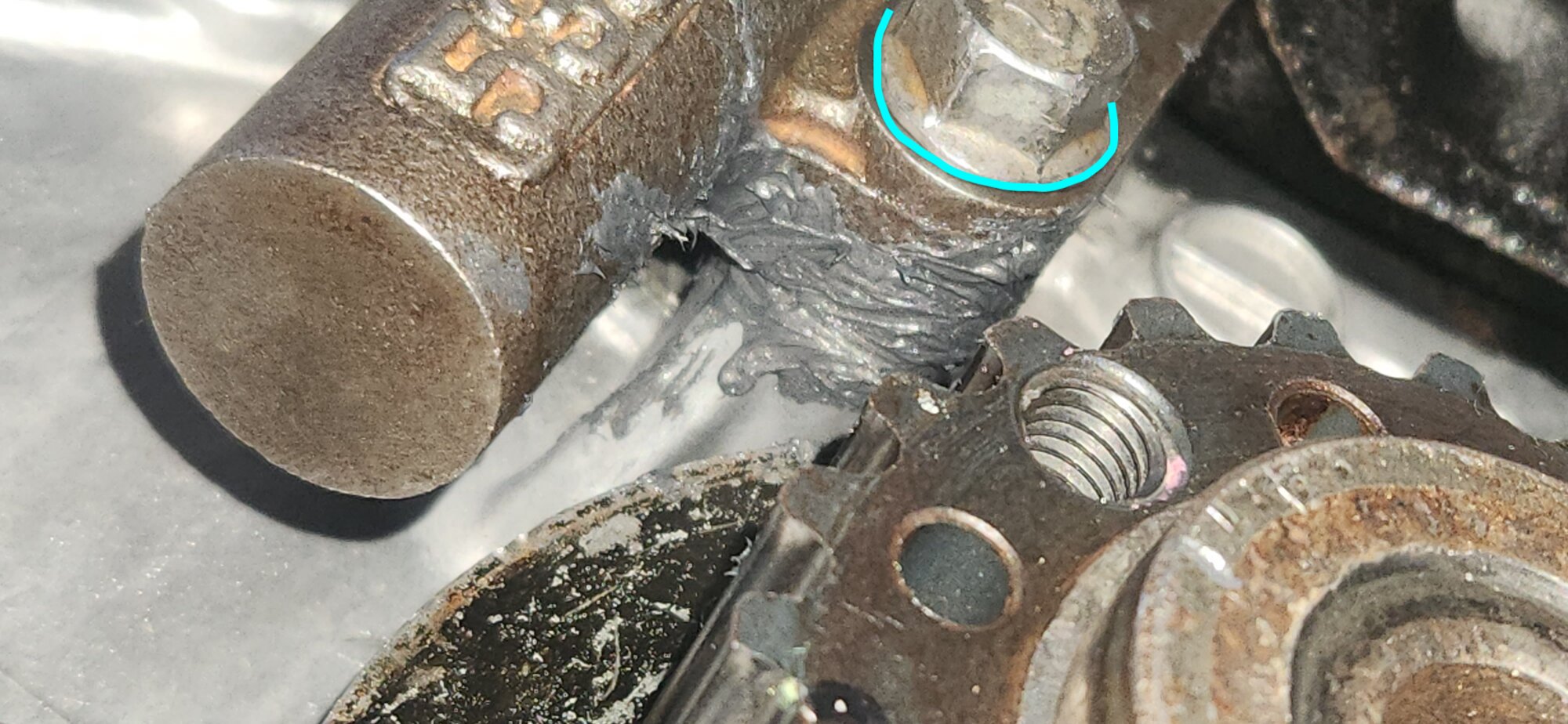

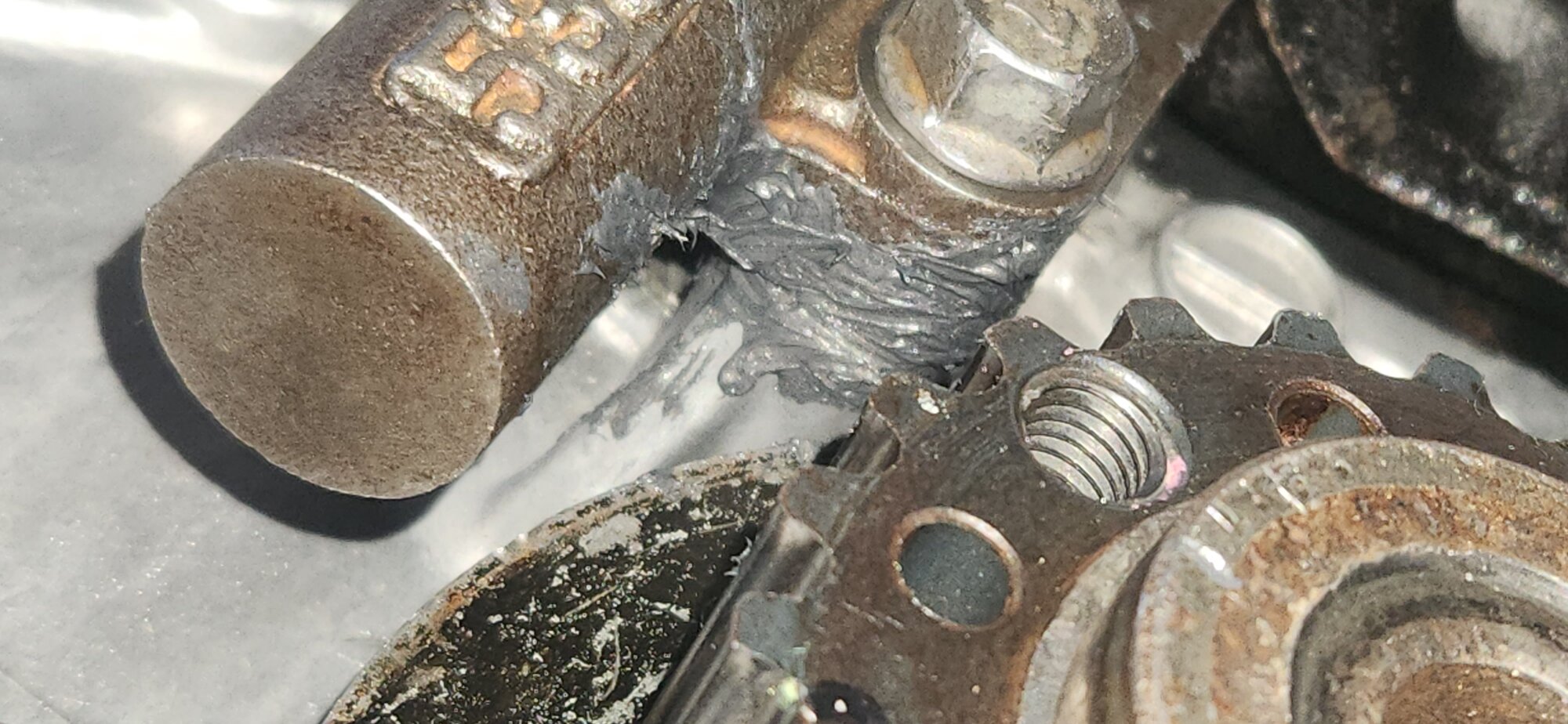

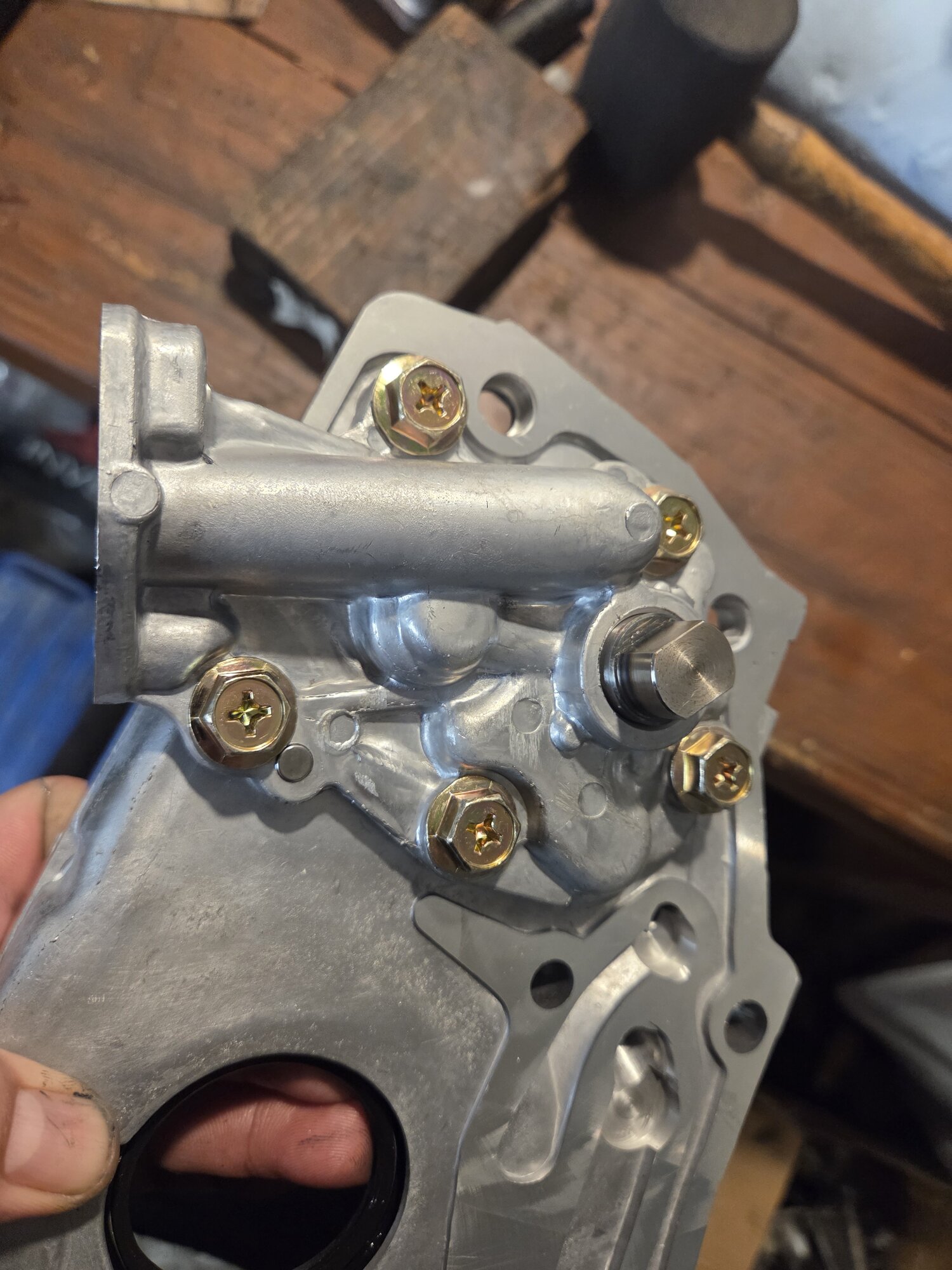

The bolt helps seal the gasket - you need it squishing the front case down. You can put all front case components on without the belt, and do the same test spinning the oil pump to look for leaks. Your gasket "might" be fine.Perfect! Thanks for clarifying. I'll add a gasket to the checkout.
Oil would still leak from the blue line. You should slightly apply RTV under bolt head too.View attachment 761478View attachment 761479View attachment 761480

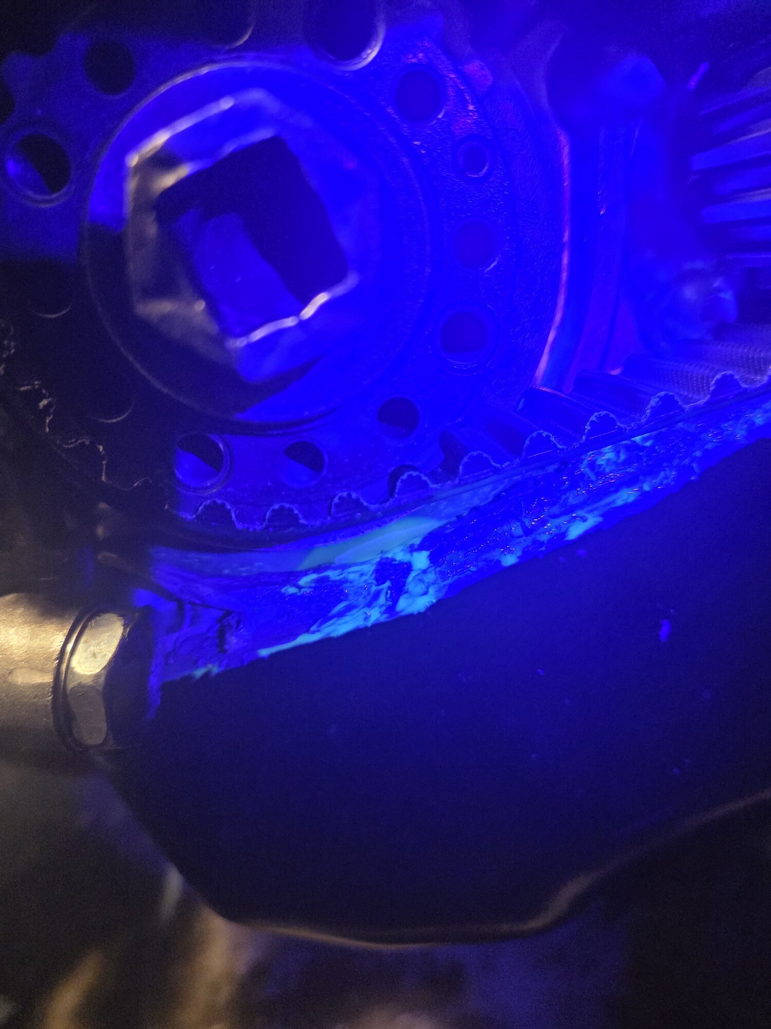

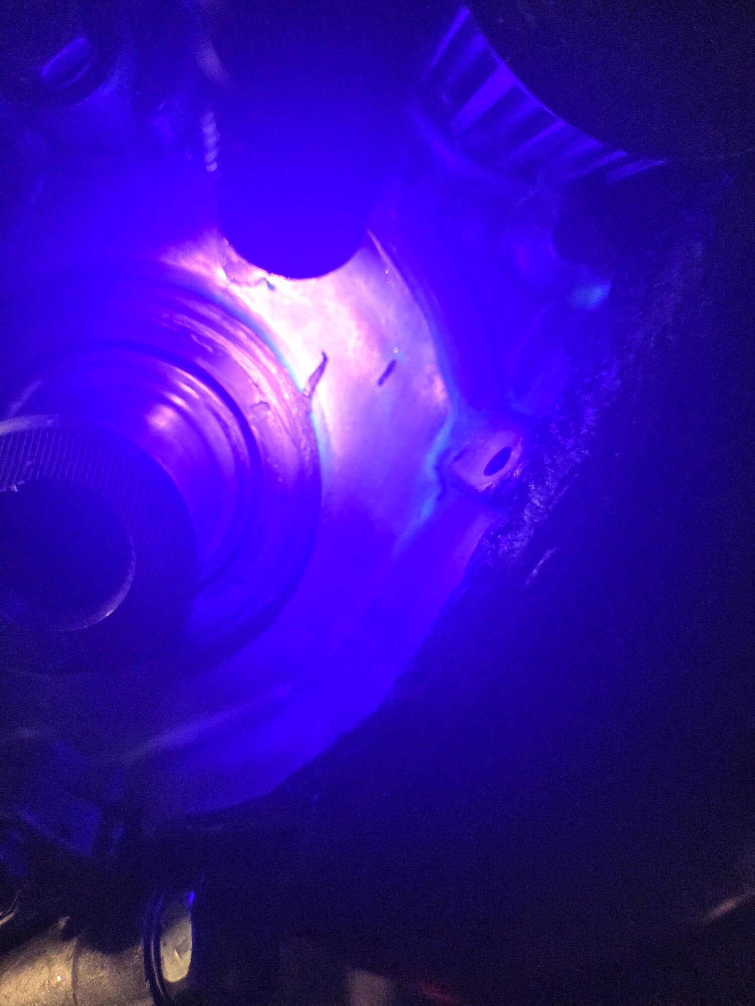

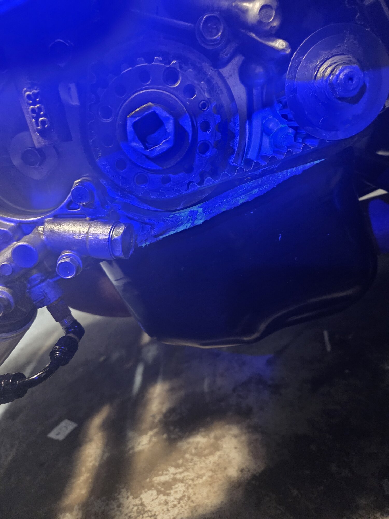

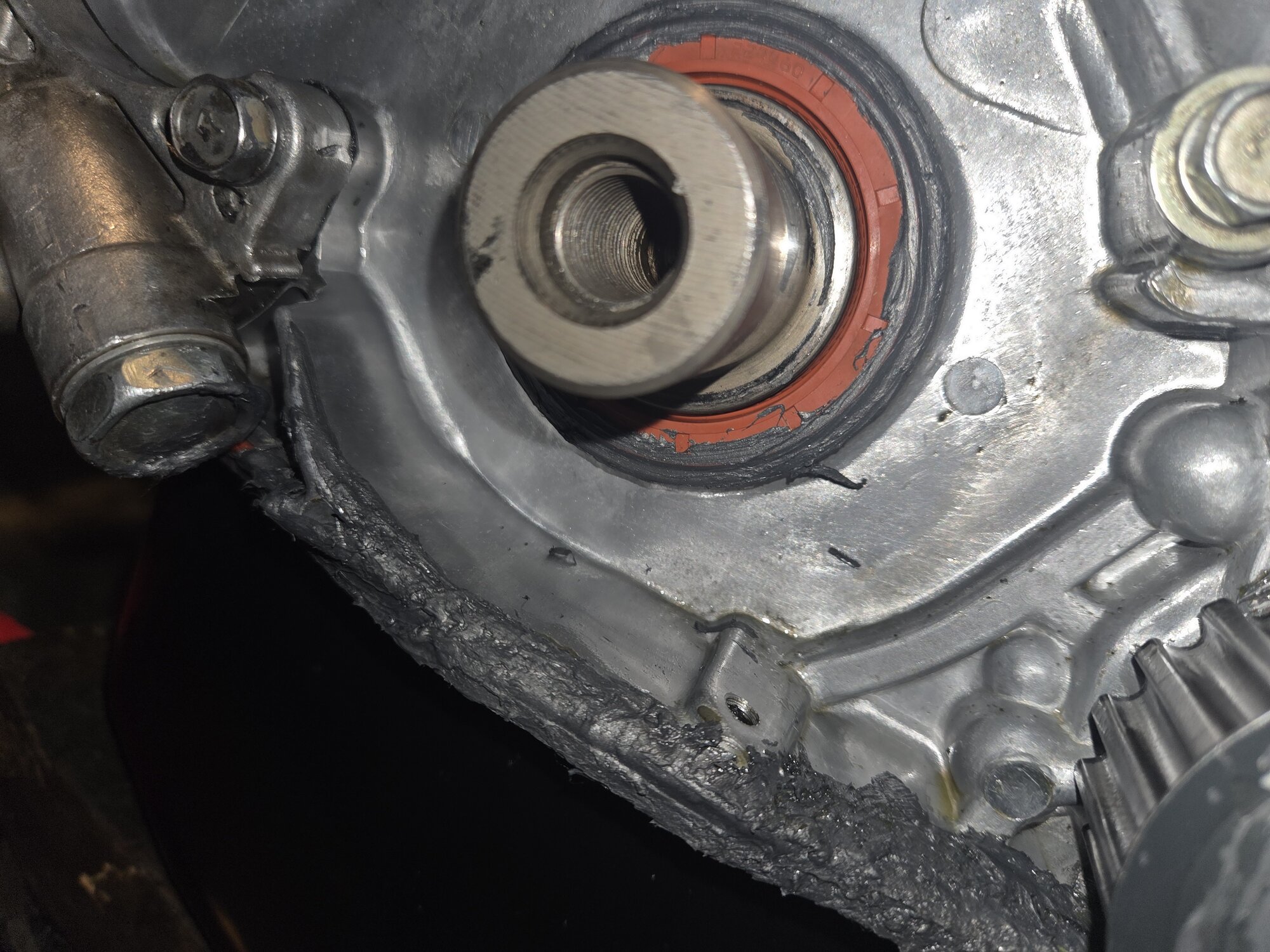

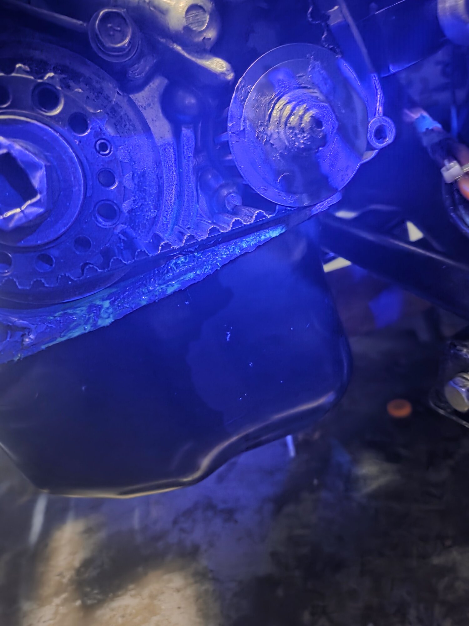

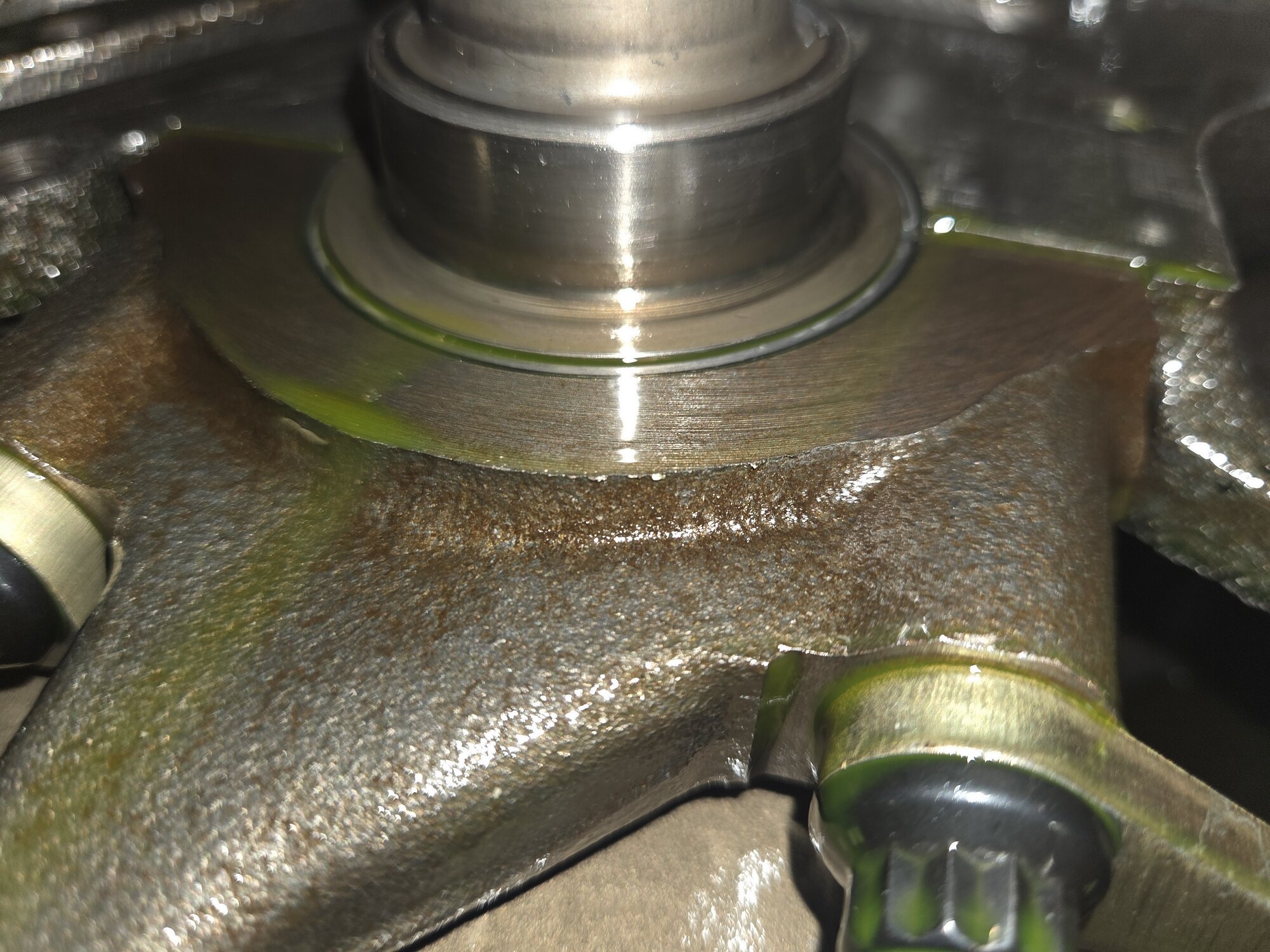

I honestly think all of the previous maintenance I've done was required. The crank seal was once leaking, the crank was once bad, the oil pan was damaged by lip and even using various pan gaskets and rtv to get it sealed.

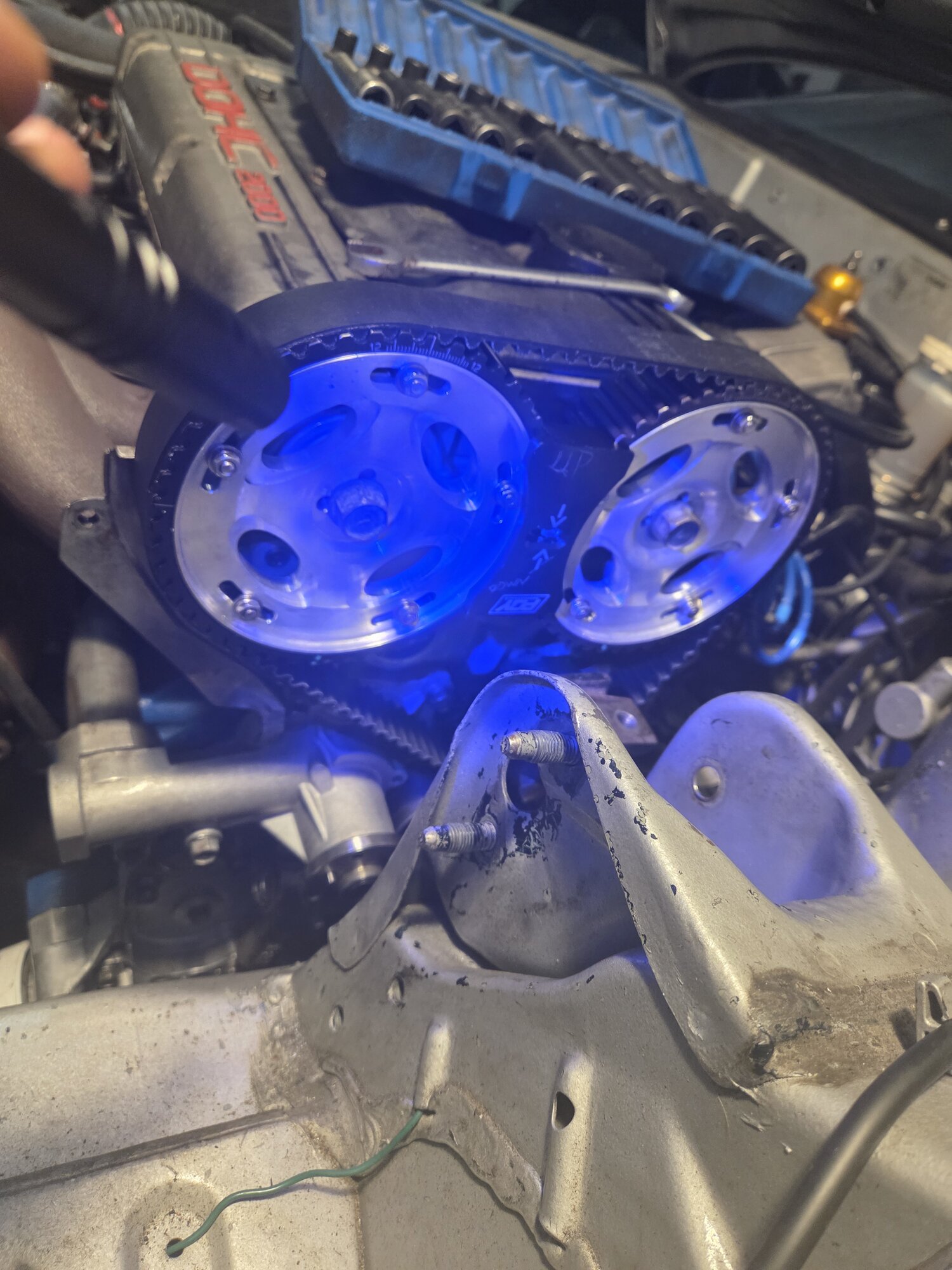

I've primed the oil pump without the belt on before but, I have always had the tensioner on. With everything off, I gave it another try and fresh oil poured out of that hole.
I've read about it many time but maybe overlooked it because it was one of those "rare" occasions but possible. I don't know.

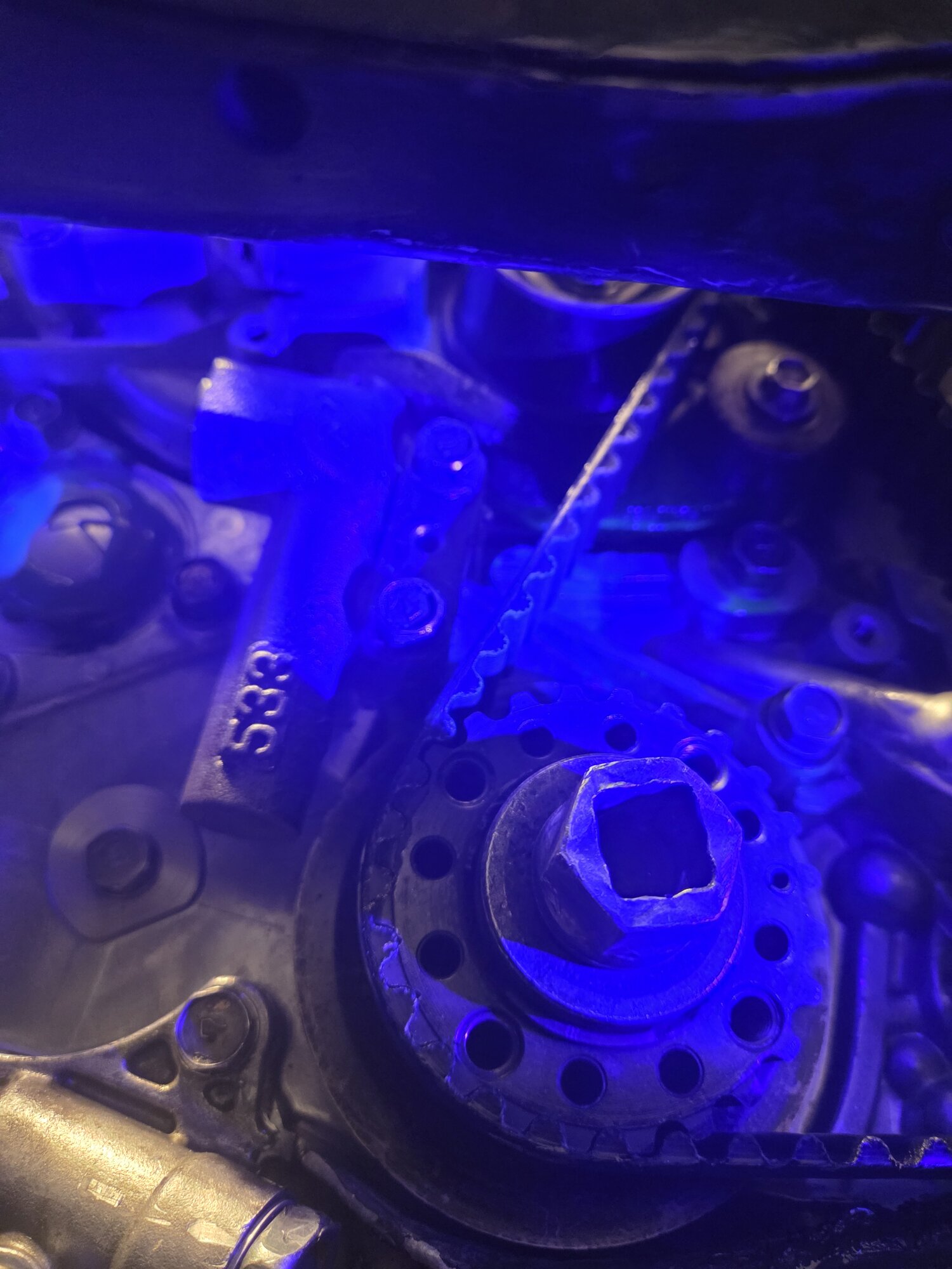

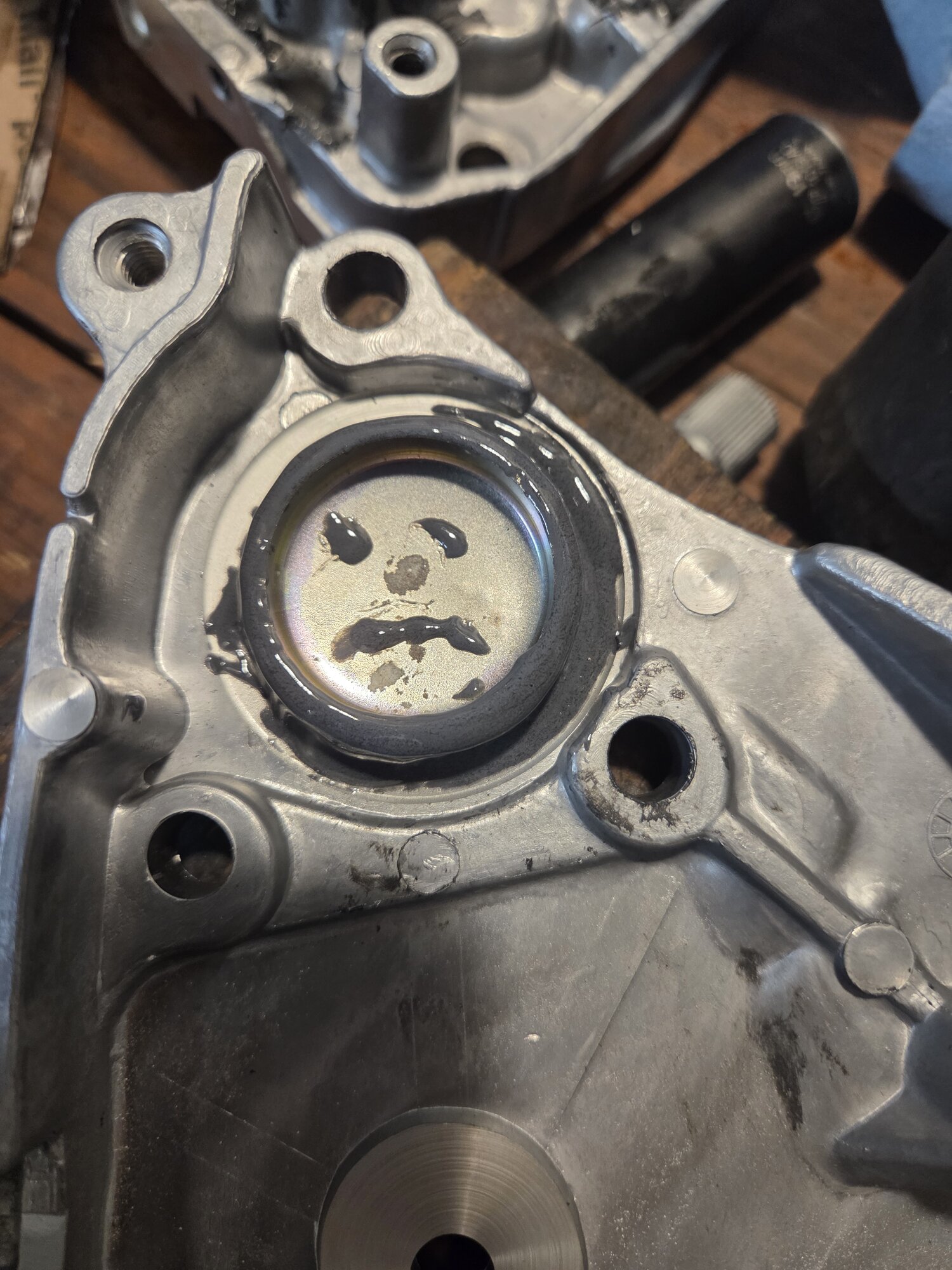

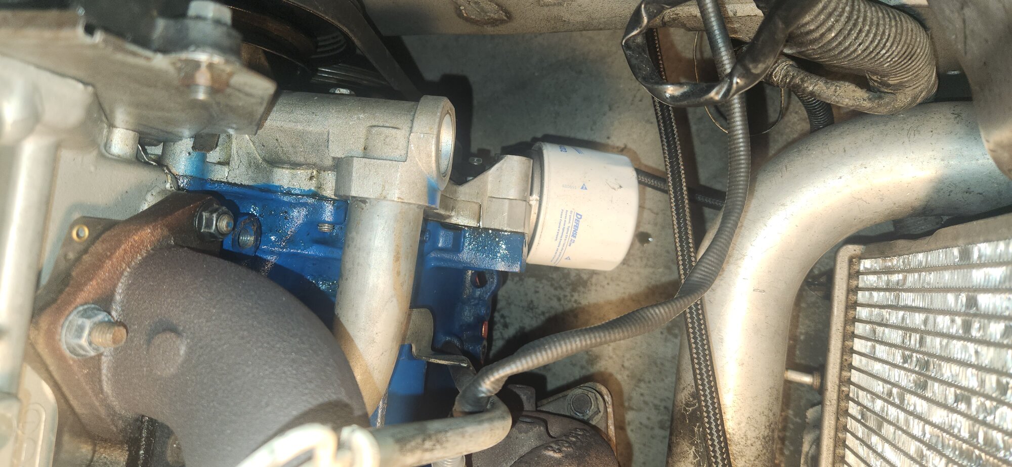

I didn't have thread sealant so I used the yellow tape for oils and gas along with a touch of "the right stuff" on the outer edge. I primed the pump again for a while and I don't see anything bleeding.

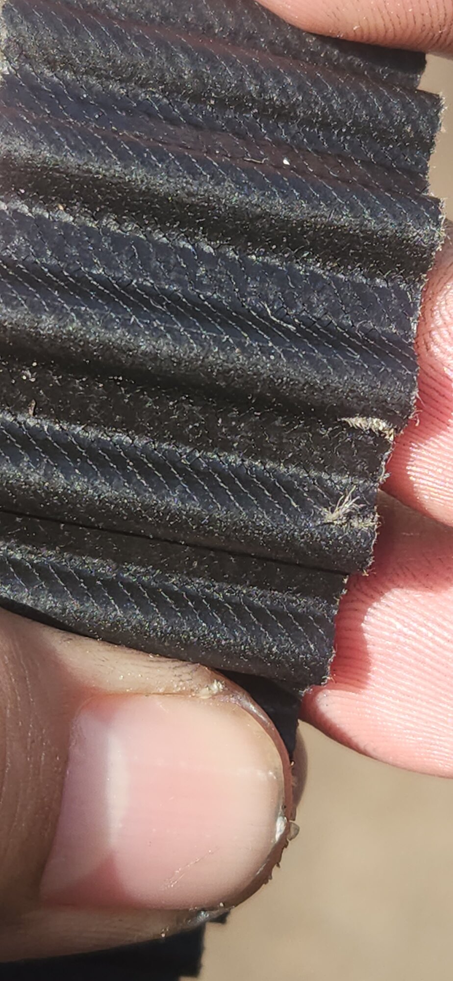

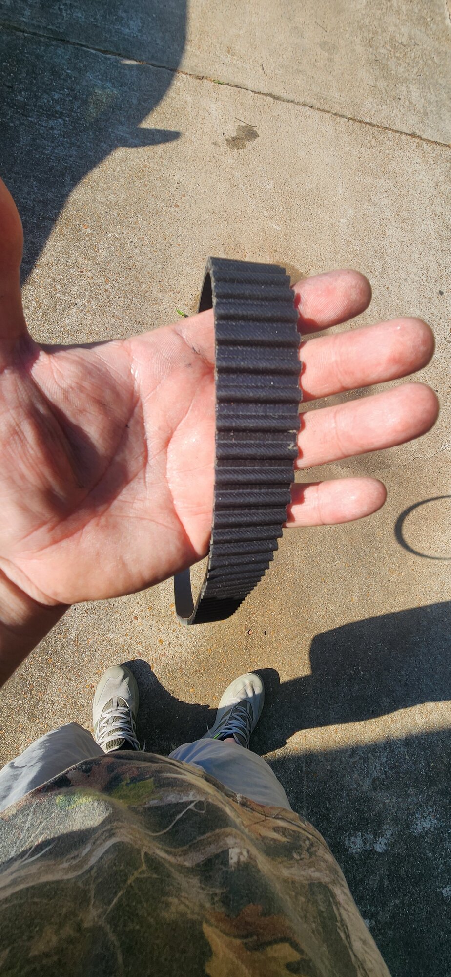

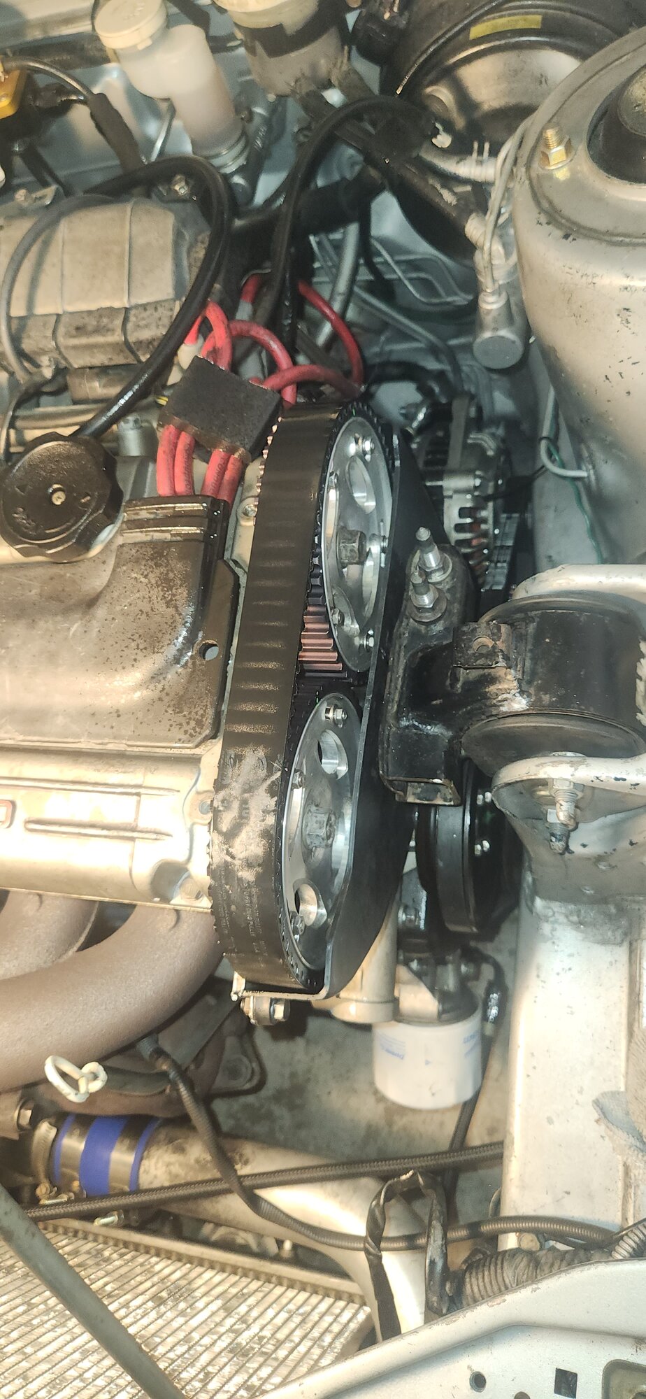

While drying my belt I noticed these threads coming loose. I don't want to take any chances. I believe this is a gates belt. Maybe I'll upgrade or try to find an oem but I don't feel safe with this on. Thank you guys again
Thank you, I'll give this a try!The bolt helps seal the gasket - you need it squishing the front case down. You can put all front case components on without the belt, and do the same test spinning the oil pump to look for leaks. Your gasket "might" be fine.
For sure, I'll add some up there too. Thank you !Oil would still leak from the blue line. You should slightly apply RTV under bolt head too.
The tensioner bolt holes are one common spot to leak. When I see oil seeping from there, I always slightly apply RTV between the tensioner flange and front cace, and the tensioner flange and under bolt head to seal better.

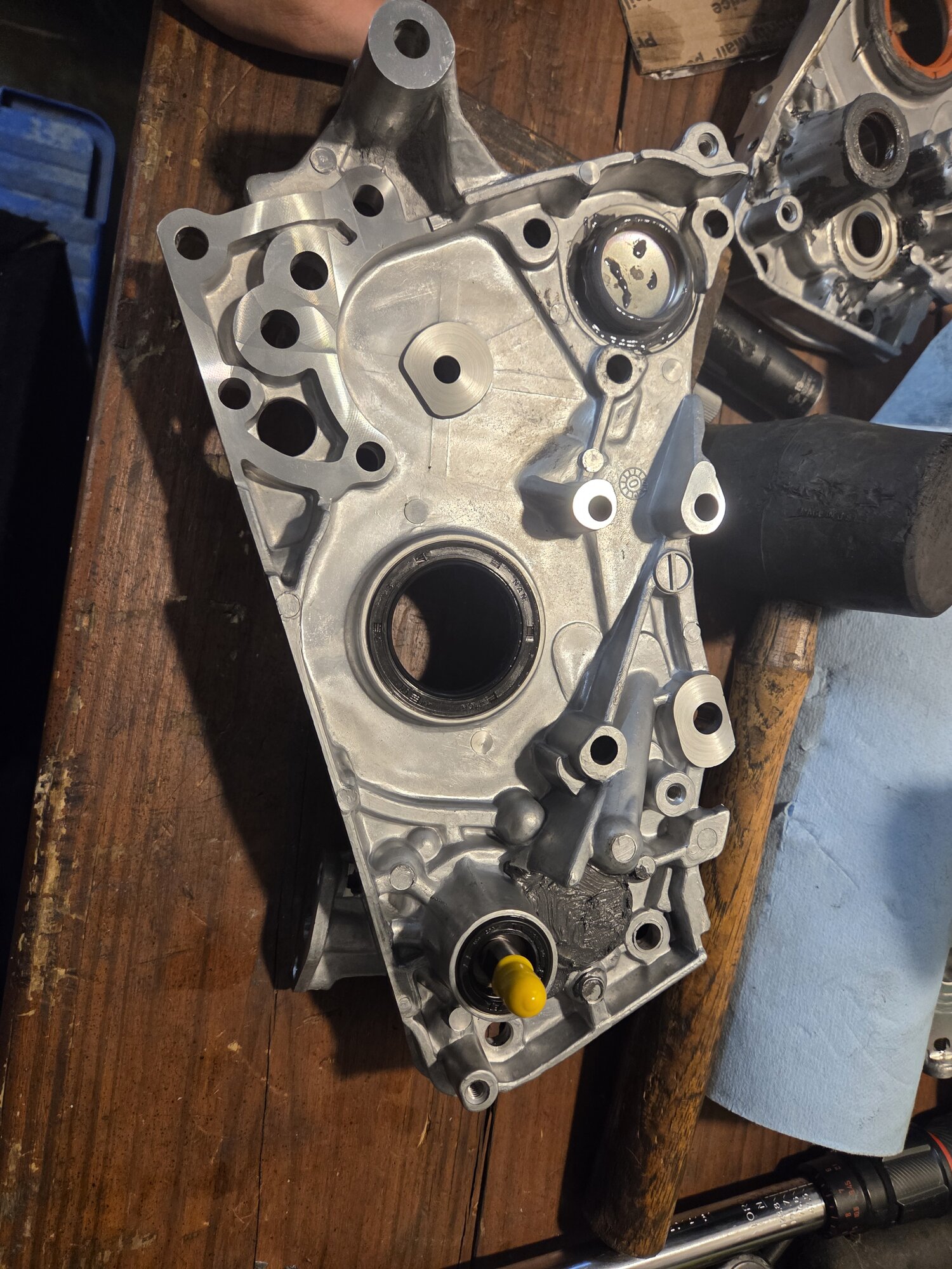

Thank you. I ordered the oem seal from extreme. I had some points saved up so I only had to pay shipping.I think you finally figured it out. You've got to be a pro by now yanking the timing side apart.

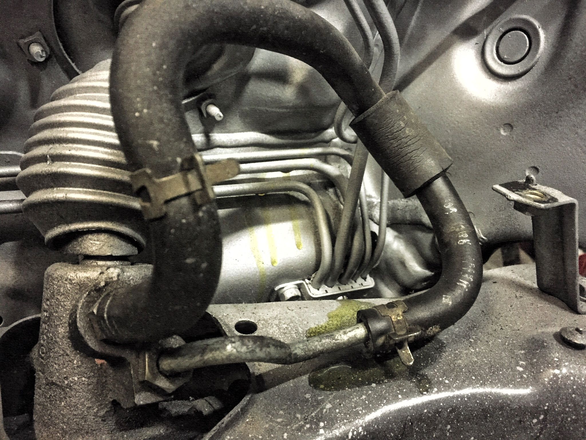

If it gives you any sort of closure/peace, I fixed my power steering leak ( I hope) but I have the world's nastiest transfer case leak. Leaks on leaks, it's what I live for. Your not alone by any stretch.

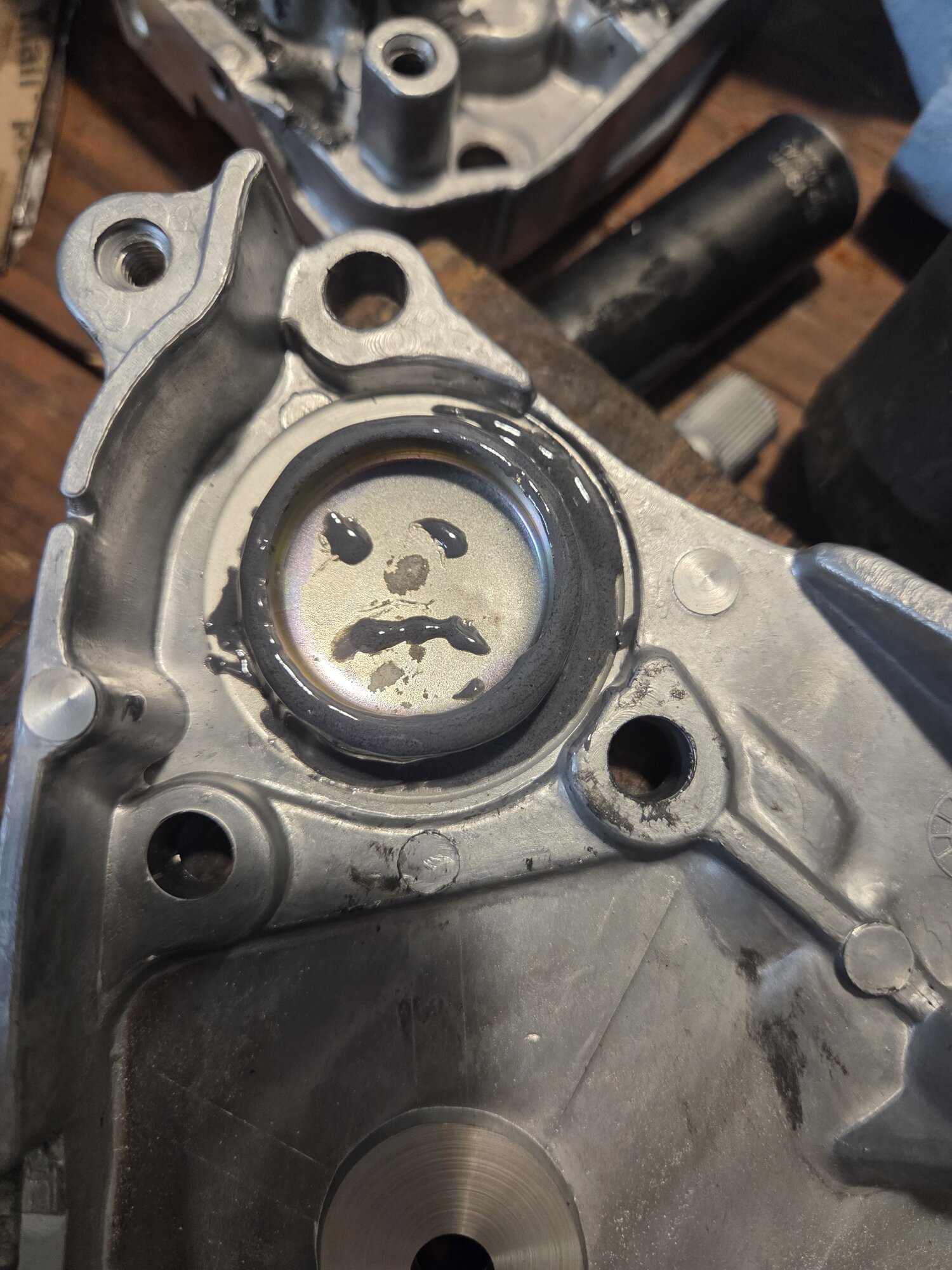

I ordered an oem plate and it was cracked so I had got a refund. Purchased an acl brand again and got the oem stubby in. Rtvd the castle nut incase. I do.have the oem seals but I want to run these first to see what happens.

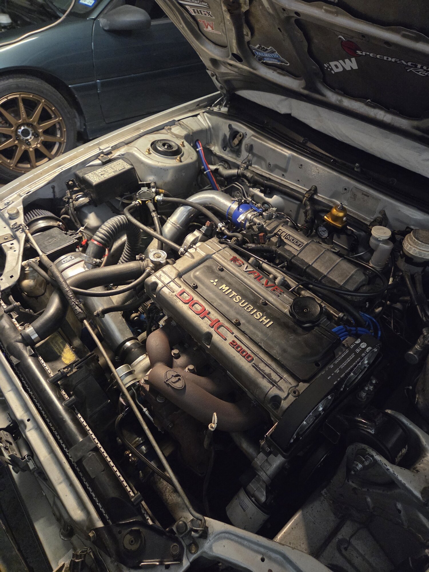

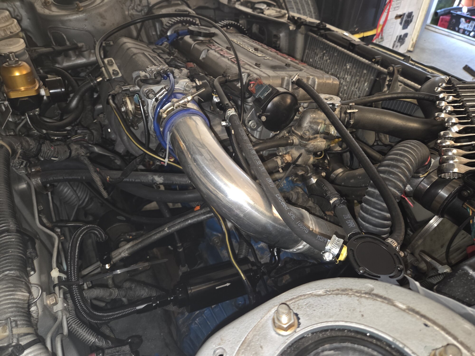

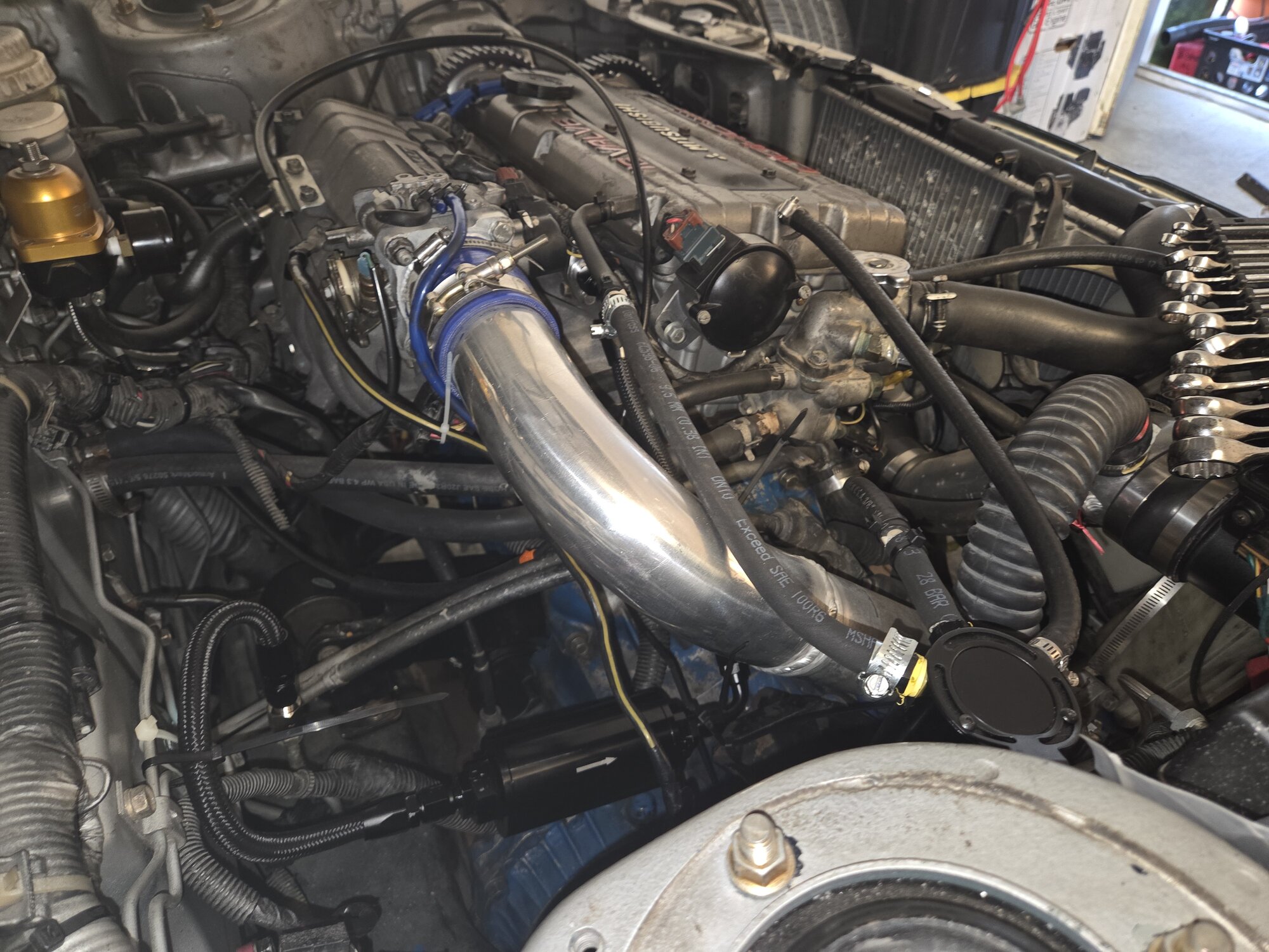

I'll let this stuff dry over night, and install tomorrow. I also installed this new fuel filter and a 40 micron in it. Using the adapters the make our own fuel lines to 6an. So it's 6an from oem to rail. I picked up a rail adapter as well.

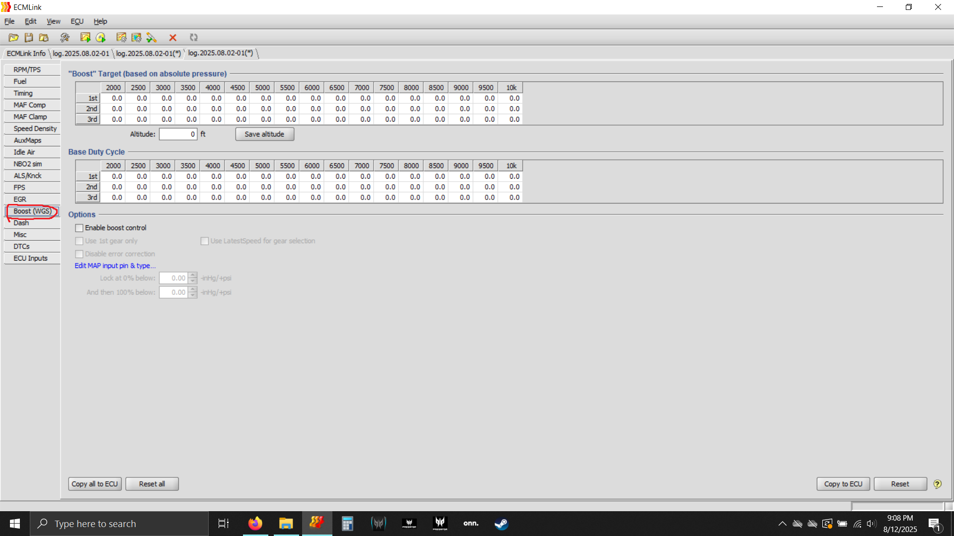

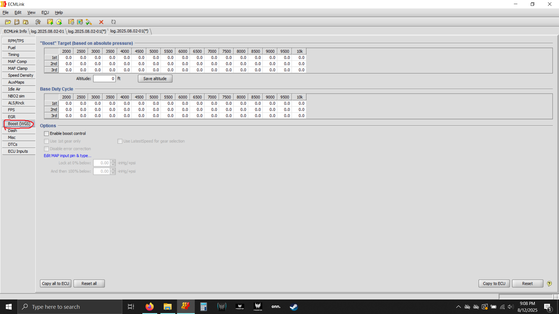

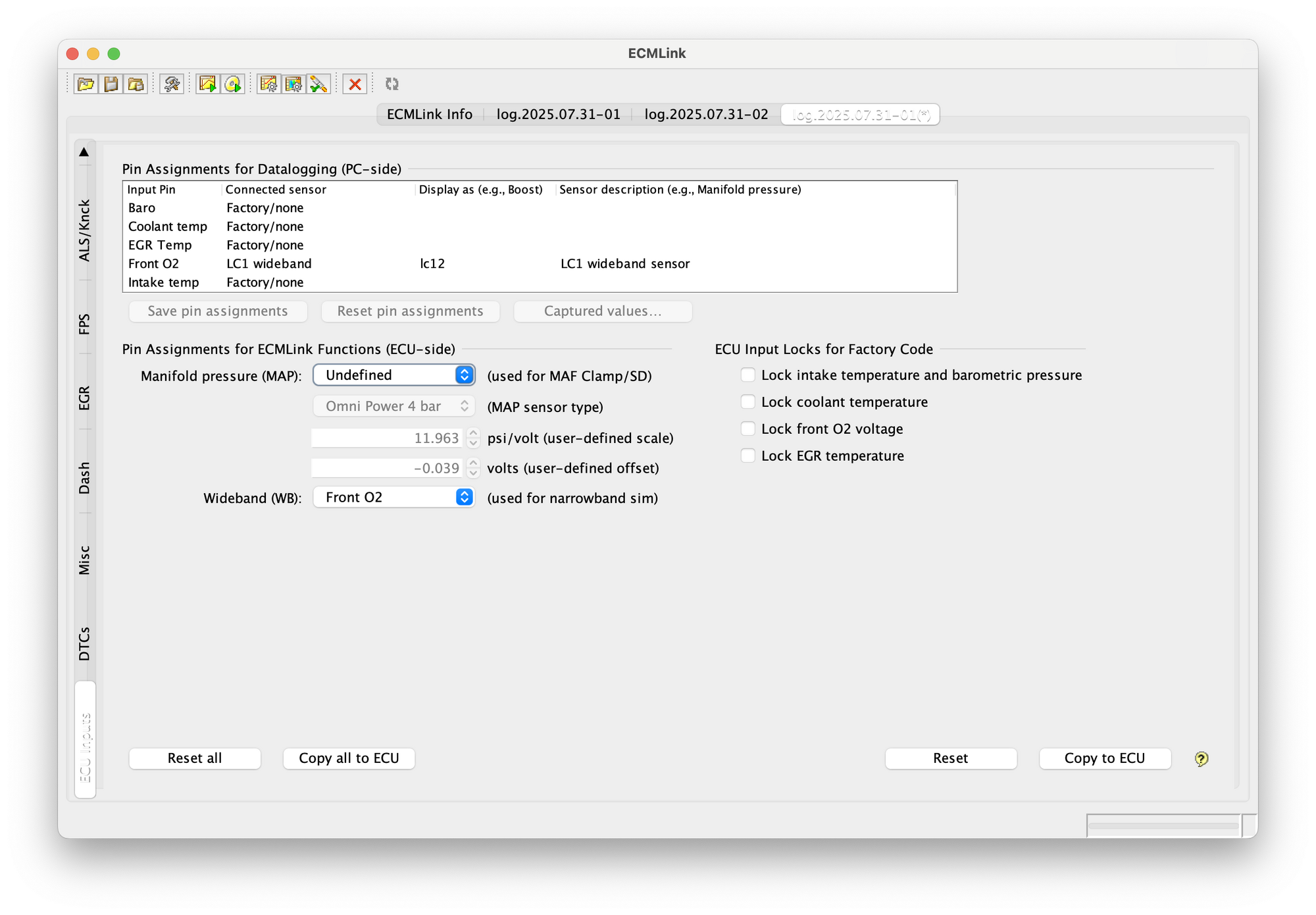

, I want to test drive It this weekend for a good 30mins and record the cruise to see what's goin on.Is it true you can't do boost by gear in a 1g?? I just installed this 3port, and I don't see the options like in the 2g videos, within ecmlink.
If I have to use a manual boost controller, this build is such a waste.
I finally got this car down to 0 leaks. Not a single drop. The issue is this thing is so sluggish, it's trash. I need to get this up to 20# or more. Under 4500, it's boring
5k and the 10lb wastegate isn't enough to push these 280s.

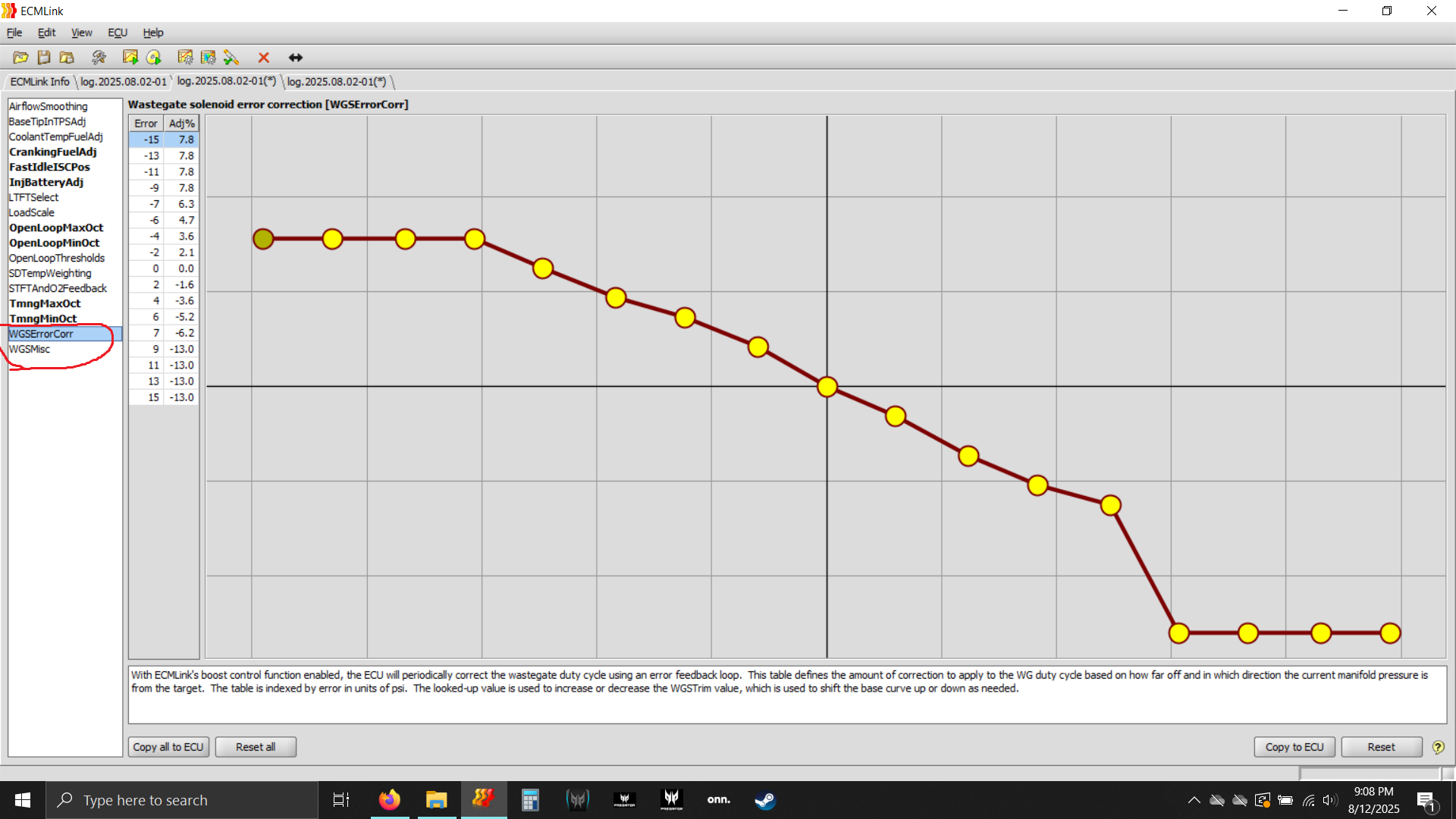

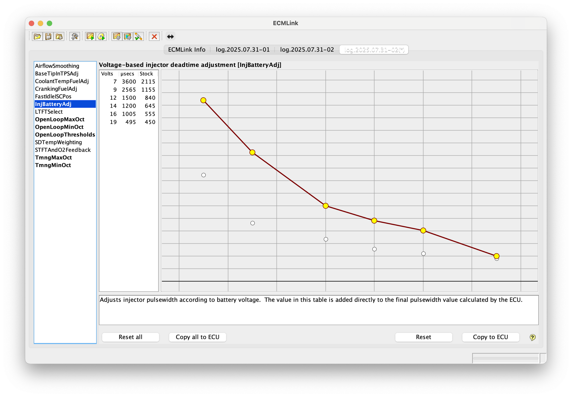

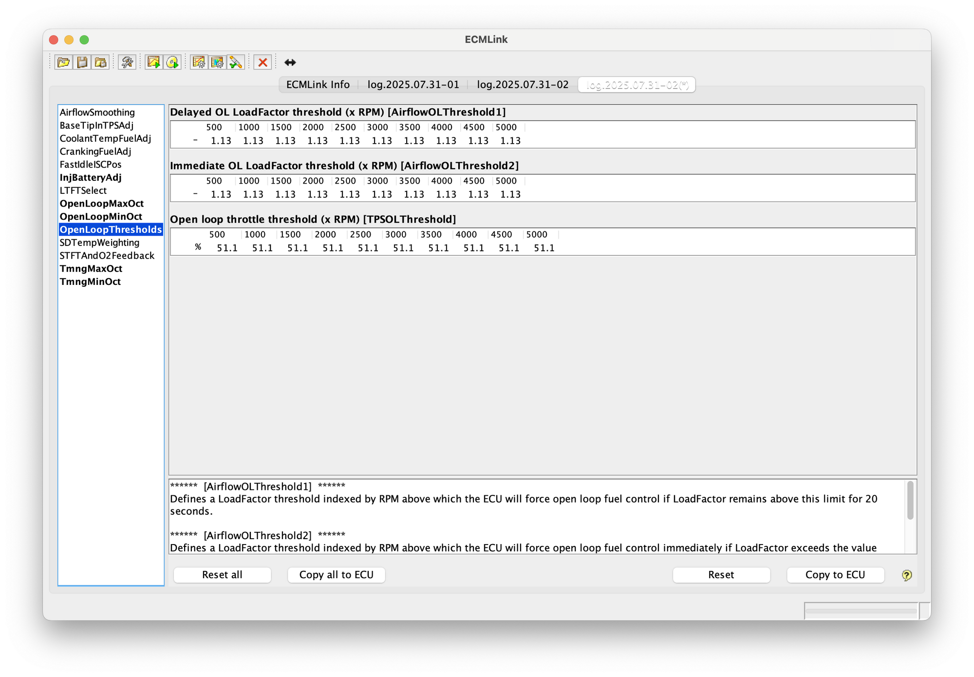

Right on, thank you !!Either update your firmware, or double check you have ECMLink V3 Full and not the Lite version. I don't even see the option for WGS in your DA tables or Boost(WGS) in your configs. Otherwise, you can use boost by gear for 1Gs just fine.
Attached below are SS' of my 1G's ECMLink config and DA tables so you can see what's missing from yours. It looks like you have V3 Lite.
I’m curious - I’ll take a look at those logsIs it true you can't do boost by gear in a 1g?? I just installed this 3port, and I don't see the options like in the 2g videos, within ecmlink.

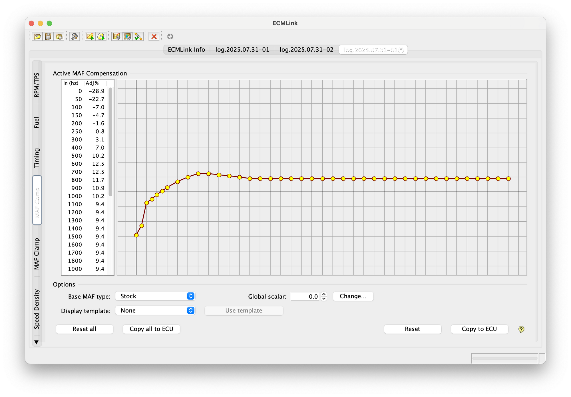

It looks like you have a 2G MAF, but your MAF comp is set for Stock. I think you can use global fuel adjustment to zero out the WOT parts of this graph.i have two vehicles with two different setups. i use the same laptop to adjust whatever is needed. I haven't been able to touch ecmlink in about 3 years cause of this leak.
within the 3 years i've upgraded to a fpgreen from a 16g. Here are some logs Iof this little cruise I did around here. i dont know what the fuc i'm doin and i hate that. can some one look at this shyt and recommend me my next step? thanks
