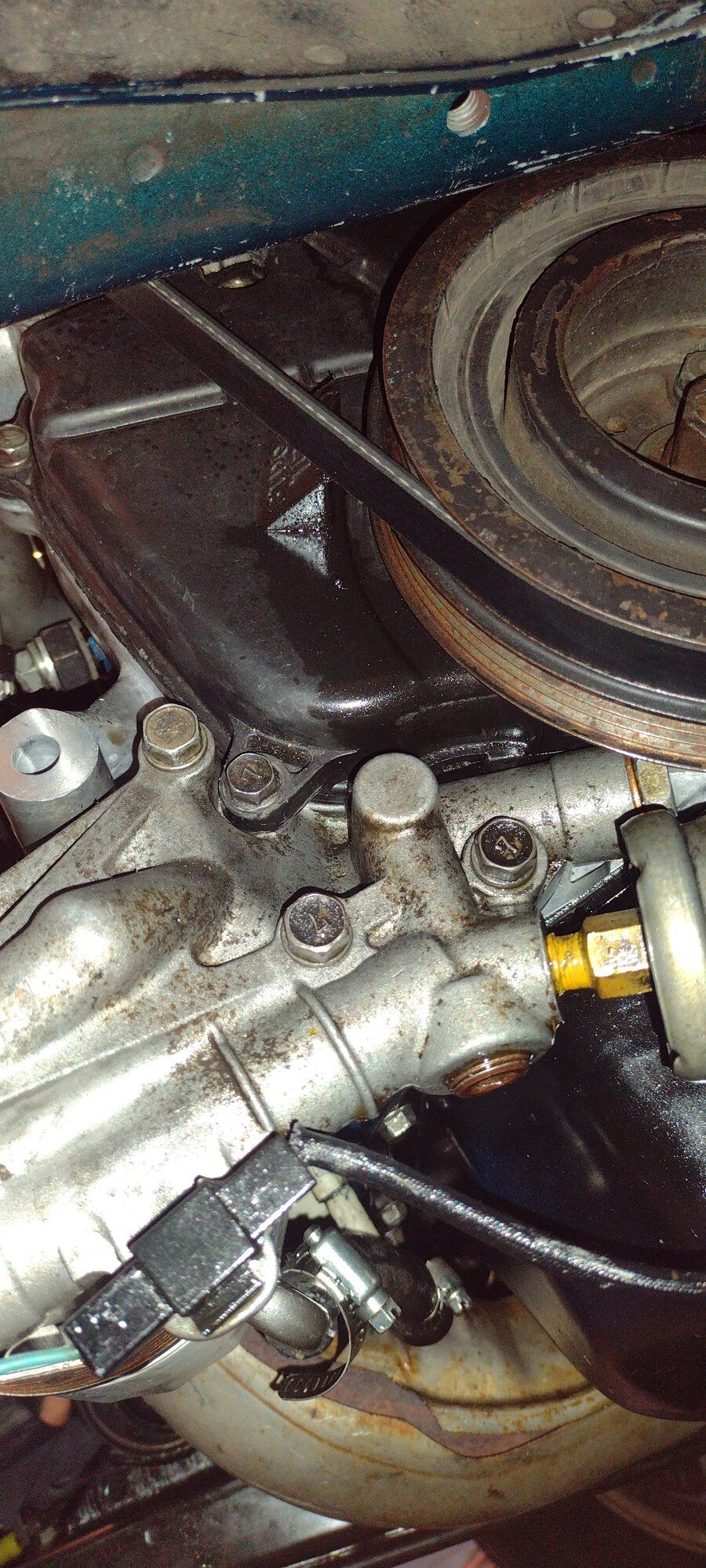

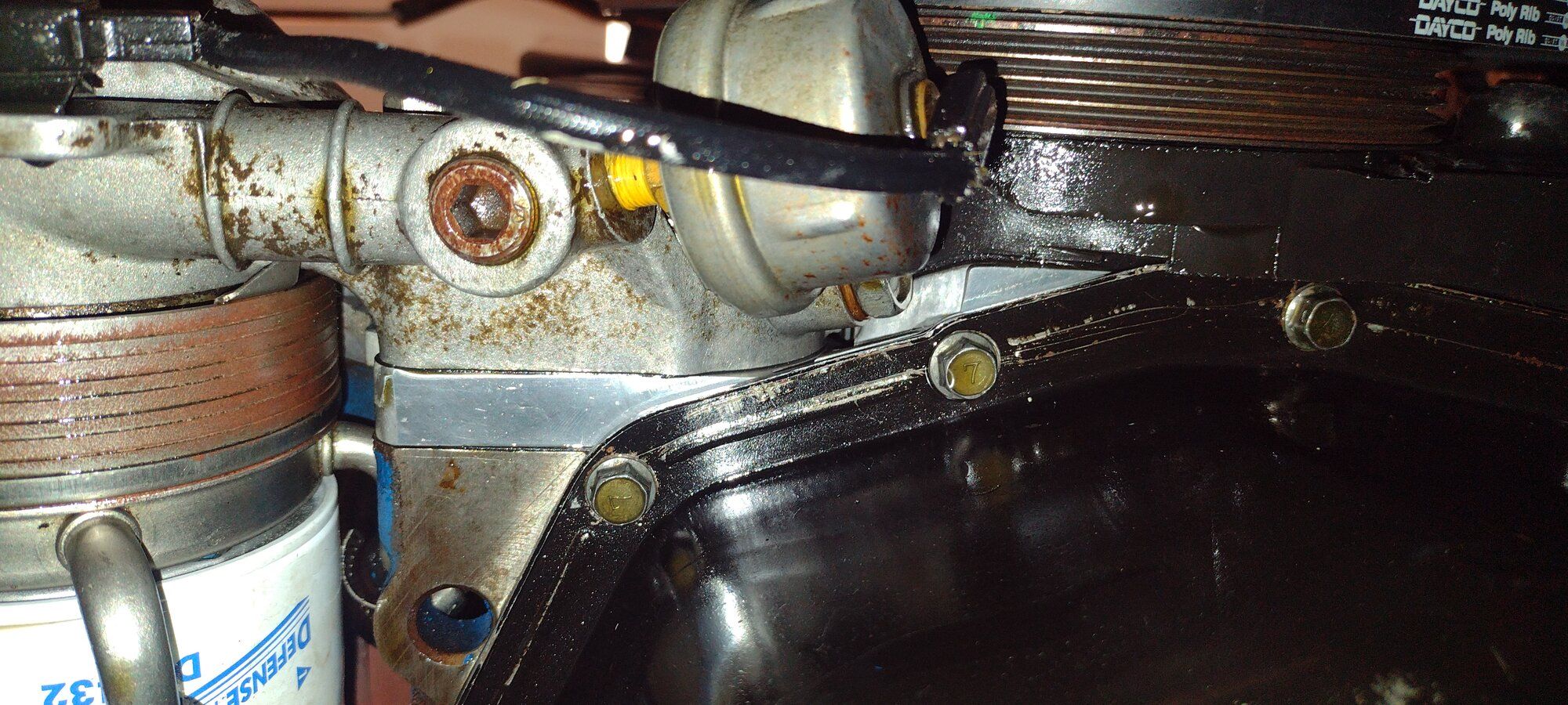

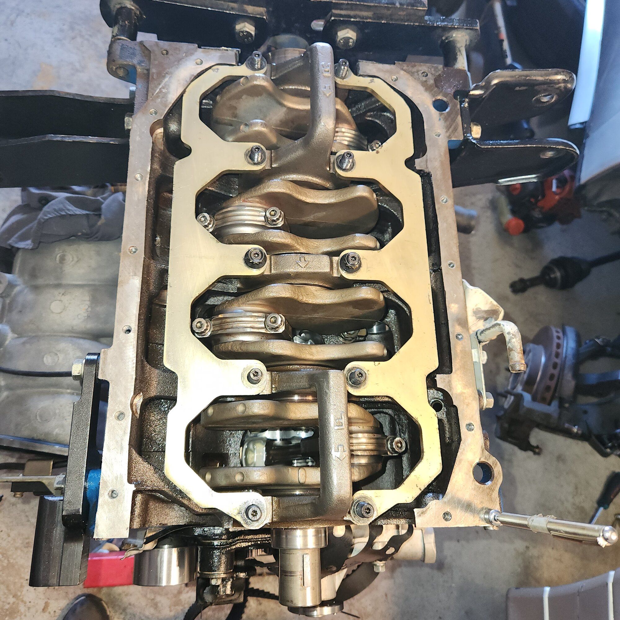

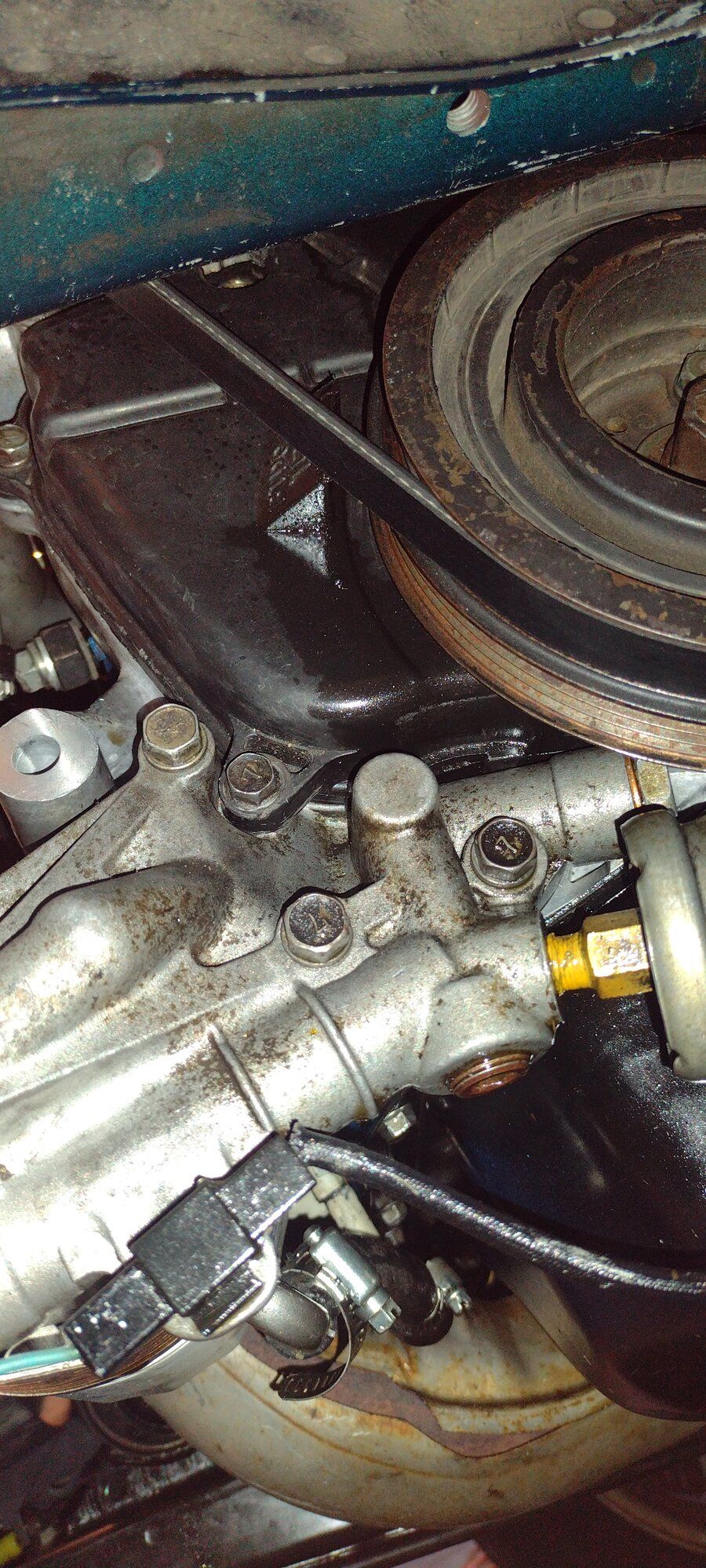

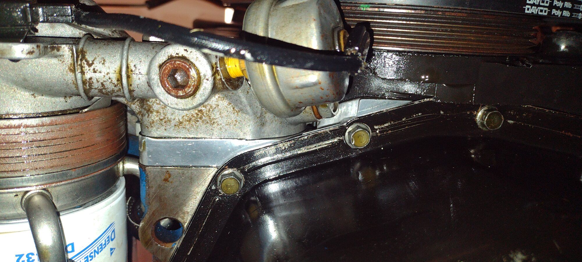

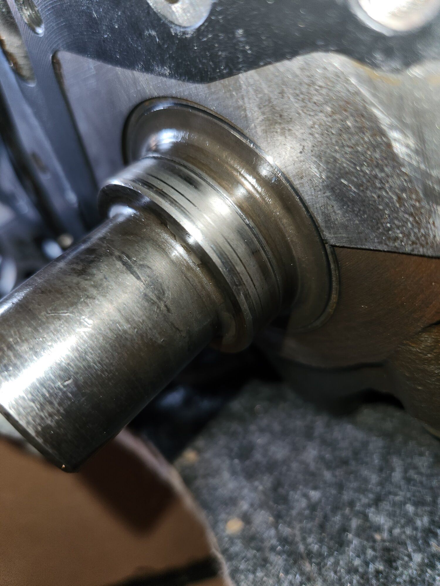

Ive been off and on with this car, mainly because of this Texas heat since April & of course other things around here. I've done a few pulls & with the help of Tony @AWD-Tony , we've managed to get it running fine. There are still adjustments to be done but just been so busy around the house to mess with the car. The few times I had taken it out, there has been no leaks. I took the vehicle out to get some wot logs yesterday( but didn't) and went to my uncles shop to talk to him about fishing this weekend. When I had got home, I went in to open the garage and when I pulled it in, I notice an oil spot again. I didn't care to look at it yesterday cause this machine has got me so discouraged, I've lost a lot of energy to even bother. I took a look at it today and it seems to be leaking in the same area. My timing belt is wet, not soaked & I believe my crank may have some scoring which is allowing the seep/leak of oil from the main seal.
I wont get rid of the vehicle but I know I need to replace this engine or possibly the crank. I'm going to need some professional help from a shop that can check my remaining cranks, and blocks. If I can't piece anything together, i'll be looking for another complete engine &/OR another 1g vehicle. whichever bundle lays out in front of me

I feel your pain. This is one of the more tedious spots in the car to diagnose and repair. Do yourself a favor, take a deep breath, and step back for a sec.

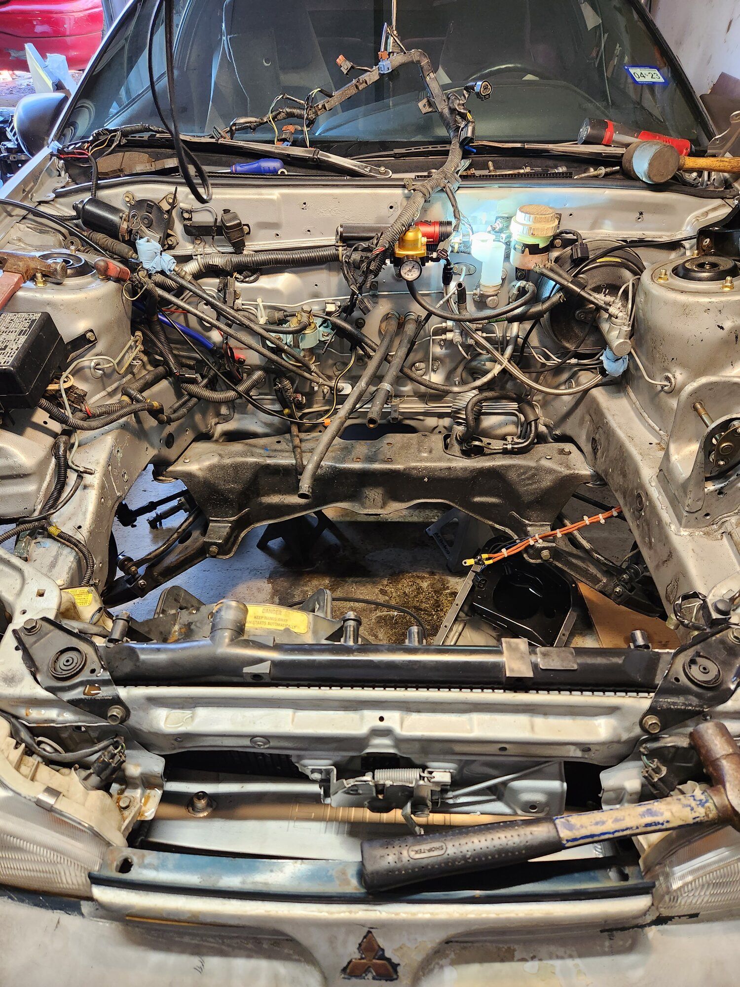

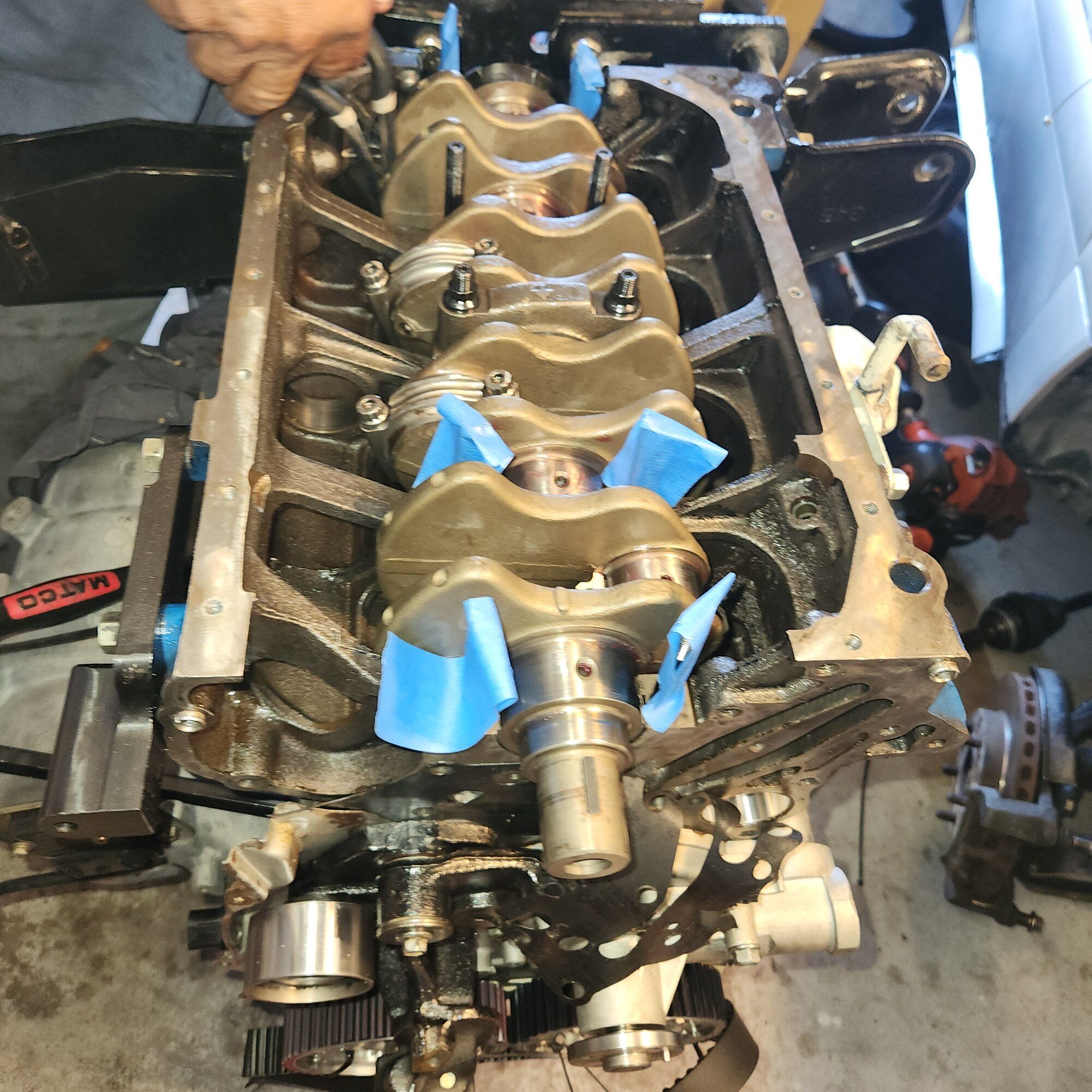

Well, I just finished pulling the engine. I have a spare crank that is within oem specs and is going to replace what I have in there now. I'm still searching for some front sleeves that'll fit the worn crank. I know I'll find it here soon, just ready to jump back in this machine again.
I made a list of things I need to touch up and replace before I put it back in. This time it'll be even more ready and that much better. I'm debating if I should get that fp exhaust manifold that everyone has or just keep using this unknown tubular. After this fix up, I should be able to push it where I had plan. I was barely running 10lbs and was having a blast.(I'm still new to this turbo stuff) but, I'd love to get it to the 18lb+ region. Anyways, I'll keep yall updated as soon as 🤘

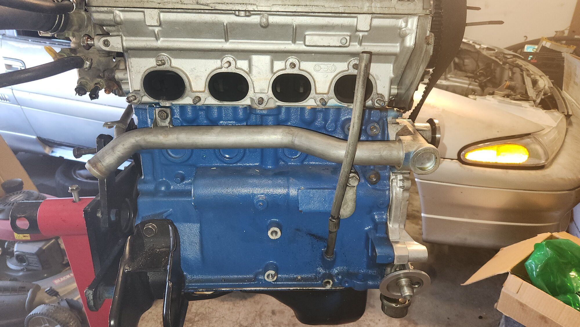

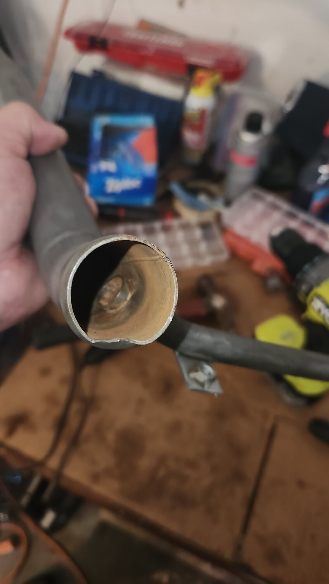

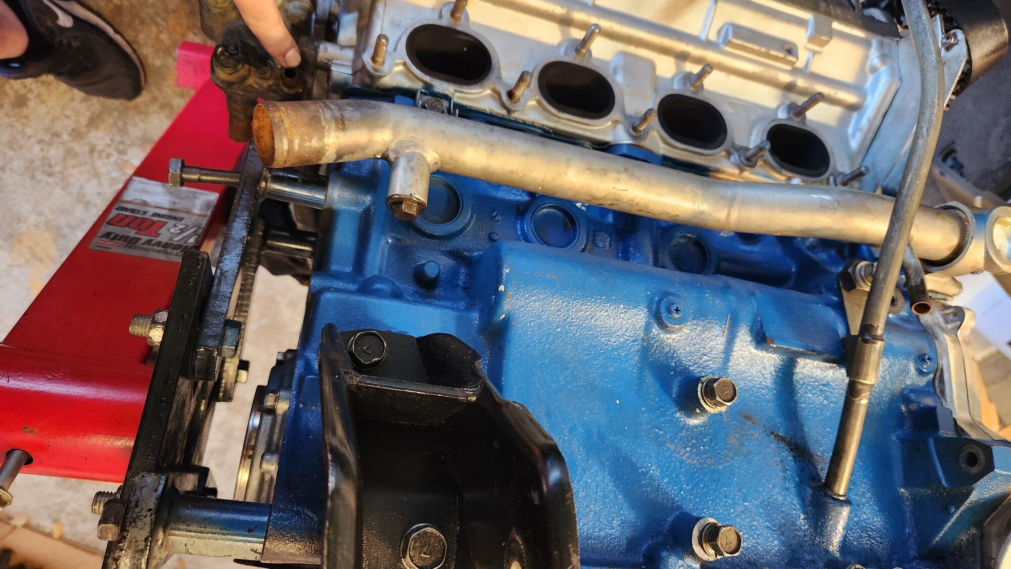

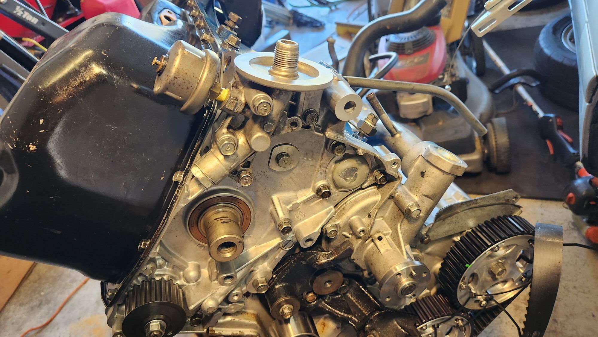

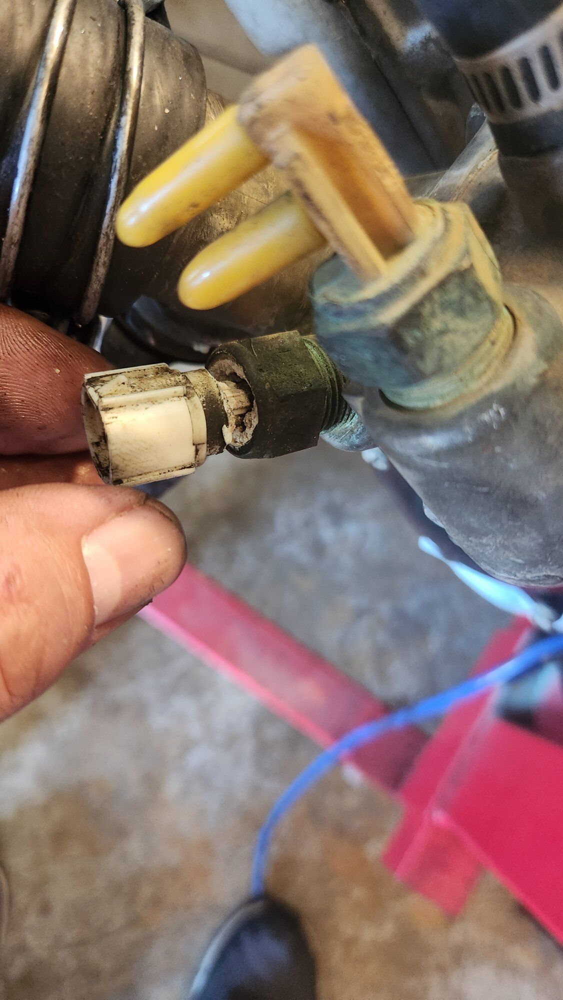

I Put the pan on w a new gasket, ofh is on/replaced with new gasket(got rid of water cooled model), removed hard water lines and put back the rear seal. I do have a stock water pipe with no nipple to exit but it's kinda dirty/rusted and I don't want to clean it up. I can run the hose back to the thermostat housing from water pipe but it'll look crazy and may touch the manifold,etc. I rather plug it at the housing and use a water pipe with no exits. I'm going to search cause I think I seen an aftermarket one somebody made for the 4g63. I need to find out which sensor this is and replace it. I'll start on the timing side tomorrow 🤘

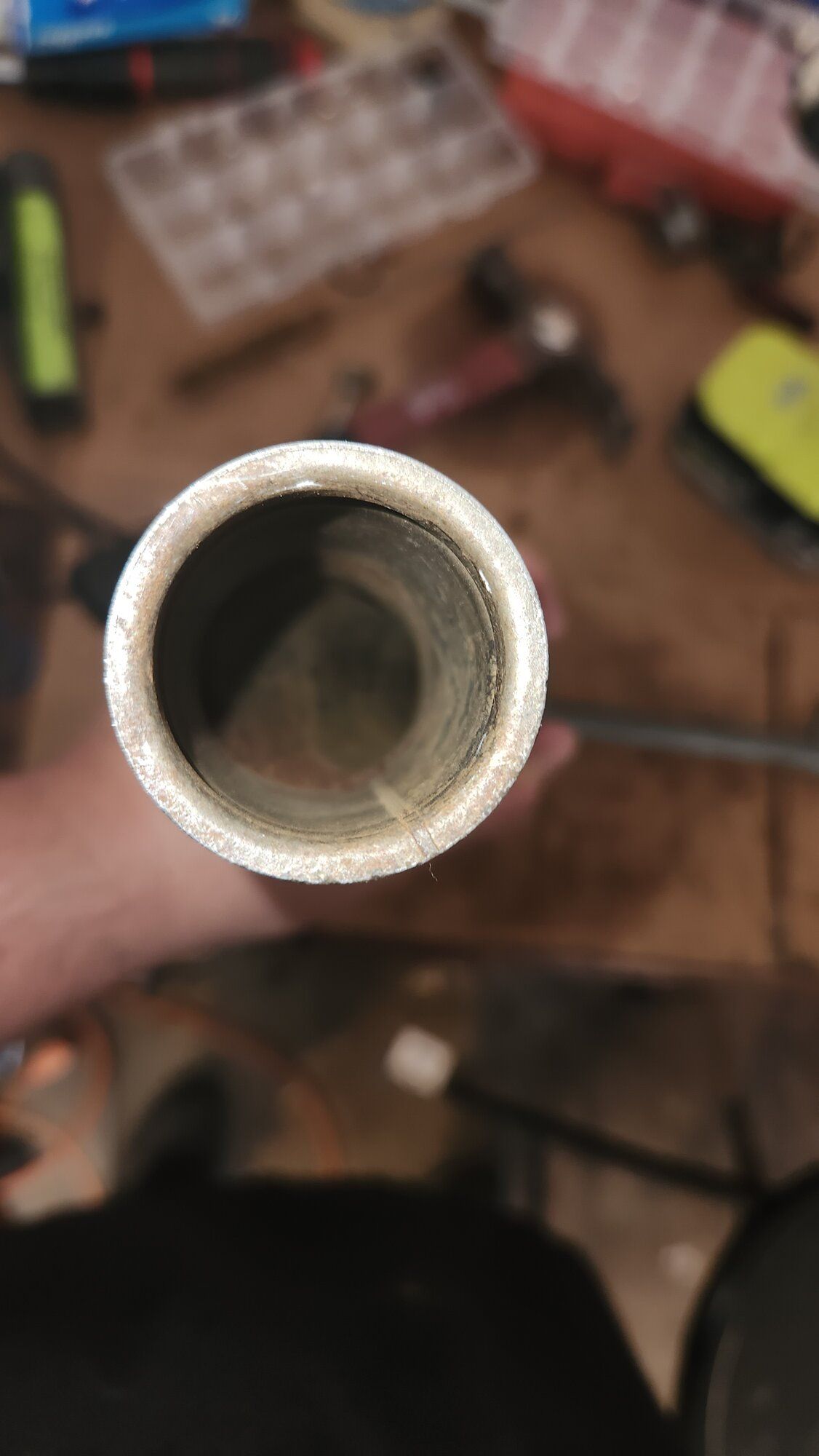

I decided to just clean up a water pipe I had laying around and install it. I didn't get to the timing. I was taking my sweet time making sure this thing was clean and all the major rust or gunk was out of it. I saw the aftermarket water pipes at around 300+ so it was a great motivation to stop being lazy LOL

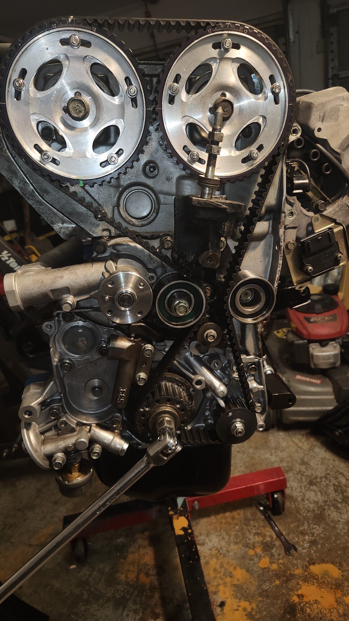

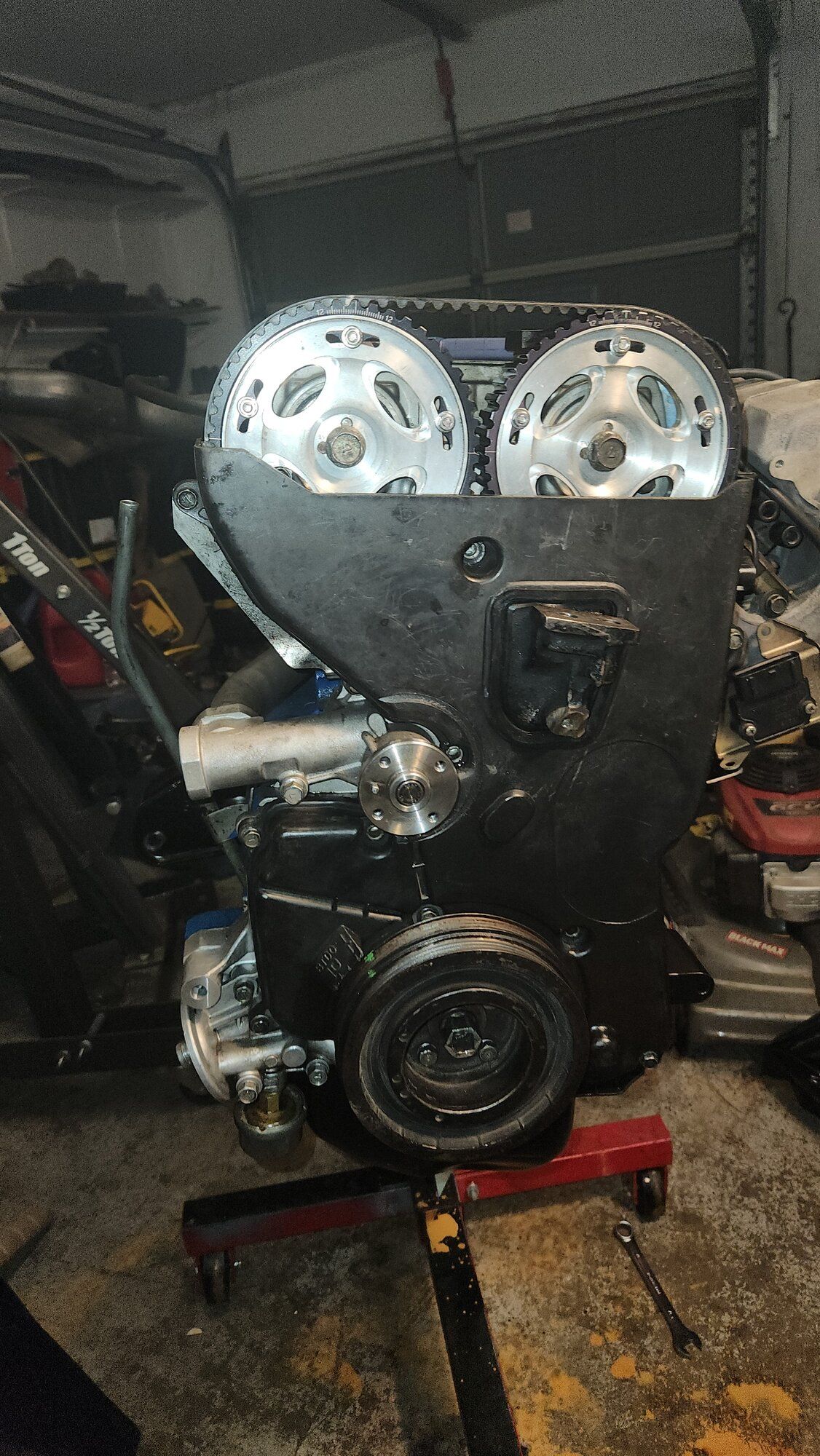

For your consideration :
You "might" opt to leave the timing cover/belt off until you have the oil system hooked up. I like to hang the motor in the car, oil lines connected, and then I put an electric drill with pivoting socket head on an extension so I can crank the oil pump independently and check for leaks/oil pressure.
Also - as you are in 6-Bolt - 1G land - you "might" also what to consider cutting the timing belt cover into two parts, so the mid cover can stay on with the motor mount parts.
Like so:
And now would be a good time to add a Kiggly crank angle sensor - 2G ish.

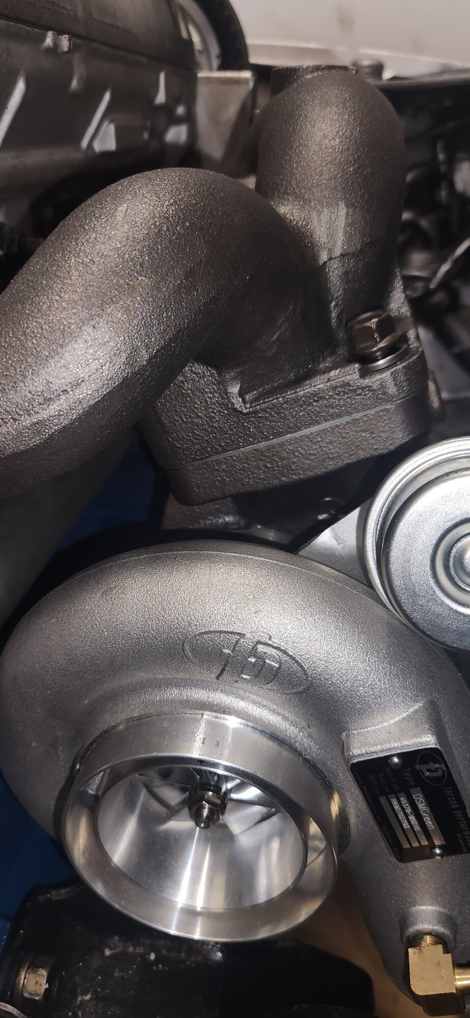

Dealing with a family emergency for the past two weeks. I need to go check/pick up my transmission. I did however pick up an fp green to replace the 16g. With the 280s and fp green, my power band should show some results on the top end. I didn't get to push the 16g but I feel this is the next best move to utilize what I have inside this machine. I'm nervous and excited.

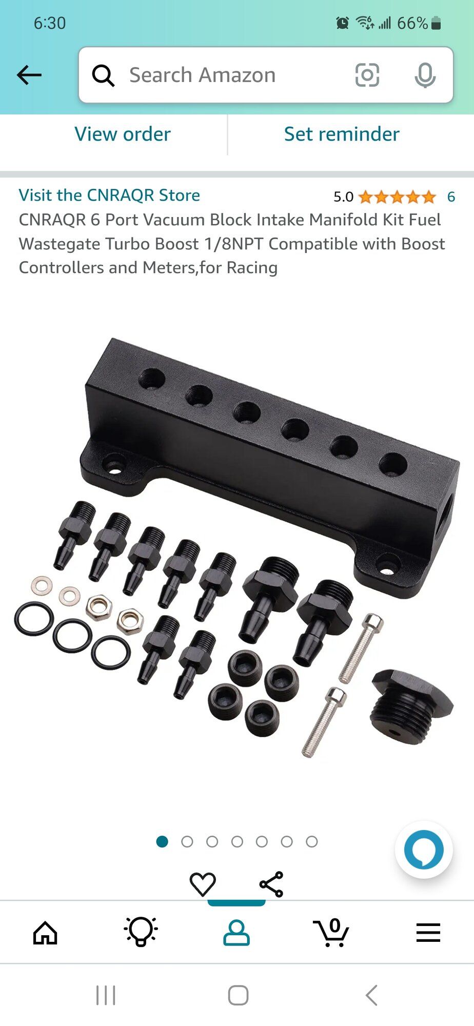

i dont want to take my ofh off and port it. I read justin recommends a restrictor and marty and a few others recommend me remote mount a vacuum block to feed it since I'm using a forward facing ofh.
I'm guessing I need to purchase the 110$ feed kit off fp site and have it run to this block I just purchased from Amazon.
Vacuum block
The fp feed kit is a 4an and I don't know how to measure the end of this vacuum block to find which adapter I need to purchase to make it accept a 4an line.(the larger port). It comes with one cap, plus i can add back my dummy light, a proper oil gauge and feed to my turbo. I hope this is the correct way to do it. Maybe I need a pressure gauge to read what the overall pressure is running to the turbo? Has it always been this tideous to run an fp green?
