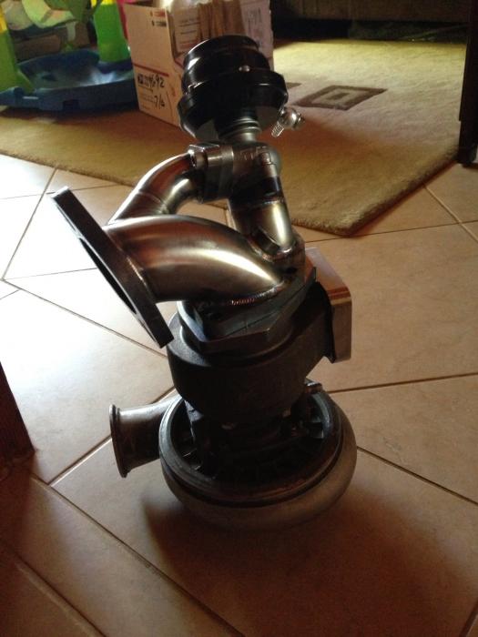

Well boys and girls, I've been extremely busy collecting and buying parts for my new motor build, trying to keep build to a 3k budget but may go over a bit. So far things are going good and I almost have all the parts I need to assemble motor and drop in. I have a .20 over block that I will run venolia race coated pistons attached to crower billet I-beam rods, acl race bearings and oem polished crank and balanced rotating assembly. This will be paired with a built 1g head that has been ported and polished and has +1mm ferrea valves, kiggly hla pressure reg, fidanza adj cam gears, crower springs and titanium retainers, new brass guides and supertech stem seals, bc272's, held down by L19's smashing a Mitsu mls. To get the flow thru this head I scored a 1g jmf drag smim w/ Q45 90mm TB, 3" ic piping going into big fmic. Turbo for now will be a holset hx35 w/ .55 bolt on bep housing and to keep up with that I got some FIC 1050's. Also added to the list complete fuel lab upgrade consisting of, fuel lab afpr and (-6an) lines a fuel lab 585 filter with (-8an) lines either running thru stock fuel line or upgraded (-8an) lines, also have aem high flow fuel rail. The rest is new oem gaskets everywhere, new front case and gears with bsek, and arp everything else I can get LOL and a ffwd ffofh, fluidampr crank pulley, and mtx-d oil pressure and temp gauge, ecmlink upgrade to full v3 and SD kit set to run boost by gear. I'm still unsure if I will run VP Q16 or get a meth kit and see how that works out. Once all the parts I ordered get here and rotating assembly comes back from being balanced I can start assembling and blue printing motor. Well that's all for now, will update again soon when all parts are in and I start assembly. :)
It has begun my friends!! :hellyeah: I purchased every single part for my new motor build. I did go over my budget but not to bad I was trying to keep it around 3k but spent 5k. Which for what I'm doing isn't bad at all, and once I sell some of the parts I won't need I can recoup some of that and be around 4k spent. Ill be updating my profile with all the info once all the parts arrive and I'm done building the motor. I plan to fully gut the engine bay and clean it up, I've never had the motor fully out only trans so there's 240k of grim and grit all over LOL. Anyway so far I got in the mail my fic 1050's and fidanza adjustable cam gears. I also have had my holset hx35 w/ .55 dsm flange bep housing In my closet for a while its got a fresh rebuild and is ready to boost. :) more updates soon and picks of parts and the build.
Well after much thought I've decided to sell the gst with a fresh 0 miles motor. My plan now is to take my built motor and all my performance parts off the gst and swap them into my 60k 98 talon tsi. I feel this is a good move for me to keep the lower mile car it also is alot cleaner than my gst. I will however keep the 2gb bumper and lights and rear hatch with high rise wing and paint match to the talon. This way if I want to rock the talon look I can and if I miss the 2gb eclipse look it will be a easy swap to have it again. :) more updates and build pics coming real soon! :) lots of parts came in this week so once rotating assembly is back in my hands I can start building the block. Fic 1050's and fidanza adjustable cam gears. 1g jmf drag smim matched with a 90mm q45 TB.
