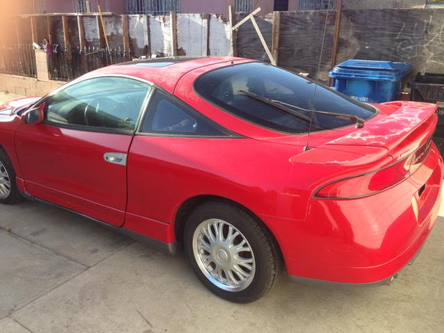

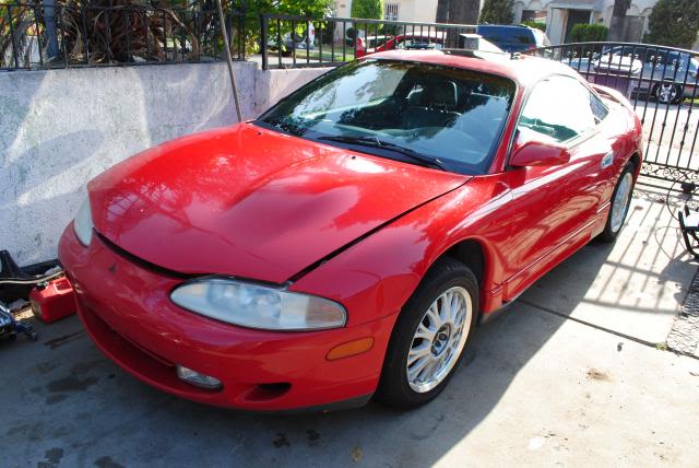

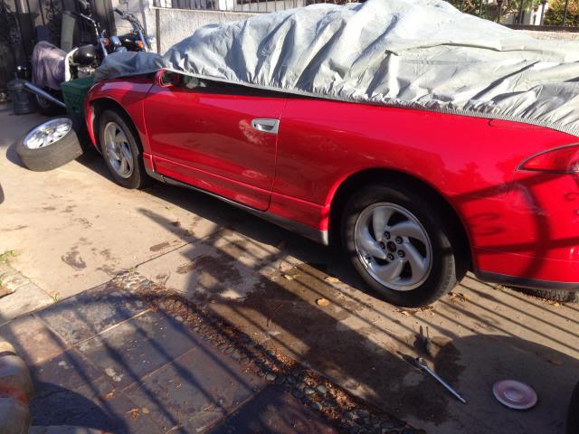

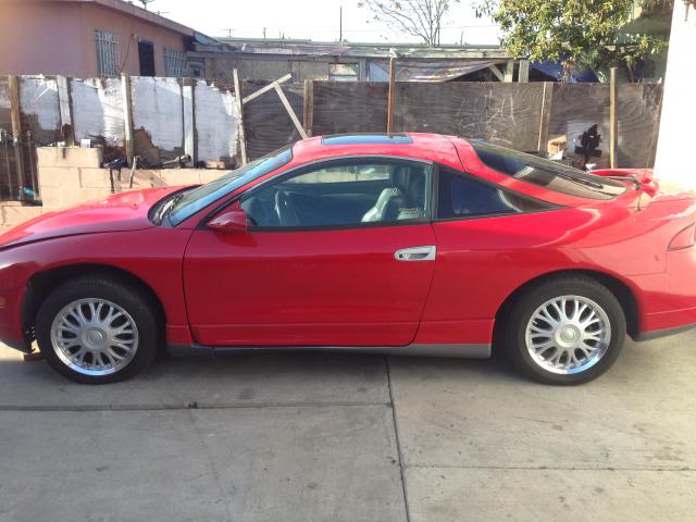

the first day i went to check it out.
yes the wheel are coming off and searching for the oem wheels.

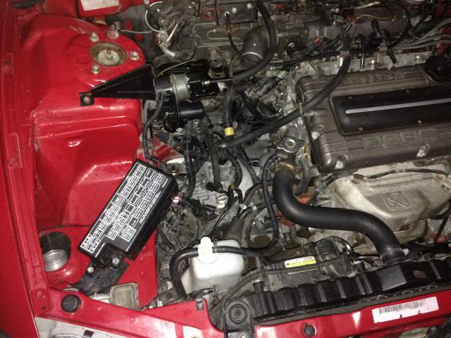

so far what i have done to the DD

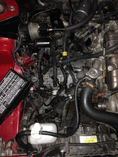

the car came with no transmission / axles so all that jazz is in transit as we speak but aside from the obvious everything else looks in good condition.
don't judge the 2x4 was not my idea was already on the car when purchased

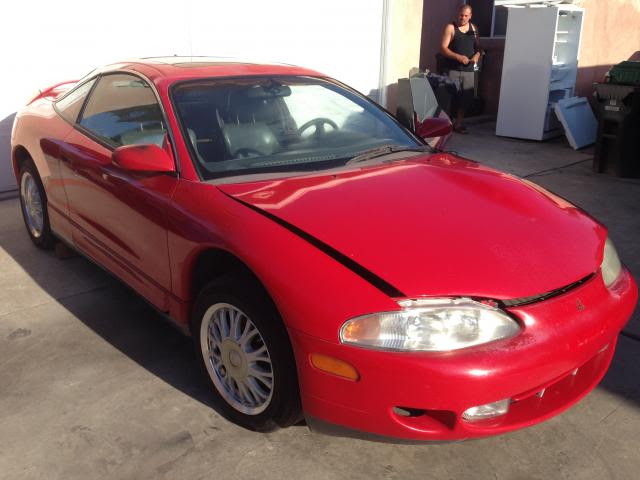

here it is at my house after a couple of replacement parts and a good pressure wash

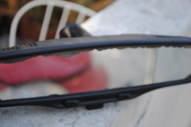

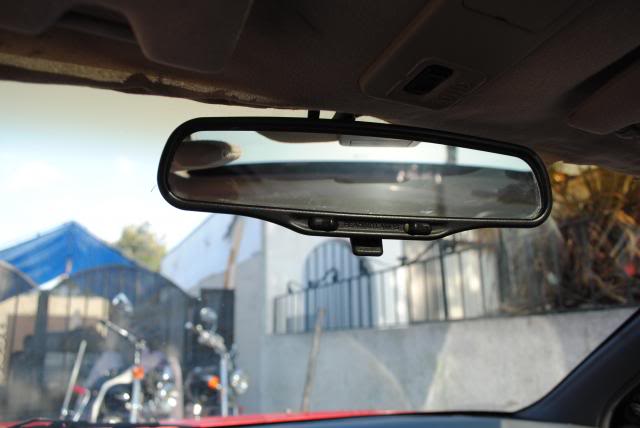

first on the list to go was the rear view mirror that was peeling.
so went to the local pick your part and found a couple parts that are replacing the old worn out ones.

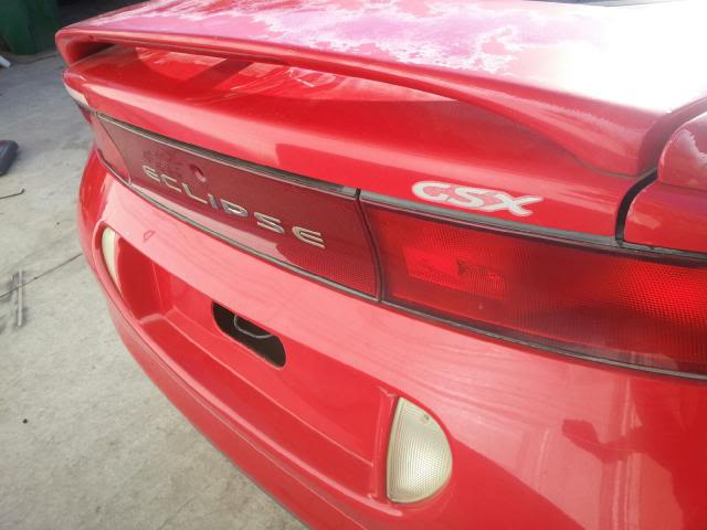

I also found a really well maintained center garnish 95 spec with the chrome lettering not peeled. pic to come soon .

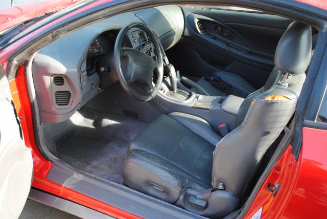

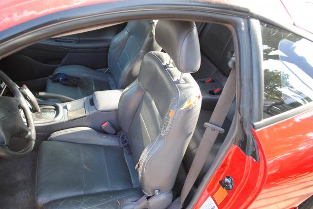

I know the seats have seen way better days, but i will get them redone in the near feature once the car is all 100% mechanically.

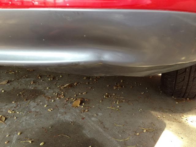

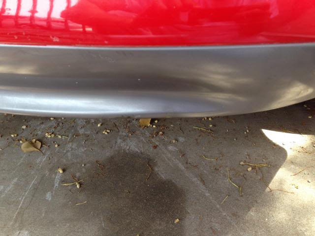

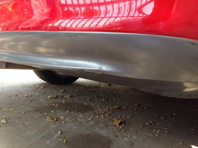

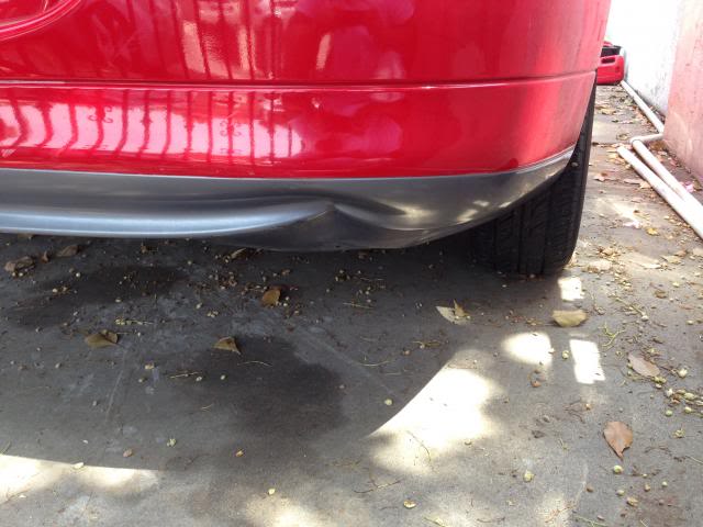

small DIY repair/ update
i just noticed this today after it was pointed out to me, and since its sat my day off and have to take what ever time I have since i have kids and a wife, and they take up most of my day.
difficulty level 2 out of 5
time duration: 30 min but depends on how bad the damage is.

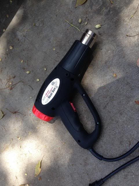

tools needed heat gun and a round dull object to push against hot plastic.
disclaimer. i am not responsible for any damages you/ may occur to the object being repaired. this is for documentation purposes only. try at your own risk
and on to the pics

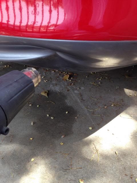

before

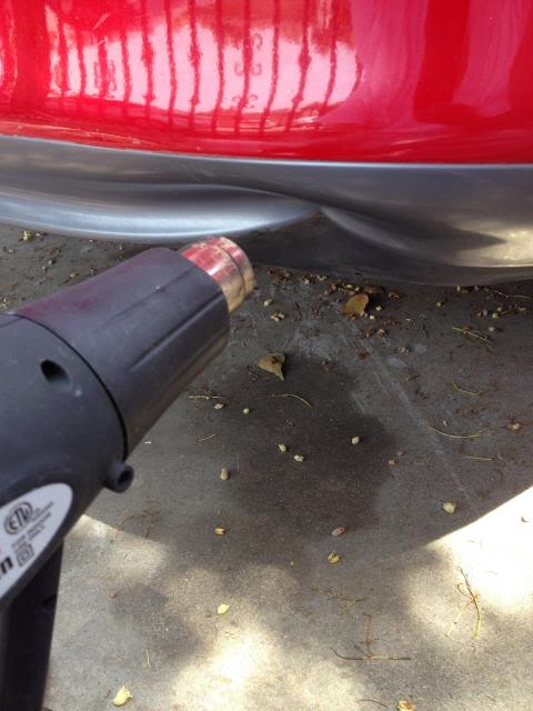

hold your heat gun 6" inches away on low heat centering around the damage area and slowly moving directly on the actual crease area for about 2-3 min.
around area.
directly on area

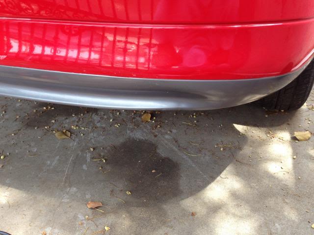

after area becomes soft, push from behind to pop the dent/ damaged area out. it still may look bad but we are not finished yet.
and after a little pushing with the dull object you get a little closer
a little more heating and pushing
and finally
Stellar work with the heat gun! Nice!
I've gotten bumper dents to pop out using another trick.... Take the bumper off and put it in your car on a hot day. A lot of the time it will pop out on it's own from the extreme heat!
Nice fix on the bumper.

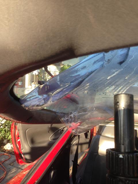

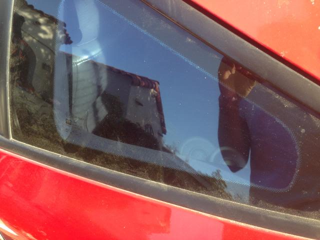

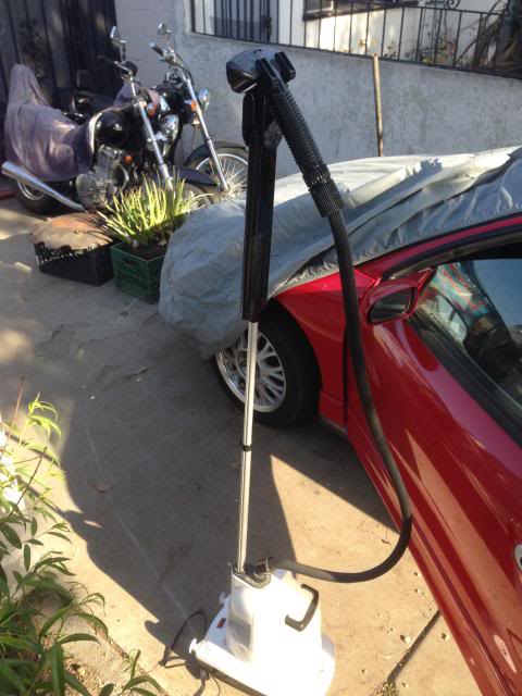

The car came with cheap old purple tint, so it had to go!.... MAN WHAT A PITA!
I used the steam method that I have used on my other vehicles but dam i have never gotten steam burned as much as i did on that day.
I just used a conventional/ home type steam iron for my suits.

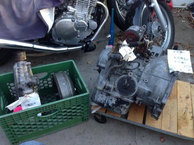

I got my transmission in today and so far the trans look like its been rebuilt. I bought it off ebay so :/ lets see how well it works. it does come with a 6 month warranty. That's what gives me a bit of piece of mind.
It was a pain in the but pulling it off the freight company trailor that delivered it to my friends shop, and more of a pain to get it down from the back of my truck.
I never had a hard time sourcing a trans as much as i had with this one. These parts are getting harder and more expensive to get. I cut a deal with the ebay seller; I got the trans, transfer case and torque converter with shipping for 800.00. i know its a ton for a auto trans but no one had one, and after searching on the forums no one had one for sale until after I purchased mine I seen 2 pop up on the forums FML. desperate times call for desperate measures.
update 5/2

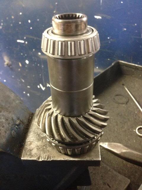

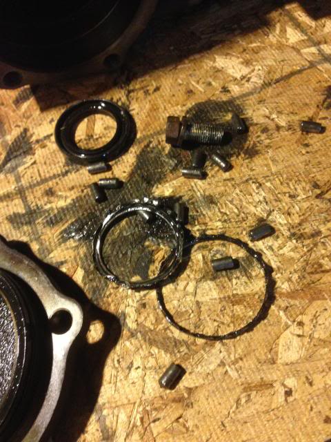

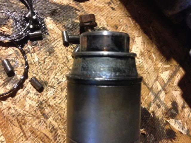

the day i picked up the trans from my friends shop that i it shipped to. the oil leaked out of the transfer case, my friend noticed it and told me to check the bearings in it because I don't think gear oil is suppose to glitter like that, ( Crap ) at the beginning i didn't want to believe it but it lingered in the back of my mind and didn't want a surprise in the future.
So i took apart the transfer case and ......
pieces came barfing out of it. moment of silence.... and then the vulgar, nasty, mother loving words came out. :bang:

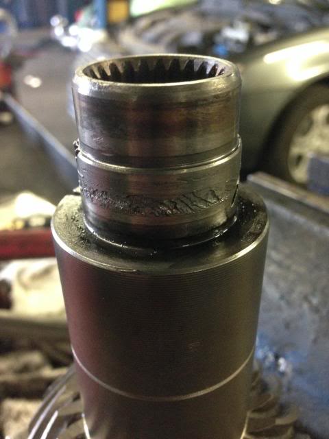

I checked out the shaft and the bearing became one with the shaft. I tried to pull it off, Heating it off but no luck. I started to try to cut if off very carefully with a thin cutting wheel. but didn't get to far since it was dark out already
i might just end up taking it to a machine shop, so they can put it on a lathe and cut it down. I looked on jacks transmissions and they sell a kit to rebuild the T case.
Long time since an update but lots has been done. :) MOD 13 here i come.

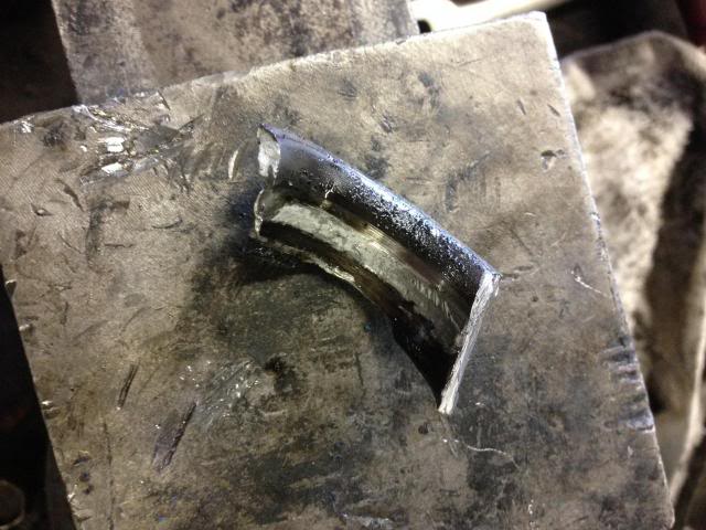

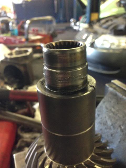

so after finding out that my transfer case was shot, I went ahead and got all the bearings with bearing seats and went to town on it. This thing was so over heated that the bearing welded it self to the shaft.
it was a pain in the behind and had to use almast every available tool in the shop to rip this thing off here is the carnage.

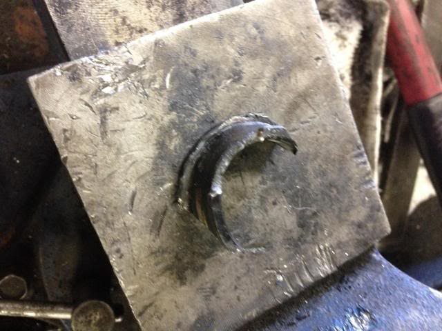

and here is the bearing in two pieces after 2 hours of cutting and bearing pullers. Finally! but doesnt look nice.
after sanding down the burs and weld mark i got it somewhat low, this was after 45 min of just sanding it with a 1k grit sandpaper, and i spent about an hour in a half doing this.
and the new bearing pressed in and ready to go back in the transfer case.

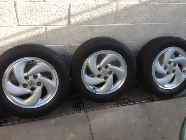

while awaiting for my transmission axle seals from south coast mitsu dealer i picked up the oem swirls for the 2ga gsx model from a local LADSM forum.
I say the swirl look much better than the wheels that the car came with.
