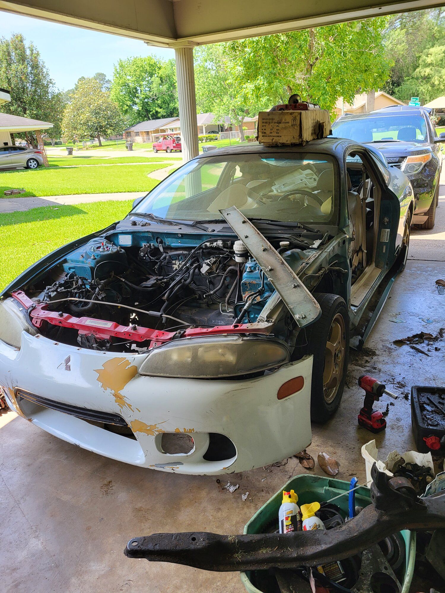

So I acquired a 1999 GSX. It's in decent shape, better than the GST I have actually. I'll be taking the engine and some other things I need out of the GST and then will be building into the GSX instead. It's a 1999 5 spd manual GSX. So goodbye GST, hello GSX LOL.
Update
Engine and head is currently being built, should be getting a call here soon to pick them up. I got a 20g turbo and FP manifold with an external gate on the 02 housing.
I also got all the cruise control crap out and put in a non-cruise throttle cable.
Some mix matched parts like bumper and I just installed a new drivers side door (no pic yet) since the old one had a massive dent.
the upper rad support was swapped out too due to someone accidentally crushing the original. I got it pretty close and after some tweaking and paint you wont notice it.
Just gotta get some cams, injectors, fuel pump, and a fmic kit and then start working on getting her running.
After that is paint.
Slowly but surely LOL.
