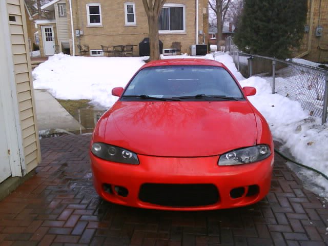

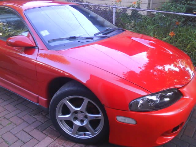

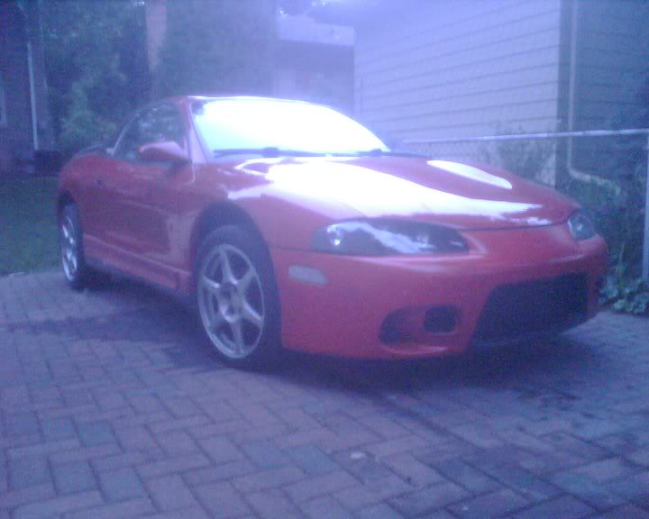

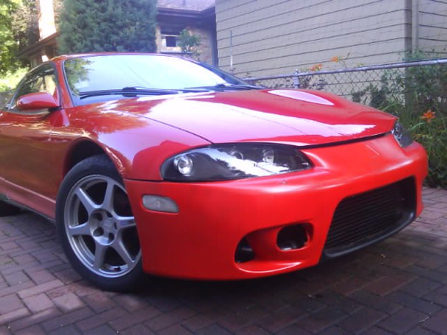

Yeah, the previous owner put it on and just rattle canned it red so it doesnt exactly match. He included a primed ebay aftermarket 97+ but I think I'm going to hold out for an oem from a red part out. I bought some 2gb side skirts the other day, and they're already the same color. Once I get the high rise wing and rear bumper I should be all set. Just going for a clean stock(ish) look from the outside. I'm going to get it painted when I'm done with the motor.
Cool Cool OEM looks the best in eyes
