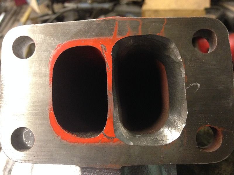

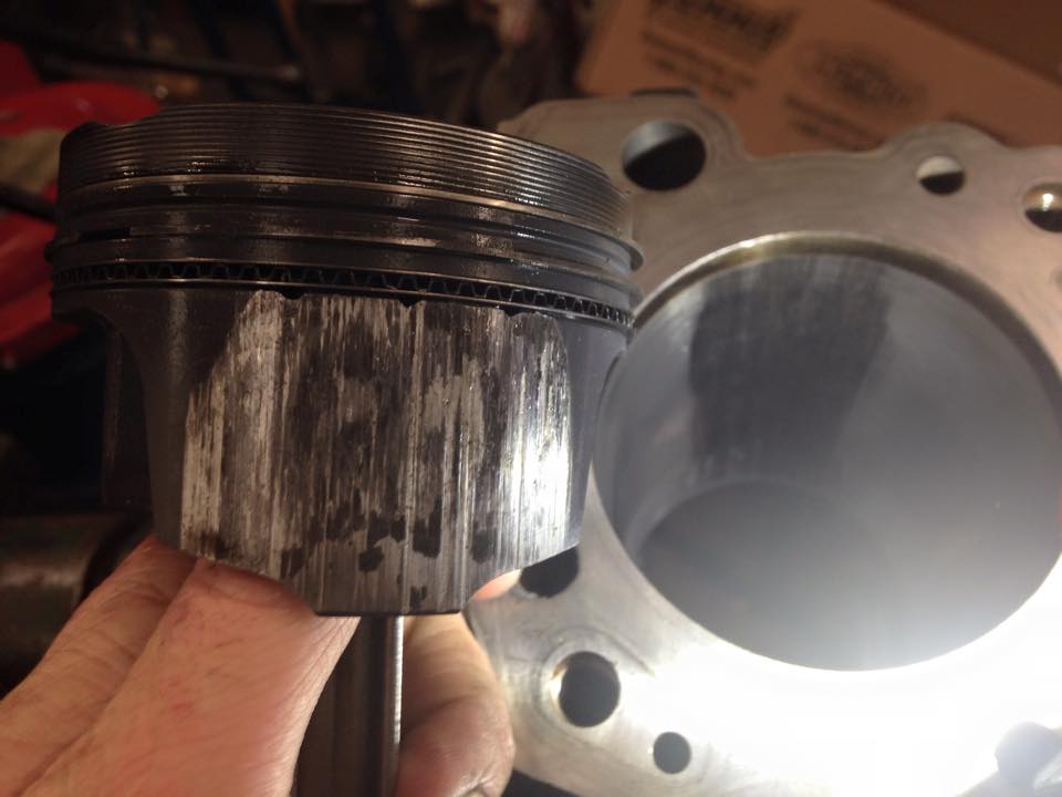

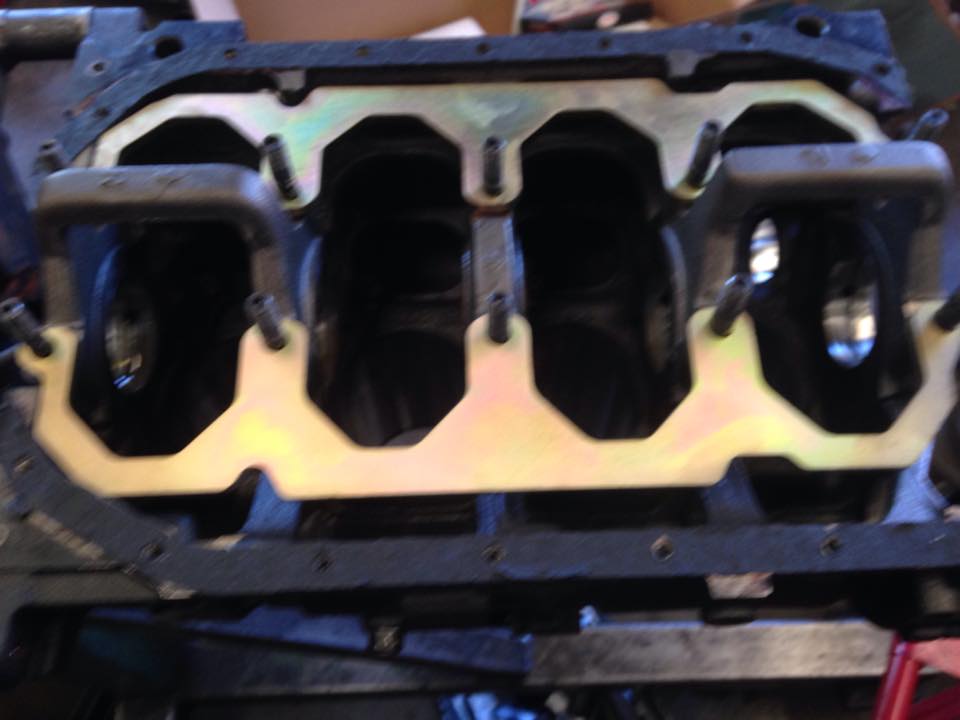

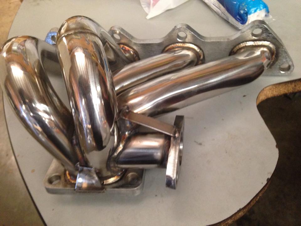

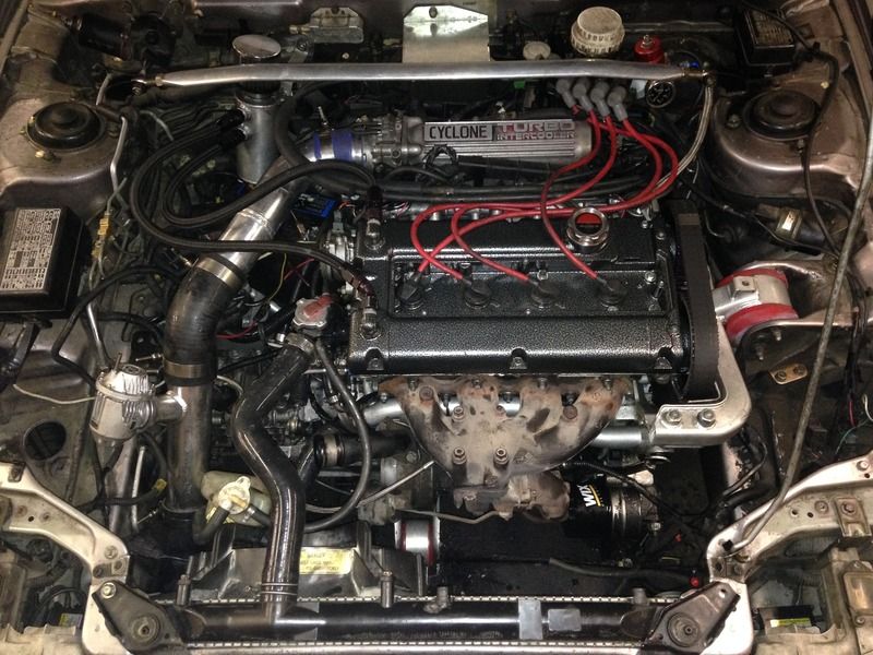

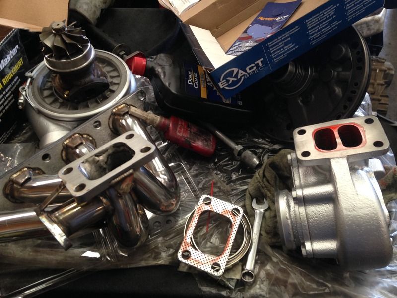

so this has been happening. Adding a kiggly girdle this time. Gonna try this eBay mani, doesn't look like it'll crack like most are known to do, I needed to space my next turbo away from block a bit, and I greatly like the sound of EWG out the main collector instead of the #1 runner. Also was able to see the cause of why my pride and joy engine only made it 70 miles. Piston to wall clearance! It is a .0025 right now, should be more, wish I caught this before!

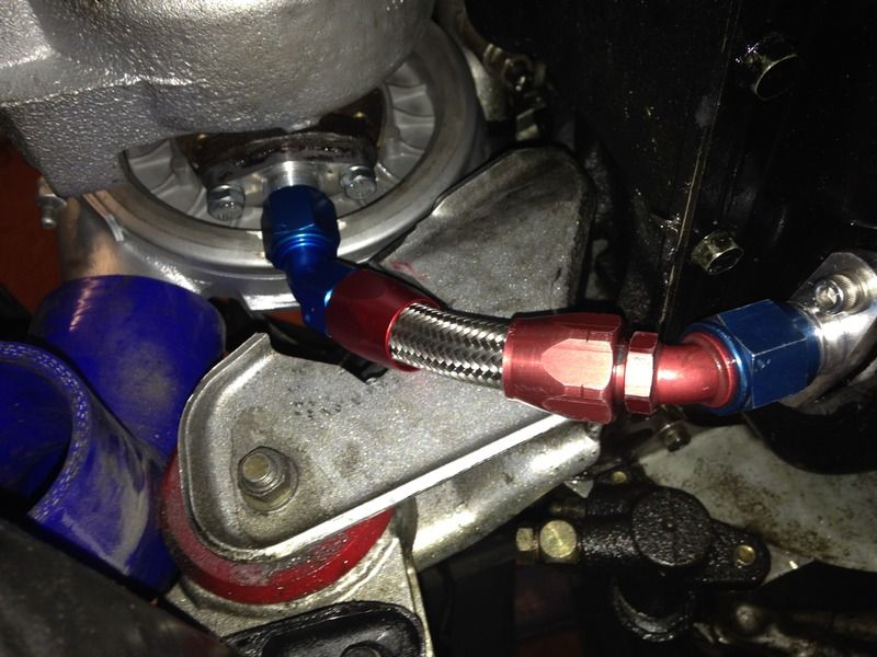

Oil feed and water pipe block

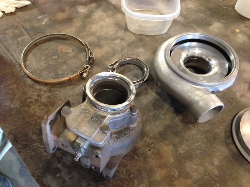

the housings back from machining, and at the coaters

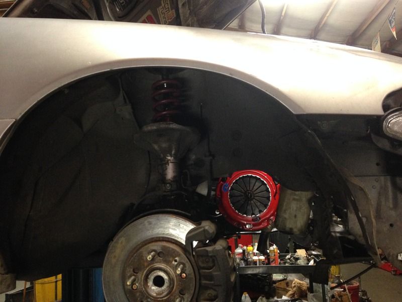

Even though I got the Holset stuff back in the mail today, I got a little impatient...I need to get miles on this clutch fast. I threw a stock 14b setup on just to drive until the holset is ready

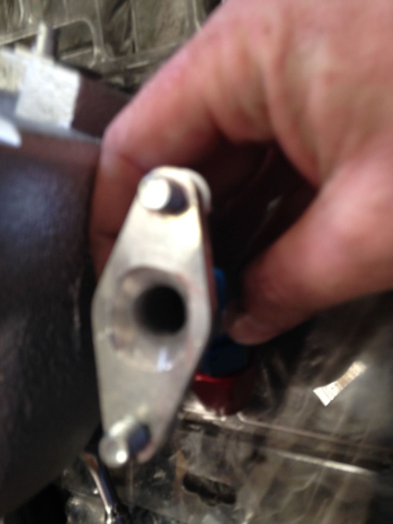

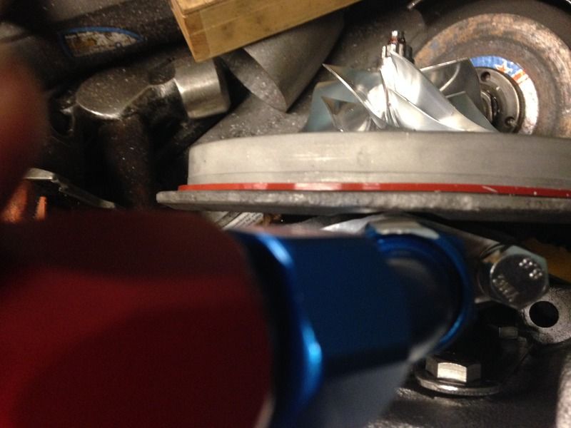

Had to clearance for drain line

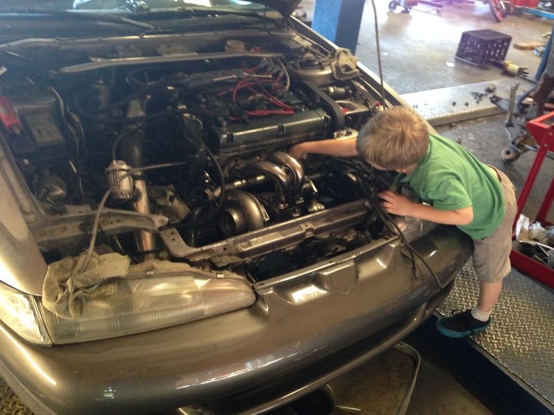

had some help from little man

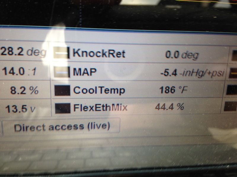

Got a pump gas tune all sorted out and started adding E85

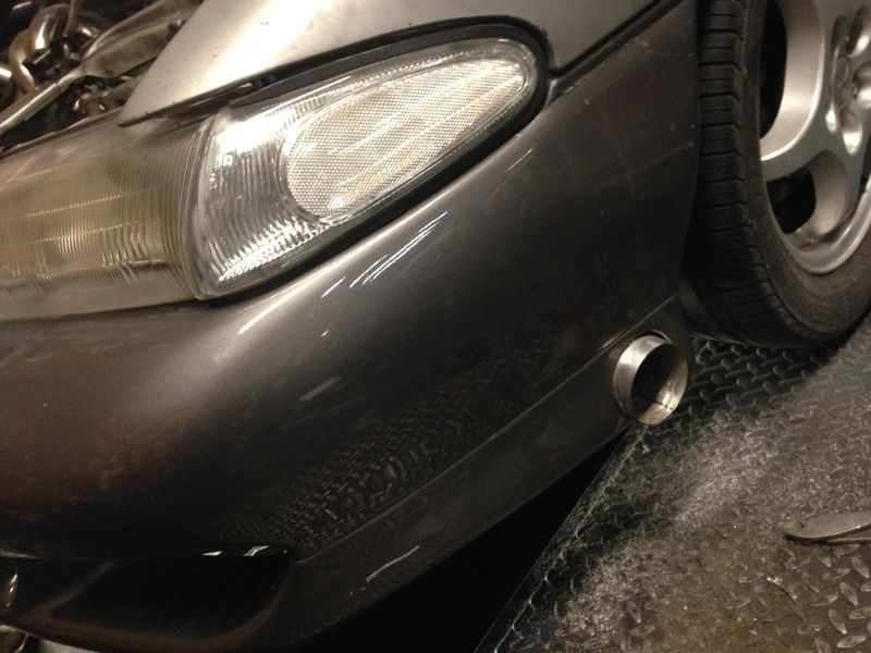

Car was way too loud so added a resonator that mellowed it out a lot.

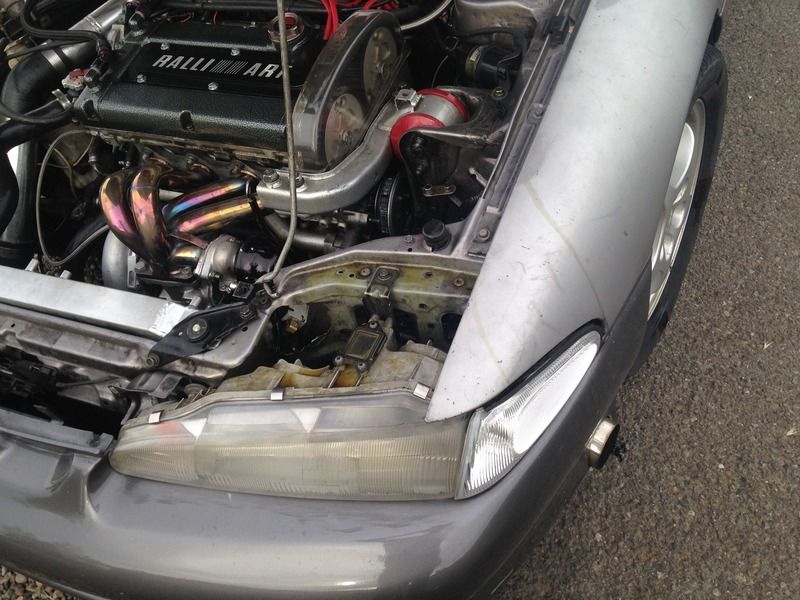

Did some engine bay tidying... went to BR7ES plugs, cleaned up wires, wire cover, timing cover, cut the slant on the exhaust better, I still need to do the overflow container, but almost there.

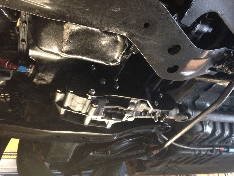

The busy ass week to prepare for IFO woodburn continued... work full day then 4+ hrs a night on the car.... installed Jeff Bush T case brace

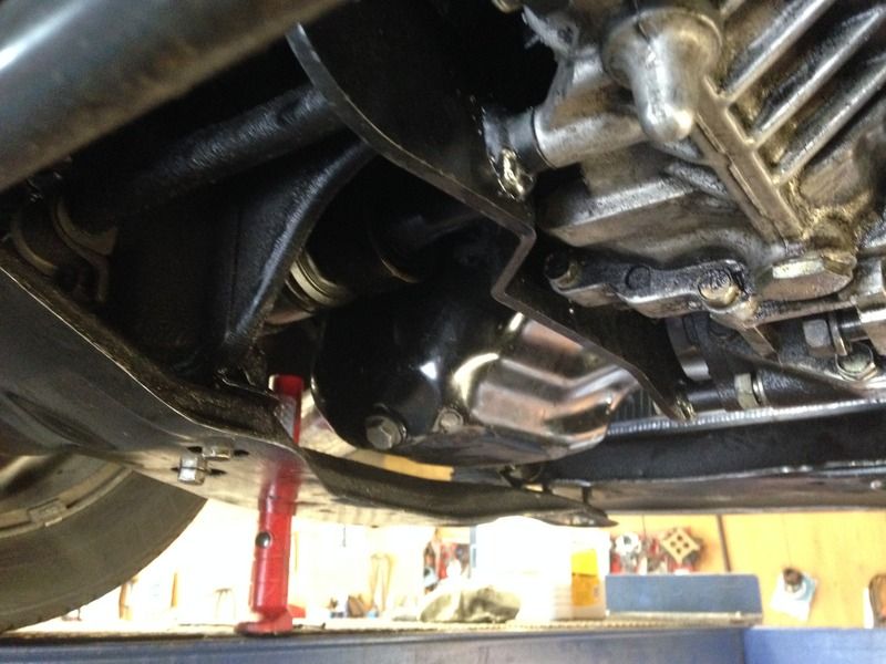

If you'll notice in that pic....my oil pan is dented.... someone pointed this out to me, I just thought "Ug I cant leave that like that...."

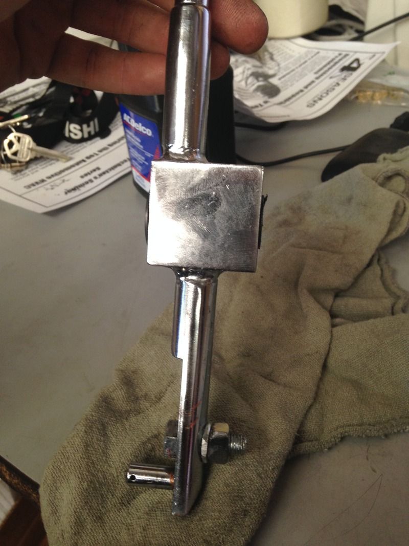

Adjusted the shifter stop a little, its pretty spot on now

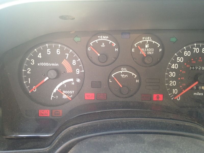

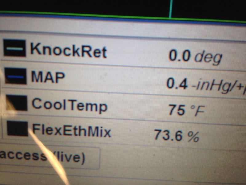

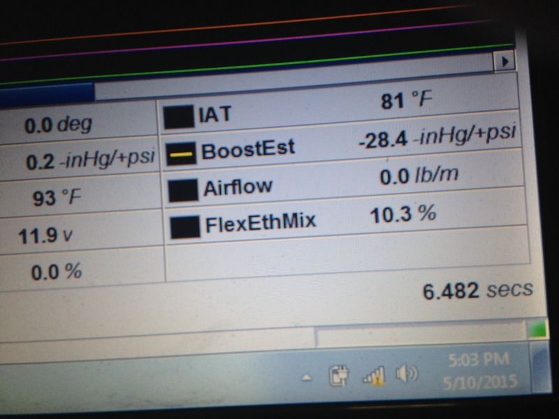

Drained the tank, put in E85, heres what it came up to with the gas at the bottom of the tank.

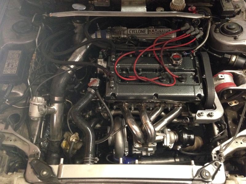

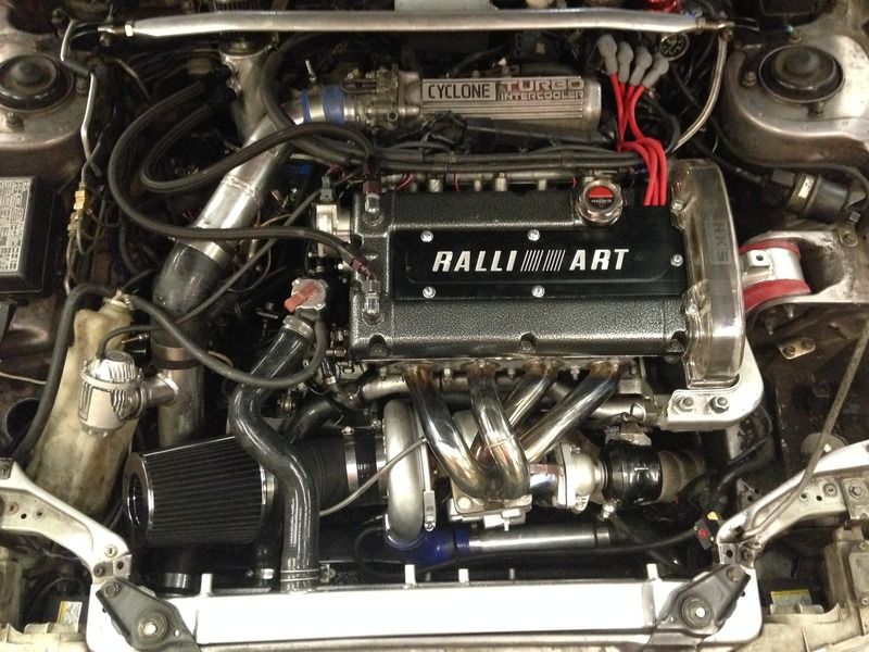

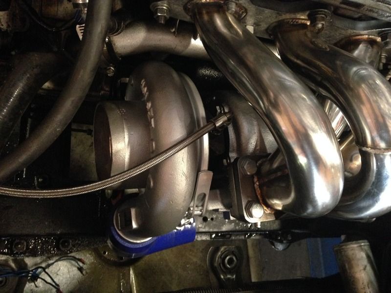

Good Job mate, i think its interesting seeing some budget pieces on your build performing as well as other peoples not so budget friendly manifold. So are you running a holset now? How did that manifold due clearance wise? Boost response no crazy spikes with the waste gate coming of one runner?

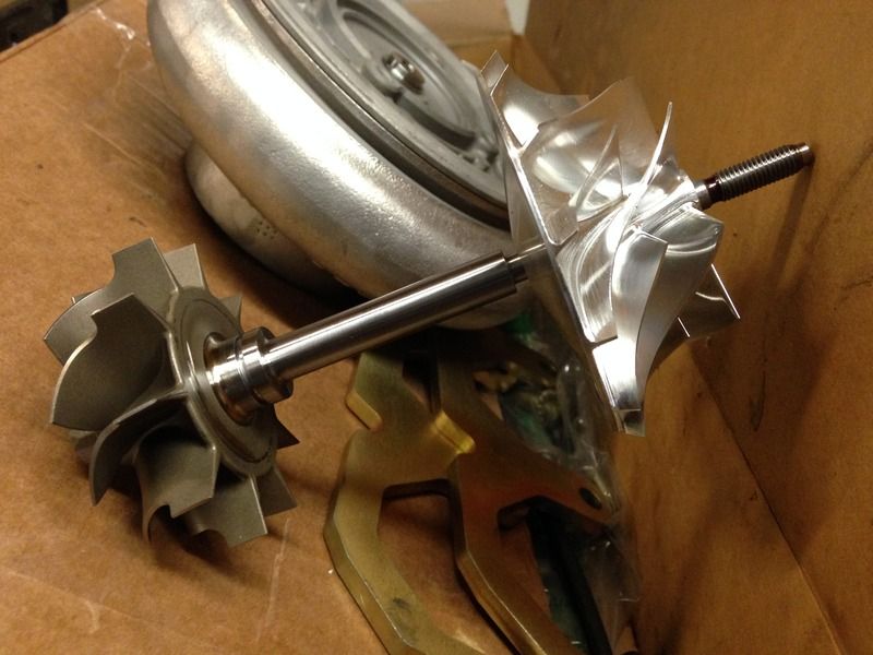

Thanks! Yes holset H1E with upgraded thrust/rebuild kit, 60 X 87mm billet 7 blade. The mani Im running is great so far, the turbo clocks the comp side out, no water pipe denting, and its a little farther out, this 12cm clears block, but I tried a 14cm just to see and that would need a clearancing. The cast 1 runner mani was the last one I was running with the GTX hybrid, I went to the recent tubular one for this holset cause it brings the turbo farther out, and main collector WGA sounds a lot better venting out, but the 1 runner on my last setup did hold like 10 psi solid so wasnt too creep prone at all
Hmm interesting. ALso looks like you are running your twin scroll exhaust side on a non divided manifold im curious to see some logs on the spool up GET ER PUT TOGETHER :D I may have to send you some pm's on the WOT tuning as well LOL

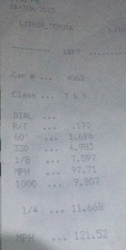

It is together?? full Spool is 4800 RPM in 3rd. Heres my last pass of the day, since the 2nd was a throwout pass, and the 1st my laptop went flying back and unplugged
How did i miss that part LOL , so what is next for the car my 50 trim maxed out at 11.5 in the quarter mile. Im not sure what i can do to hit my goal of 10.9 and retire from DSM's but upgrade my turbo hmmm ill send you a pm about your set up.

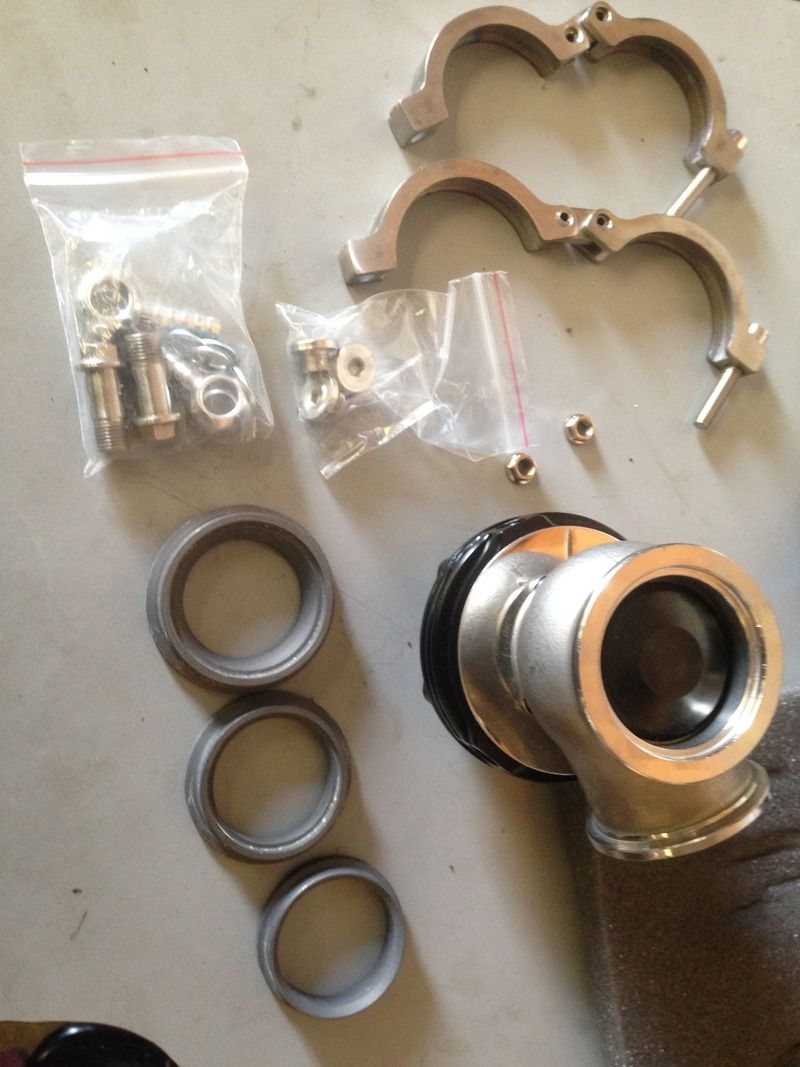

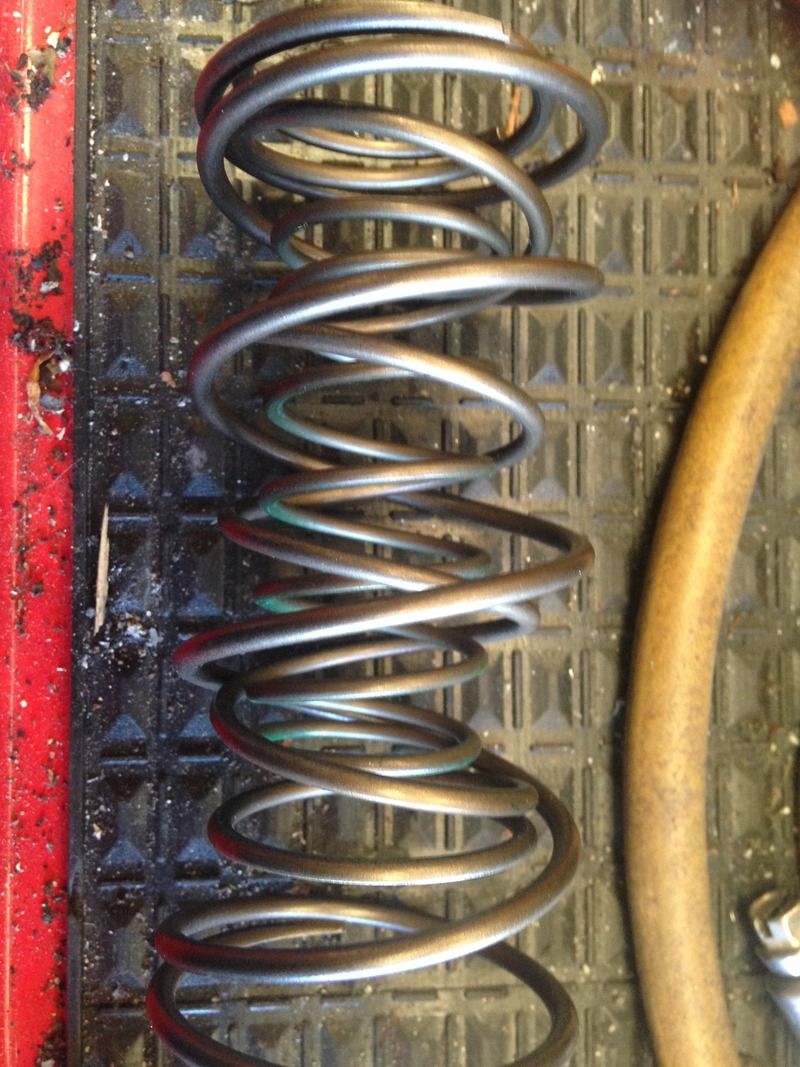

So been running the car at the local track, working bugs out and shaving times down. First off I was seeing boost creep, and couldn't run more than 29 psi...after a BLT, it was found to be the EWG, leaking from boost lie out the dump tube, so went to a V band style, got the flange welded on
Got a good strong spring setup

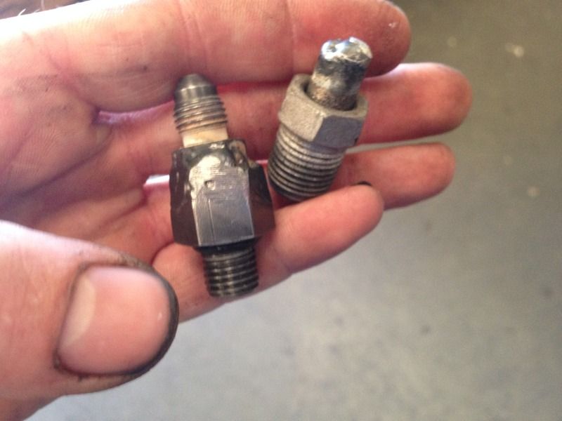

the oil cooler bolt worked loose, sprayed oil all down the track, I didn't have a clue until my oil light came on at the return road...turned it off fast, fixed it with a bunch of red Loctite, a new Oring, and a bracket to hold the cooler and take some weight off it. What was pretty much 2 races after... IT DID IT AGAIN!!!! Right at the launch, spun in its own oil, luckily I pulled over quickly and didn't piss too many track officials off...
Not only that but there were a few things that were routinely loose on this thing...the alternator pivot bolt, top two bellhousing bolts, axle carrier bearing bolts, they've all been getting Loctite, lock washers, whatever I can do....

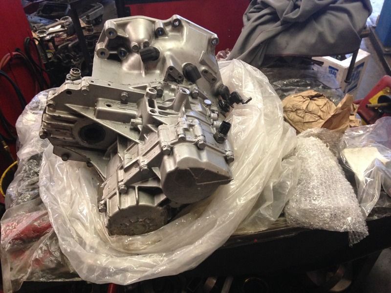

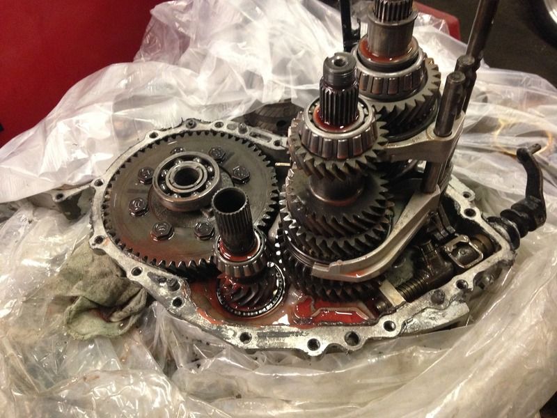

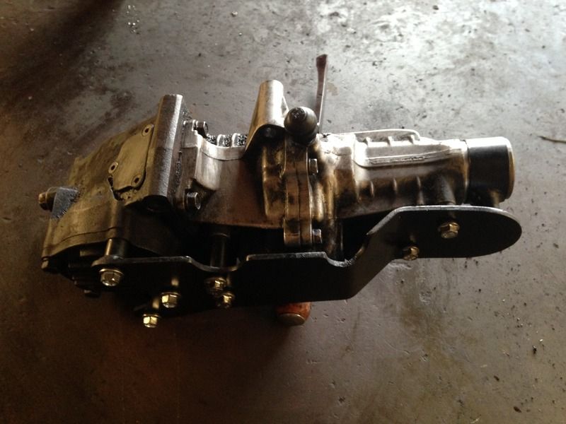

on the horizon is a full Evo III gearset trans, bought it with a broken shift fork, finally going through it.

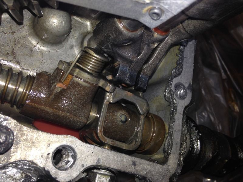

it ended up being the rail, easy fix. this has the evo 3/4/5, so ill be doing the evo 1st, 4 spider diff, ect.
so the permafix of the oil filter bolt

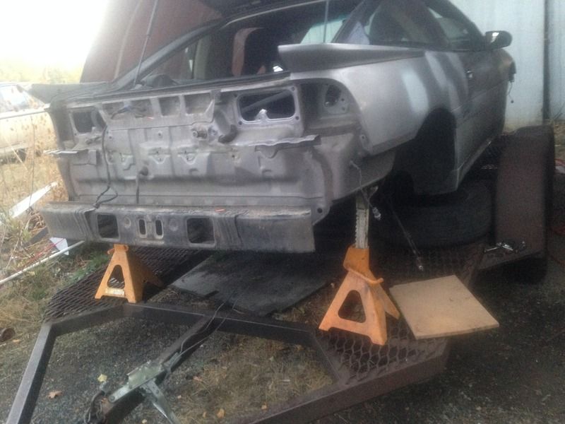

So... This is the part of the build thread that we hate to do... but I'm saying farewell to this car. Its been with me for around 10 years, and I put over 50k miles on it, but I missed out on a lot of racing this year due to little bugs and issues, and I need to start fresh. This car is pretty uncomfortable to drive, It developed a symptom of having dim dash lights, and a growingly lean condition. It started at "eh thats a little lean, I should add fuel." It would correct then next pull need more, and more. Got to the point where 100% duty cycle on 2150s, and 14:1 AFR. It wasnt obvious things like fuel flow/pressure, it came down to a wiring harness issue that kept me busy for over a month. On top of that, things on the engine were always getting loose, and the trans had to come out due to 2nd gear synchros being done. I have a GVR4 that needs love, so rather than "plan A" which was this 11 sec dsm and a 12 sec galant, Im just going all in on the GVR4 for the hot 11sec street car, and a Foxbody for the nasty weekend special car. Yes it will be 4G63 powered, but both these cars need a lot of parts. So even though I hate when people part these cars out, the fact that I am using EVERYTHING, it eases any bad feelings or guilt.

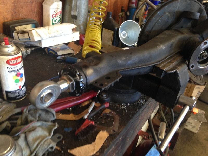

GVR4 gets-engine, trans, clutch/fw, front axles, 4 bolt rear, 5 lug knuckles, 5 lug rear arms with toe elim kit, VRSF fmic, gauges, ect
fox gets- engine harness, ecu, 2150s, fuel pump/-6 tank to rail
So heres where we're at:

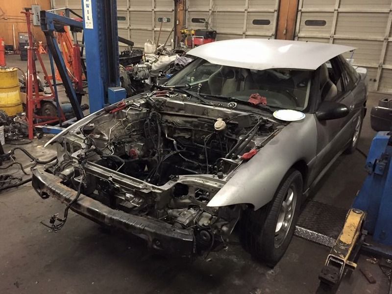

Pulled engine/trans

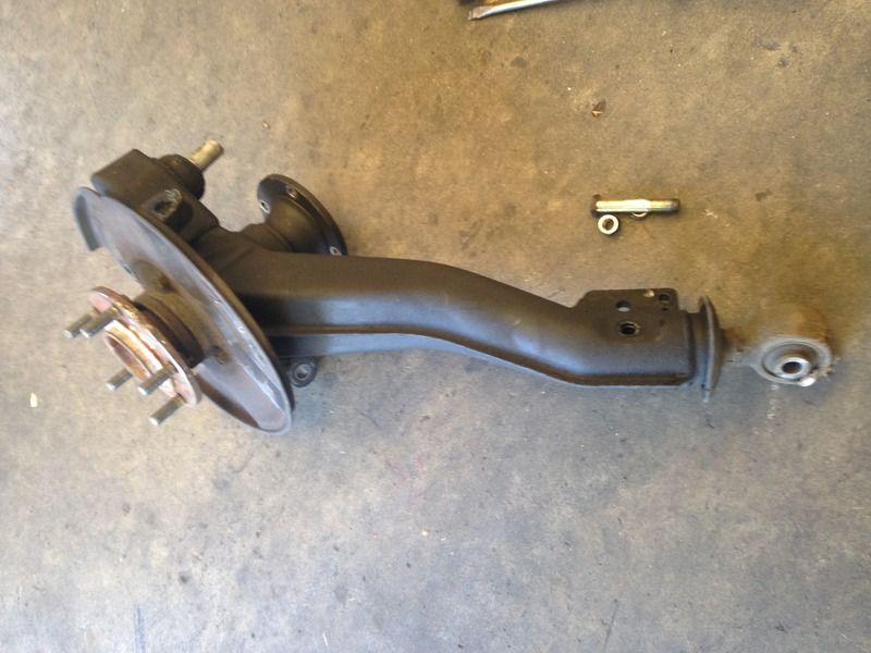

Pulled struts, knuckles/brakes/arms (for 5-lug swap)
All thats left is the engine harness for the fox.
Plan is to freshen up the trans, put balance shafts in the engine, and run the exact same combo in the galant. Should go nice and quick since its already broken in and runs. So thanks everyone for reading, sorry this journey has to come to an end, but this cars sacrifice will definitely go to a good cause. We're getting a super nasty GVR4, and an even nastier foxbody in the future. Be looking!
