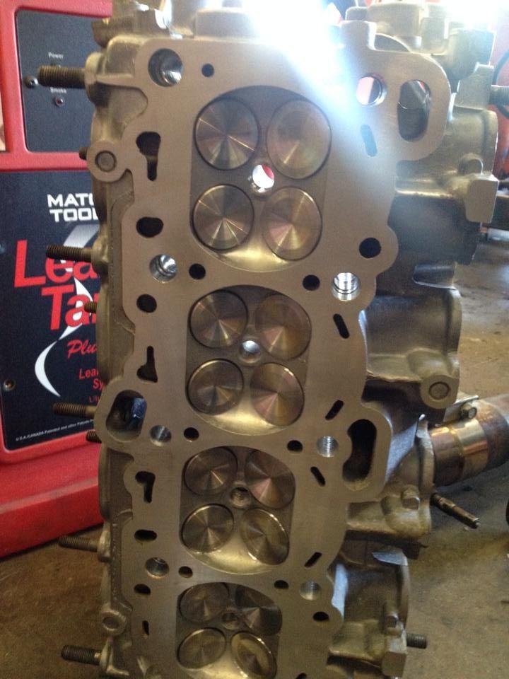

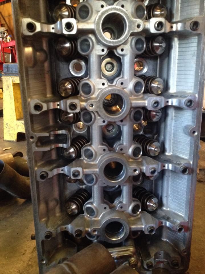

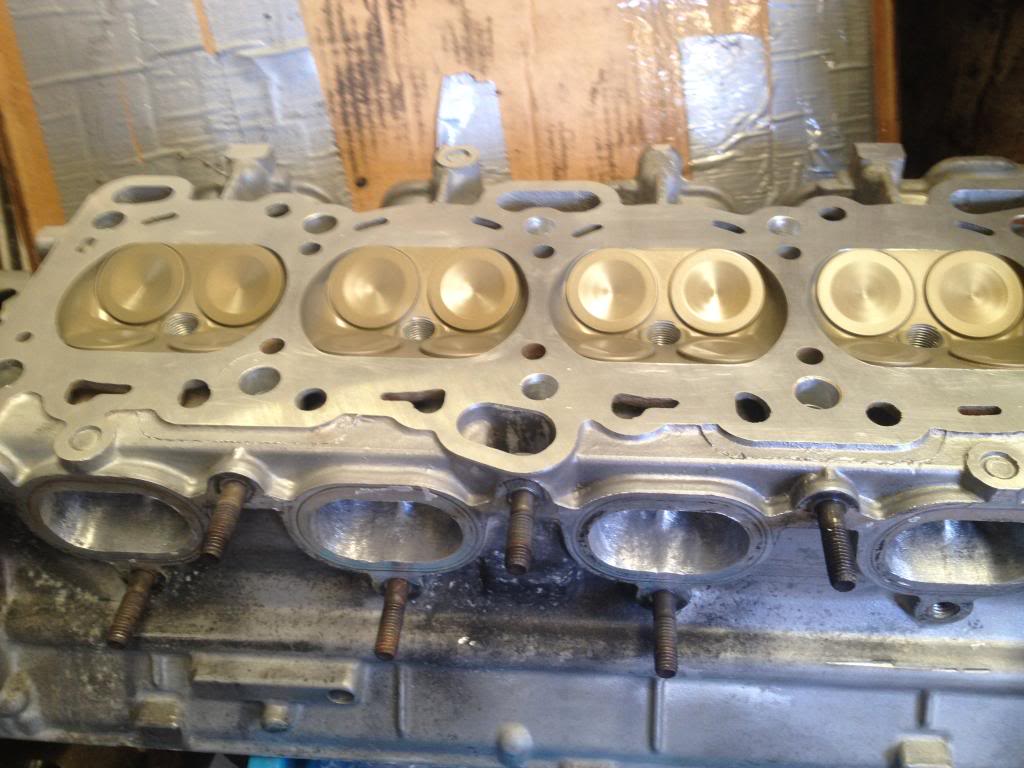

Well some of the bigger things are happening on this, theyre just mostly buying the last bit of things, which are by far the most expensive, and stacking the parts on the shelf and waiting unfortunately. Been waiting on the machine shop for a while... The top end guy was luckily not as backed up so my head was able to get all worked over and assembled. Total that was done was a resurface, valve guides on all 16, 3 angle valve job on existing seats, order keepers,drill for bigger 6 bolt head studs, and assemble the head, all for under $400! $390 to be exact, cant complain too hard but I wish the bottom end would hurry up.

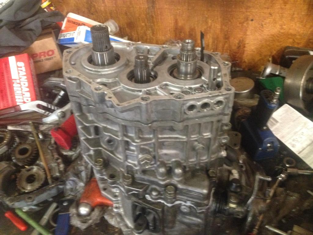

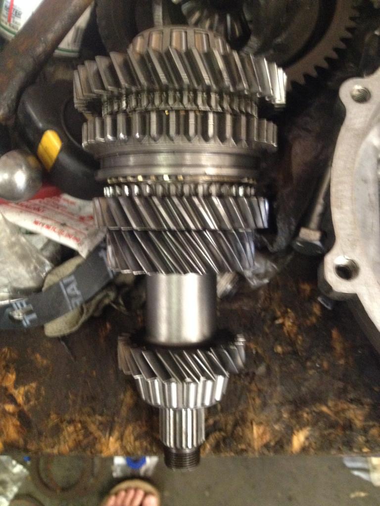

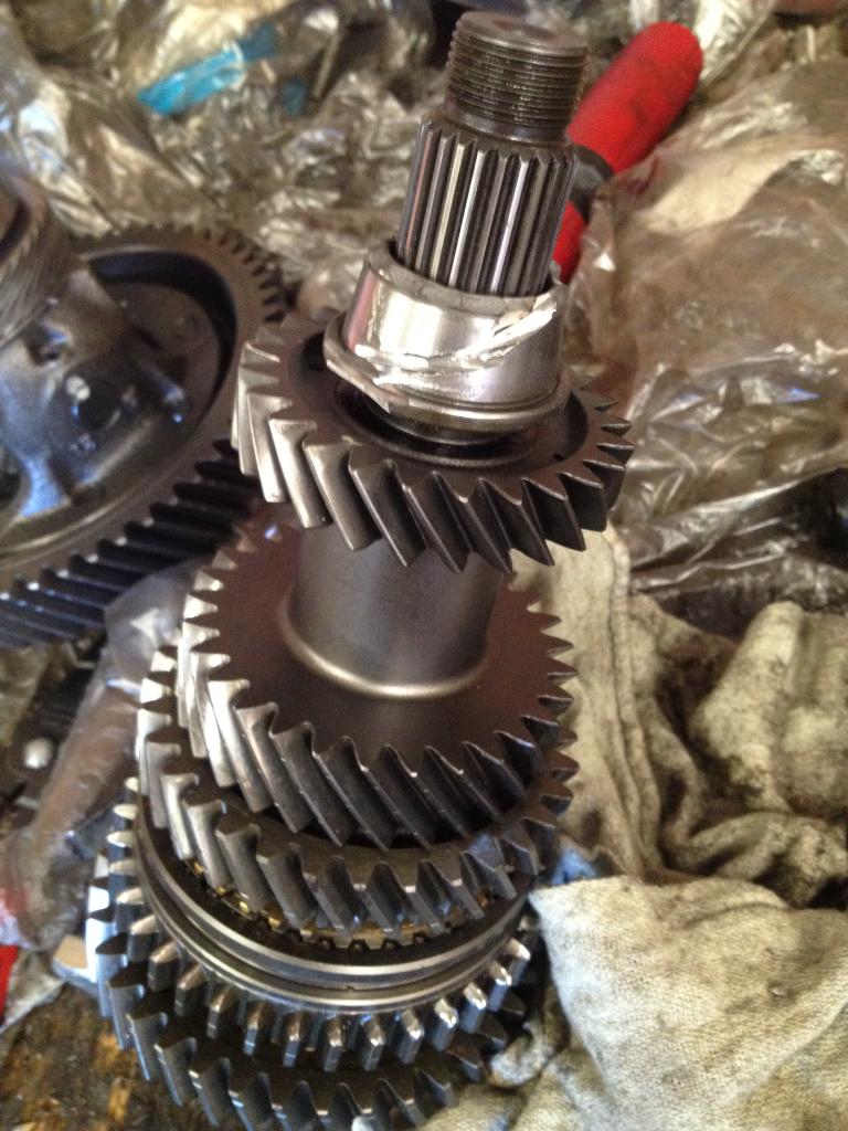

Got a full trans rebuild kit

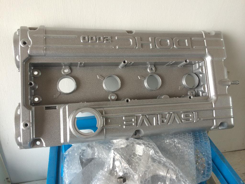

Got the parts back from coating.

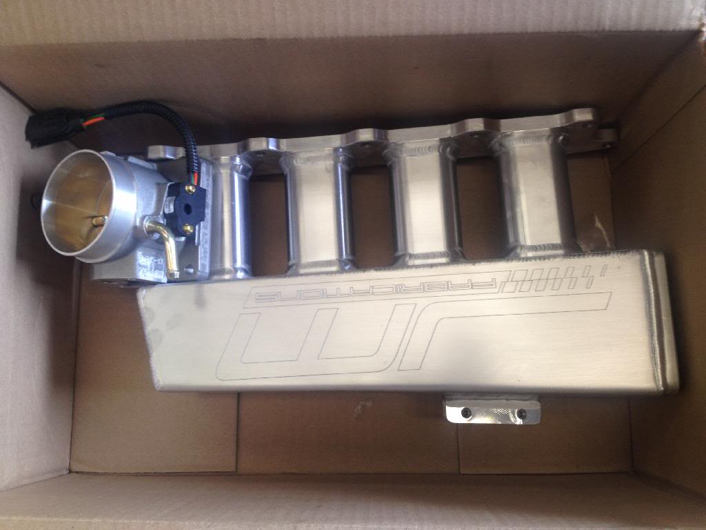

Intake setup came in. JMF race, 75mm BBK TB

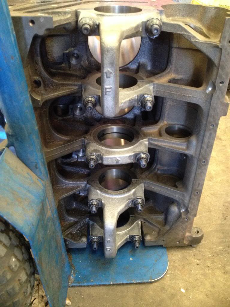

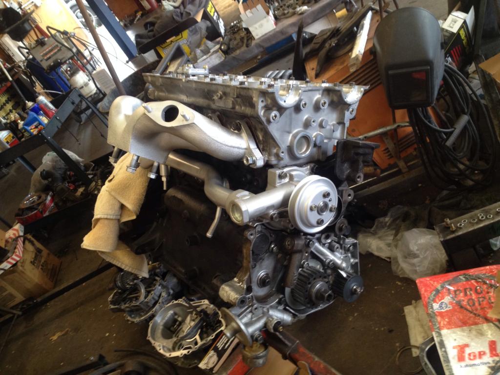

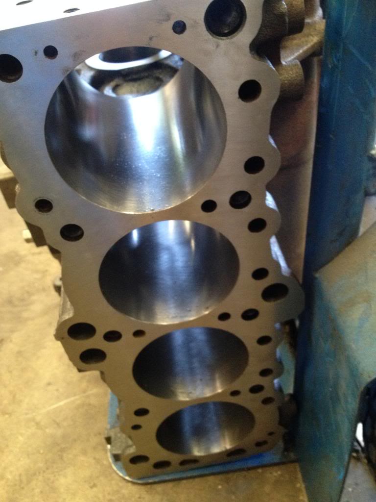

Got a call from the machine shop, they started on the bottom end, went to bore it and found the cylinders were already 20 over! So blew down my shortblock that originally came in the car and had it to them in an hour
Sucks I did all the oil galley mods on the other block for nothing but I shouldve mic'd it and checked the bores I guess. More to come!

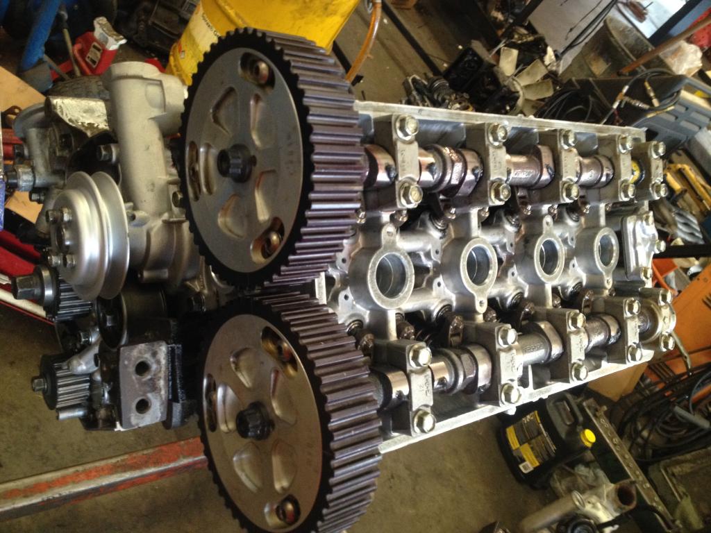

Port matching

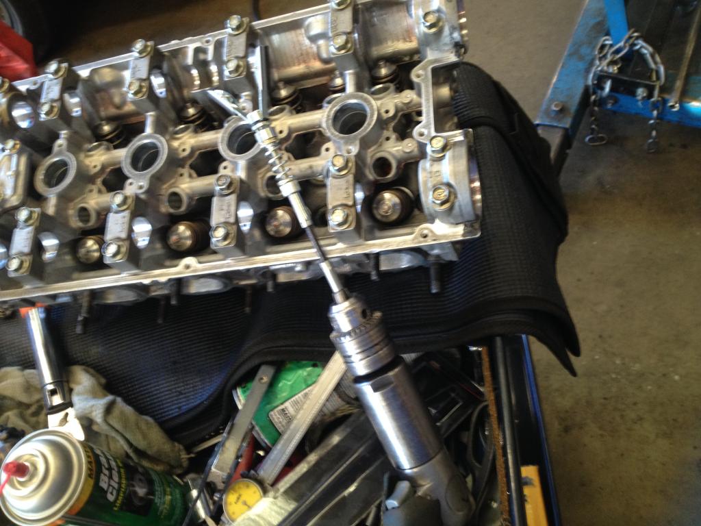

A couple of the cam caps didnt flow the way I wanted to, so they got lightly honed with a brake cylinder hone

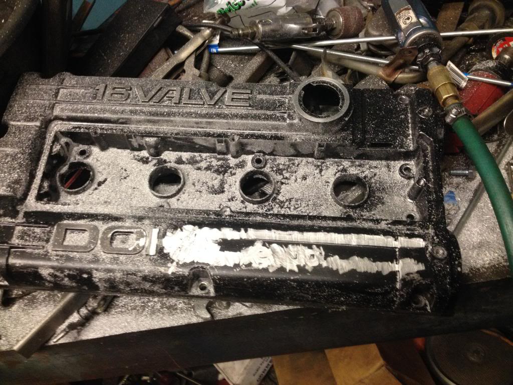

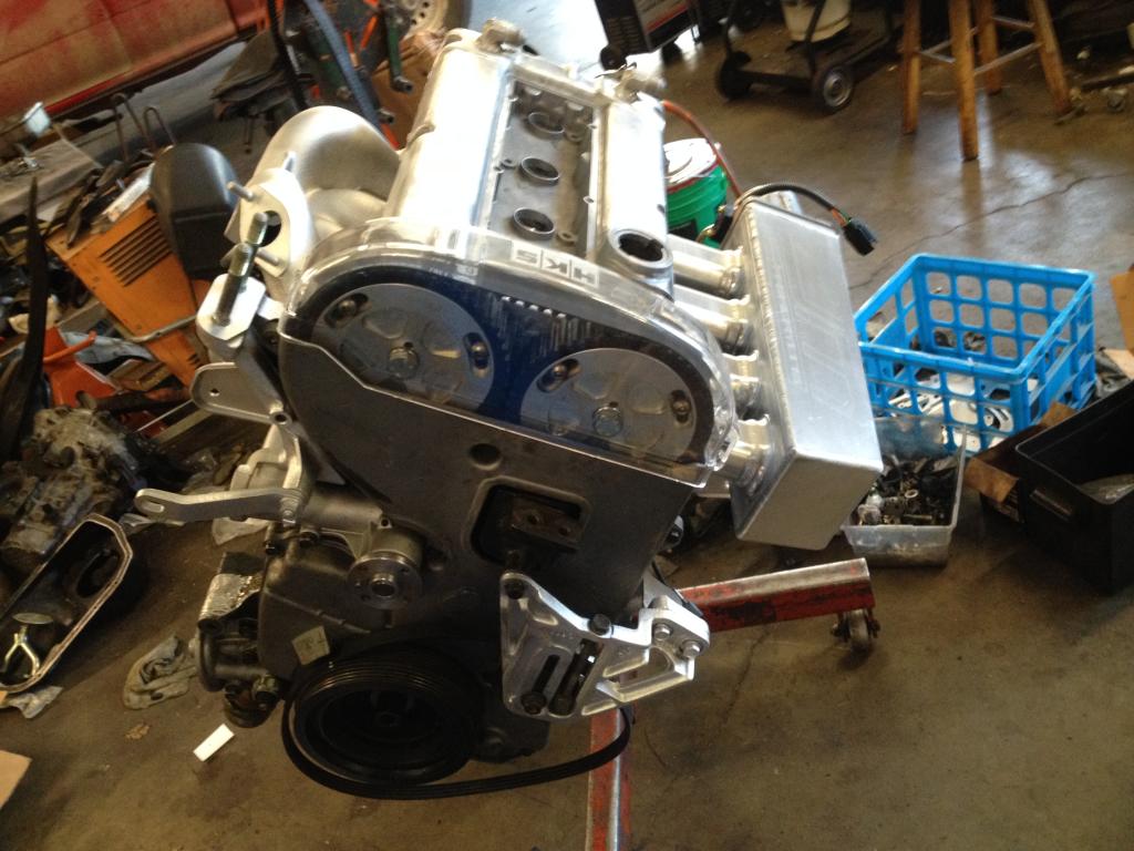

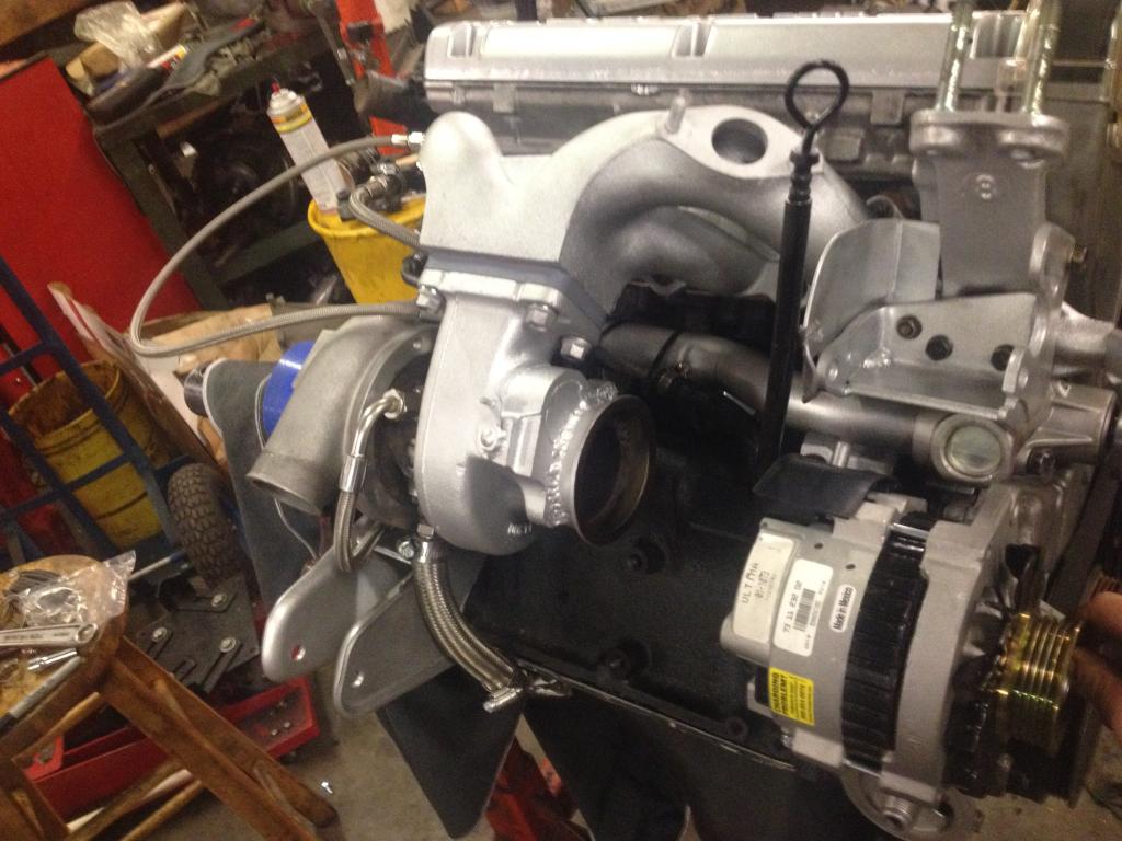

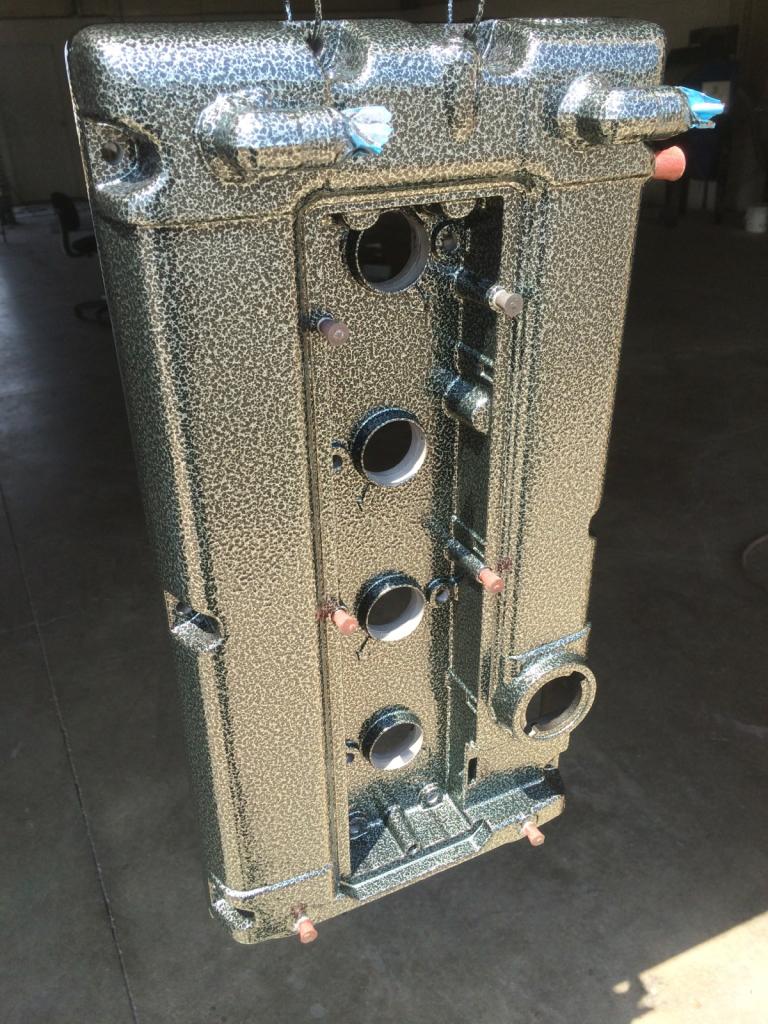

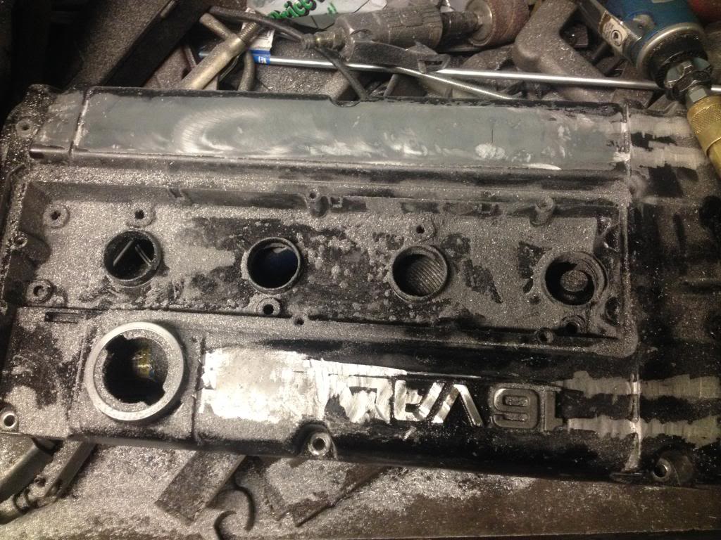

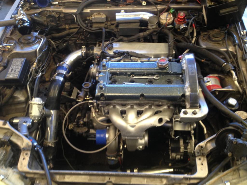

Gettin real close now, the last of the engine brackets and valve cover are at the powdercoaters, should be putting the turbo on tonight

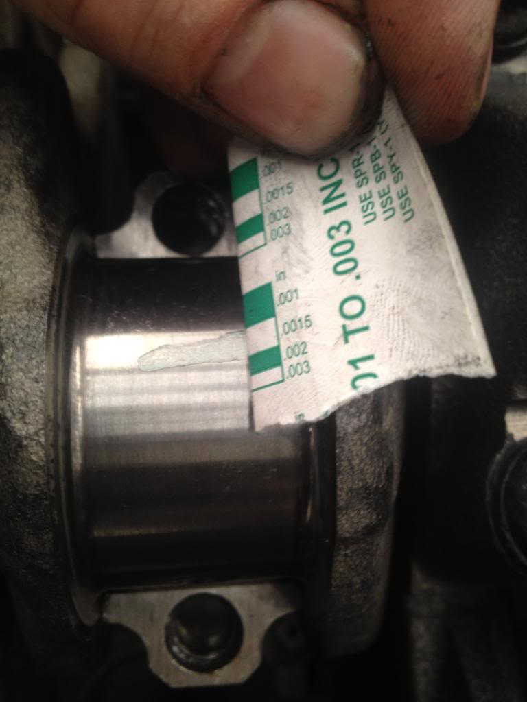

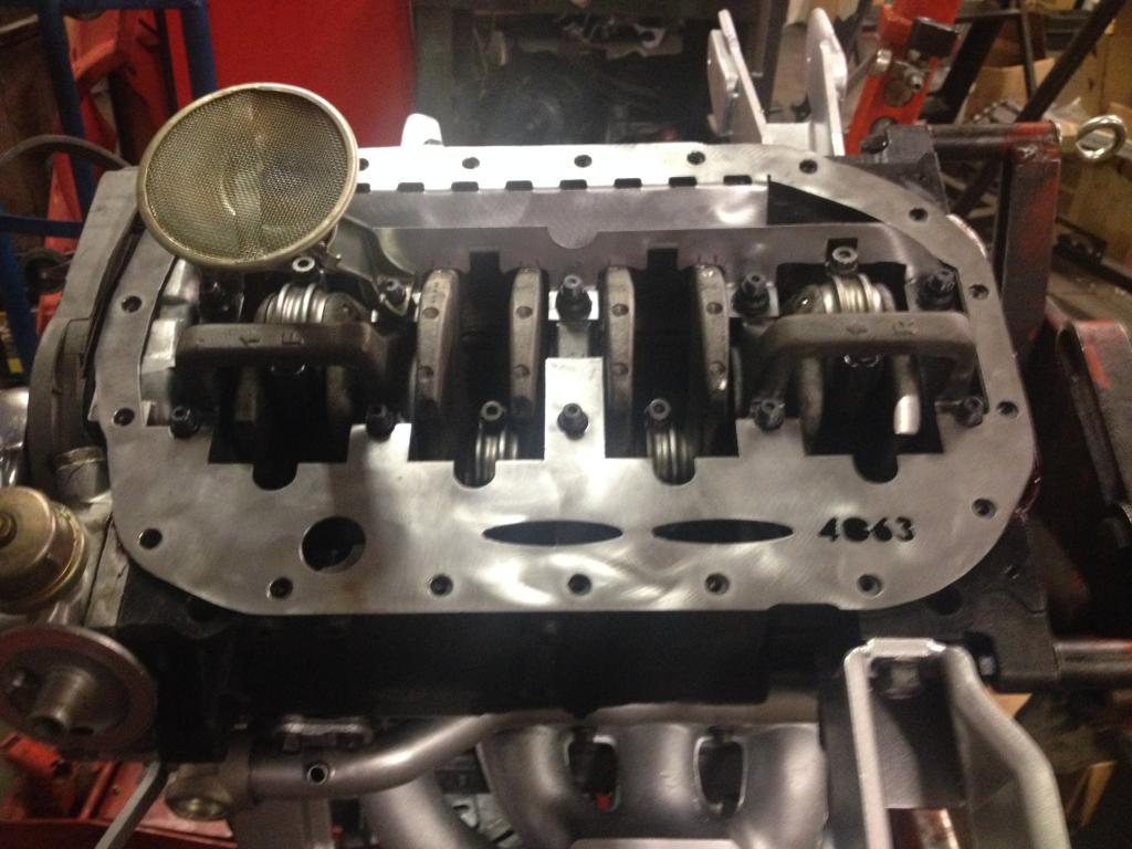

Thanks man! Glad to see someones still reading this haha. Its close I swear, everythings checked out, rings .020/.022, bearings are all .0015, doin the crank scraper now, then its just turbo and accessories :)
Thanks man! Glad to see someones still reading this haha. Its close I swear, everything's checked out, rings .20/.22, bearings are all .0015, doing the crank scraper now, then its just turbo and accessories :)

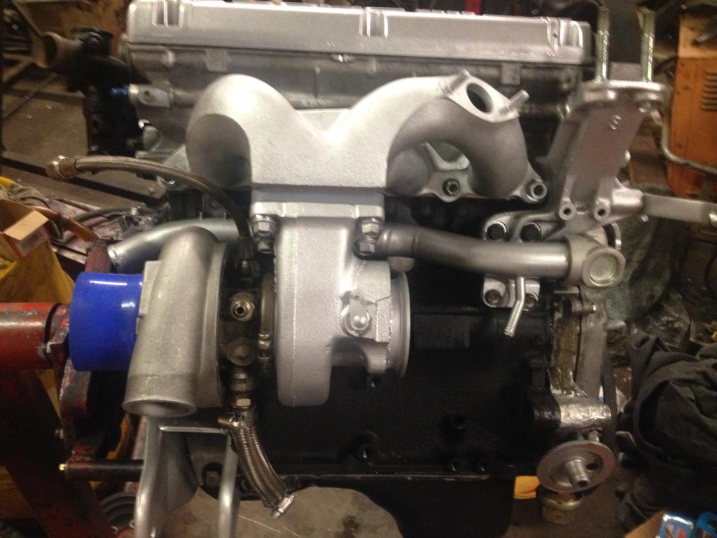

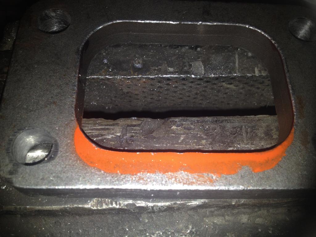

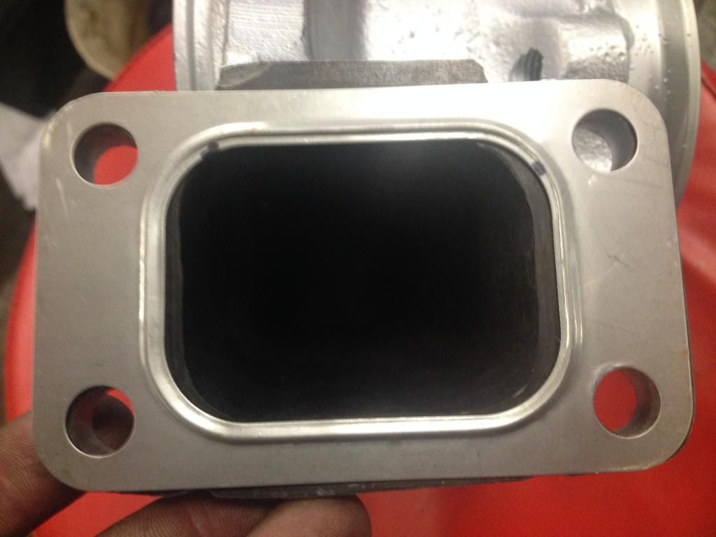

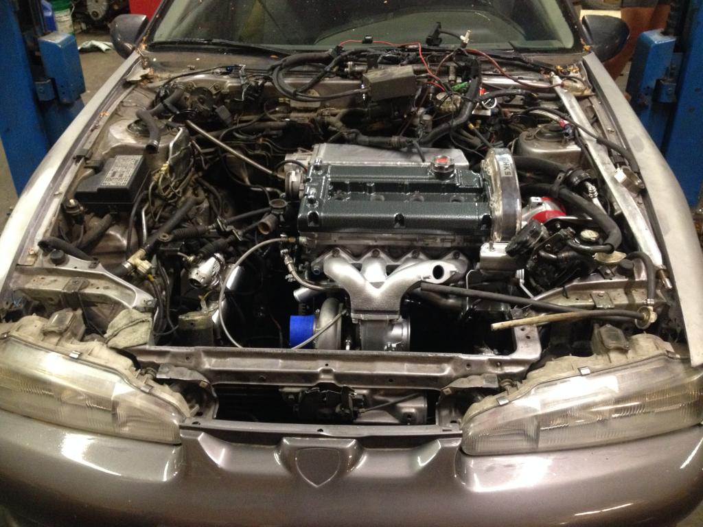

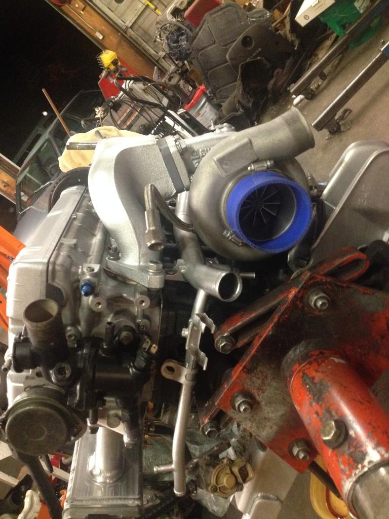

I knew the turbo inlet didnt line up perfectly and the last time this was going it was just a trial period, but it was pretty laggy, Im gonna take my time and do a flange thatll work as a porting plate, since I dont wanna compromise the turbine housing with how far out of whack the manifold is. Can see about a eighth inch step on the sides
and a good quarter inch on the top. OUCH

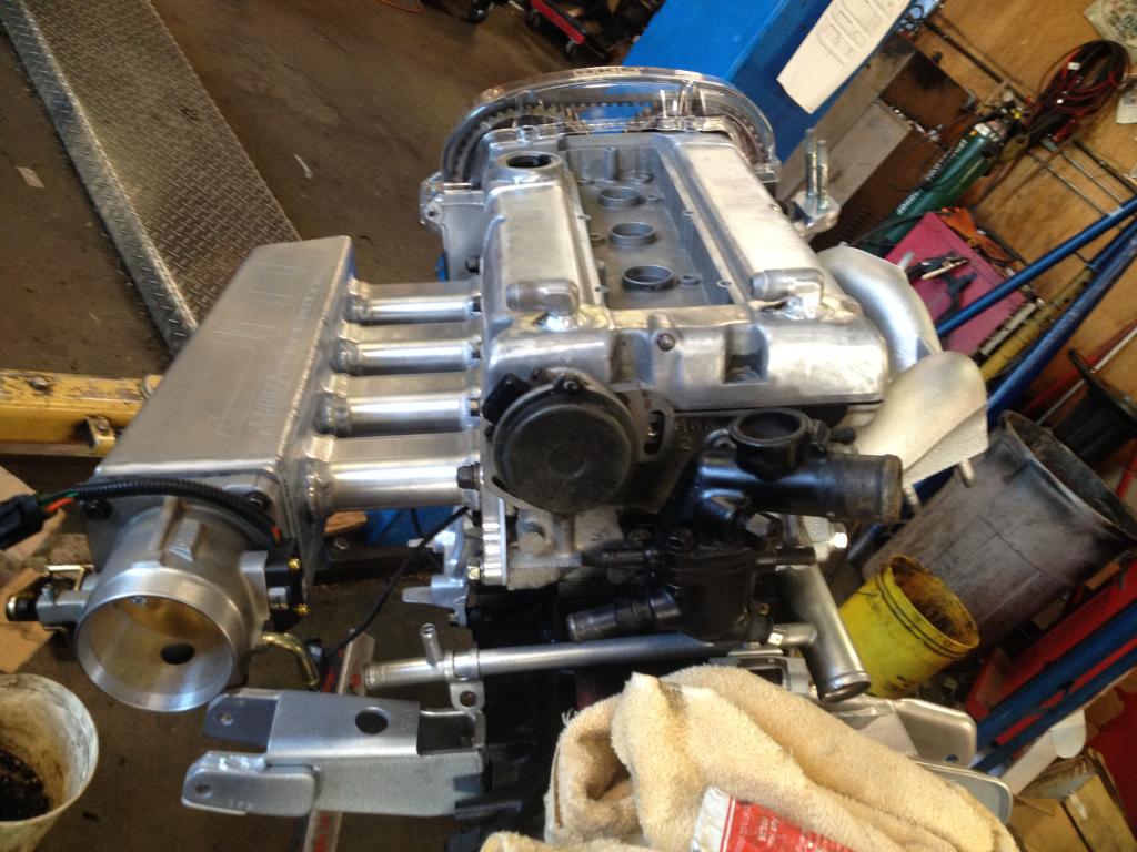

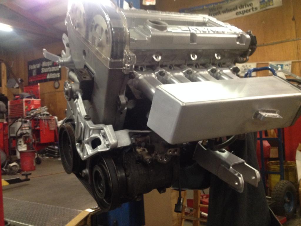

Turbo is on with the flange, all port matched, I THINK I AM DONE PORT MATCHING FINALLY.

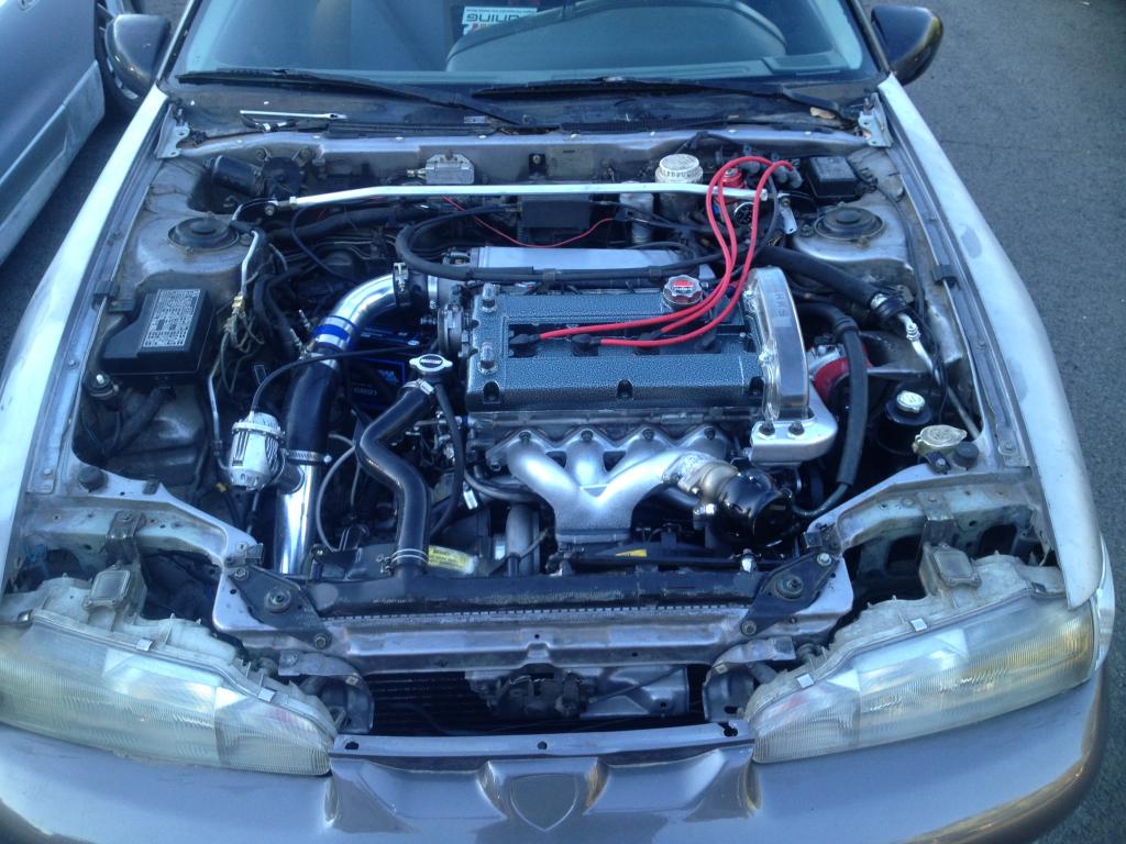

Started hooking things up...

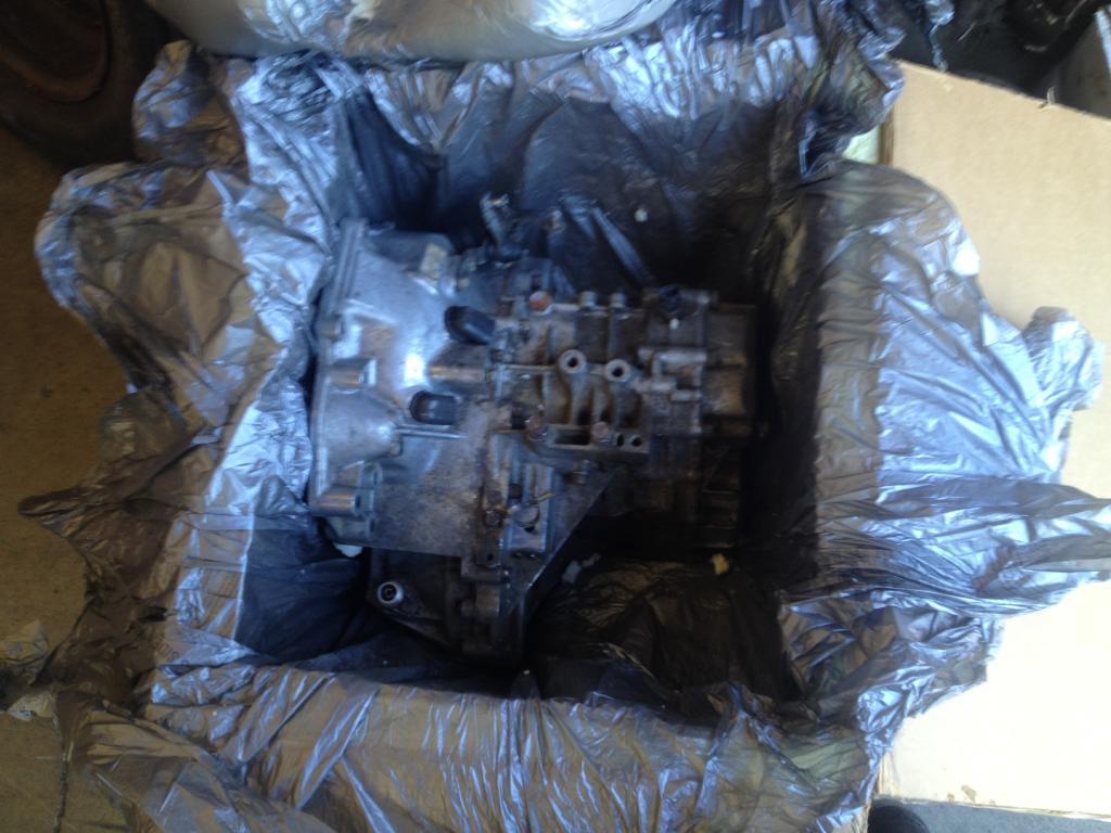

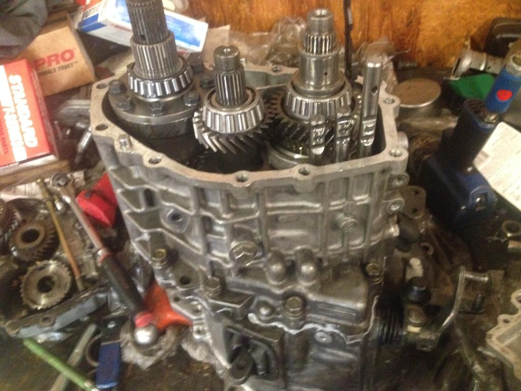

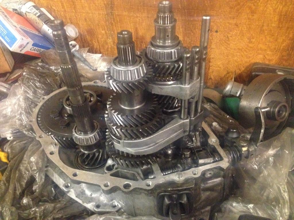

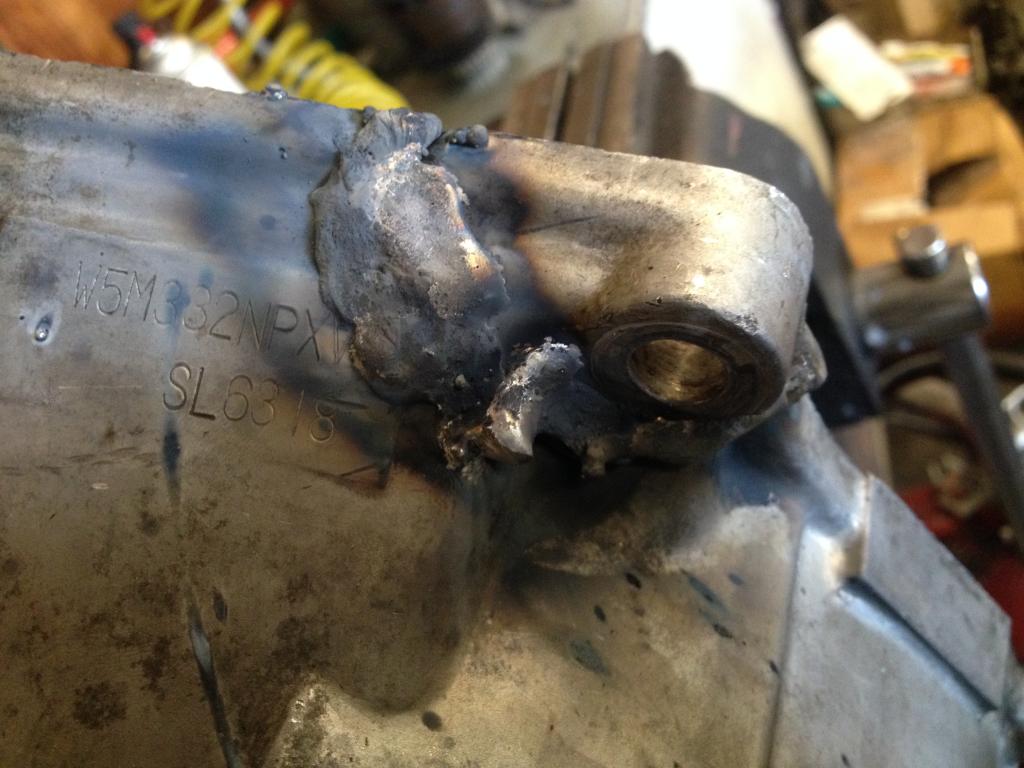

Got a stock 92 trans
Threw the 4 spider diff in it and hoping for the best

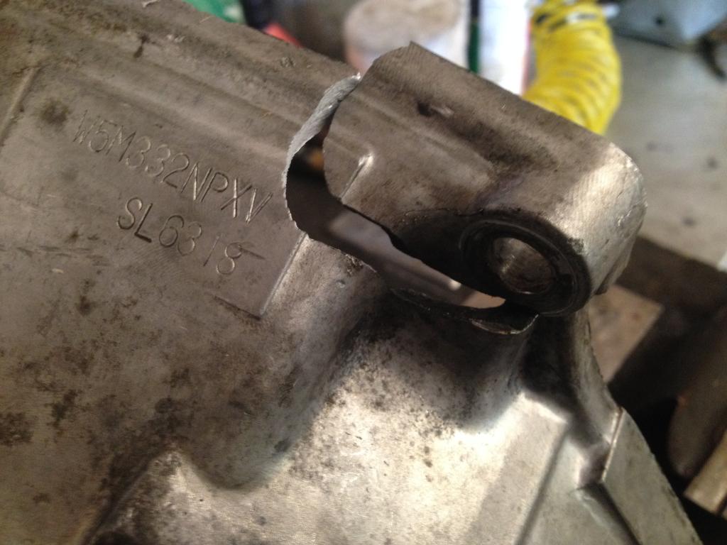

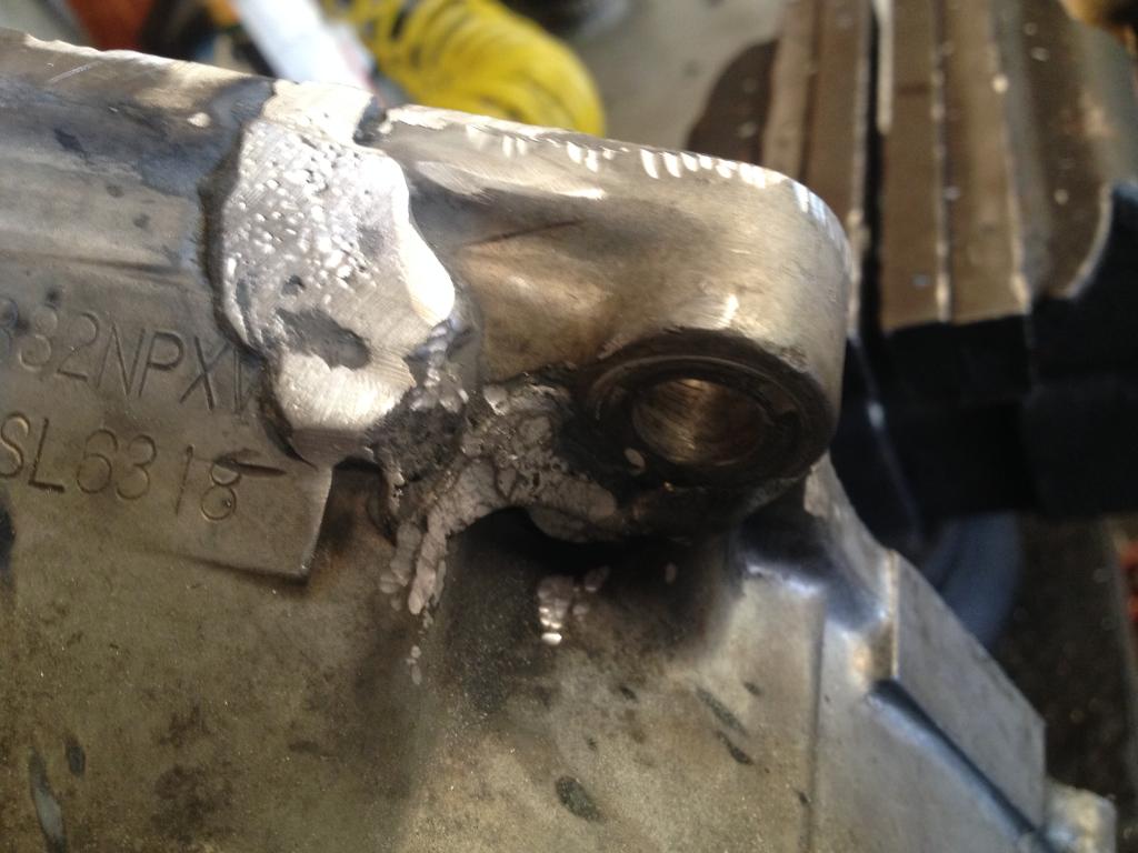

Had to fix a broken ear on it

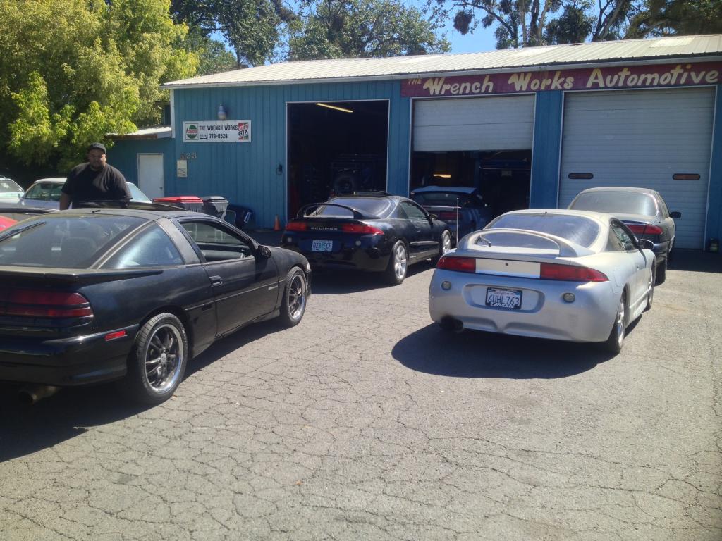

Had a good little hangout at the shop

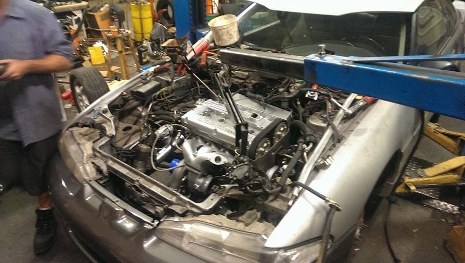

Aaaaaand...
1E913CA9-CF85-488A-9D58-A1102B296867_zpsxzmiynxn.jpg[DOUBLEPOST=1409648104][/DOUBLEPOST]

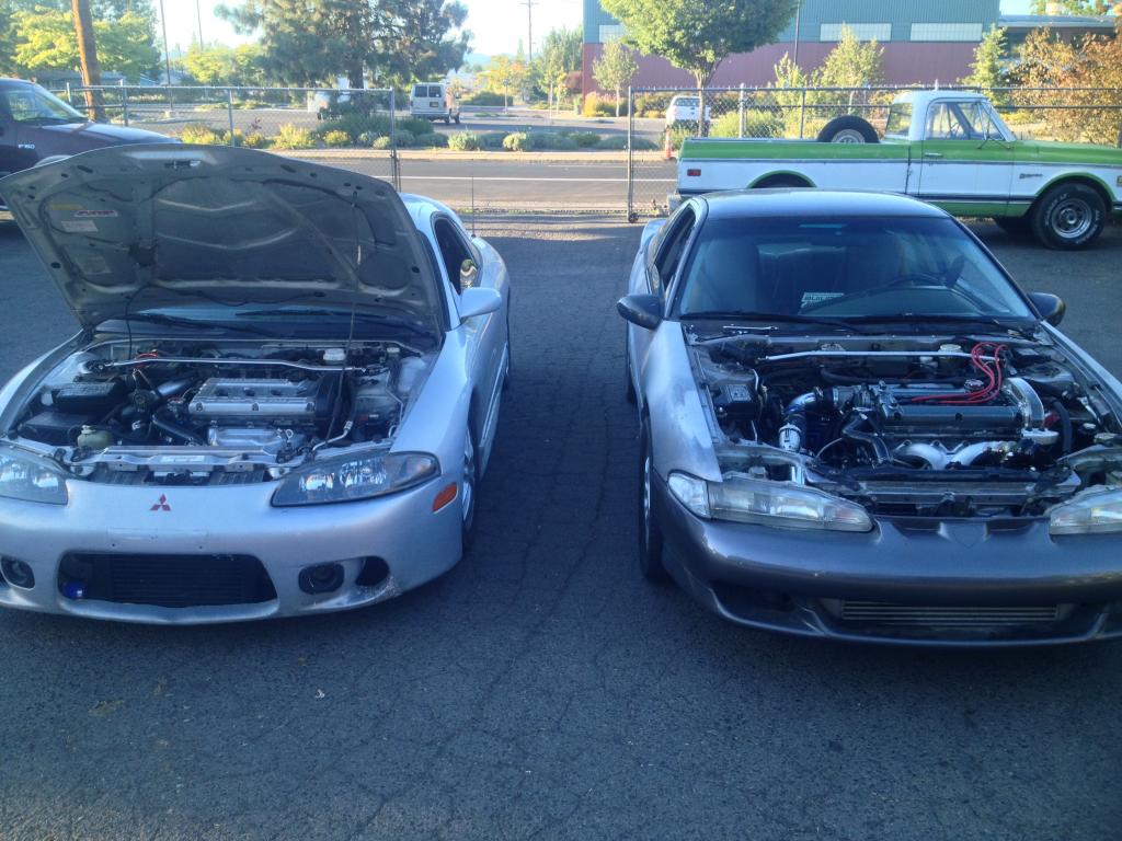

Got 2 running DSMs now!!
