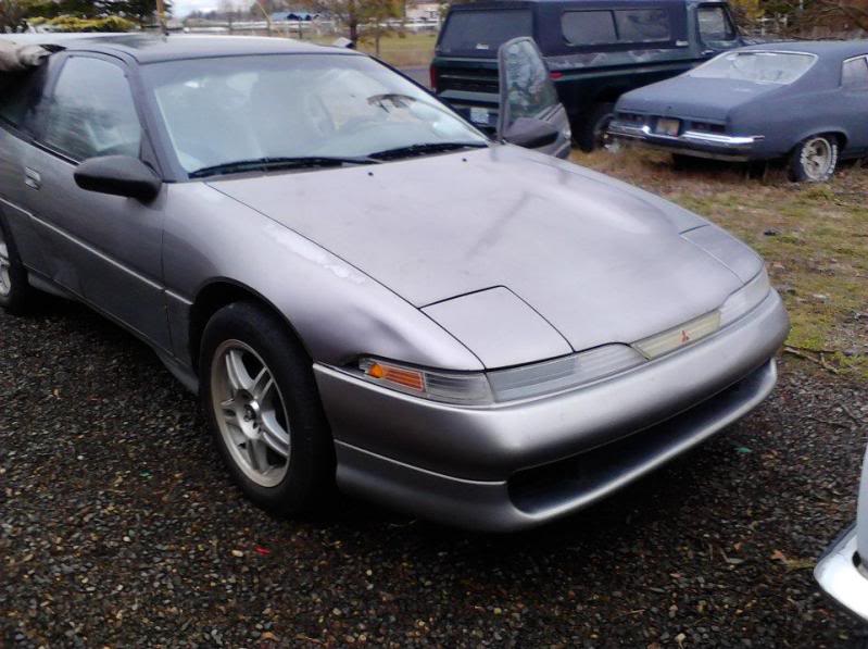

So Ive had this car for the last 9 years finally decided to put it out to the world. I AM VERY PROUD of how good my DSM has been to me. This car has impressed the hell out of everyone including me, and for everyone who says DSMs break all the time, are unreliable, or need totally redone to run decent, THEY SHOULD MEET MY CAR. Id like to start by saying I couldnt do any of this without my dad, and although Ive done most of the mods myself, my dad has always been there to point me in the right direction and of course generously lend his shop for all those late nights.

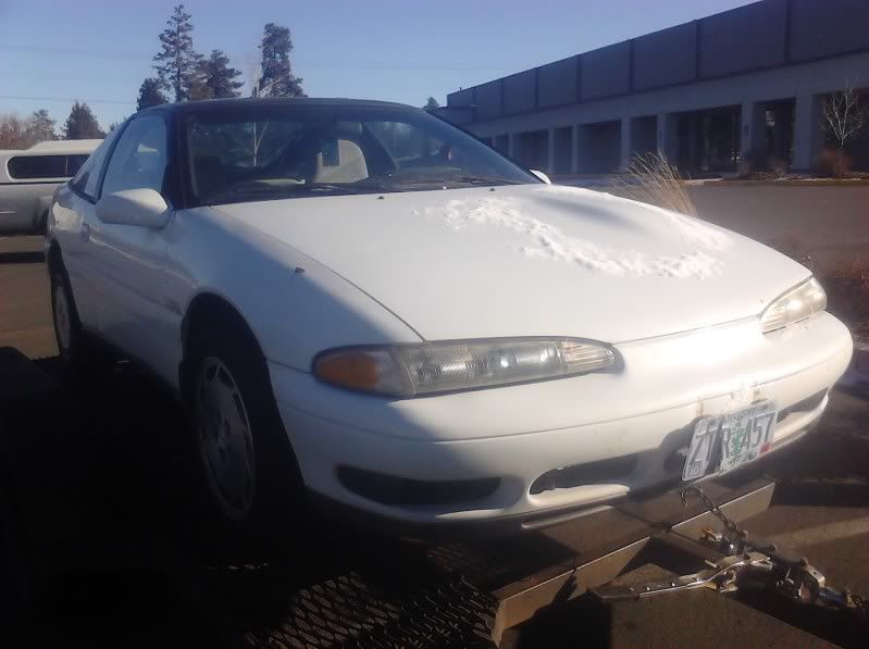

So I bought it in Stockton, CA, Was mostly stock, unmolested and taken pretty good care of. All work was done by dealerships or reputable shops and had reciepts, the mods I can see are KYB GR2 struts, an aftermarket front sway bar on the A arms, and restrictor taken out of the BCS.
It had 167k, I paid a bit too much for it at $2700, but I was young and it had to be mine, and it was on payments which helped.
So I trailered it home, which was $200 alone, and the problem sorting started LOL. First it was apparent the alternator was bad, which obviously the voltage regulator went bad cause there were 8 (Yes EIGHT) blown out bulbs, an array of relays, stock stereo unit was fried, ect. it needed a battery, I changed the fuel filter, the tires were dangerously cracked/aged, So I found some 300zx rims with good tires. Also a retard deer T-boned me 3 months owning it as you can see, his head hit the fender, then he spun around and his ass put the dent in the door. (If you havent heard the Louis CK bit about the retard deer you must listen)

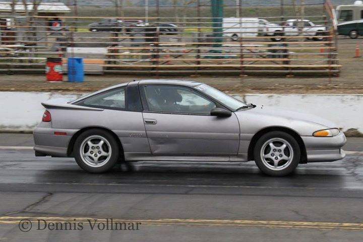

I ran the car at the track and Best it did was a 14.20@95 with a 1.9 60 ft

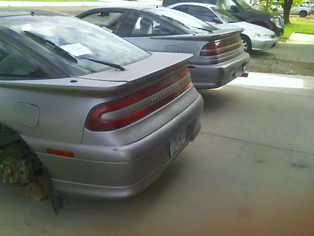

I picked up a 94 GS no engine for $150. This thing was very clean and gave me a lot of goodies :)
I got the seats, steering wheel, master/slave cylinder, shorter shift knob, and all necessary body parts for a 1Gb conversion. It was even the same color. After I was done stripping it went to the crusher and gave me $150, FREE PARTS are cool!!!

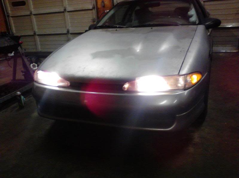

Then I got tired of looking at all those 94 Eclipse panels and finally decided to tackle the 1Gb conversion. For all the people afraid of this just know I did this in one late ass night. Drove in 5pm when the shop closes for business with pop up headlights, rolled out 4am all 1Gb'd out! (BTW I did the rear bumper the previous night as you can see)

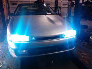

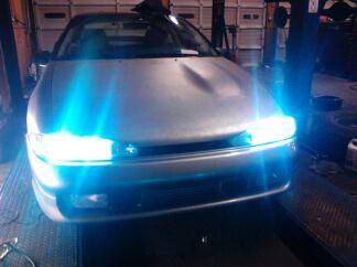

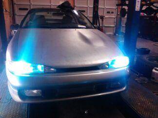

The headlights were brighter, but still not to my liking.... in comes the HID kits! I bought 2 kits for lows and highs, and wired it so that highs/lows are both on at high beams. Theyre GRRRRREAT!

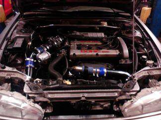

Also ordered ECMlink V3 LITE and finally made use of the socketed ECU I had been running for years, I used this in conjunction with the MAFT and the GM maf still

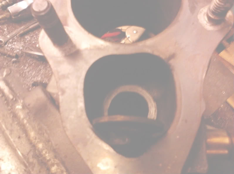

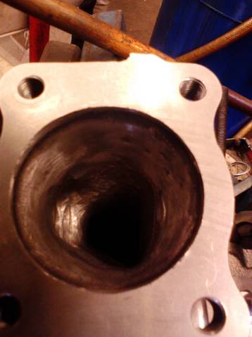

Took off the O2 housing and turbo to port them

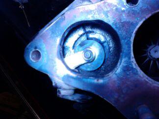

I realized the stock 14b was finished
No wonder it spools like shit!! LOL I actually had to put this busted thing back on to make it home for the night, but I ordered a big16g off ebay that night. Yes ebay, I just needed something to get me by for a while. Also ordered a CXracing FMIC and piping kit
Dont run these intercoolers!!! ....but more about that later
So I knew ahead of time these turbos were known to creep, so I ported it before it went on
I also ditched the WGA and welded up a Garrett actuator to give more throw and open the flapper all the way. These mods and the fact it came with the bigger 34mm flapper, it still would creep to 15psi. Perfect! LOL so running this turbo as low as it could go, was still as high as I could go with the stock fuel system and was hitting mid 90% IDC.

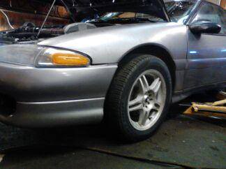

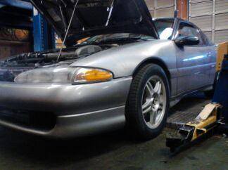

The car sat too high
So It saw the torch

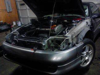

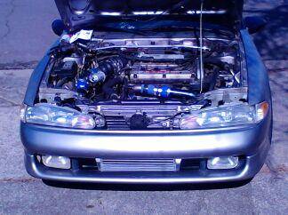

I didnt like how cramped everything was in the engine bay, so I deleted ABS, deleted the charcoal canister and did the battery tuck, Then with the newfound room I switched to blow thru on the MAF and an HKS BOV
I didnt like how unstable the hz readings were with all the turbulent air, and how your AFR would be different daytime or nightime with temps, so I switched to SD
It was at this point I hit the track the first time since all the more serious mods started
[ame=[MEDIA=youtube]EOZy27p5qRo[/MEDIA] vs. 350 Chevy Luv - YouTube[/ame]
13.7@99
Granted a lot of mods for a small improvement, this was with launch control, NLTS, ect, but I was thinking long term and foundation building :hellyeah:

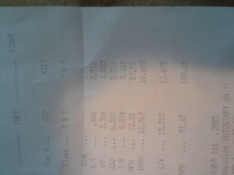

So with boost and revving I went in expecting dipping into a 12, and was disappointed with a 13.26@103! I was pretty let down... After talking to people on the ECM forums I realized it was my intercooler. My IATs were starting around 80 but hitting 150-160 at the end of the pass. I hacked my bumper to fully expose it, I was spraying it with water before every pass to keep it cool, didnt matter. It wasnt heatsoaking it just wasnt thermally exchanging the air it was blowing straight thru. It was at that point I realized a core was not a core. My timing had to be pretty conservative with how hot these charge temps were, and the best I could muster on straight 92 pump was a 13.01@104. Finally at the end of 2012 I said screw it and put a 50/50 race gas mix in, added 4* of timing all around, and clicked off a 12.86@107. My goal that year was to click off a 12 and be faster than the 12.95 my gas hoggin ground shakin Camaro does, and I did it. I loved how much that timing helped the car, it even sounded meaner going down the track, however that one time running race gas toasted my stock O2 so I had to switch to O2 sim, and it was so depressing when it ran out and you had to detune your car....Heres a couple vids from the 2012 season

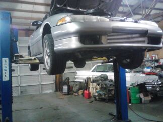

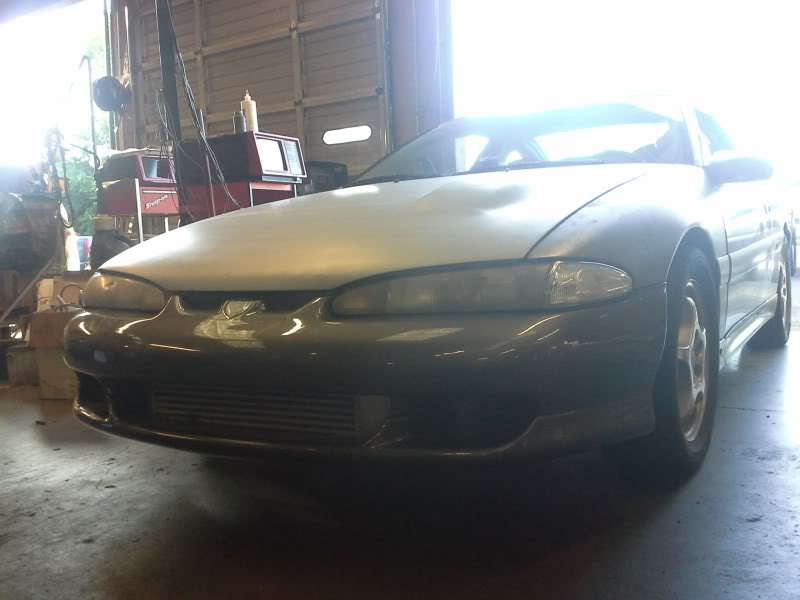

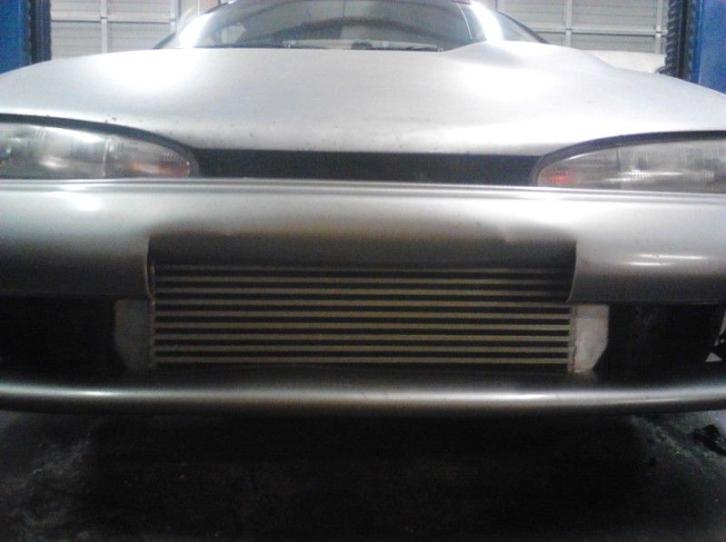

So fast forward to 2013, I did the VRSF fmic
This thing is awesome. Welcome to ambient charge temps all day any day. I felt a little more power on the butt dyno just from this mod, so I added a degree of timing, it took it, added another, no knock, then another LOL. I added 3* of timing just from a better FMIC. Yeah buddy!

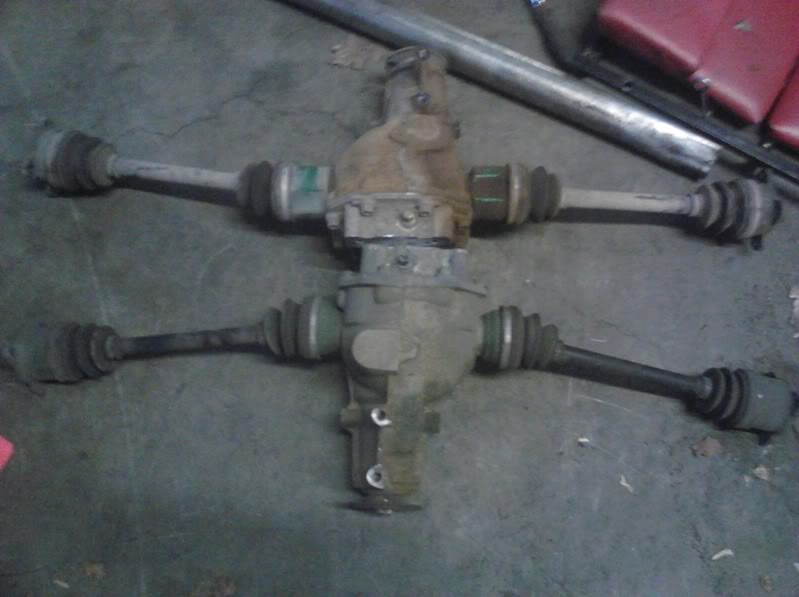

It was then I took my car to the snow and got very out performed by a WRX with LSD rear. I thought "gosh I need to get rid of this 3 bolt"

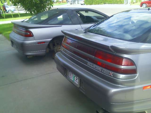

So I picked up a 92 AWD laser.
and what do you know it had a 4 bolt LSD rear :)
So I did the ol switcheroo and got me a 4 bolt rear

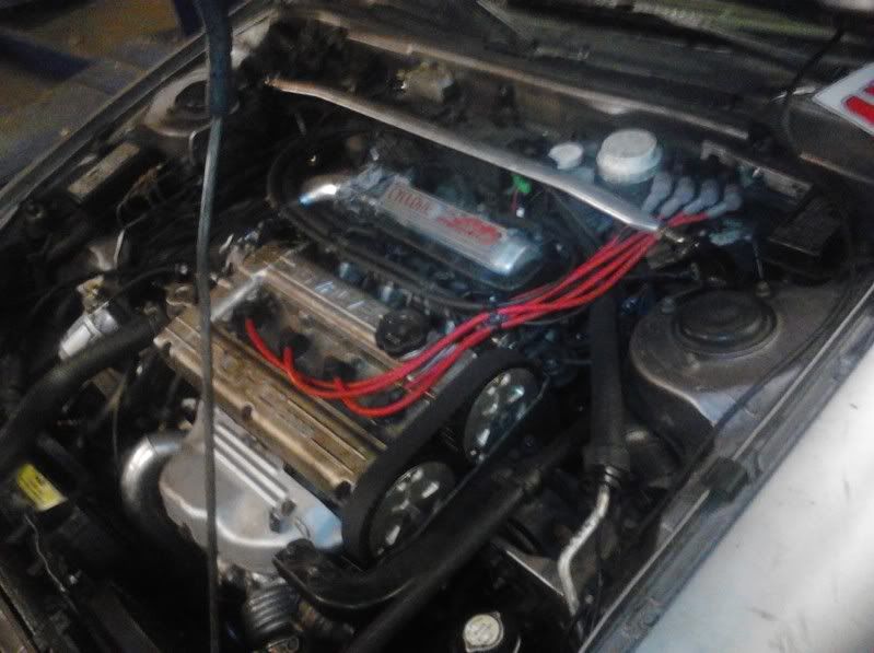

The clutch was on its last leg after 3.5 years of torture, I was still running balance shafts with about 40k on the balance/timing belts, I was still on the stock intake and had horrible off boost power which I realized was part due to my cams being a half a tooth off... So I started plotting for a big upgrade week...

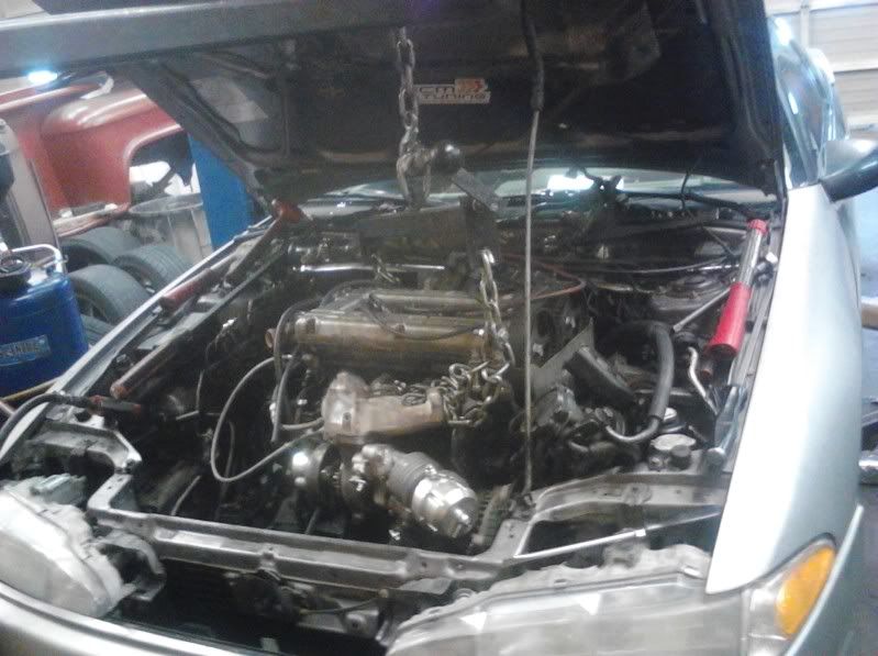

I pulled the engine
Changed knock sensors

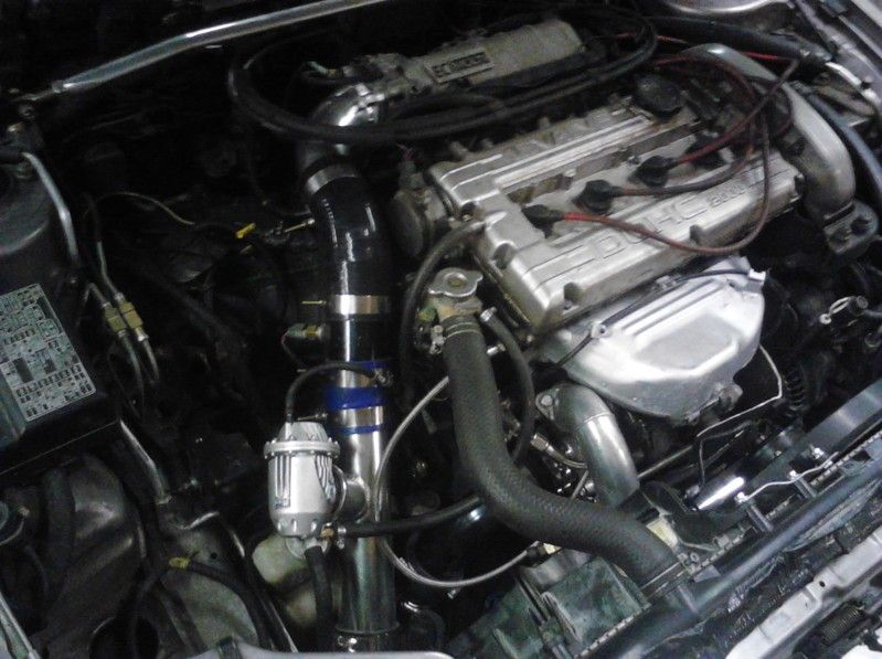

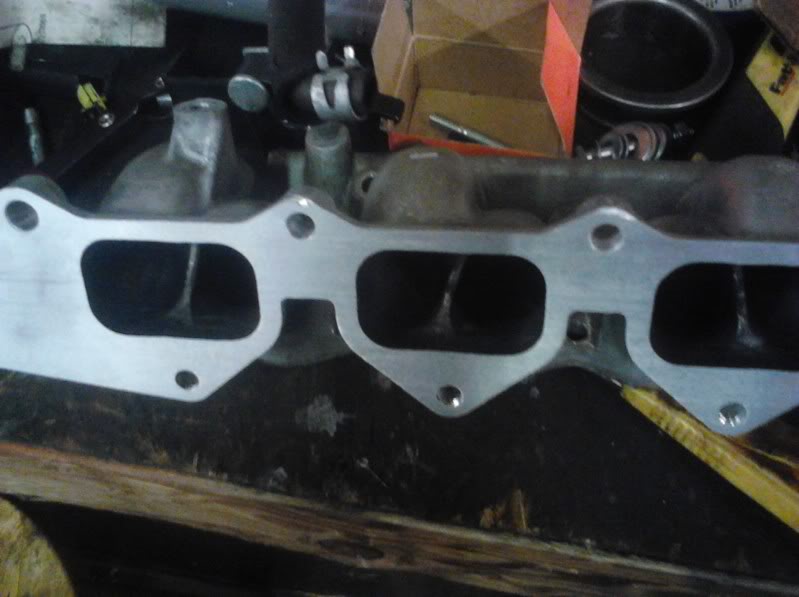

Did a cyclone intake
Upgraded to V3 FULL

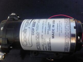

got all the pieces for a water/meth kit

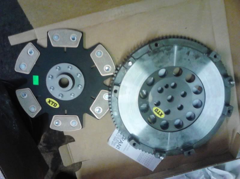

XTD stage 4 with chromolly FW, CC forged fork/pivot ball, OEM tob, SS clutch line
Pulled balance shafts, did a timing belt, and AEM adjustable cam gears, mounted the Coils/igniter on the firewall

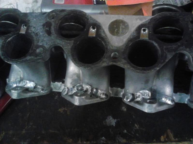

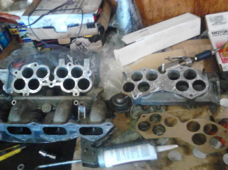

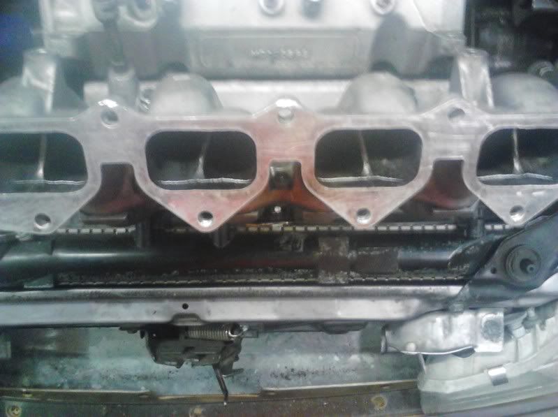

Realized cyclones dont work with AC the hard way and cracked the runners
Tried again
(sure am glad I pulled the engine to change intakes just to have to do the swap with the engine in LOL that shit sucked)

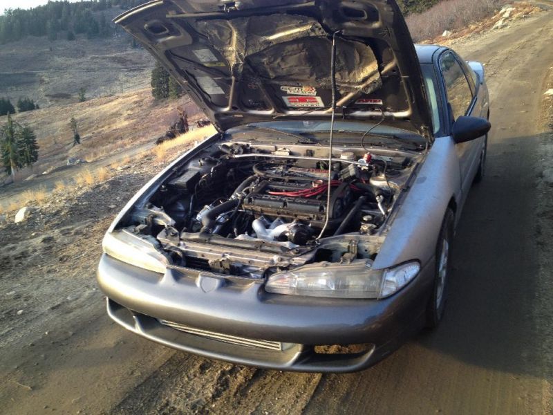

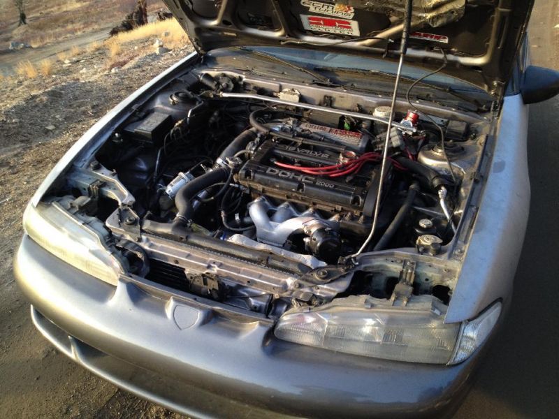

and that pretty much gets us up to date on mods
I have been tuning with the water/meth injection, I worked up to the same timing tables I ran with the race gas mix last year, and opening day at the track did pretty much same time 12.92@107 at 22 psi(spun a little, fresh track) Might be a little ambitious but Im hoping to reach the 11s this year, but if you were paying attention to mods, I am still on the stock longblock/trans, run 12s with bolt ons on pump gas with 210k on the clock, still daily drive and get 21mpg town, so we'll see how this year turns out but either way this thing has proven tough as nails :)

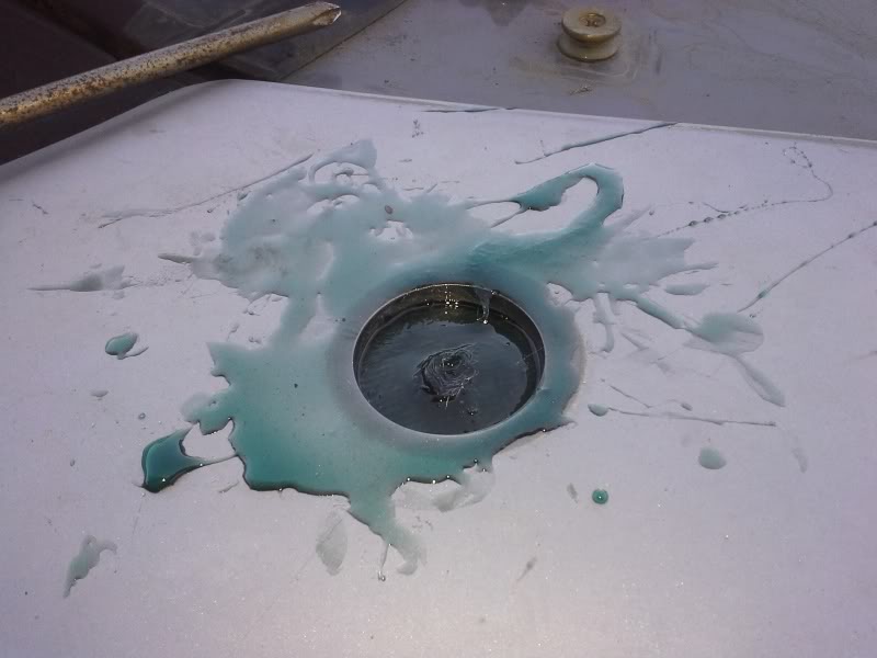

nice build... Also wondering how the AC cracked the runners.
How did the a/c crack the runners? WTF I've never had that issue on any of my Cyclones.
So engine was out, AC compressor was unbolted and left in the car lines hooked up. The Cyclone was put on the engine, lowered in, and the AC compressor never bolted up flush. It acted like it was binding in the mount and wouldnt go the last inch and suck up. I said screw it and left the AC belt off for a couple days, then I realized the Cyclone was leaking at the mating gaskets (the guy I bought it from had seperated it) So I took the intake off, engine installed, and did gaskets to seal it all up. With the intake off I said, "Hey I can get to this AC compressor way easier" So I tightened it all the way up, and figured the engine vibration unbound it. Then when I went to put the intake back on, it seemed to go on okay but when I boost leak tested I had a giant boost leak on the bottom of the runners and they werent flush with the head. I thought it was just binding on the stud theads so I fought it for hours, eventually tried drawing it in with the bolts, and you see what happened. Its pretty tough to see if youre not looking for it but the #1 runner hits the top of the AC compressor and they wont work together in stock form. Never read anything about it with all my Cyclone research before I bought/installed but once this happened I looked around and it happens, also to 2Ga guys

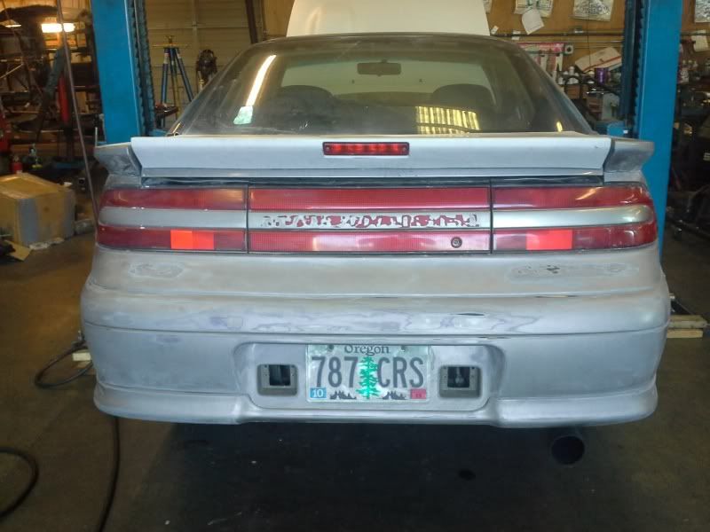

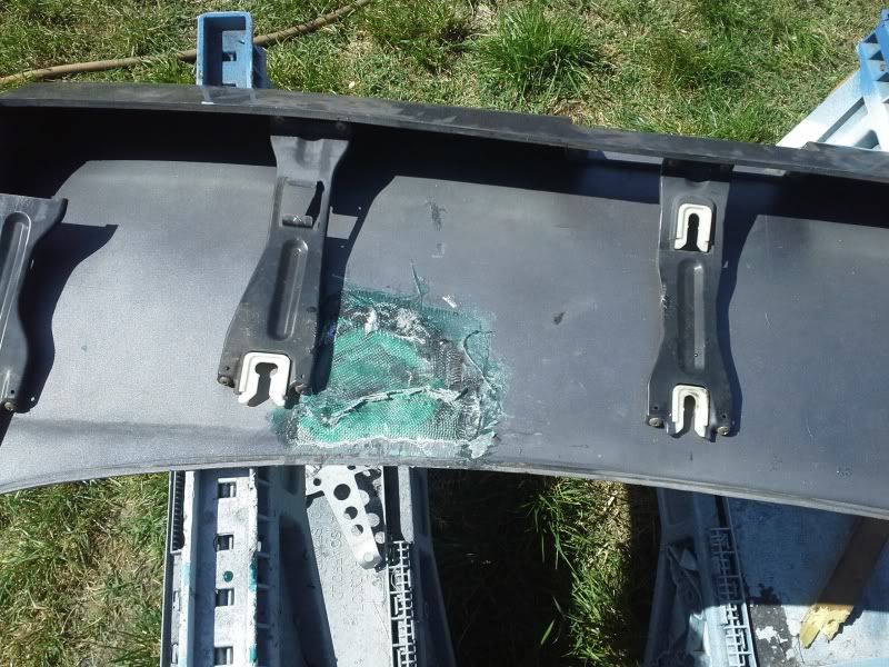

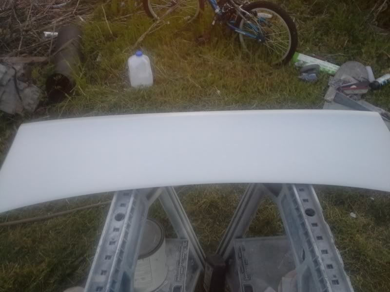

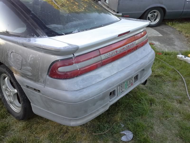

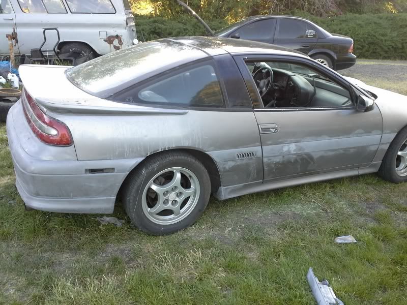

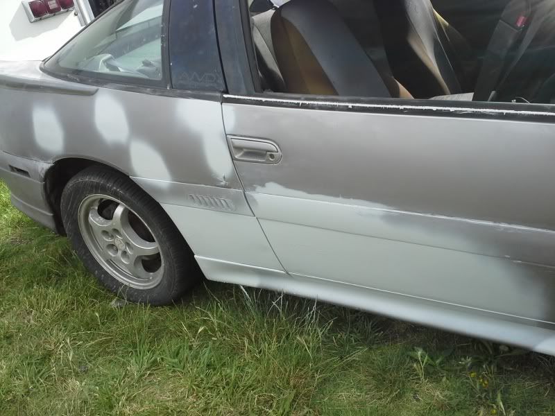

So on a new chapter of this car I started on bodywork on this thing. Its well overdue, this thing should look half as good as it runs and not be scoffed at. It looked pretty much perfect when I first got it but with time the clearcoat started coming off, and the 1Gb panels I swapped on had been resprayed in a horribly cheap single stage, so has no gloss at all it looks primer! Also along the way I'll be looking into some weight savings, cause this thing weighs close to my Camaro, and more than my buddies 5.0 stang, which just aint right.

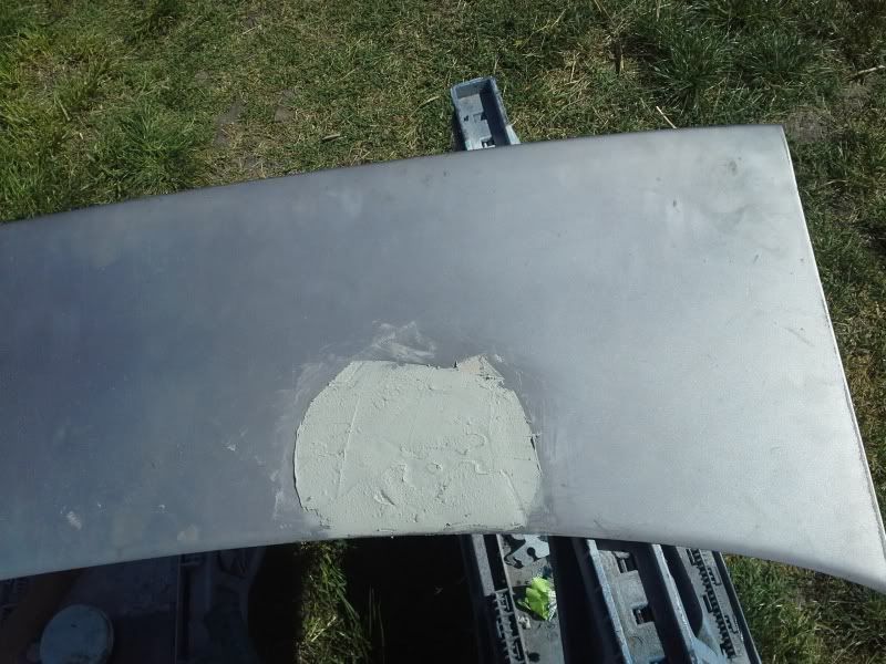

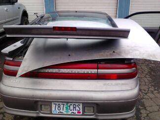

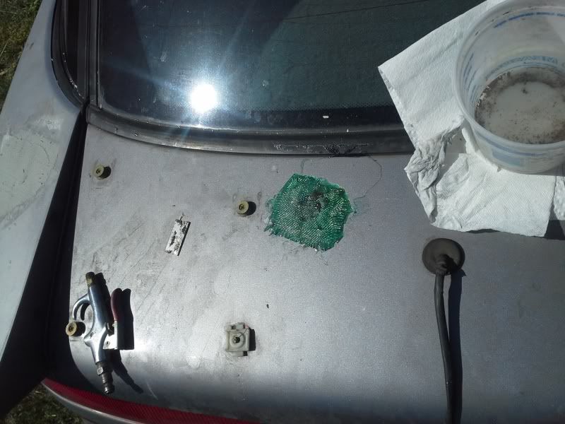

So first things first Im shaving some of the options/devices I wont be using- The rear wiper, antenae, rear washer wiper.
First was fiberglass
Filler
Then primer surfacer
Well thats what I got accomplished today. Pretty happy with the progress, more to come tomorrow
So original plan was to primer sealer every piece as its prepped out, until finally ready for paint. but after consideration I remembered theres a 48 hour window, and if you dont paint within that time you have to sand the sealer back down, so really Id be making more work for myself, so just gonna sand and prep everything, do primer surfacer in spots needed, and wait for sealer at the same time as paint. Big thing is just have to be conciensious of moisture (god its tough when you have to drive the car youre painting) So today all I did was some serious sanding.
1 Question tho. Why the 1gb convesrion?
Where do you want me to start? LOL
1. Weight
2. Engine bay room
3. Aerodynamics
4. Headlight bulb options- halogens in the pop ups still totally sucked, and retrofit HIDs are expensive
5. It was free
6. I just think this looks awesome
I have a 1gb,But I would love a 1ga,those sexy things.But its still your car I was just asking.
I have a great starter package if you wanna convert. Hood, Fenders, parking lights, rocker panels, rear bumper, dash bezel, pretty much only thing Ive sold is door trim and headlight buckets. and Im still using the 1Ga front bumper cause donor cars was no good
love the 1gb conversion, I'm doing the same on mine
Its really not as big of a deal as everyone makes it out to be... Once you have the 1Gb headlights and hold them up you know exactly what you need to do.

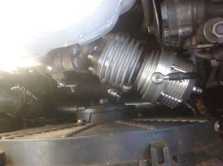

Well my EWG is an eBay knock off for the awesome price of $65, at WG pressure it was 13 psi, and most I could do with a controller was 22, so I bought a small blue spring, and popped that puppy in, now its 23 psi WG pressure. :rocks: I tuned it to 26
[ame=http://www.youtube.com/watch?v=Gqyl_ymxbEk]New tune 26 psi 20g DSM 91 GSX - YouTube[/ame]

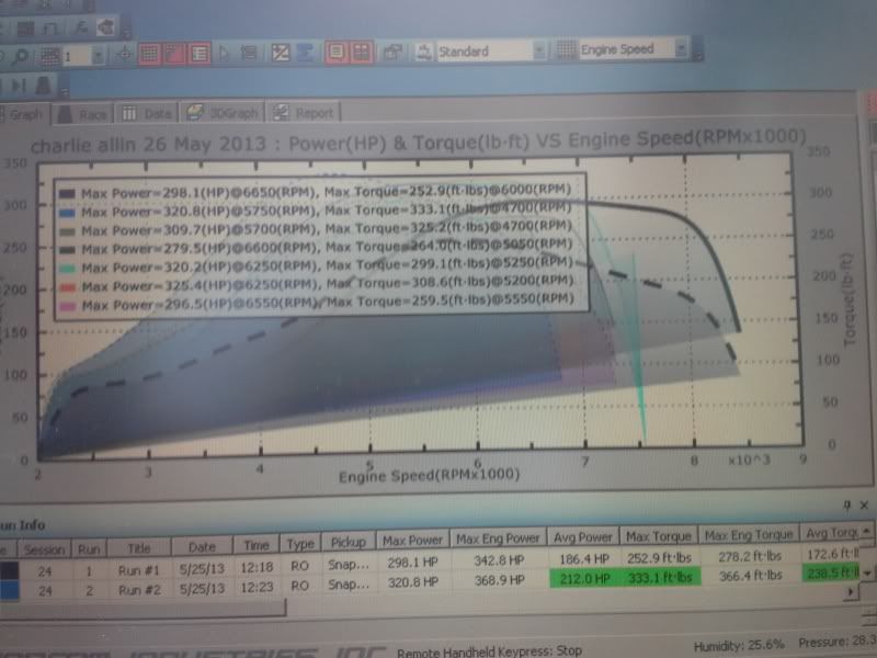

but it didnt give me the giant power boost I was expecting... I was hoping this was gonna blast me to knocking on the 11s... and instead did a 12.61@110... I still trapped the same speed! WTF! I didnt drop timing no knock ect. The dipstick did pop out tho so Im thinking the ring sealing isnt the greatest, when I leaked it down it was around 20%... but stay tuned, I picked up a 94 trans, and gonna do an OEM rebuild on that, probably with a welded center diff, and will probably do an OEM rebuild of the engine as well while its out. At this point Ill need another DD.

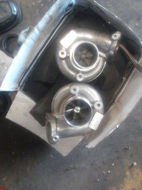

Well the car has an official sponsor of Turbo Lab of America, and a T3 upgrade is in the works. Also of course has the unofficial sponsor of my dads shop, JRs Wrenchworks. Had a pretty insane night at the drags. They tried something new called mignight mayhem, starts at 10pm and heads up running till 2am! (super dense air) and burnout contest, only $10 to run, yeah I was down! I pulled in around 7, a little early so I could watch some friends run the early races, had a couple beers and hung out, then noticed my car had a BIG trace of oil puking out the right front tire area. I had the center diff out around 3 weeks ago, and thought theres no way it could've been leaking this whole time...after some investigating I saw the sidecover had cracked!! YIKES! It was right at the input shaft area so knew exactly what it was, the 34mm nut came loose. Well it was getting dark fast, I was a little buzzed, I finally said screw it and jacked the car up on the pit pad, cell phone lights, battery impact gun, ride to the shop for thread file, FIPG, another 34mm nut, 90w, it was a crazy thrash session but I had it together and pulled into the lanes about 10:10. It was super crowded and had an insane turnout, I guess the change of venue brought out new faces. I was surrounded by 15-17 second Hondas/ricers, it was actually pretty hilarious. All the new faces had never seen a DSM apparently and nobody gave it a second look. I pulled up with a GSR swapped civic, his buddies said to my buddies, "I bet he gives that eclipse a run for his money!" My buddy said, "No it wont LOL" Well I did the honorable thing and counted to 3 after he chirped away, and gave him a good head start, and caught him about the 3-4 shift LOL. Vtec this!

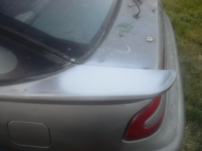

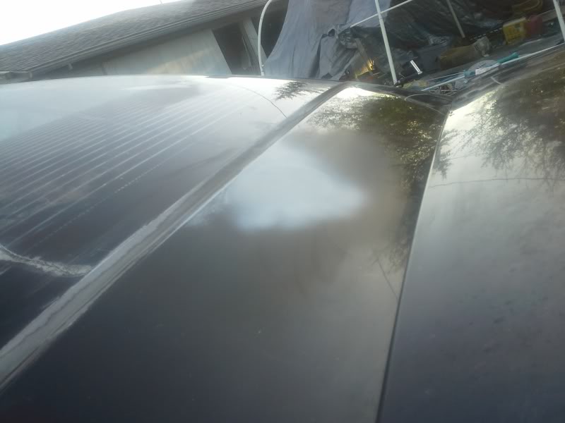

But still goin on the bodywork, used a unispotter on the door and got it all straightened/primered.
Still not sure what Im doin on paint yet, I don't wanna jamb/engine compartment prep, so Ill probably do the stock color with a little pearl for that little something extra. Well thanks for reading, stay tuned!!

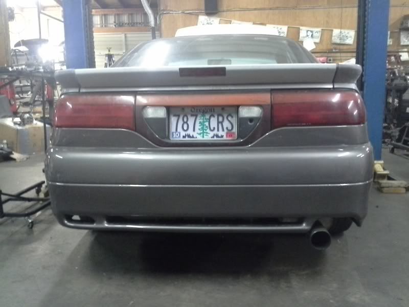

Scored some MUCH MUCH sought after parts. Ive always wanted to convert my car to a 1Gb Talon, but the parts were always kinda tough to find. Well after a 7 hour drive (one way) and straight back I got everything I wanted. The front was very very straightforward
When I do the rear Im also planning on shedding some weight out of the crash beam. Stay tuned!
IF you're looking for a 1gb talon spoiler let me know. I have one in my garage :)
Thanks I think Im okay with the crossbreed it is now :)

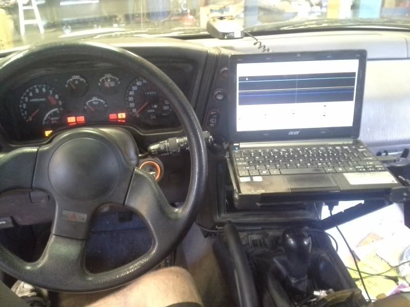

Laptop mount

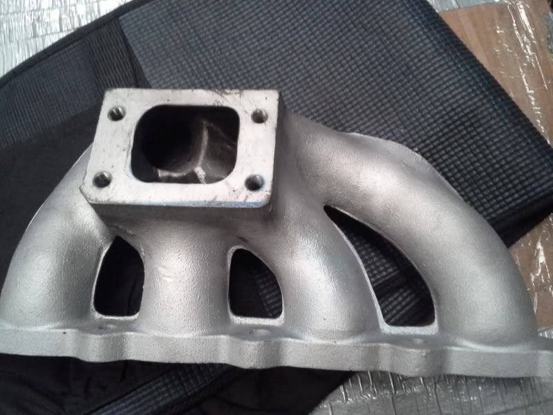

T3 Cast mani
