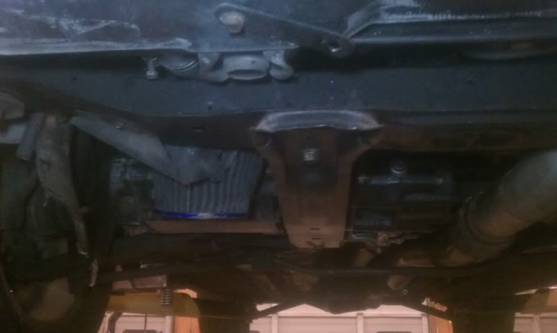

Is your exhaust pipe touching the converted talon bumper cutout? It looks very close. Second the laptop mount question. Does the mount fold up/stow when not in use?
In the pic yes, the exhaust fit perfect for Eclipse bumpers but Talons are over more, its been fixed tho.

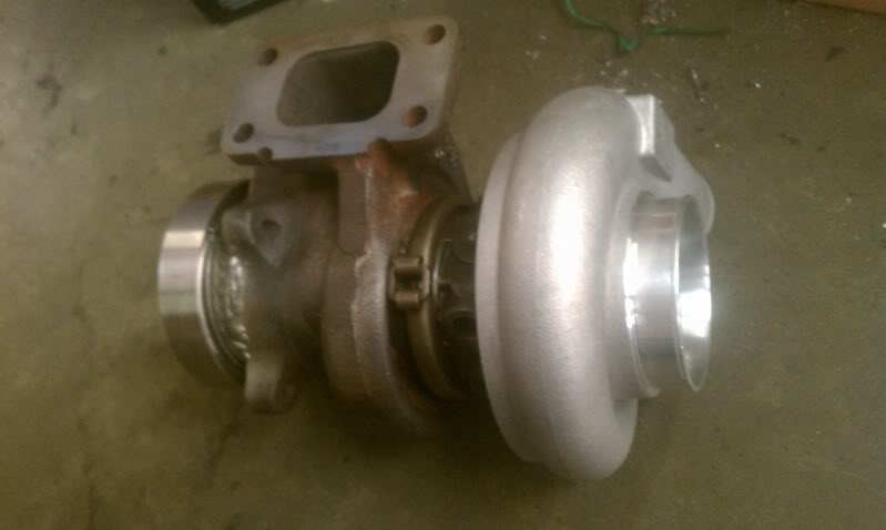

The turbo came in today

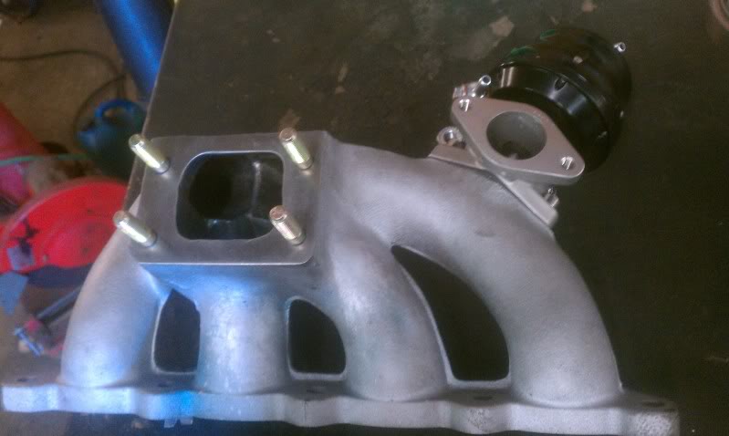

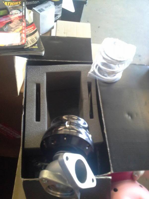

So really trying for some more simplicity on this one... V-band outlet, no O2H, and moving the EWG.

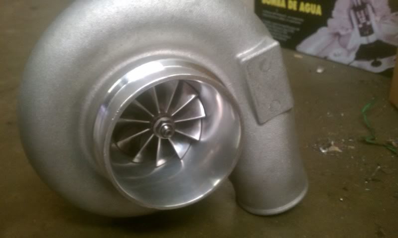

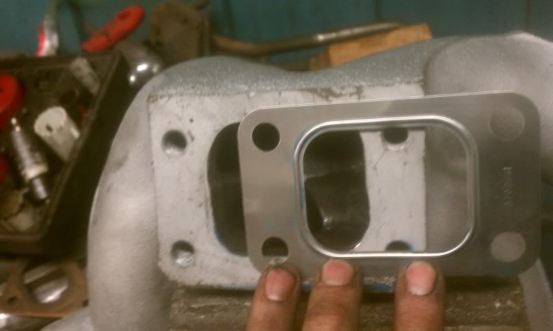

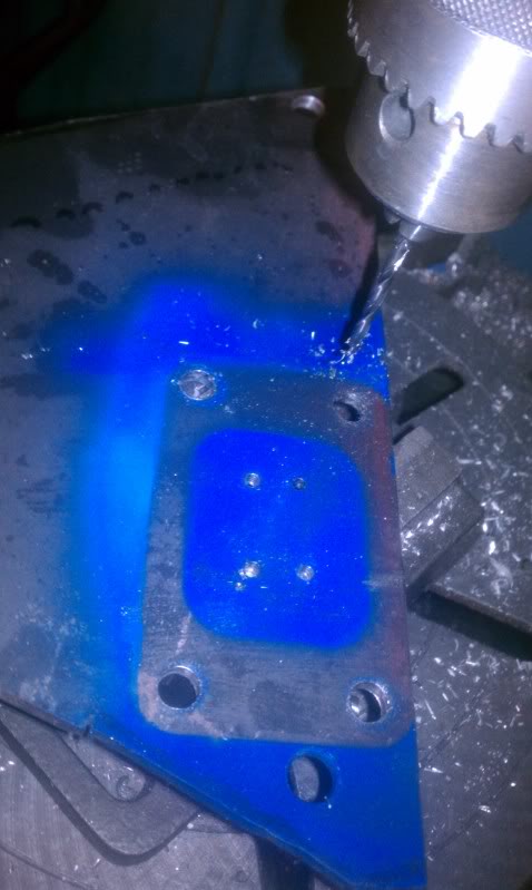

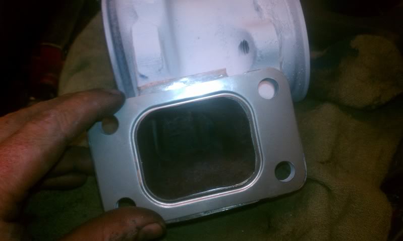

Specs are its a TD06H4 hotside, with a billet 11 blade 3076 compressor wheel in downfiring cover. First order of business was to port match everything... which is a ton of work for me since the T3 exhaust mani is a little off compared to the turbo inlet

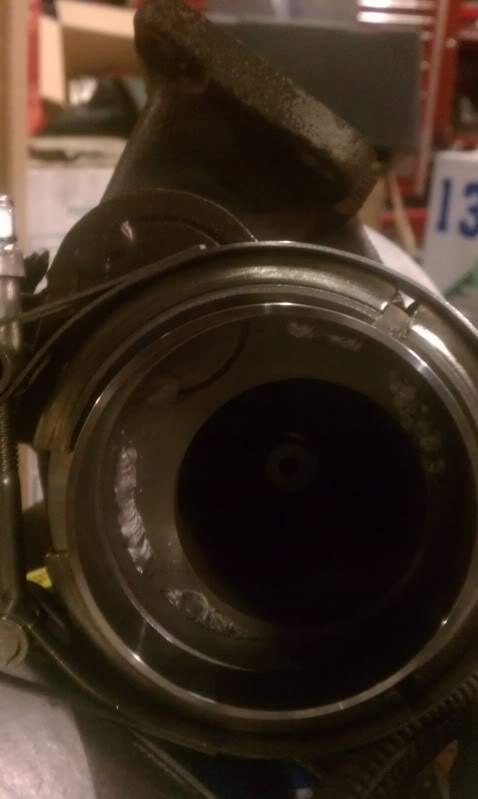

If you look close you can see one sides flush, another is off.... no worries tho I always make due with whatever Ive got

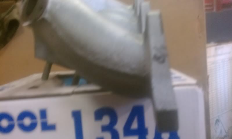

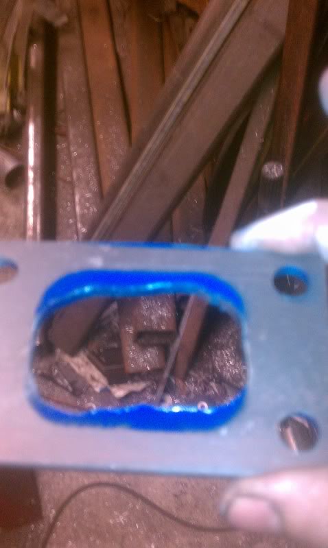

So just making a thin plate to port match it, we'll see how it turns out. I ported the shit out of the exhaust mani, there was a lot of nasty casting marks and cleaning up to be done. I didn't take many pics cause it was a 14 hour day, more to come thanks for reading

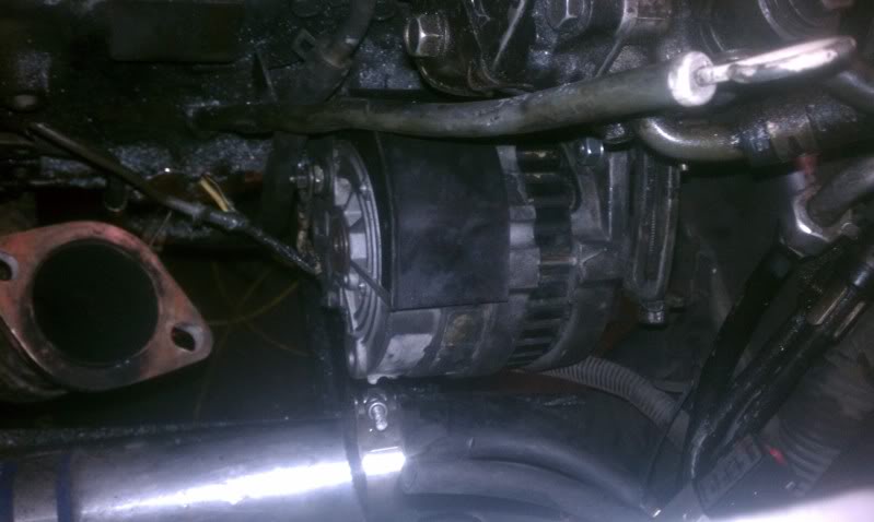

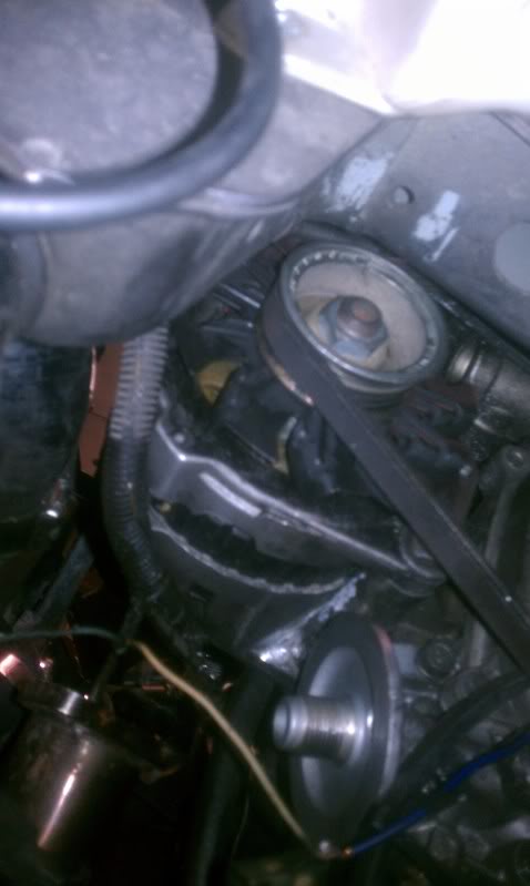

...and as promised (as if you cared LOL) The Saturn alternator went on
Quite a lot of clearancing involved but its all good once its on.

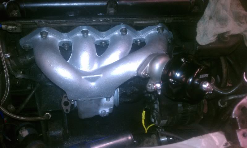

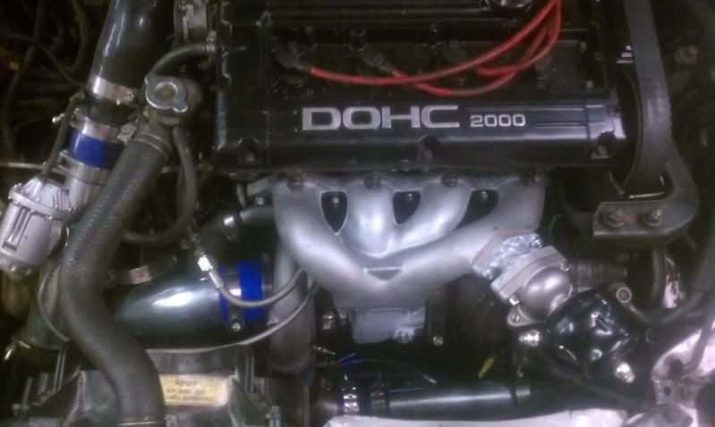

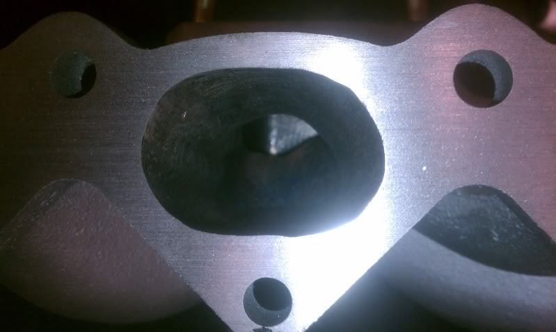

Finally all done with all the work on the manifold... port matching, resurfacing all mating surfaces, and of course porting for flow as well.

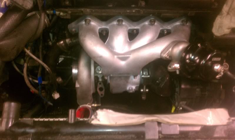

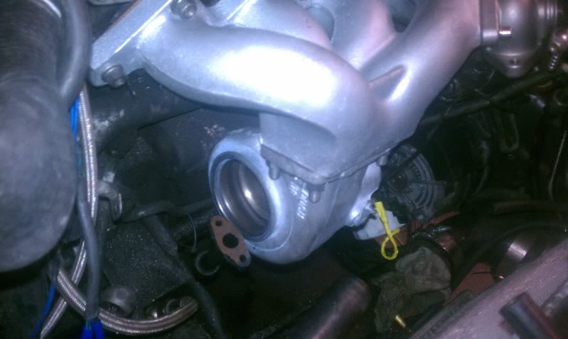

....and guess what?! The turbine housing hits the block! I was real nervous on the clearancing of this one... I took a little off of both the block and the housing... Its very close but at least the gasket surfaces will sit flush

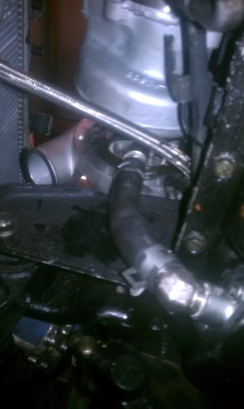

Had to run one of the water lines (the one that doesn't go into the turbo but runs all around the thing along the block) in a totally different way to clear the compressor housing, put it BEHIND the lower rad hose, Also had to do some more lines in soft line... the front water line was totally different so changed that, and the oil drain was different as well. Basically this manifold sits the turbo lower and possibly a little closer to the block.

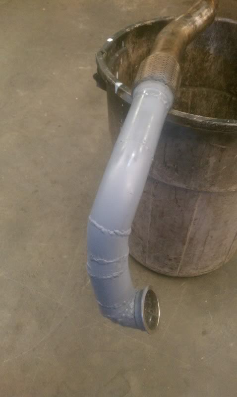

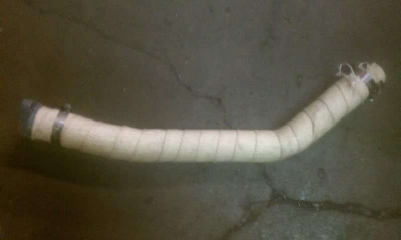

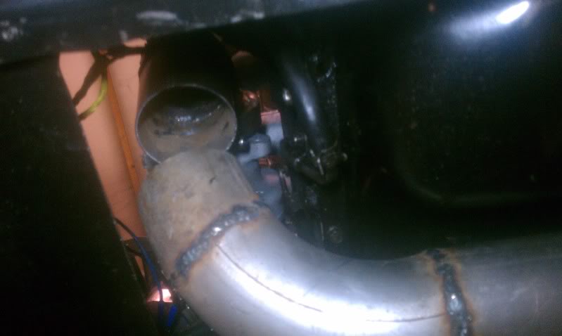

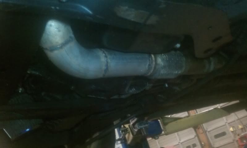

I started on the downpipe, that part is gonna be a bi***, super tight when you do V-band outlet. thatll take up most of tomorrow and maybe itll fire up

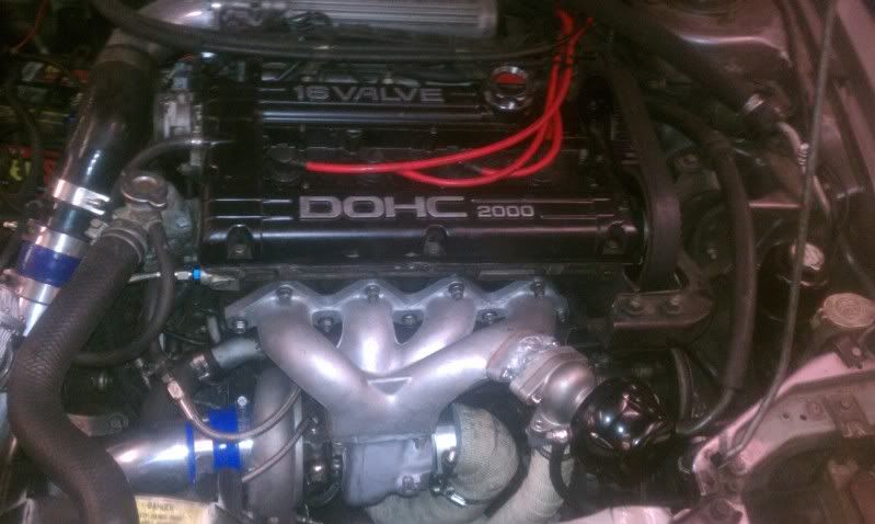

So the car runs in and out of the shop at least...turbine housing hit the block so had to have the machine shop bevel resurface the mani

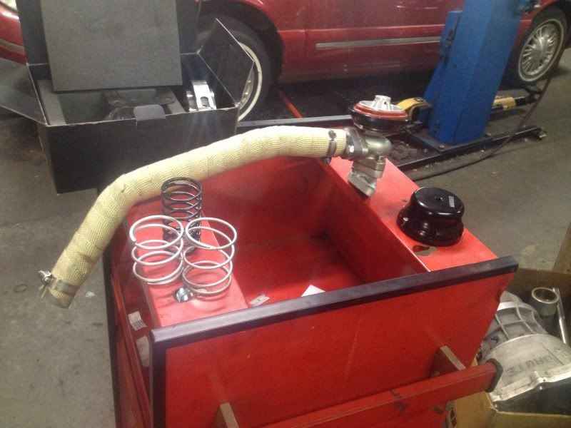

Intake setup is done, hotside charge pipe is good, wastegate clears the hood and closes now. Just got some more plumbing to do, and one of my coolant softline is leaking junk fml.

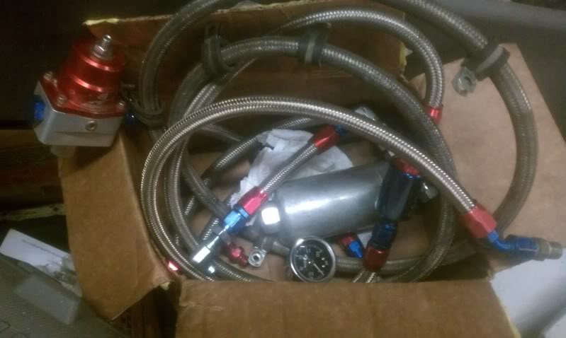

well the rewired walbro 190 started to show its limits after 25psi of boost... so the whole fuel system got an upgrade. A Bosch 044 went on a modified stock hangar, -6 AN from tank to rail, then an aeromotive regulator. Ive been working back up to 25psi and seeing where the new turbo likes to really sing

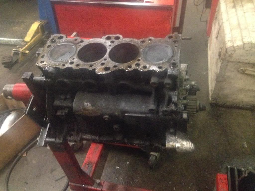

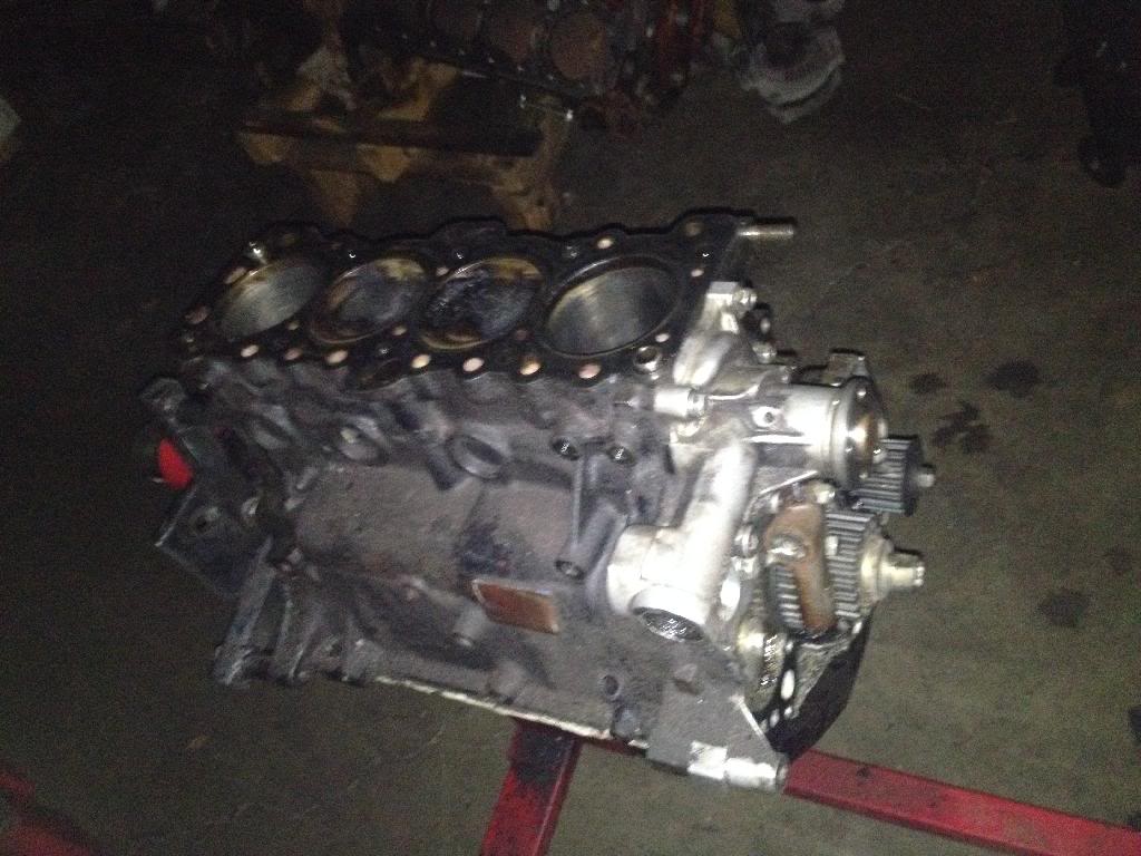

Got the shortblock out that I got from a member

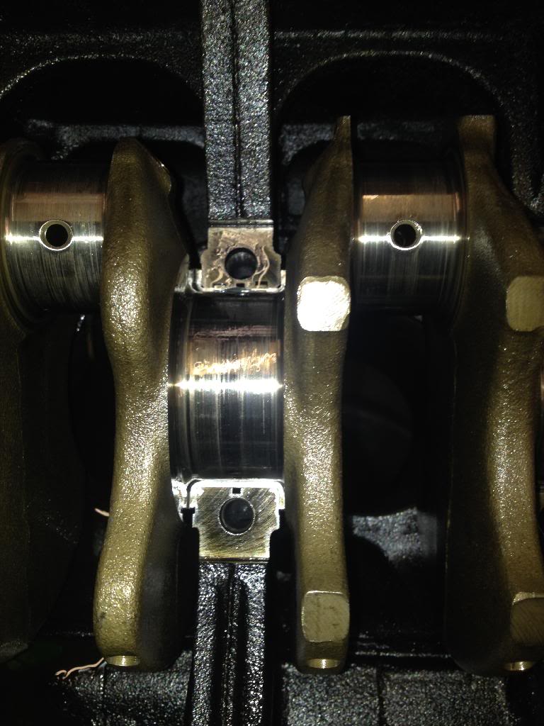

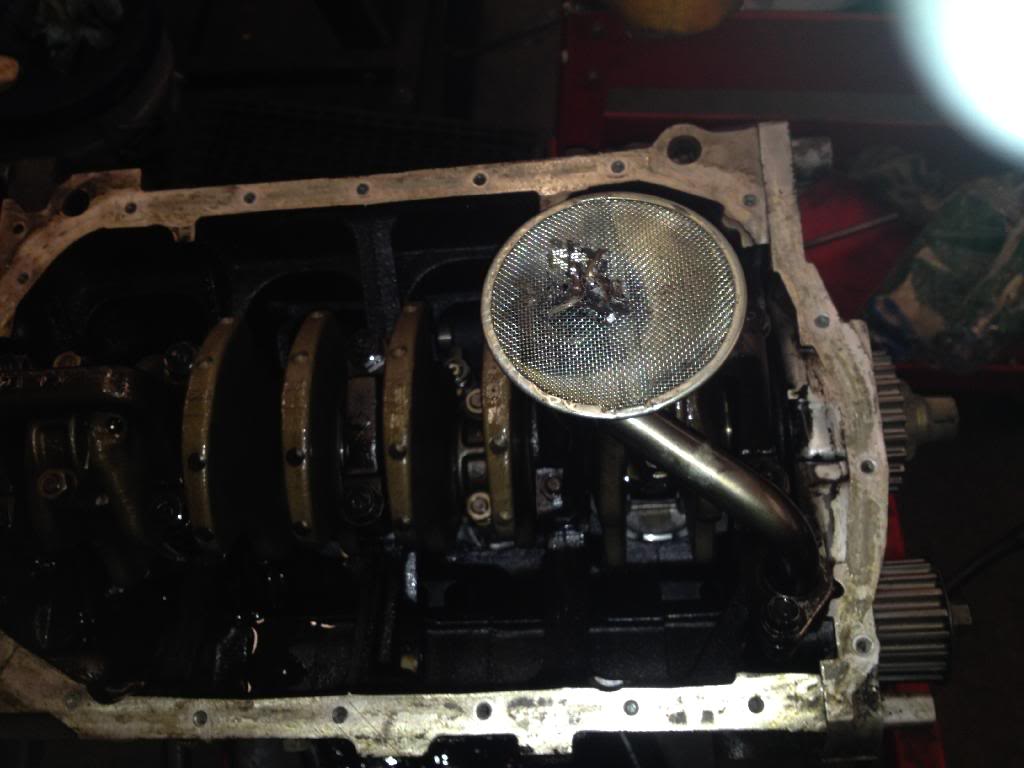

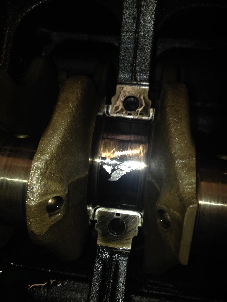

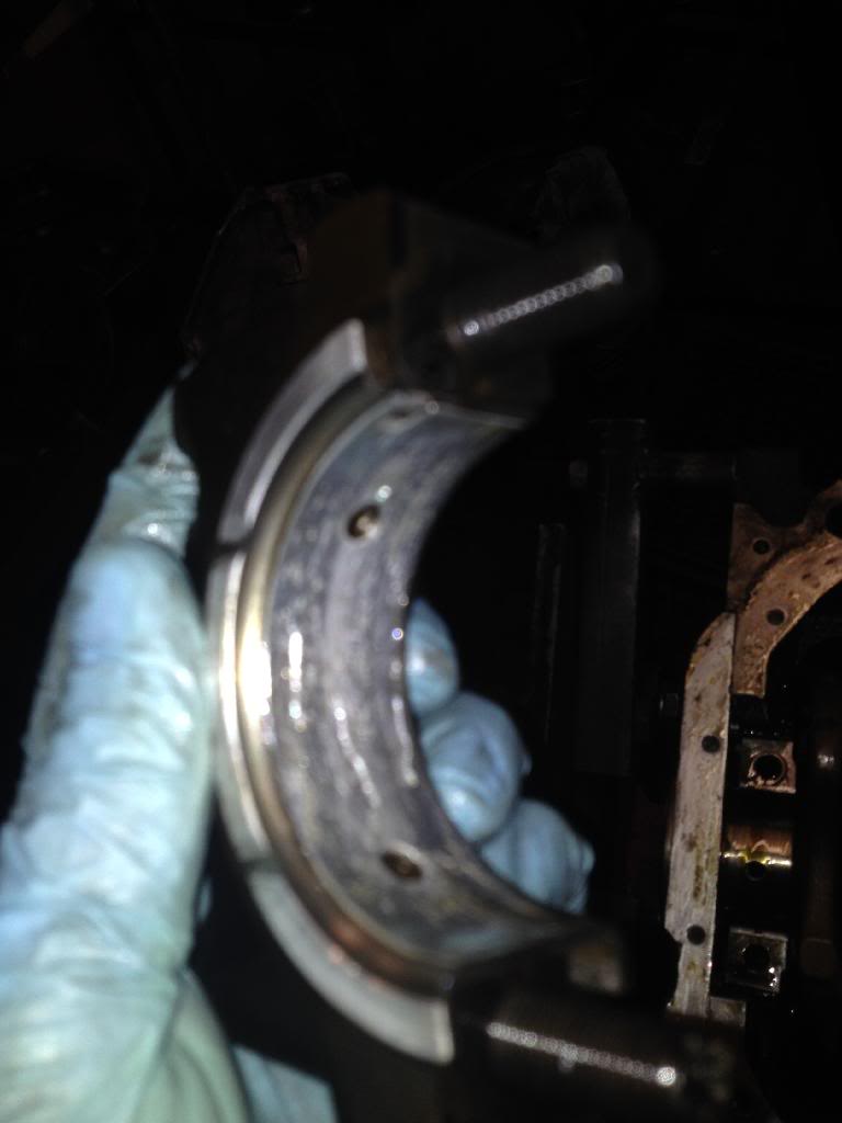

Pan taken off revealed some metal
It spun the middle main bearing, but not bad at all and the crank will totally polish out

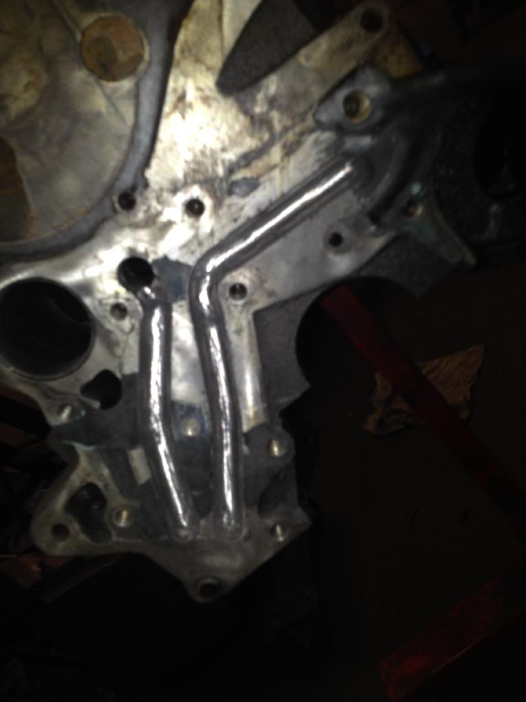

First mod is polish the oil galley

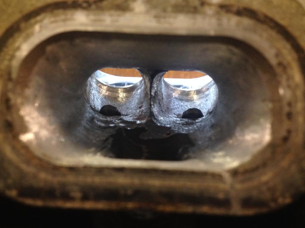

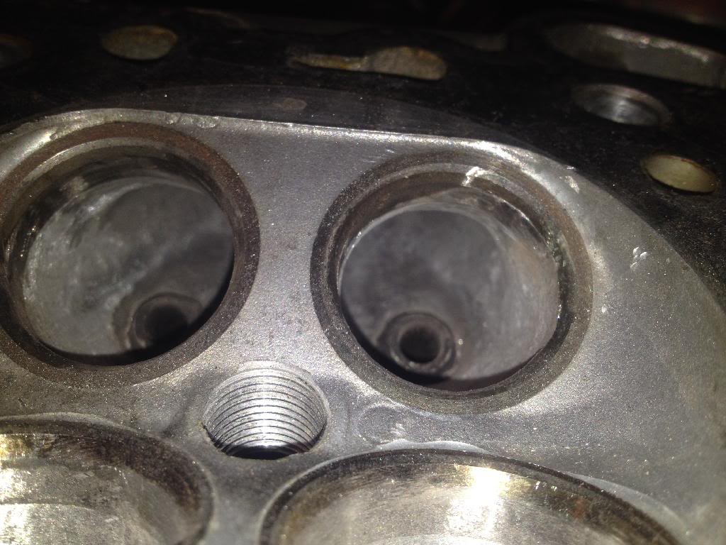

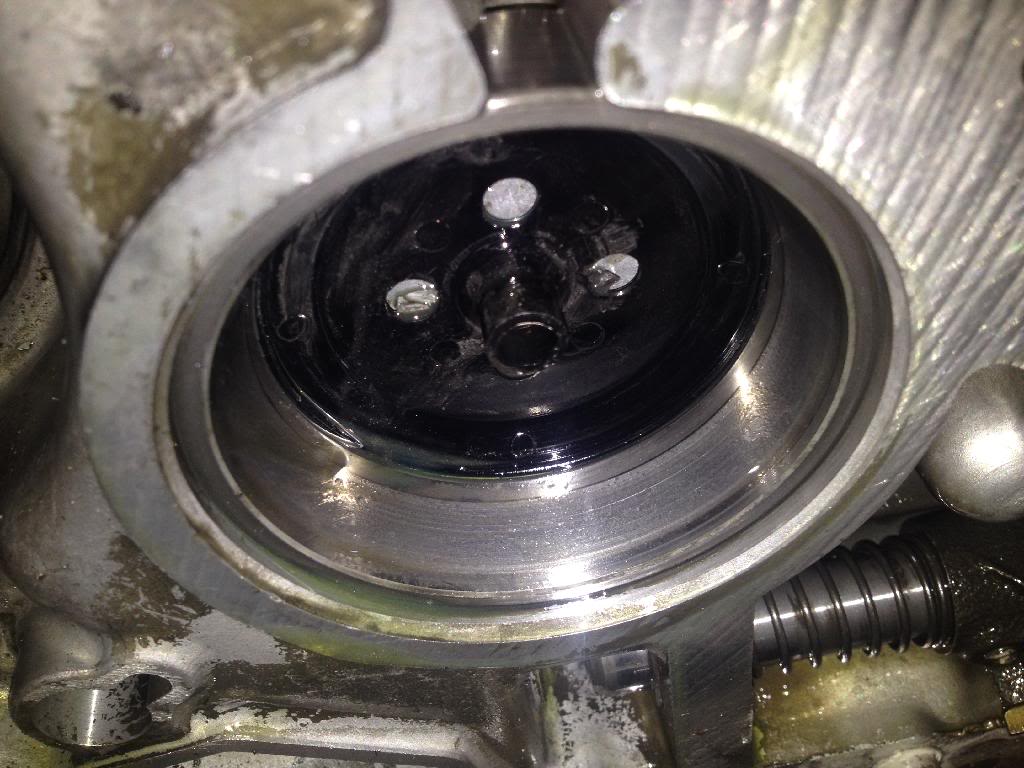

I was anxious to see how clean the intake ports/combustion chambers would be after all this time and spraying water/meth for about a year.
Intake ports were crazy clean, but CC still had a lot of buildup which wouldve probably made hotspots to help induce knock

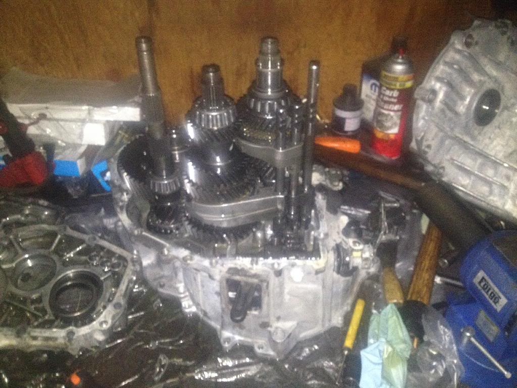

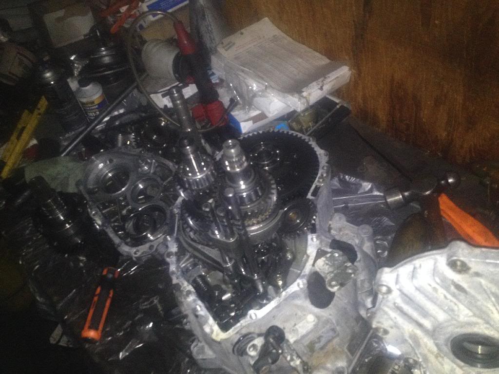

Got the trans case all cleaned up and pulled apart.

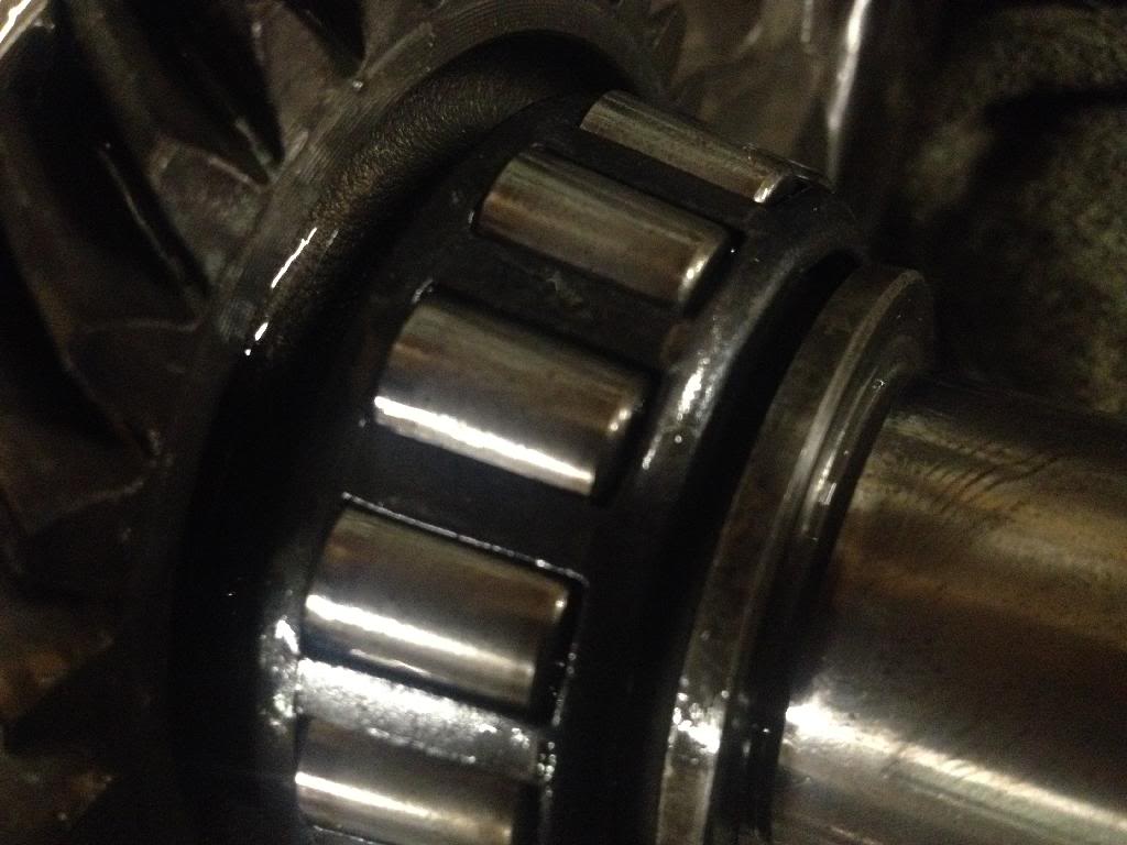

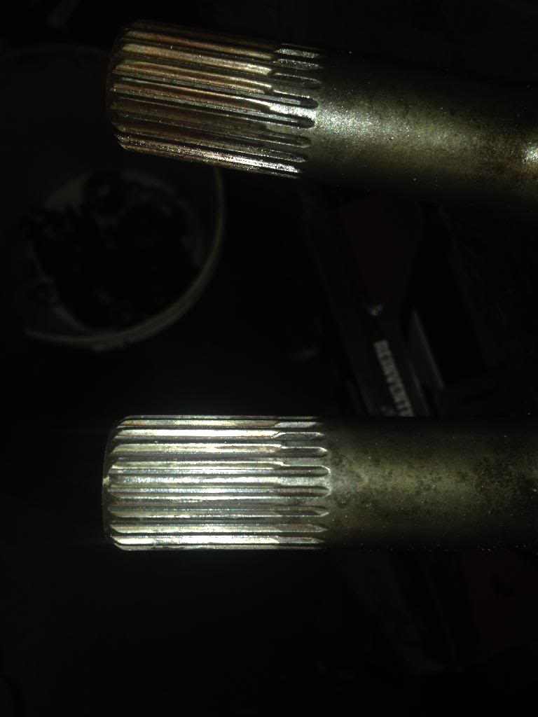

I think I found the culprit for the noisy bearing in the trans, theres one thats pitted and worn.
So, update time. First- the trans carnage
One is the one I was running, other is whats going in

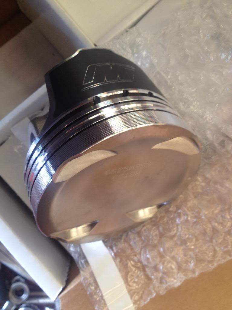

Wiseco 1400HD in 9.0 cr

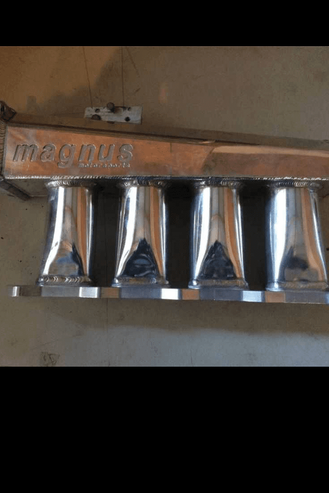

Magnus SMIM with 70mm TB
