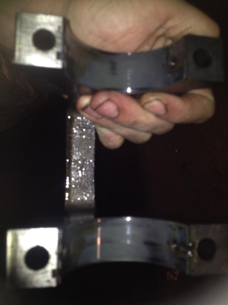

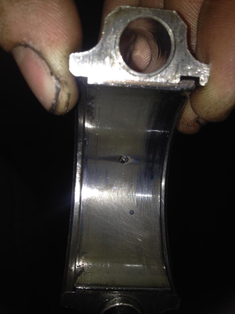

So...no update for a while... sad to say its not cause Ive been hauling ass around everywhere... So I hit the 50 mile mark, changed oil filters, was starting to romp on it a bit more, even tho I was SUPER easy on her...was on WG pressure of 14psi, no water/meth, no knock, and slowly working my way up in RPM to tune as I went, my initial thoughts was it was still pretty laggy, was hitting full boost at like 5k, which was worse than before but figured SMIM and bigger cams. I took it up to 6500 by the 50 mile mark, it was really starting to come alive at the higher end! I was adding airflow in SD so made sense, that night I went ahead and ran my buddies vette ZO6 just see how Id fair, shifting at 7k still on low boost, we were even if i could get into spool soon enough. Welp after that run it started knocking slightly. I nursed it home totally bummed but somewhat optimistic. Did a compression check, 210/210/205/110, I hoped it was a collapsed HLA which was making the fuss, but cut open the 50 mile oil filter, NOPE
Cut open the new filter with 20 miles for a total of 70 on the engine, same thing. Pulled bearings, they all look evenly starved
I didnt pull the thrust main yet, but all rods and every other main look like this. So far I know then that, its not starved enough to be getting no oil, its not contaminants left in the block, ect. Basically it was slightly starving across all journals. IDK the cause yet, but I know at this point I shouldve had a better oil gauge thats more responsive, cause although the pressure was higher than last time it ran on the tired engine, the gauge responds very slow, also shouldve had an external oil cooler, HLA regulator, just lame cause I ran most of this setup before. The big thing thats different is the 2G head, have a feeling thats where the issue is.[DOUBLEPOST=1413954533][/DOUBLEPOST]So theres a light at the end of the tunnel, I have a plan. Rather than pull engine, hunt for problem, buy more stuff, wait for more machine work, and basically be down for quite a while, not to mention still be somewhat limited to 500+whp by stock crank, no girdle, and stockish trans, Im gonna be doing a "shelf build". Ive got spare 6 bolt stuff, screw it. I only ran this new turbo setup for like a month and a half due to such a narrow powerband (4900-7700) and fear of breaking stuff, especially with a noisy trans, I tore it down. So ill be doing a refined version of that! It'll have 2G 8.5 cr pistons, so less lag, evo springs so higher redline, HKS cams which are known for being "drop in" cams so less lag and more power, other than that pretty similar to before, cyclone intake, GTX3076, ect. This makes a lot more sense, I doubt the stock 92 trans wouldve shifted at 9k with a single clutch anyways. So this should be good for 8k and 500whp, which should be plenty for now, and best part is I can play while Im going through the forged engine, do more upgrades, and do the EVOIII gearset trans thats waiting for a build. So everythings on the way, shouldnt be long at all for this to go together since its so stock.

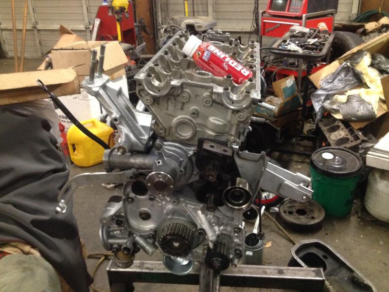

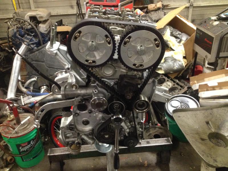

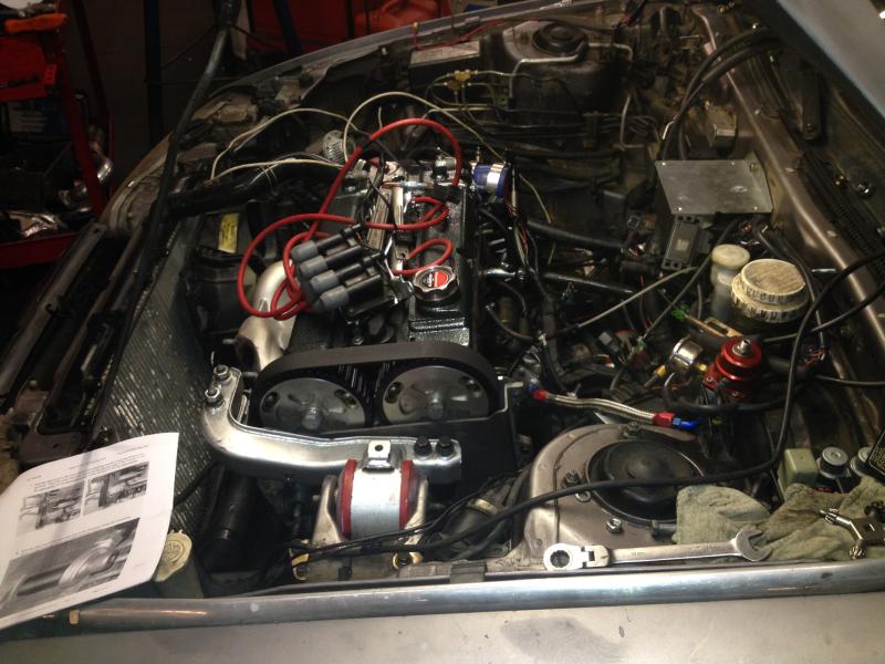

Sooooo....where the hell were we... Ive been a busy guy.

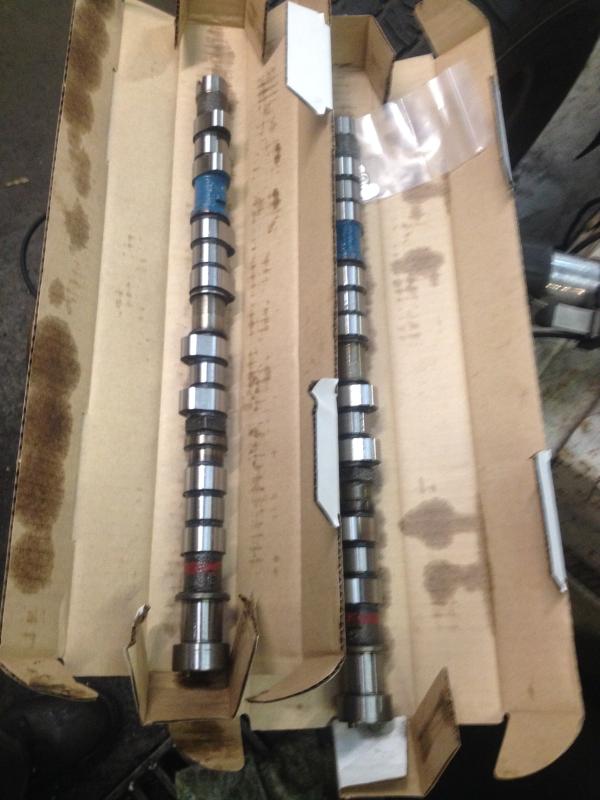

Delta regrind HKS 272s

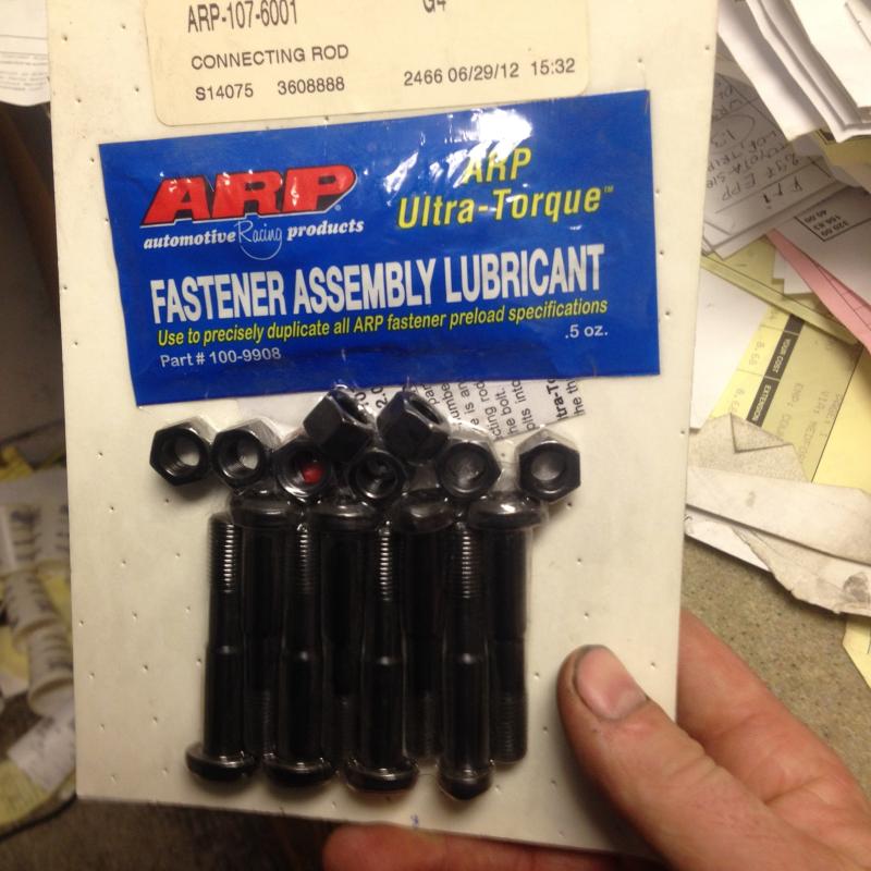

ARP rod bolts
Evo springs installed

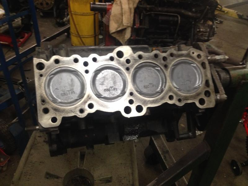

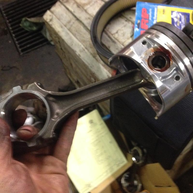

2G pistons on 6 bolt rods

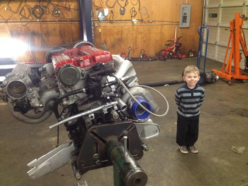

A bottom end
Between not even a shortblock and running took 3 days, and that was while I had the kiddo around. Not bad if you ask me. Im beat! So a bit of lifter tick, even tho I soaked and bled them down. Gotta take care of that but took her down the road, seated rings under low boost, a ton less lag, way more responsive, and pretty darn lean due to the extra airflow. These HKS cams sound totally different, sounds mean as hell. Pretty stoked
Awesome build, did you have the rods checked/ resized after installing arp rod bolts? I have read mixed views on this wondering what you did. Also any clue what caused the oil starvation problem?
Thanks! Yes, I talked to the machine shop and they said everytime different bolts are put in they must be resized, but its light enough that theyre still standard size bearings.

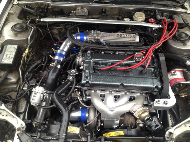

Things are going great so far, got 75 miles on engine, oil filter change/cut open, had a bit more than Id like to see but nothing I wont just keep my eye on. 150 miles on clutch which is the main concern right now, gotta hit that 500!!

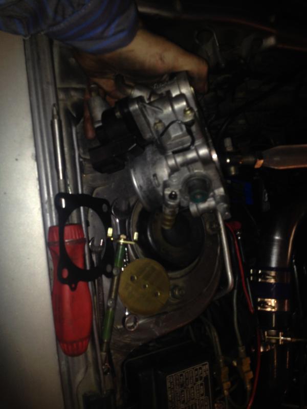

Fixed a lot of boost leaks, rebuilt throttle body with new seals

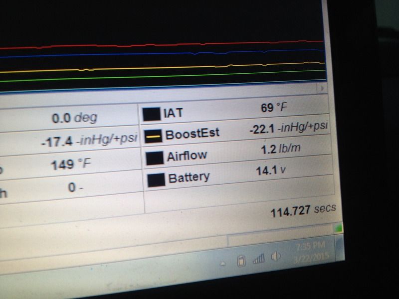

Ran a bigger alt wire to try and improve voltage, did some cleaning up in the engine bay. Did a total of 9 pulls today, all I did was tuning...its so involved since I try and get stuff near perfect, setting global to match boostest and keep the airflow numbers accurate. Just on WG pressure right now, 14ish, but damn the car has so much more low end and respnse! It comes alive just as good as a stock STi which I loved how little lag they have, difference is my shit pulls up top too LOL. Only Flowing 34 lbs/min but can already tell this is gonna be a killer street combo

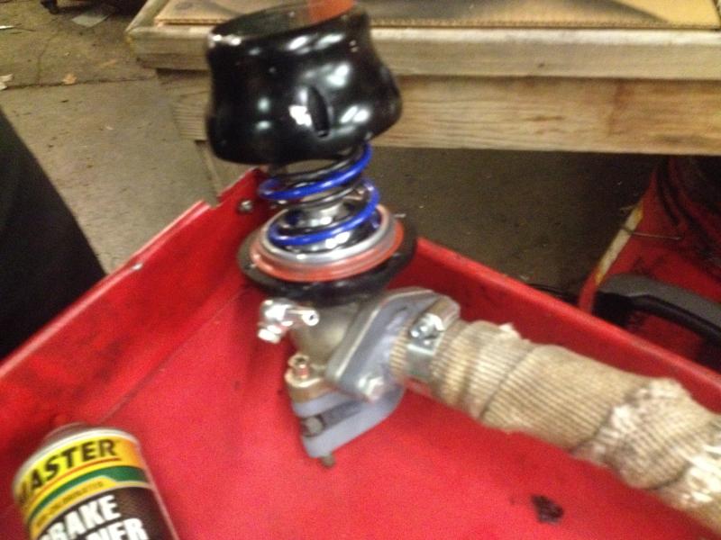

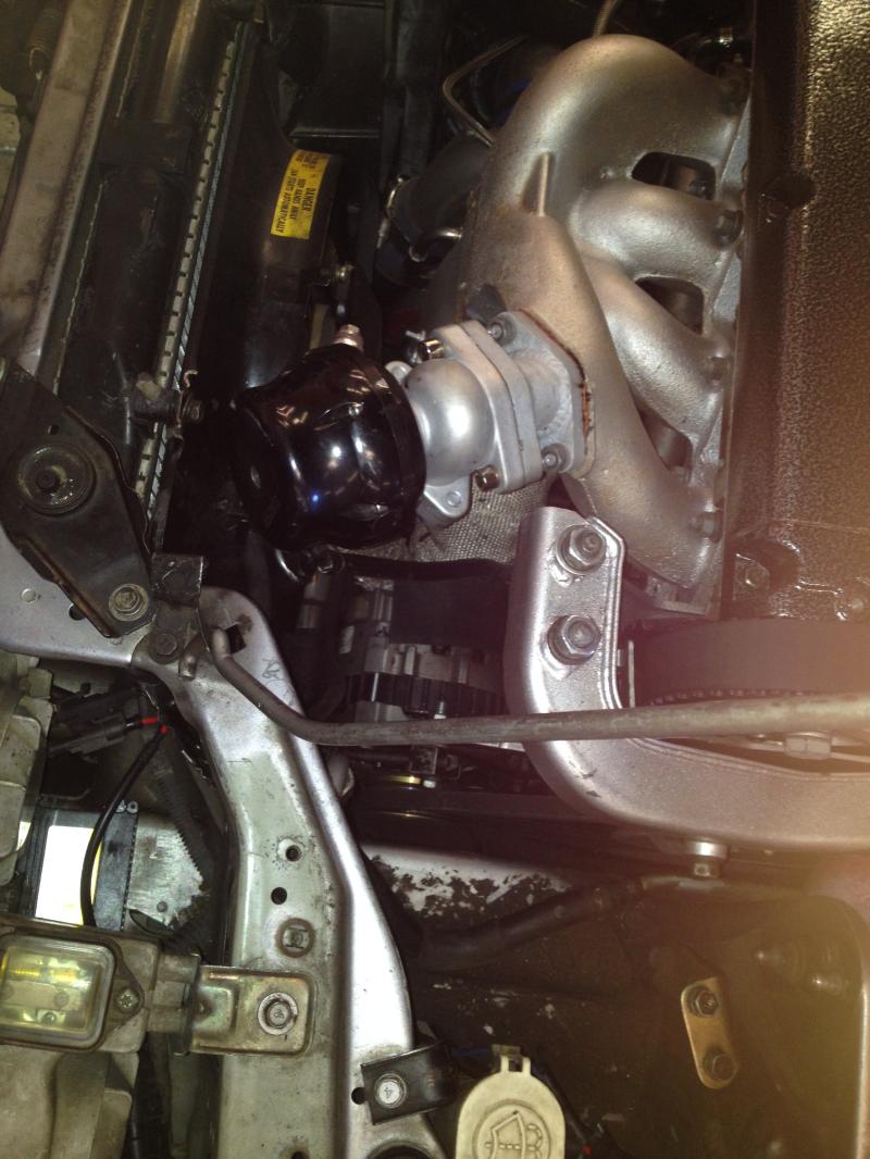

Took off the wastegate, put in a big blue spring with the small black, went from 15psi to 19psi, actually had a lot of tuning to do for this, had to pull a lot of timing, did 10 pulls tonight, Im at 375 miles and counting. Plan is now that this boost level is basically dead on dialed, and is the highest boost I'd run on pump since the timing curve is ridiculous, gonna start on the water/meth injection and keep stepping up the power :) 70-90 went from 2.15-1.91. Last winter was 1.6 when it was all said and done[DOUBLEPOST=1417847167][/DOUBLEPOST]Heres a log

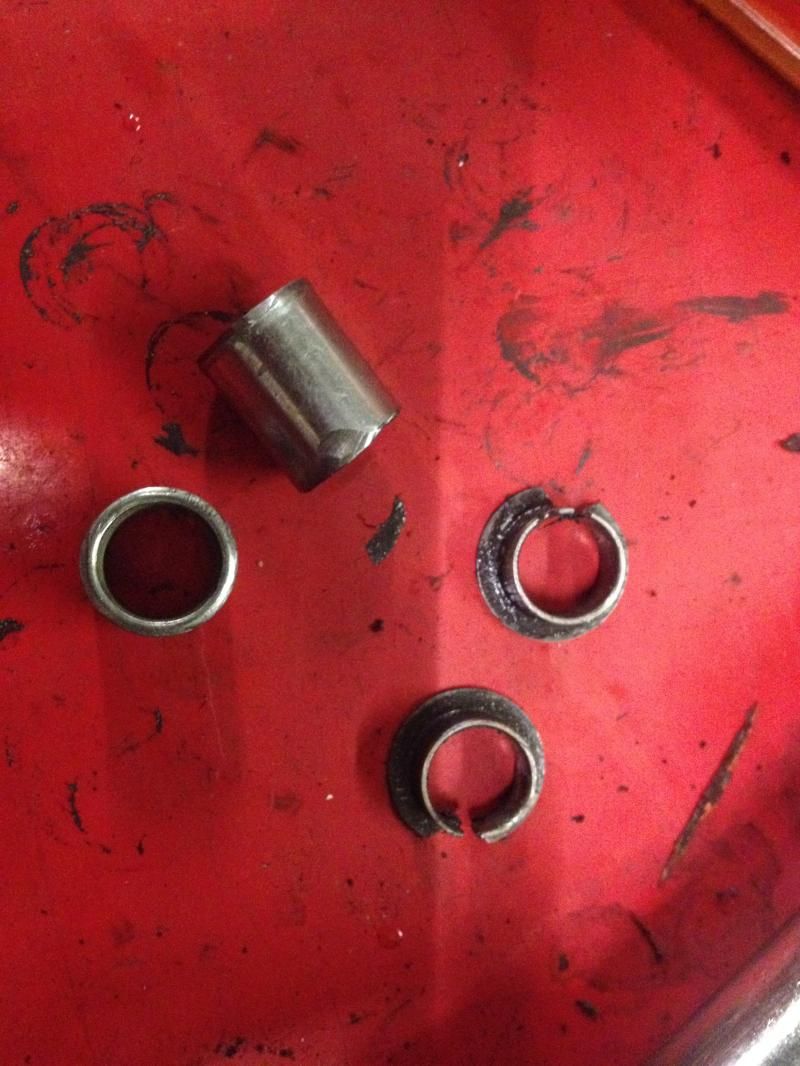

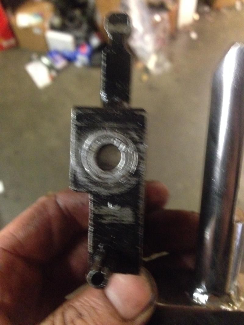

Updates! Lets see.... Had to do some shifter mods. Got rid of the EVO metal shift bushings, and pressed in solid bushings.
Lubed the shift cables, and put in a shift stopper so I can BANG gears without fear. Shifts like a dream now.

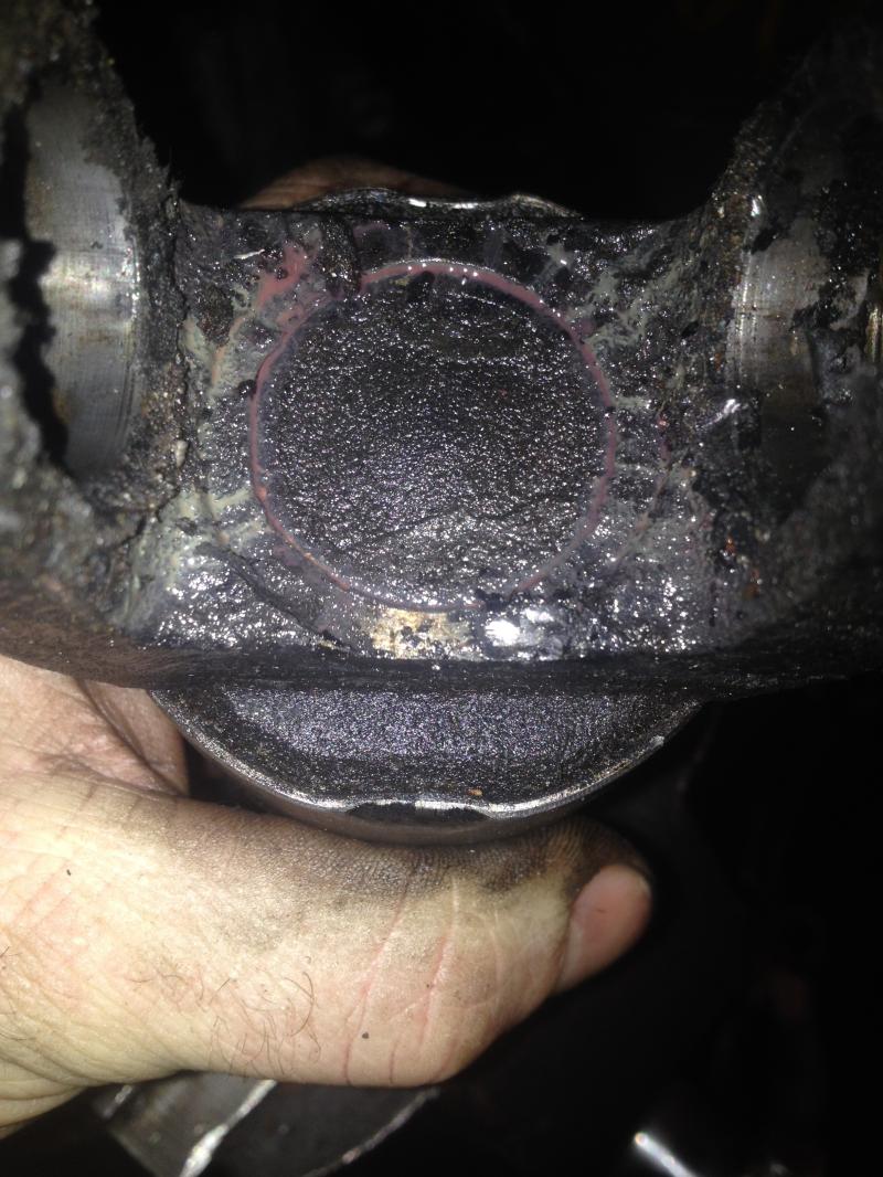

Next....got some leaks...

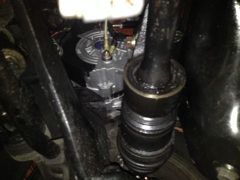

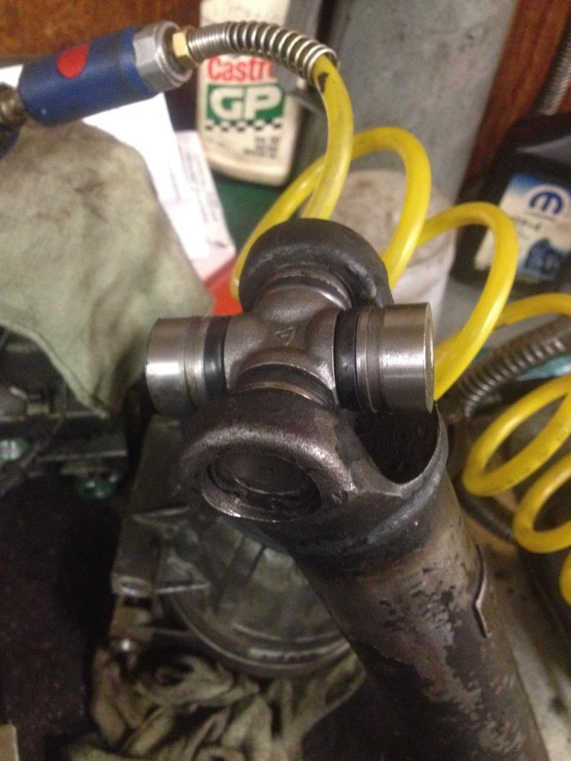

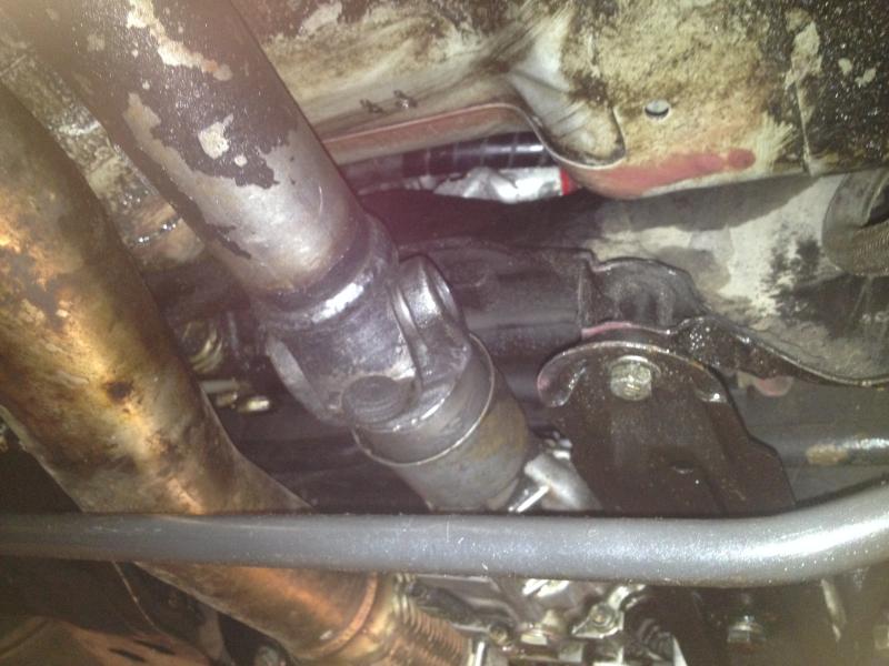

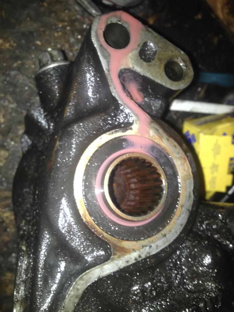

Pulled T case, did input/output seals, U joint, and driveshaft yolk, all were leaking.
So the T case holds fluid... got some more leaks to address, just gonna have to go through them...

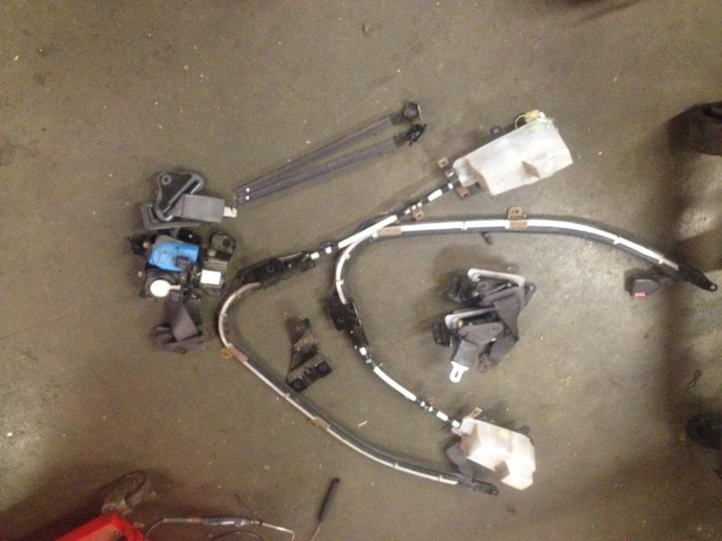

and finally a light diet with going to 2G manual seatbelts, saved a good 40 lbs

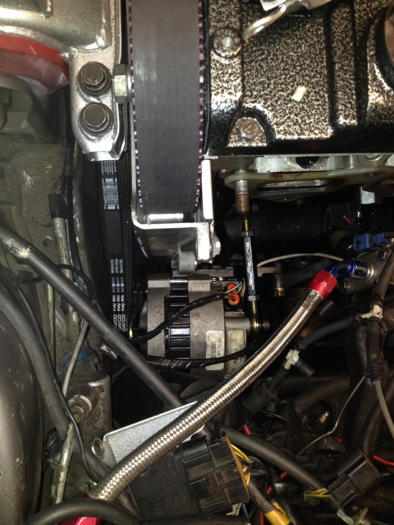

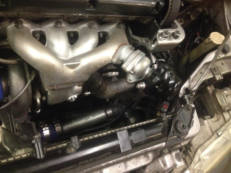

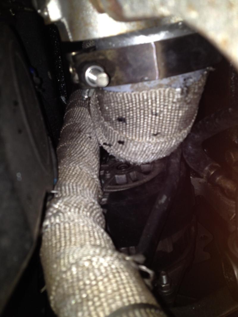

So... First was getting the alternator away from the downpipe
Jay racing alternator relocation kit

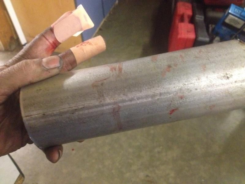

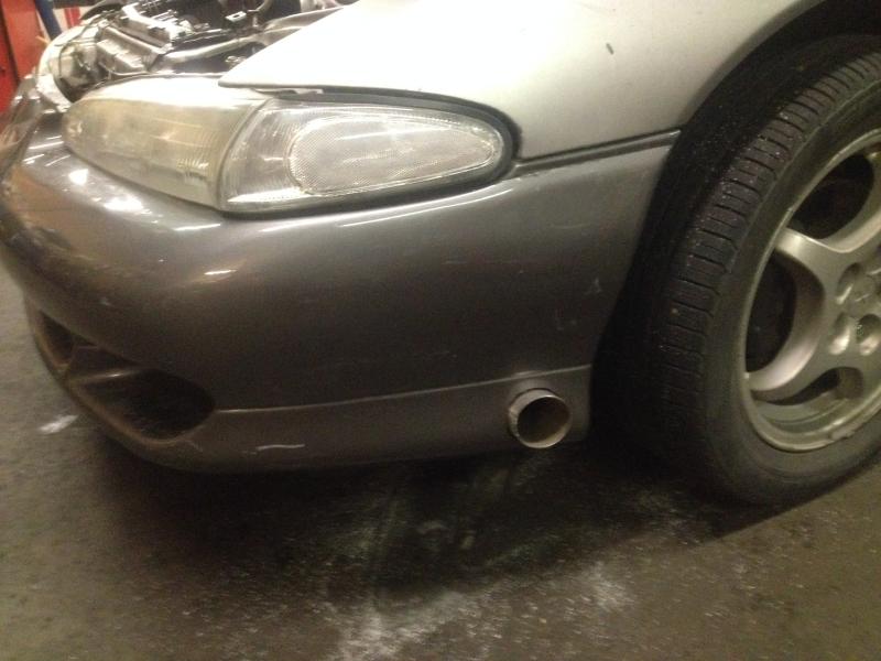

redid some exhaust work, cut myself

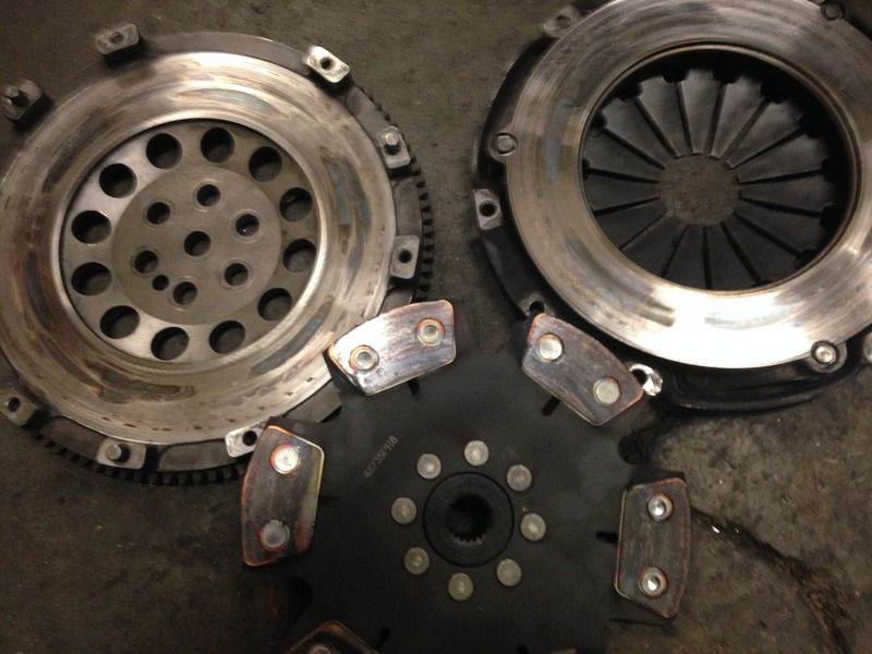

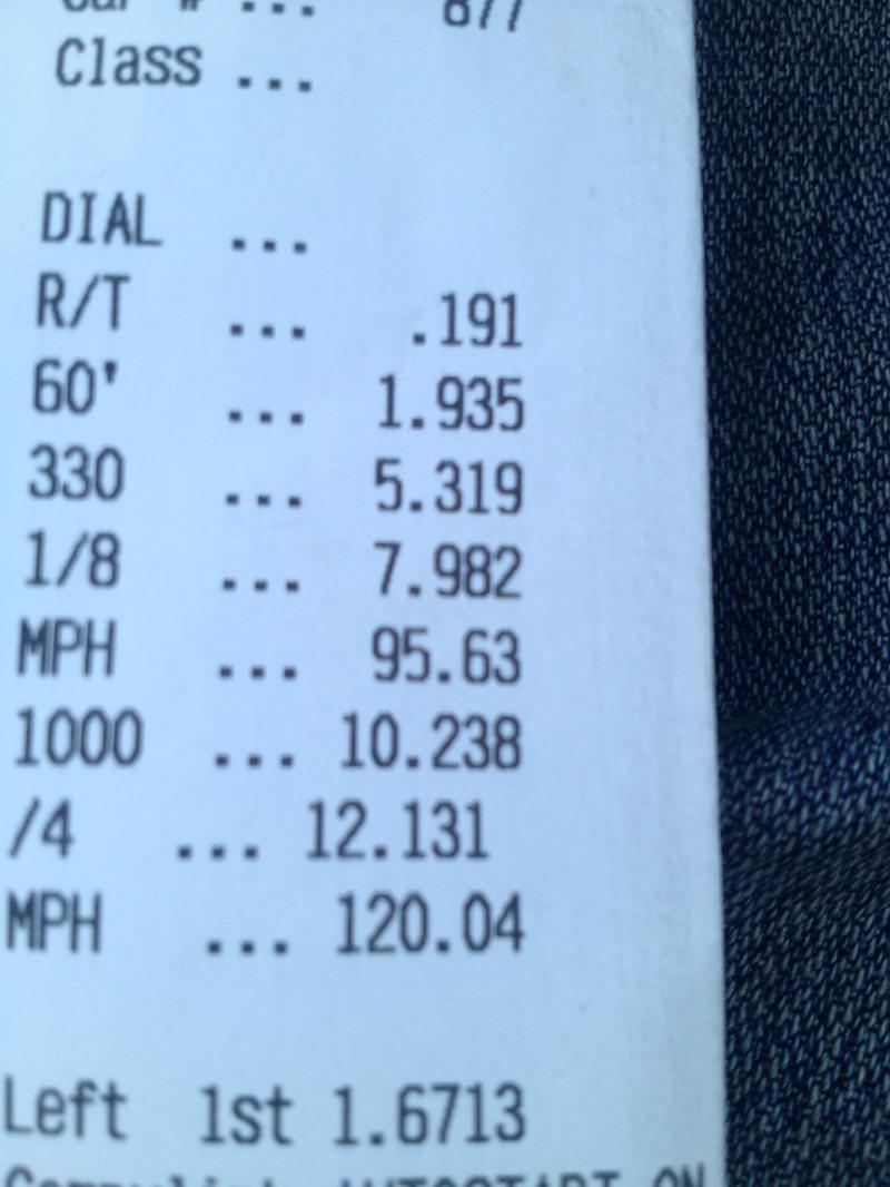

Time for a clutch, this is the best I could launch without slipping. Ran 30 psi, saw 52 lbs/min, on pump/water meth inj. Timing curve is still too low, Will be moving to flex fuel and Holset. Wanting to break roll bar index not a problem this year. More to come for sure
So close to 11's! Just read the whole build and totally subbing!
Yeah man little disappointed but not really, my normal 60 ft is a 1.85 or so, best is 1.79, which is actually with this same model of clutch, XTD stg 4, if I had my normal launch it wouldve gotten there, the track I went to is a thousand times better, Woodburn raceway, the density altitude was -950ft that day, and the traction is usually good. Its cool though cause the local track doesnt open for a month, so this test hit got me to see some issues to sort out till then. It is gonna be a great year thats for sure

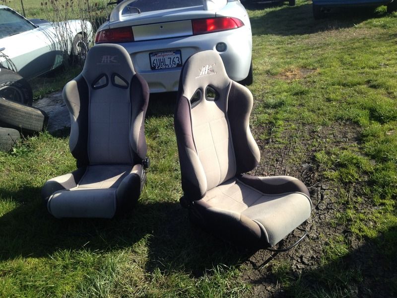

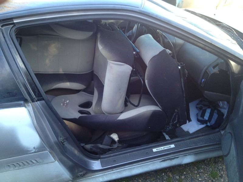

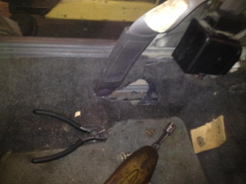

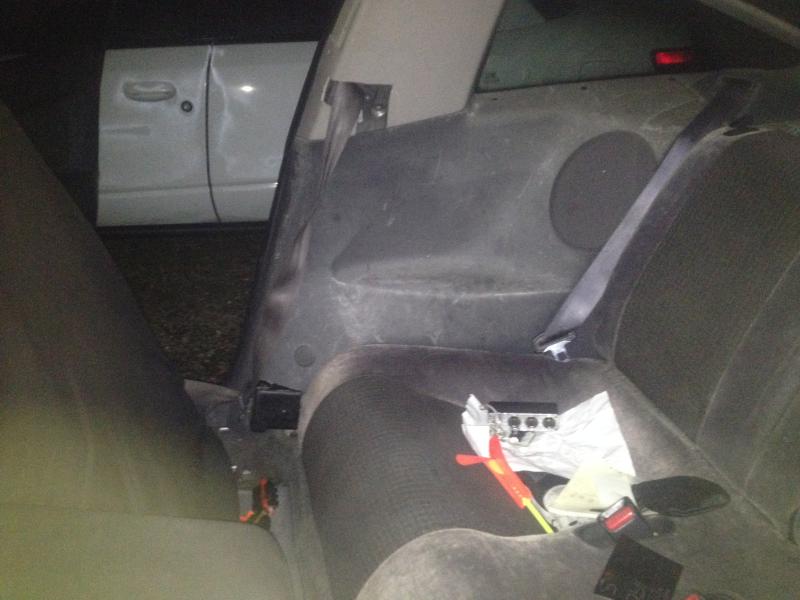

Going to some old APC seats outta my Camaro. 7352D0F0-5401-4135-A763-8FEB2476DF3D_zpscdewpgkw.jpg
These seats have been a crapload of work... got the passenger in after a good 3 hours of fudging. The drivers is gonna be way worse... 574B316D-0BEC-451F-A084-9ECCB83D2BCA_zpshlrsshbn.jpg
all this for about 30 lbs savings... but it all adds up. Also sold my 2G, so going full bore on this and my GVR4, more to come!

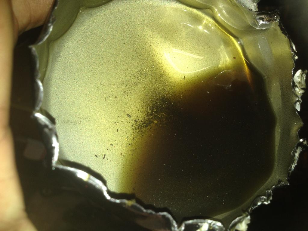

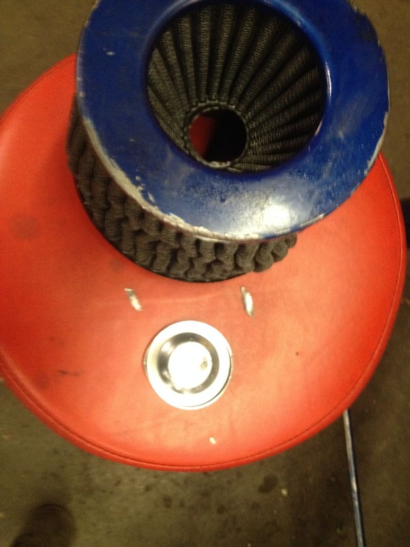

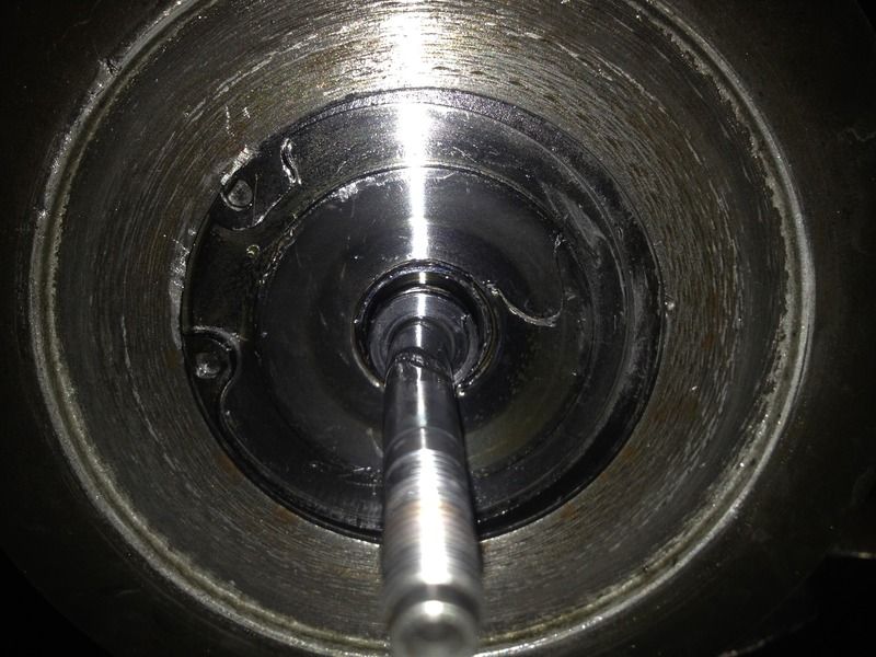

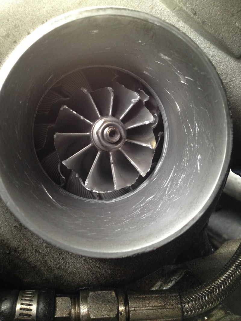

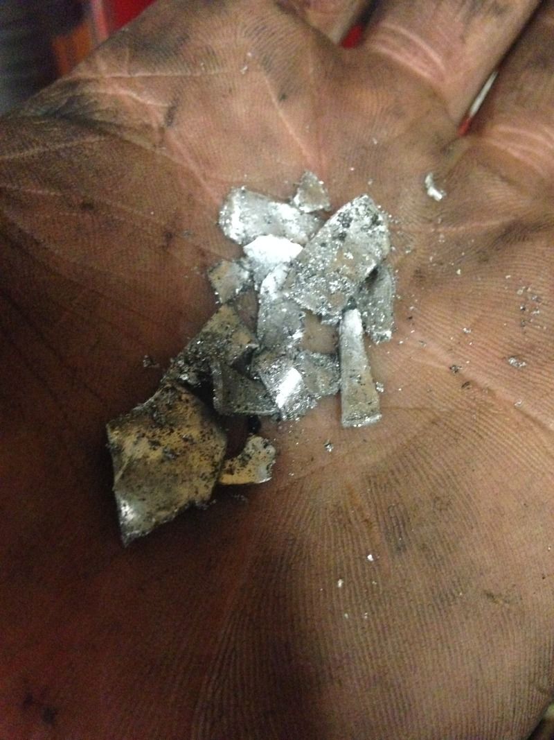

So I went out for a run on lunch... spooled up... lost boost, thought I blew a charge pipe, nope. Saw coolant dripping and dipstick popped out so knew it was bad
Broke the turbine shaft in the thrust area
Luckily I already had the next step in the works and my bigger turbo was already being machined so shouldnt be down too long, sucks tho since the track opens in a week and a half!!

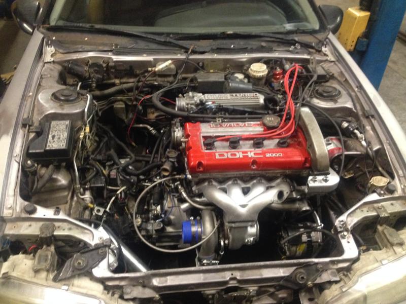

So this is where Im at, I was already working towards my goal of 500+ (more like 550) whp street car, with a good usable powerband, I needed to refine a few things... Less lag, more top end, less weight, street manners, flex fuel, ect. I could tell after running 30 psi for a while this turbo probably wouldnt get me there, so Ive been working on the next deal there. Also obviously a clutch, changing to flex fuel, keep going with the diet, and soon, PAINT!!

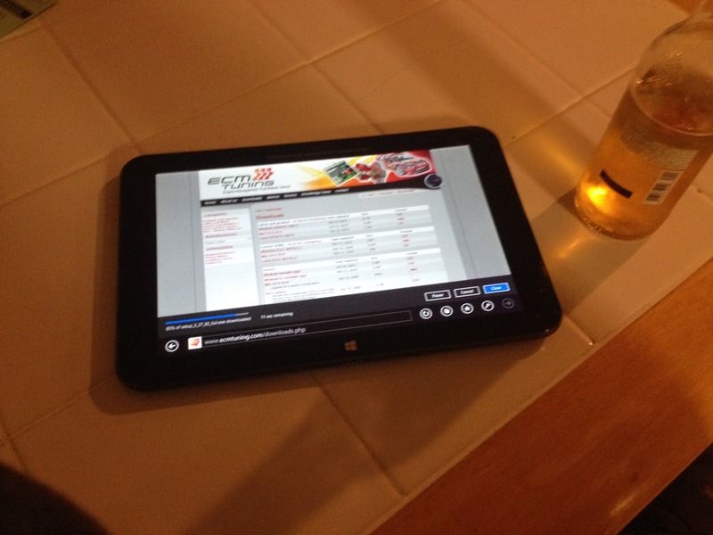

So for the street manners, got a tablet for logging, was tired of lugging the laptop around everyday

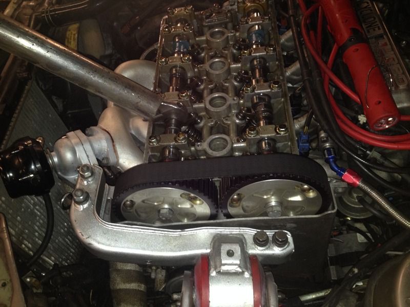

One thing that always drove me nuts is I had to stack lock washers on the cam bolts, I cut them down, did them right, retorqued headstuds, ect
Also did some cam timing changes... Did
-2 ex, which added some top end with no loss in spool!! then I tried
-4 ex/-2 in, not so good, lost some bottom end, didnt gain top end, just bland
-4 ex/0 in, this seems to be about right, more top end, likes to spin 2nd and bounce revvy, when before I'd find myself short shifting 7500 from flattening off
After the alternator relocate I was seeing some voltage dropping out, if lights/fan/stereo ect were on I was seeing low 12v at idle. Pulled axle, got it exchanged, tried to find a 130a but had to settle for a 96 again. Since Im going to flex fuel I know my fuel pump needs to be working at its max

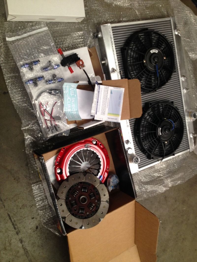

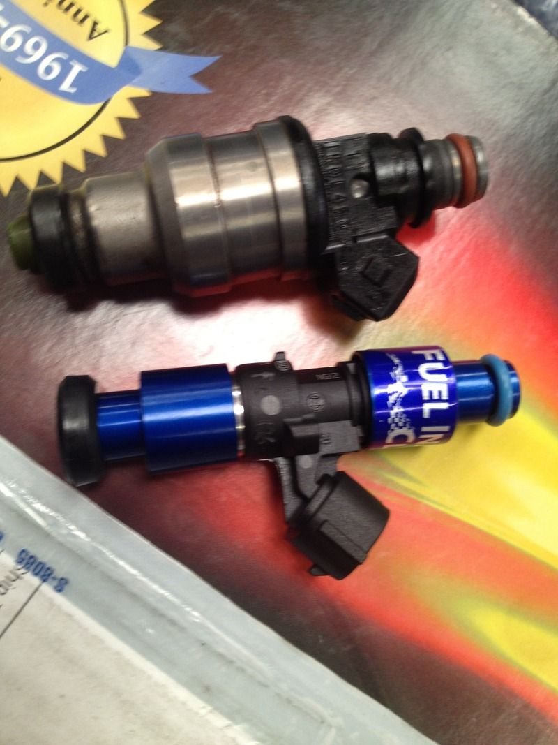

Then the real packages started arriving.... Weve got....
FIC 2150 injectors, pigtails, resistor bypass plug, aluminum rad/fans, flex fuel sensor/plug, Southbend SSX/TZ clutch.
Man these things look funny next to a low z injector

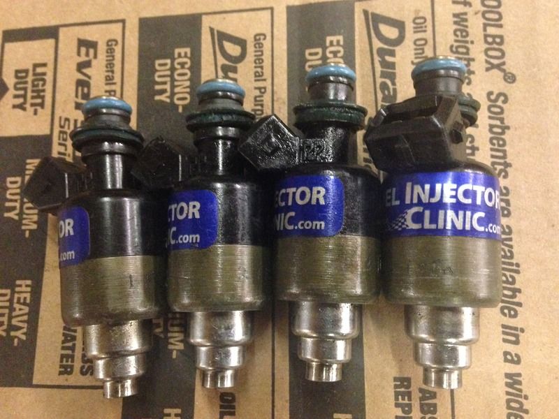

I don't think I've had this car so apart in years. More coming off too, fuel rail came off for mods/injectors
The trusty fic 1050s I've been running for so long

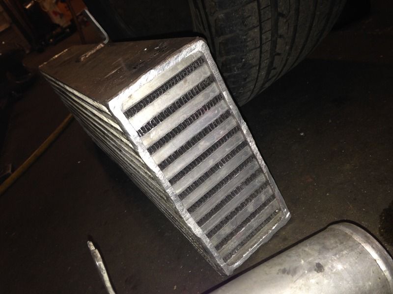

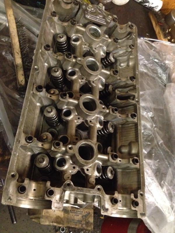

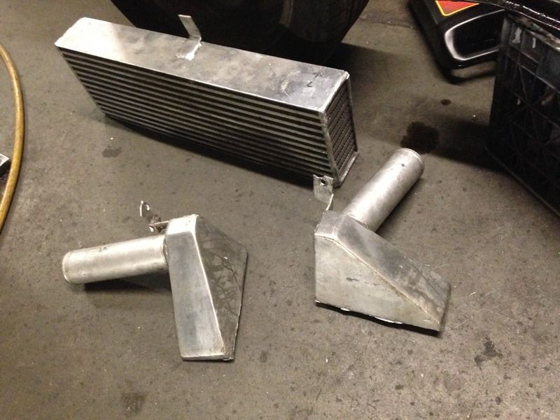

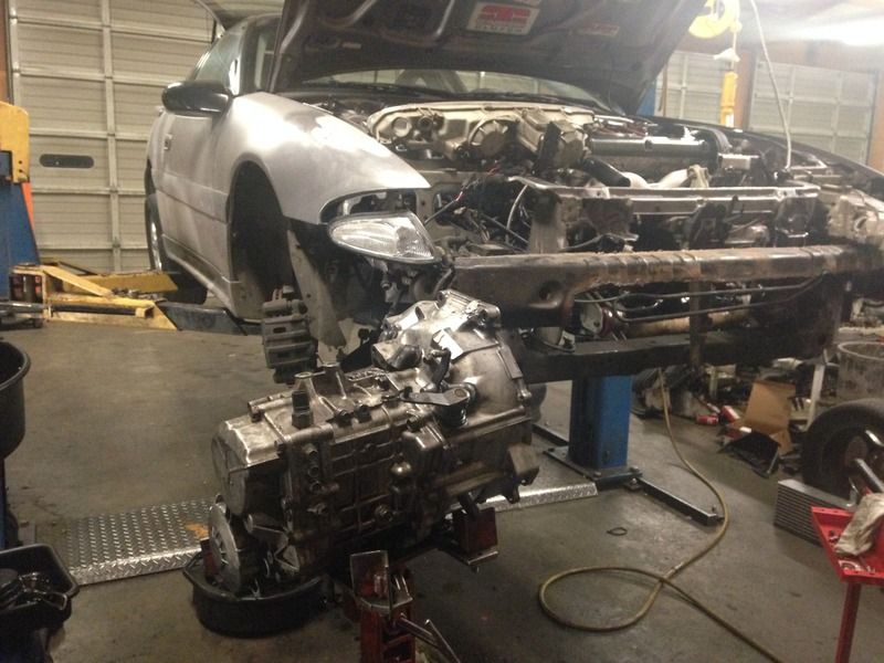

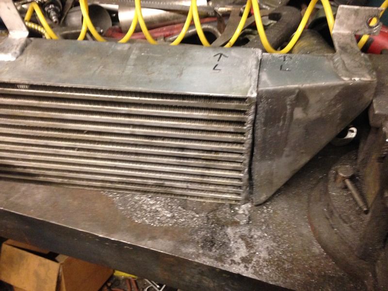

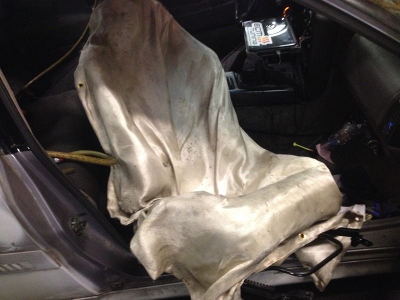

So day 2 of this mayhem tear down...I didnt take too many pics cause there isnt a lot to see yet, I Dig out pieces from intercooler

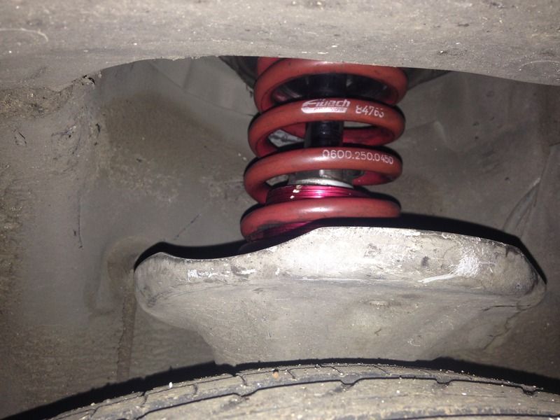

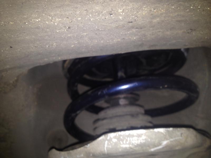

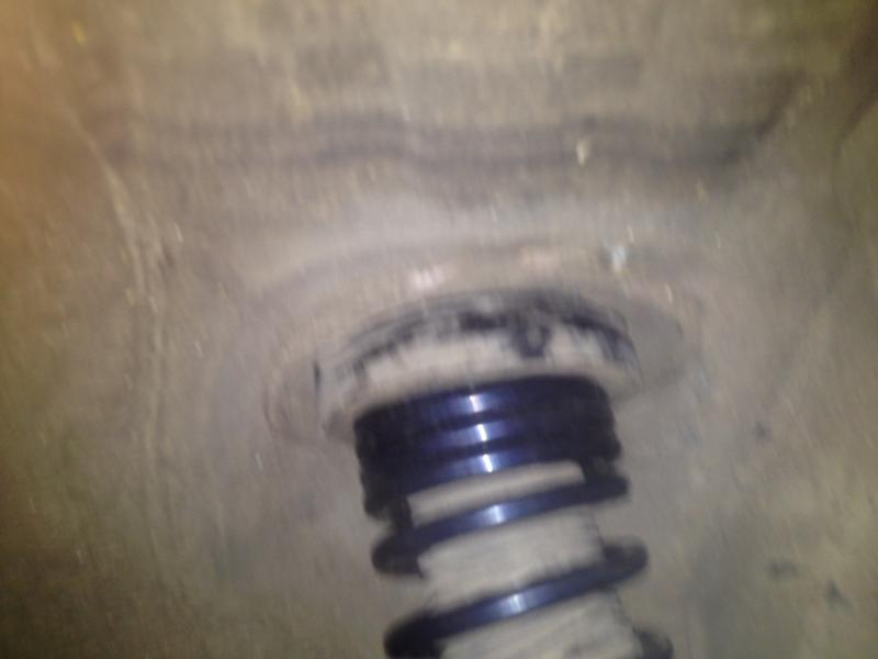

Ever since I did the H&R springs I hated how it sat/handled. It was too tall and soft, so put on some ground control coilovers, which was pretty much all for today
Also picked up a spare part or 2 from a friend. Going along with the cars diet I will be doing a lightweight hatch for summer time, and keeping mine for the winter.

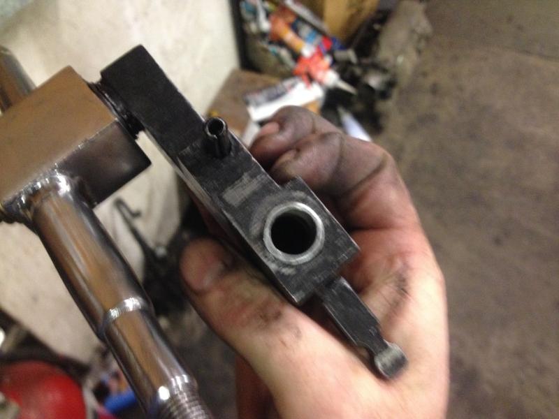

Tomorrow Ill be sending the flywheel in for resurfacing, doing new seals in the trans, and getting all my aluminum parts welded up (I dont TIG)
