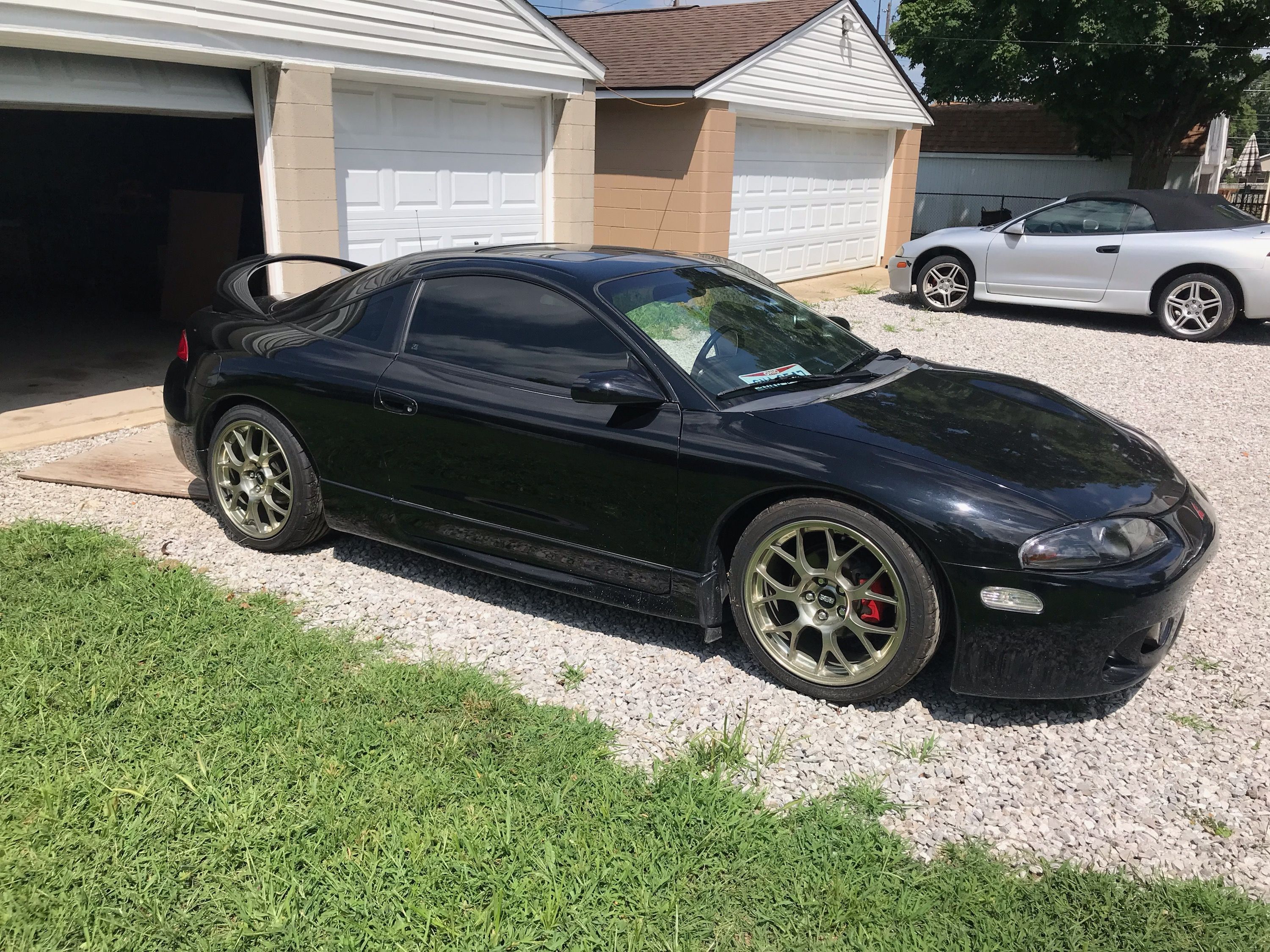

1999 GSX DD build
Daily driver street build.

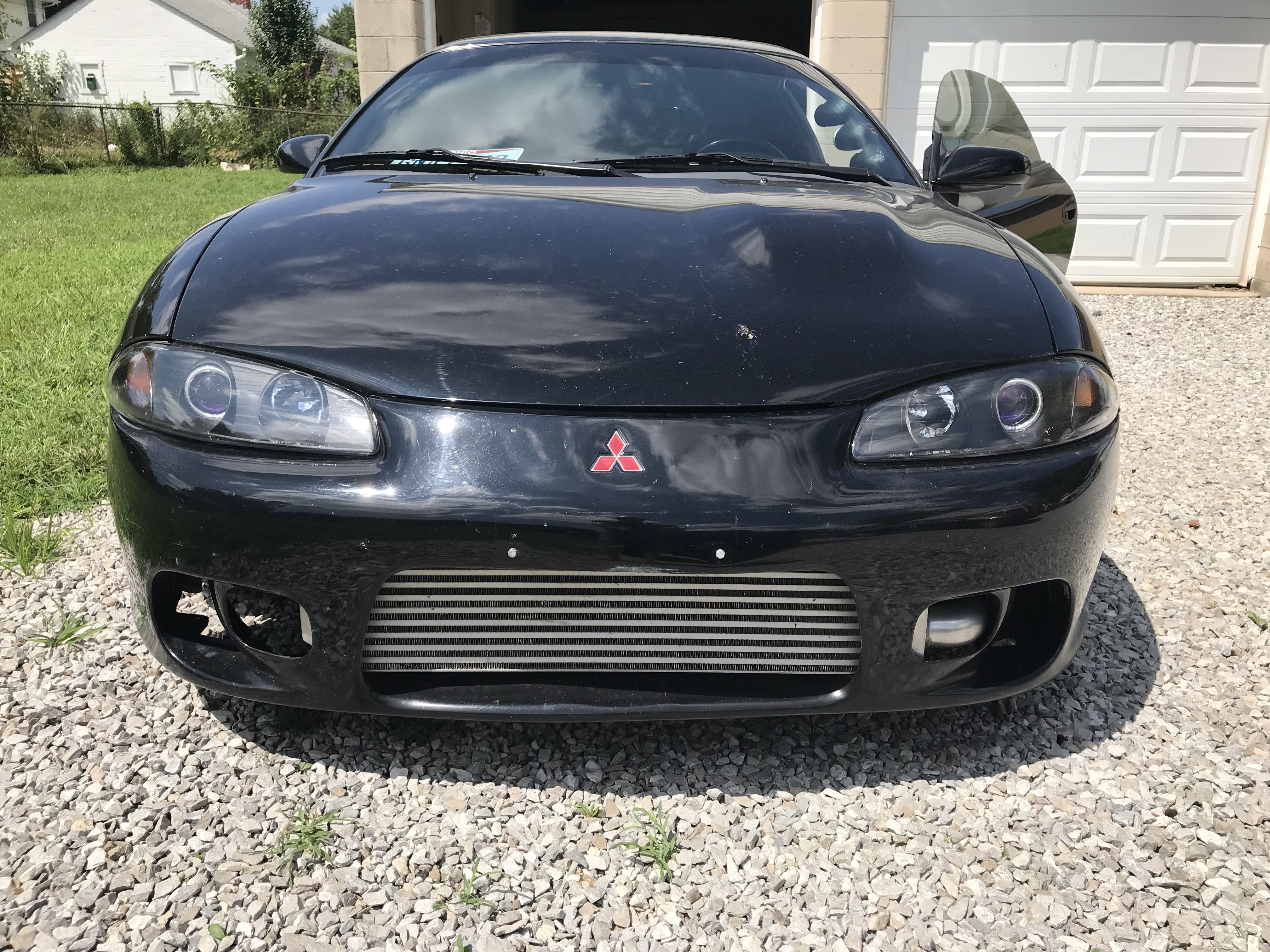

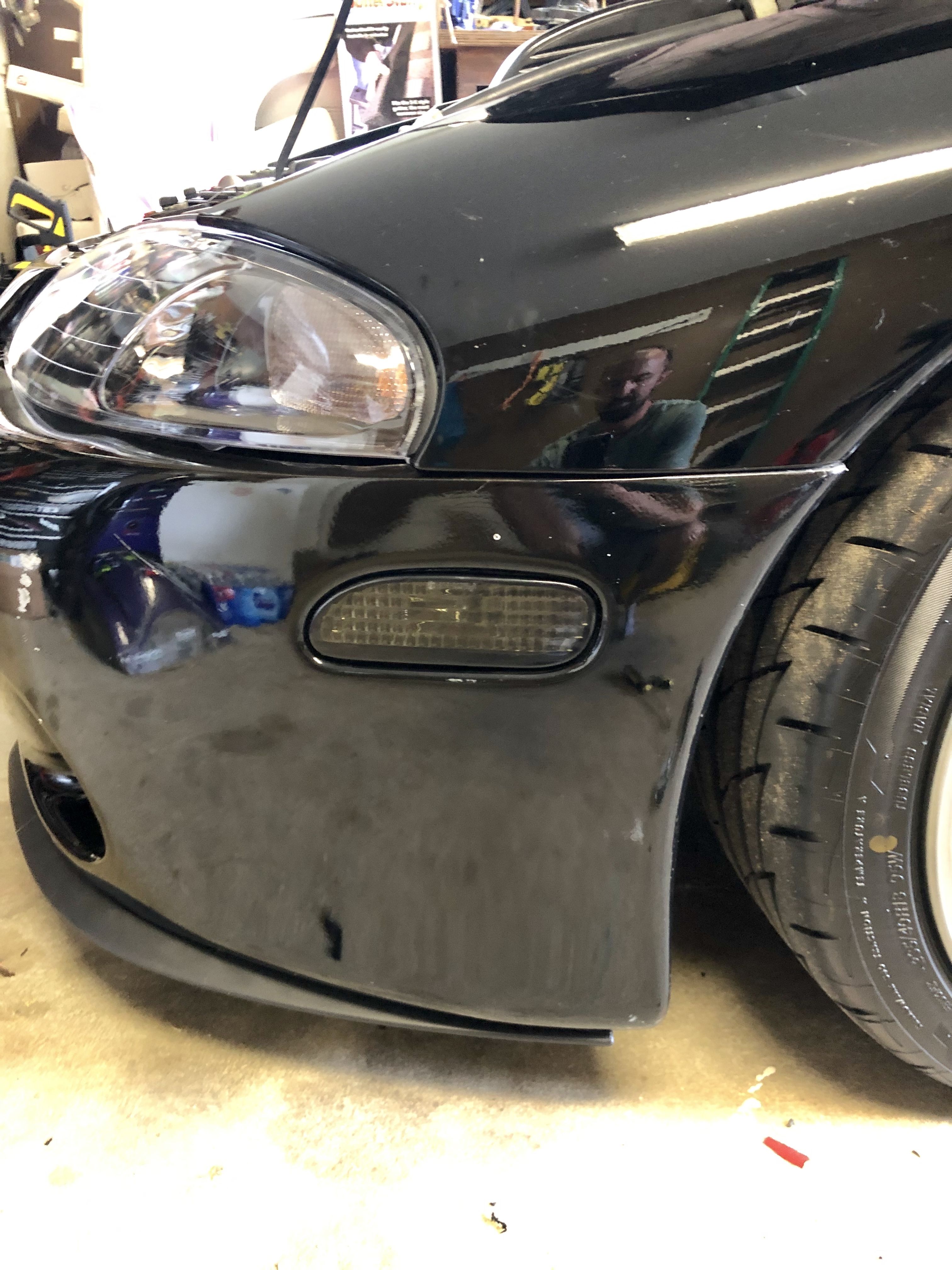

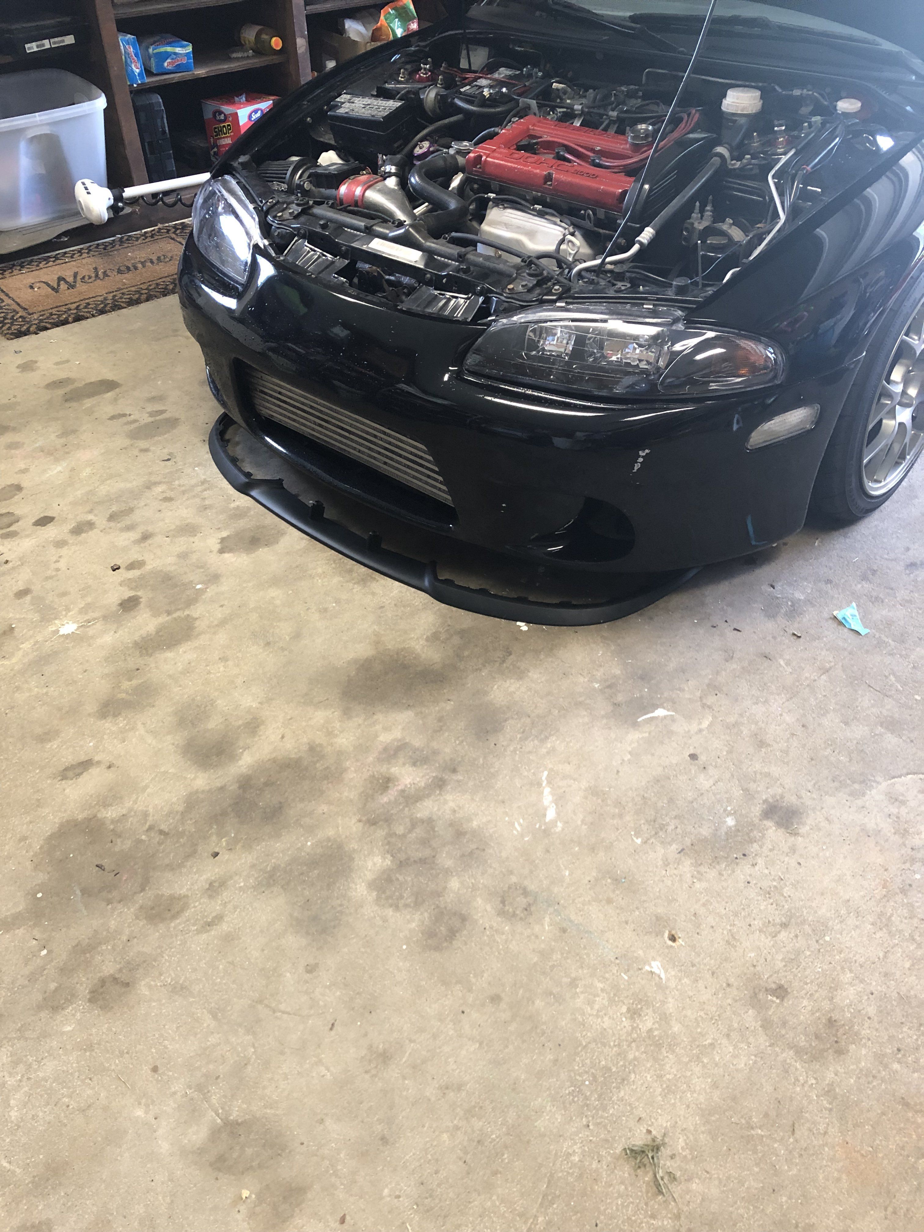

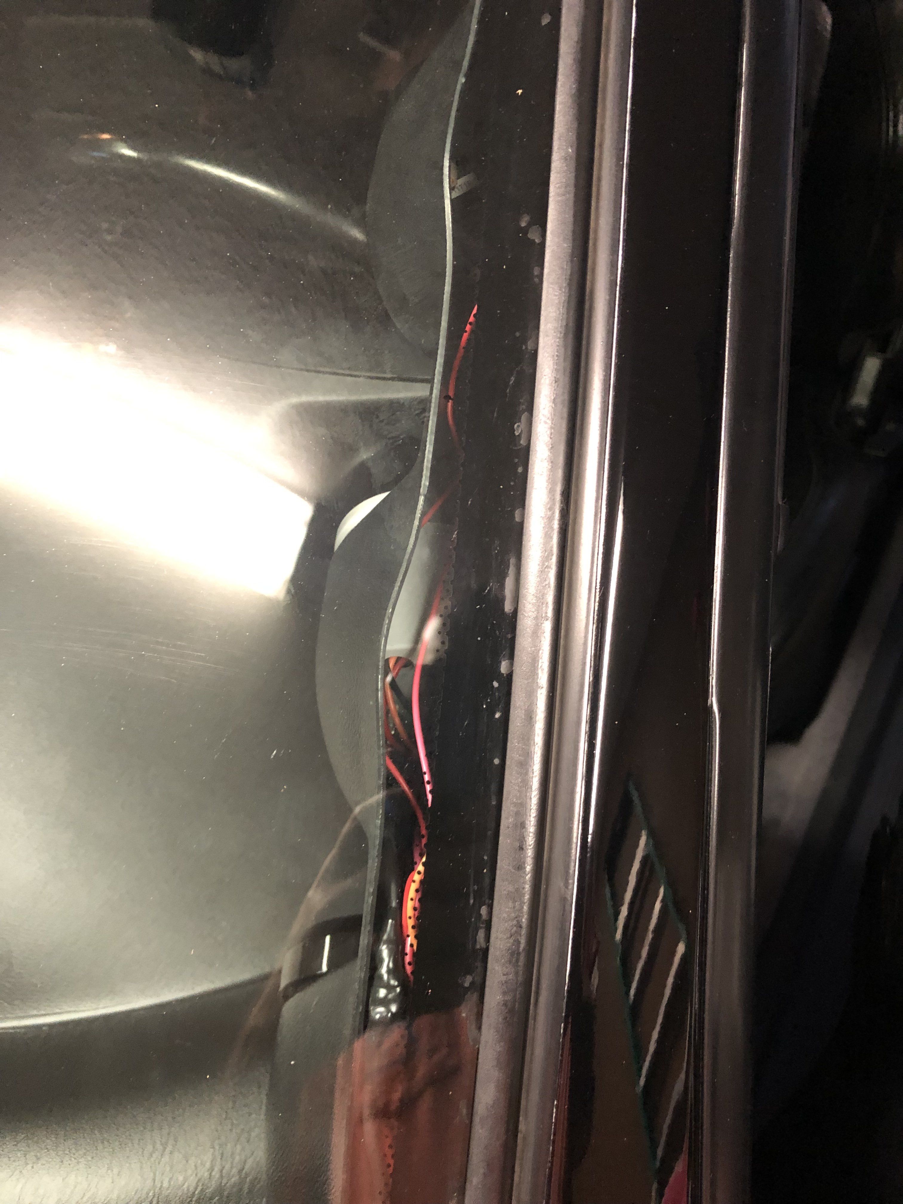

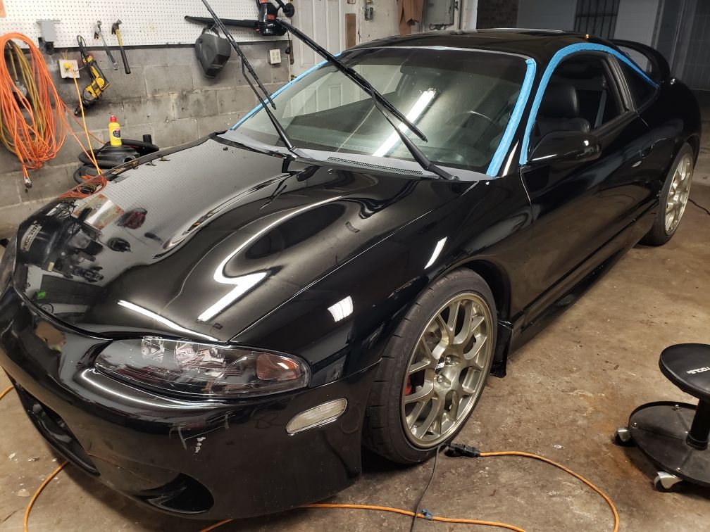

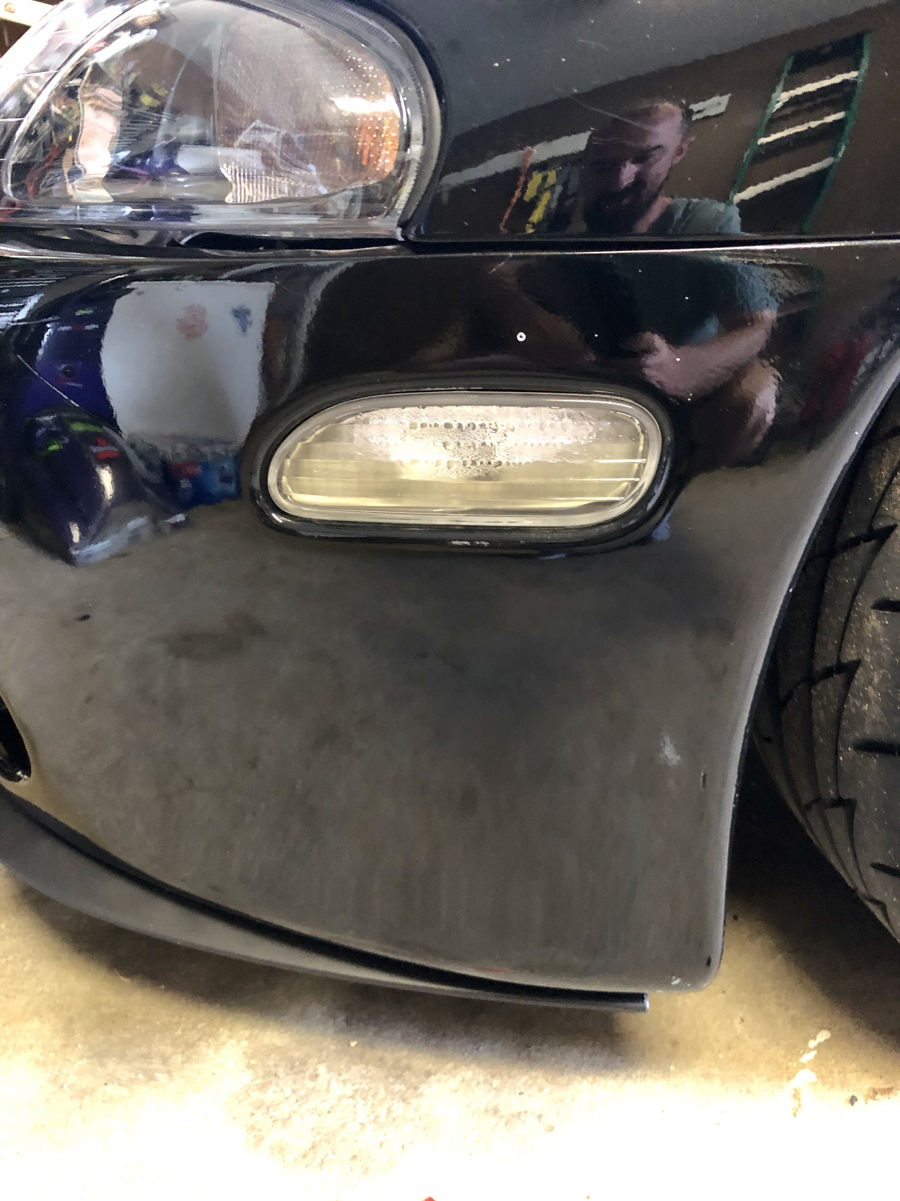

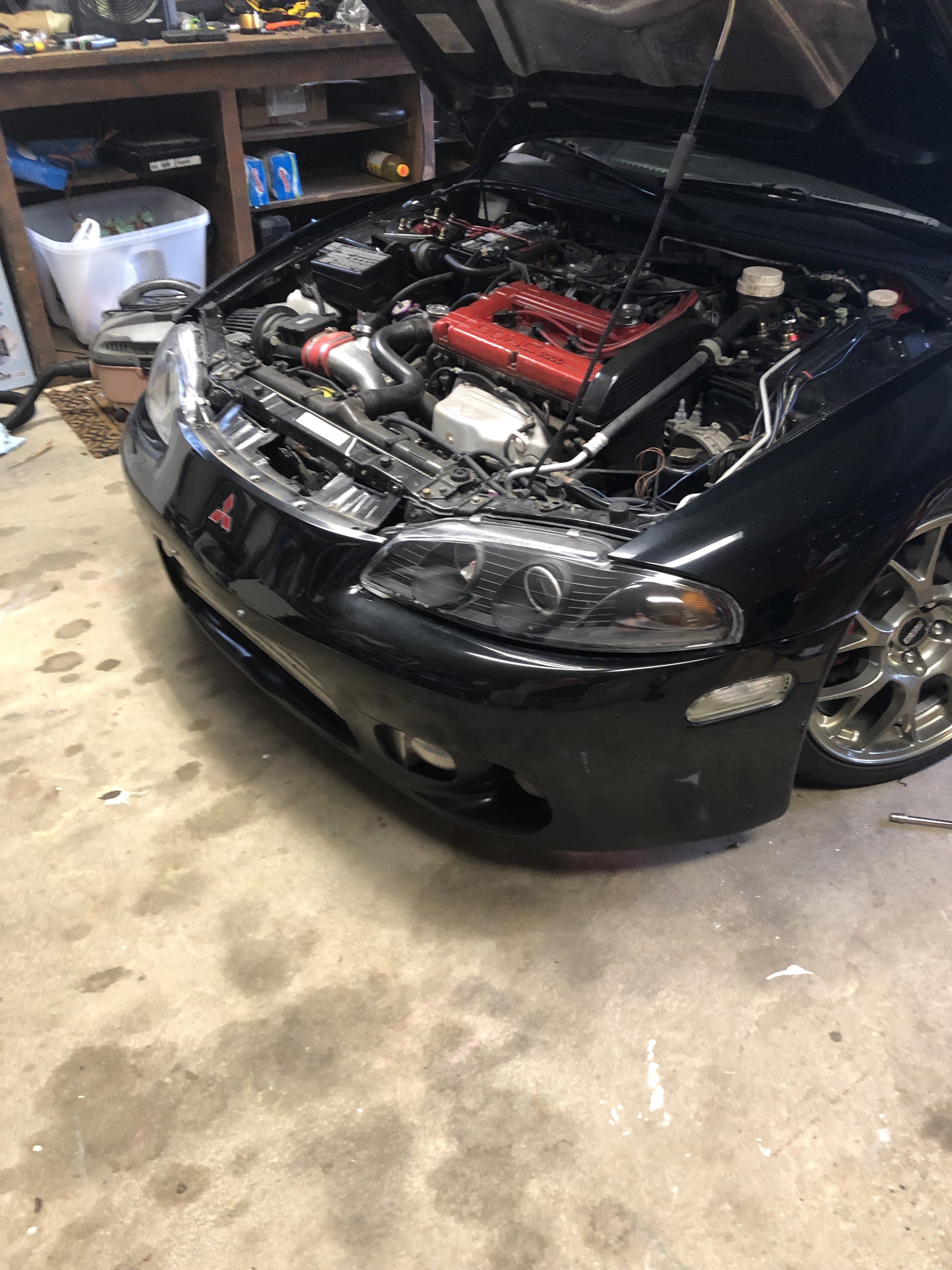

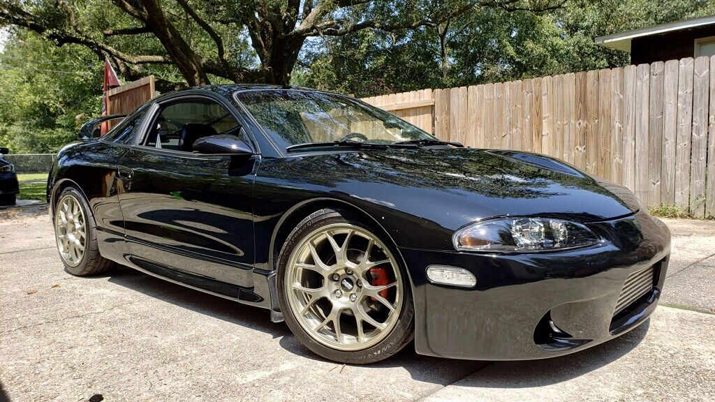

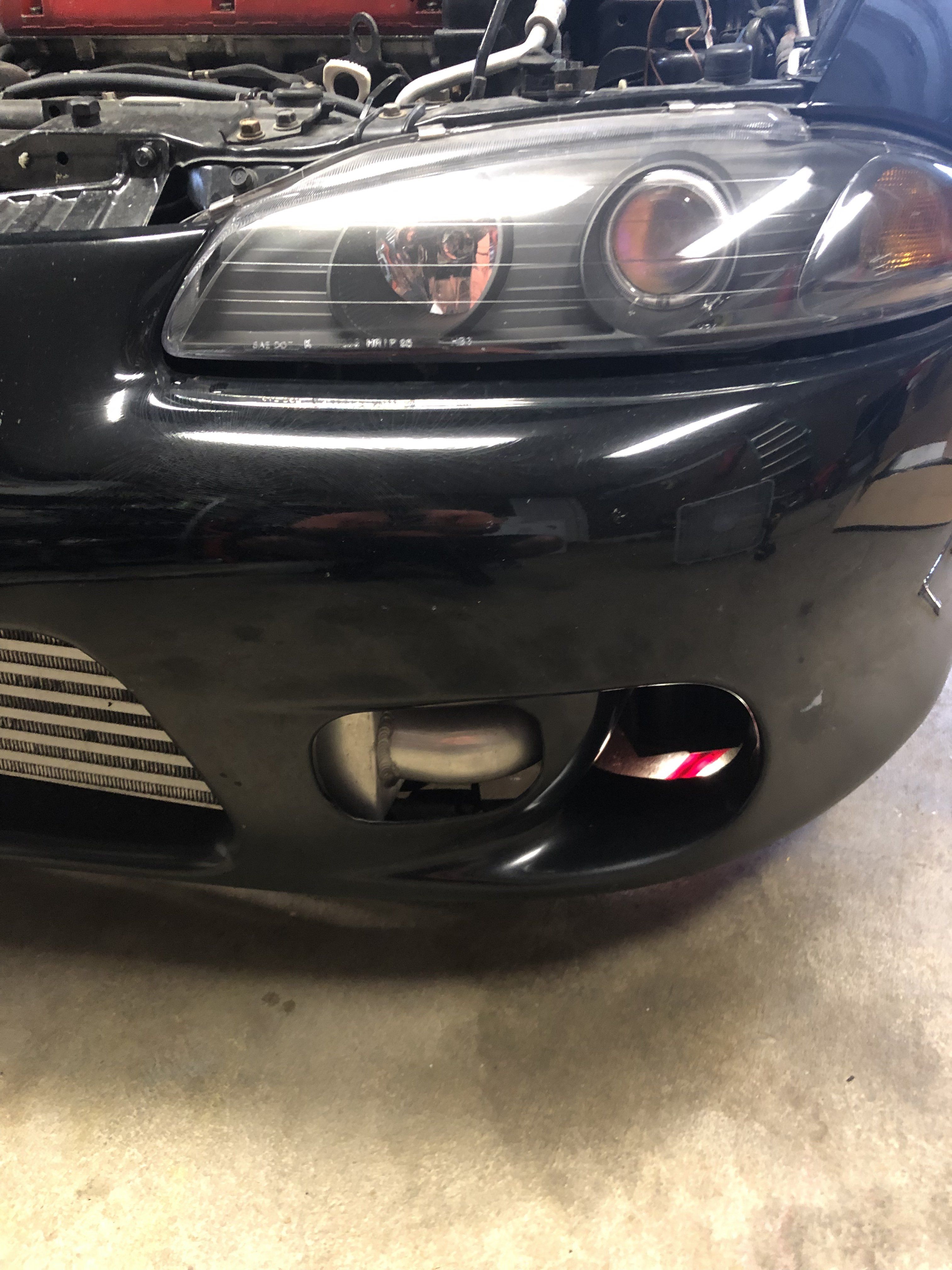

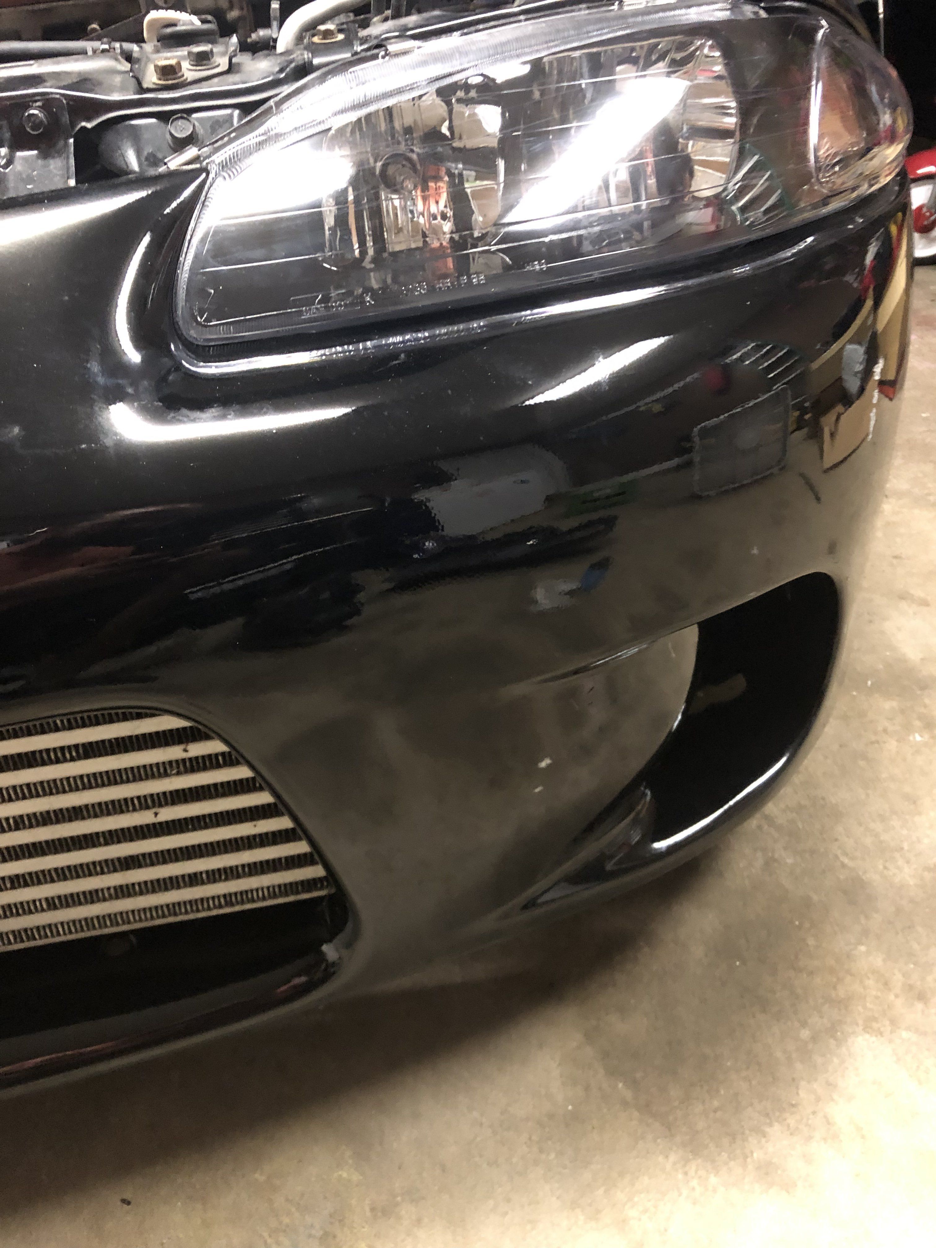

First things I addressed were the headlights and bumper. Replaced the headlights with some OEM style amazon specials. Bumper had the fog light holes shaved and repainted.

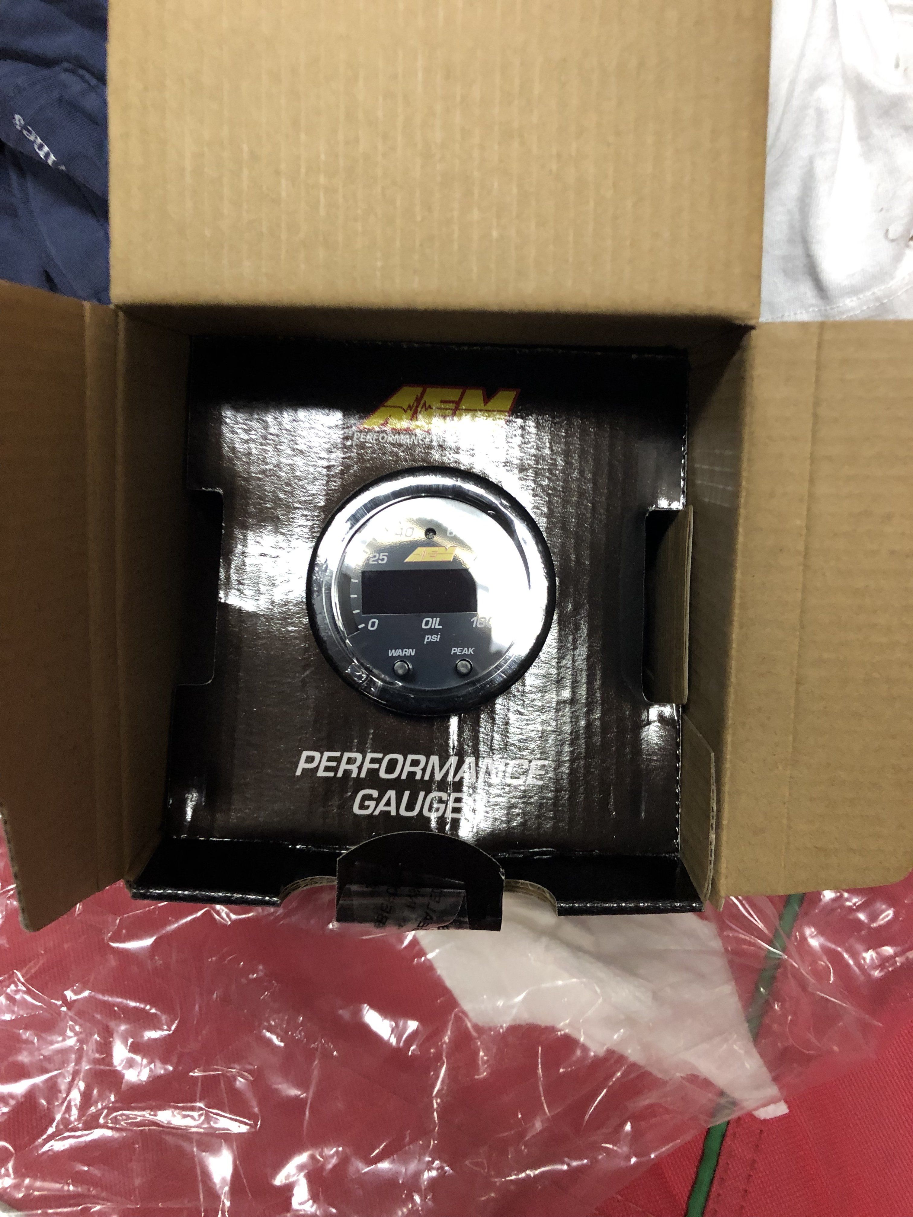

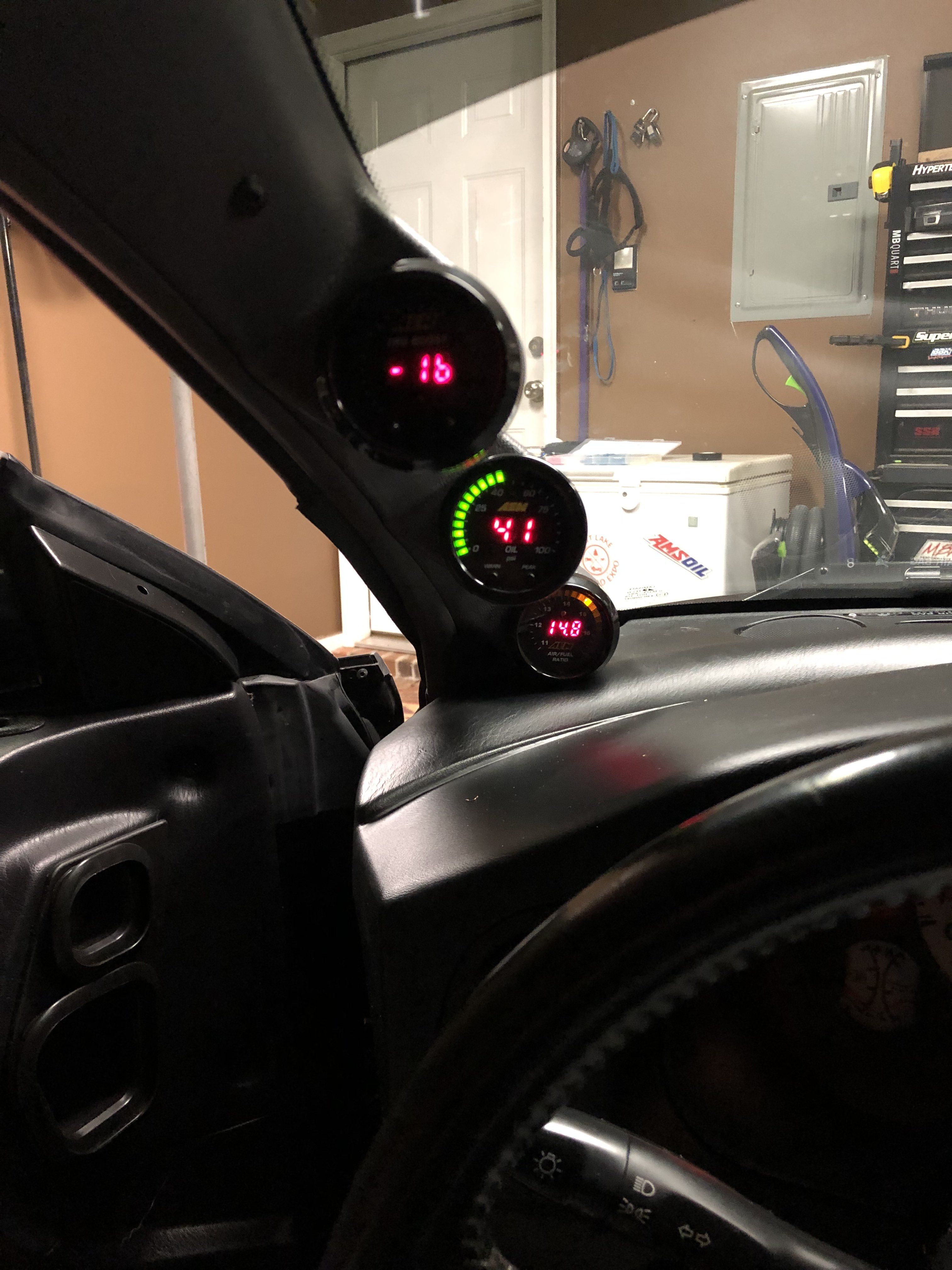

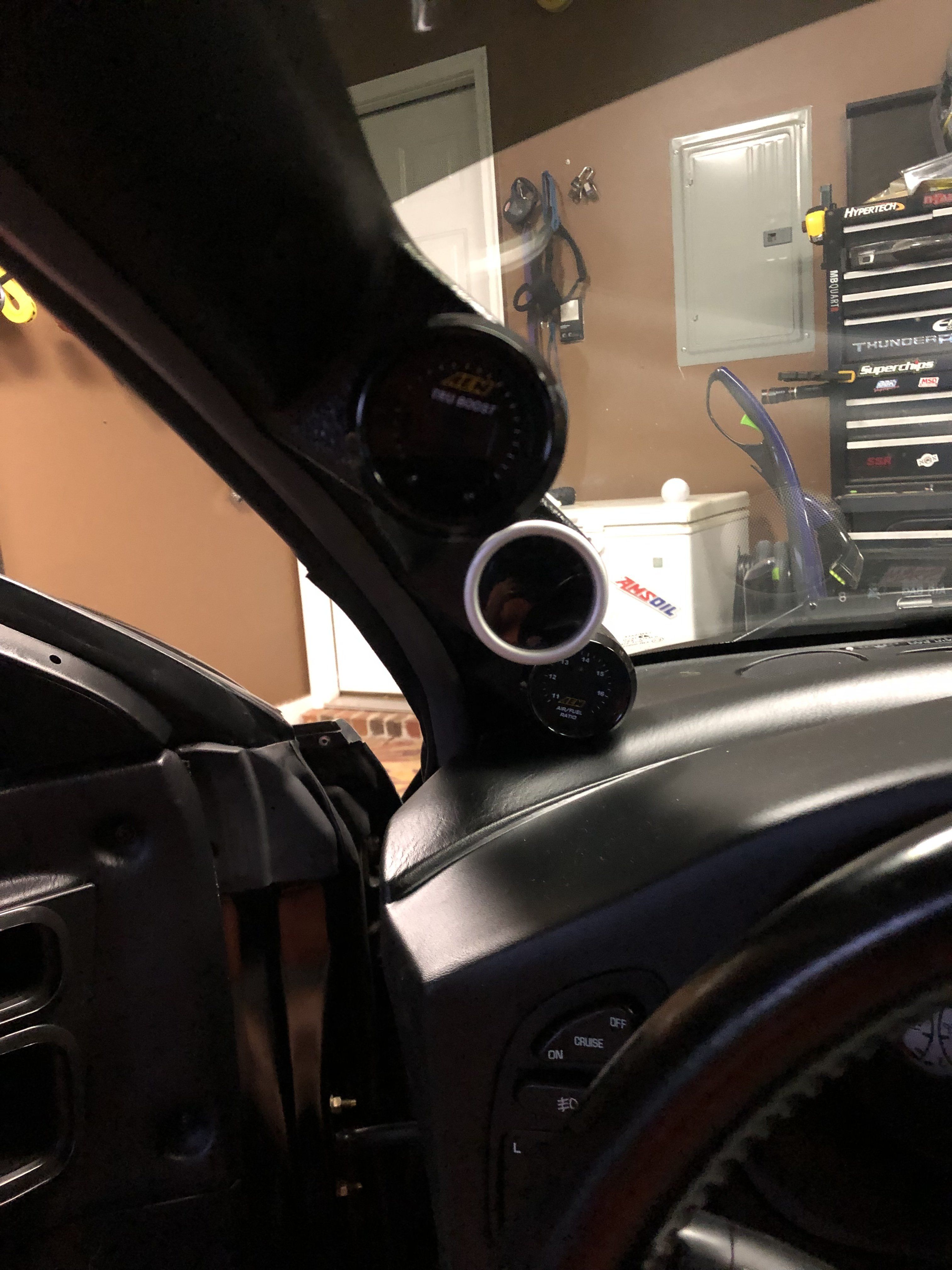

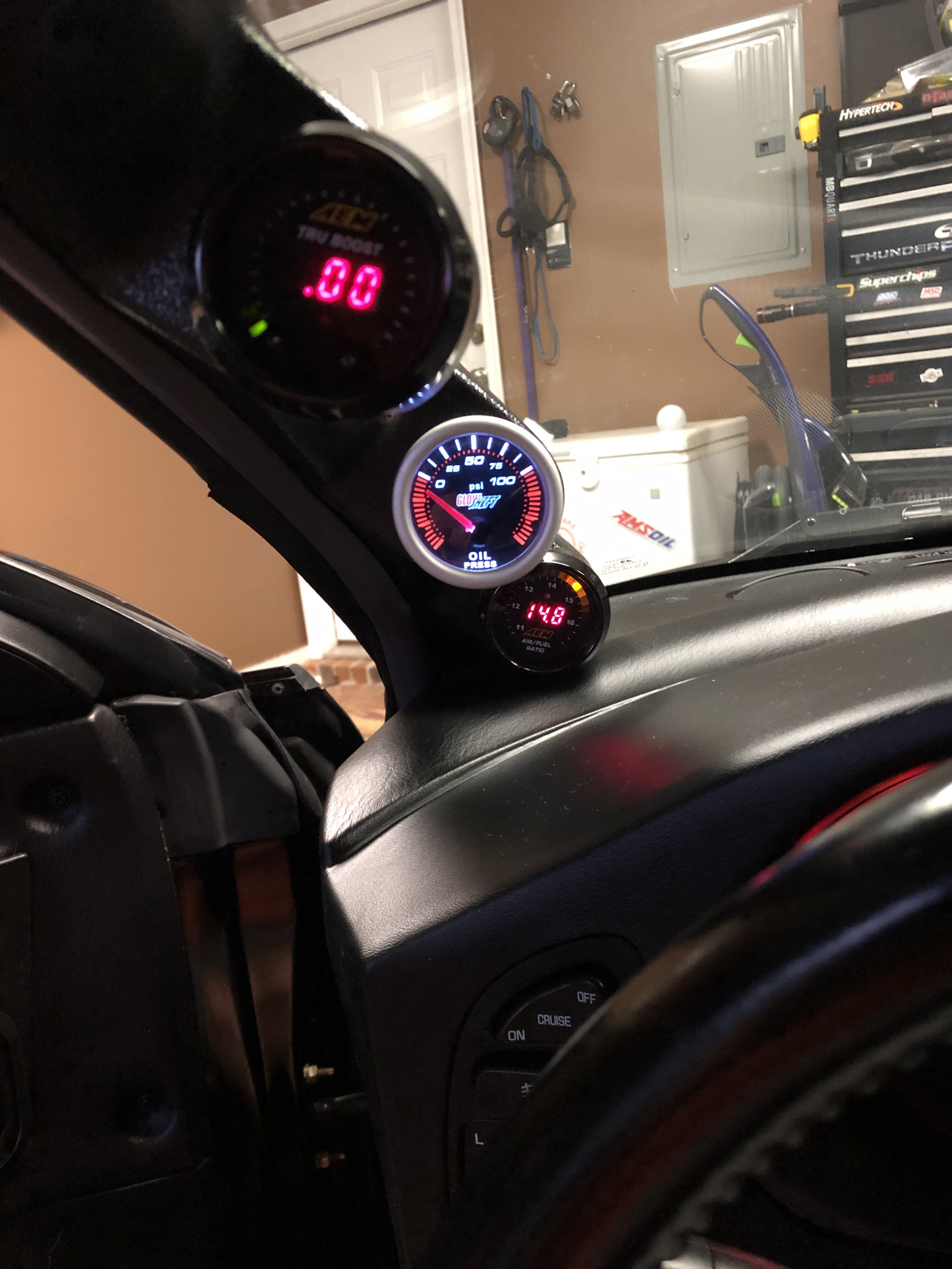

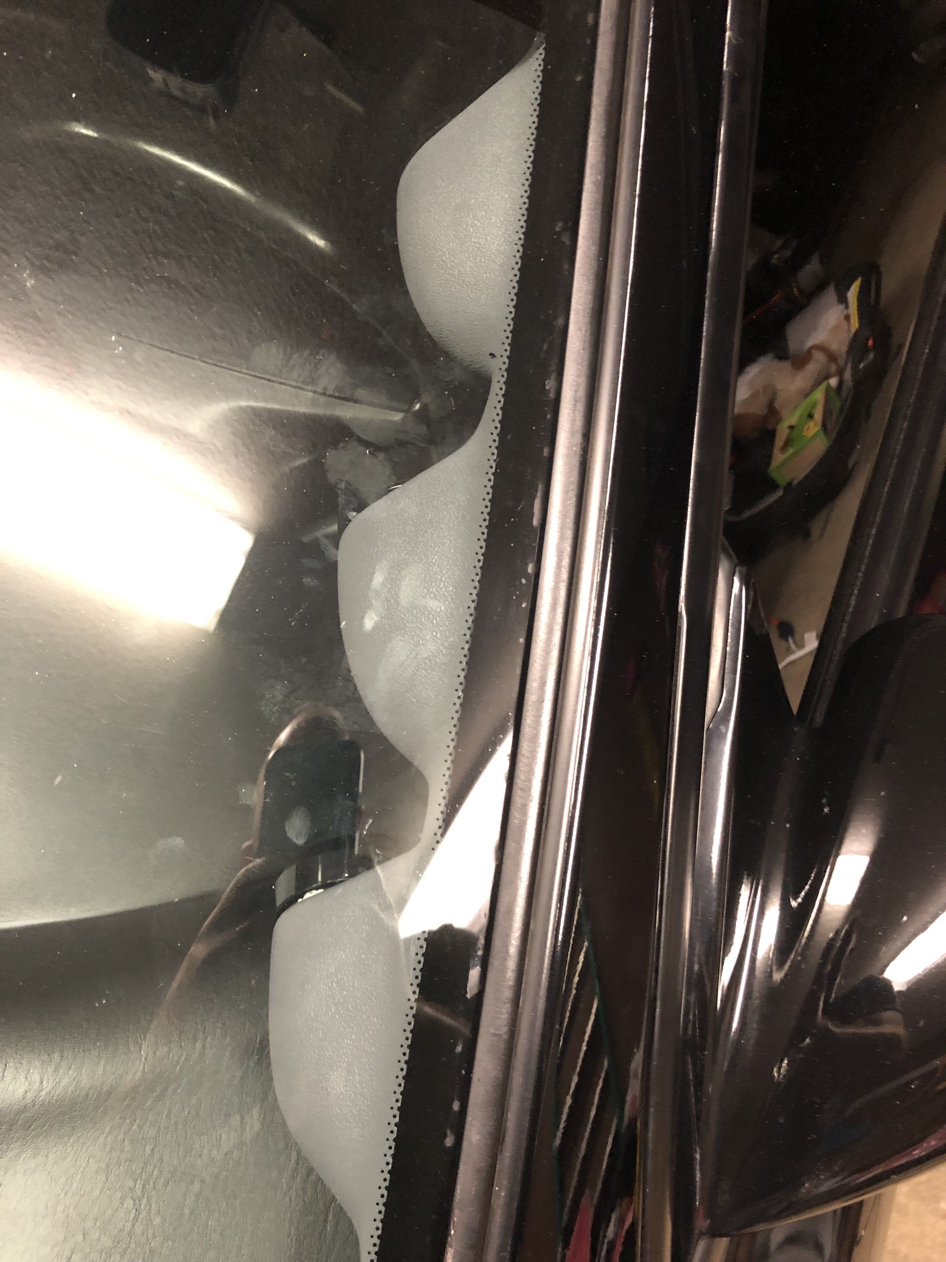

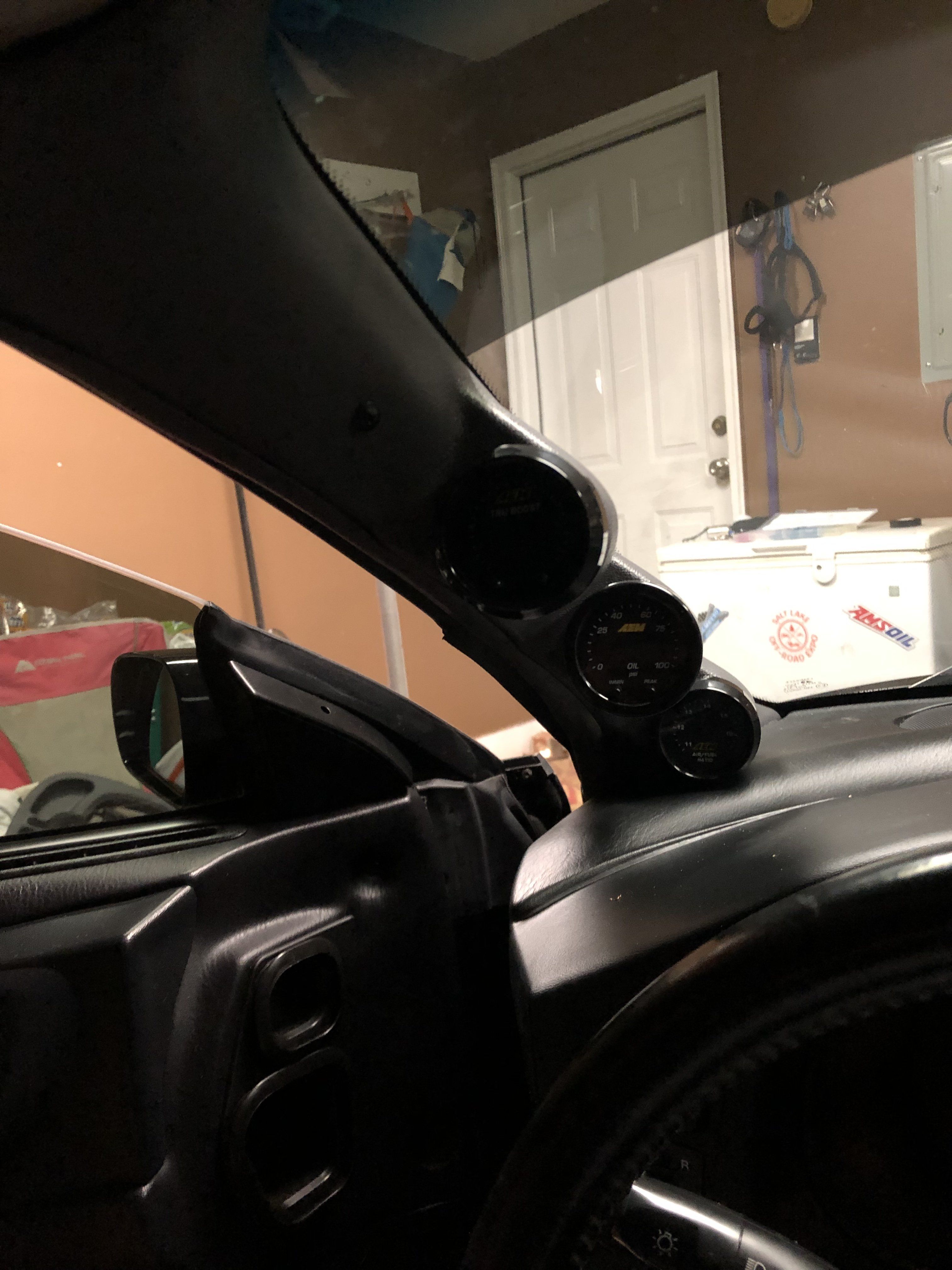

Finally got around to replacing the cheap ass triple pod and glowshit gauge. Autometer to the rescue on the pod and AEM with an oil pressure gauge. Now it’s not so terrible.

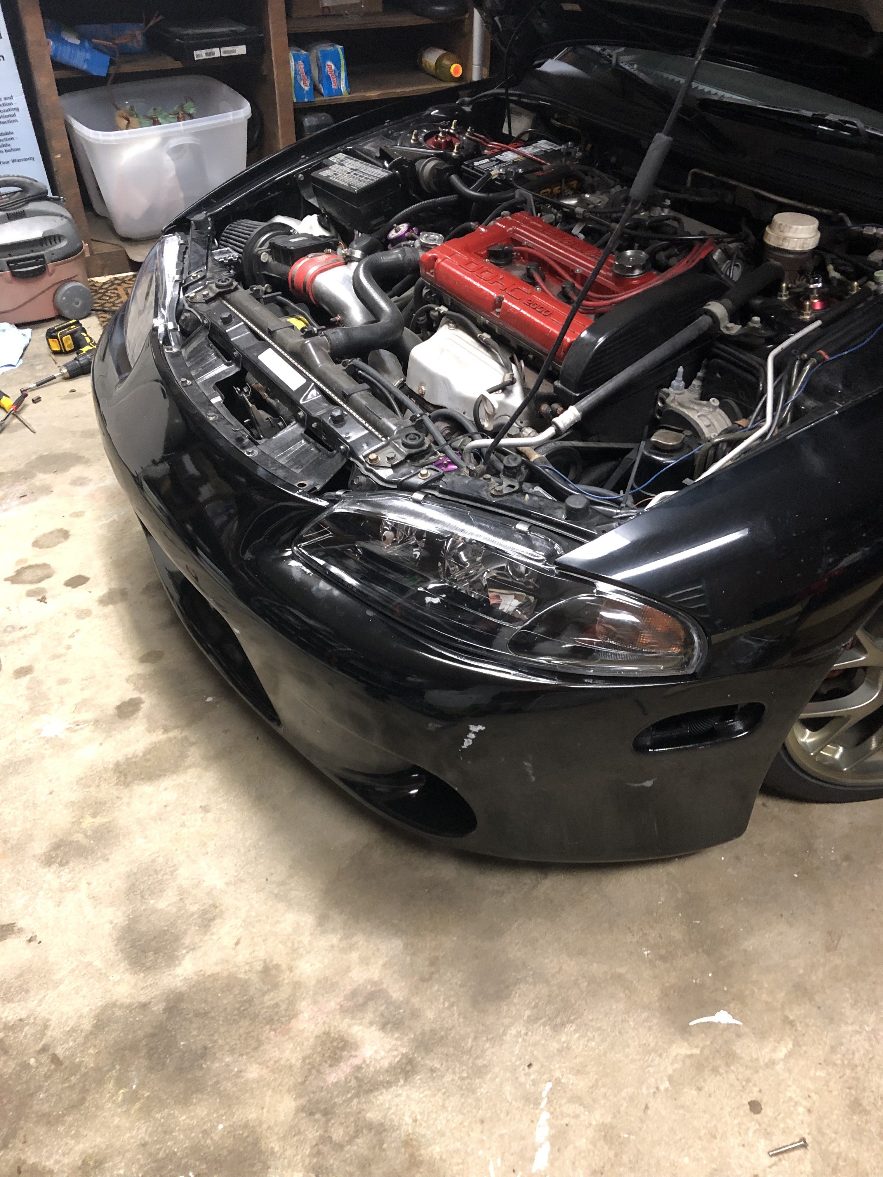

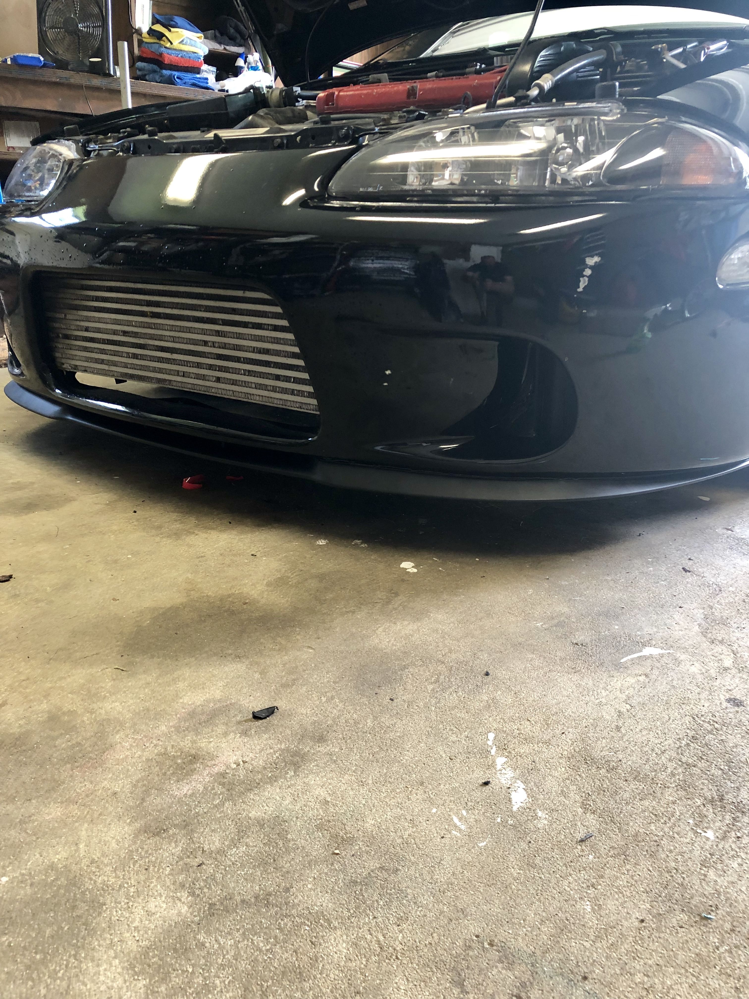

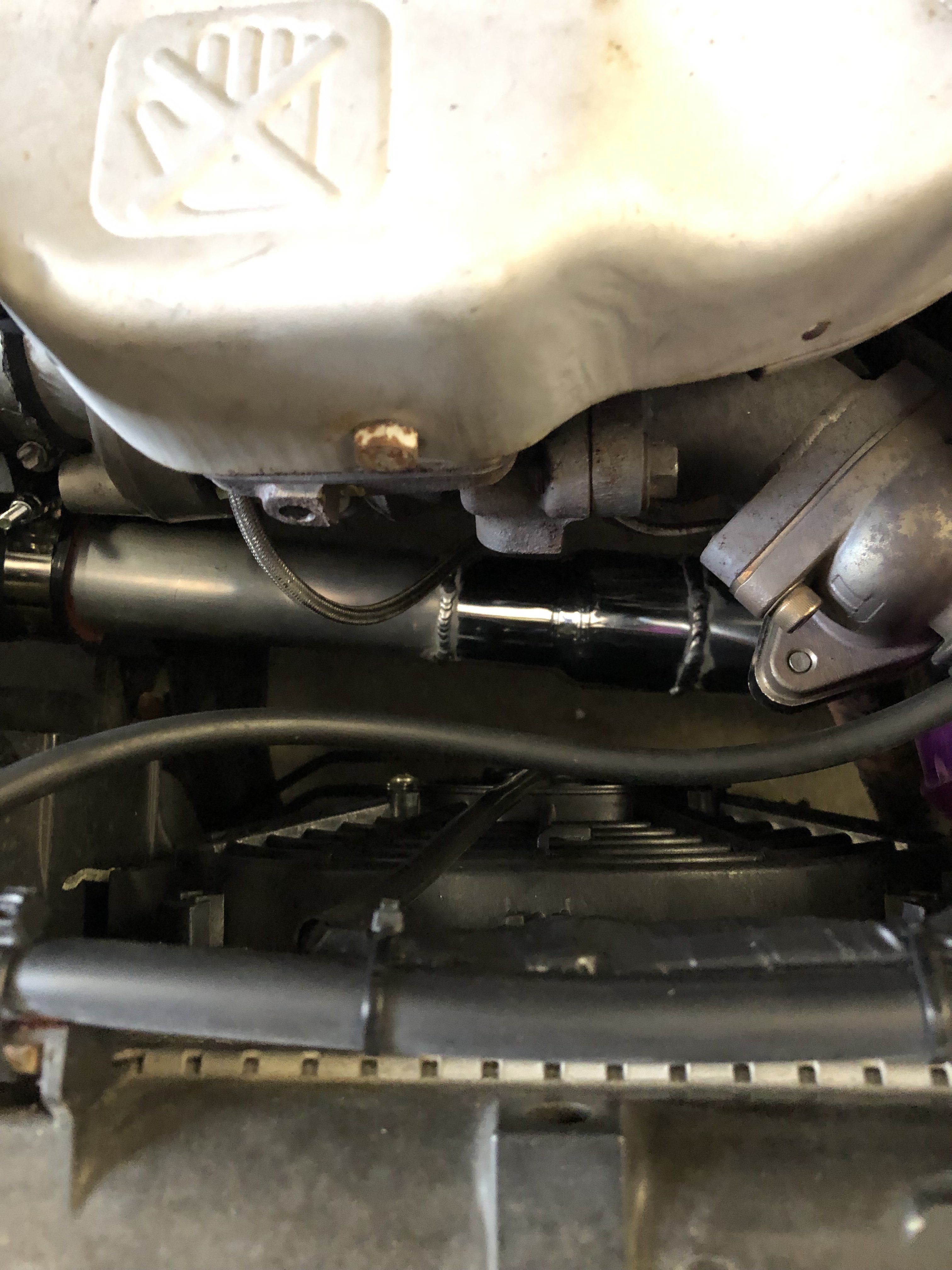

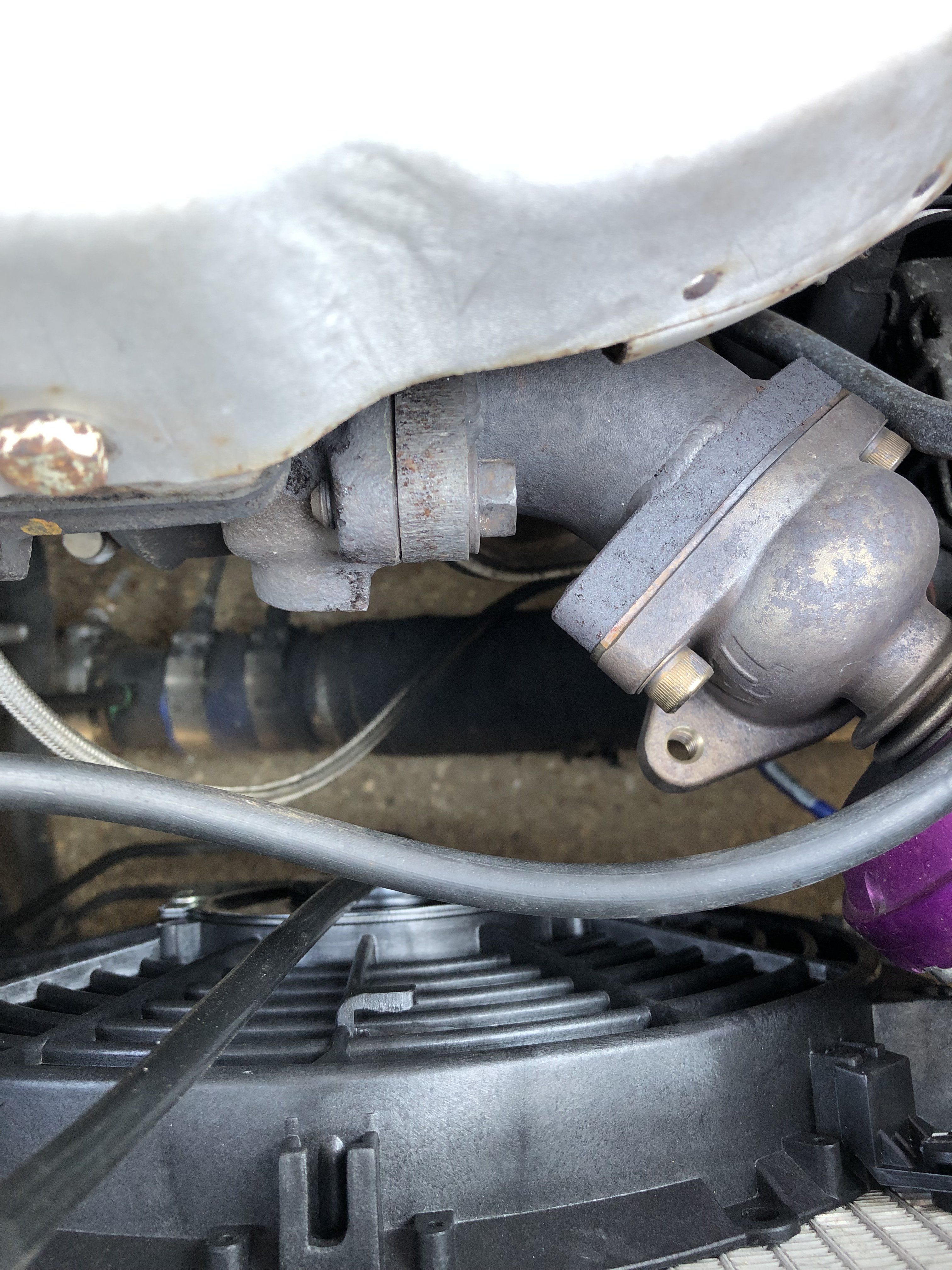

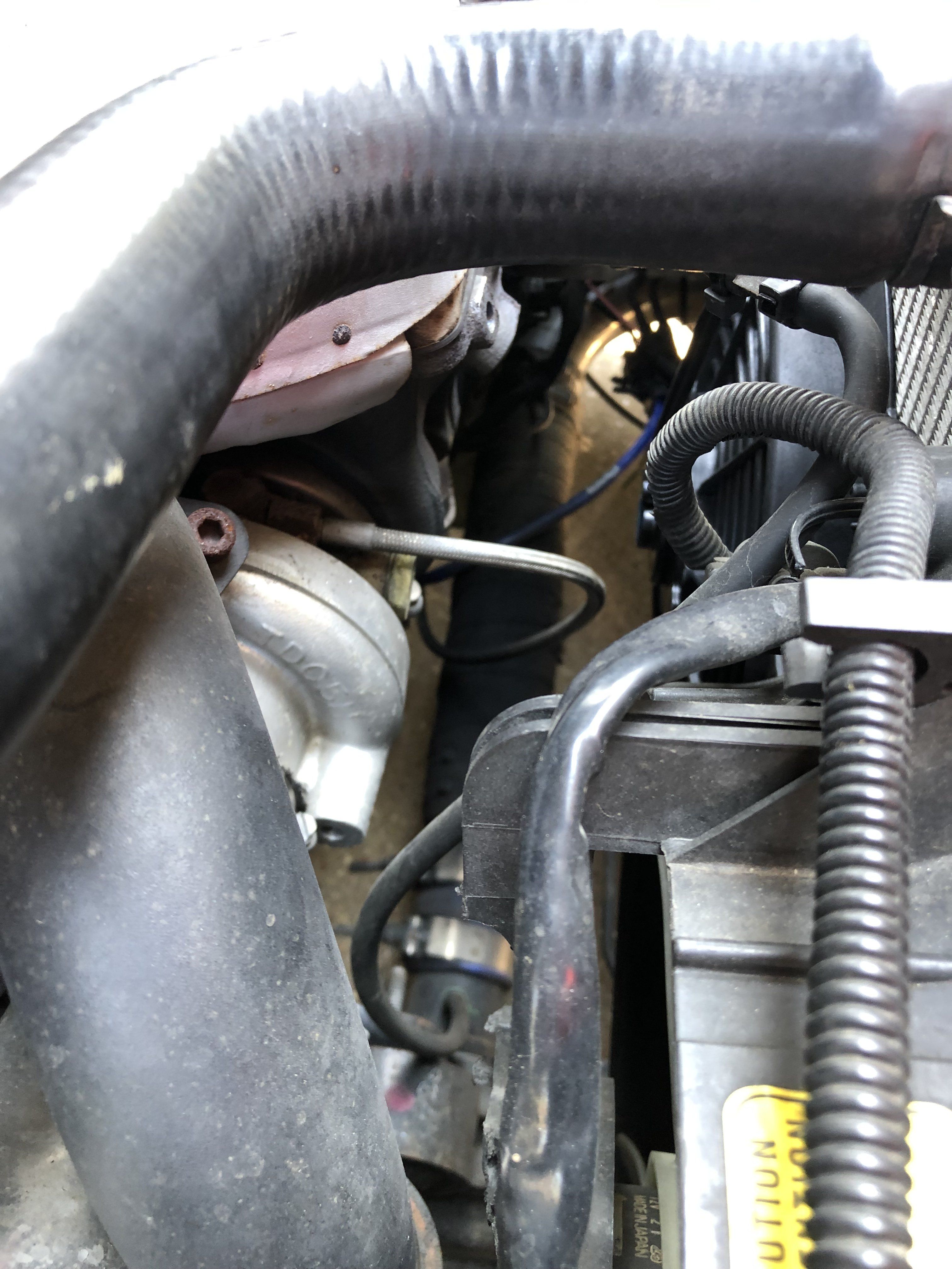

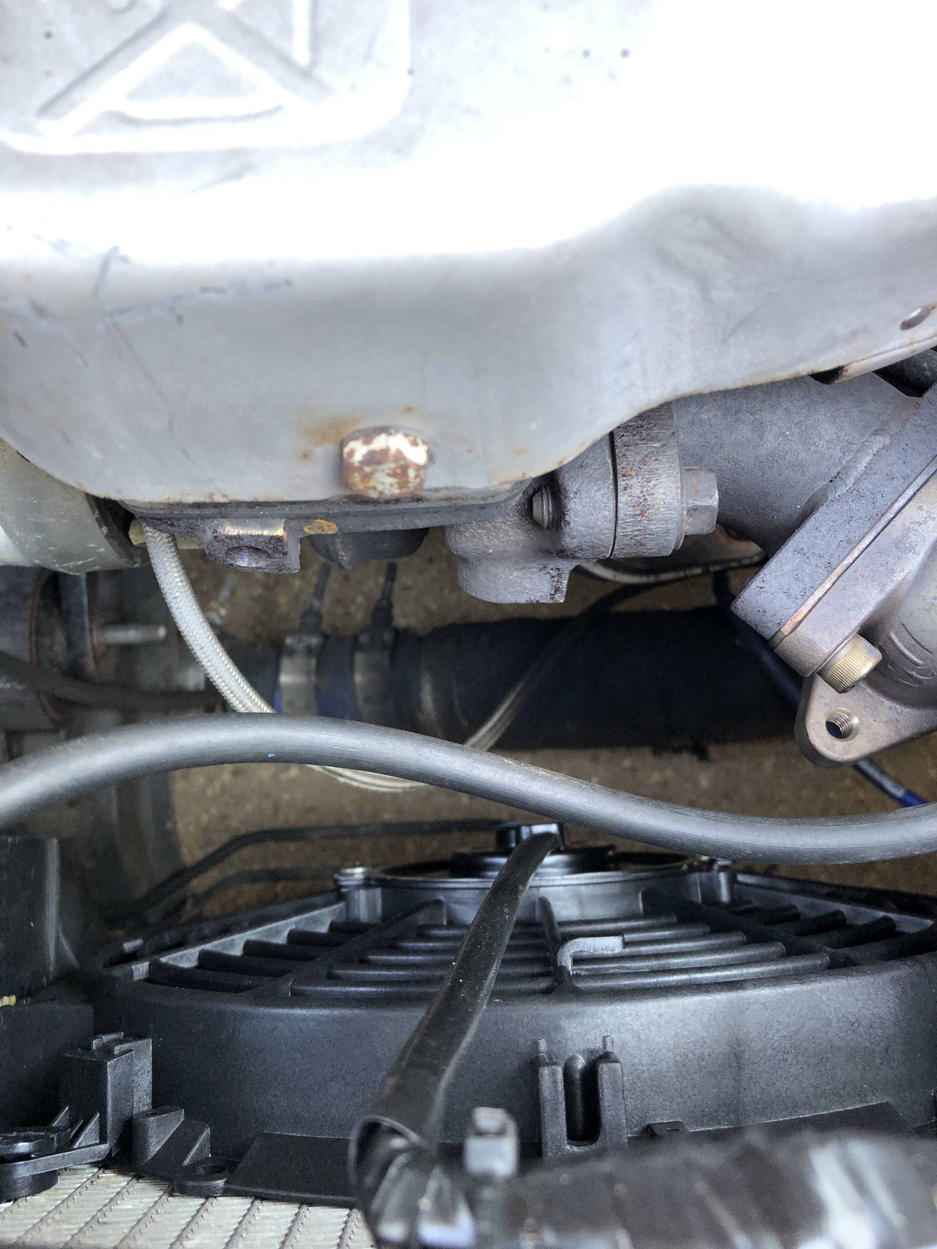

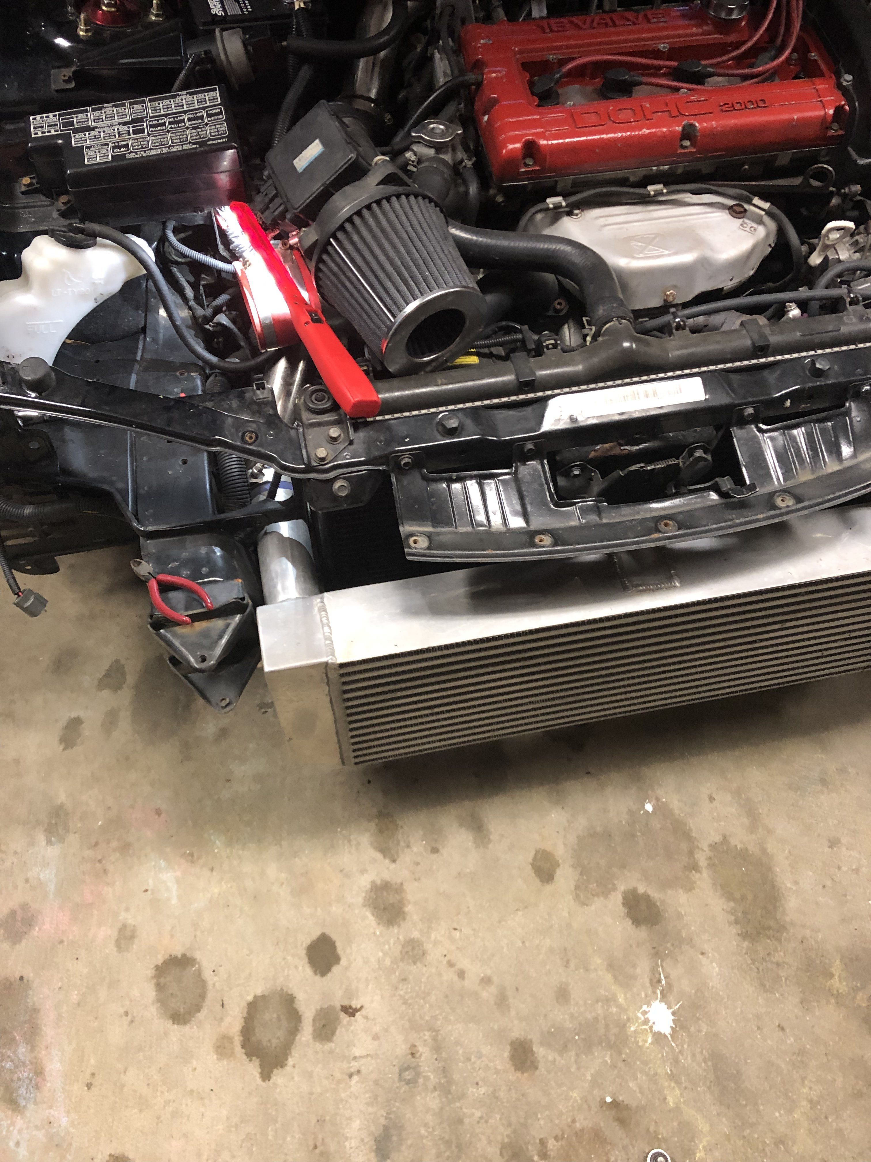

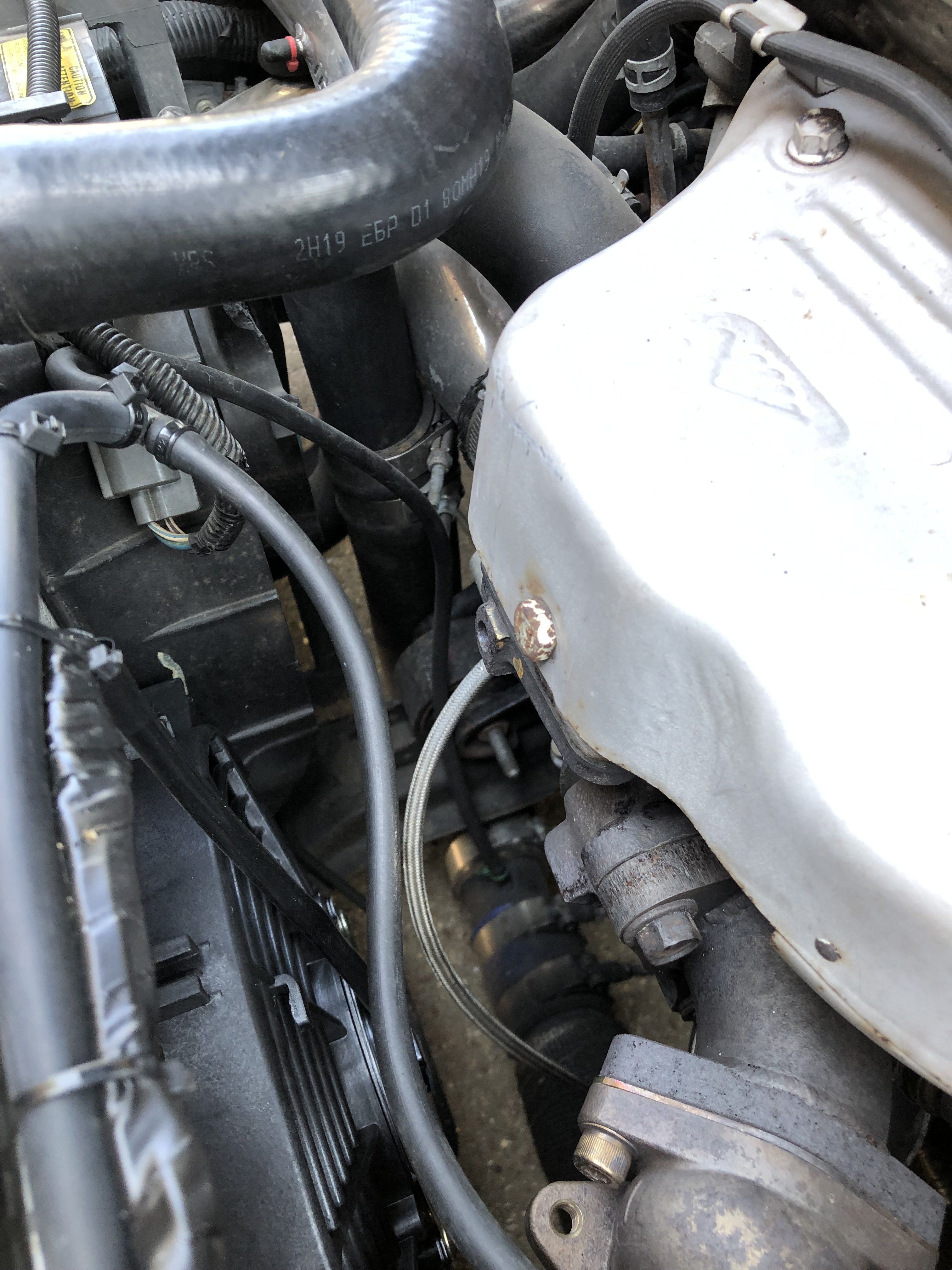

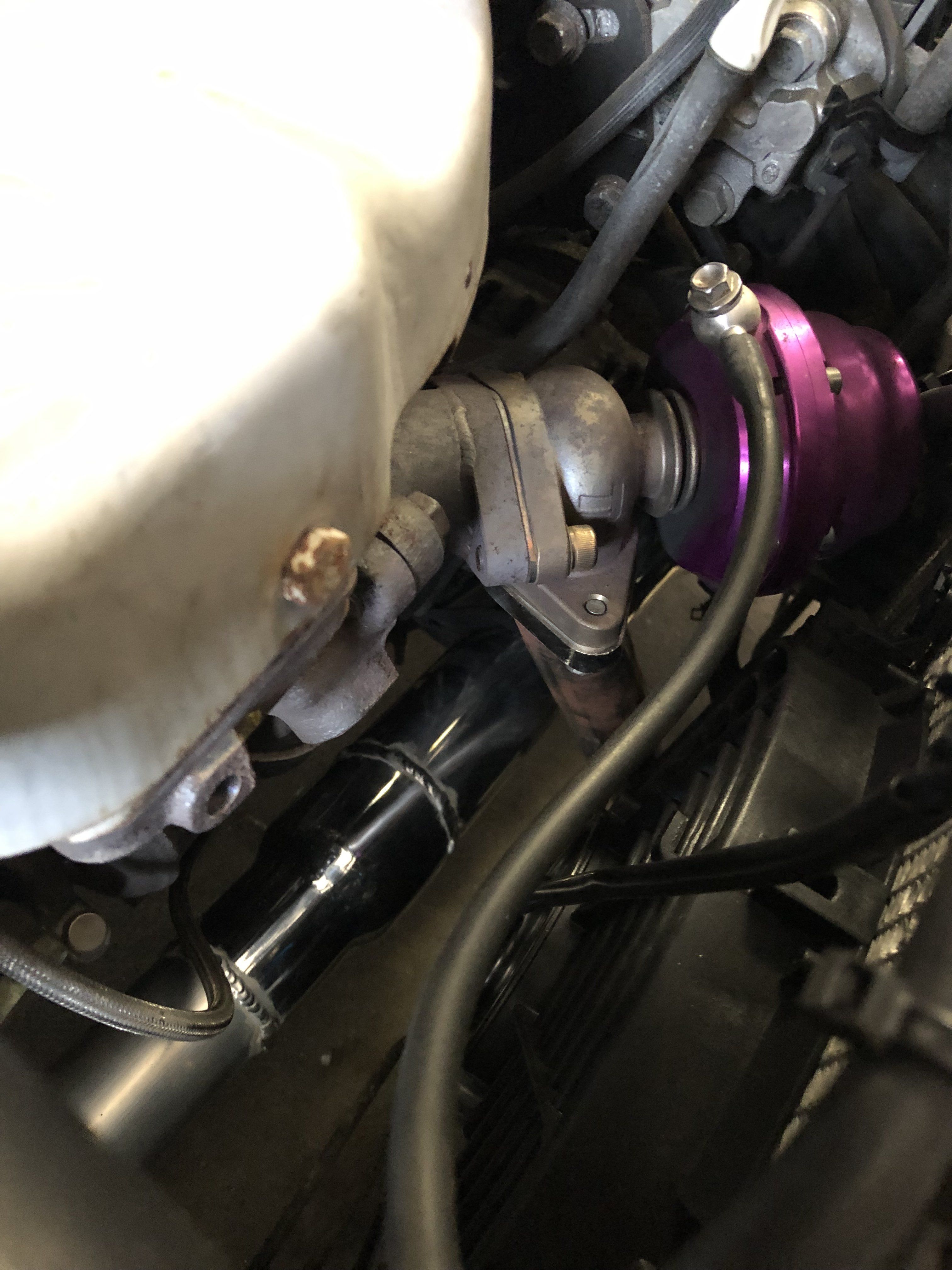

I got around to getting my lower IC pipe remade and getting a dump tube made. The previous owner had put some clapped out intercooler contraption down there as a pipe. Anyways, properly routed and welded now and my wastegate is actually dumping outside the car now. So it’s a win/win.

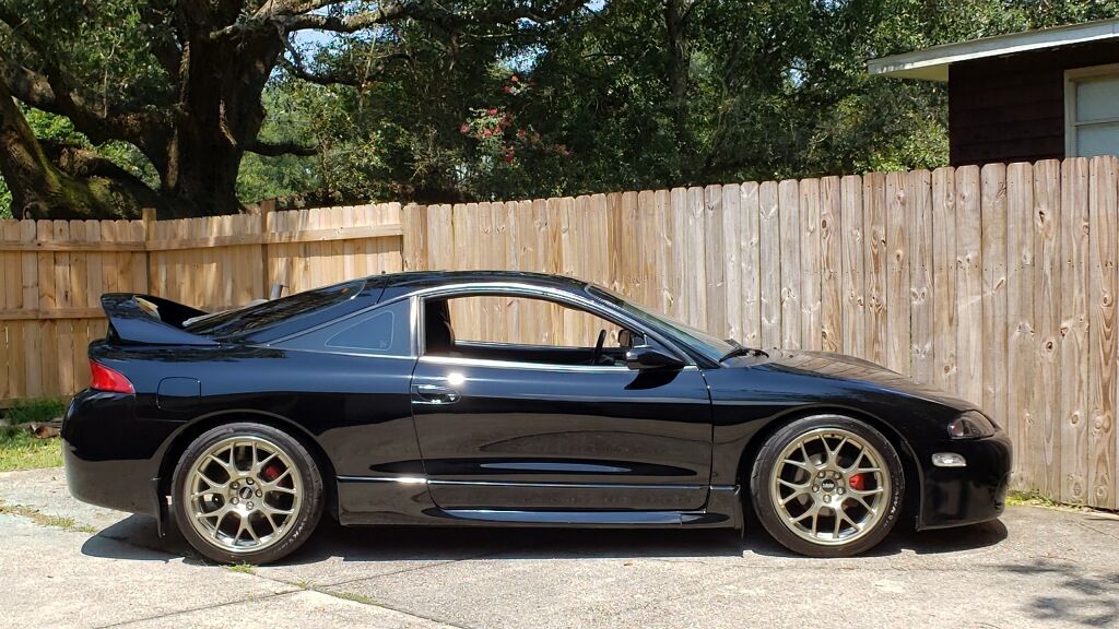

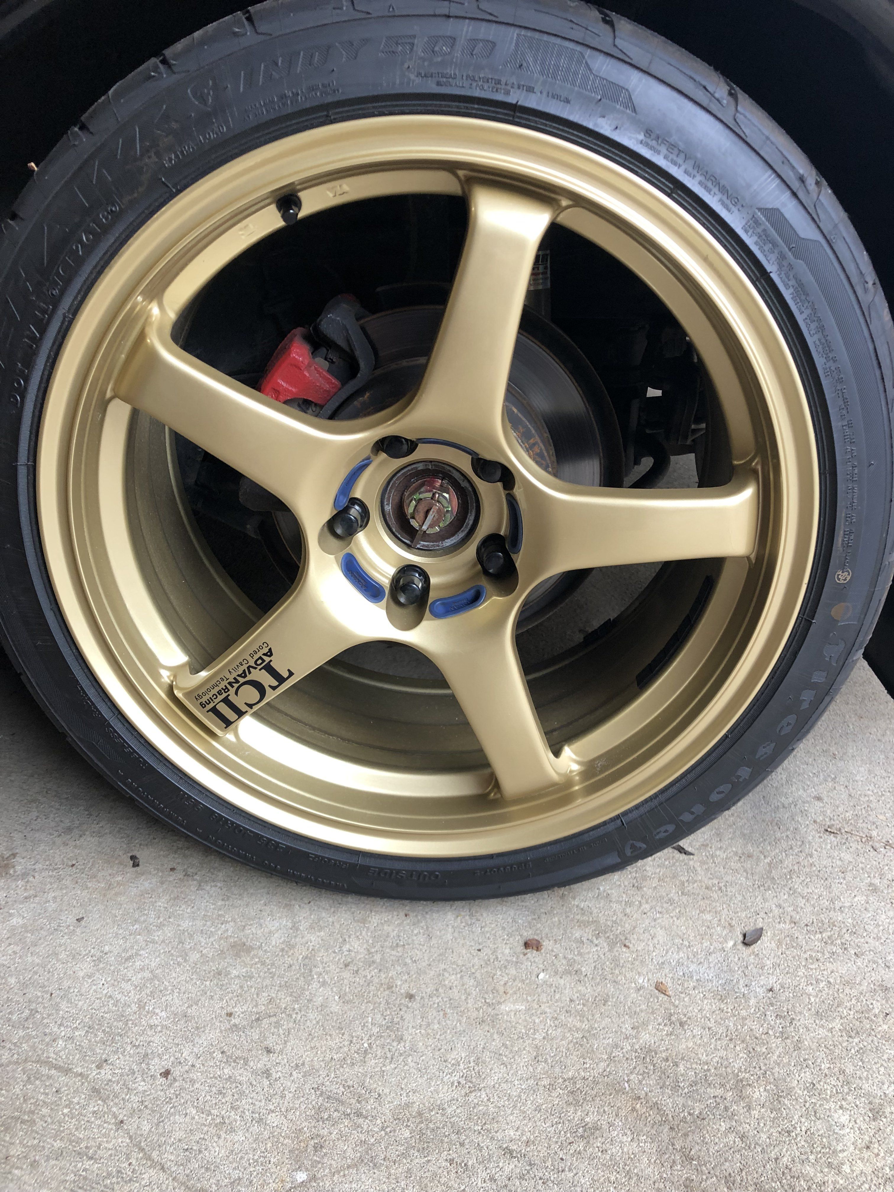

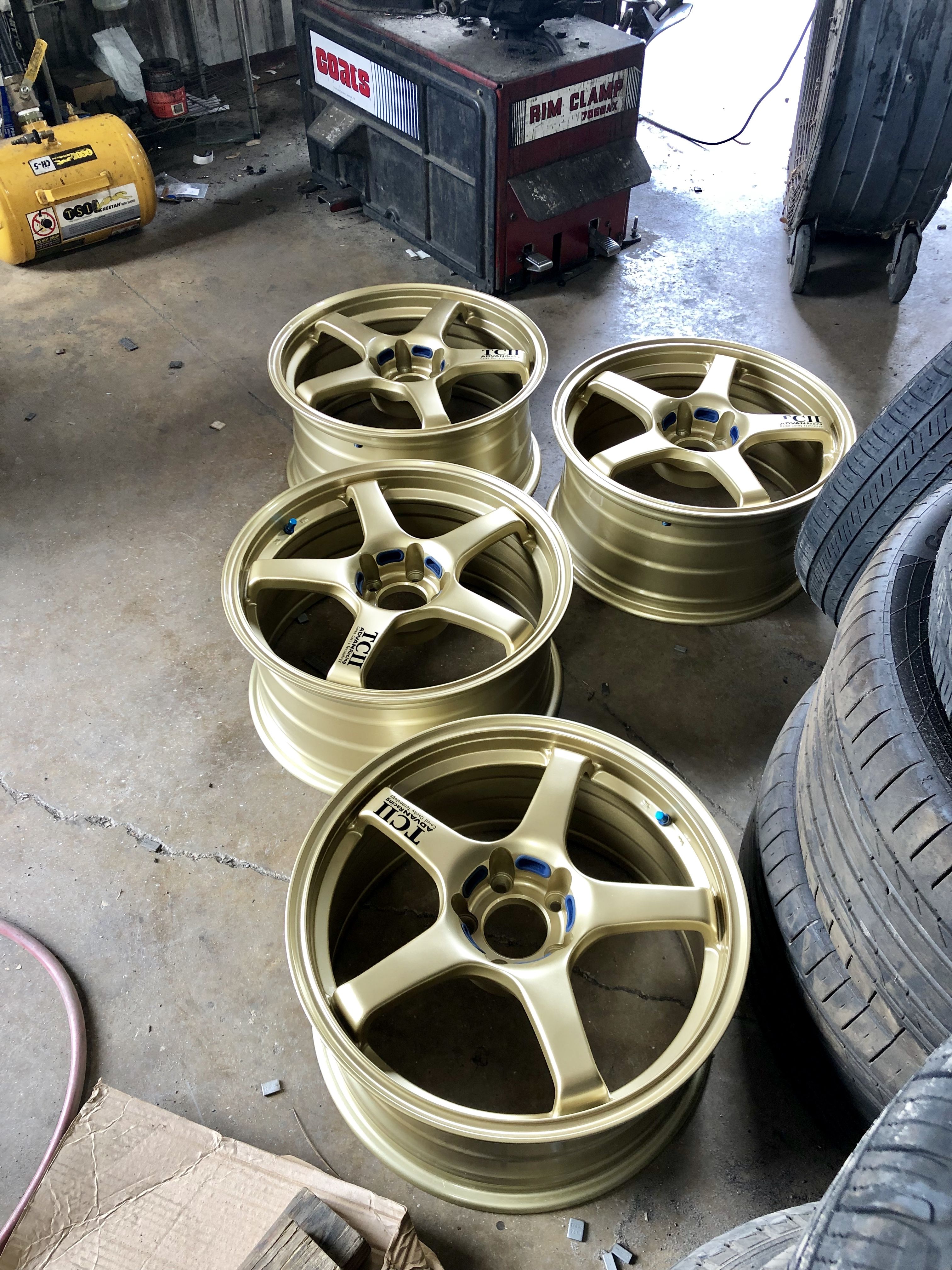

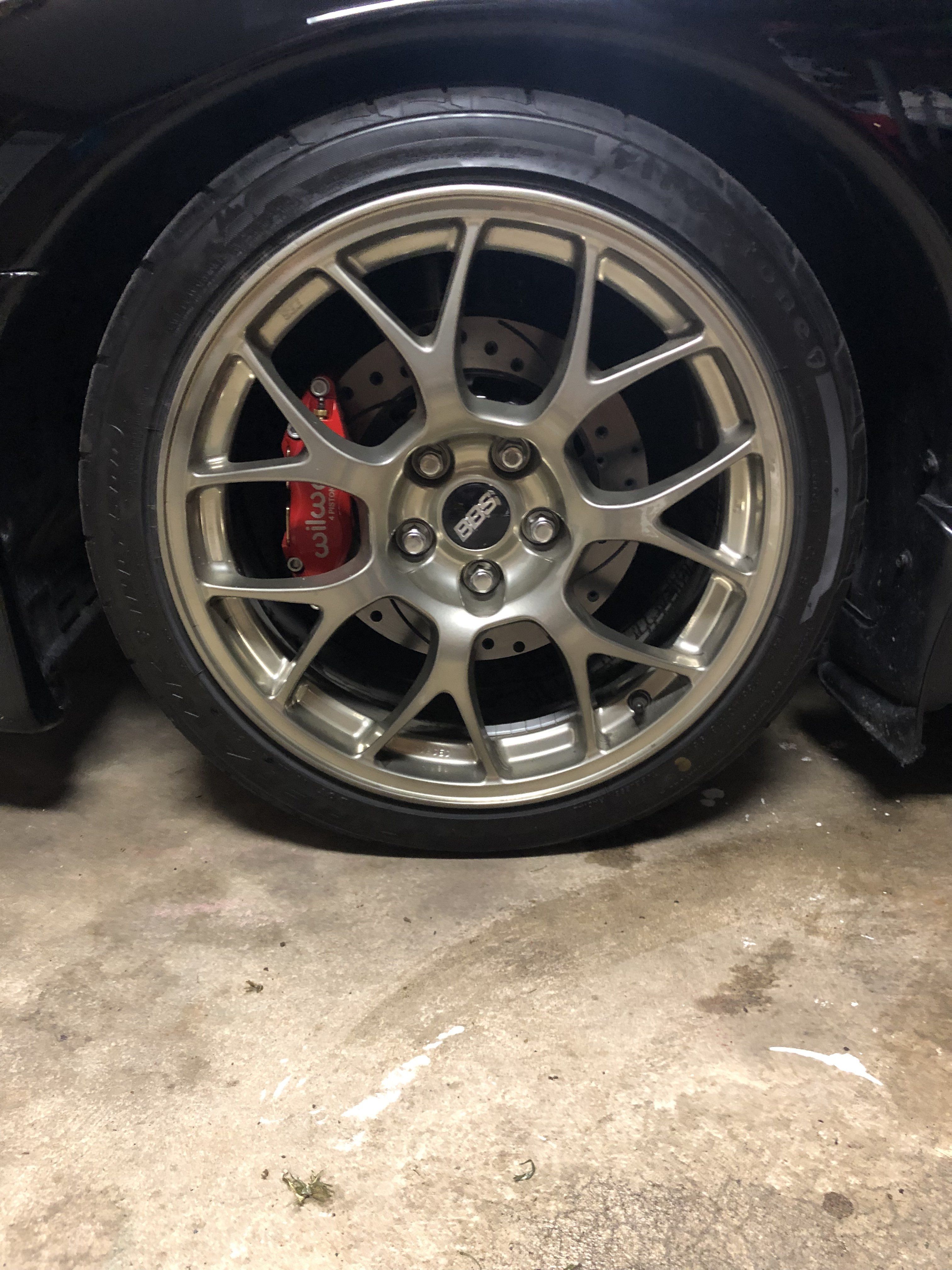

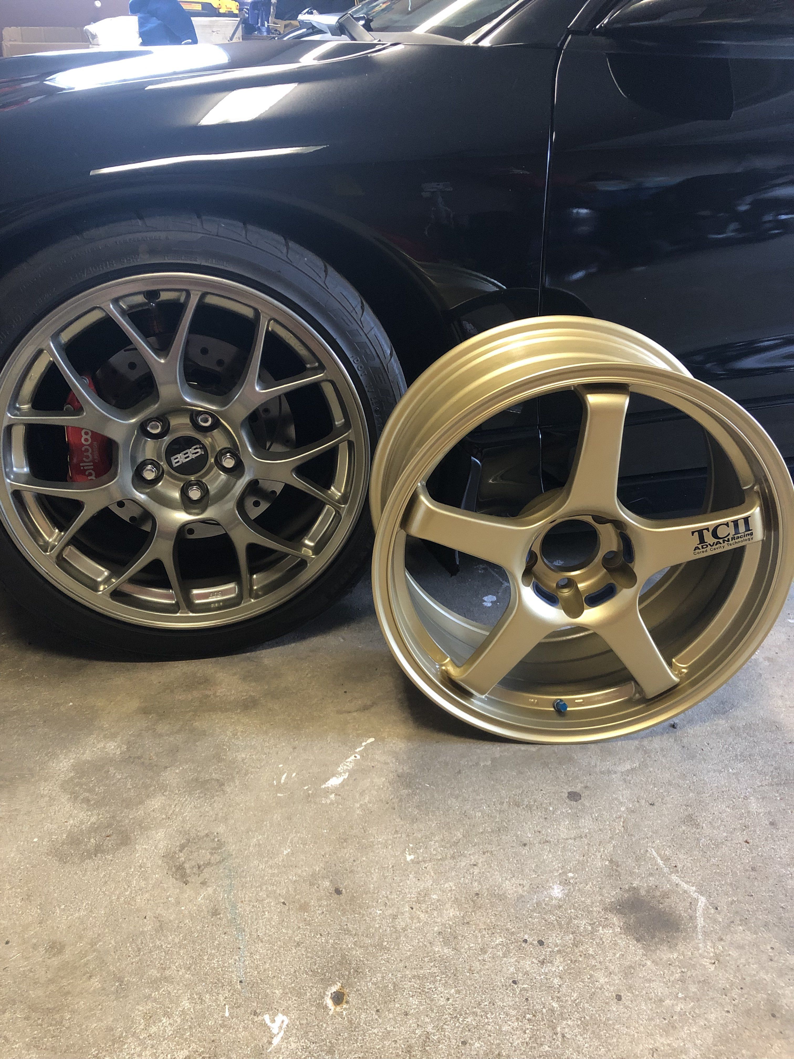

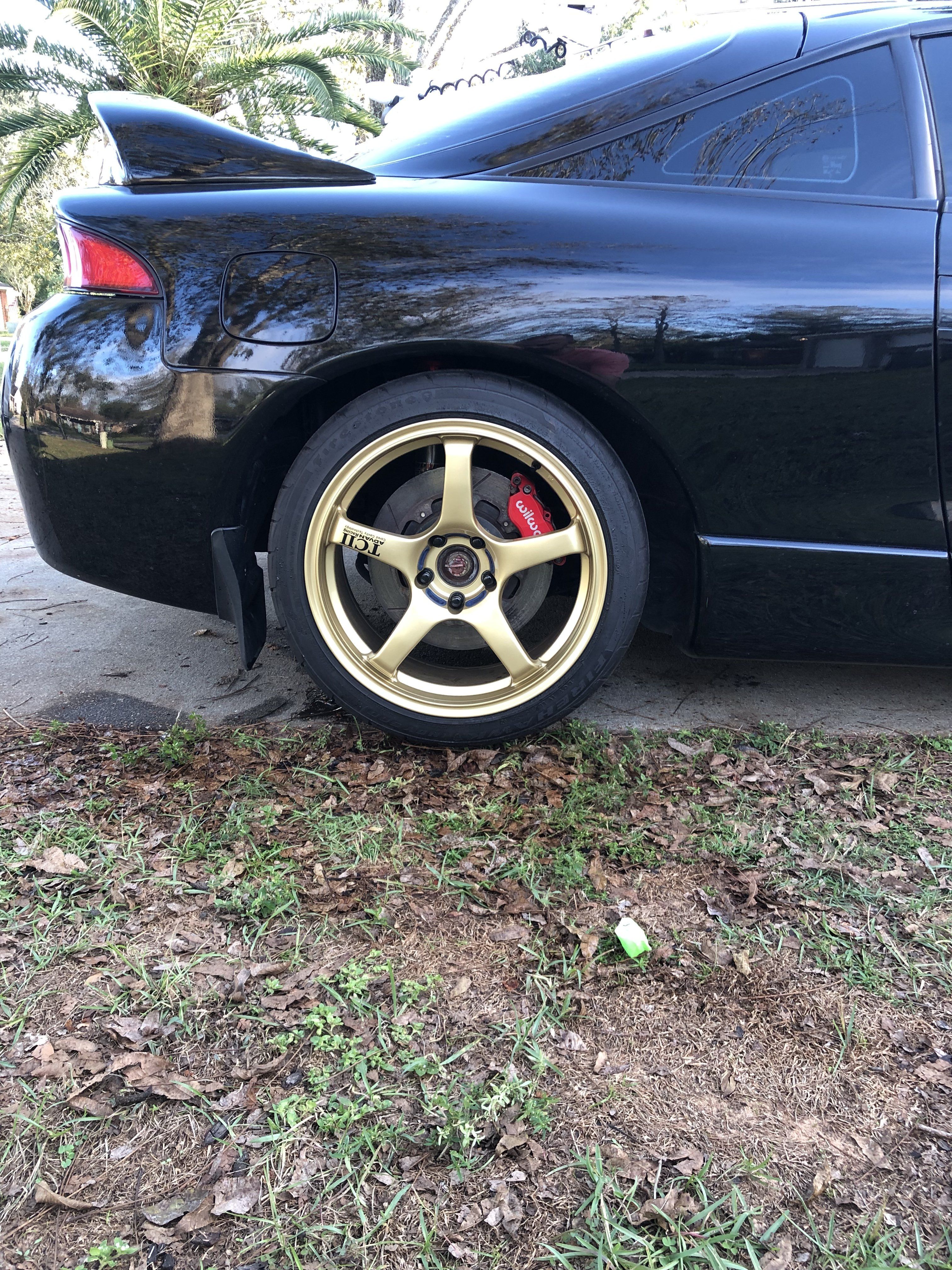

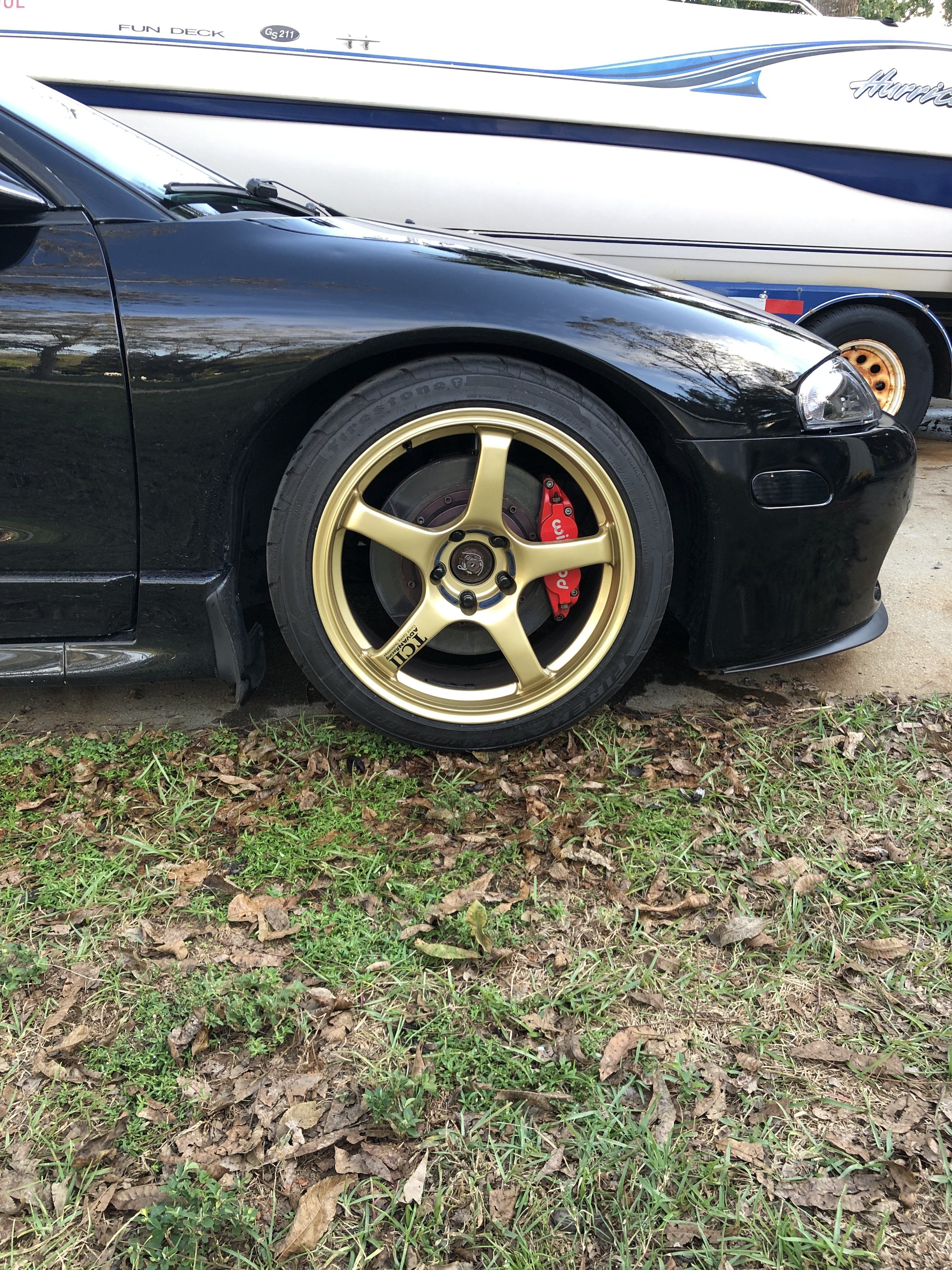

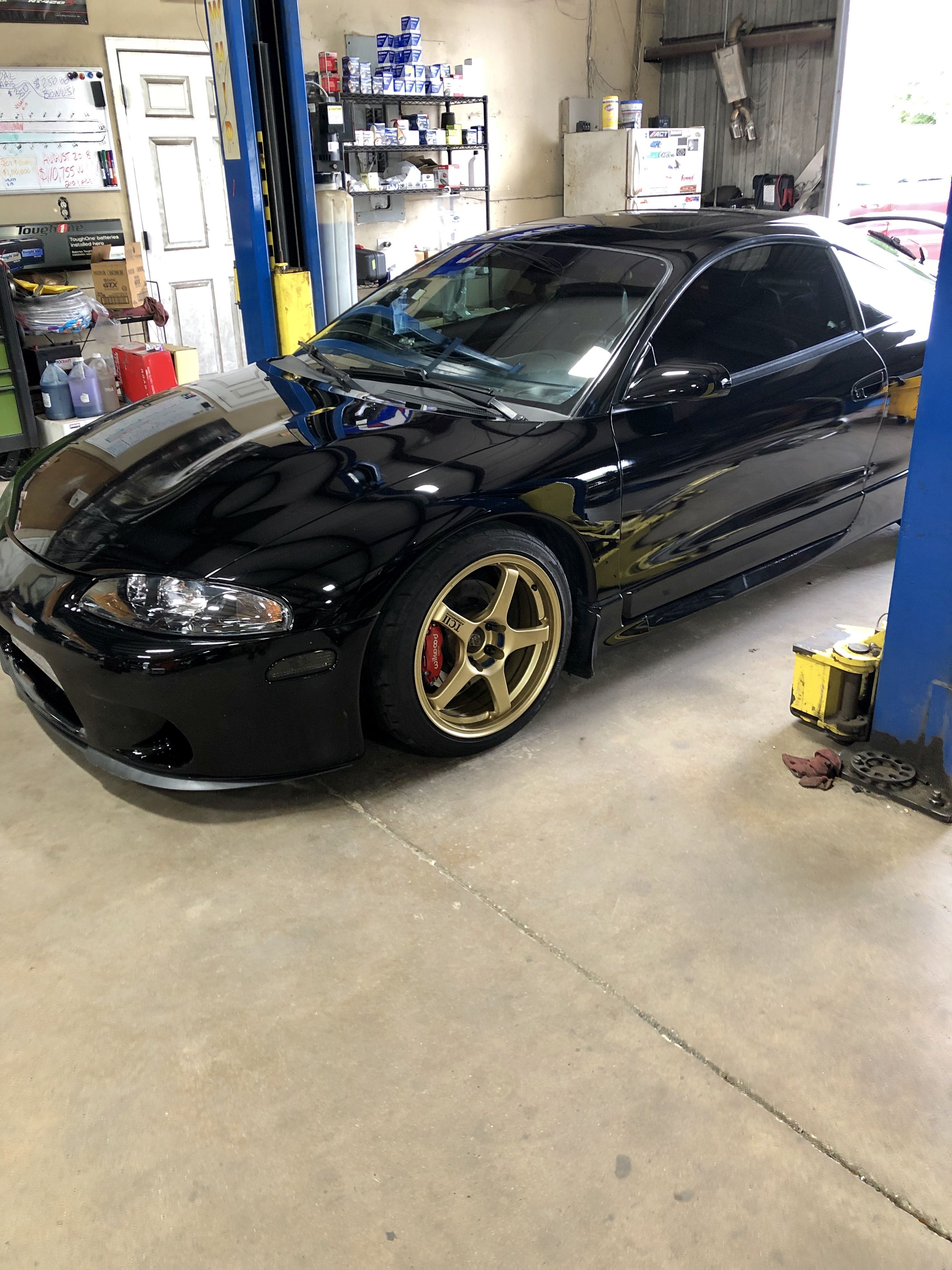

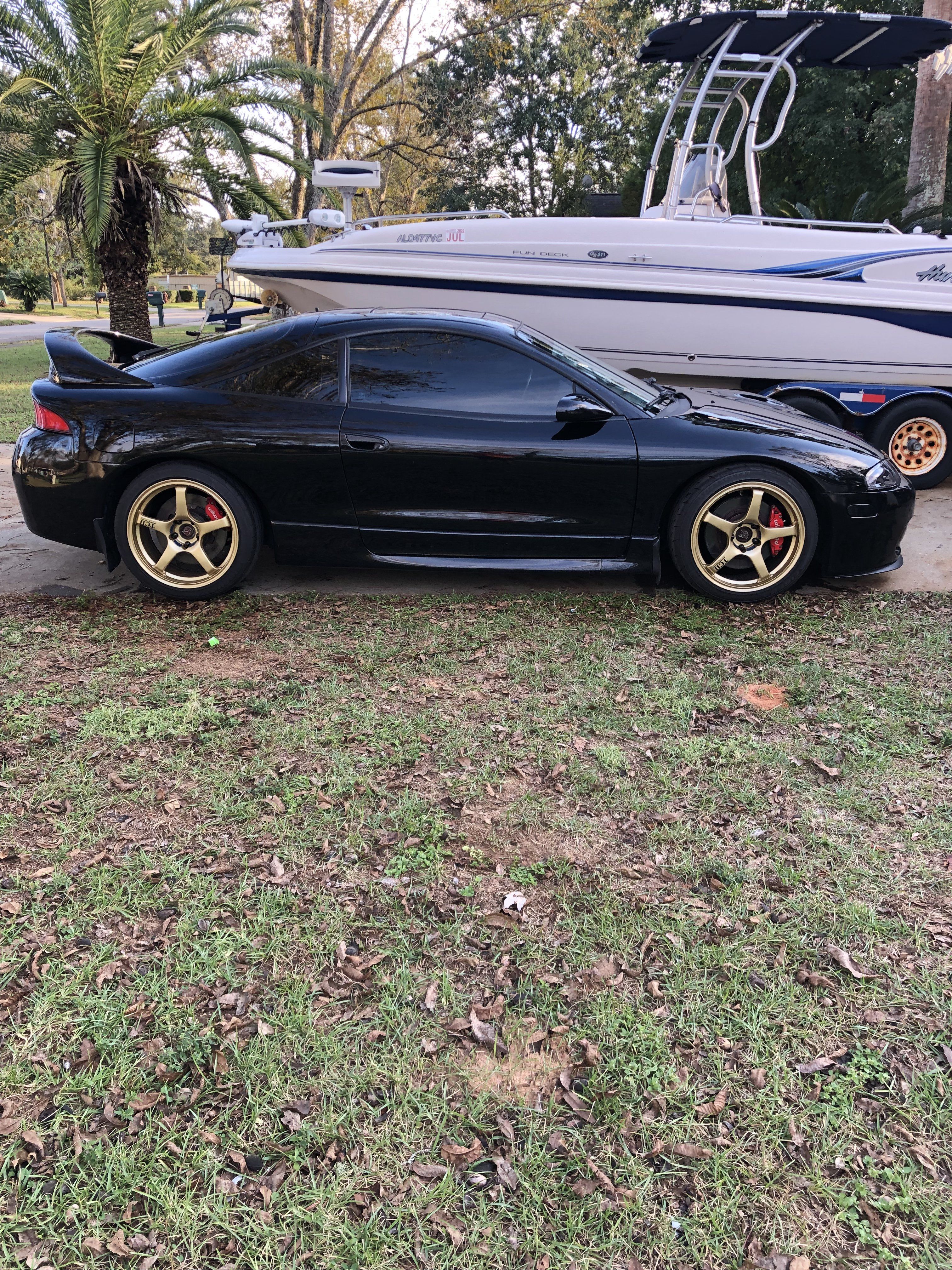

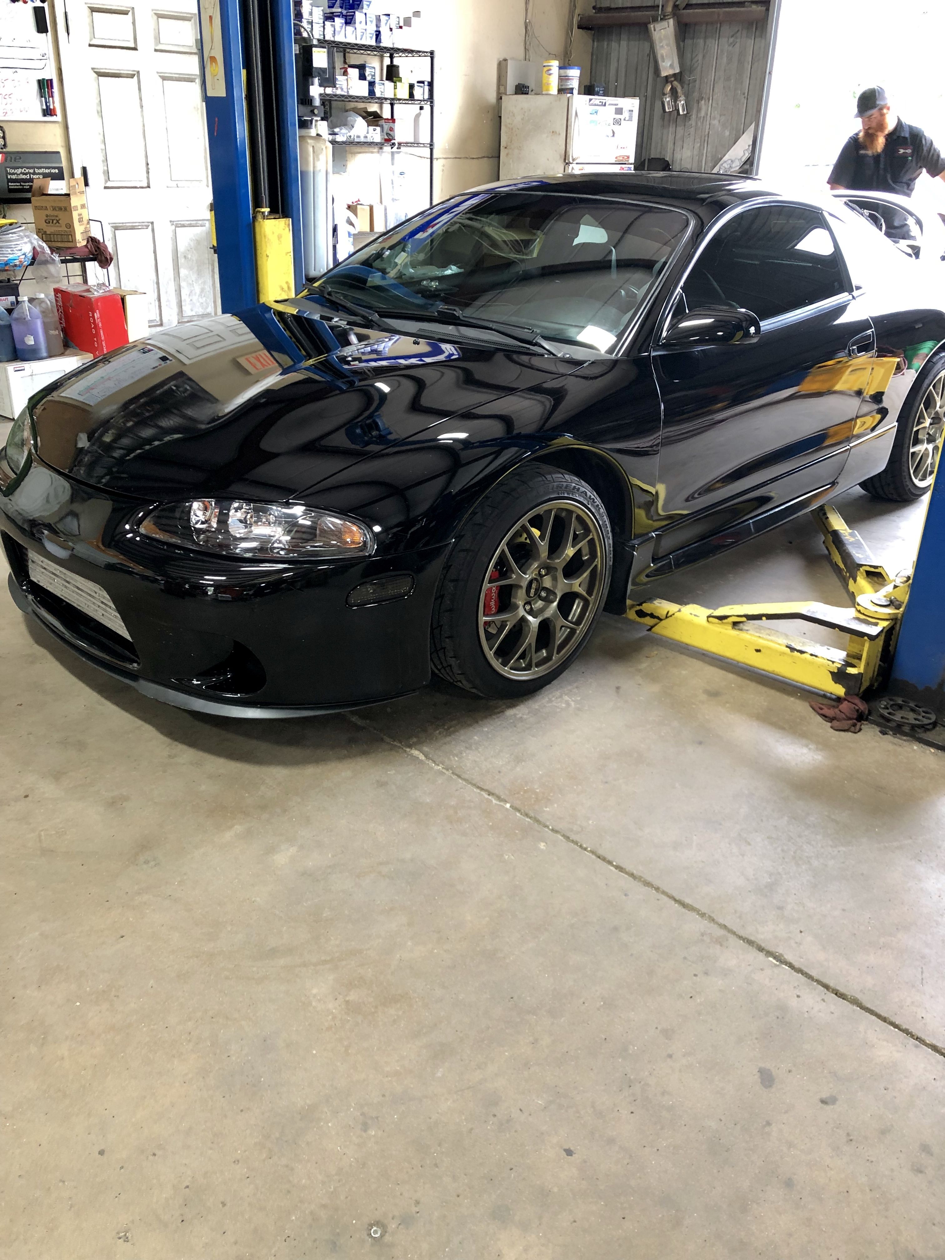

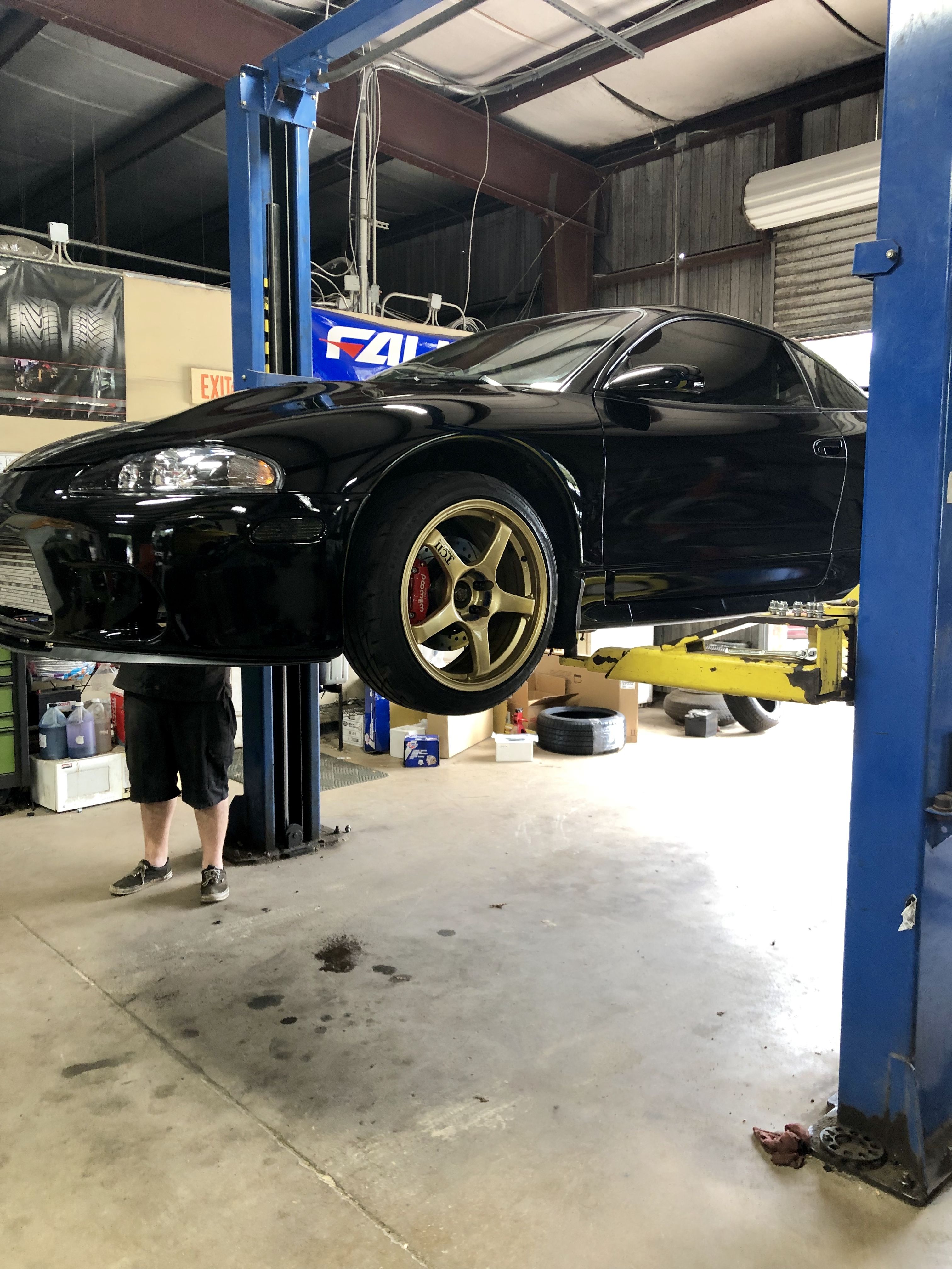

Got around to installing my new Advans. 18x8.5 +31. These are the cored cavity versions meaning the spokes are hollow, allowing these to be super light while being cast. Fitment was spot on with 235/40/18 Firehawks.

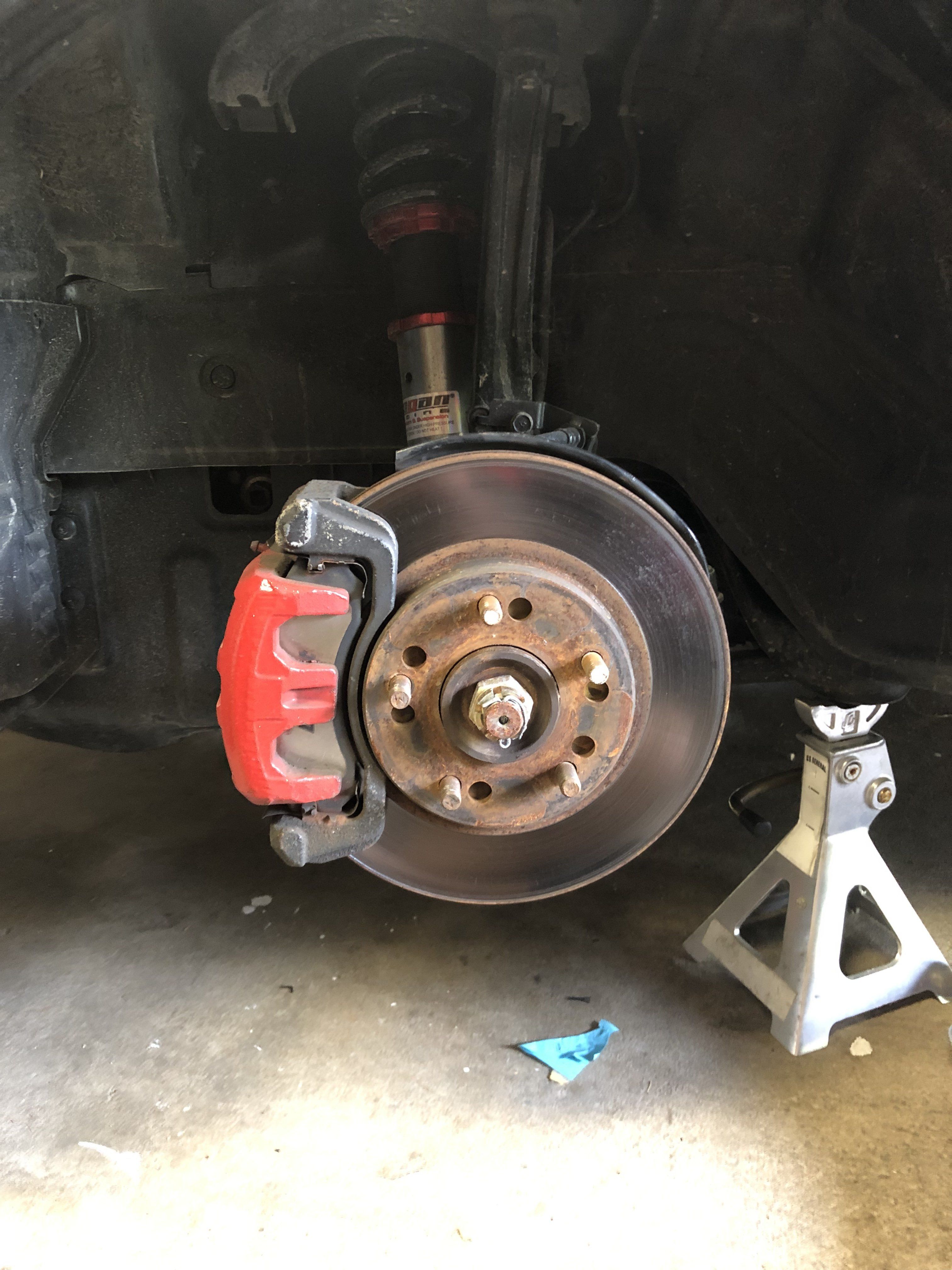

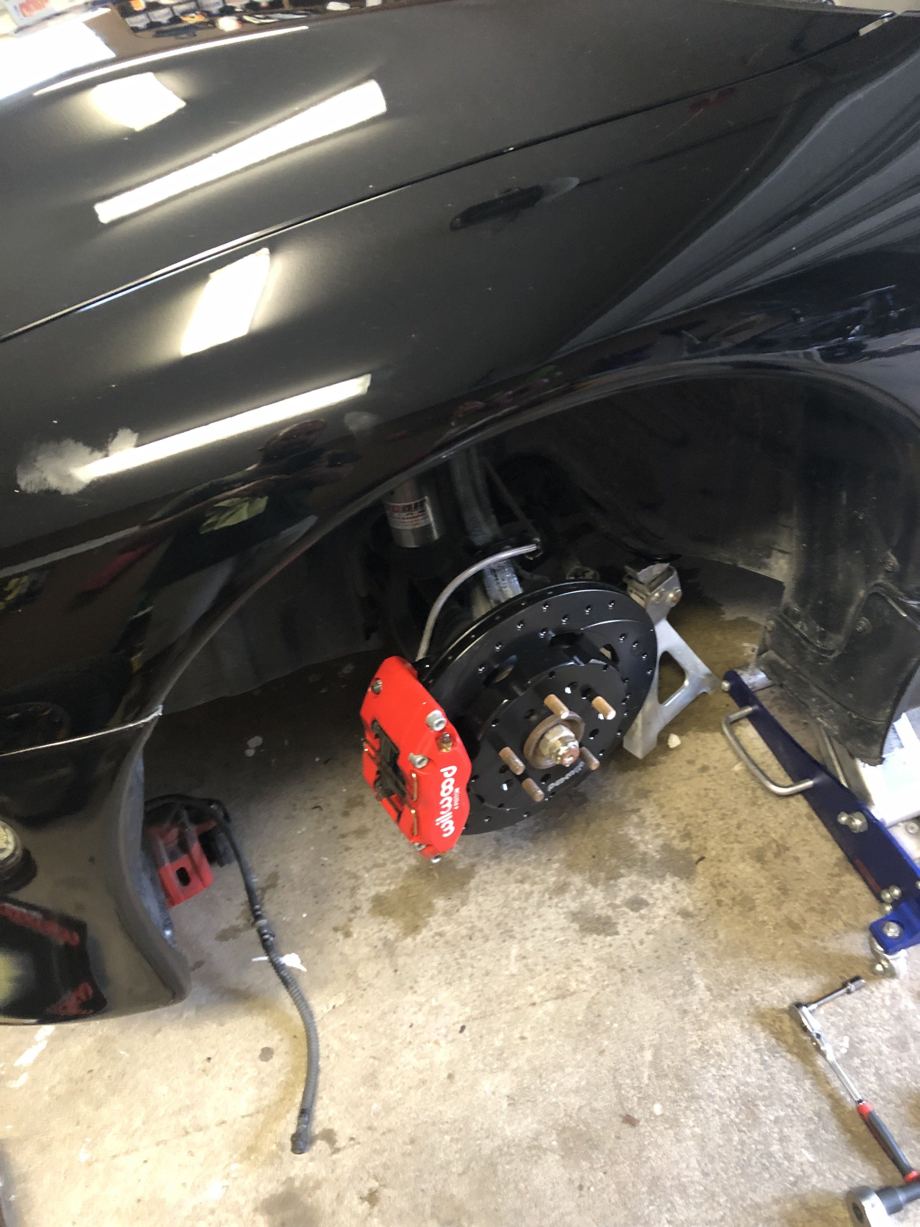

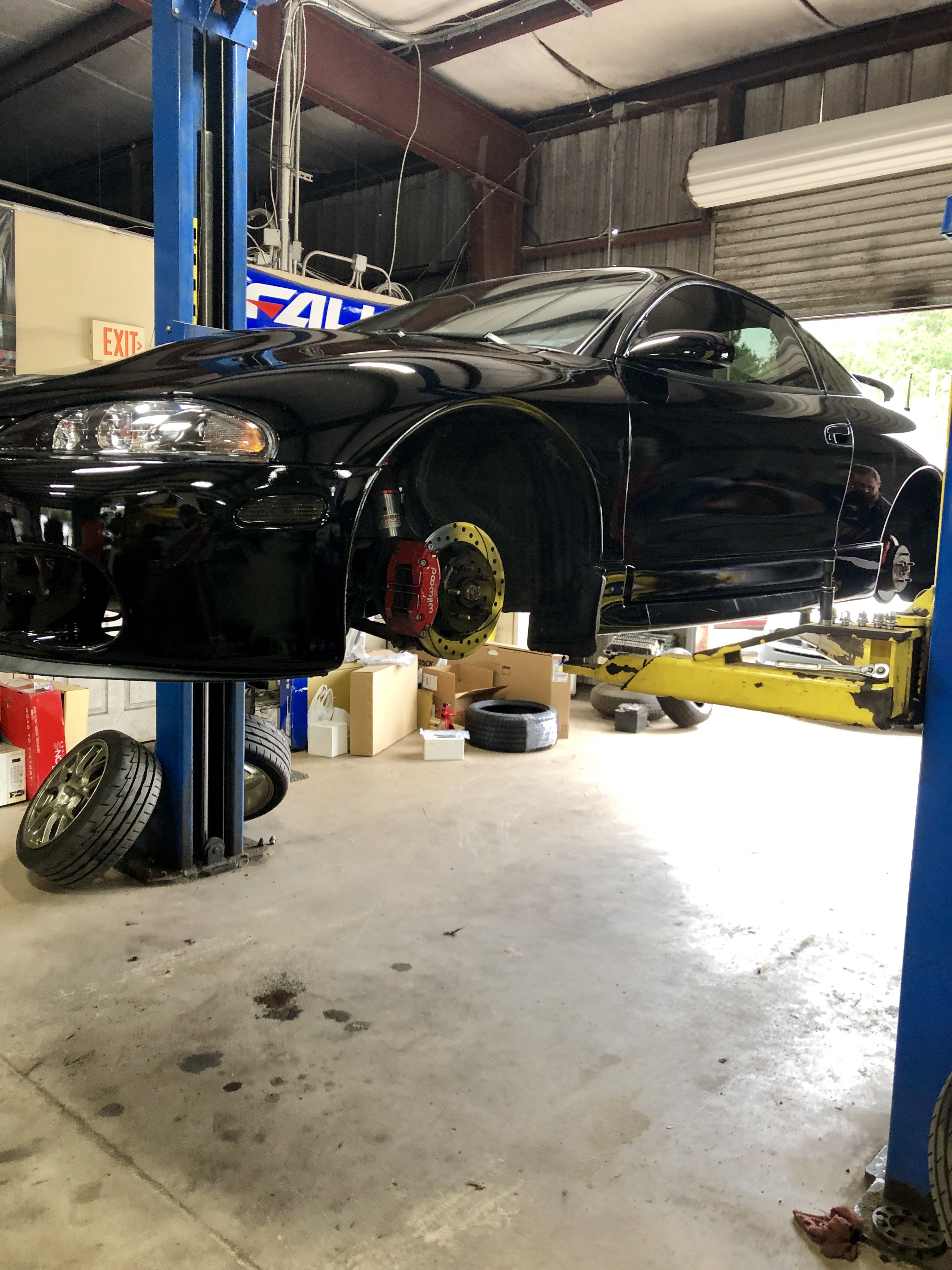

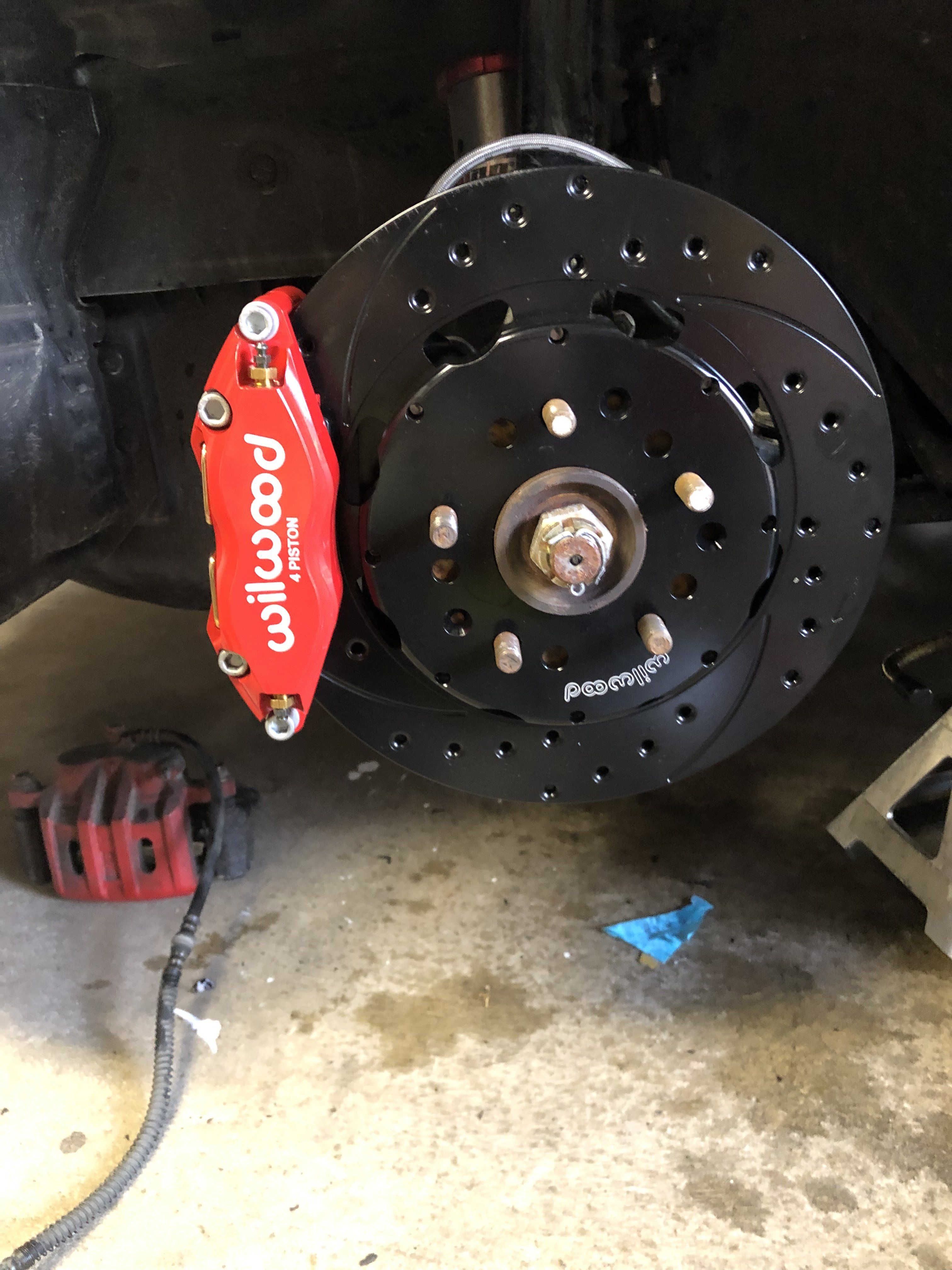

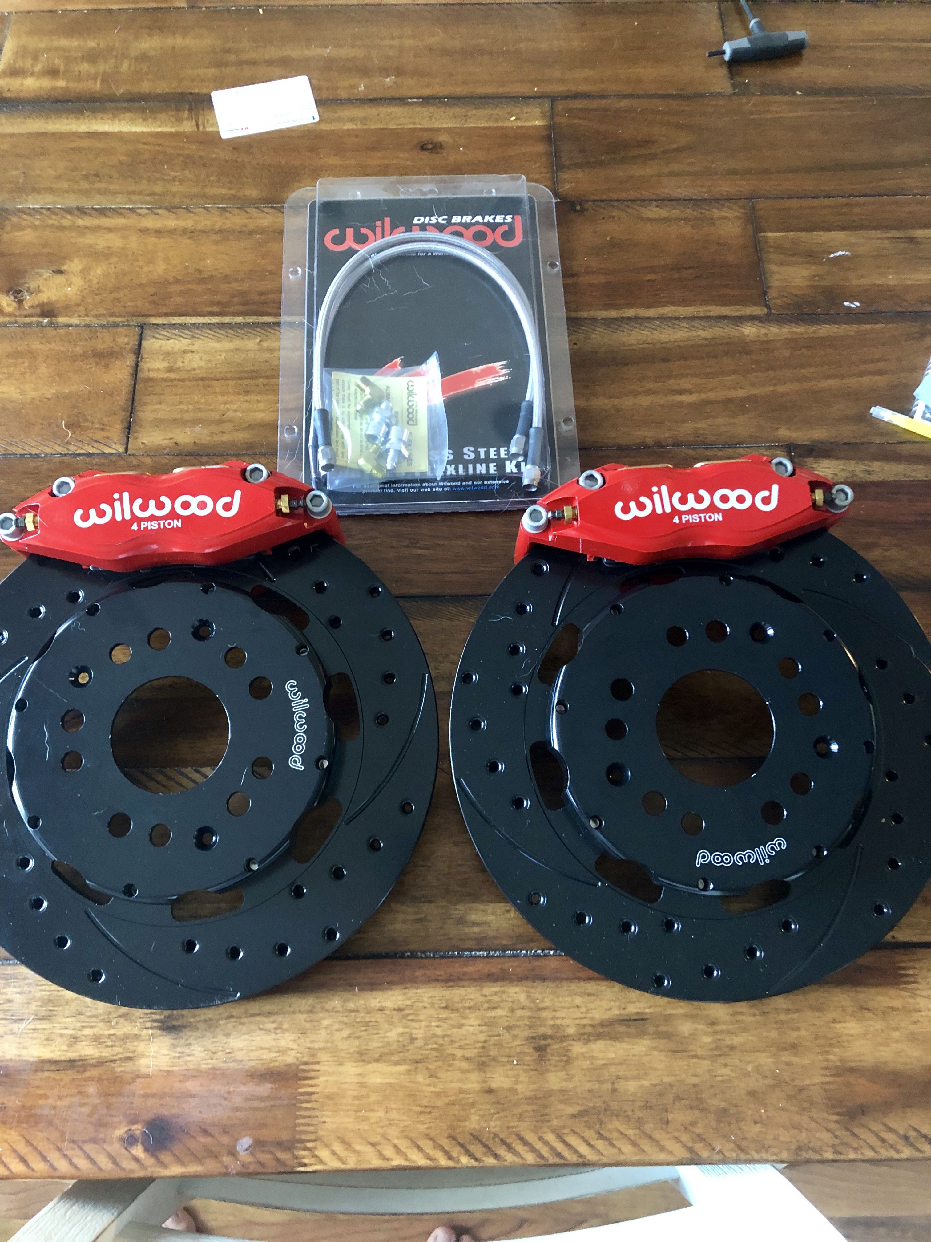

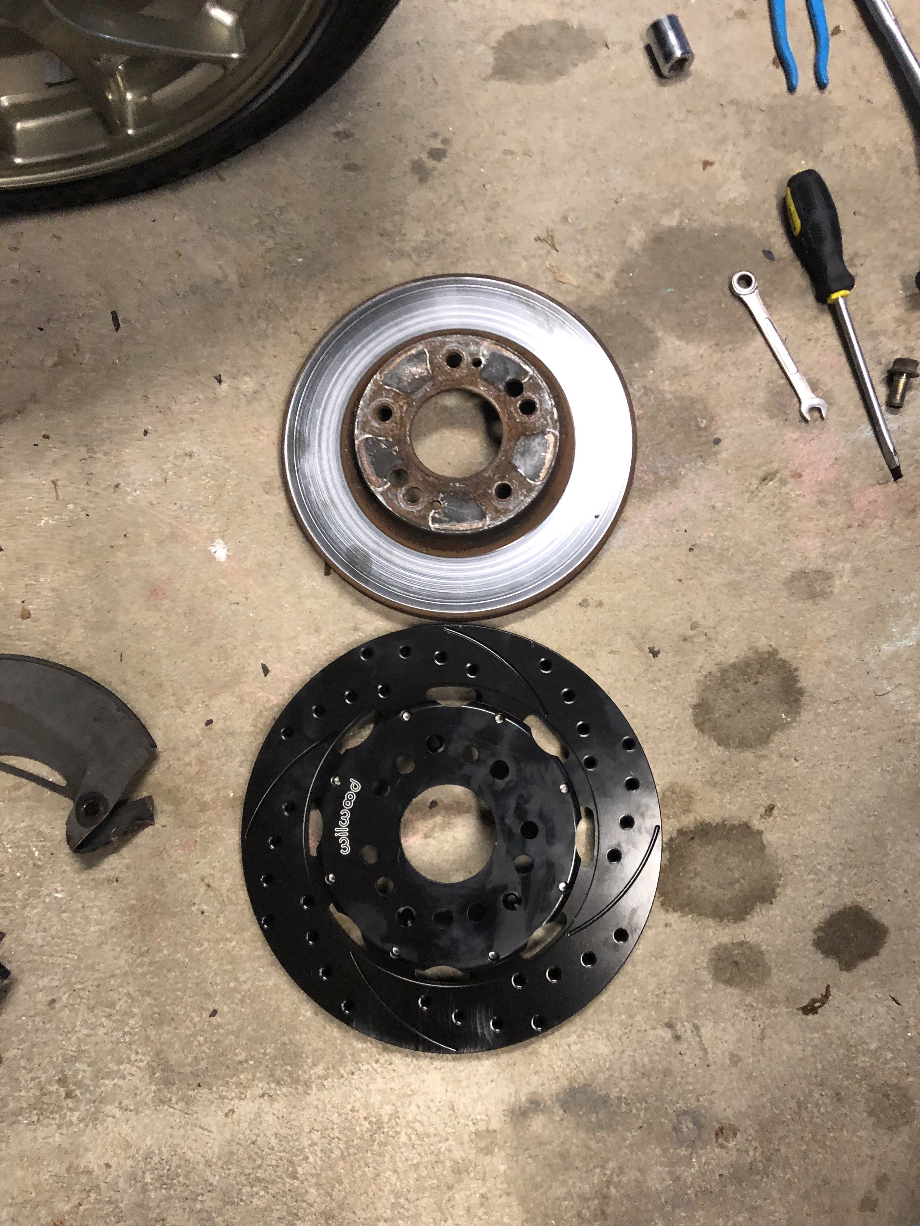

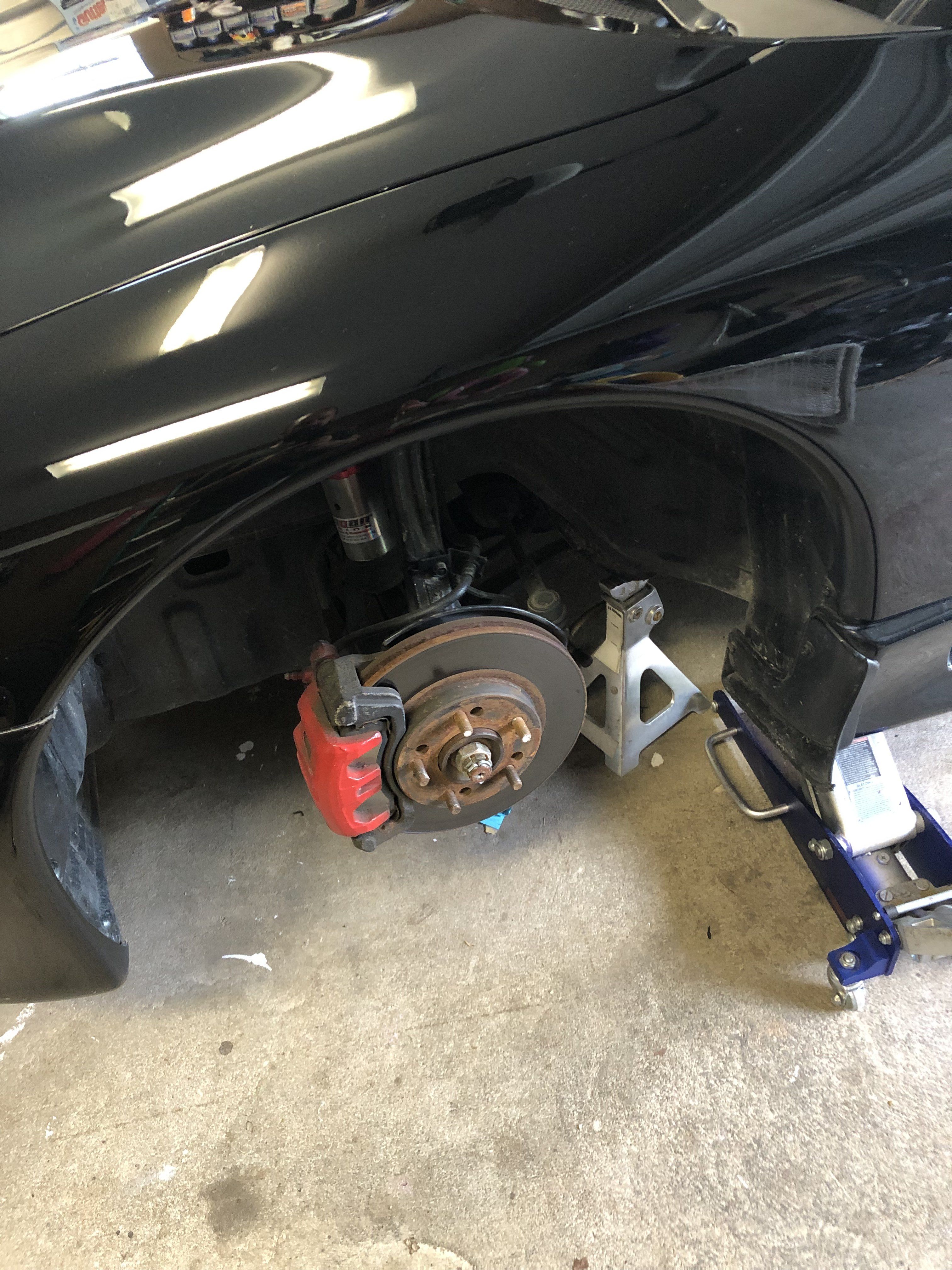

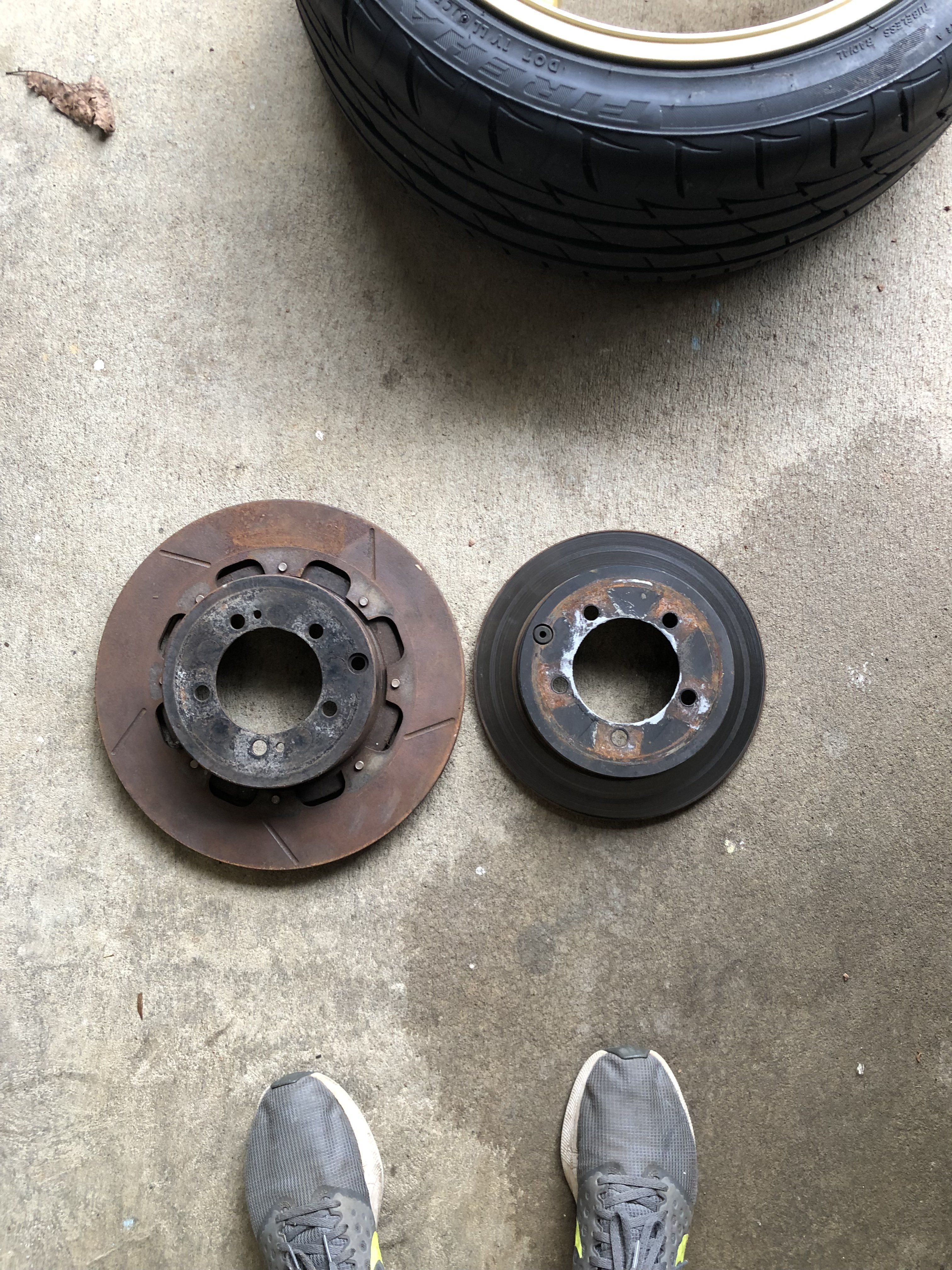

I decided my 12” Wilwood BBK wasn’t enough with the new wheels and came across a used TCE Wilwood front and rear kit. These are 13” rotors front and rear with 6-piston and 4-piston calipers. They filled the wheels much better. And it stops pretty good.
