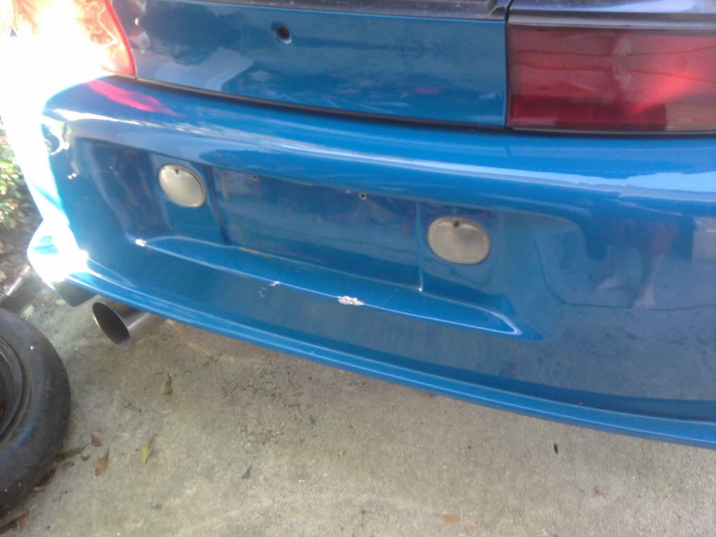

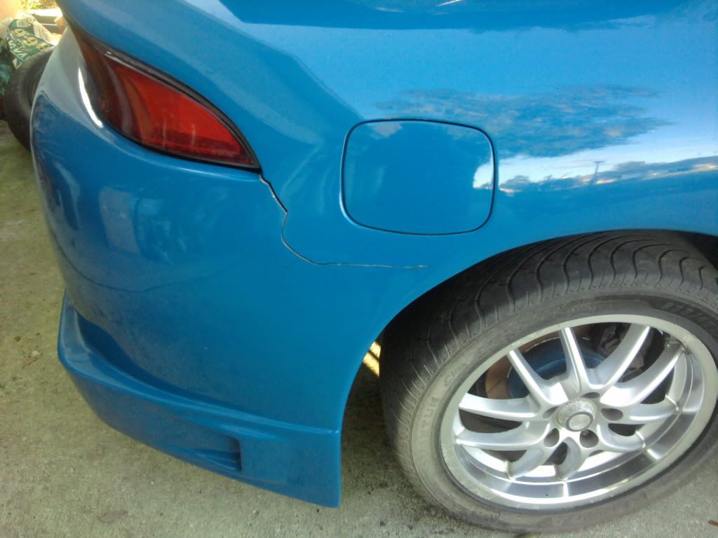

As to the bodykit... It needs MASSIVE amounts of work i think... I am no bodyman however. Rear bumper has some chips, dings, and spiderwebbing and where it was molded into/onto the rear quarter panel cracked bad.

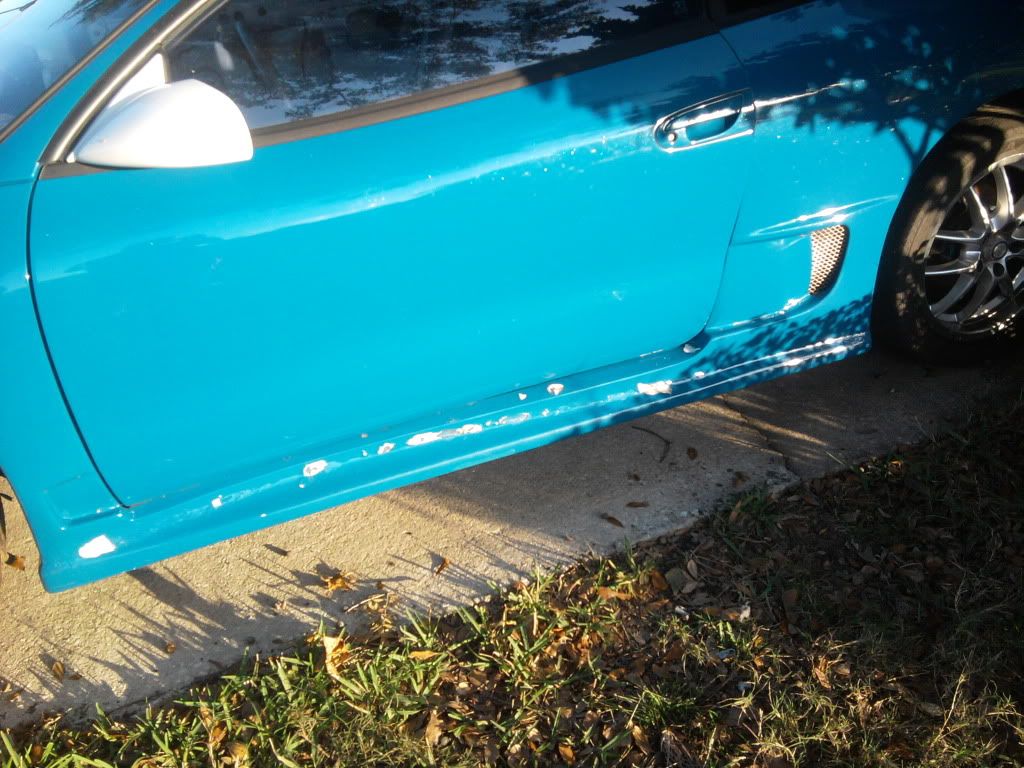

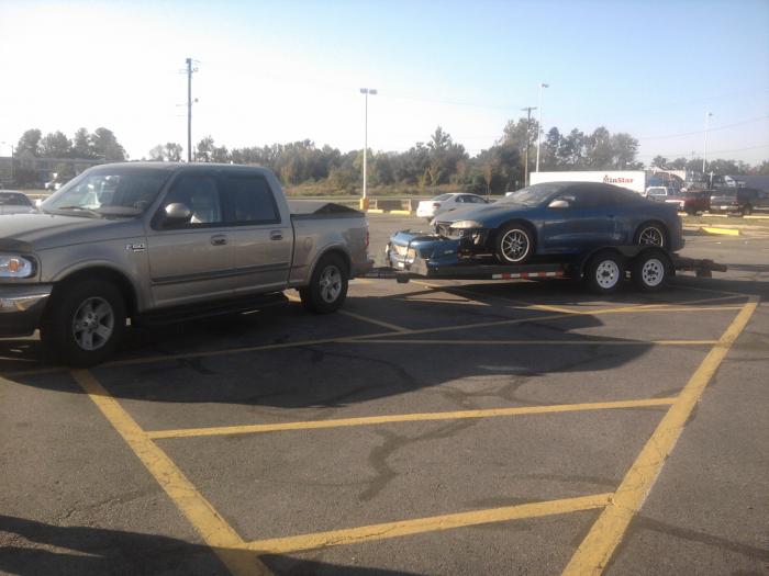

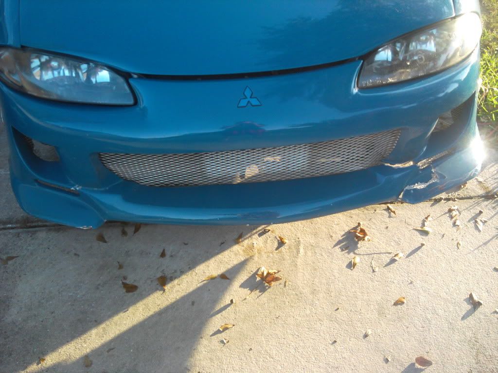

The front bumper has real bad cracks (one of my not so smart moves, when I was loading her onto a trailer for the first time, I didn't remove the front bumper cover, so the trailer ate it). Also, whoever painted the car, did not use the appropriate primer or prep or something, because the sideskirts are flaking and chipping so badly, if i catch ANYTHING on an edge of paint it comes right off...
Plans- I will change the front to a 2gb Front bumper cover, but I like the look of the skirts and rear. So 2gb, bodykit skirts and rear, and I am in search of a 2gb highrise...

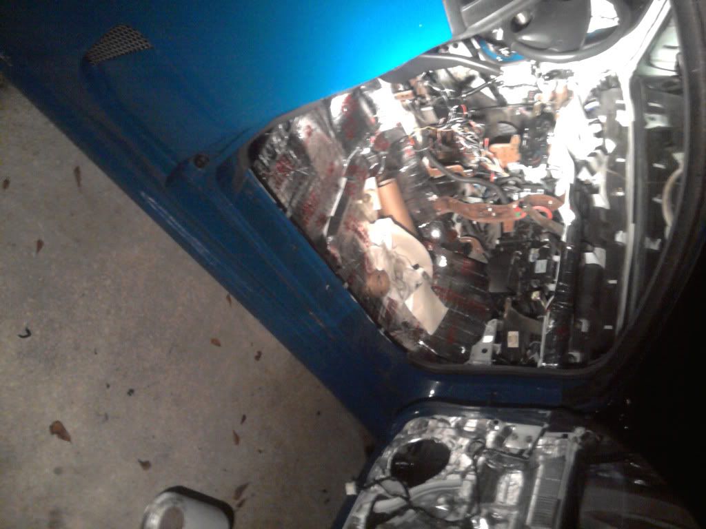

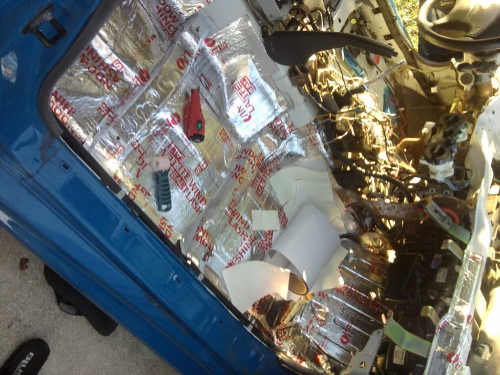

Update: Had a busy day this past Sunday. Started getting busy on the interior. Cleaned out the Harness going to the ECU, Igntion, and just about everything else besides the radio harness so far.
Also began laying deadener on the Passenger side.

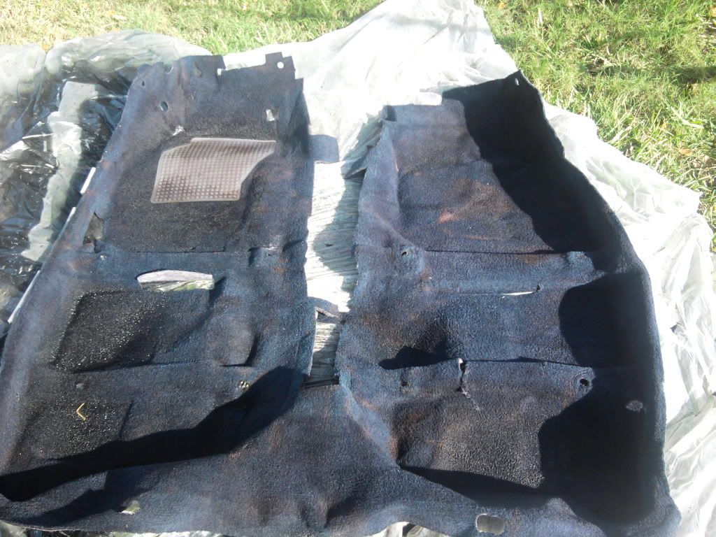

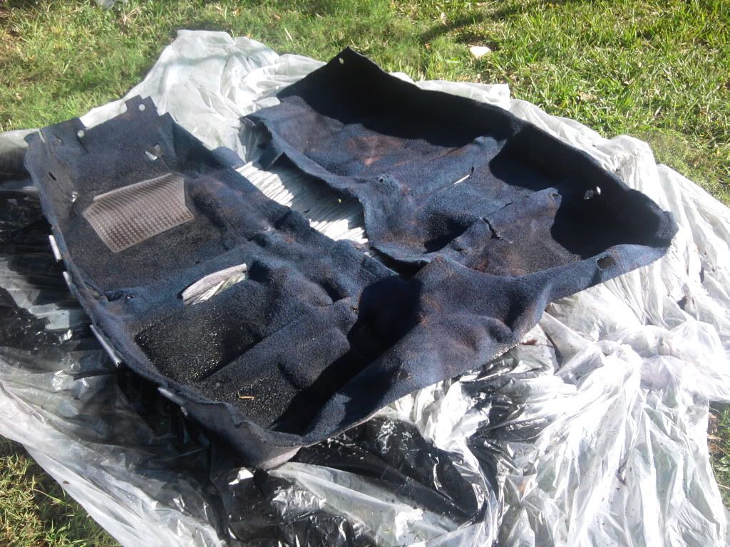

Also spent 1.5 hours cleaning the DISGUSTING carpet. 1 and a half cans of Tuff Stuff from Wal-mart, a stiff bristle scrub brush, plenty of rags/towels, and a pressure nozzle on the hose and she looks MUCH better... Some stains remain though..
But that is okay. Now it is in this bucket.

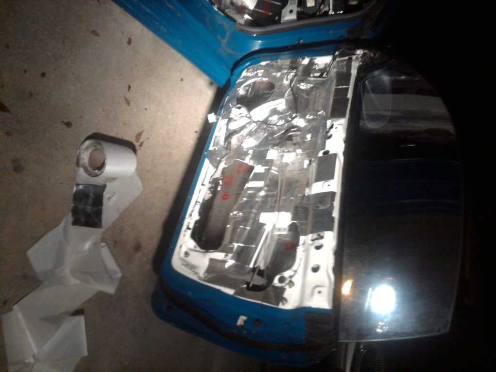

Also I started customizing the interior further. Disassembled Door panels, Wetsanded them with 600 grit. Washed again with soapywater. Washed again with 91% rubbing alcohol. Placed in sun for 45 minutes, and they have been treated to 5 light coats of Krylon for plastic.
Well, That's all I got done on Sunday. Have the day off, so more getting done today. Sorry that some of the pics are so dark. It was getting dark as I remembered to take pics for updates/ posterity. Expect an update between this evening and Thursday Morningish!
Had a busy day Yesterday. Pulled the Carpet out of the Dye bath. I think I need to double up on the Dye, and I have some spots that didn't take dye so well...

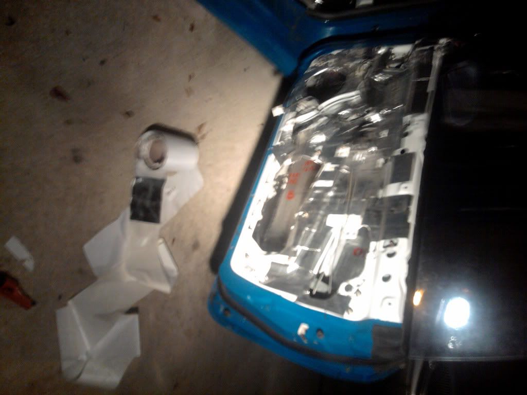

Also got more done on the dampening. The are now 2-3 layers on the passenger floorboards. sounds solid. Also, Added more to the door. There already was 1 layer of dynamat xtreme on the outer doorskin. So i added more on top of it, and started on the inner doorskin. When closing the door, there is now a solid *WHUMP* sound... still not done with it yet though.
