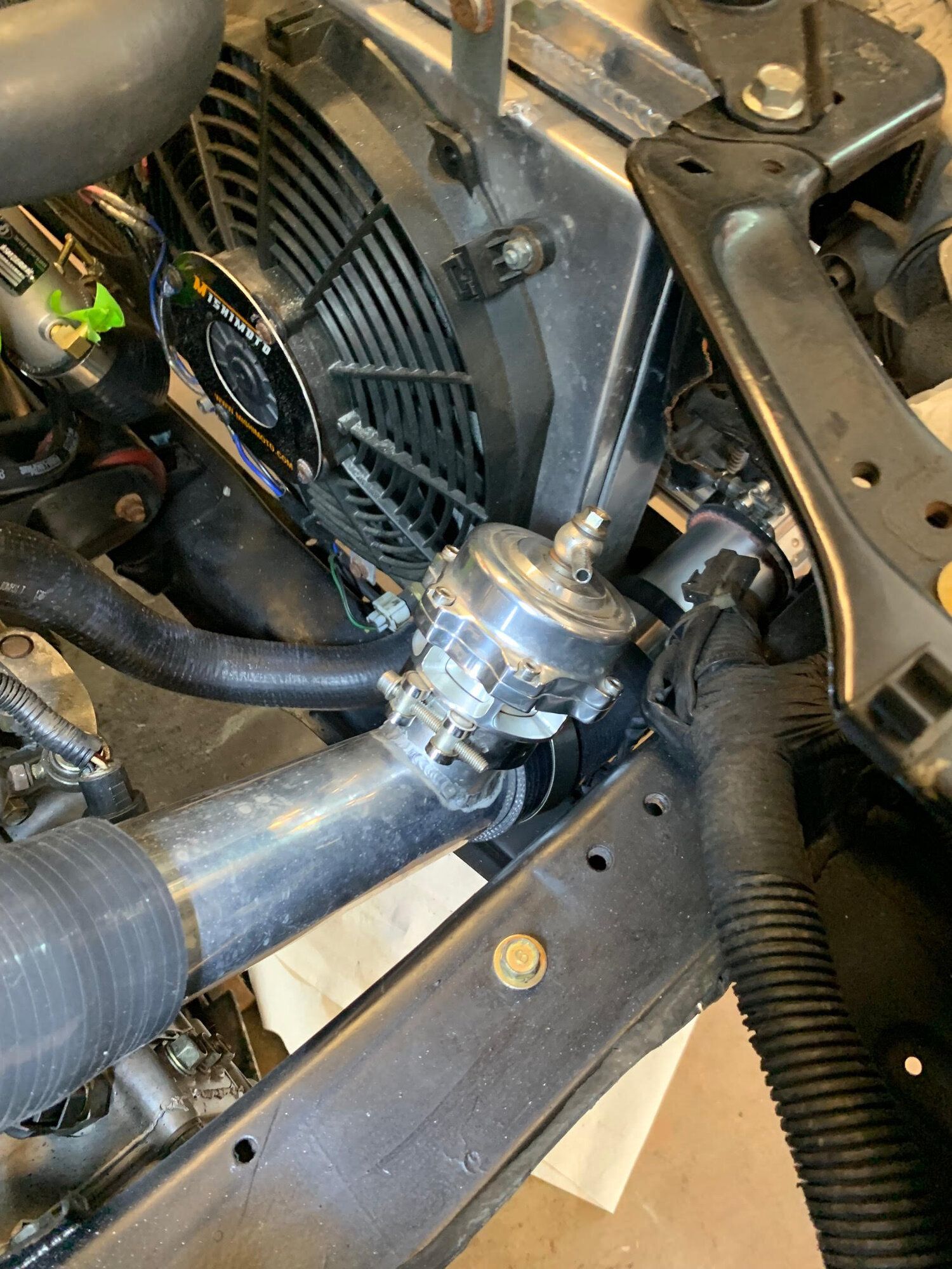

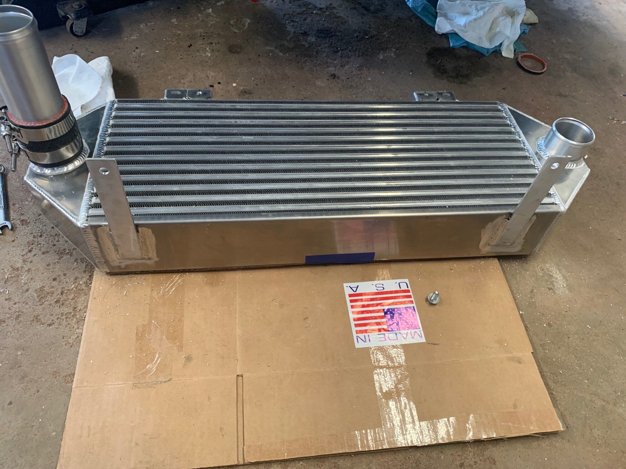

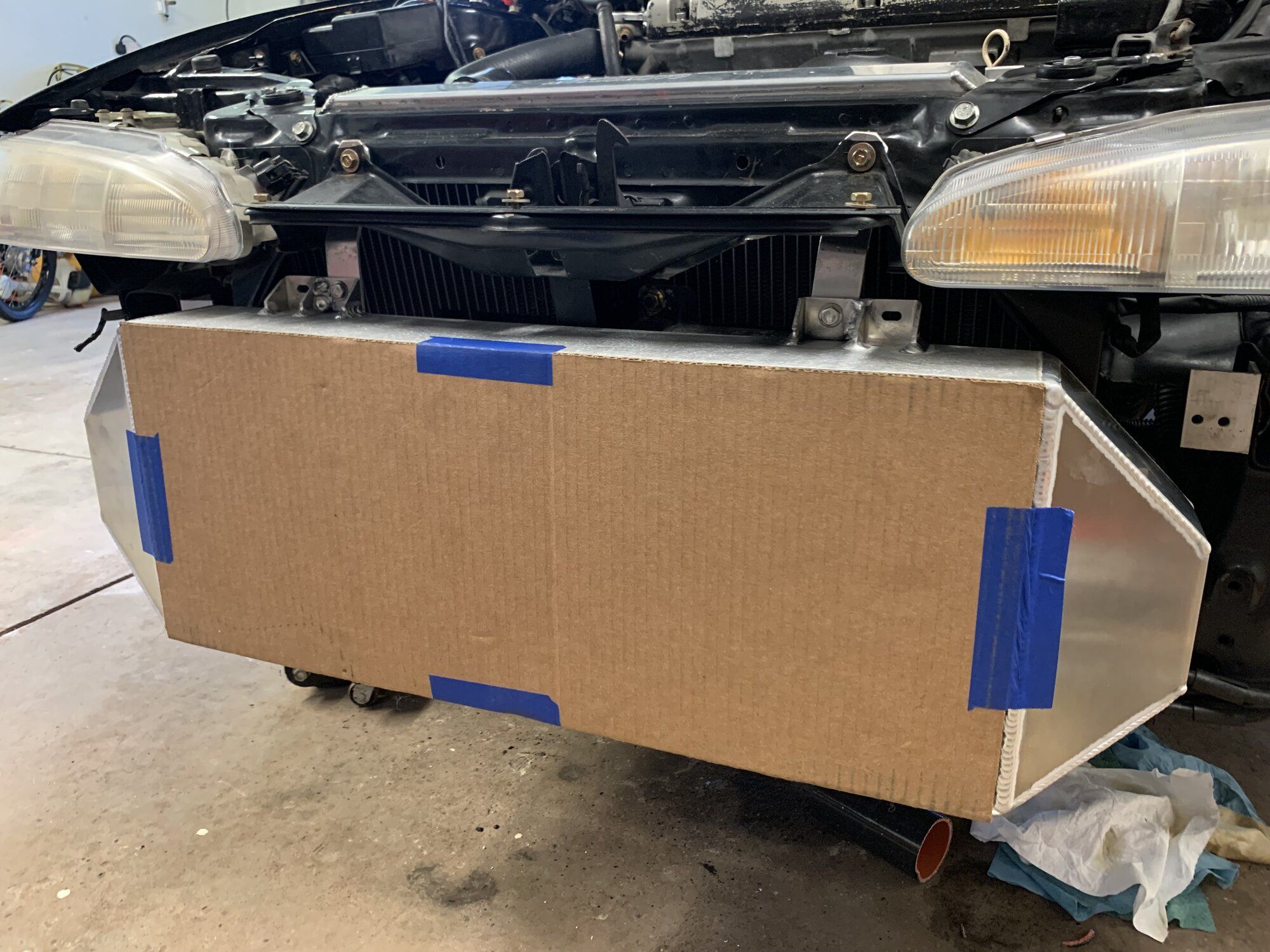

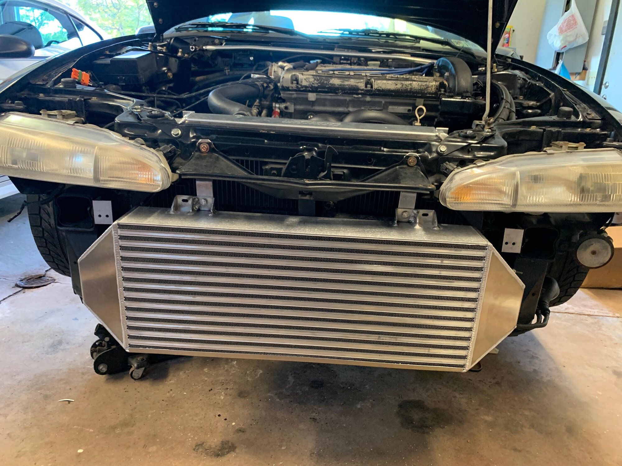

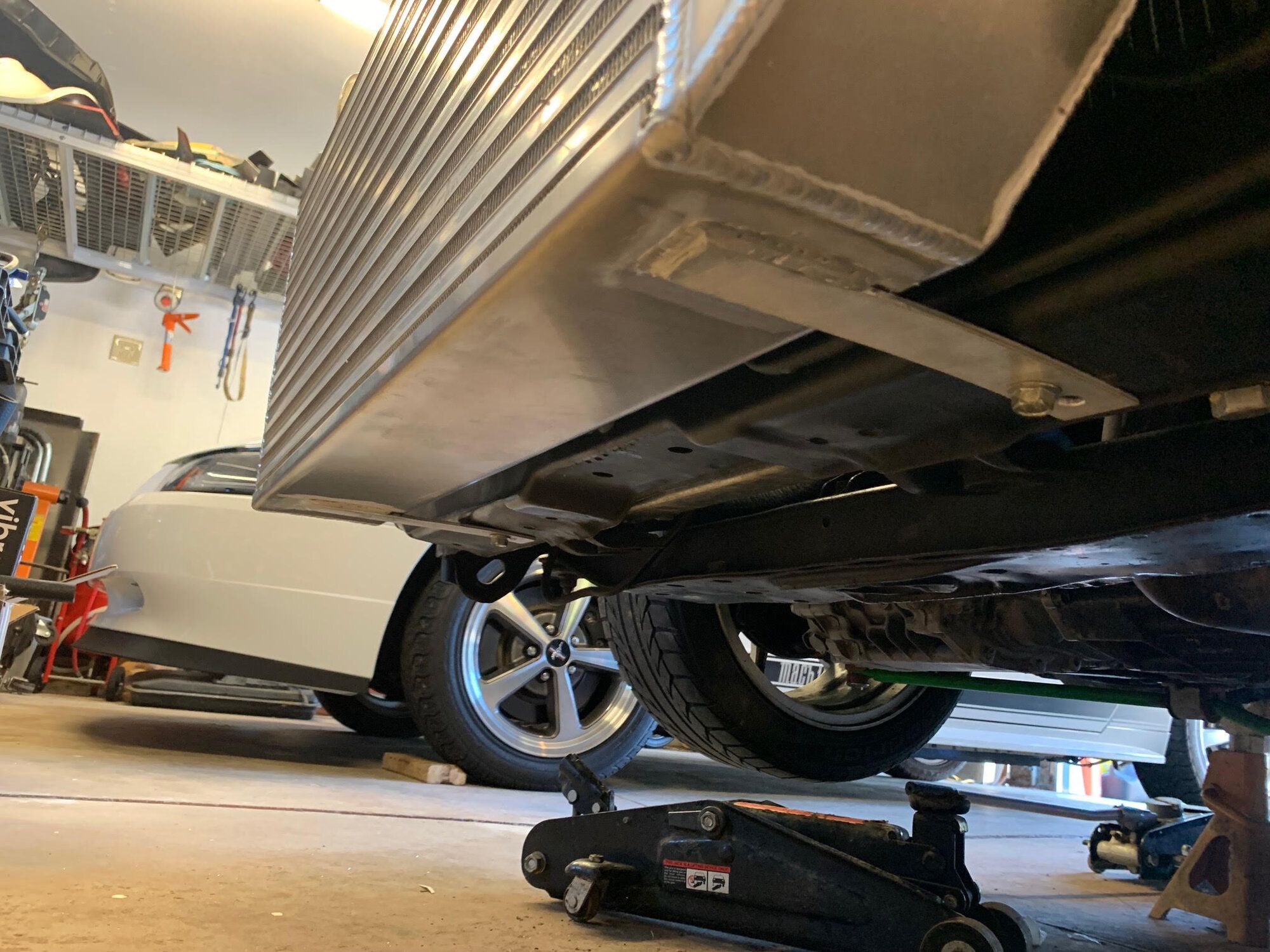

I also got tired of waiting for ETS to take care of my FMIC so I had secondary tabs welded on so I could jsut get this thing done.

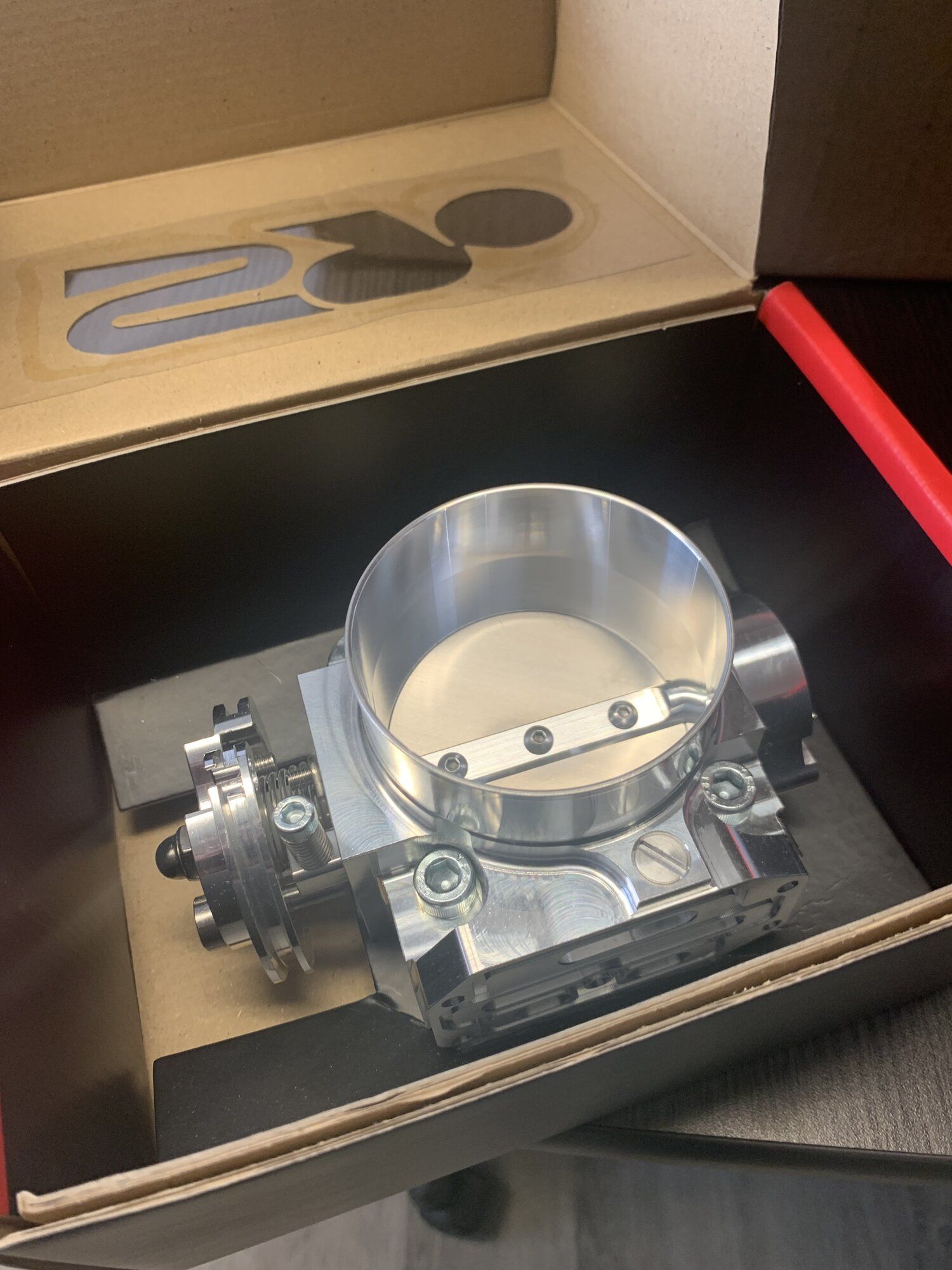

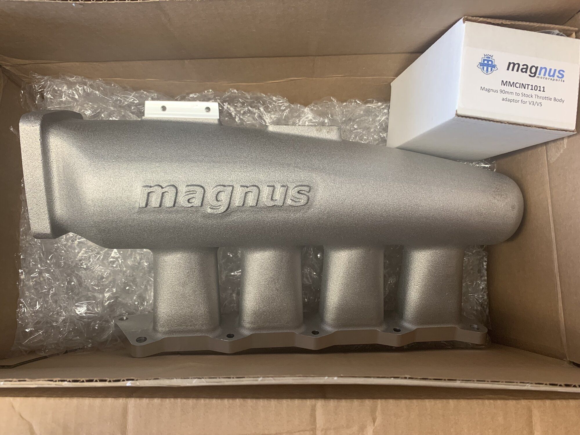

I got inspired at the shootout and I ordered a new Magnus V3 manifold and S90 74mm throttle body today. I also have an FP intake and filter setup coming.

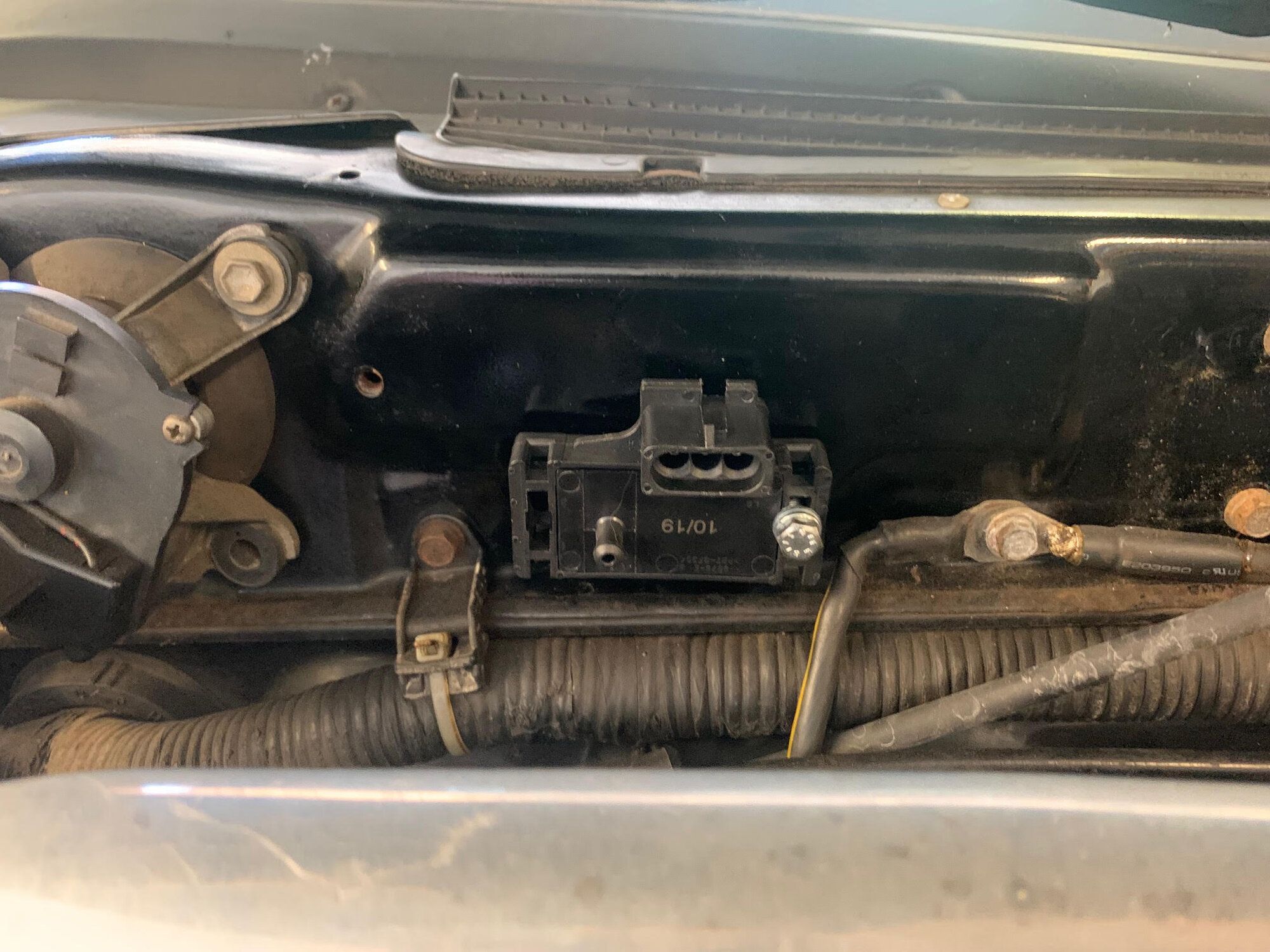

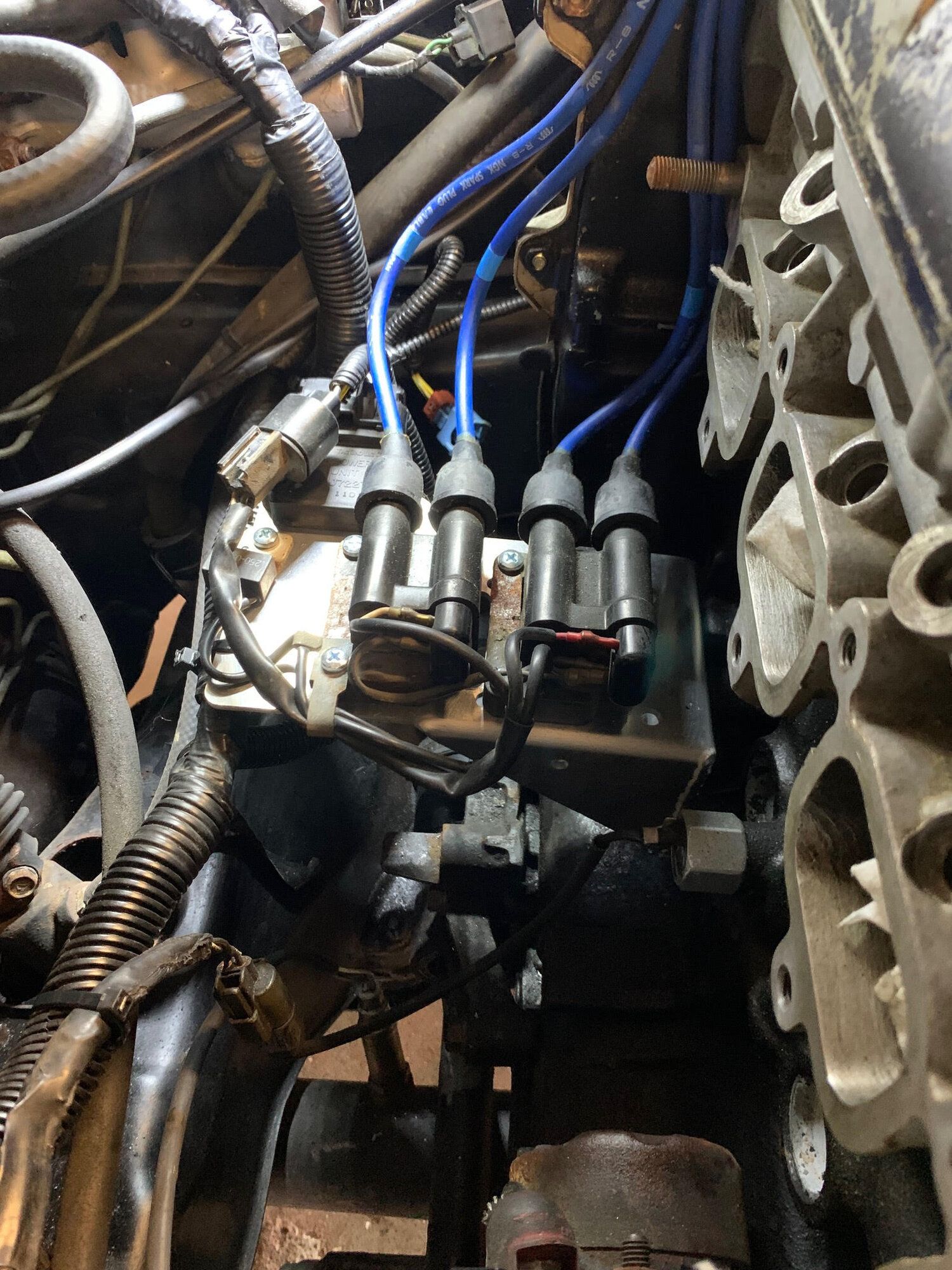

Made some more progress on the car yesterday. I replaced all the radiator and heater hoses with fresh ones. I got the bumper cover trimmed out some more to clear the FMIC. Next I need to put my coil and transistor on the JMF bracket, change the fuel feed line from the filter, install my MAP sensor, install the flex fuel sensor, and replace all the vacuum lines.

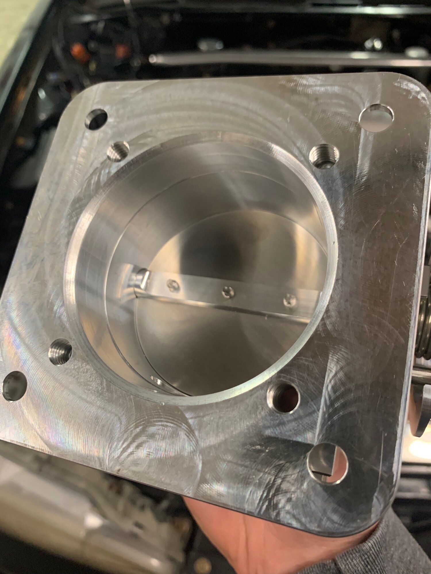

Got my throttle body adapter bored to 74mm to match the throttle body.
Added two bottom straps on the FMIC that tie into the lower radiator support.

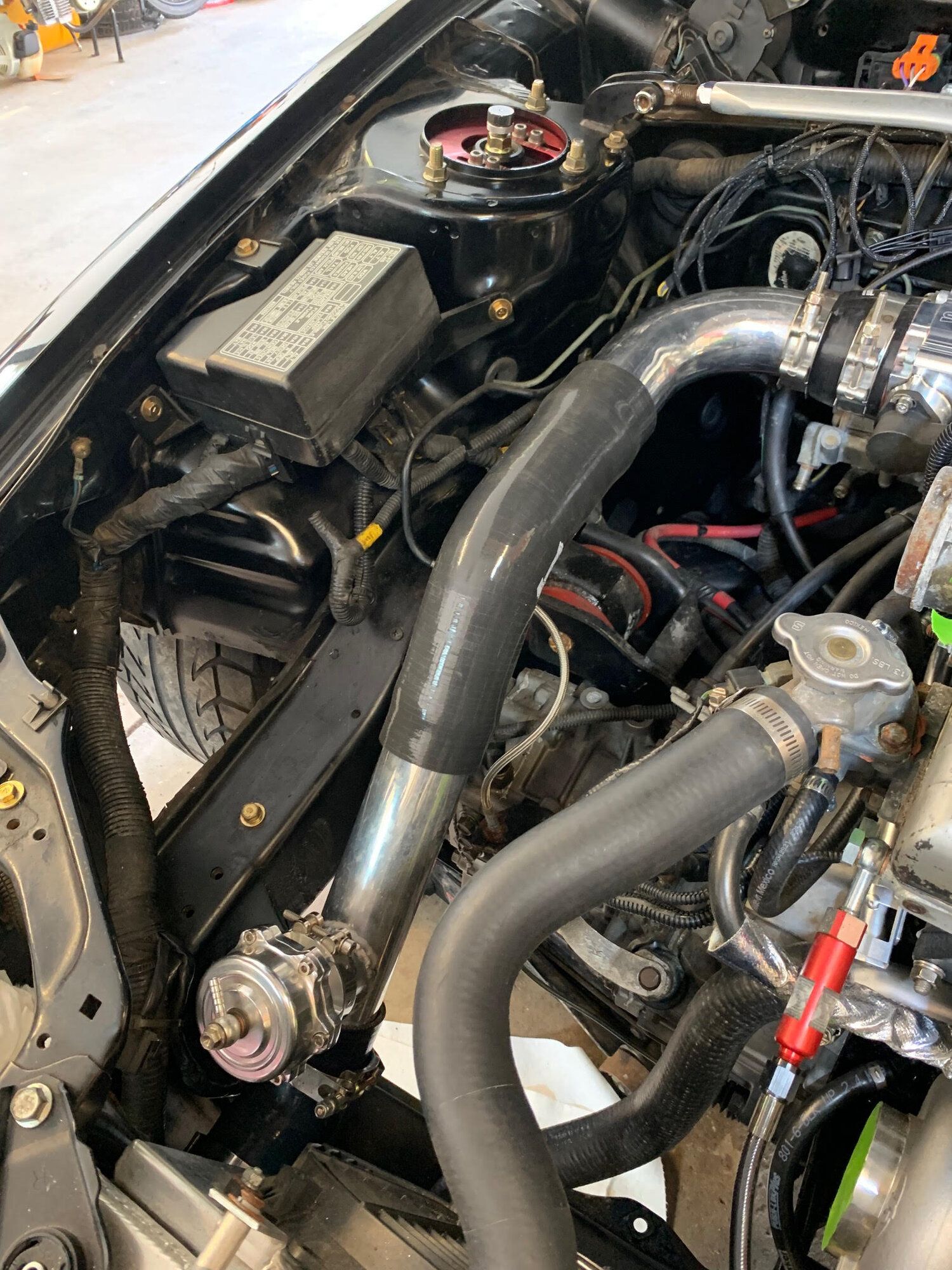

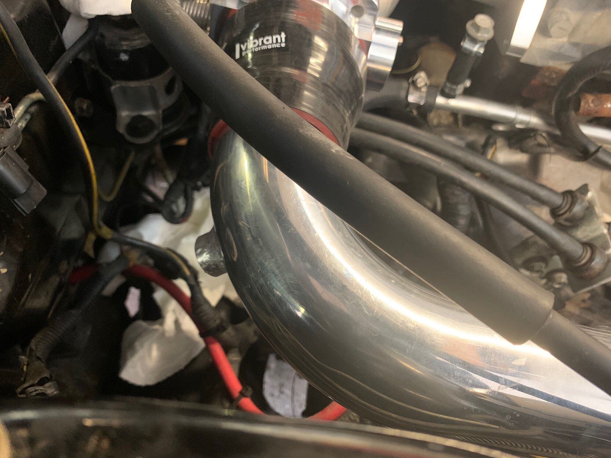

Made a new upper intercooler pipe hard 90 degree with AIT sensor bung.

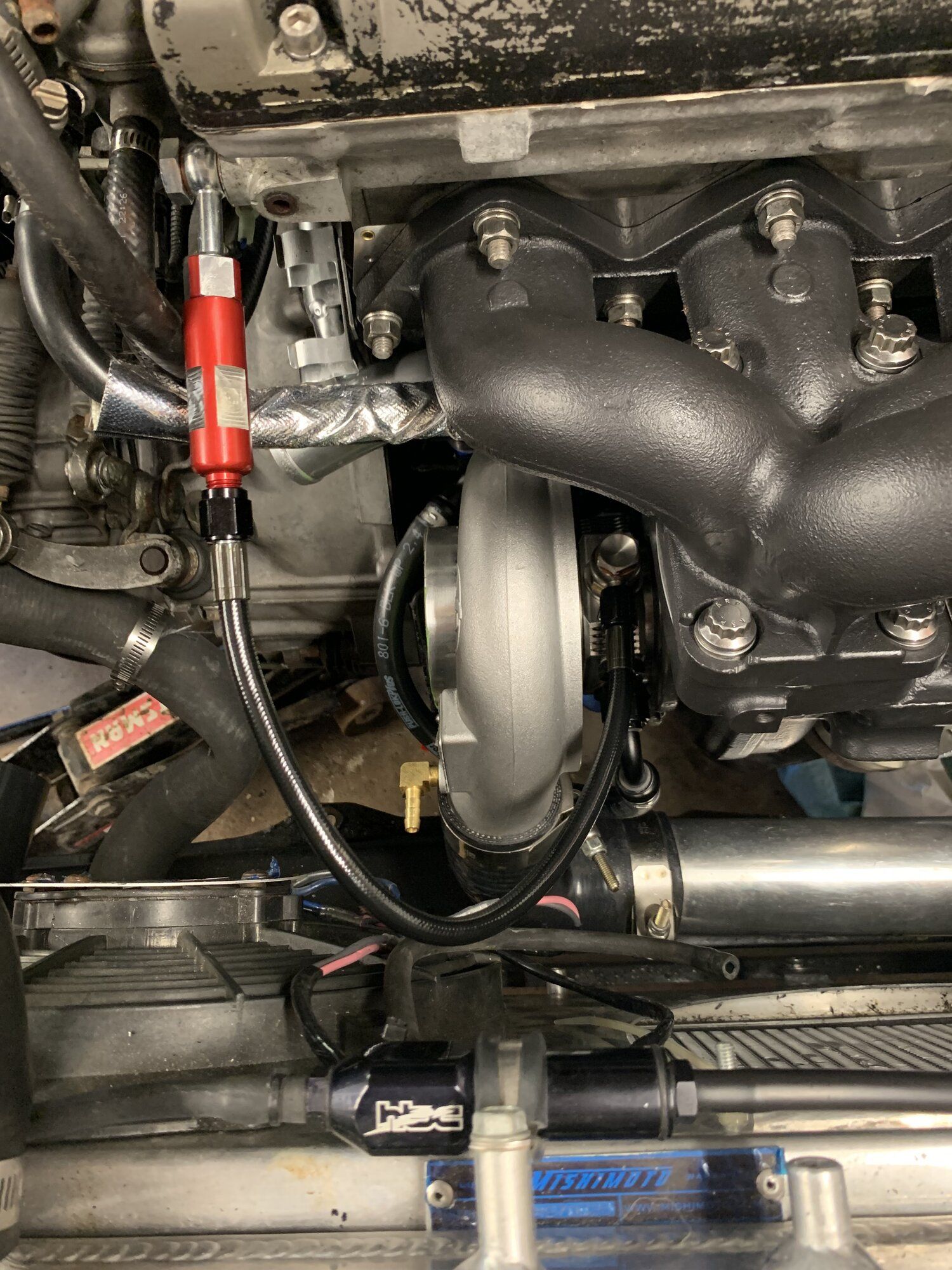

I checked tonight and I have -8 fittings on my cover. I do think most of issues came from a bad drain because this old hybrid 60 trim I had on there was so offset the drain was right through the middle of the motor mount so I had to reverse the fittings and put a 45 on the turbo plus cut the mount just to get it even close to fitting. With the new FP Zero I was able to flip it back around with no issue and have the straight fitting on the turbo. It also doesn't help I'm hitting over 100psi of oil pressure when cold and high rpm. I really need to port the housing, but we will see if I make it that far as I would really like to get to TPG and get tuned by the end of September.

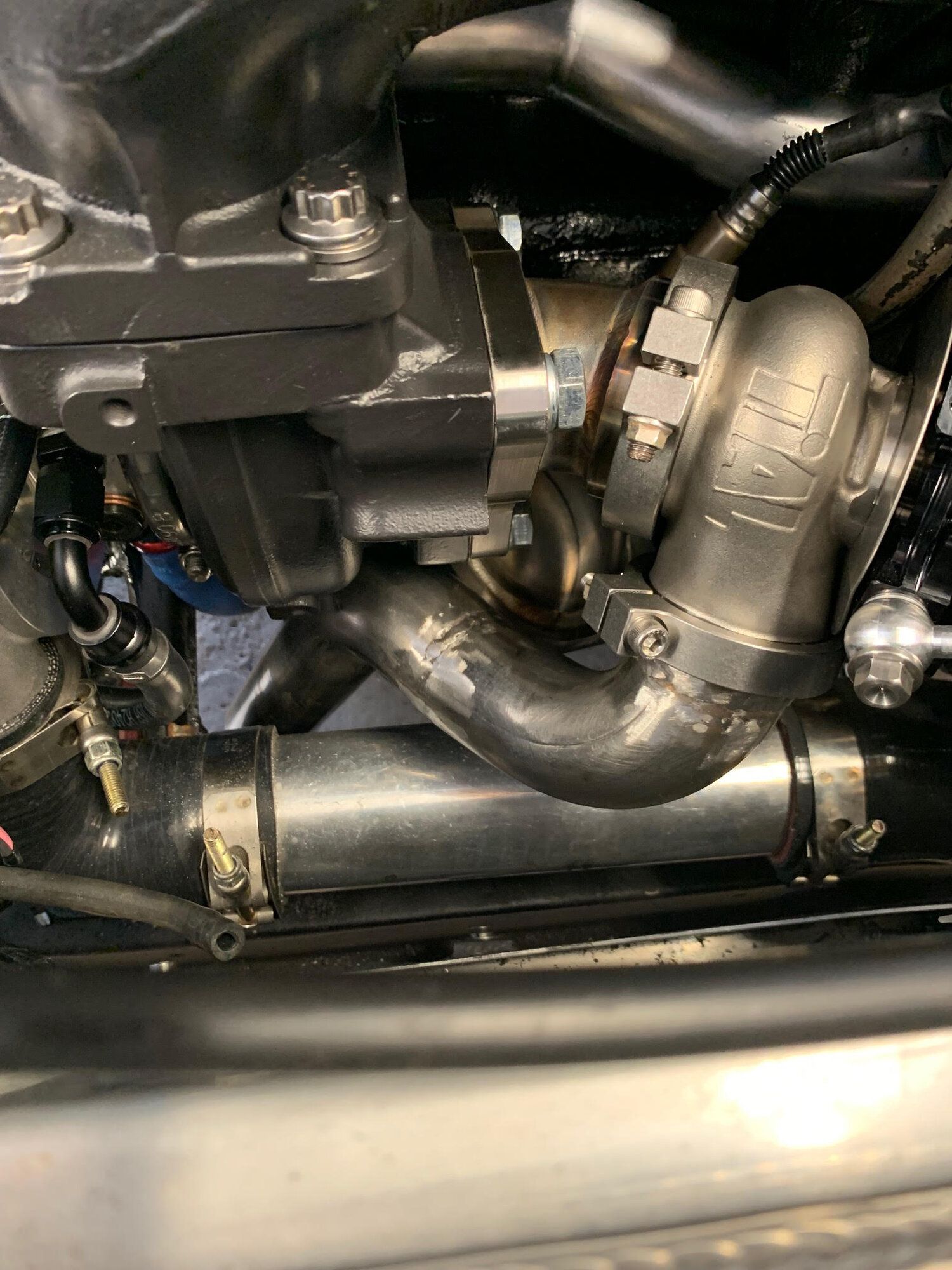

Made my own dump tube yesterday. Full stainless welded with stainless MIG. Not the prettiest thing but it will work. All this welding is really making me want to pick up a TIG setup. It has also given me a new found respect for all the fabricators out there and the level of work they are putting out.

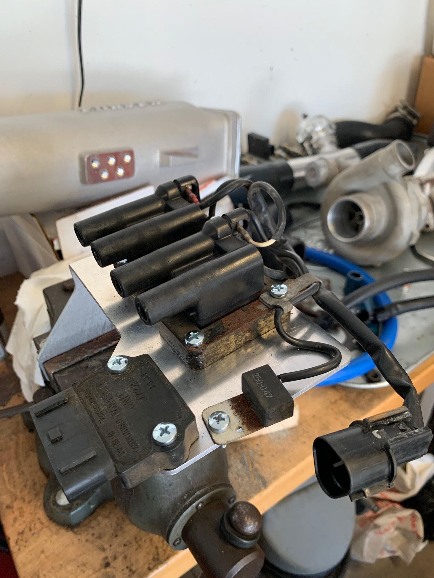

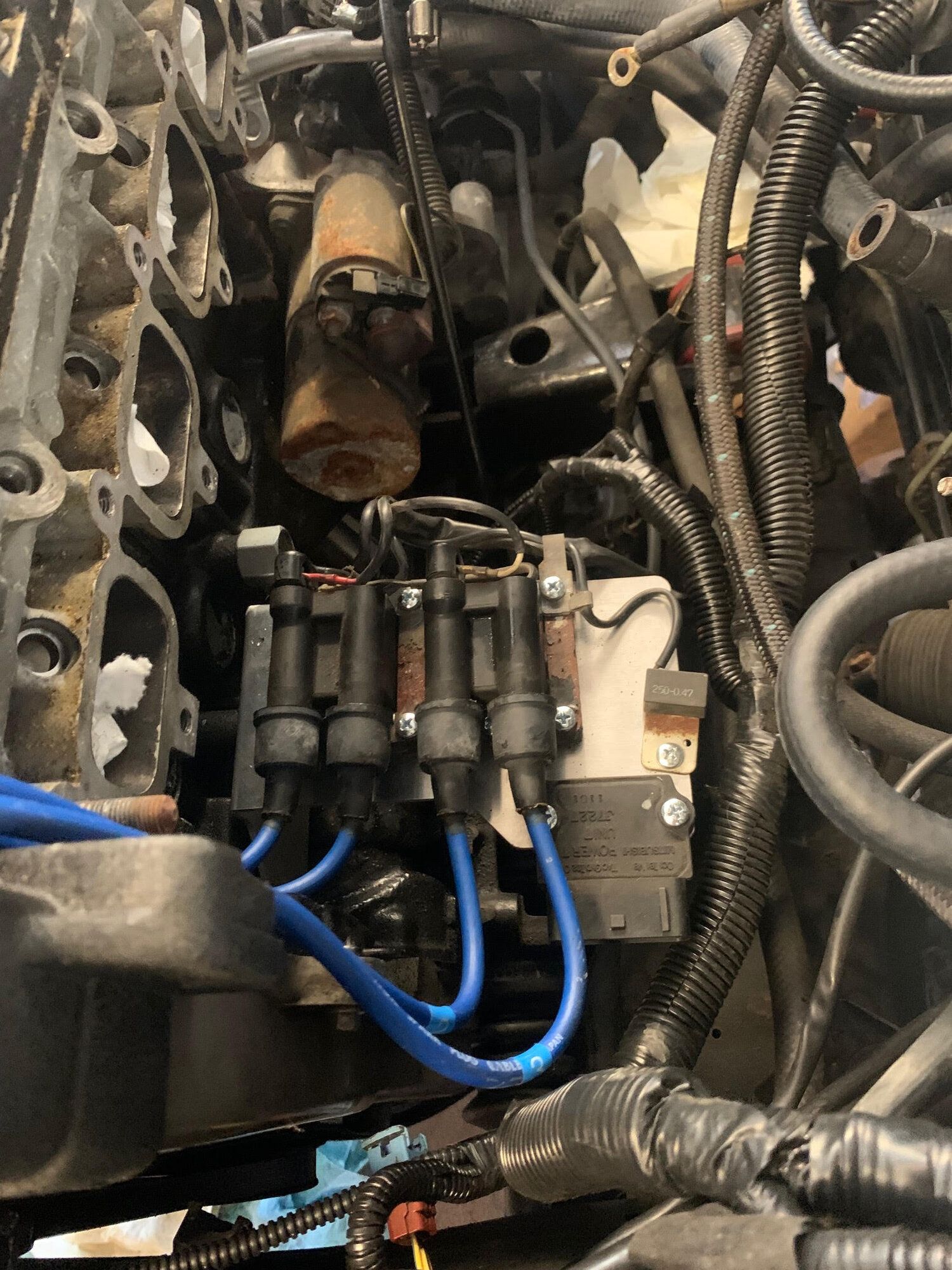

I got my coil pack and ignition module relocated.

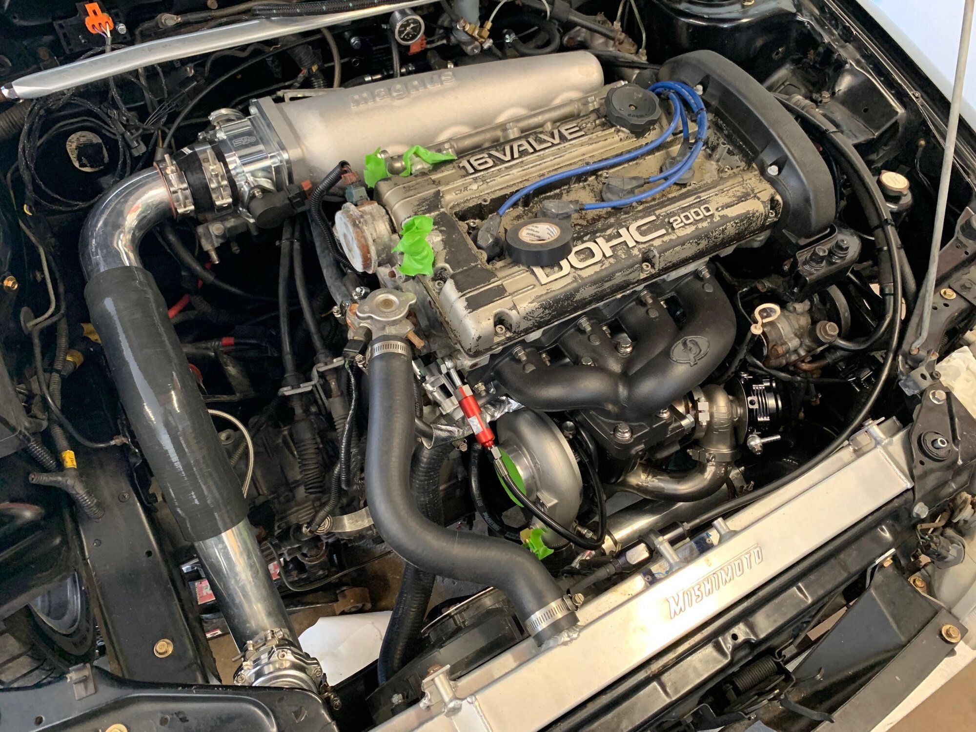

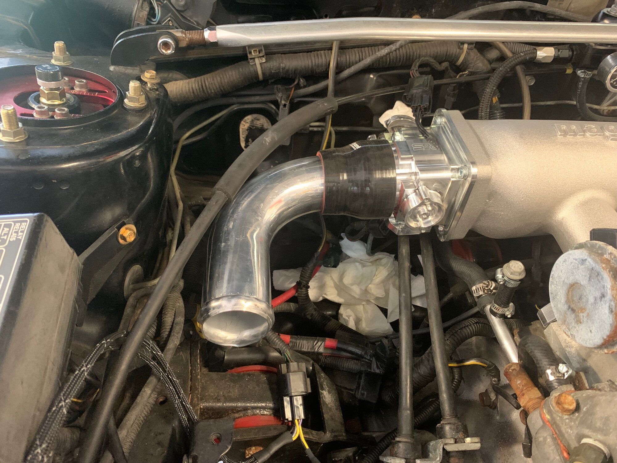

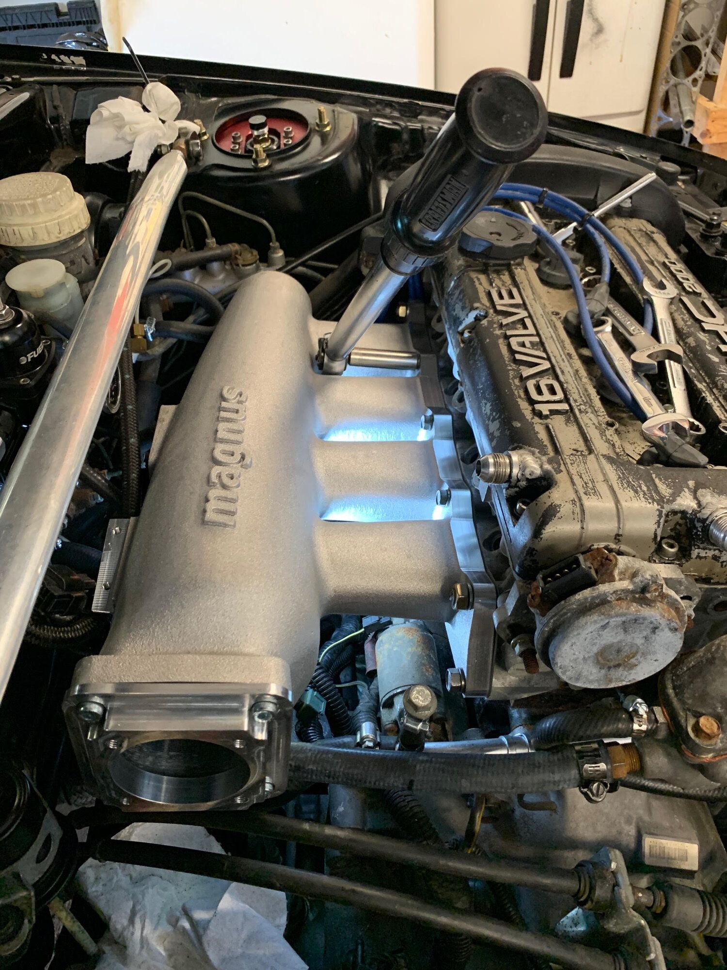

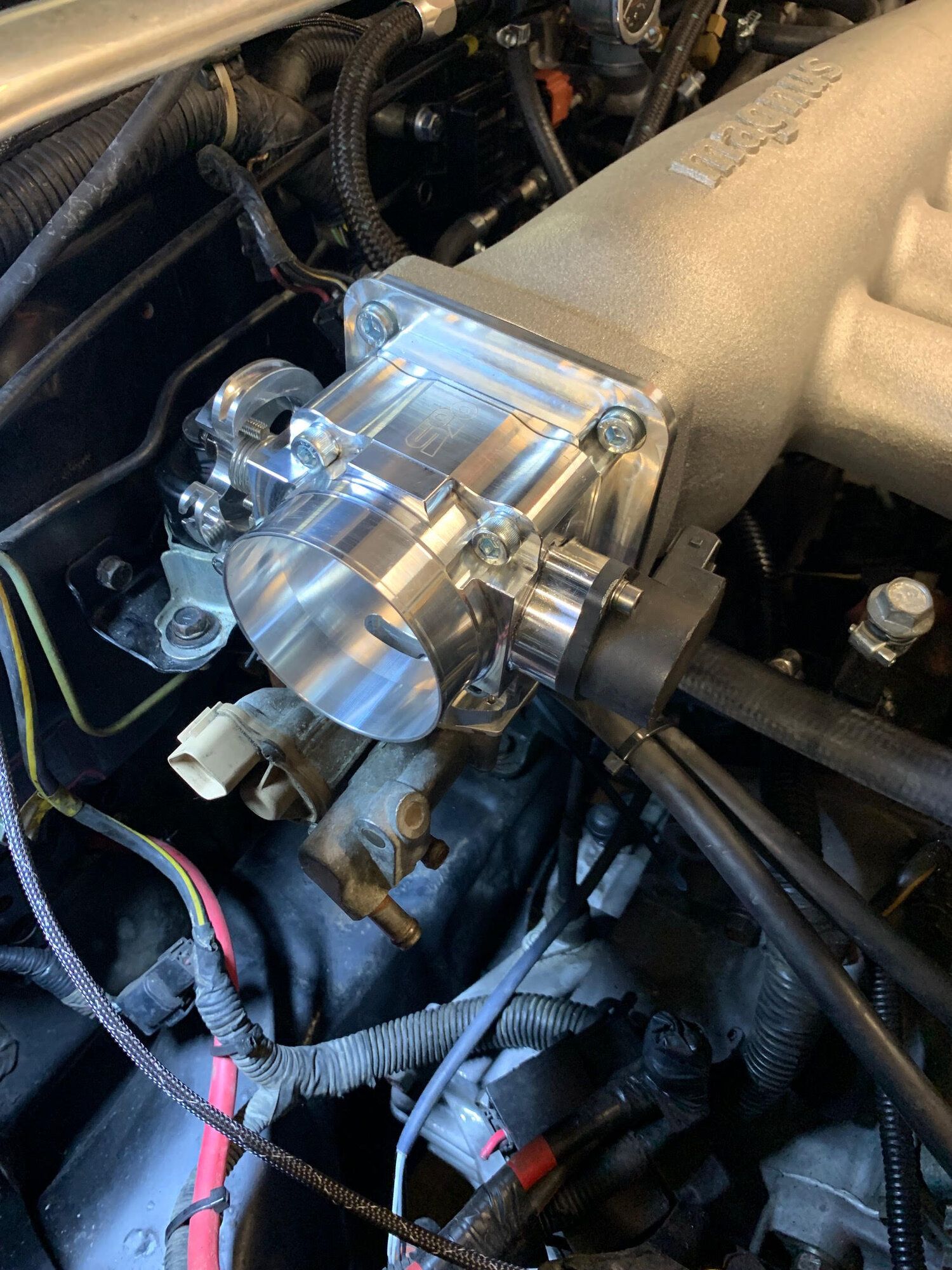

Then I got my intake manifold installed and torqued as well as the S90 TB. I'm still running the ISC with a FIAV block off, and of course it now sit right where the shifter cables go. I had to zip tie the cables up creatively without binding them to get it all to clear. I've toyed around the idea of removing the ISC but I'm not sure I want to get into that right now either. I did get high idle (2k rpm) when hot sometimes before I took the car apart.

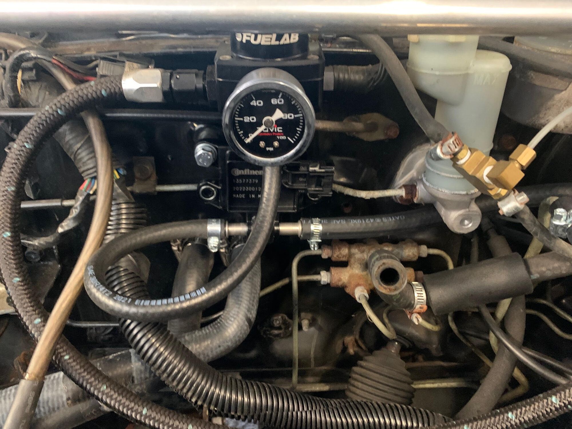

Got the fuel rail and injectors installed this morning and routed the wiring harness under the manifold. Fit up my upper intercooler pipe and I'm hoping it clears the FP intake when it finally arrives. I looked at my catch can and I'm thinking I'm going to mount it where the SMIC used to be. It's the only place there is room and it will be easy to drain. I tired to install my throttle cable and the mount on the Magnus manifold isn't close at all to working. I had to grind down the flange on the cable just to get the slots to line up with the mounting holes on the manifold. Even then you can only use one bolt to mount the cable, and it's still in between slots to get the right tension. I also can't figure out what size they tapped the holes for as the stock bolts don't fit nor do a couple others I tried. I made a trip out to Summit and picked up some more t-bolt clamps, vacuum hose, and -8 line. I also updated my ECMlink firmware and sent my current map over to Nate at TPG to get a good base map.
