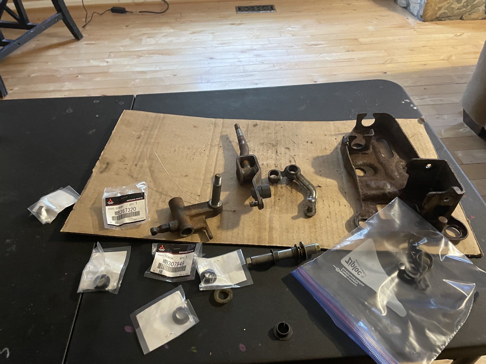

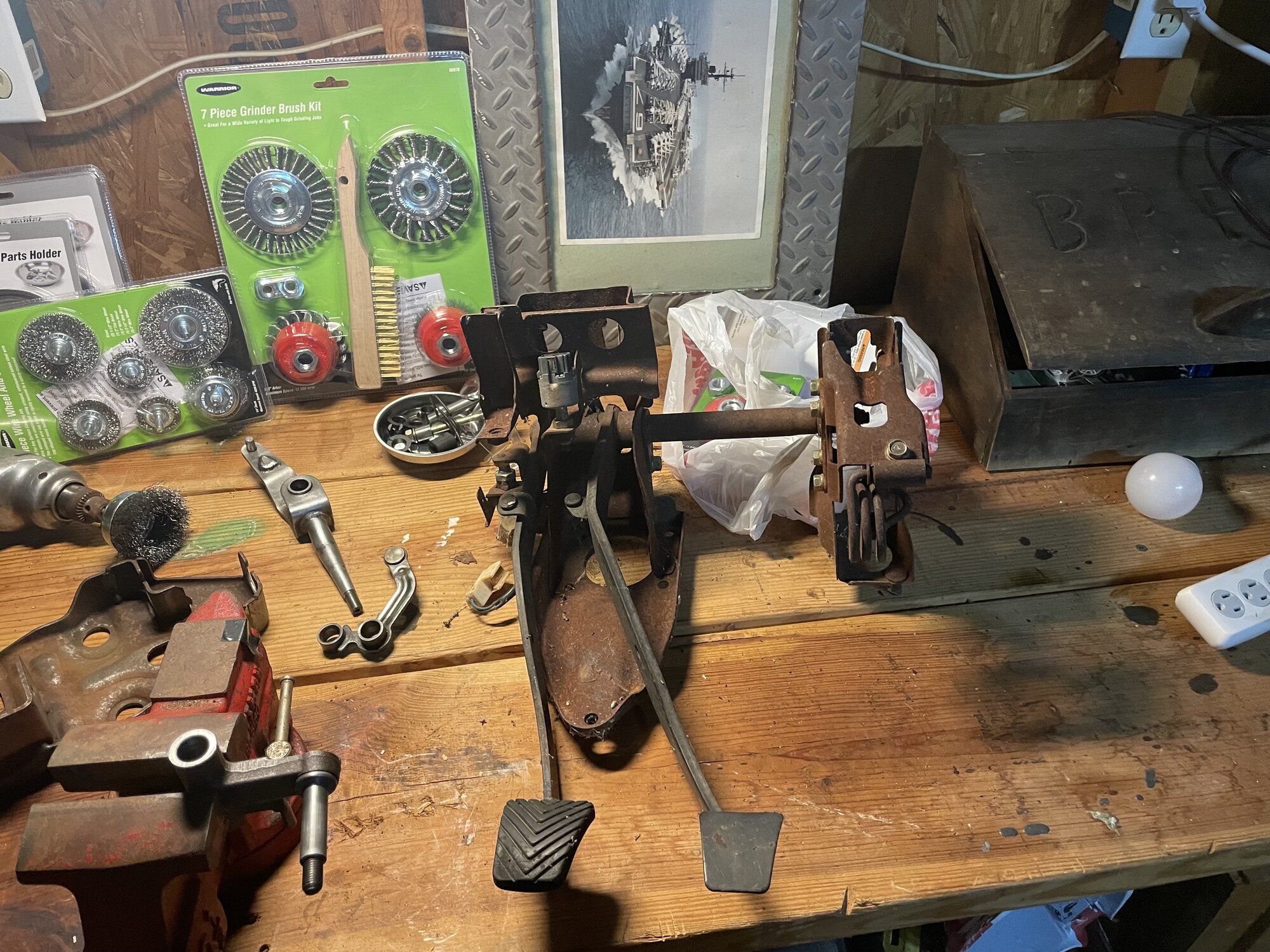

Starting off with addressing one of the known issue from when the car was parked. Busted shifter cable bushing.

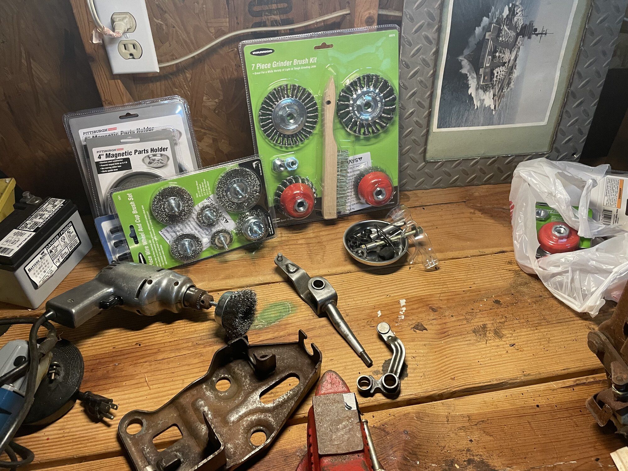

this week I pulled the interior and removed the shifter I cleaned it up a little and compared the current bushing to new OEM bushings and confirmed my suspension. I plan to prep the surfaces and rebuild the whole linkage as the under hood bushings are gone as well.
Update Misc.
After work and school, me and my boys stopped by China Freight and picked up some supplies to get thing moving. I also ordered a bottle of Rust Oleum-Rust Dissolver. I plan to try it out on the shifter assembly once i finish with the wire brush and scuff pads.

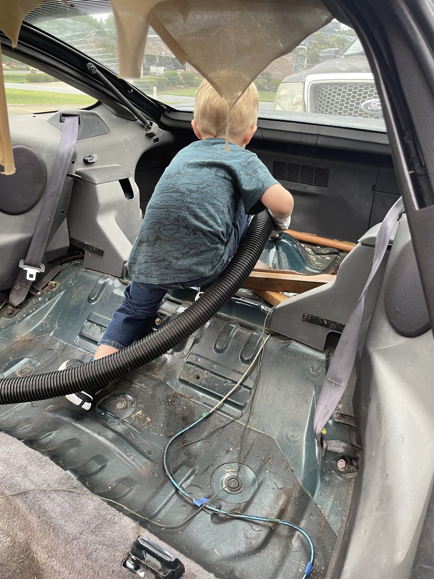

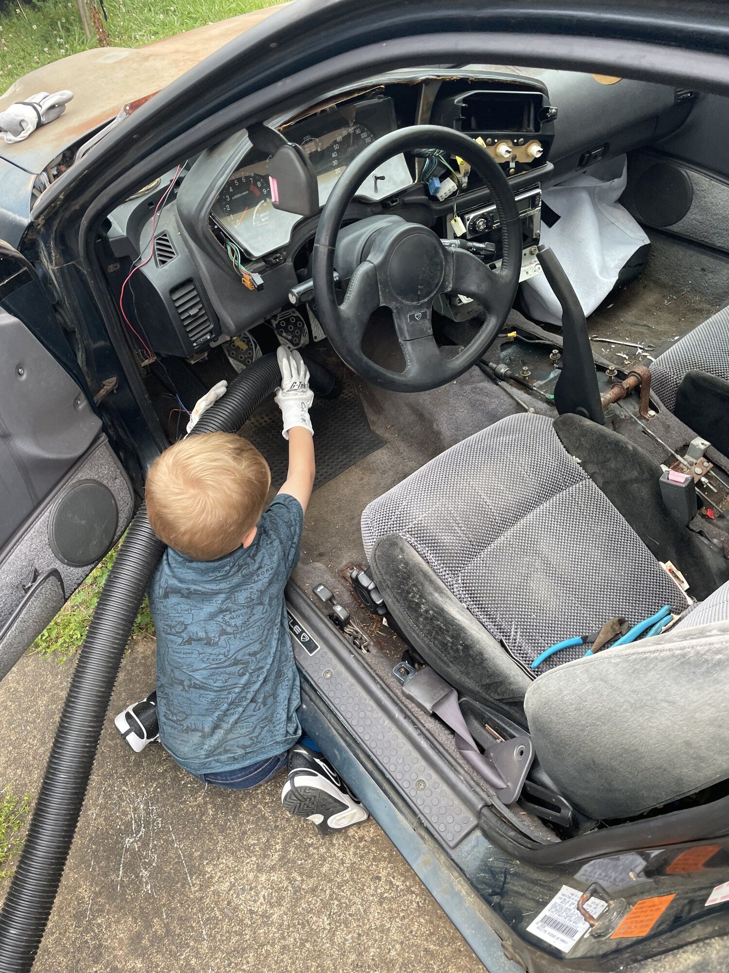

Last week the boy and I finished removing the interior. He took the seats out all I did was pick them up and move them to the garage.

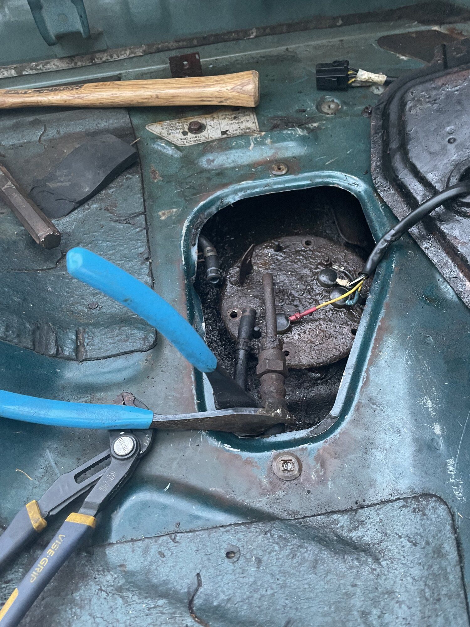

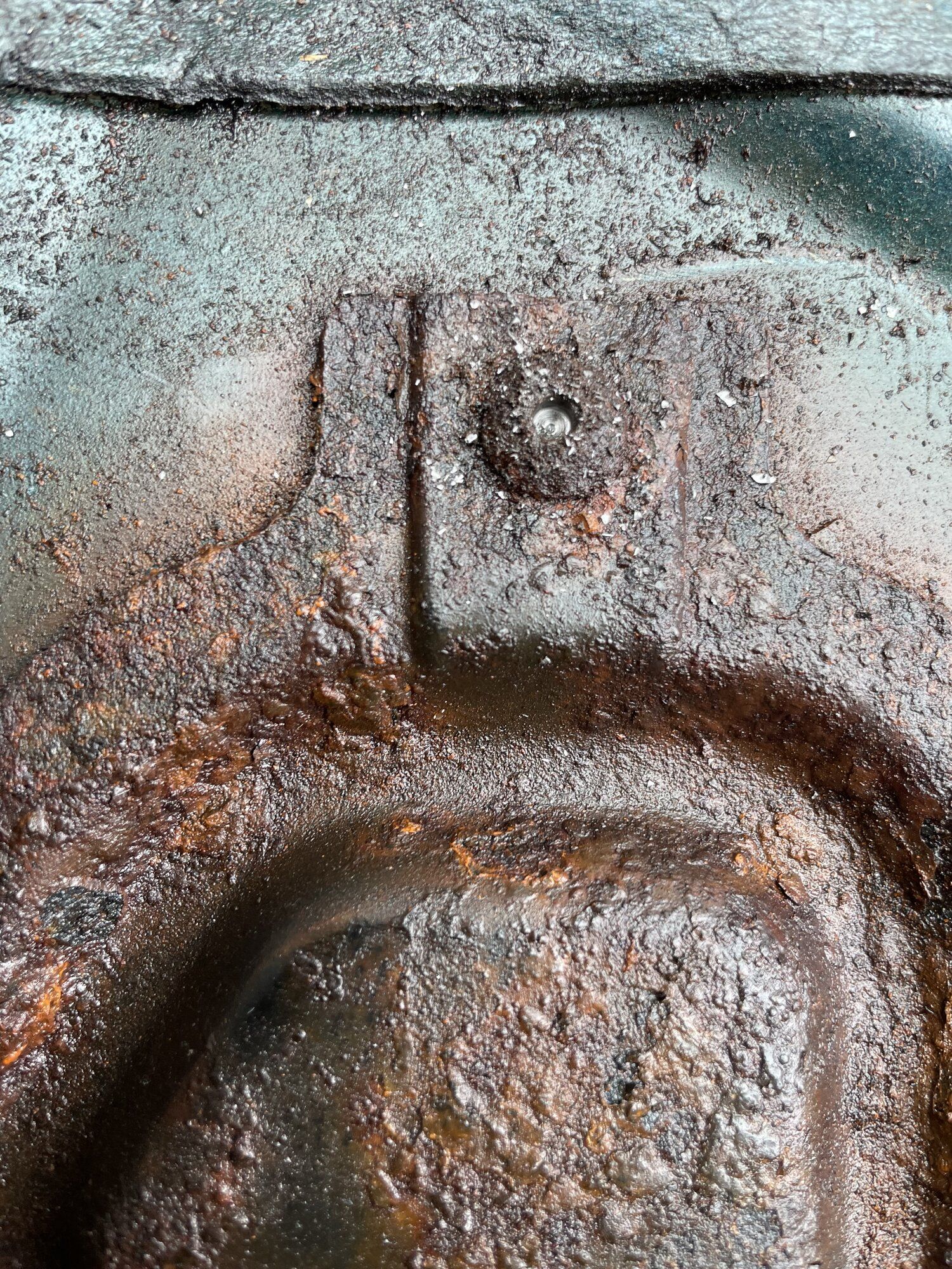

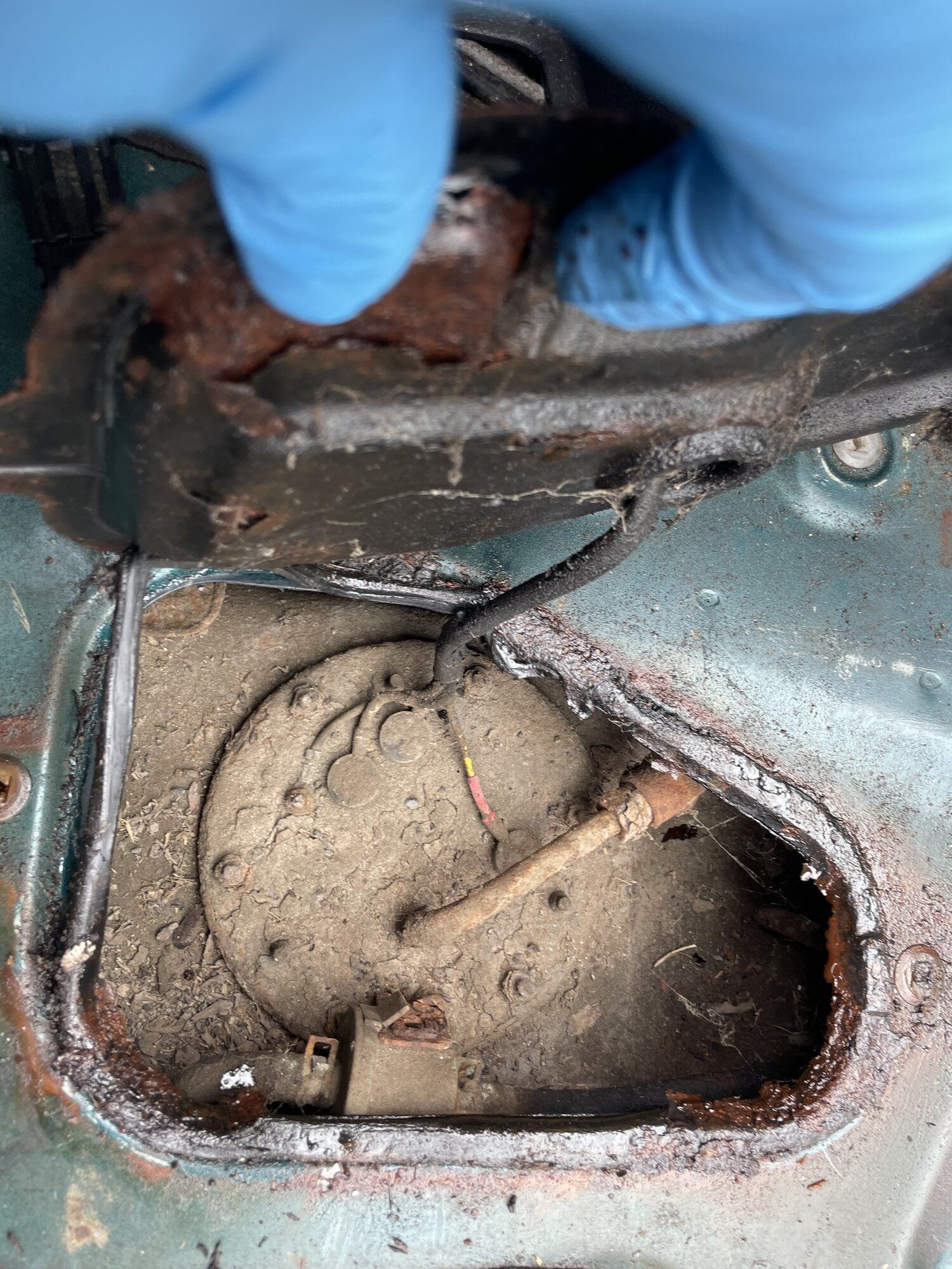

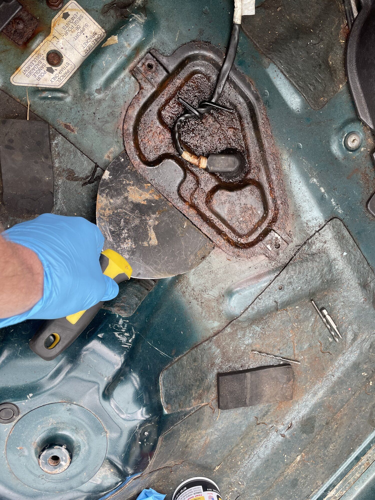

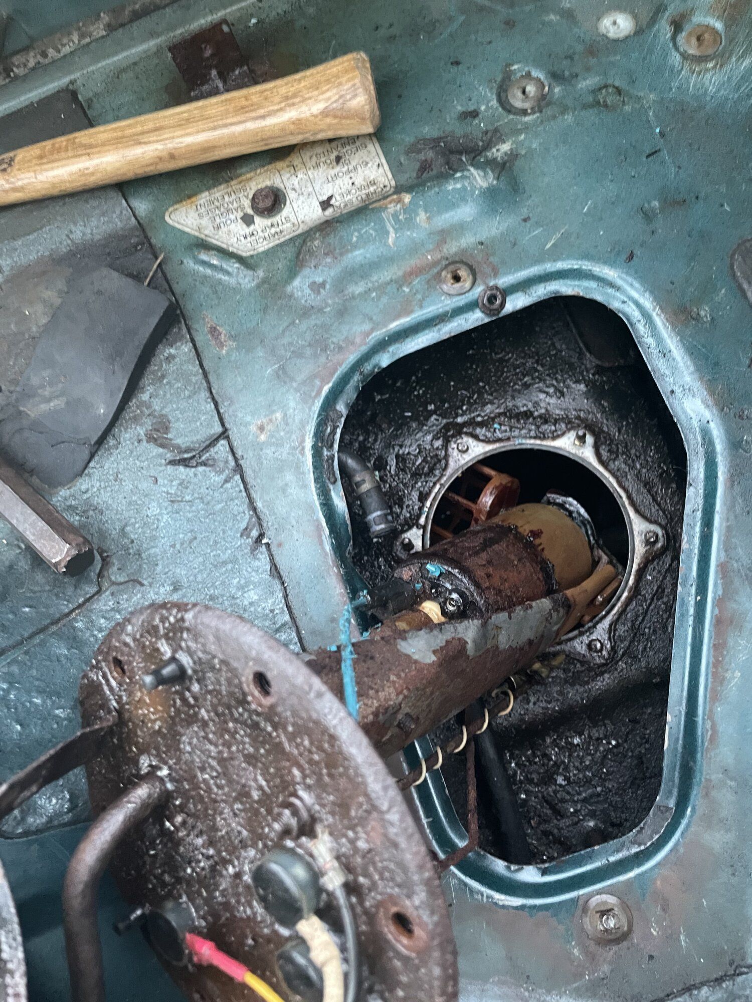

Over the weekend, I worked on getting the fuel tank stud and bolts loose, hitting them with break free every day and working 15-30min here and there.
I had removed the hanger a day or two before, I took care to let the studs soak for a few days. But ended up snapping 3 of the 5 studs. I had a plan going into it that a JMF Fuel cell and RTM Replacement hanger would probably be in my future. Along with deciding on using the 255 fuel pump that I’ve got set aside or going ahead and getting a 450 high-pressure pump to cover my HP goals.

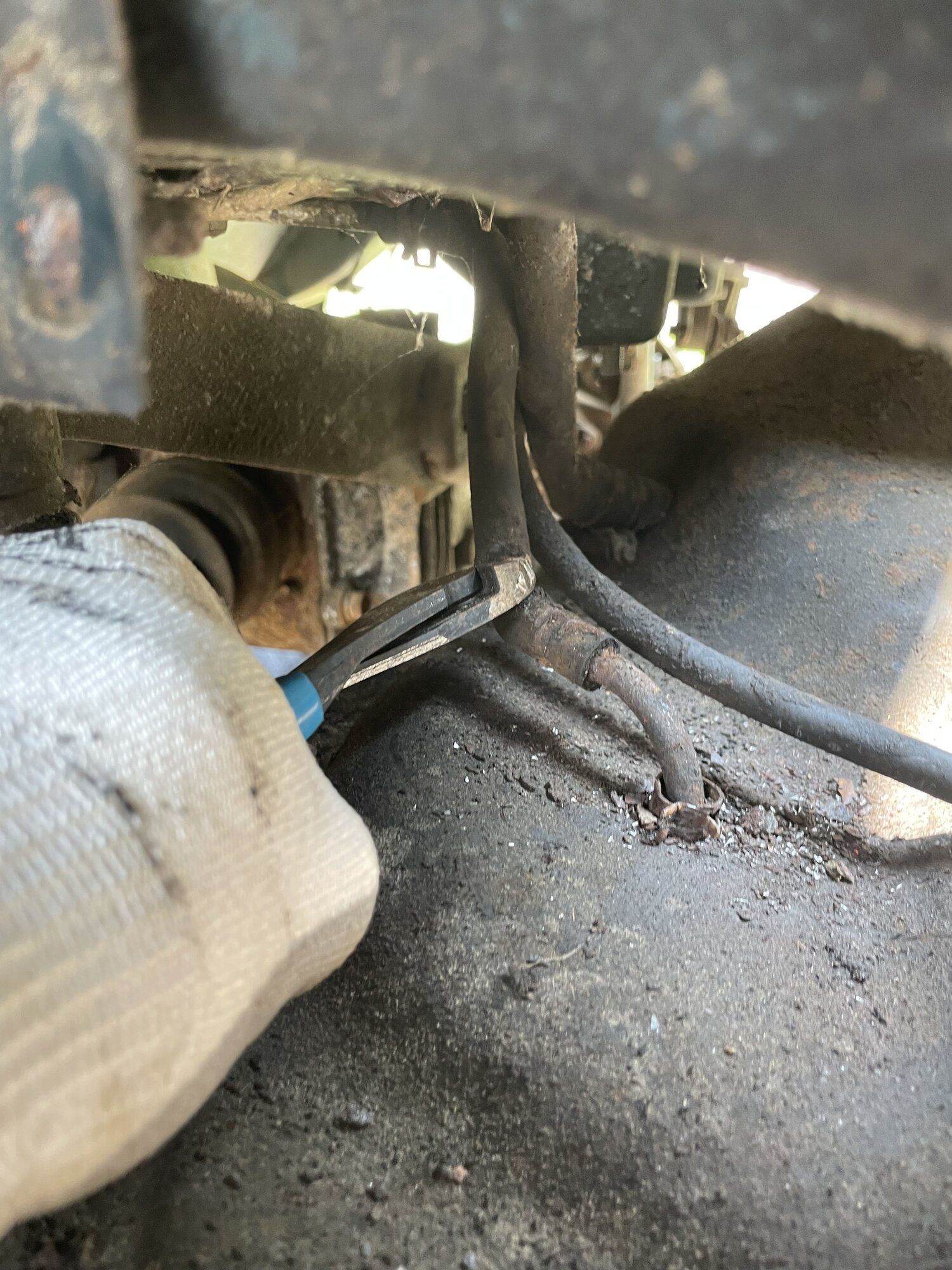

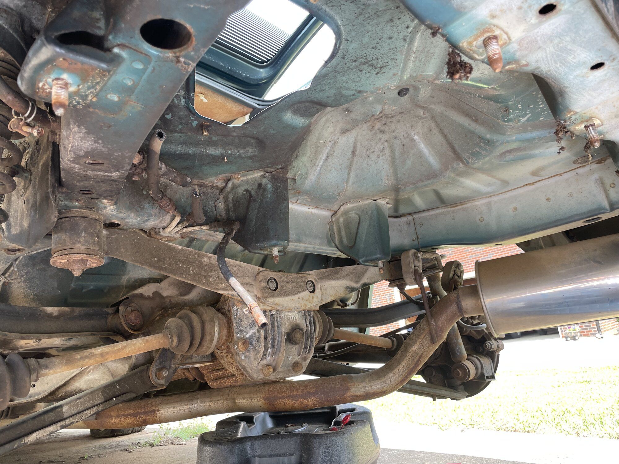

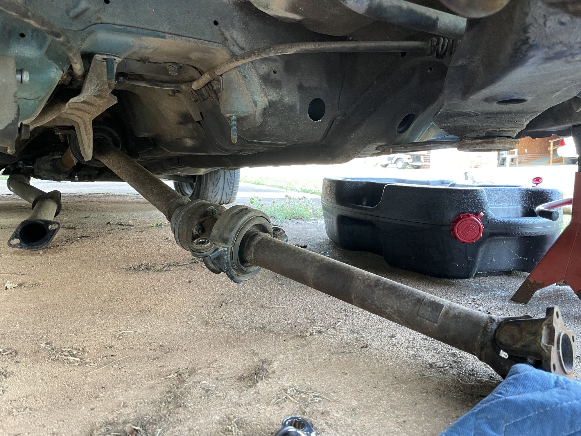

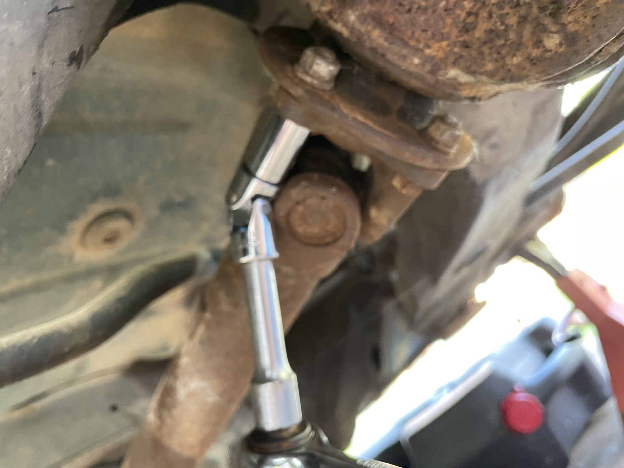

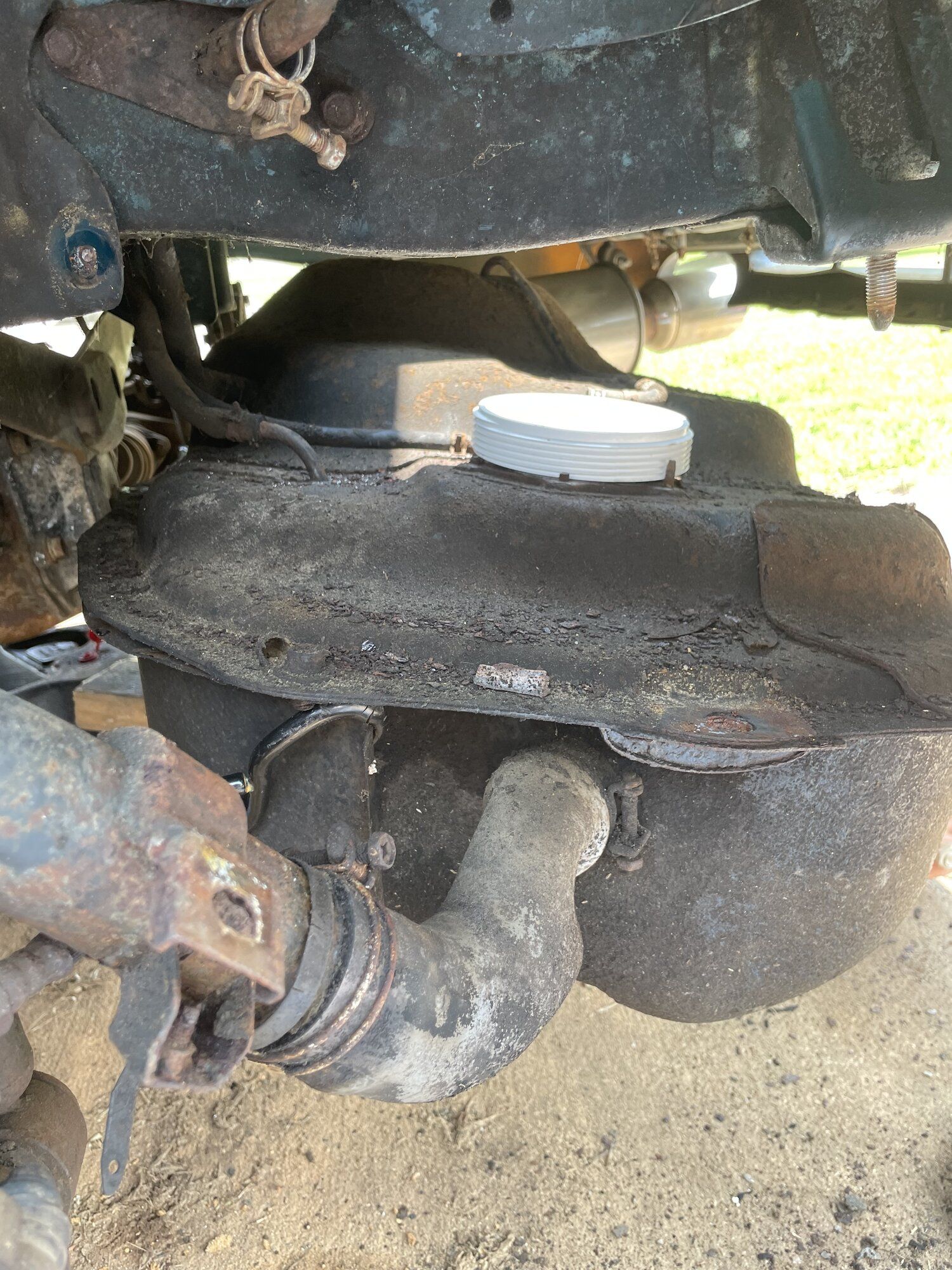

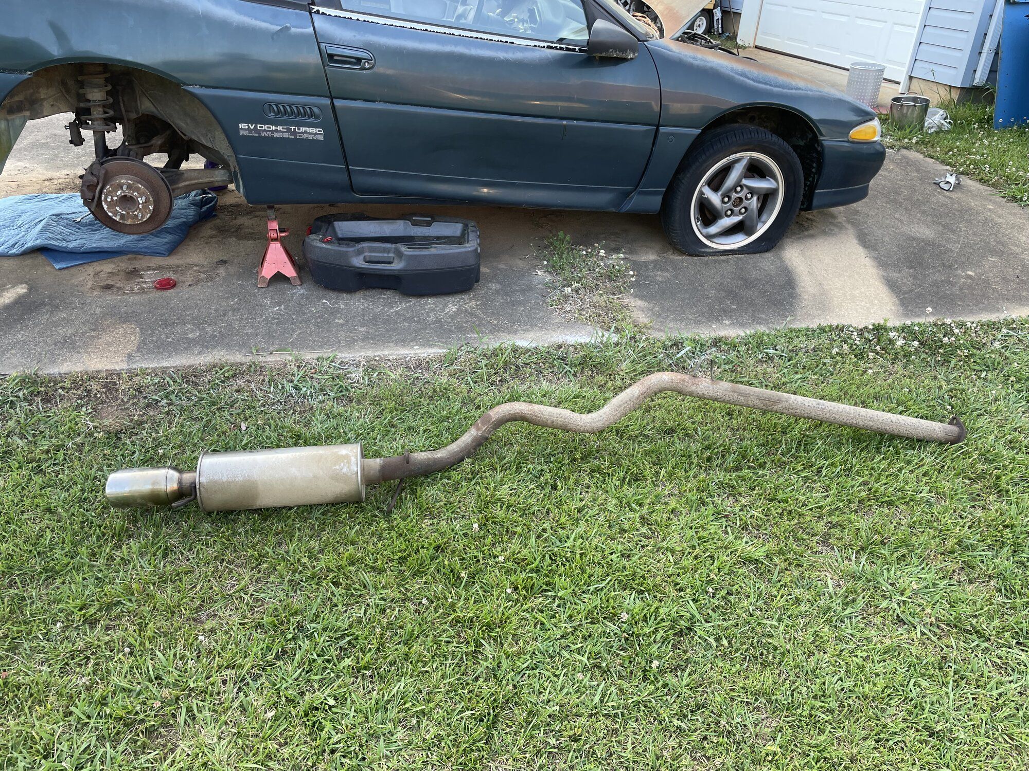

Today, between work and kid appointments, I was able to drop the tank, came back that afternoon, and actually made pretty quick progress on removing the subframe. I was able to get the prop shaft bolts off easily, as I was worried due to the rusted-up drivetrain not being easy to rotate. The rear exhaust bolts were fresh and came off without any issues. I had been hitting them with brake free before and a few times after work each day.
Tomorrow through Friday, remove the parking brake cables, and drop the subframe. Remove the driveshaft assembly for inspection, I assume I will end up with a Driveshaft Shop replacement as all the joints are shot and it will probably be cheaper in the long run.

So much room for activitiesso much room.JPGtank drop2.JPG!

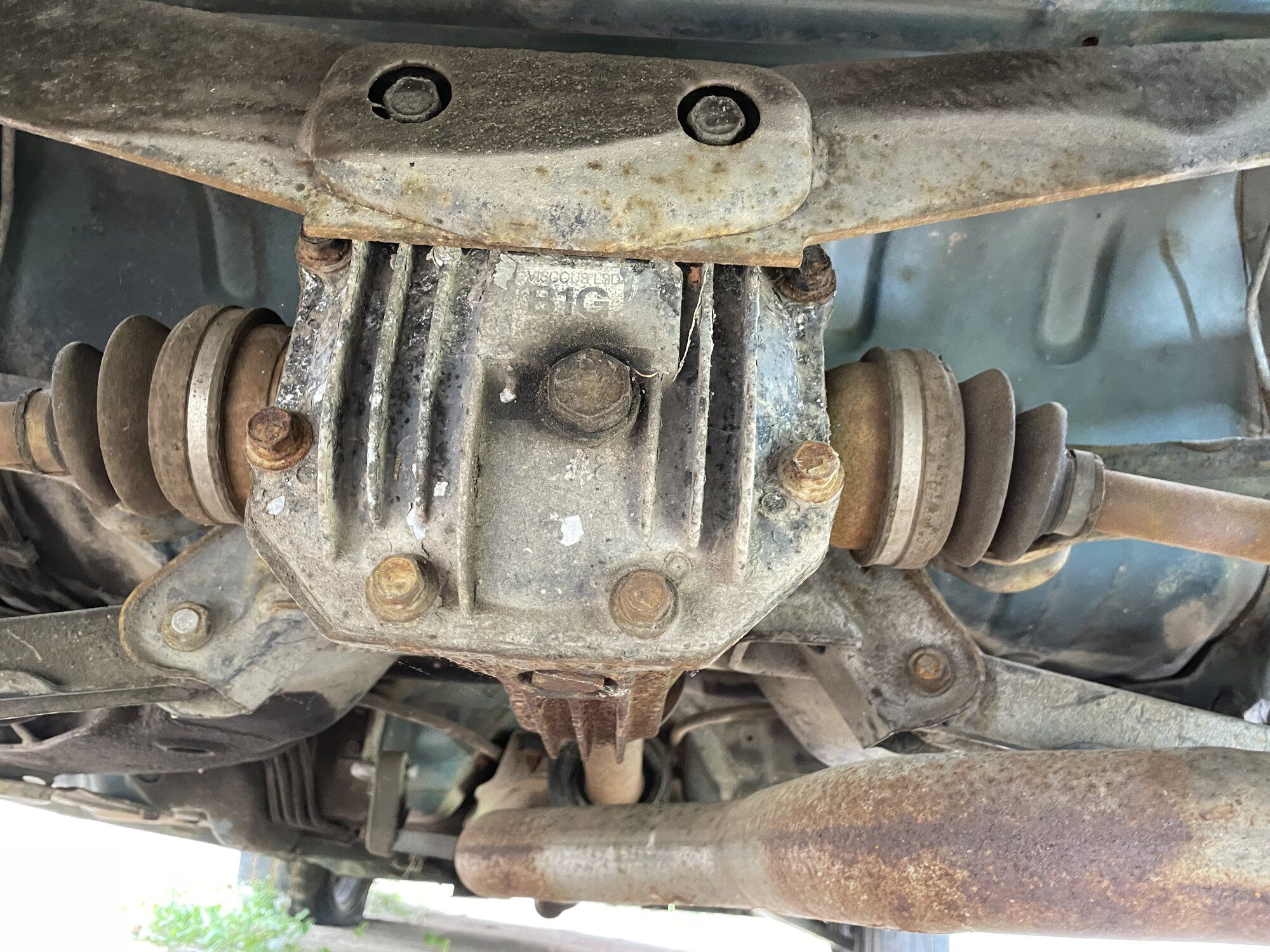

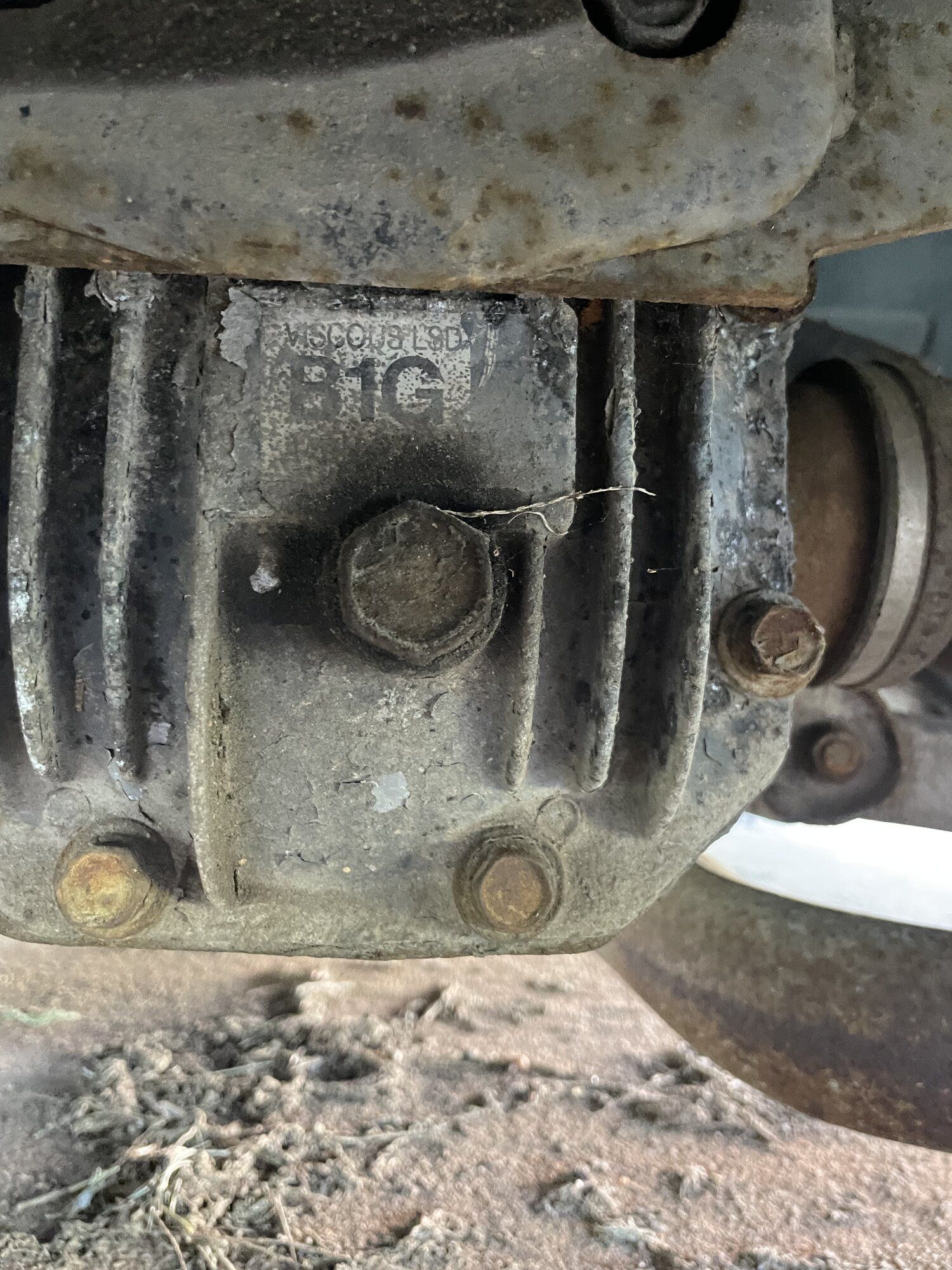

Rear Diff:Rear Diff B1G.JPG

Rear differential:
360.00 Core B1G 1g LSD
600.00 Team Rip rebuild.
150.00 2x stock axels (Rockauto) then upgrade later to DSS after the motor is done.
