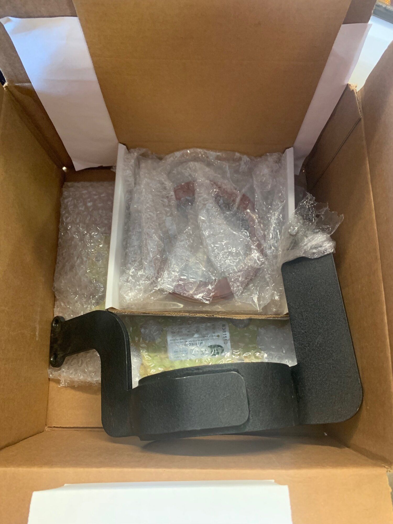

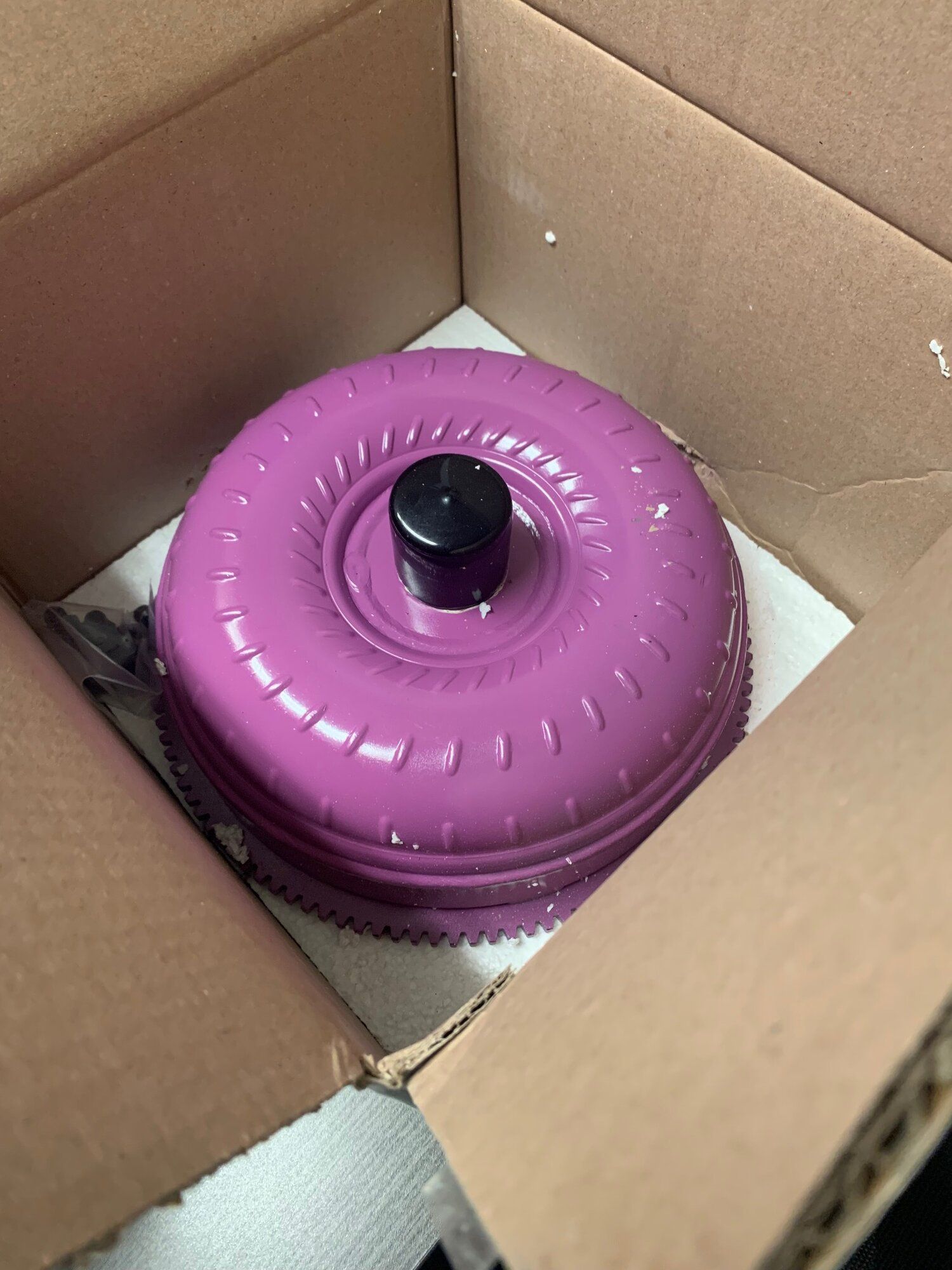

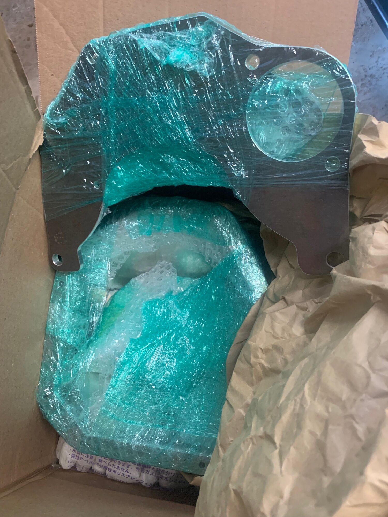

Quick update, parts starting to flow in now.
JB/Precision #8 Converter and 1G install kit, trans pan, and t-case brace. Kiggly flexplate, diff saddle, 5-disc front clutch. Shift kit with IPT spring kit. ALTO rebuild kit. Driveshaft loop.
Still need to get welded center diff, and transfer gears.
