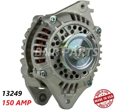

Also, what the heck is this stud for? Some kind of ground from the case to the chassis as a some kind of auxiliary ground? My harness doesn’t have anything to hook to it, doesn’t look like this photo from the internet has anything hooked to it either. Didn’t see anything in the fsm about it.
On my 2g the stud is for a thing in the wire loom. It’s similar to like a p clamp that holds the alternator/ofh wires to and keeps them out the way. I’ve done so much to wiring tucking that I don’t use that stud at all. No ground wire hooked to it or anything.
