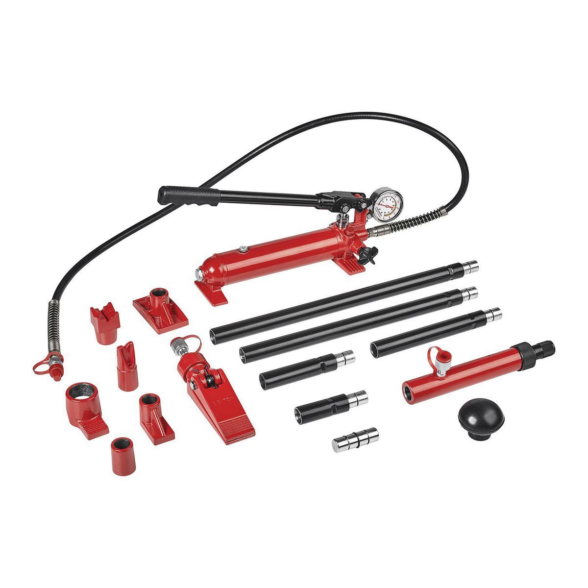

Lock a bearing splitter on the outside of it and use a slide hammer on each side of the splitter or a small body jack from a car or a porta power in between the splitter body and the transmission case.
