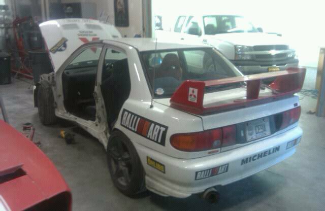

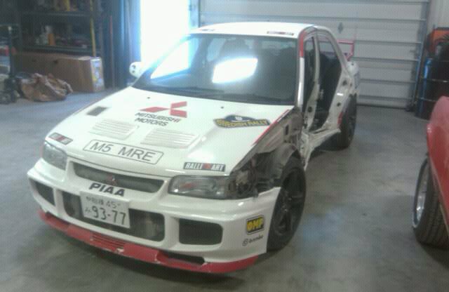

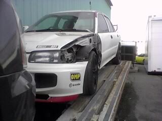

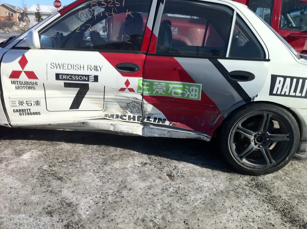

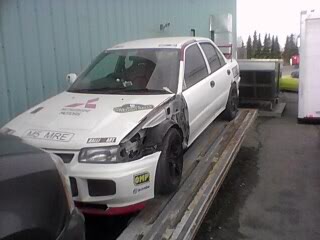

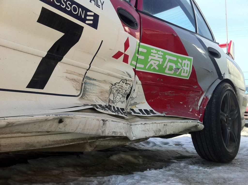

and some side damage LOL

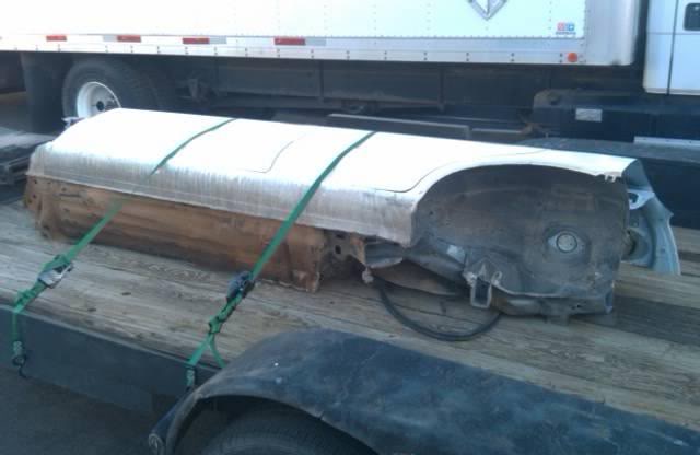

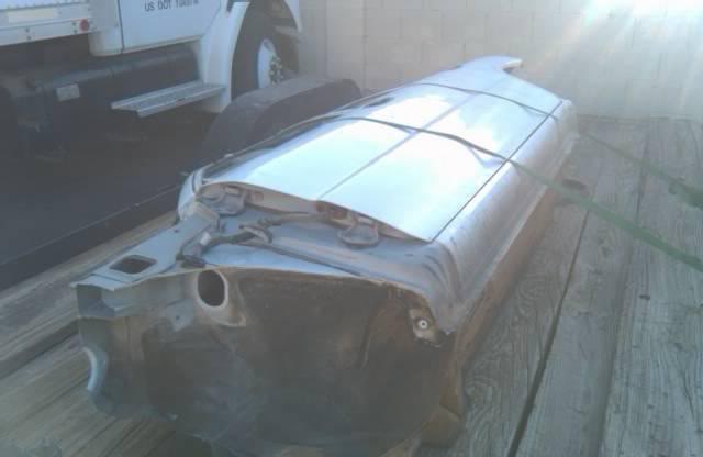

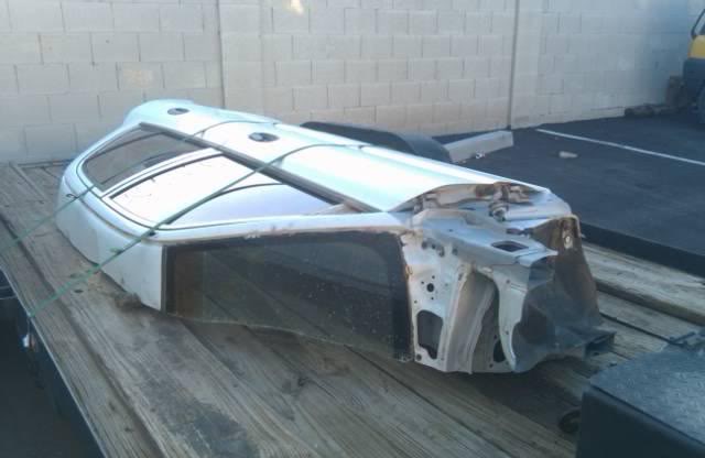

but i do got the replacement parts on the way here's some pics

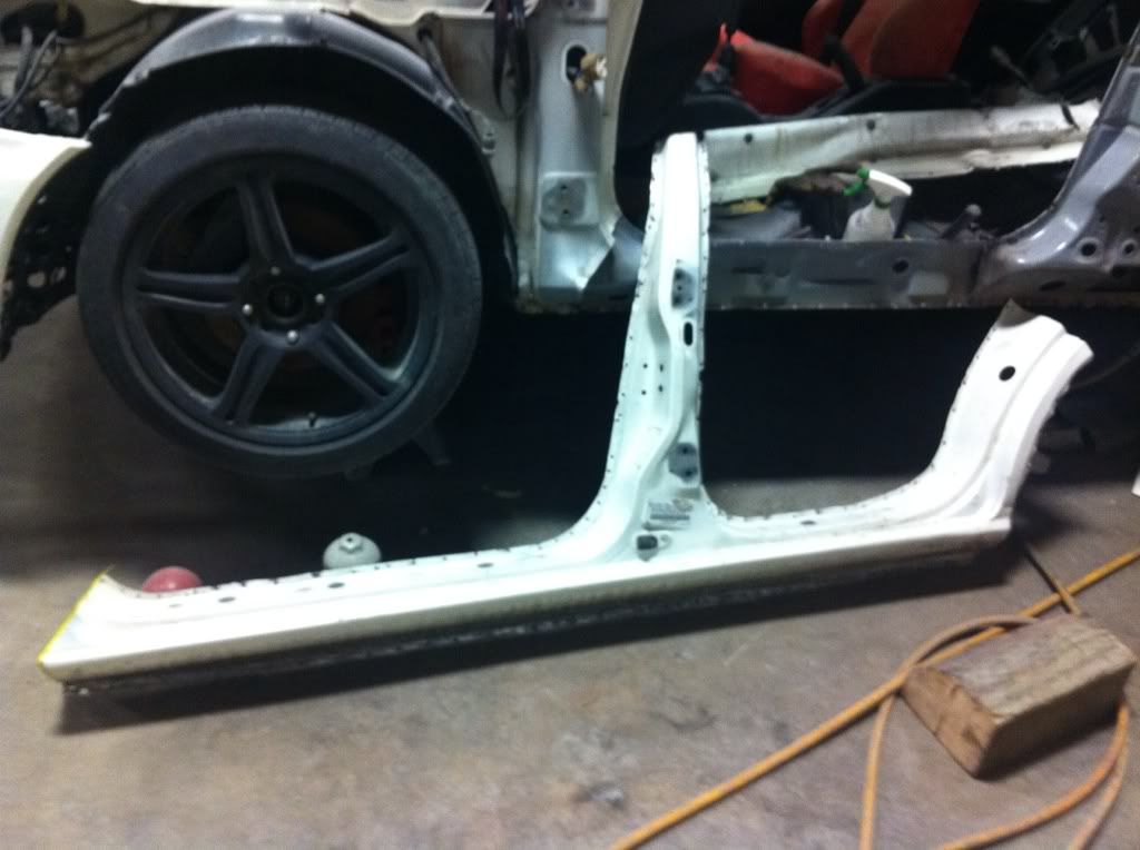

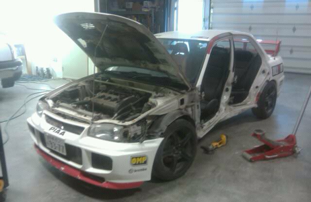

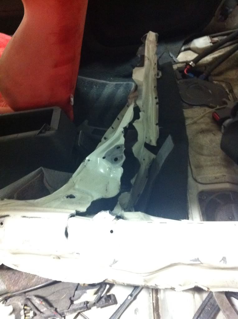

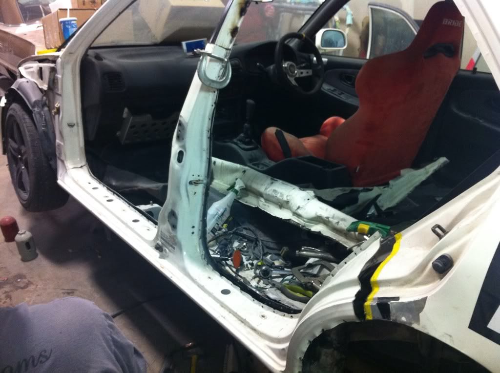

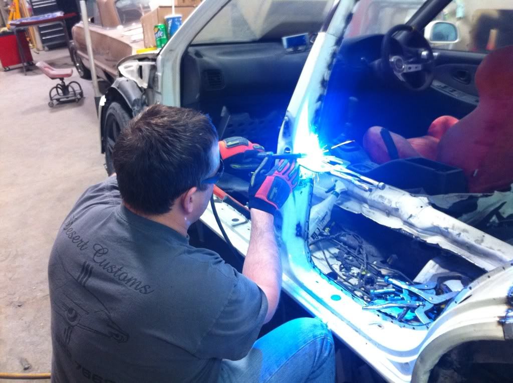

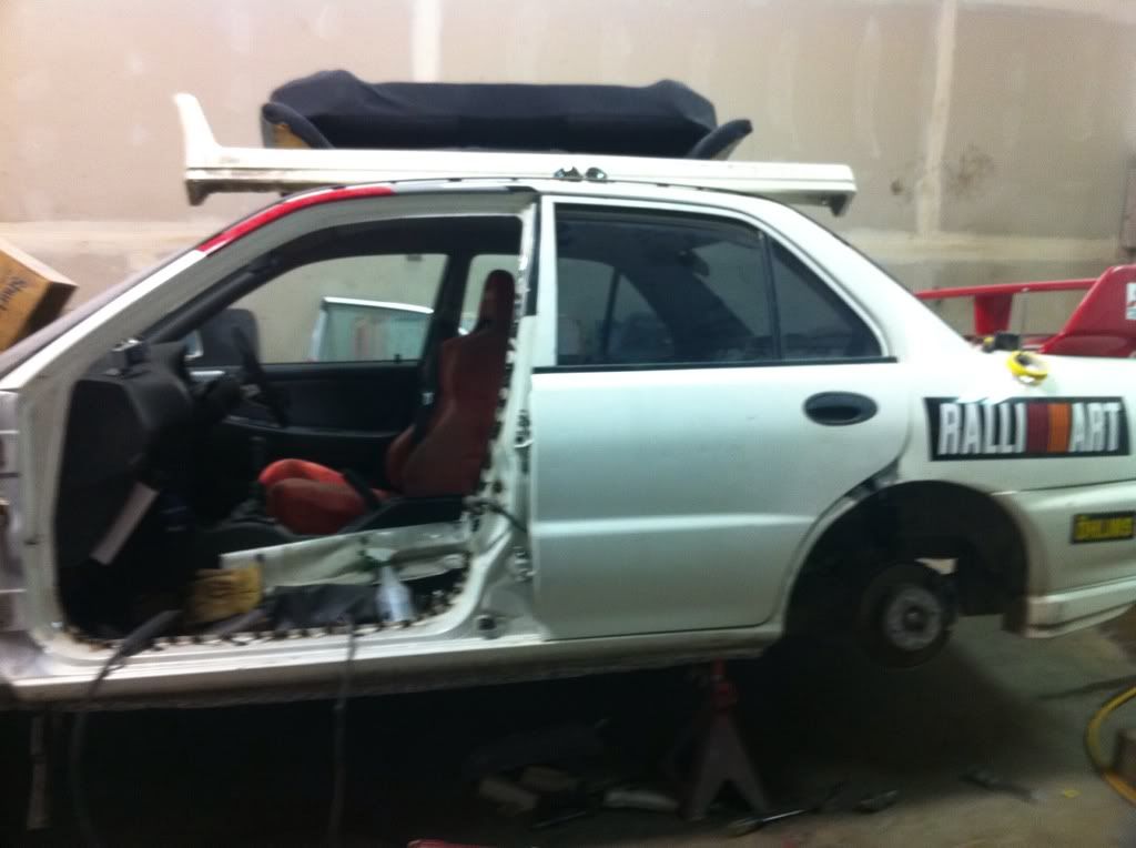

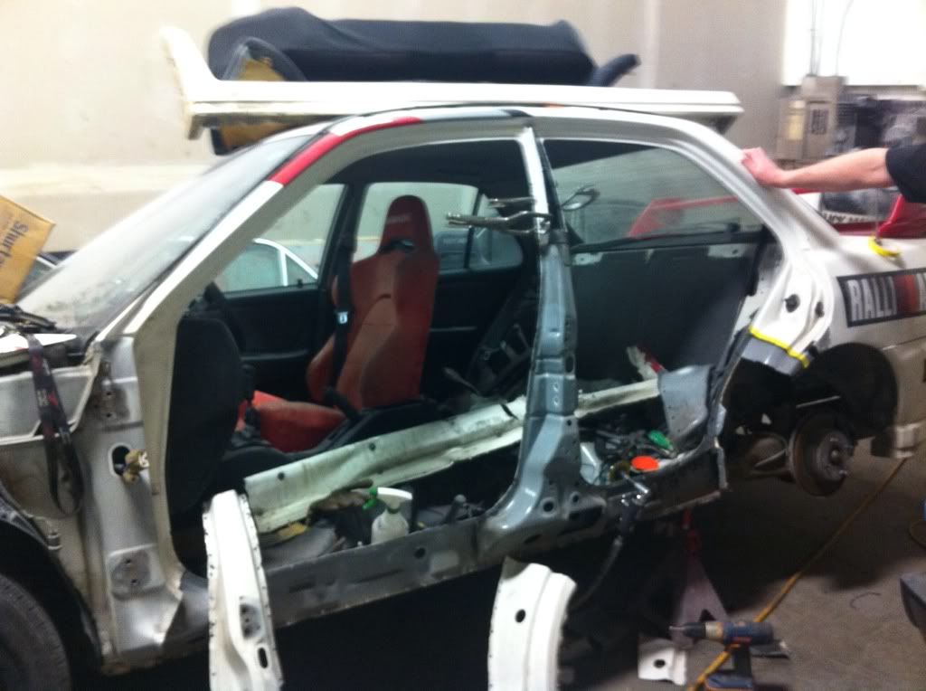

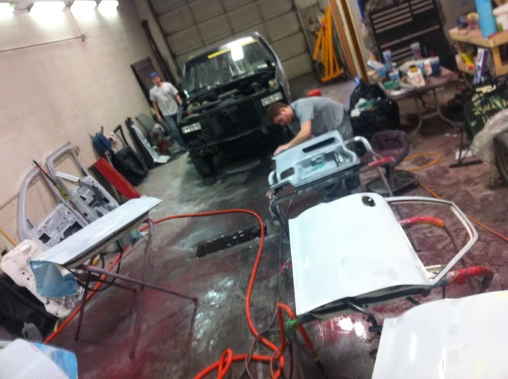

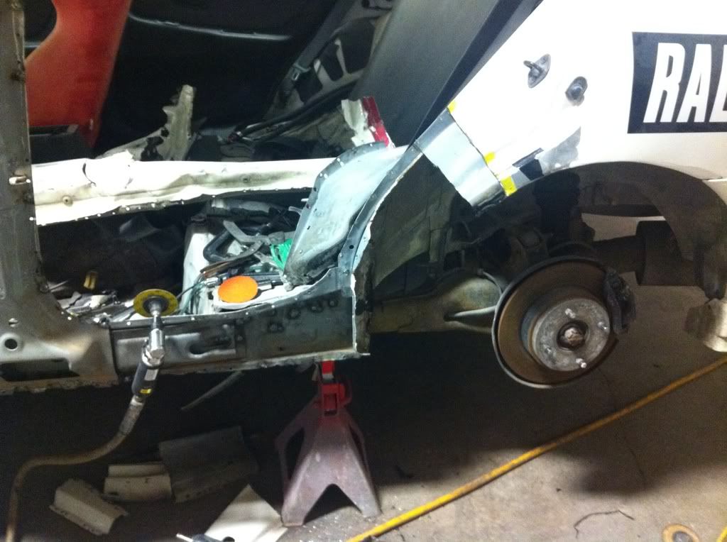

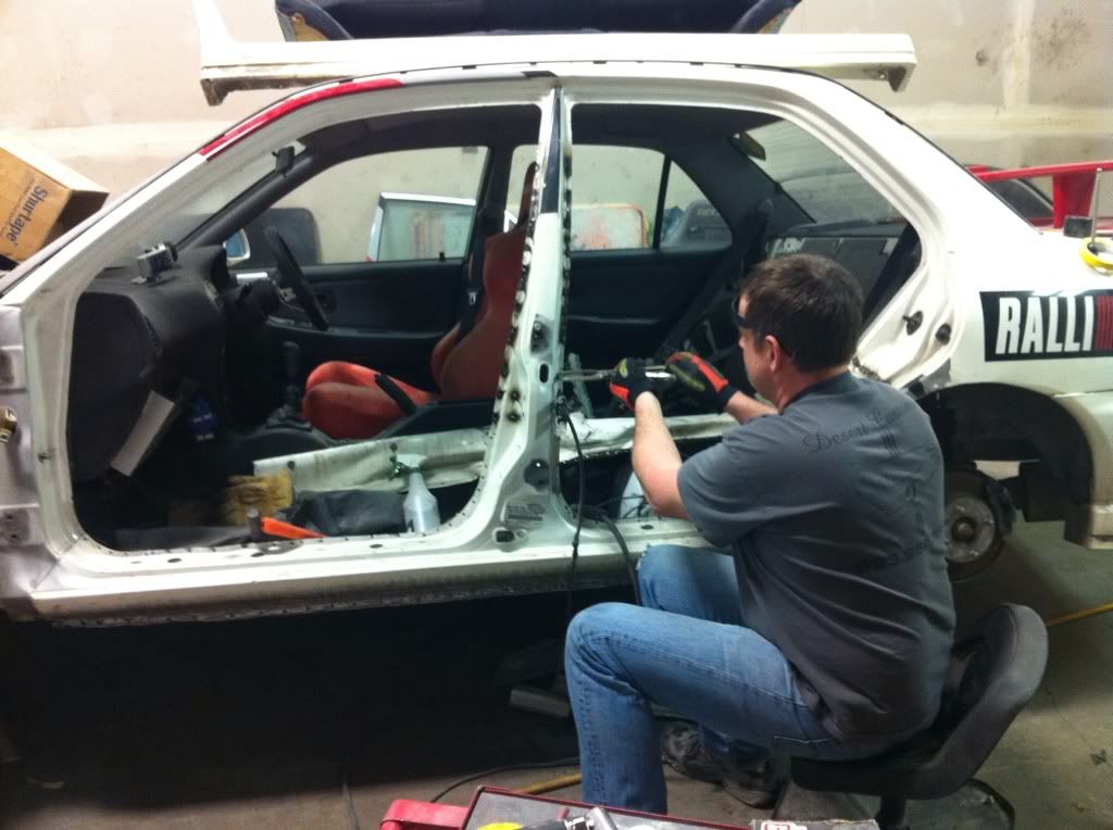

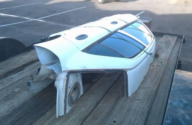

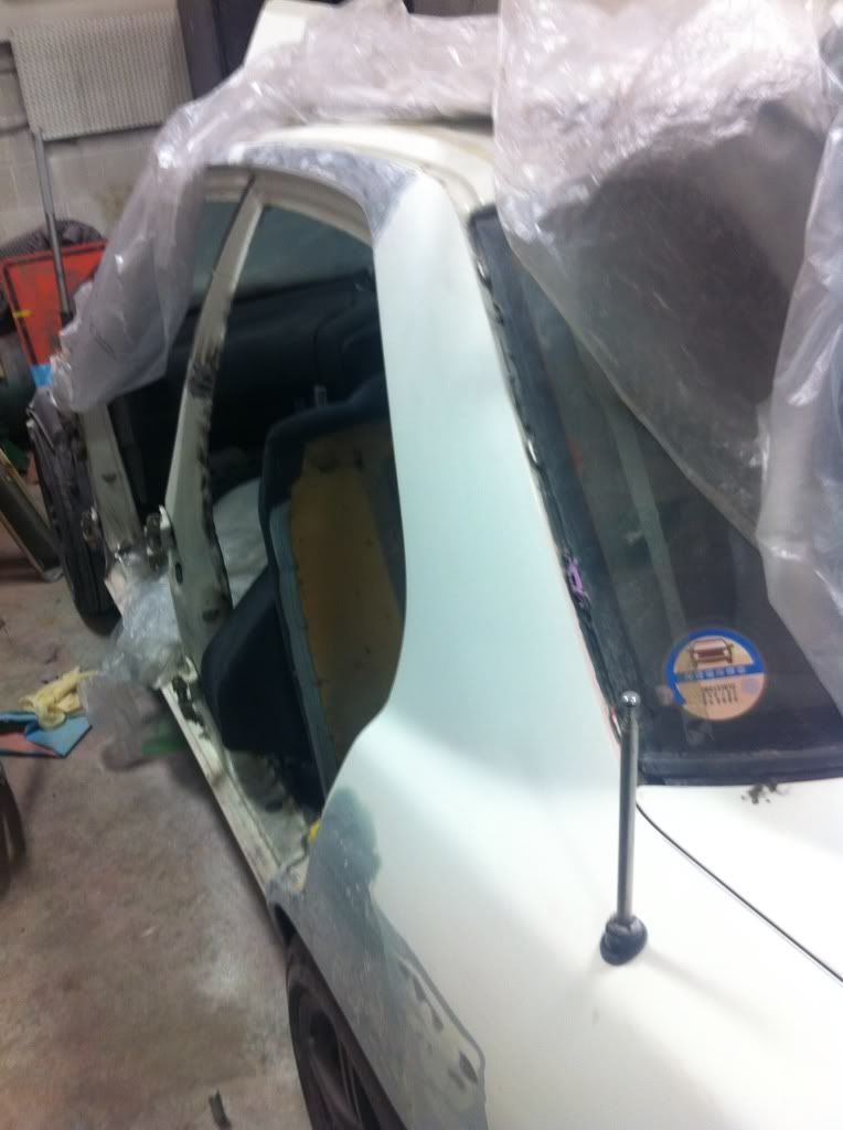

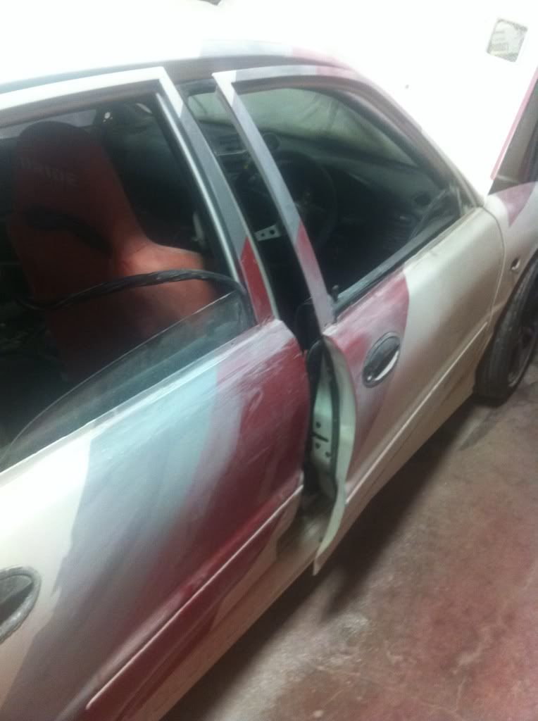

bit of a update got the doors off and was able to look a bit more of the damage off to the frame rack it goes before the side of the car comes off figured it was best to undo the factory spot welds and just replace the side like the factory woulda put it on the next thing is do i put the sticker back on or just go back to white

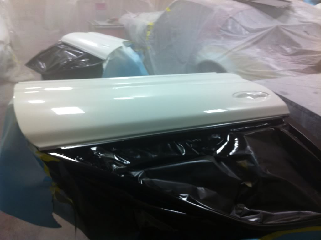

so here's a bit of an up date got the doors on and the car straighten back out the bad metal cut out new metal fitted up ready to go in

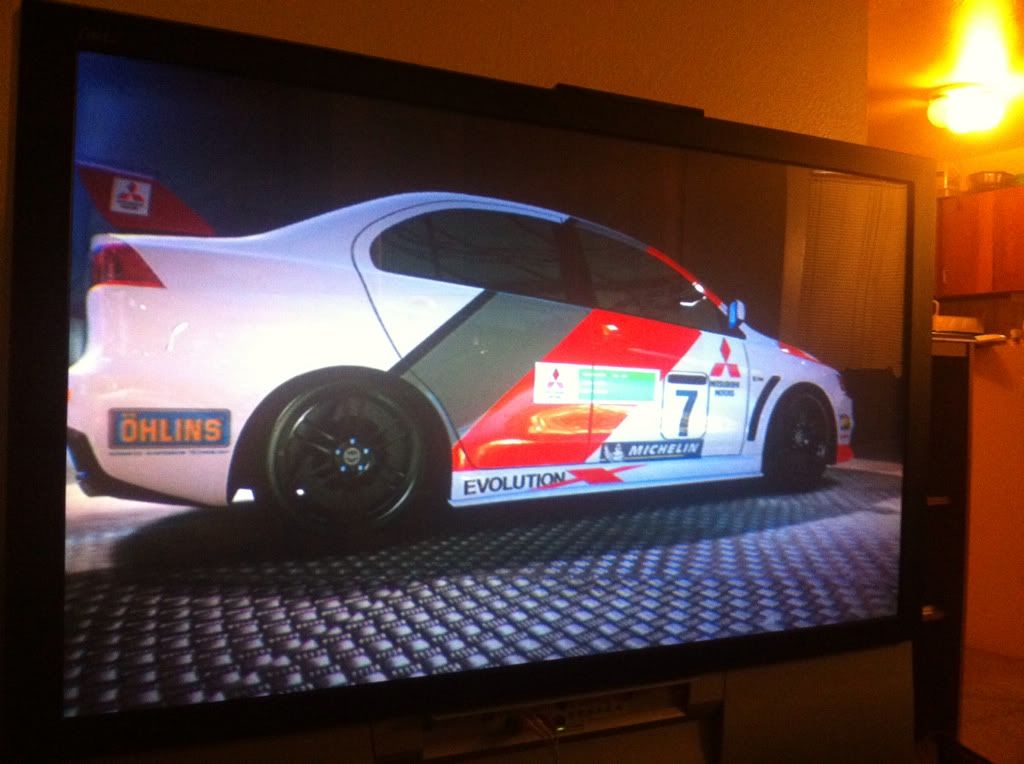

and also was bored in forza...LOL

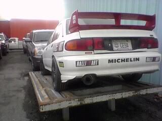

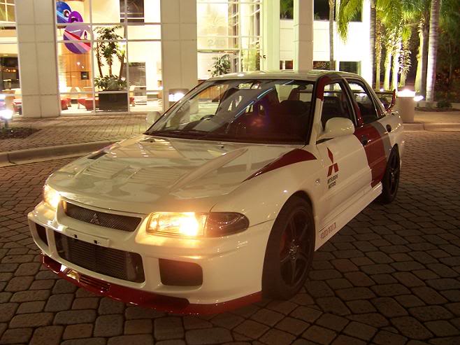

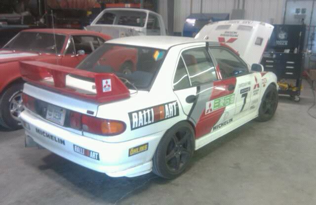

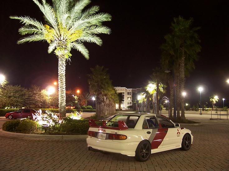

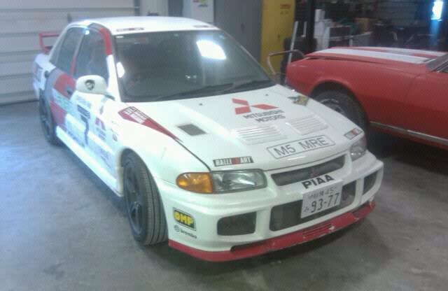

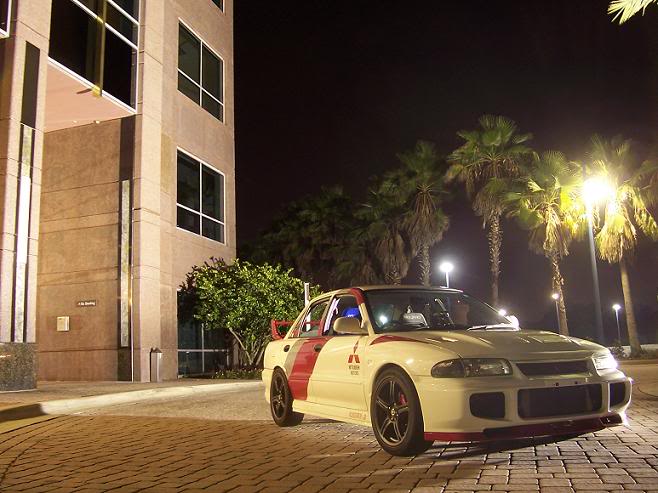

and found some pics of the car when it was first imported

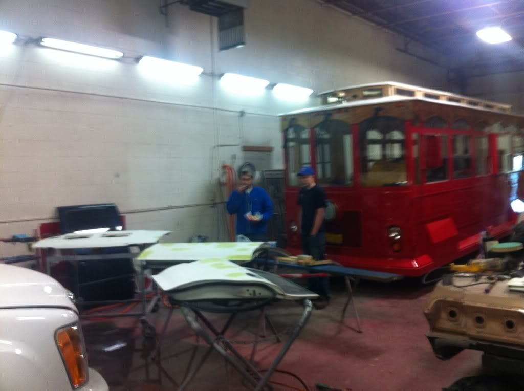

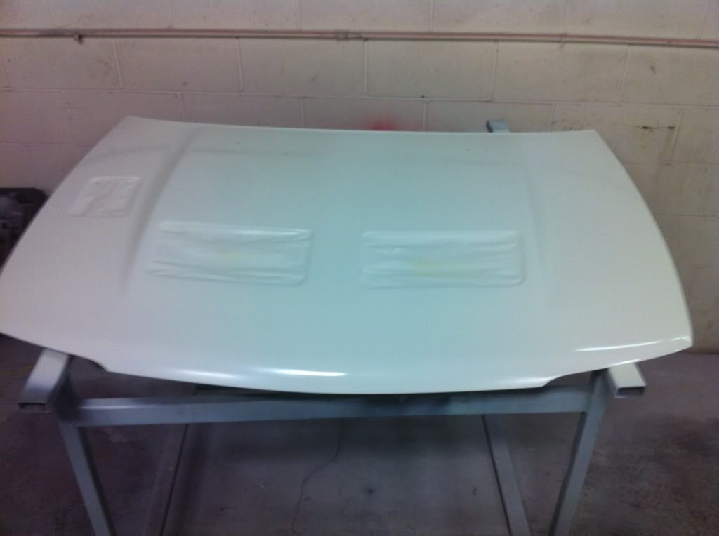

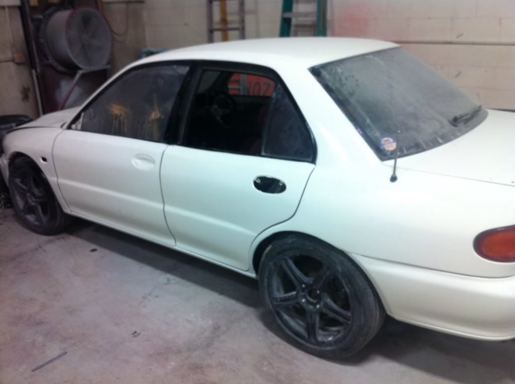

so before it gets painted

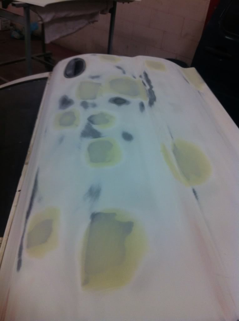

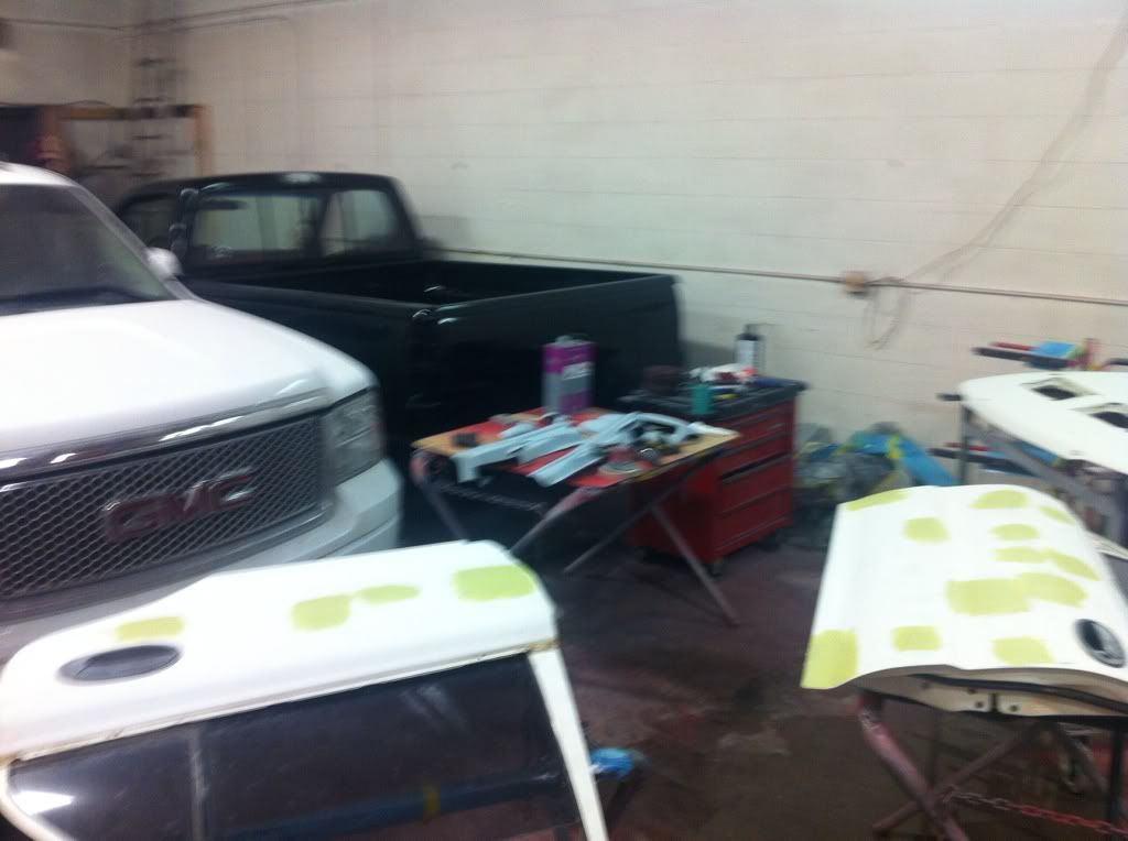

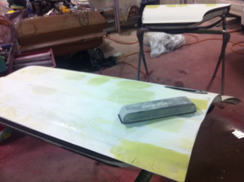

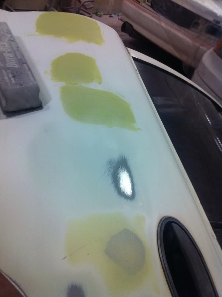

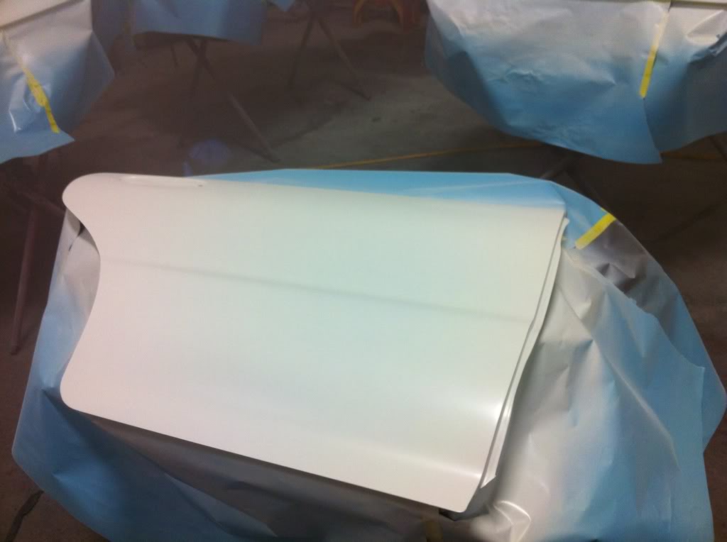

well still working on it doors are done was to tired to take the last primer pics and realized man i hate sanding LOL more chassis work to come btw how do you take the front bumper off?
he doesnt help

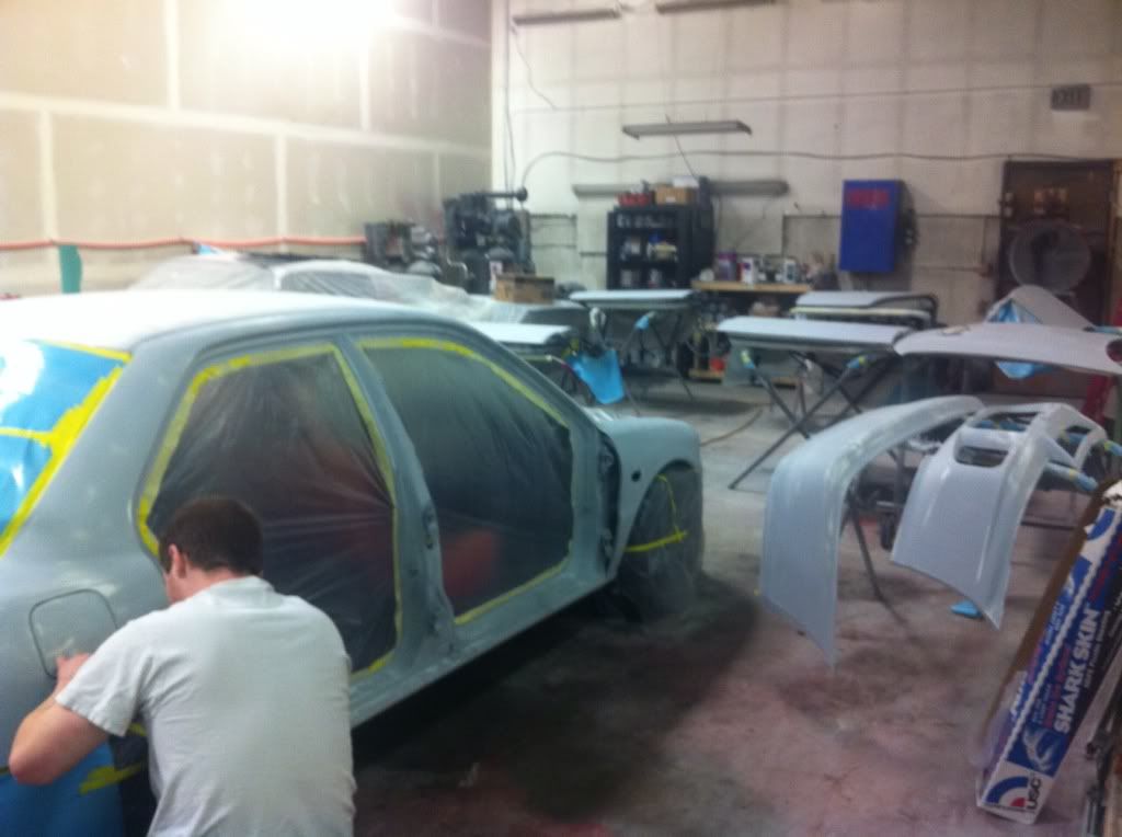

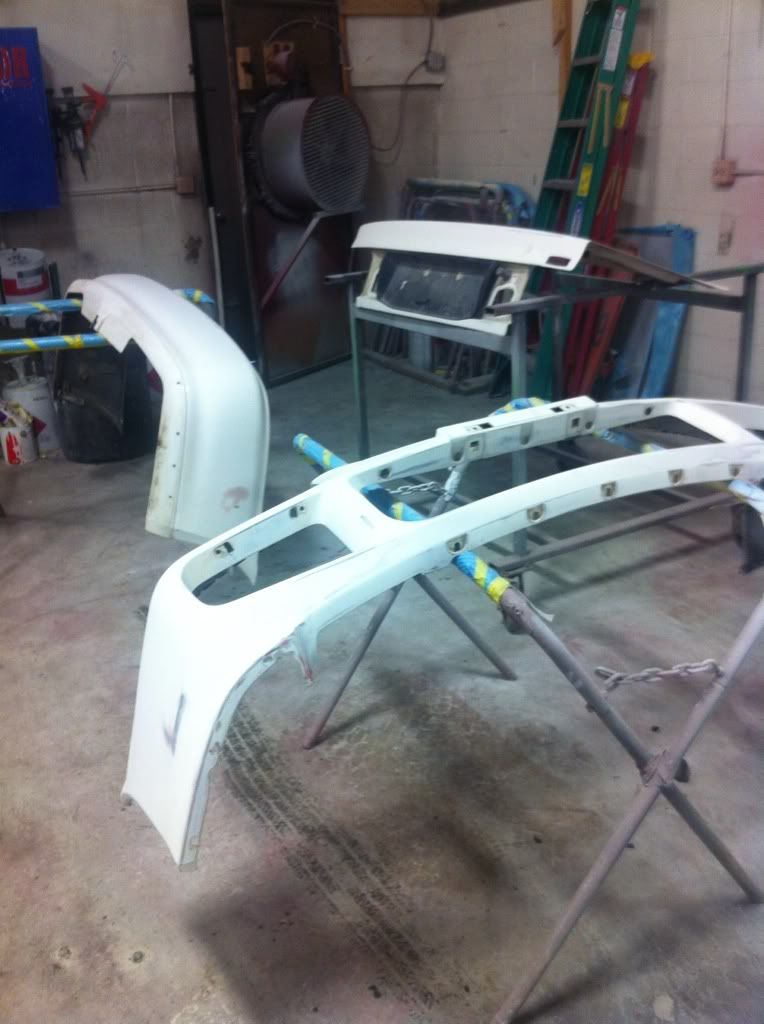

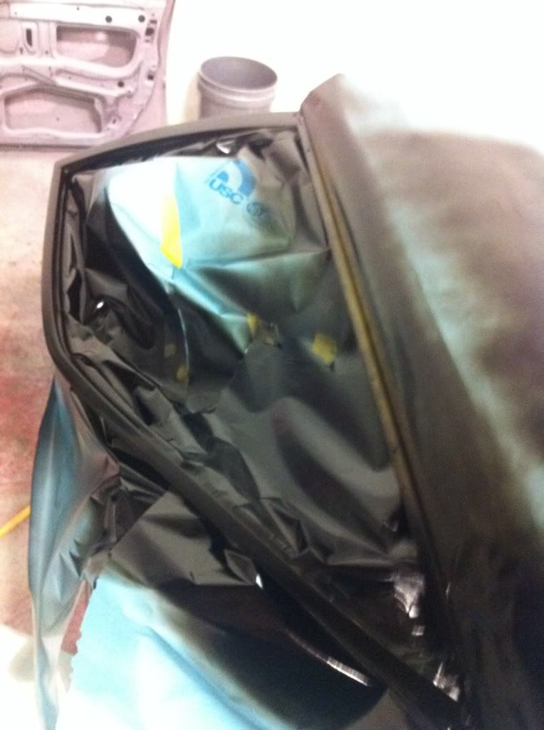

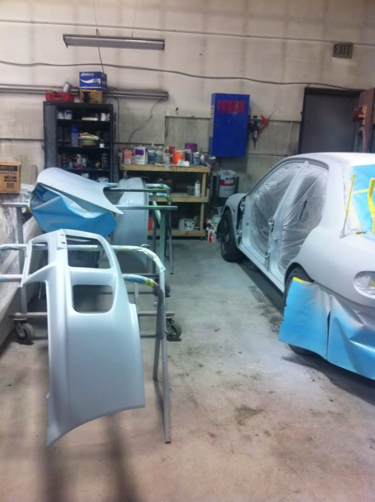

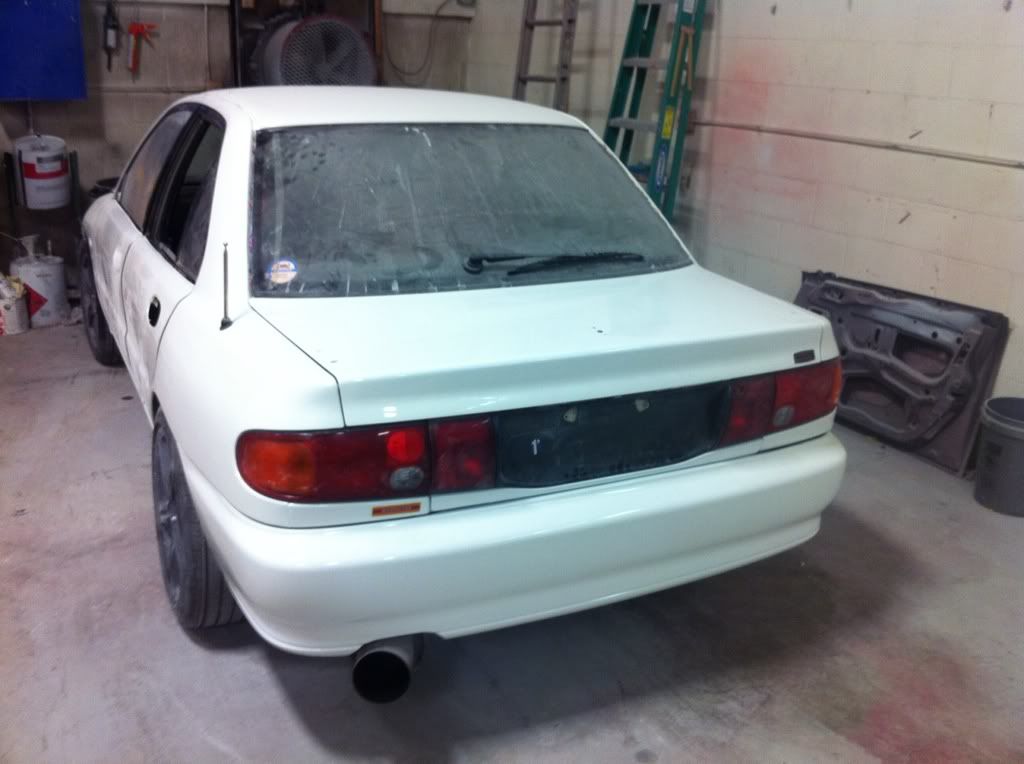

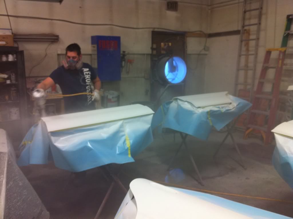

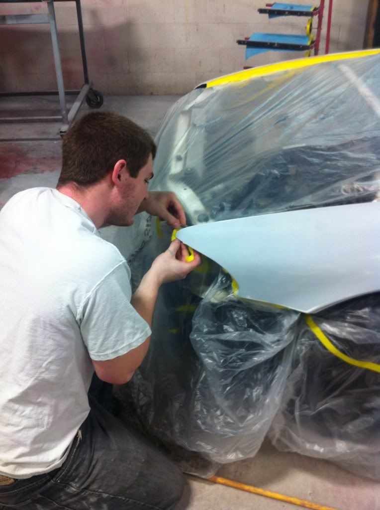

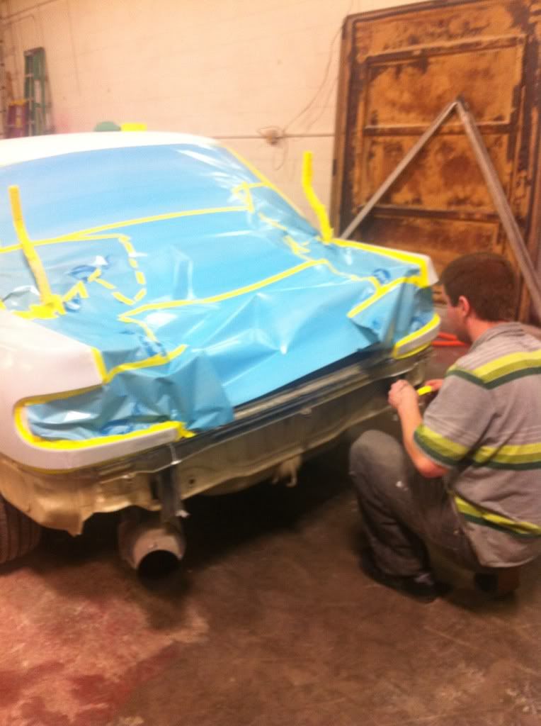

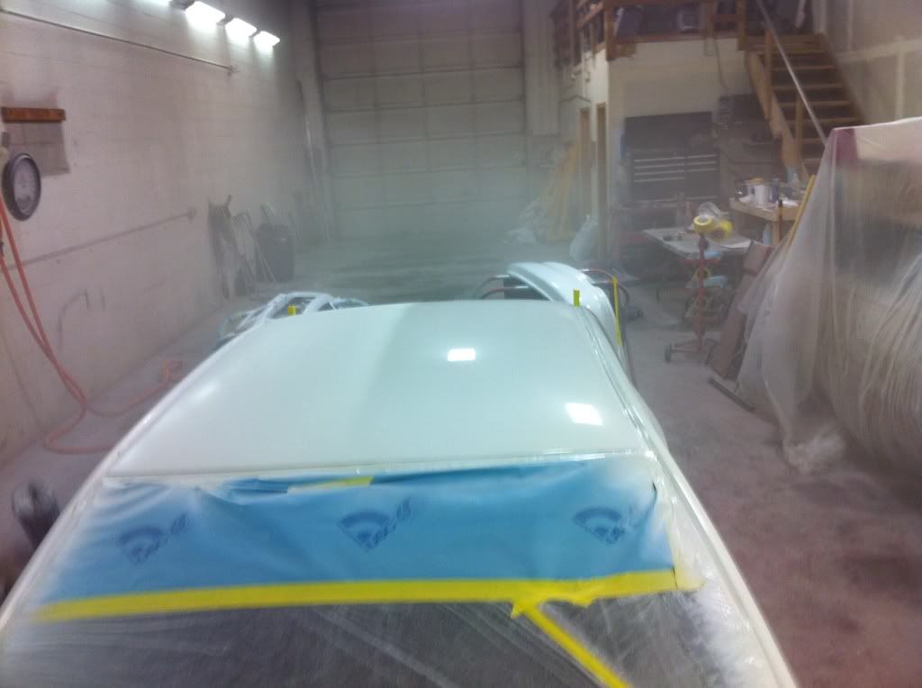

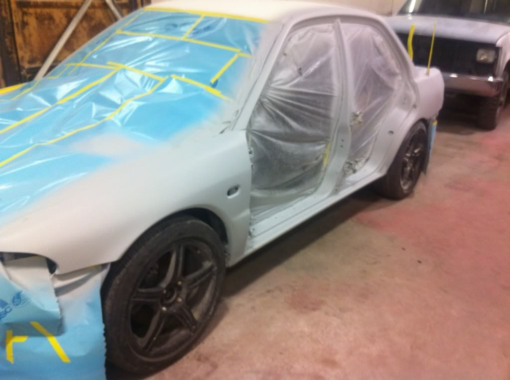

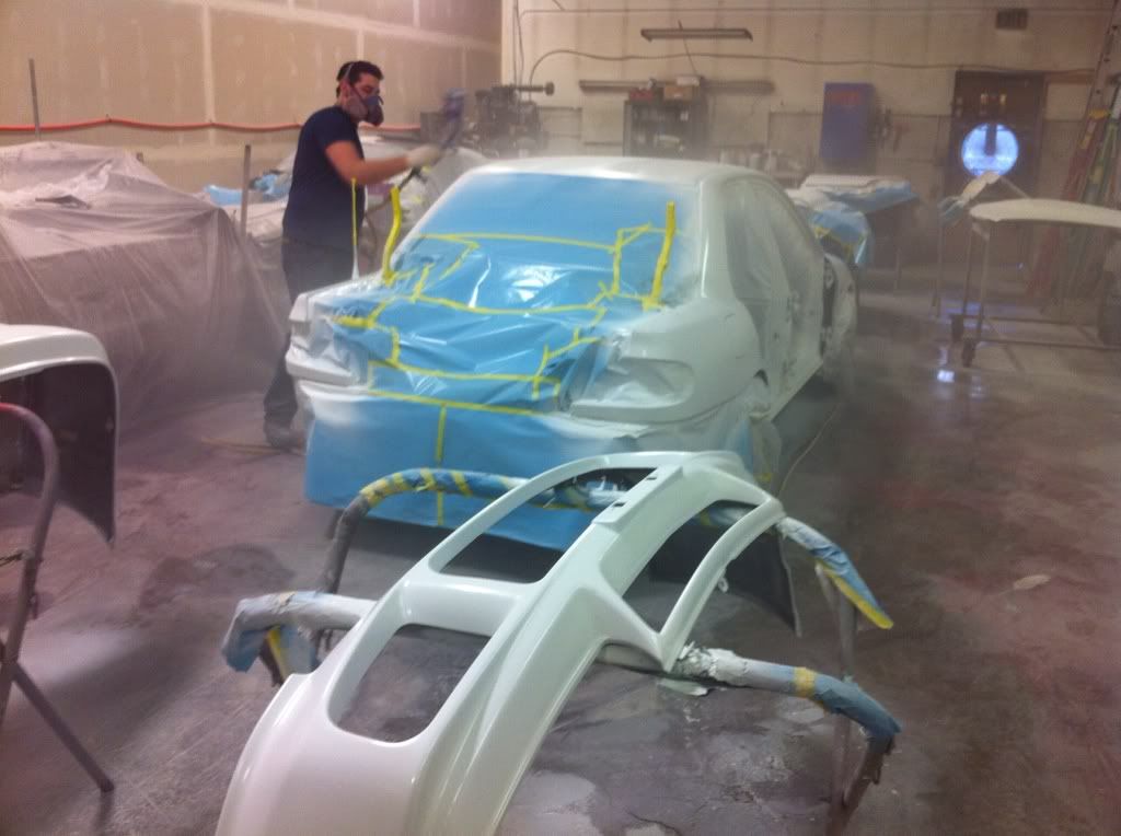

time for another up date been a bit cause well i've been working on the dang thing but now it's in paint...well the car and most of the bits are just some loose ends need to be finished but now come the reassembly job but i've had enuff 3am and other late night for a bit
here's some pics
ill get some pics as bits get on the car

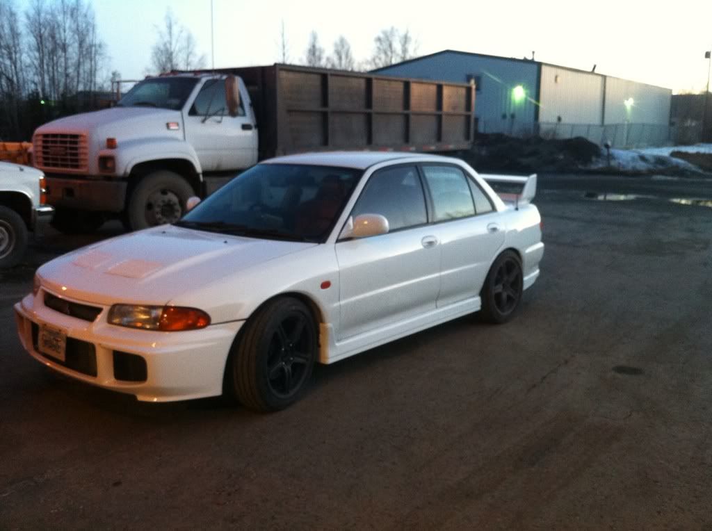

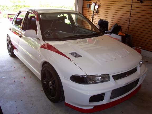

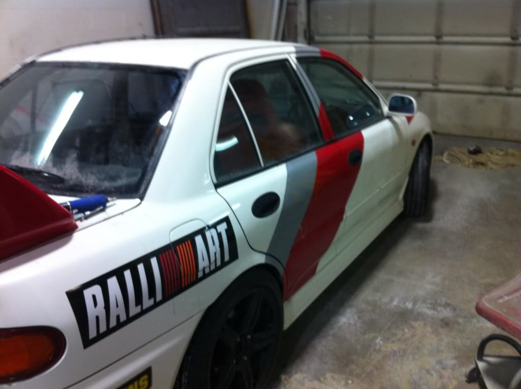

sitting at my house for the moment got some odds and ends to finish up but took it out for a bit last night i got a bunch of work stuff coming up so won't have much time for it for a while but for the most part it's together
Thats as it sits now need to find a new front lip the old one was to far gone and all the duct work underside as well for the brakes needs new weather stripping and center console and need to find some evo 3 seats and rails might stick some evo 10 seats in idk yet but the exedy clutch is slipping under boost so need to find a cheap decent twin or looking a spec clutch i have a act 2600 6 puck unsprung but dear god it wouldn't work on the street
did pick up a aeromotive 340 fuel pump that thing is impressive way better then the 255 of old and it would out flow my current bosch 044
best thing of all its awsome to have this thing back on the road the looks and stares and reactions are great and to say i got a real evo 3 from japan is even better and that well all the hard work was done by myself and had some good freinds to help along the way next part of this thread will be the mechinical side of things wich is about time for me i hate sanding now i wanna get back to what i know how to do..LOL

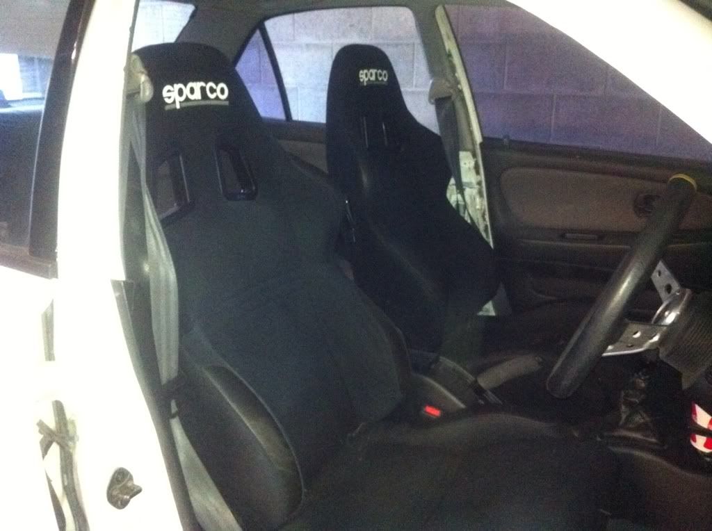

the mismatch front seats are out now inplace of some temp sparcos for the moment

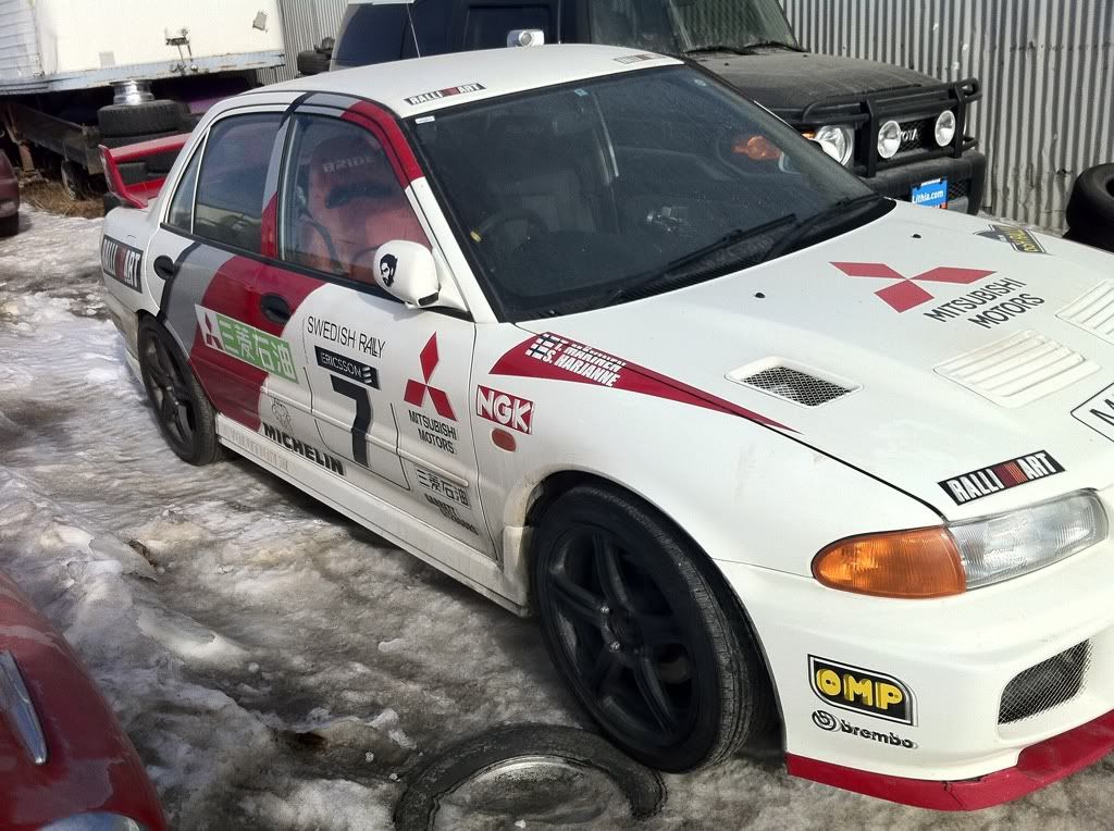

Not much new to report at this point just Drivin back and forth to work it's cold out been below frezing but no snow yet so that's good but once the snow is out ill get the standard sideways in snow pictures

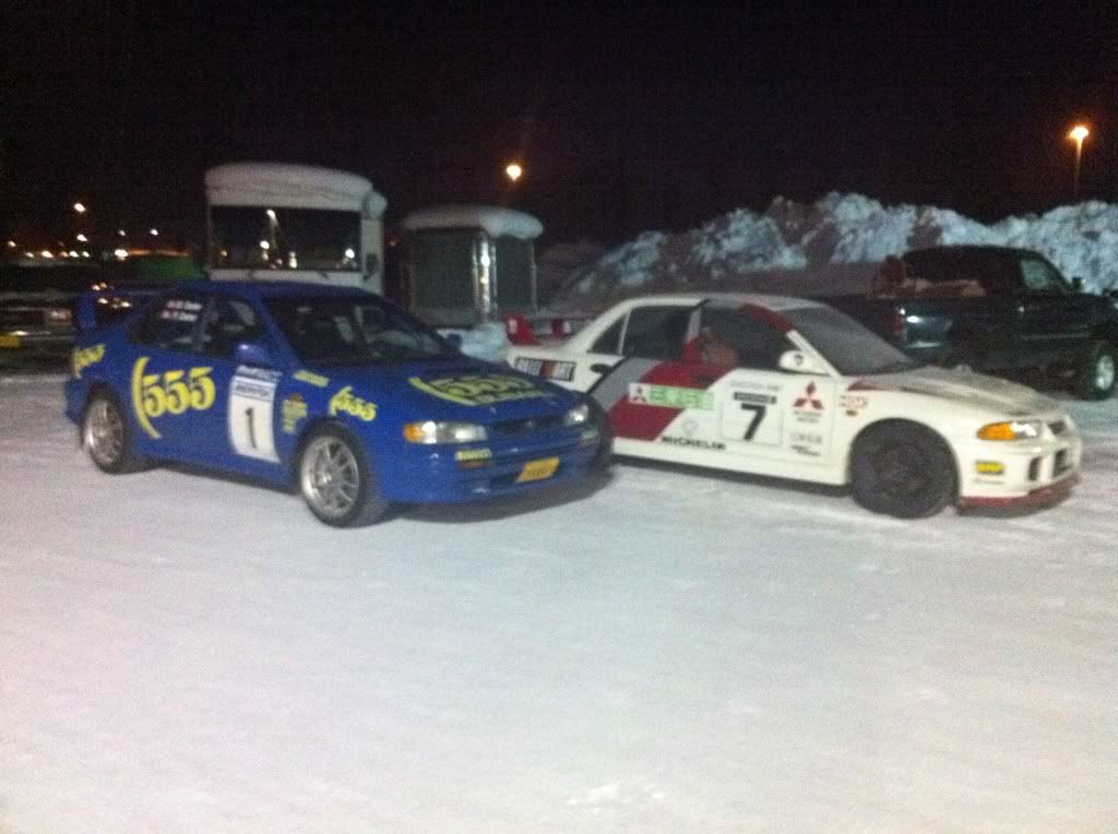

Been a bit since a update the evo been kinda hiding in the garage since i got a forester for daily use and put suspension and wheels.......well any way took it out ice racing the other day we had hot rod magazine drove up from California so i decided to drag it out mind you this is only at 10psi of boost but enjoy the video only one i got done and uploaded so far i'll get some pictures also

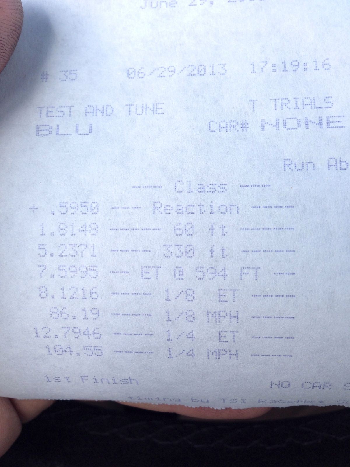

i think next would be to see what it'll run in the 1/4 as it is right now
Awe, you got rid of the rally livery!
Sponsor stickers, sure... but :(
at some point that will probably come back on the car but for now i like the plain stealth mode if there is one for this car..LOL
