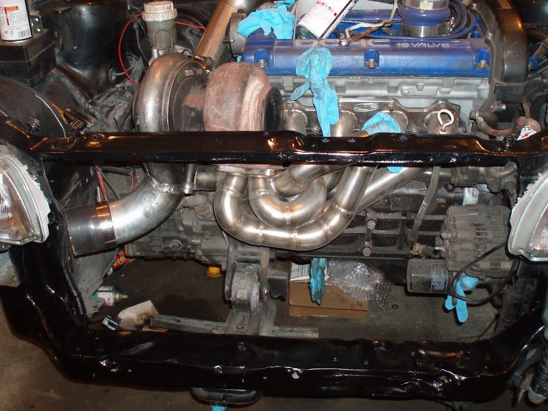

We also managed to do some cutting into the front of the car, to make way for the intercooler to mount first, and then to do a bit of measuring with regards to radiators and clearances. First a bit of cutting...
And then test fitting.
As you can see, clearances are at a minimum.
I'd love to have the fans on the backside as pullers but it's not possible. We need them on the front for clearances for the vertical front braces that we're going to make to try and strengthen the front end a little. So pushers they have to be. With a 3" exhaust going down just in front of the exhaust manifold, it gives us a little room to play with the radiator, but not much. At the moment the radiator is 1.25" thick and 24" long. We could just about manage a 1.75" thick, 26" long, 12.5" high radiator but anything more than that doesn't give us enough room. If the intercoooler moved forward (like some might think of doing) then too much would have to be cut out of the front bumper. Going to have to look for custom options for the radiator in time, but I'll see how this one goes for now.

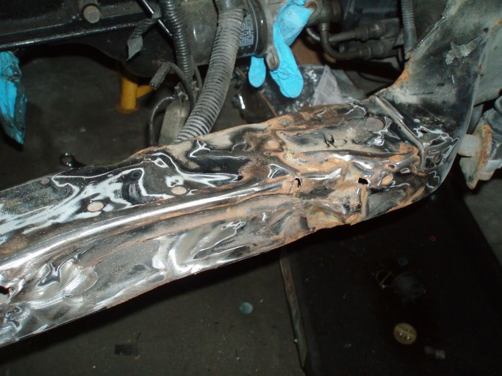

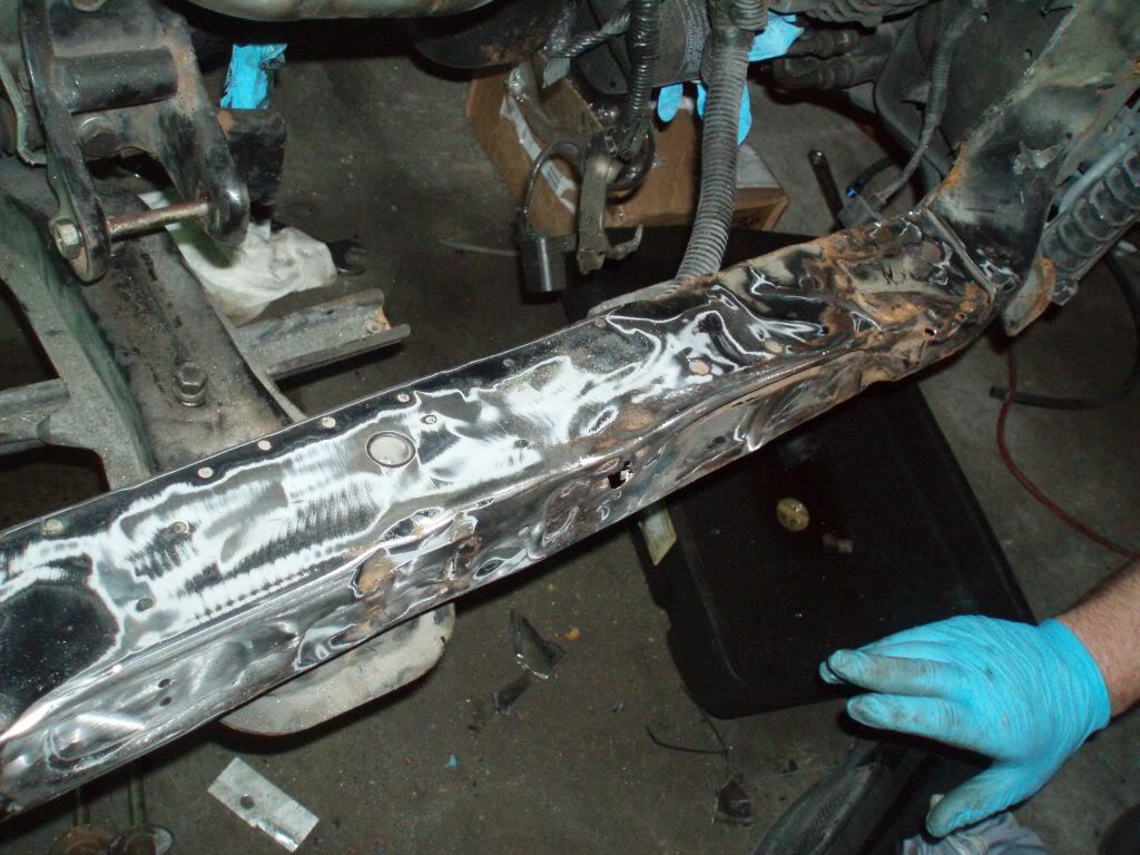

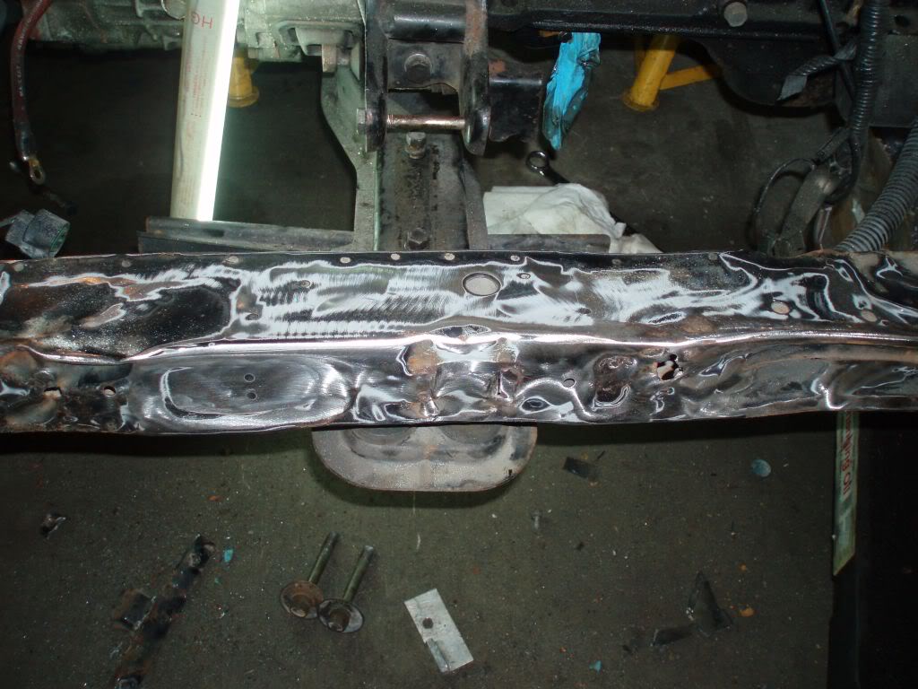

The front crossmember has also taken an impressive hit too at some point! Will take pics later but we are thinking of 3 options with it (going from cheapest up)
1. Leave it as it is.
2. Weld a plate over the front and top of the crossmember.
3. Get a whole new crossmember made and welded in.
Will have to think about that one as it's even more expense.

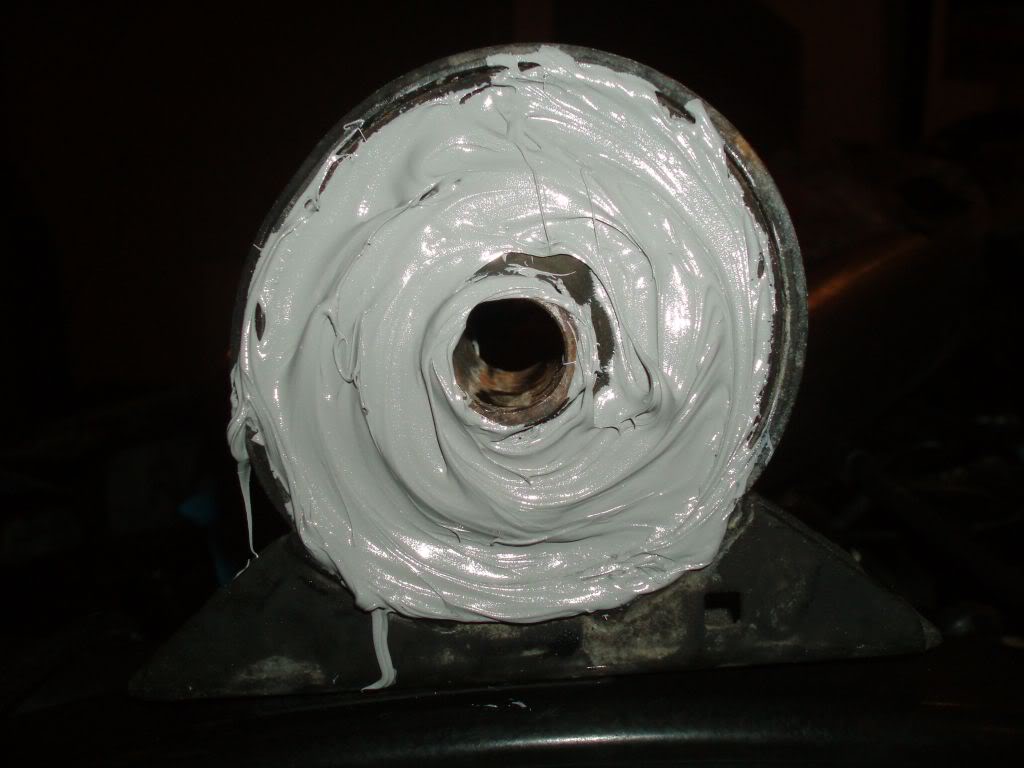

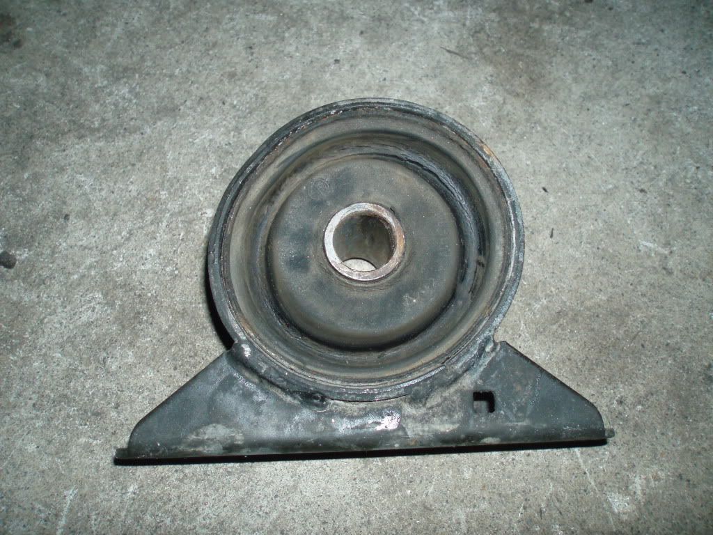

Ghetto-modified the front motor mount too. My recipe for success was:
Take one front motor mount (well used)
And take one tube of polyurethane "Pro Caulking"
Combine the 2 ingredients until all rubber has been covered and gaps filled with caulking. Leave for 2 days or so and then reinsert stiffer motor mount. Job's a good 'un.
Also took another look at the front crossmember of mine and ground some of the rust off it. It's in a hell of a condition to be honest. God knows what happened to this car but it took a heck of a hit right on the front. Going to try and get another crossmember cut out of another Evo and welded into this one to add a bit more front end strength and stability.

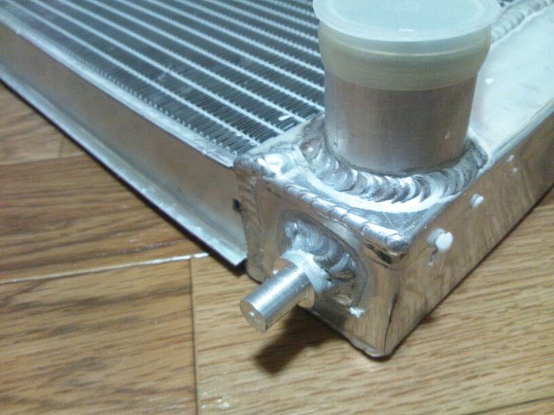

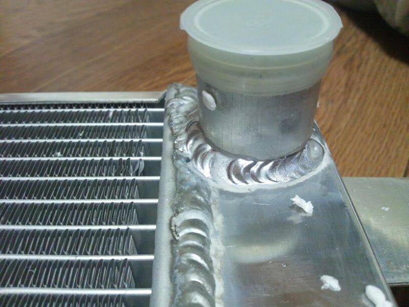

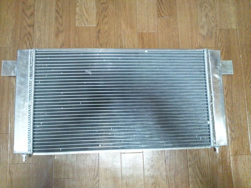

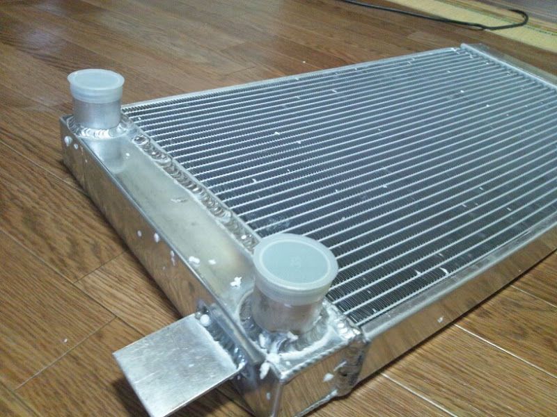

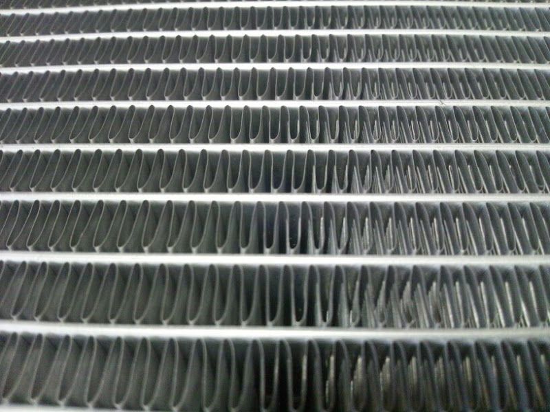

OK, a few little updates. Custom radiator was ordered yesterday night at 10pm from a company in Hong Kong (or maybe China). Found the company on Ebay and saw they made custom radiators. Send them a template and they seemed very knowledgeable and accommodating. Even better was when them emailed me at lunchtime today to say it was finished and would be shipped out later today! In the end I got a radiator with core dimensions 318x480x40mm and overall size should 318x640-660x40mm. All aluminium and dual pass. Not bad for $280 including express shipping. Will only know for sure the quality when I see it and then install it, but they sent me a picture and it looks nice.
Once that comes I'll be able to start fabricating things up at the front end. Also checked the radiator fans today. I actually think my cheap Ebay fans along with this radiator and the things we're going to do have a good chance of cooling it. I also threw a thick Permacool 6" fan on the front of the oil cooler which will be permanently on to keep temps down. Don't worry - the cooler is thermostat-controlled so it's not like the oil will take longer to warm up. I am looking into the HKS oil thermostat though which opens at 75C instead of 100C; could very well help to keep temperatures right where I want them to be (at operating temps, but not much more) That little fan generates a small typhoon to be honest. Should do a great job on the oil cooler even though it's not a perfect mount.
Also fit up the new caulked engine mount, which seemed to be a fair bit stiffer and will hopefully help against engine rocking.
Didn't do much else but some more parts came in this week (although worryingly still no turbocharger; getting a little concerned now). The only thing really worth showing pics of is the Aerocatch hood latches. Looks a great bit of kit and am looking forward to throwing them on the car.
As for my front crossmember, I'm considering getting a 3mm steel support cut and welded onto the top and front to add a little support to it. Tried to source another one but it was in arguably worse condition than this one. Just need to source the steel for it.
And that's about it for now. Probably doing a bit more work on it tomorrow so hopefully another update later on this weekend.
Completely custom made to my specs, all-aluminium radiator made and delivered to me all within 7 days. $280.
Bargain! (Providing it doesn't leak/blow up, on first use, of course).

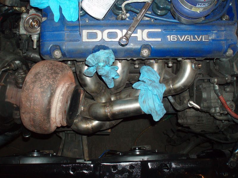

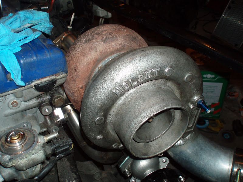

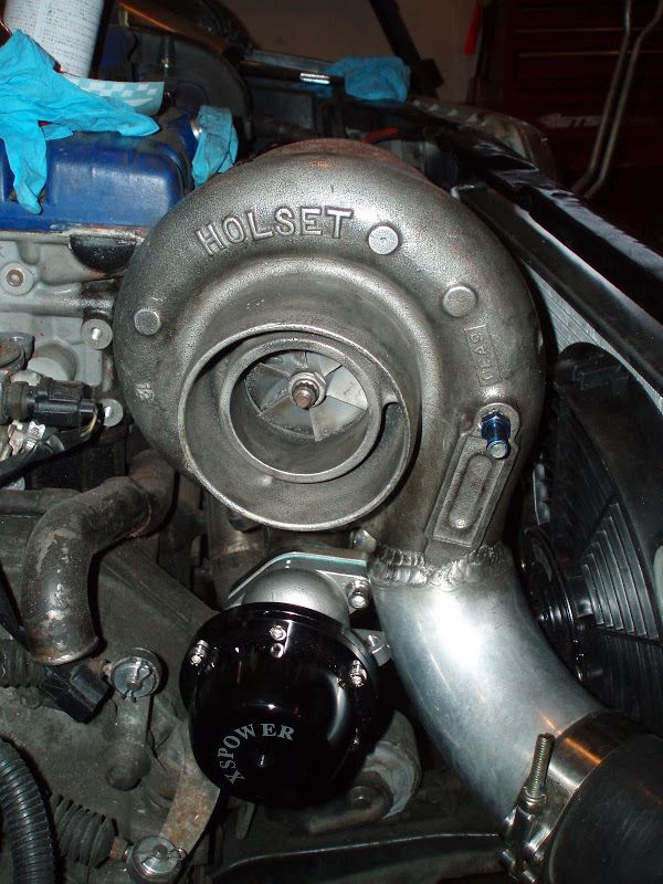

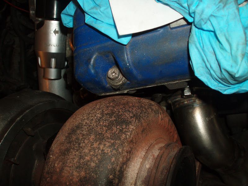

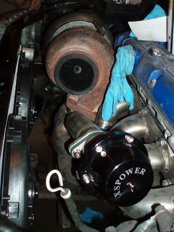

Good news - I got a HX40! Bad news, it's not mine. Many thanks to my buddy Chris though for lending me his for test fitting purposes until mine gets here. It's actually the 19cm turbine housing as opposed to my ordered 17cm, so it's a tiny bit bigger than mine, but should give me a good idea of it all. Pretty mixed news with everything to be honest
As it stands, the 19cm housing didn't fit onto the manifold. The compressor housing was hitting the head when it was about 1cm off hitting the manifold flange. Even if this 17cm housing was over 1cm smaller on the engine side, there's no way we'd get a turbo blanket in there too. When we spaced the manifold out with washers though it did fit just about though, so I'm contacting JM Fabriactions again to see if they'll sell me a straight 1/2" exhaust manifold flange with some longer studs. Road Race Engineering also sell the flanges, but only their mild steel one is in stock. I've seen a couple on Ebay too that I'm contacting the sellers about. It will make the front clearances between the downpipe and the radiator fans even closer, but it's what we're going to have to do.
The other minor potential issue with the Holset on there is... is the bonnet/hood gonna close?! I don't even want to think about that at the moment as it seems so far away, but I think I might have to cut into the bottom part of the driver's side grille on it for it to fit.
We made some cuts on the downpipe too to get it to fit but am waiting for the v-band to come in so we can actually get that fitted up closer to the turbo. The initial v-band setup the supplier sent me didn't have the male-female lips on the inner of the flanges so am not sure it would seal that well.
Now the more perceptive of you will have noticed that those are, yes, XS Power 38mm wastegates on there, and I know you're going to scream about how wrong that is. But you guys try what I'm doing with the budget I have available! So here's the deal with them; I knew I would be taking a bit of a gamble but I don't have any internal organs left to sell for genuine parts, and trying to sell off the girlfriend's daughter so early into a relationship seemed like it might cause a rift between us. So I got these ones. Has the gamble paid off? Well when changing out the springs for the 1bar springs I did look at the diaphragms and they looked like they'd been pushed down a little in the wrong way, and might not make a perfect seal. But, I have contacted them about it, and 2 genuine Tial diaphragms go right into this and would cost only $100, so I'd still be saving money going this way :)
But with those wastegates on we were able to plan out wastegate exits. Basically they are going to go right into the front of the wheel well on either side, well clear of the wheel (I don't plan to be at full boost on full steering lock anyway; if I am I've got more pressing issues to think about). They are sized up and cut, and will be welded today so they can be fitted.
