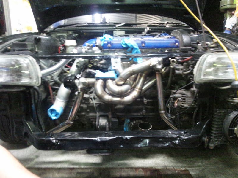

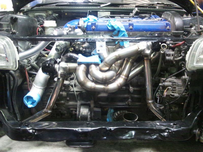

Very little done on the car today except picked up the wastegate dump pipes which have been cut and welded and should work pretty well. I'm gonna have to heatwrap the oil cooler lines as a precaution, but other than that I should be good to go.

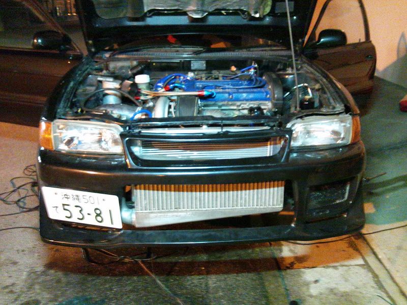

Also test-fitted the bumper today and it looks like I've got plenty of room for the intercooler. Now how the bumper is going to attach to the car because the front crash beam is not going back on is a whole different matter!
Welding hopefully tomorrow of radiator brackets, front braces and a few seams at the front.

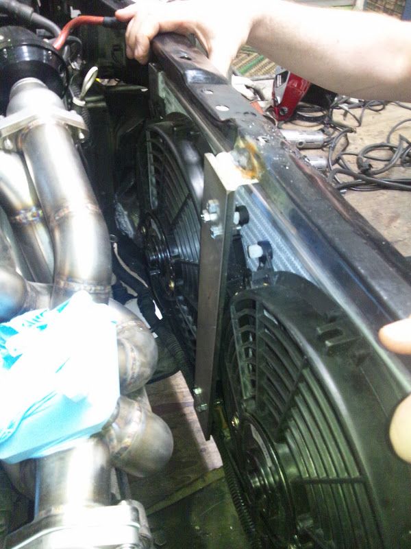

Front end starting to shape up nicely. Got a front centre brace welded in place tonight to strengthen everything up at the front. Should give more support, and fits perfectly just behind the radiator fans.

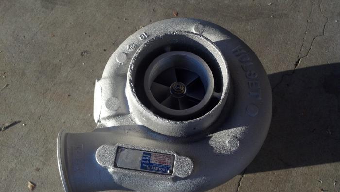

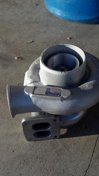

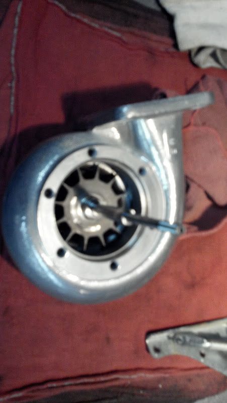

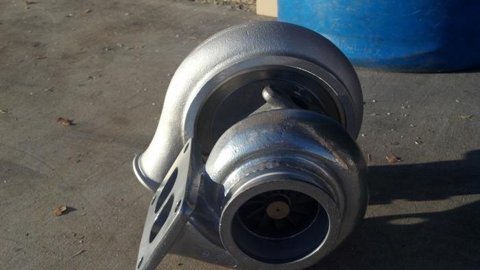

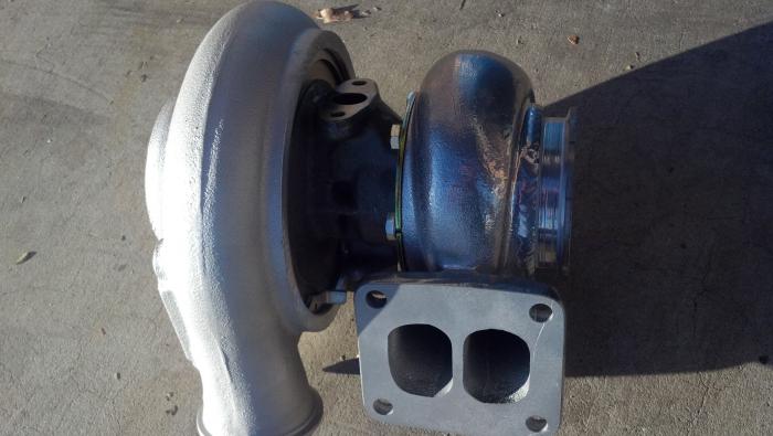

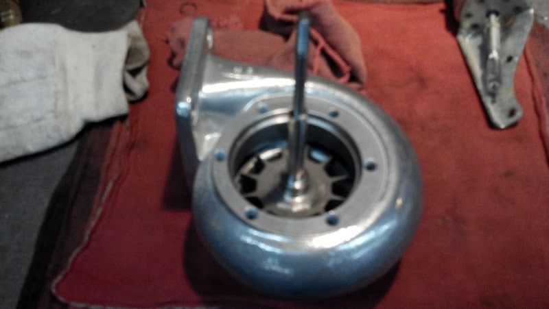

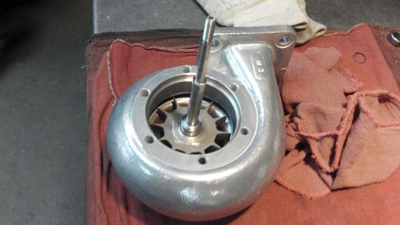

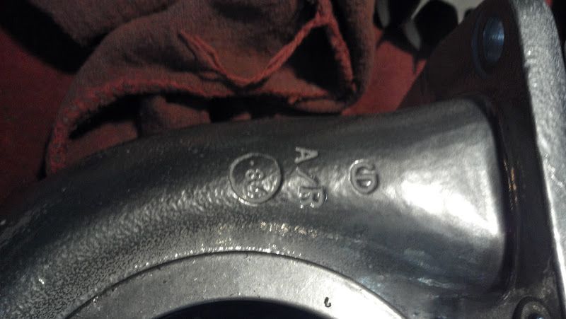

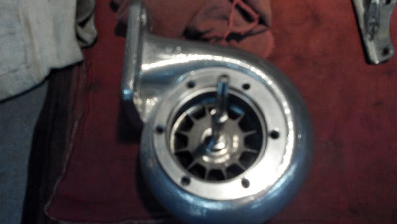

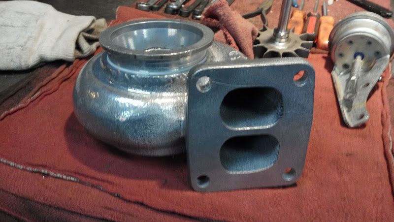

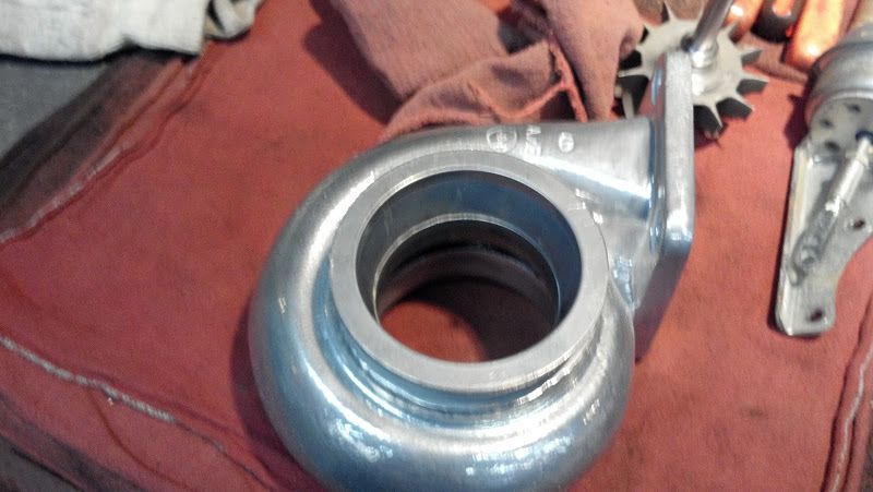

The replacement turbo has been ordered and will be getting put together from Tuesday or Wednesday. I'm going for the even more powerful 6-blade HX40 with a .84 a/r, twin-scroll T-4 housing. Round about equivalent to the 16cm Holset housing, it should give me at least 1.4bar by 3,900-4,000rpm. While my current setup will be run it it efficiently the 6-blade variant gives me space to grow in the future if I decide I wanna make even more power.

conversions are always going to be off based on how turbine scroll is constructed and how each turbine wheel has different flow tech involved. Best way IMO is to compare them side by side and get a good guess going on. If you compare the holset sized housings in "their" rating you can see some vast differences.
the .84 garret is almost physically the same size in diameter, and inlet size as a 16cm housing. So our best guess is the .84 is closest. Only time will tell I guess.

The post above me kinda already says this, but this conversion is COMPLETELY useless. These are for the mitsuibishi designed volutes. You can't even use these for factory evo 8-10 turbine housings because they are a newer, different design volute than the older mitsubishi turbine housings. Anyways, point I'm trying to make is the two are completely unrelated, any size inlet can be used to make any ratio A/R, it all just depends on the volute design. Holset did not copy mitsubishi when making the HX series turbine housings, so there is almost a 0% chance this conversion table would work. Theres also the possibility that it would be accurate for one size (say 10 cm2 = 0.73 A/R) but not the same for any other size.

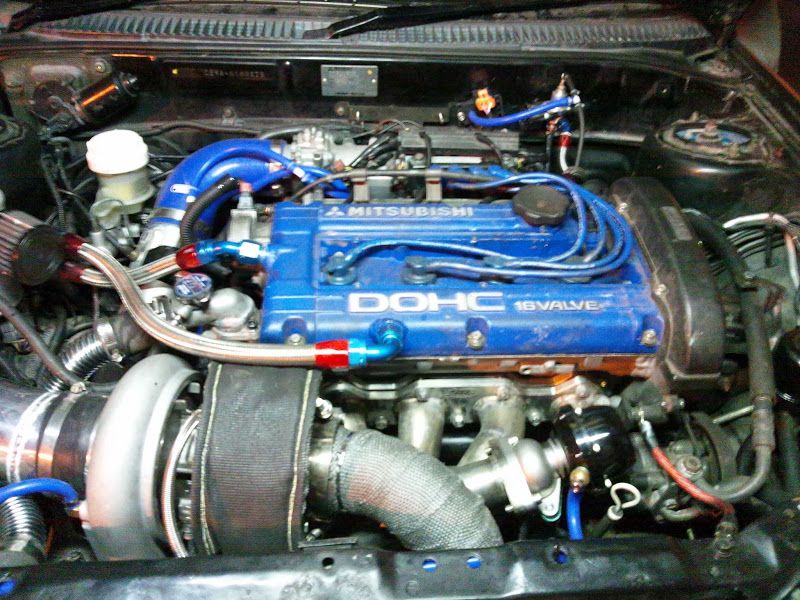

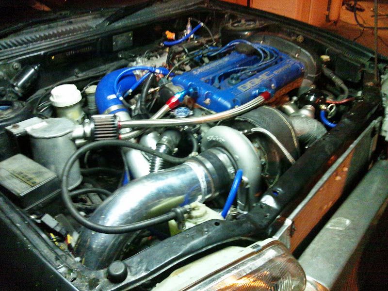

It's alive! Only just though, and what a mission it was to get it there. What I thought would be just an hour today ended up being 12 hours of constant work without any breaks on it. The battery got connected up relatively easily and without major incident, and that was where the simplicity ended.
When that was wired in I was able to connect the battery and see if everything did. My boost controller, fan controller and wideband did, but they stayed on when I pulled the key out! Realised I'd tapped into the wrong wire under the dash so had to redo that, and then a few other bits of wiring.
Got the oil line re-cut and welded and got that fitted up after much messing about. Problem is that the drain line comes dangerously close to the manifold. While it's not gonna be a big issue at idle or doddering around, I probably wouldn't want to do any full power runs in it when exhaust temps inside the exhaust manifold are 1600F or so. The flanges are aluminium too which have melting points of 1200F. They should be ok but I might need to extend one of the lines so I've very little rubber line close to the manifold.
Got that fitted up though and the car filled with oil. Did the same with coolant, after dealing with a coolant leak and realising the radiator is sealed with no drain (my bad... forgot to request that!). And then it came time to test it again. I wanted to test the fuelling to make sure there weren't any leaks after changing to the new FPR. Activated the fuel pump and the pressure gauge went up to 46psi monentarily, and then dropped to 10psi and stayed there. Strange. Tried again and only 10psi again. Checked voltage to the pump which was fine and the pump was definitely working. Changed back to stock fuel pressure regulator and no change. Tried firing up the car and it would sometimes try to cough or start for a split second but would then die again. After an hour or so I pulled the Walbro out as I'd assumed it was bad. Had a look and it turns out when I put in the Walbro in I hadn't transferred over the plastic spacer that goes in before the o-ring on top of the pump itself. We replaced the stock Evo III one with a much better Evo VIII 3-level o-ring and put it all back in.
Tested the fuel pump again and had fuel spurting all over from a couple of leaks near the FPR. Took a while and new hose but sorted those out too. And then I turned the key finally and it started up.
For the first time in almost 4 months it was idling. It has thrown up a CEL which I need to work on diagnosing, but will look at that tomorrow after work. I think it's something to do with the speed density setup I'm trying to get working. We also have an exhaust leak at the turbo-downpipe v-band, and we broke an older v-band clamp further down in the exhaust, but those can be sorted out quickly enough.

Me too. The poor idle was caused mainly by the v-bands not being tightened properly. Once we'd tightened them down it sounded a lot better and meaner (see "less like a tractor"!). Unfortunately we did break one old v-band so now have a huge exhaust leak once again! Someone did comment that the turbo vibrated a little when it was running rough, and that it might not be good for the manifold. Do you guys think I should try to make some turbo-engine bracket up?
Also got an issue with the fan controller. Two of the buttons didn't seem to be working (I know, serves me right for buying used), and it wasn't recording the temp right. On the plus side it was saying the coolant was way hotter than it was, and so the fans were kicking in early. Better than not at all!
