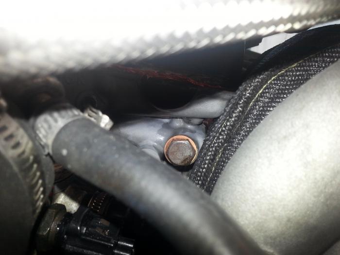

Taken another look and it could be my half-moon that's leaking. I think I feel a little moisture under there, even after RTV-ing the hell out of the top gasket. Take a look at the pic below (which completely misses the half-moon - sorry for that.
At first you might think it's the oil feed line from the head I've got blocked with a bolt and steel washer, but the oil seems to start above there, and I don't think would come out of that bolt hole at such high pressure that it would spurt upwards. Does my diagnosis sound fairly solid?

Think I should just replace straight away, or try removing it and re-RTV-ing it first?

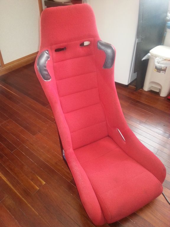

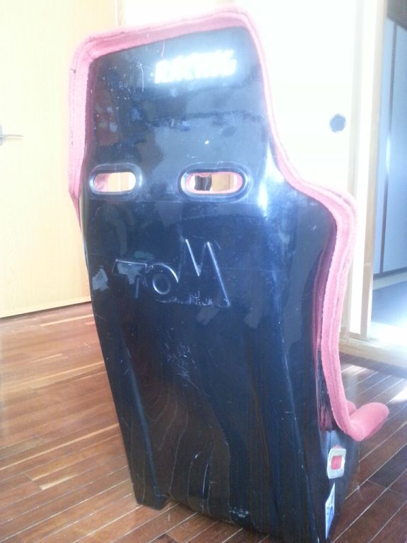

Expensive Recaro racing seat about to be sold. Cheap "Tom" (Tom's knock-off) but lightweight full bucket seat bought for Y3,000 and ready to be installed. I just got to figure out how to mount it to the seat rails I've got. Might need some help with that - anyone that knows me knows that giving me a drill to play with inside a car is a bad, bad idea.
And for anyone that's going to claim that unless the seat is Recaro/Cobra/Sparco/Bride then it will disintegrate in a collision, believe me, the seat breaking if I'm in an accident is one of the last things I'm worried about and that will kill me!
