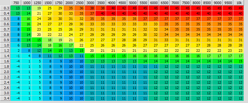

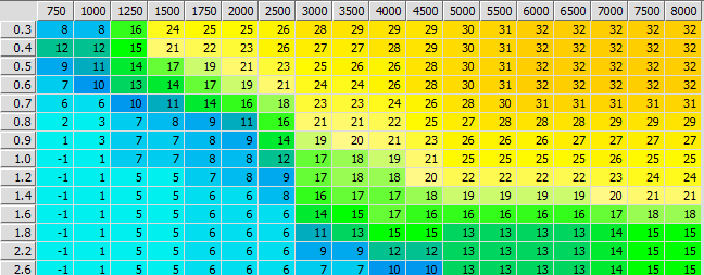

And I've just been reading the data from a guy in the States who's got a fairly similar setup as me, and having good success. He's running a HX-40 Pro on a built engine with the usual nice trimmings but stock intake manifold, but is only using 91 octane petrol. And he's doing a knock-free run at 30psi and making close to 600bhp according to his ECMLink figures (not good for a comparison I know, but still showing good power). Another good figure would be saying his 70-90mph times are about 1.15s and the turbo peaking at 65lbs/min of airflow.
What is interesting for me is looking at his timing maps, and seeing how much timing he's dropped compared to my map currently.
His timing map:
My timing map:
Now I know there are lots of factors involved, but it does look like I could still drop timing by a degree or 2 at the higher end of the rpm scale and pick up some more boost (running around 1.6-1.65 bar at the moment, or was the last time the car was fit for a 1/4 mile run). And knowing that the turbo is only starting to come alive, I'm wondering if sacrificing timing in favour of boost might net me some big gains in power.

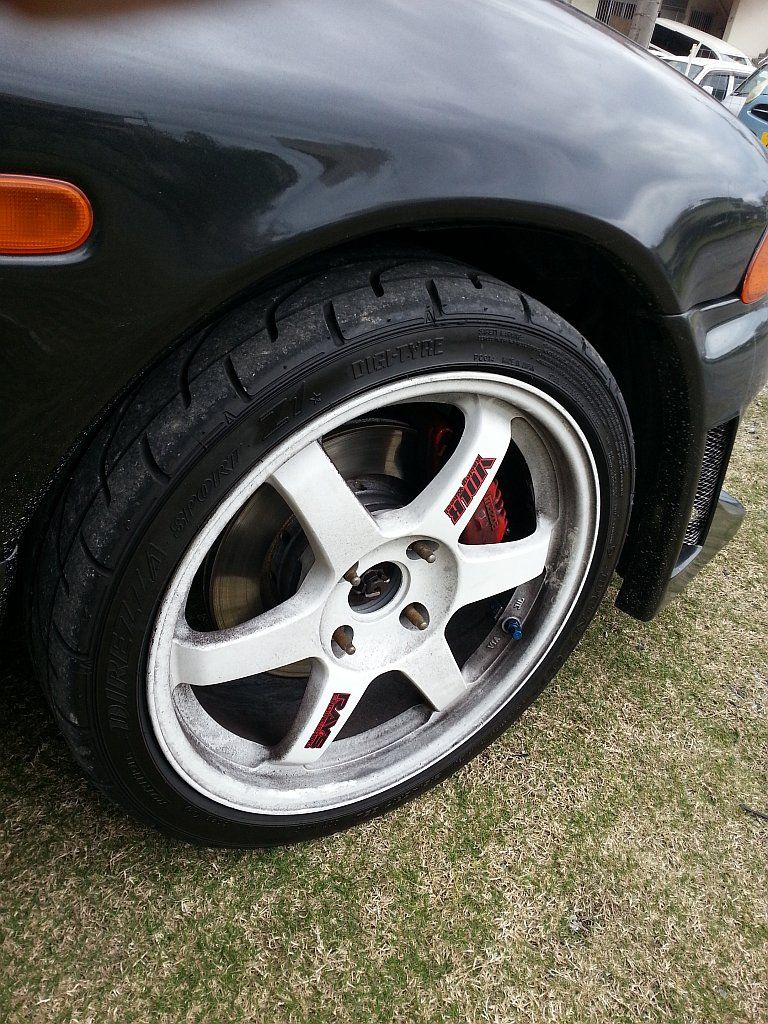

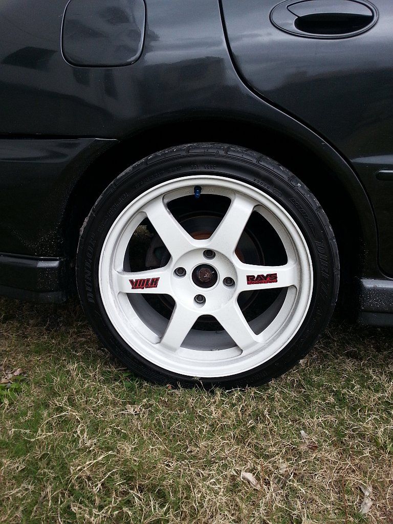

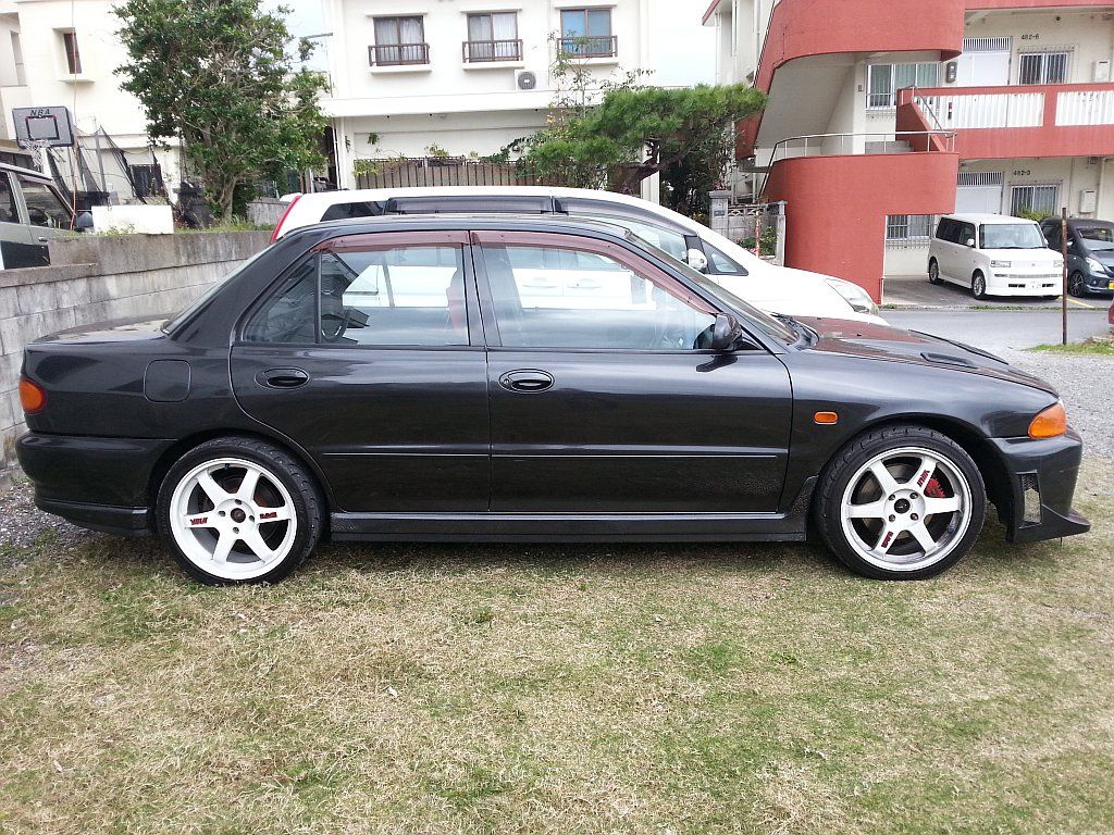

My Christmas present for the car was a set of new shoes, in the form of some TE37 rims and Star Spec rubber. Just waiting for the new original decals to come through and they'll be put on too.
Those rims look sexy on your EVO, good choice!! Oh, btw, I consistently find myself in the same dilemma of whether to buy something of necessity or purchase something frivolous. Guess which one normally wins :hmm: Great build!
I second the sentiment about the wheels, I'm not a huge fan of white but those look the business:thumb: Now for another 1.5" moar low and you'll be killin' it:sneaky:

Any lower and the front bumper would be scraping on small kerbsides going in and out of parking. I love the HKS Kansai bumper to death but the front lip means I can't drop the car nearly as much as I would do otherwise.
go taller tires next time and drop her a bit more. but car is looking great Dave!

And the rims are almost finished with the Rays Time Attack decals on them. I know alignment of the stickers may not be 100% perfect but neither is the rest of the car! It certainly transforms the look, and I think in a good way.
And yes, the rims need a clean but I have to wait for a week for the adhesive to set really good before that.

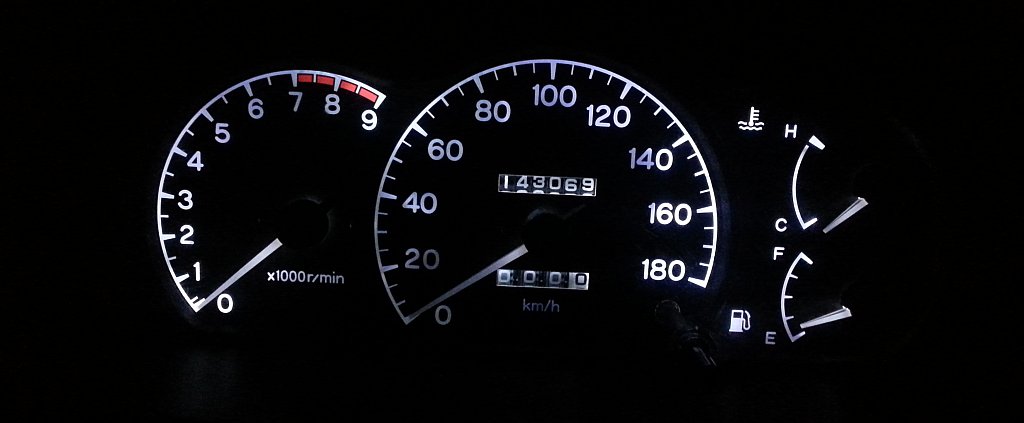

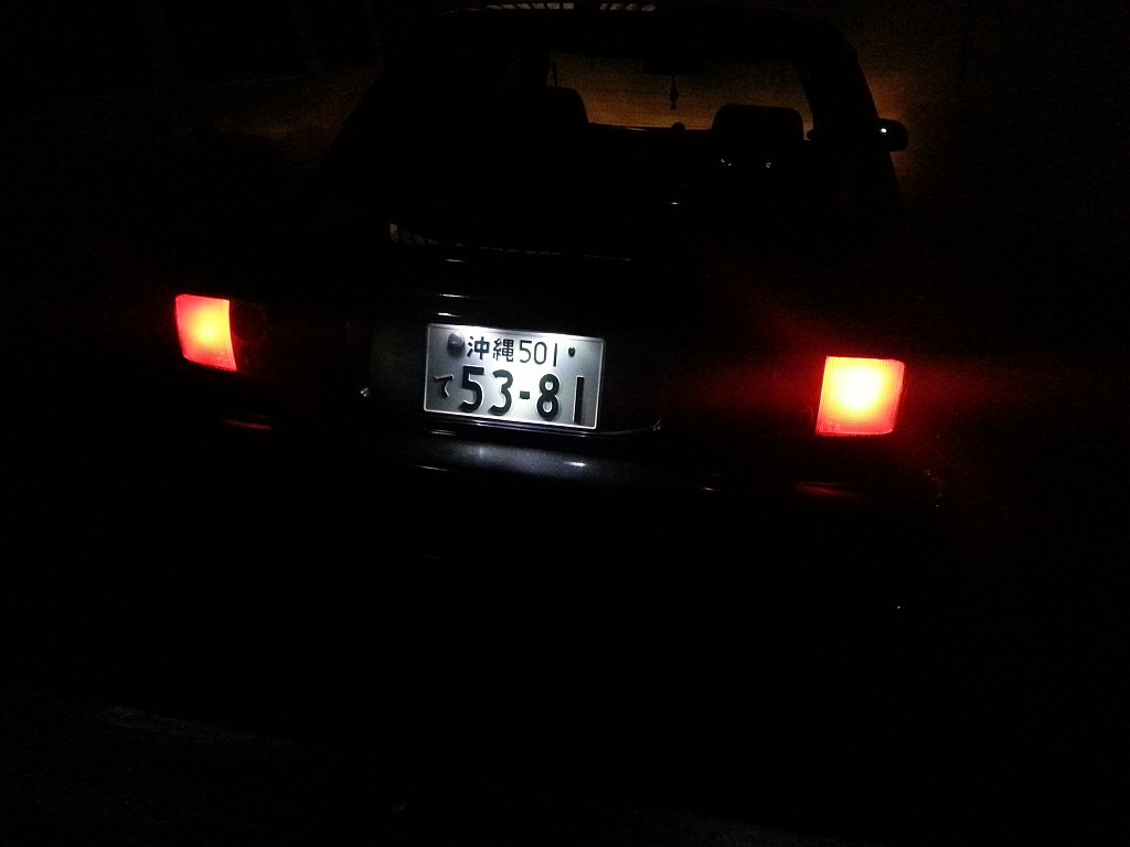

Well my LEDs came in today so I pulled the cluster out and fitted them. Have to say I'm pretty pleased. There are a couple of darker spots, but you pretty much always are gonna get them unless you customize a whole ring of LEDs around the cluster.
Also did the licence plate too. Am thinking about maybe looking at getting LED for the brake light or reverse light, or even side lights at the front, but am not sure if the directional nature of LEDs will mean it's not so good for them.

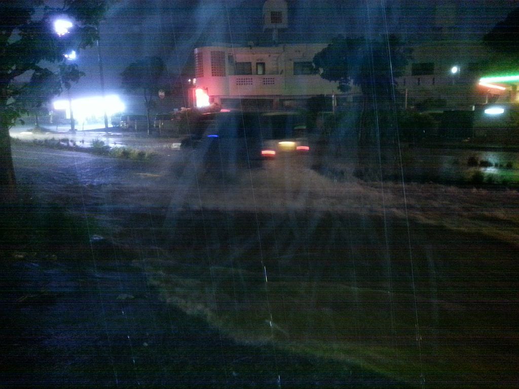

Not so much a big update as an observation. I found out the car doesn't like being driven through about 1km of 6-8" high water coming down the road like a river! I know, it's hardly a revelation, but was certainly an interesting experience. Driving home from work and the rain was torrential, even in a very wet rainy season we're in now. As I was driving up this hill though the water was just getting deeper and the car in front annoyingly was getting slower. Bizarre as everyone knows the best way to make it through standing water is to floor it and not go slower.
Then the wipers started to slow a little and the lights dim a tad and I thought... well, not good things. Managed to get off the road and into a parking area (pretty lucky there was an opening as my windshield was fogged up and the lights not too bright so it was an educated guess that I wasn't going to hit a 6" high kerb). Just as I parked up the battery light came on. Turned all electrics off apart from the engine and it recovered fine after a few seconds of idling so it must have just caused a short at the alternator or in the battery line running under the car.
Saw a Prius make it up the hill and thought, "Awww, hell no!". Got to the end of the taxi parking lot and damn near launched it out of there past the river and onto marginally drier land! Car was fine after that so just needs drying out a little I think. Don't want to do that again any time soon though.

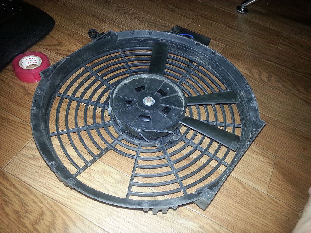

Noticed my temps about 3-4 degrees higher than normal a couple of days ago. Not a huge amount, especially with temperatures soaring now summer has hit, but enough to make me have a look into the engine bay. And what do I find but this!
The gaps in the shroud I cut open to inspect, but all bar 3 blades have been broken off at the centre. Now I refuse to believe that those little Chinese children working 48 hour factory shifts would make something shoddy, but god knows what has caused it. There are no marks on the radiator from where it could have hit. There are no marks on the inside of the fan shroud from where there could have been contact there. It just seems like the fan decided summer was coming and it was time to pack in.
I'm driveable for the moment with temps just a little higher, but need to get another fan on order ASAP.
Dave, I hadn't been on this site in 6 months. I was reading through page 5 and 6, catching up. I thought to myself, nice, Dave's car is doing well for a change! And then your fan splodes and your alternator shorts. You have so much luck with that car man, LOL. Glad to see you are updating your build thread going forward though. That car deserves it. :thumb:
Thanks man. Thread needs to be retitled: soldave's 1001 ways his early Evo tries to kill itself!
Not really. About 18 months old, and even Chinese-made Ebay fans I've used in the past have lasted longer than that.
Reckon that water could definitely have been a factor though, looking back.
well not sure what brand that one was but I have been running Spal fans for years and never seen that happen, i had a pair of spal fans that were on a car I bought and they lasted for over 10 years between me the the previous owner. the bearings went on one and the other just quit working the motor went on it

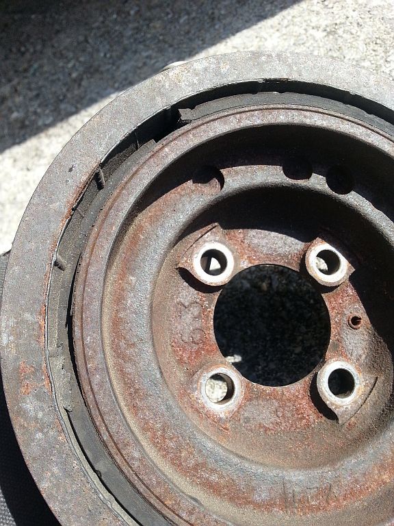

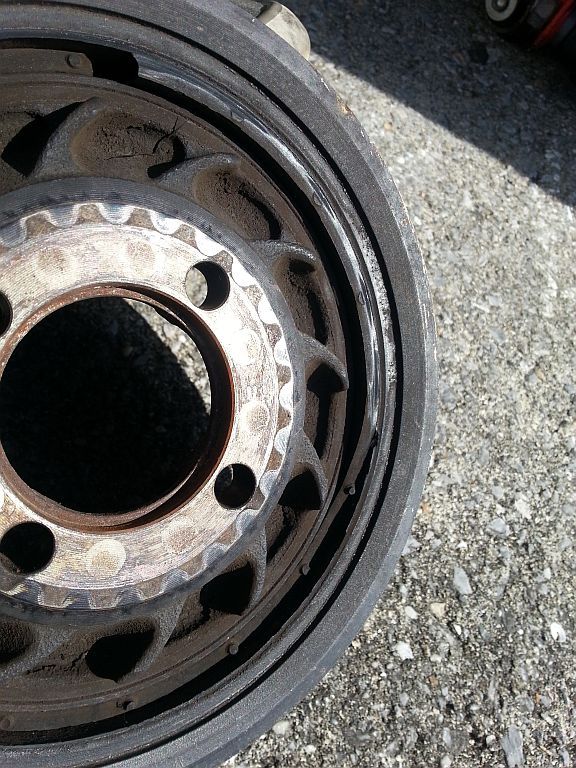

Well it never rains but it pours with this car. Got a replacement fan on order but am ok driving around with one so far. However, I've not been doing much driving at all as about 10 days ago when driving I was hearing a squeaking noise at a certain rpm (around 1750) near the timing belt area. Got home and inspected it and the 4-5 year old OEM crank pulley wasn't looking in the best of shape. Seems like the Okinawan elements were claiming another victim. Decided that with the engine internals an upgrade wouldn't go amiss, so got a Fluidampr on order.
It arrived today and I've just come up from fitting it. Glad I've not been driving around while it's been squeaking, after taking a look at it when I pulled it off.
http://i673.photobucket.com/albums/vv99/soldave/2013-06-29161719_zpsf467bc39.jpg[img]
Threw on the Fluidampr and things seem a lot smoother with the car on idle now. Might just be a placebo effect and me trying to think there's a difference, but I'm sure it's a lot better than the old stock one.
