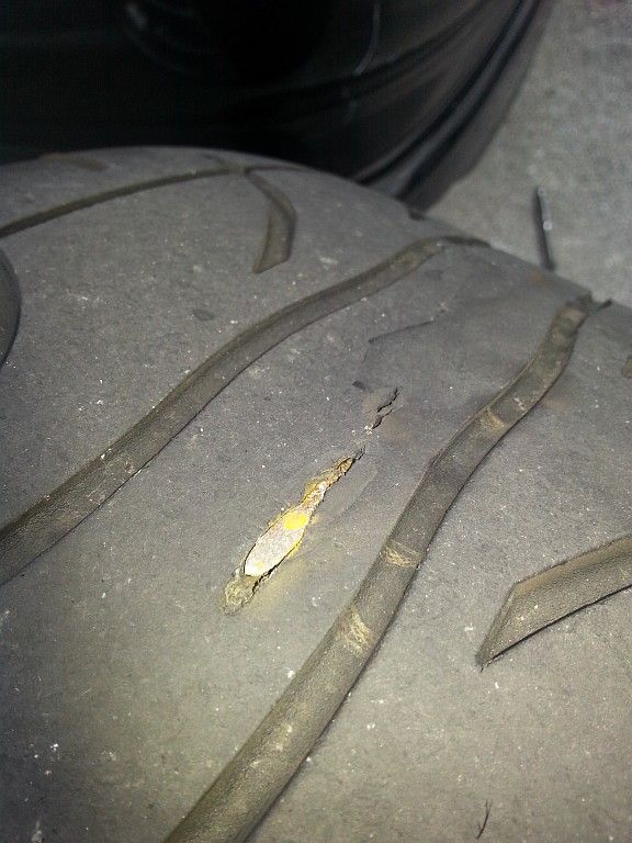

Just today when I thought my brakes, coolant leak, oil leak and everything else going wrong with my car coming to an end, I came to bleed the last brake caliper and saw this:
God knows what it is but it's deep and big. So that's a pair of Star Specs I'm gonna have to get (wanna get fresh both sides) and they're in closeout at the moment so am gonna have to be quick too. Just what I need before Christmas :(
