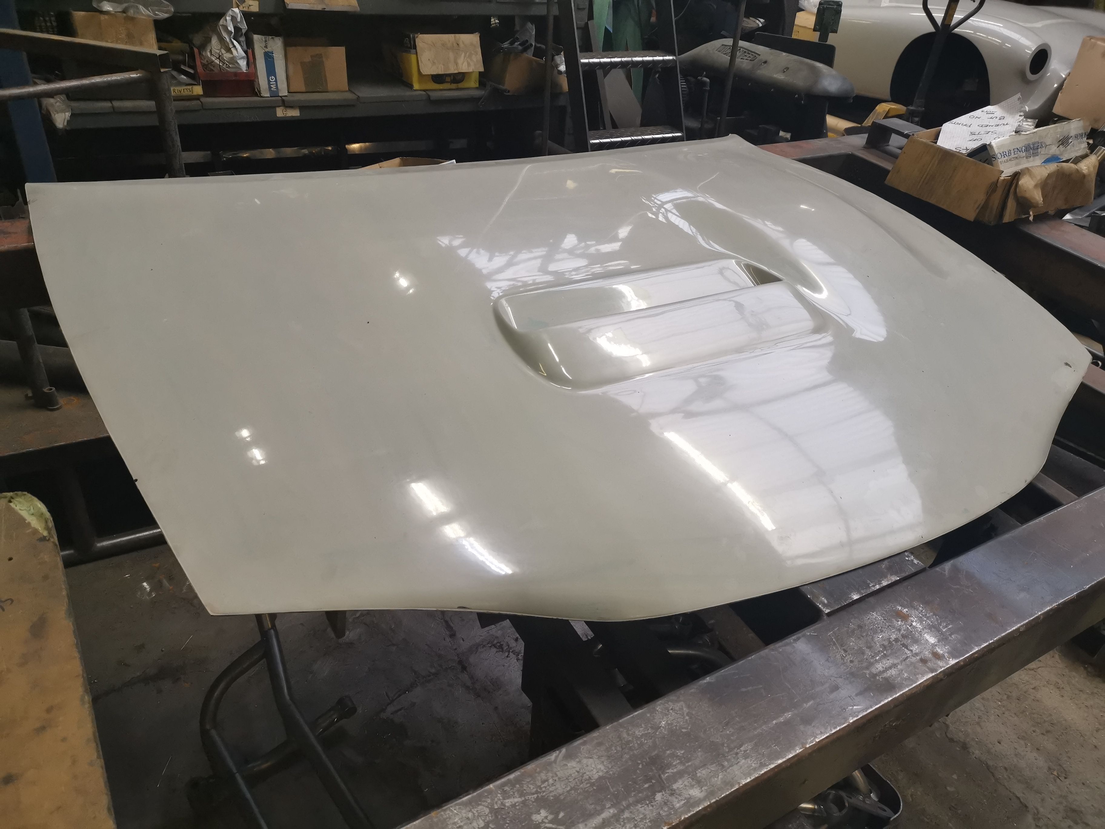

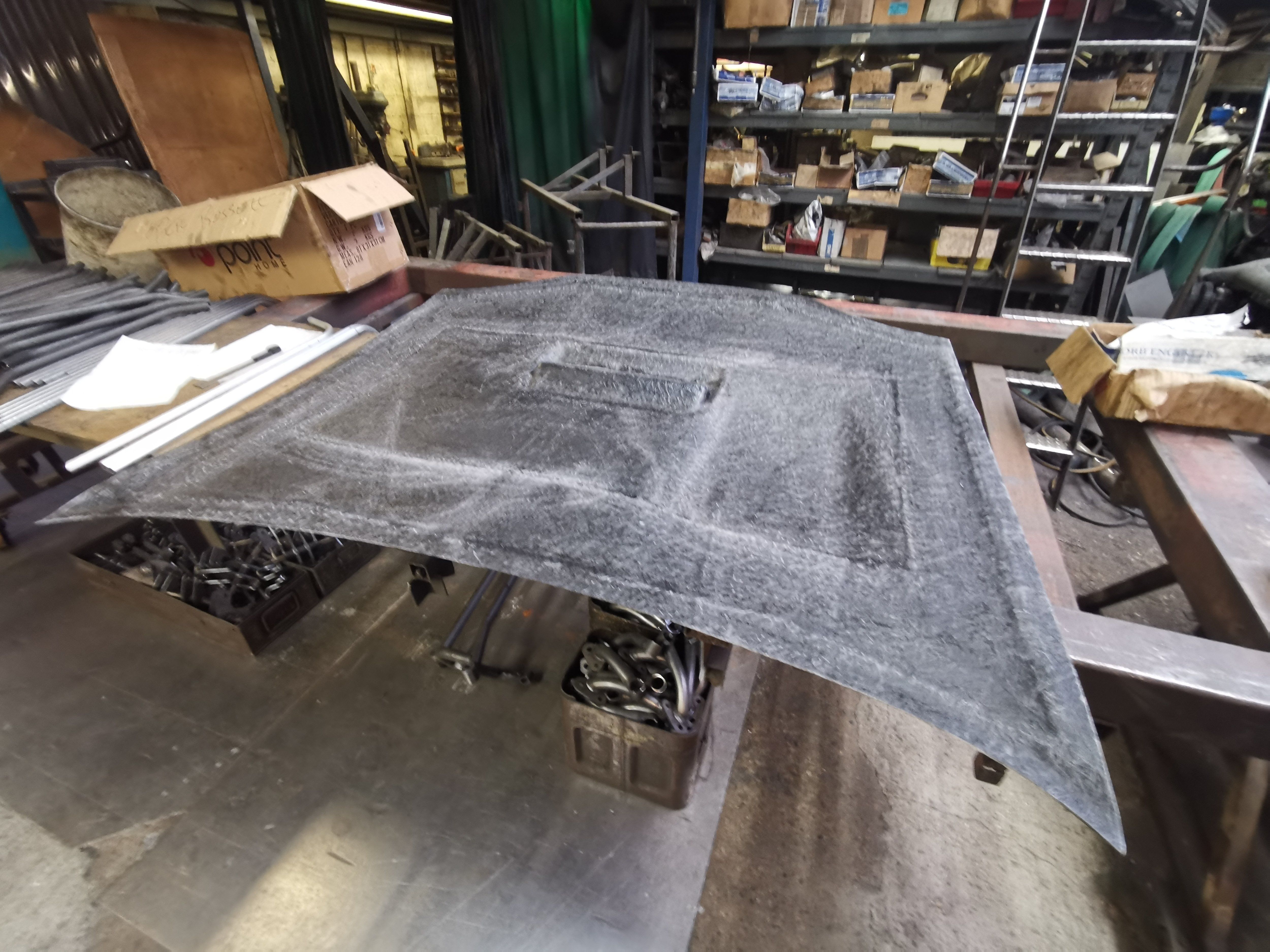

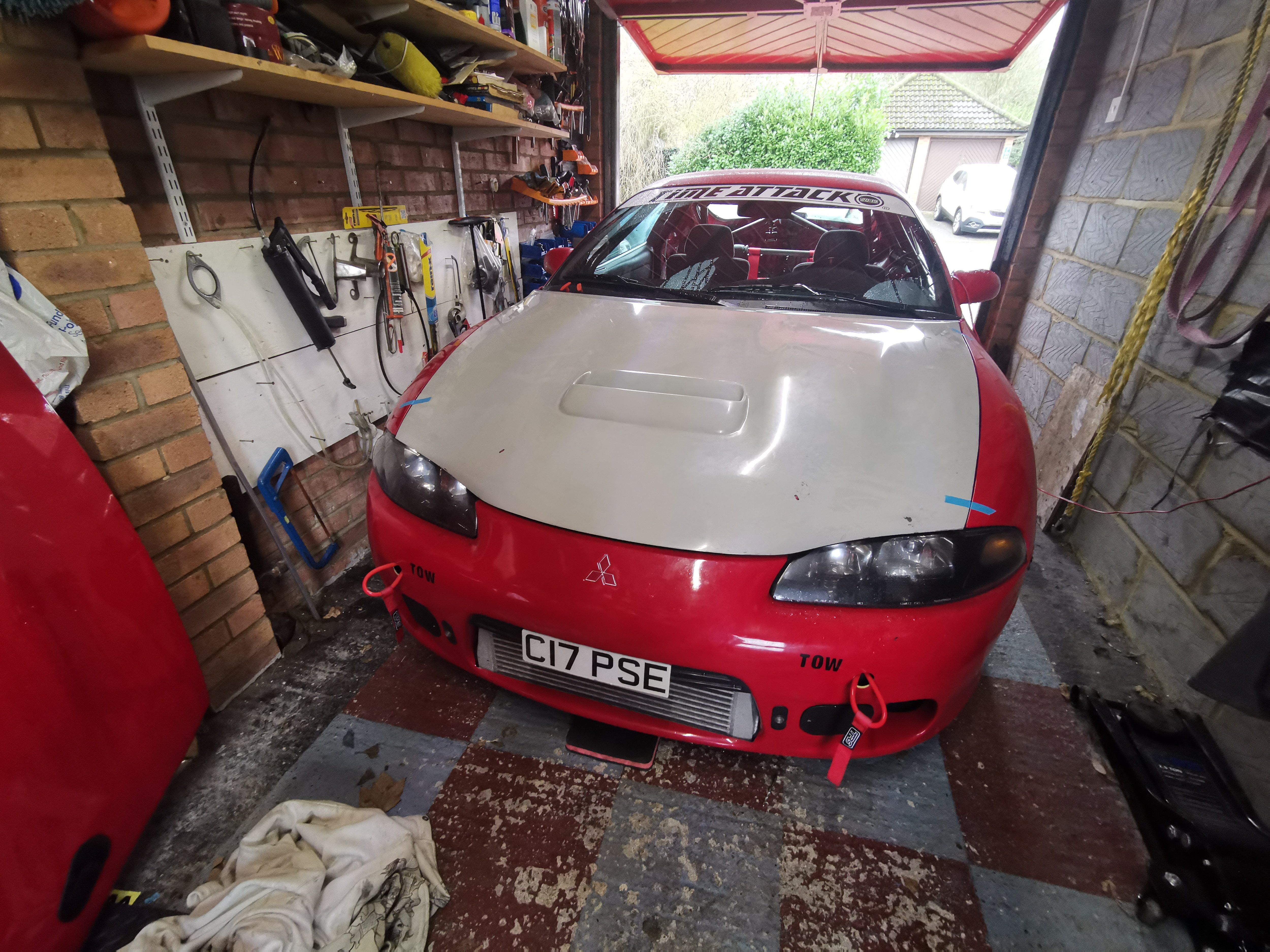

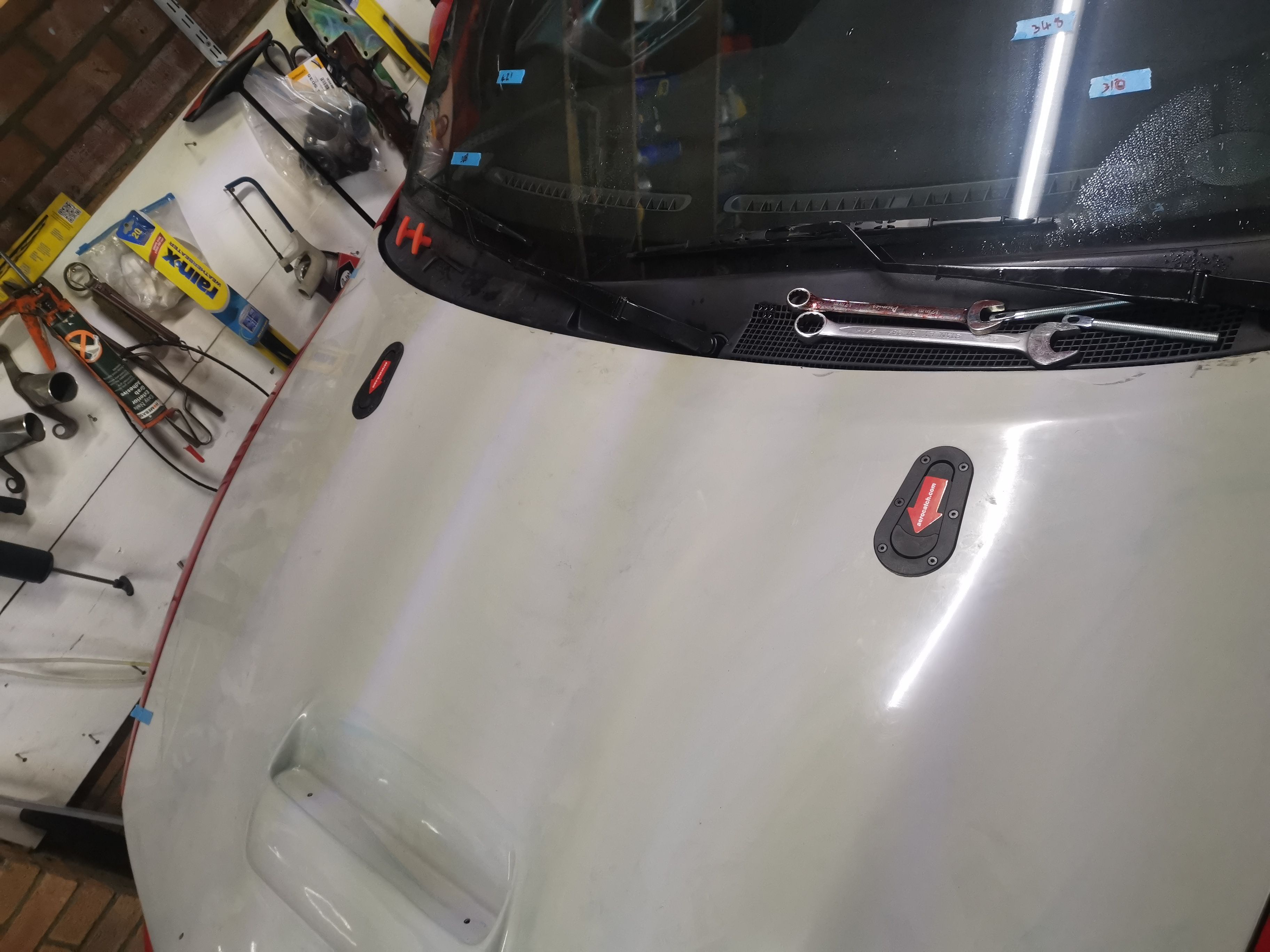

Who remembers when i prepped my hood for a mold? Well i have the new one with me now (actuslly had it in november) but only today i got to work on it and started to get it on the car. I have ordered another set of catches and can finish it off next week.
Its so light as its single skinned, 3 layers fiberglass, 1 layer kevlar and 1 layer carbon. Can hold it up with 2 fingers which is nice compared to the oem hood!
Not much else to say on this currently as im still working on it and shortly after its done i will paint it.

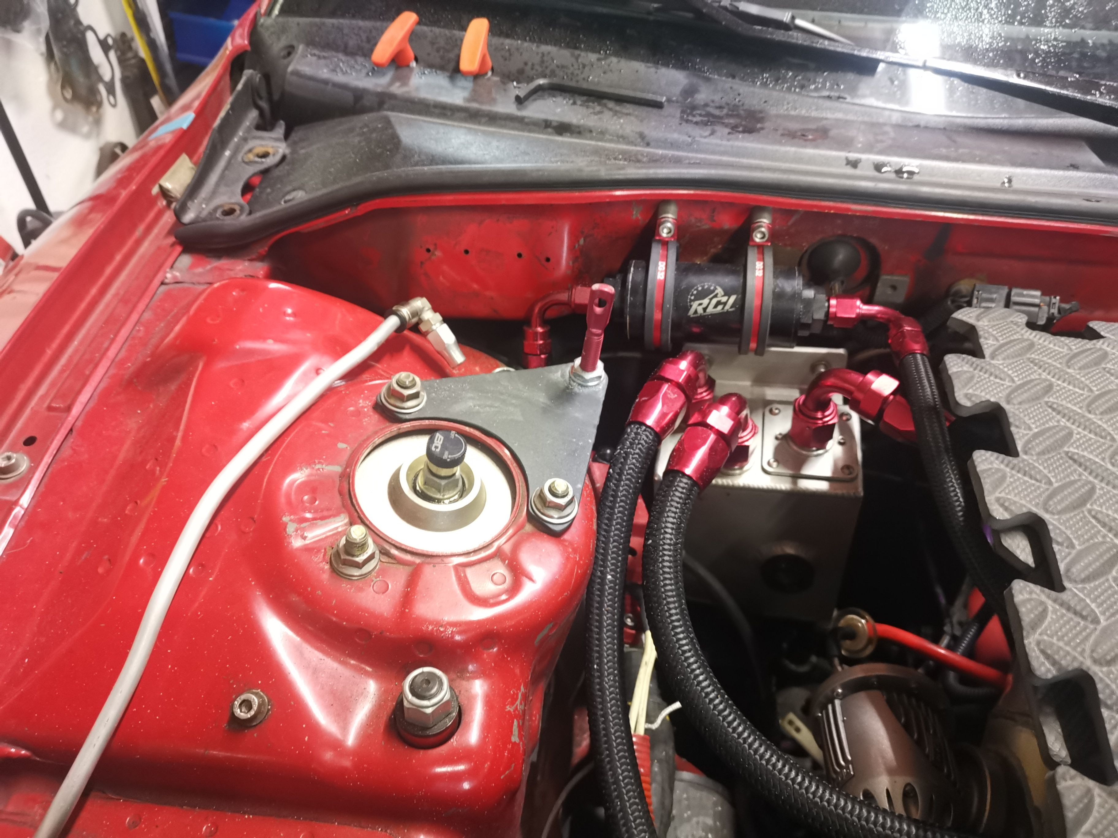

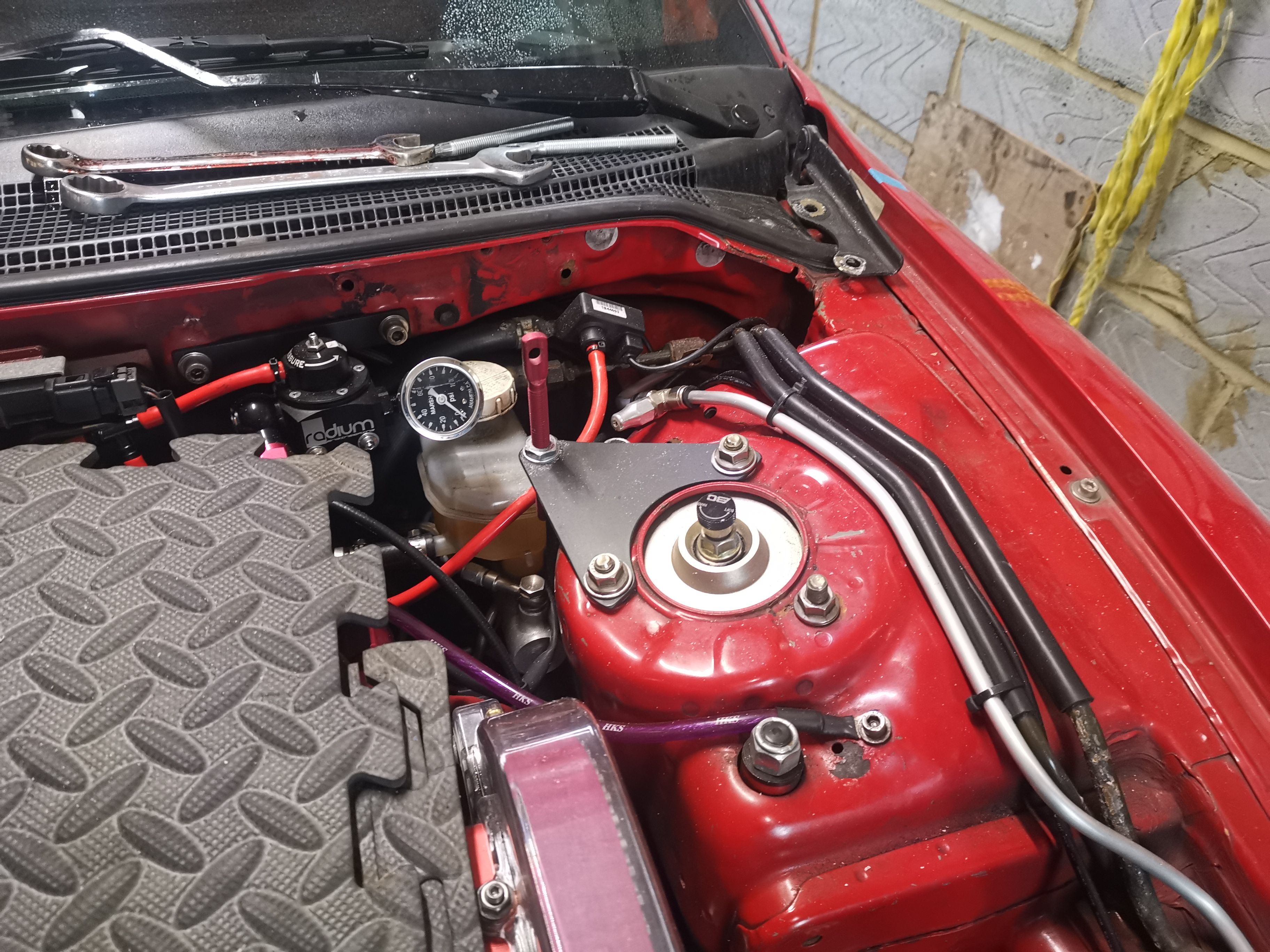

I wanted to mount the rear aero catches by the fire wall area but could not find a suitable area that was equal from left to right without relocating stuff and that was not the plan so i came up with a solution that means its exactly the same for both sides, i made a template at work first to confirm it was ok and fitment worked then made 2 from steel for safety and strength.
Using the strut tower ment both sides would be the same and i can easily remove the brackets and install them again without and issues. I had the room so i took it! Worked out well i think
Wow nice hood. Are you opening the hood from the back side instead the front?
This makes me remind the corvettes with the tilt hood.
Any insights of the process.
Yeah so it acts as a vent and pulls heat out instead of a scoop to collect air. A few other use this vent and it works really well.
As for the process? You mean me putting the latches on or the making of the hood? As i dont have any on the hood

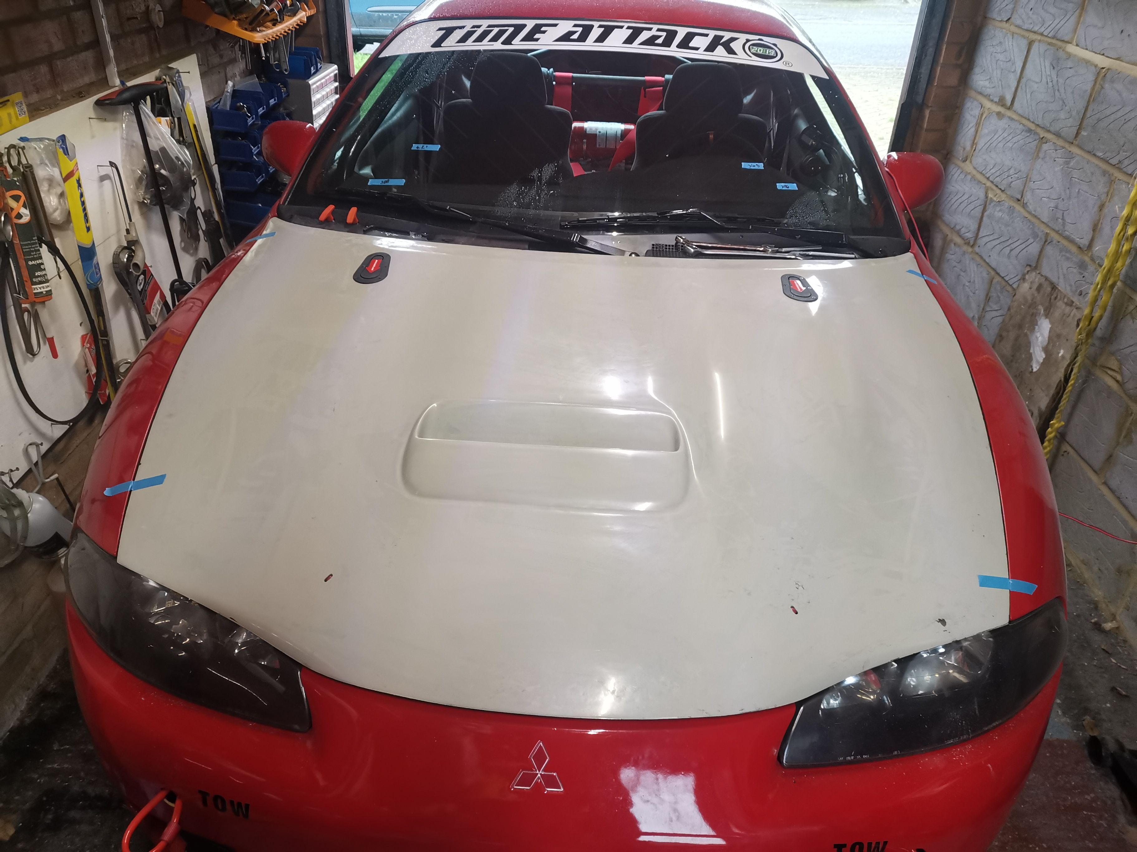

Nooice! Now that's full race setup.
@miguelmcv if you look closely at the second to last photo you can see where he has 2 small cuts for a 2nd pair of aerocatch latches, at the front of the hood close to the nose of the bumper.
You're getting rid of the hood hinges right Bobby?

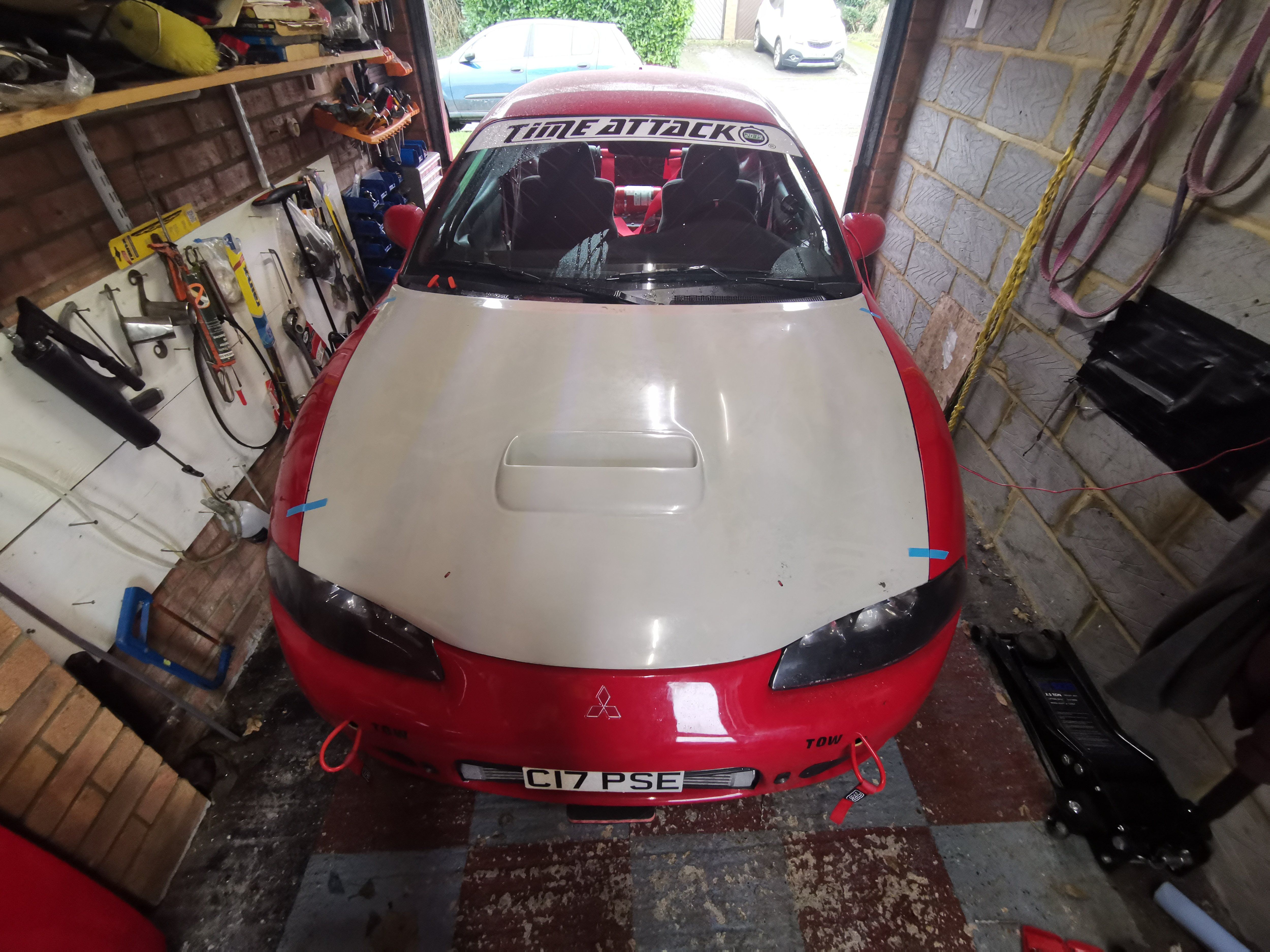

Arh i think i miss read the original question! Damn me and fast reading dont go well LOL.
So im keeping the front catches like my oem hood has so yes it will be 4 total and the whole thing is lifting off and no hinges at all. Less weight all around yay.
I was curious on how you mount the latches in front to see where you bolt it on or how you did it.
I read your comment wrong and fast so my fault sorry, im having 4 catches so the hood will not use a pivot hinge and the whole hood will lift off instead when i need to work on the car
Haaaa, I see it.
Thank you for pointing it out.
