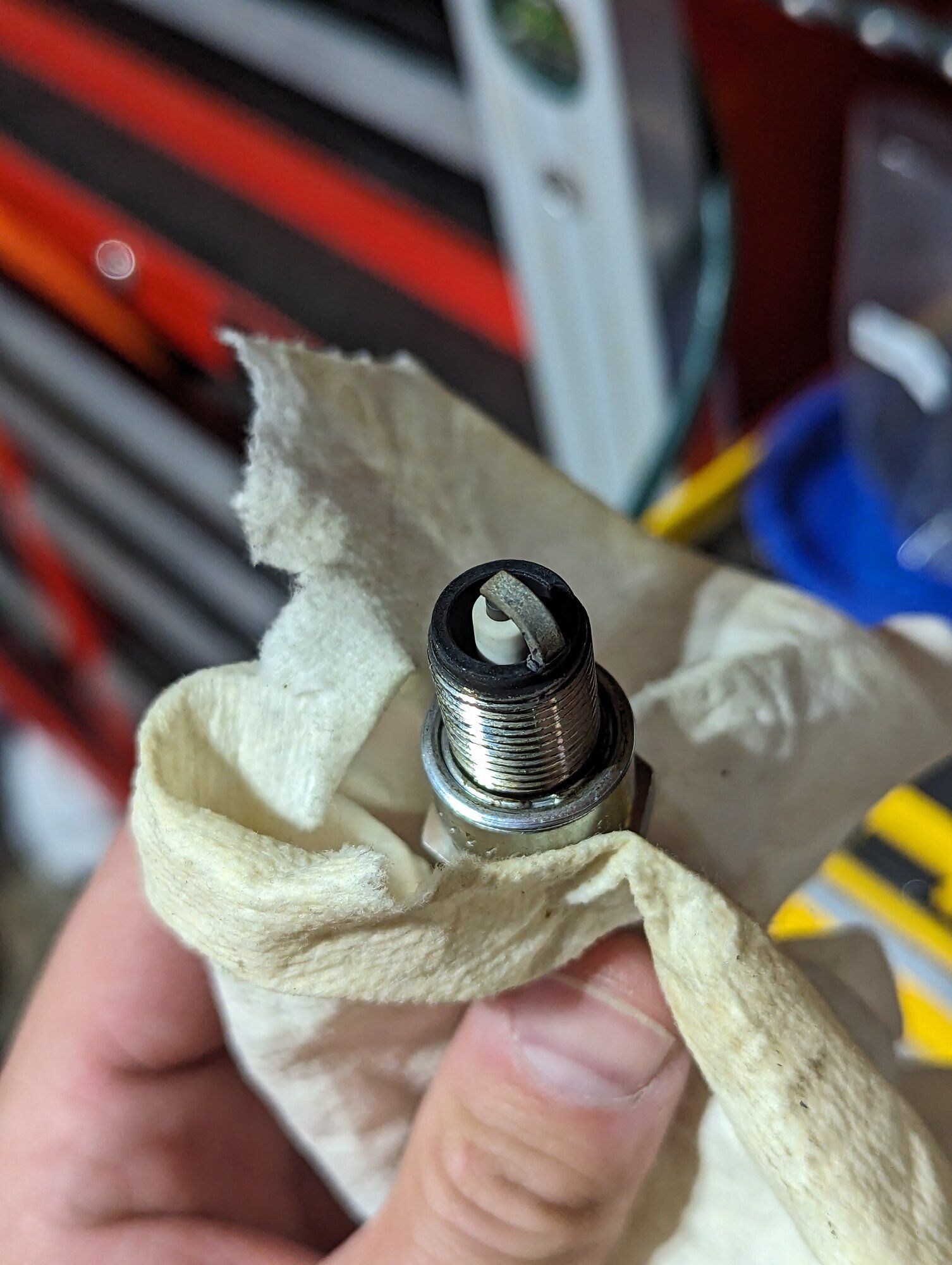

It's got the BPR6ES in it right now and I'm gonna move to the BPR7ES. Just gotta go pick them up from AutoZone tomorrow after work.

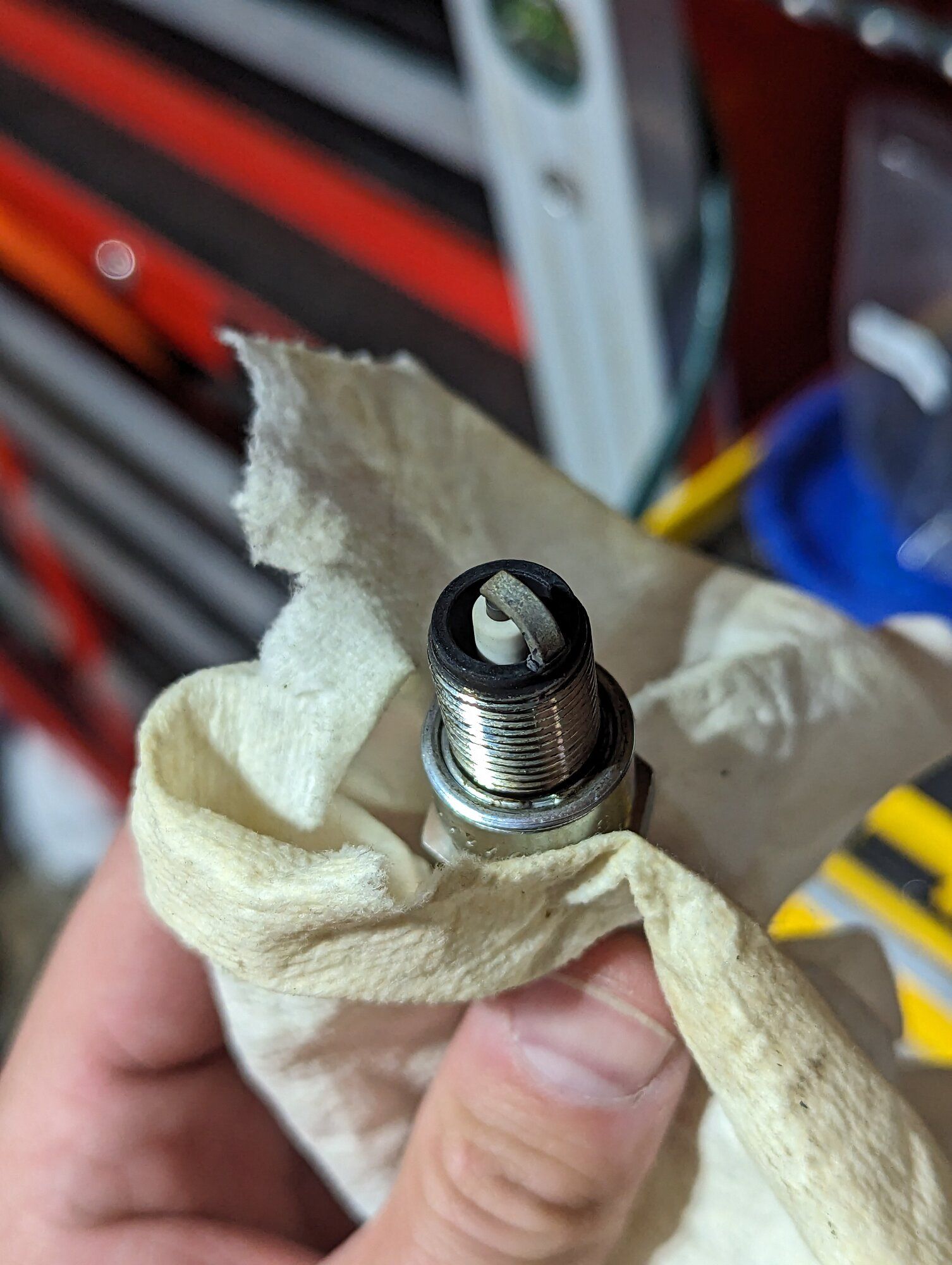

While the plugs were out I took a look down at the pistons and I THOUGHT I could see detonation ping marks. The car hasn't seen any real detonation that I can think of, only false because the knock thresholds haven't been tuned yet. Could be just carbon build up from running rich. My plugs seemed to be carbon fouled too to hopefully that's the case. I might try to rent one of those little scoping cameras and take a look up in there and find out. Fingers crossed it's not detonation.

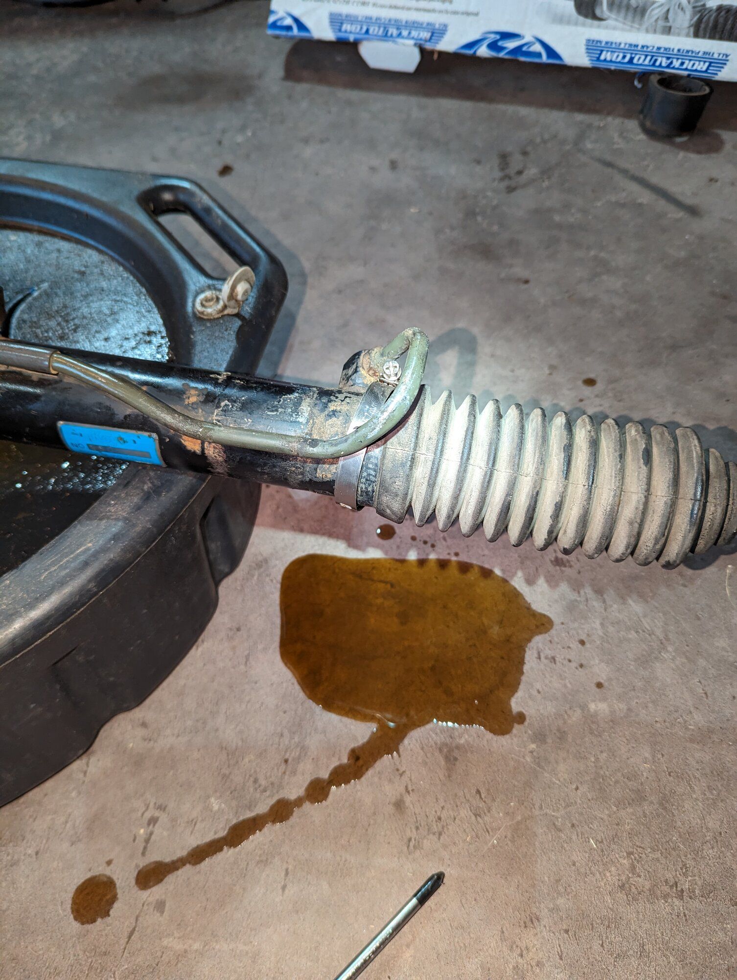

My power steering was working but pushing fluid right out the top of the reservoir. I read up on this and people say that the pump could be sucking up air from the shaft seals on the actual rack causing it to push fluid out the reservoir. I ordered a refurbished rack from rockauto and that gets here tomorrow. I pulled the belt off the pump but it still seems to be doing it so I'm honestly not sure what else could be causing it. Hopefully that rack fixes it.

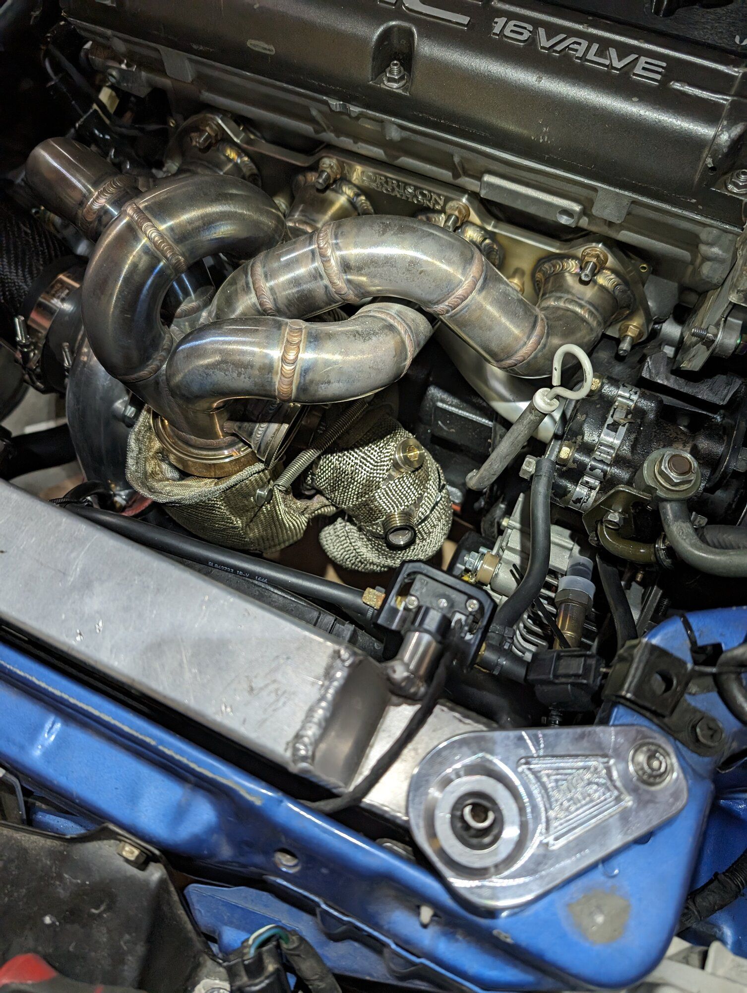

My alternator might be bad because of the power steering leaking also or maybe it's because of the heat from the exhaust. When I drove for a bit my voltage drops down to like 13.4v from 14+ v at a cold idle.

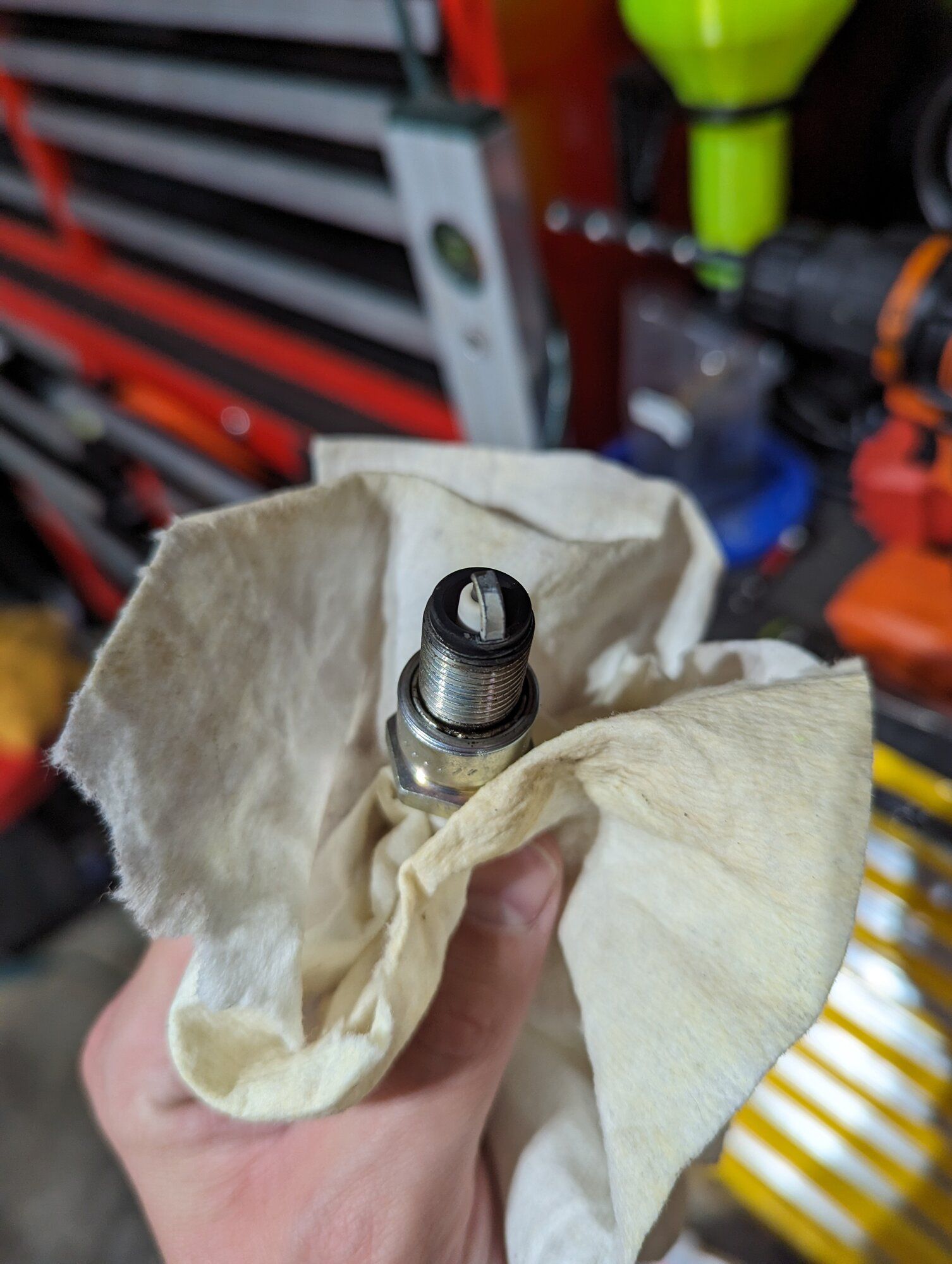

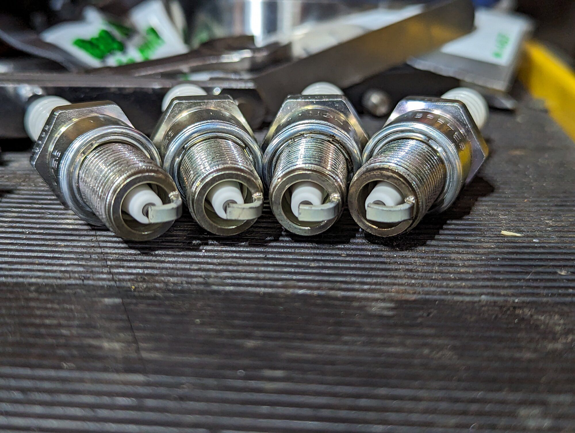

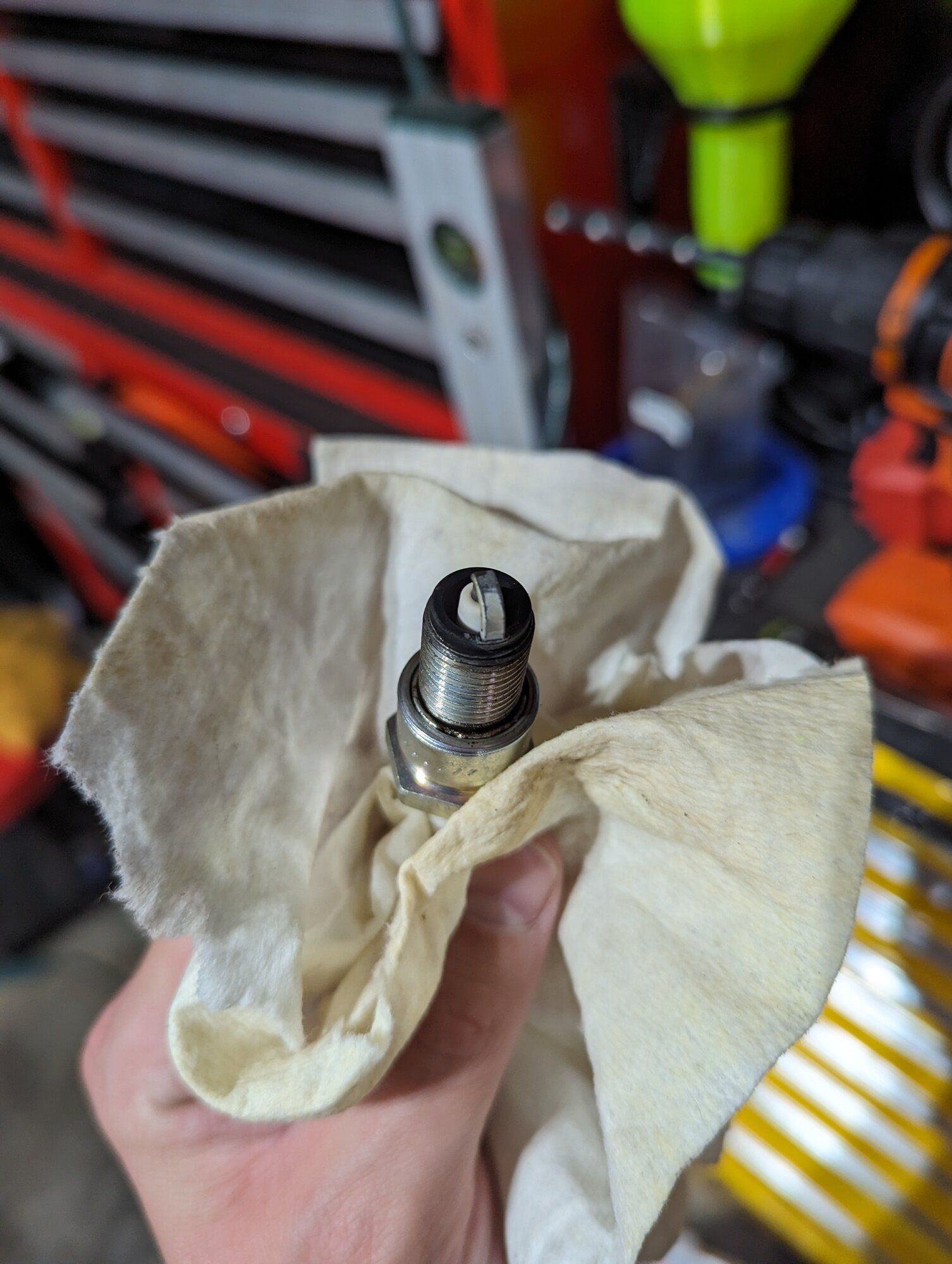

So replaced the plugs with the BPR7ES and took the car for a drive. I gapped them down to .020" per recommendations from a buddy of mine that runs a tuning shop on the other side of the state.
It actually seemed to feel worse. I could hardly get the car to move from a stop, and one time it started misfiring so I shut it off immediately and re-seated the plug wires and it stopped misfiring long enough to get me back home. When the breaking up starts, the AFR goes way lean and then it also throws my closed loop stuff off too based off my wideband reading. Keep in mind I'm not even giving it any beans, I'm literally touching vacuum while just trying to drive extremely casually.
Here's my new plugs after about 2 miles of driving and breaking up. To me, that definitely seams lean.

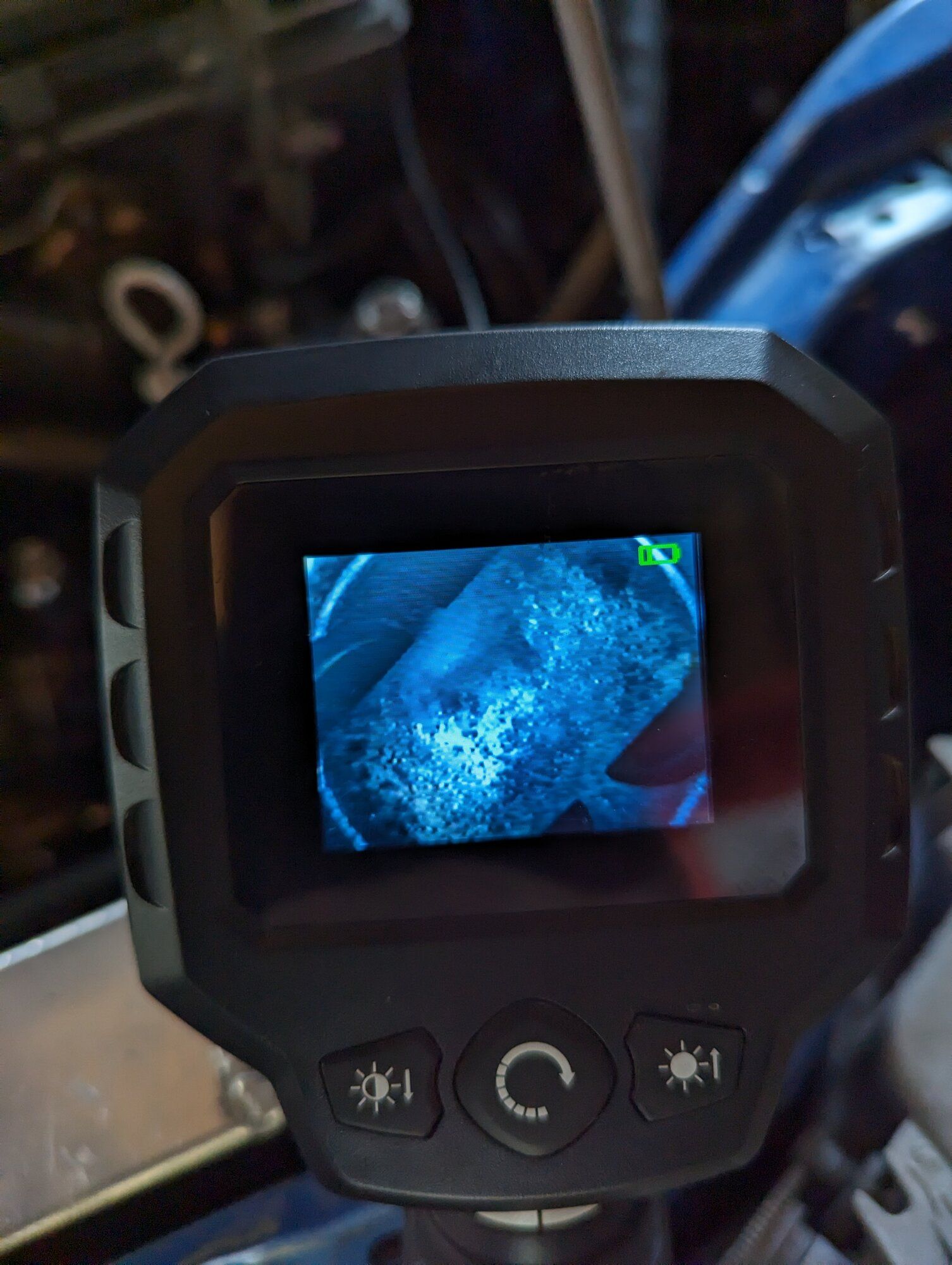

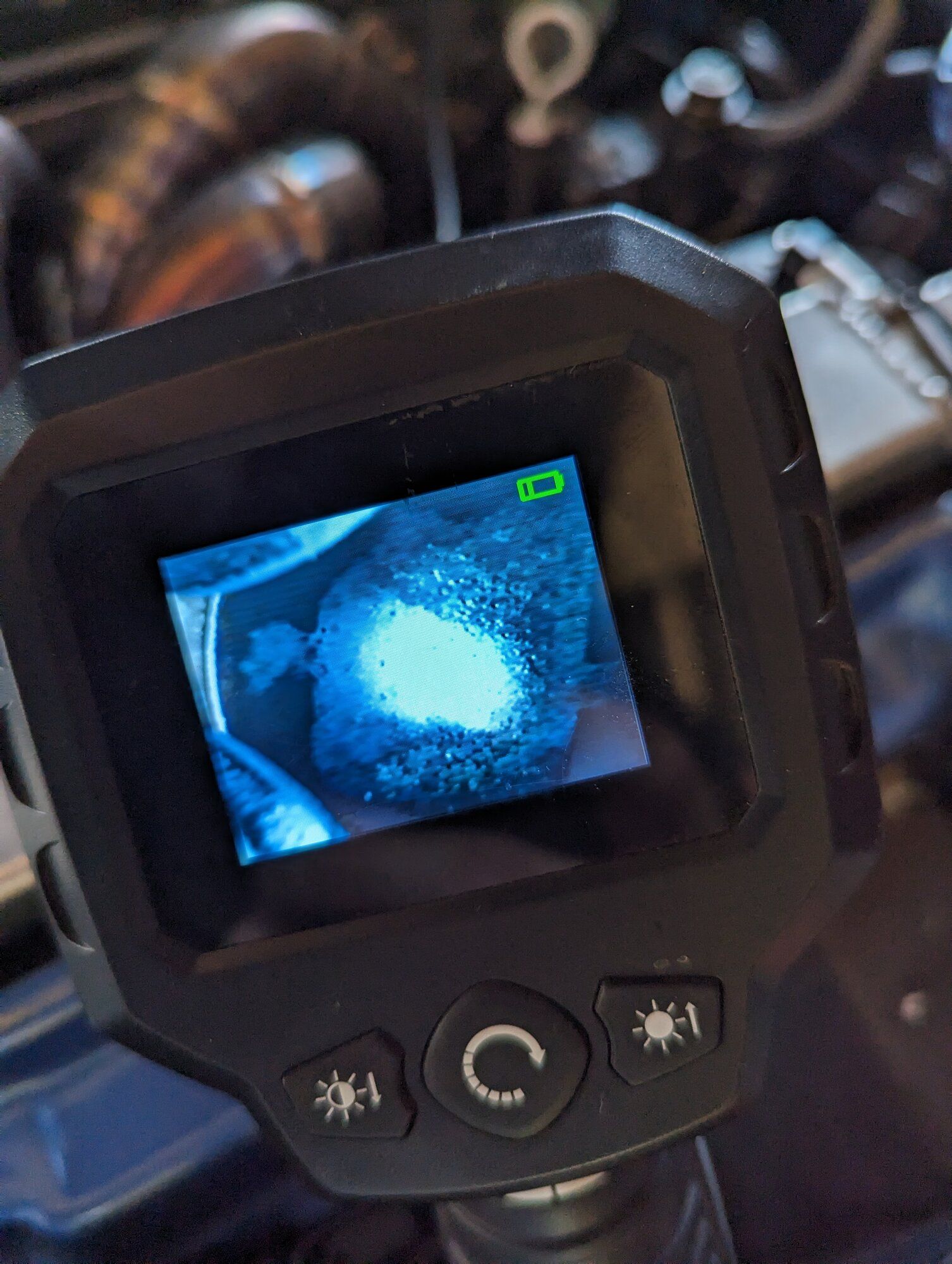

I did rent a camera from AutoZone to look inside the cylinders while doing a leakdown but the camera was so awful it's hard to see what what is down in there.

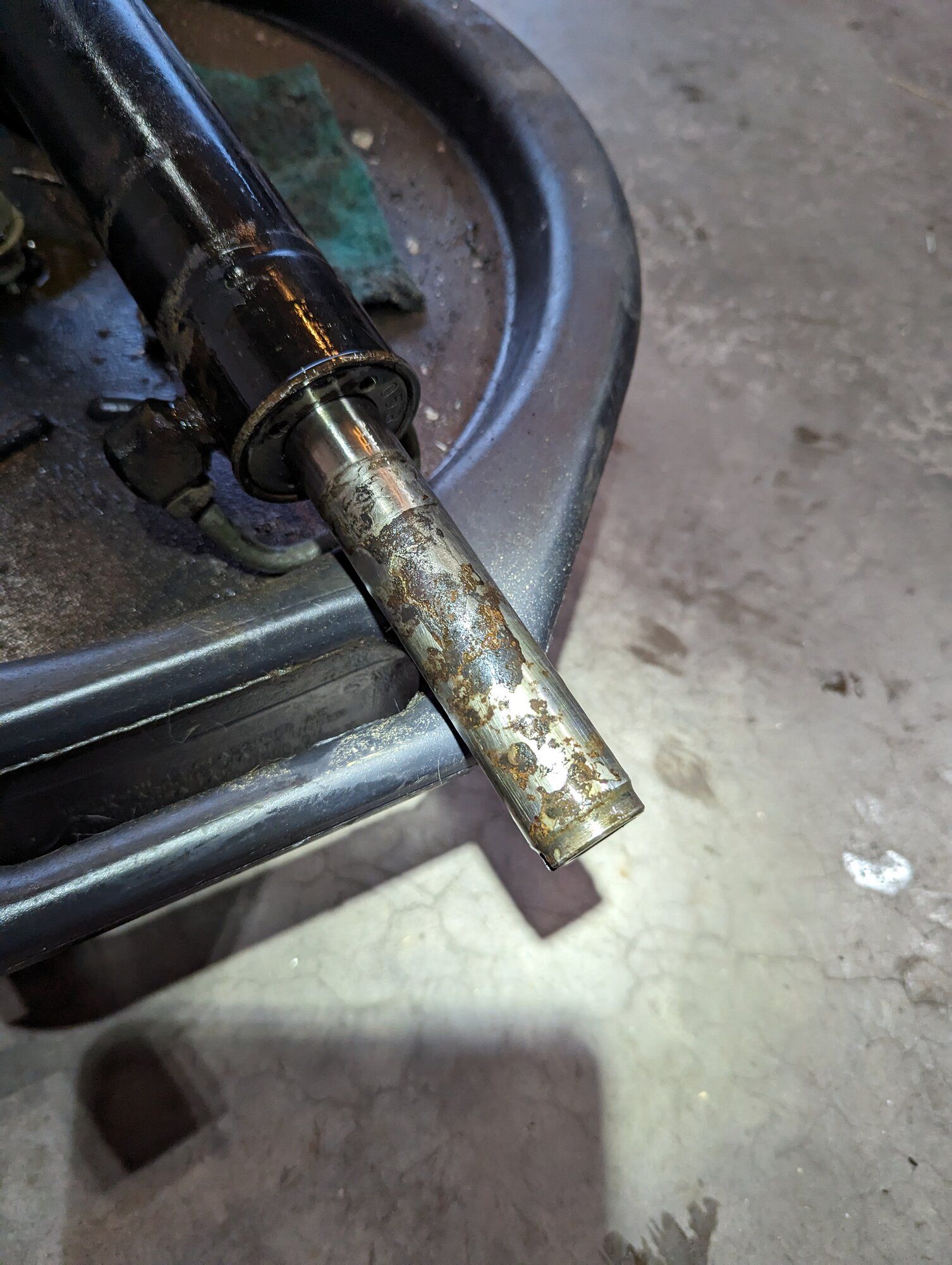

My new steering rack came and I worked on getting that installed last night. One of the hardlines that is on it was different than OEM so I had to swap one of the other ones off the rack I'm returning so the mount would fit. I told you guys this eBay rack was trashed. When I pulled off one of the boots, fluid just came gushing out.
I realized also that I haven't had my Injectors cleaned since I started tearing the engine down 2 years ago so I removed them and have them packaged up ready to go to FIC to have them cleaned. I'm not sure If this will help with the car running bad or not but even if it doesn't they probably still need cleaned.
I think my power steering pump might also be leaking. So it's leaking right onto my alternator and I'm sure between that and the heat from the o2 housing/ downpipe isn't helping. I'll look into a rebuild kit for the pump and might have to get another new alternator again..

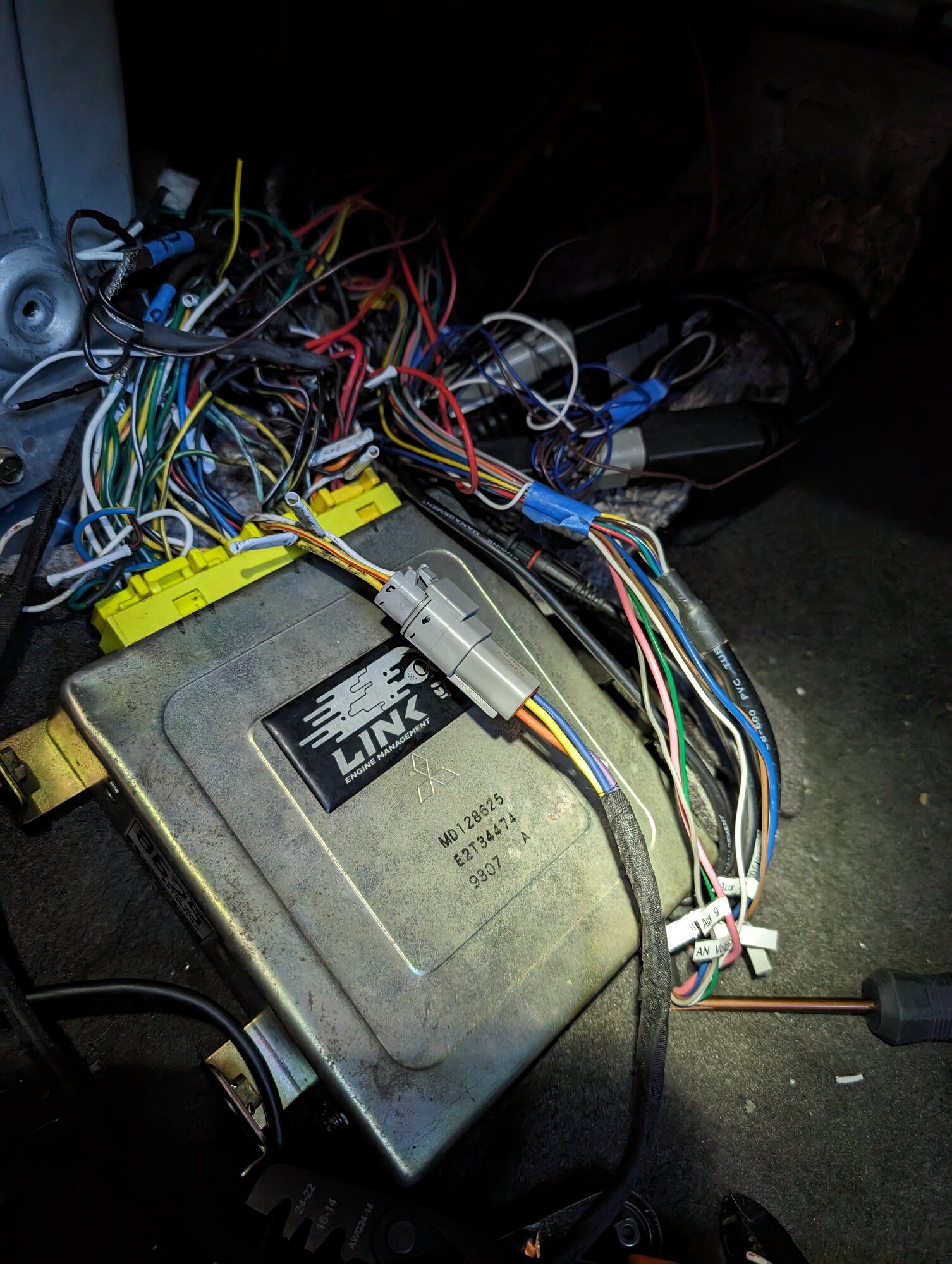

I ended up snagging some Brand new OEM Hitachi GTR Coils, and the Brewed Motorsports COP plate and wiring harness.
Ill have to run 2 new wires to the ECU for the IGN 3 and 4 for the 2 other coils AND setup an 12v switched relay for the power for the ignition as well.
My issue is if the PTU Gets deleted, which is what generates the Tach signal for the dash how are people that go to a full COP kit getting tach signal to the Dash? ive read just about every Tach post on the site to try and figure it out but it seems that everyone still has the PTU and are using the stock ECU in wasted spark so.
From one of them I read the ECU gets the Engine RPM from the CAS black wire (pin 21) so is it correct in saying you might be able tap into that for the dash? Also from what i understand a few posts said that the tach output wire from the OEM PTU splits and one goes to the ECU and the other goes straight to the dash.

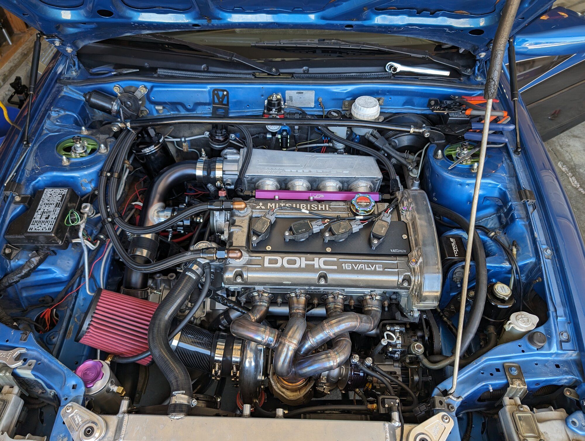

Made it out to a Cars N Coffee Event.
So honestly not a ton has changed. Ive been working on the car a lot but its all been troubleshooting the car not running right. Basically whats been happening is the car ends up getting so rich when hitting right around vacuum that it misfires and breaks up really bad.

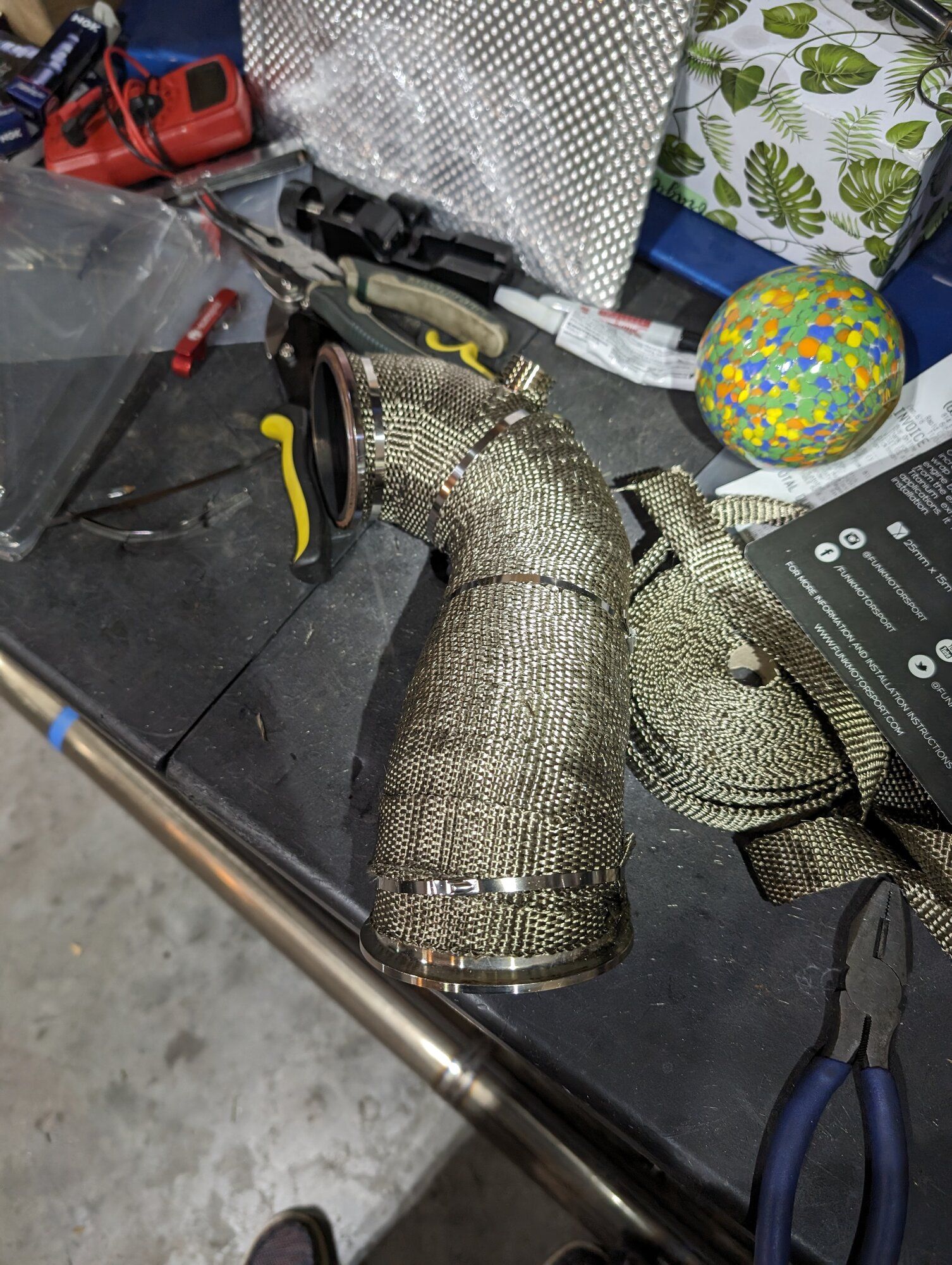

I also picked up some heat wrap to wrap the downpipe to help with the head around the alternator. Got that pulled off and one fairly quickly. Hopefully this helps a bit.

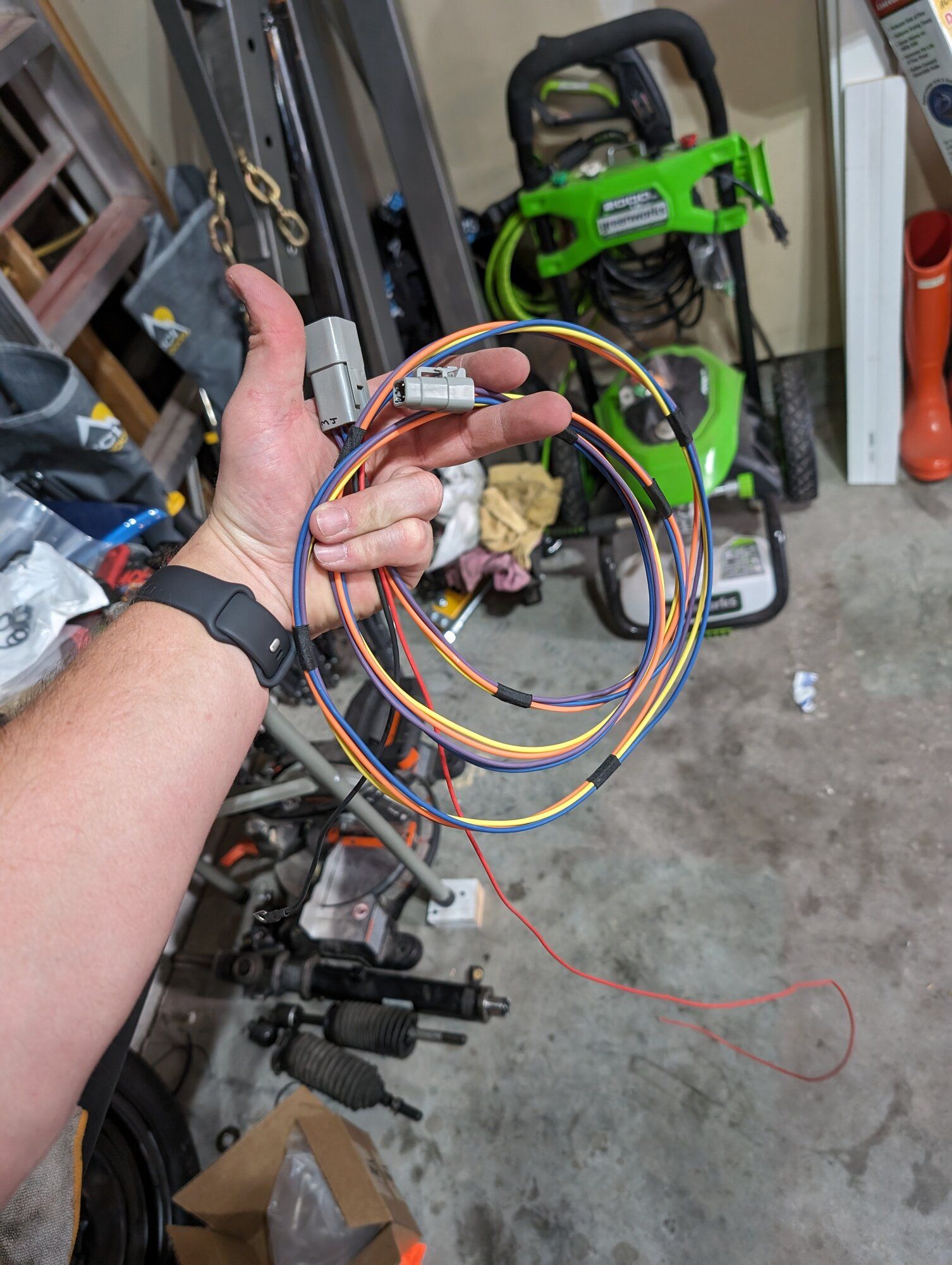

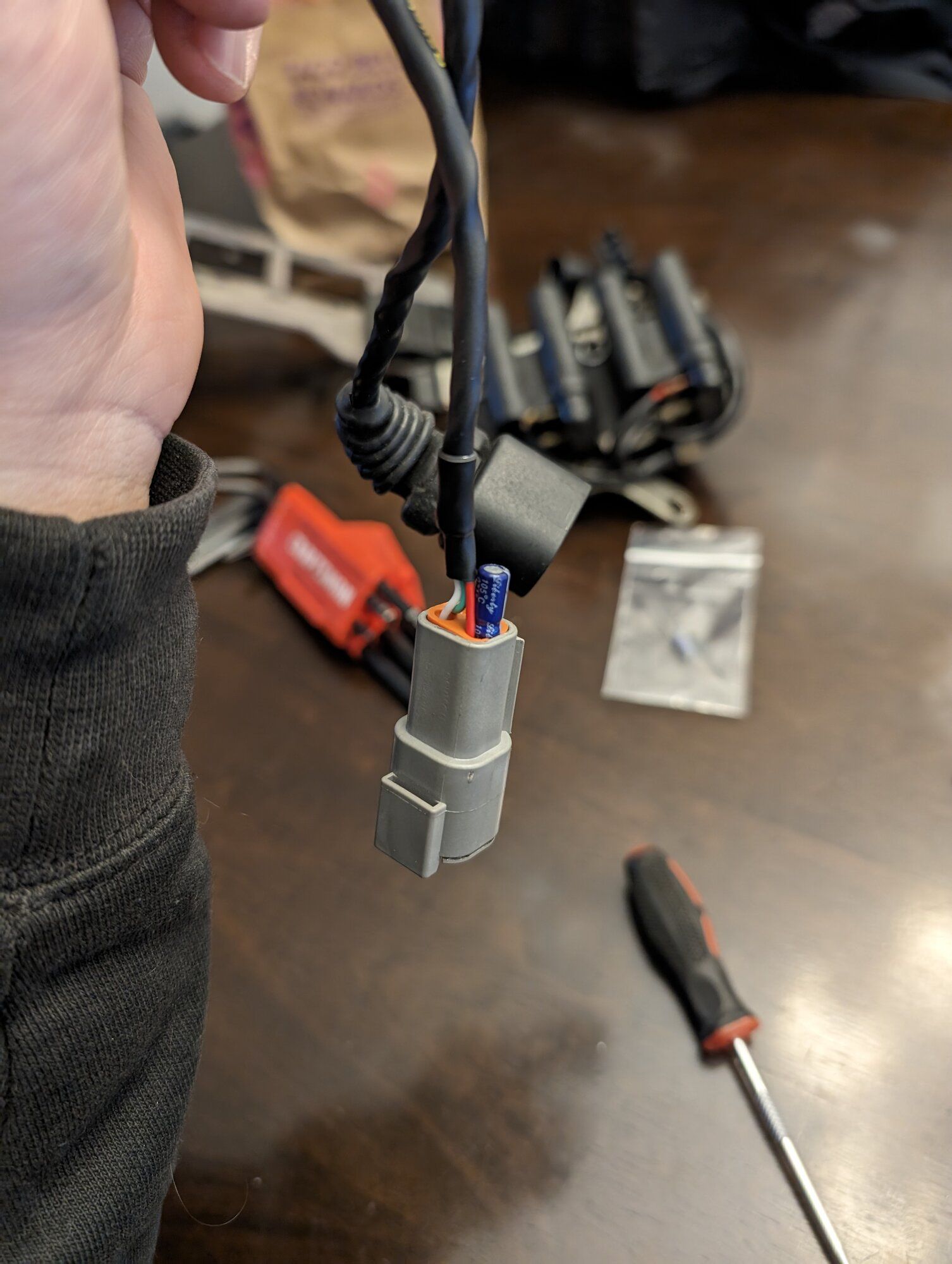

I was able to get the COP installed. I ended up making my own harness starting at the 6 pin Deutsch connector to the Ecu for the trigger wires, power and ground. As for the Tach issue i actually just used an output wired right to the wire to the harness that went to the dash and it works perfect.
I had to use another output for a new fuel pump relay trigger for the factory MPI harness and it works perfectly.

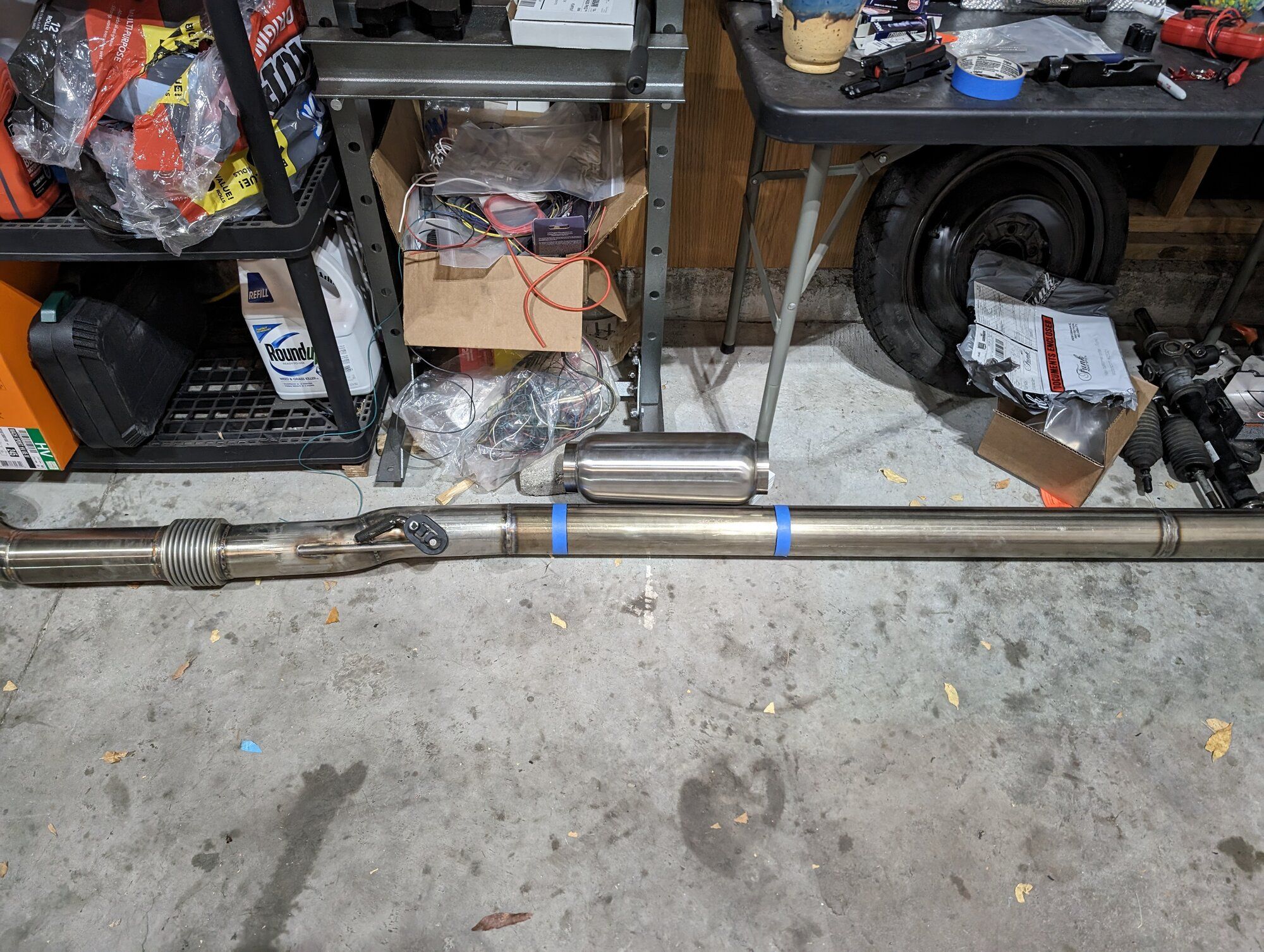

I picked up a stainless Resonator to install to get rid of the crazy drone and raspiness of the exhaust as well. The whole midpipe of the exhaust is off and at a fab shop to get that installed. Hopefully today ill pick it up for a test fit to make sure its good and then it should be good to go back and finish up. Im really excited to get the resonator installed, because i hate how loud and awful it sounds. Even if it doesnt completely fix it, it should help in the very least.
Car sounds great at idle!

You ever rebuild your PS pump? If you want to try an easy fix, replace both the o-rings at the top of the pump where the PS Line bolts onto the rod.
I've got both o-rings you need. If you're interested, throw me a PM with your address and I'll ship them out to you fo' free. I bought a sh*t ton online because I needed two and now I've got 15 sets of PS pump o-rings. Lol.
I did actually! Bought a kit off rockauto. Ended up using only about 4 of the O rings and then had to snag an Oring kit from ace Hardware for another O ring since the kits was too small thickness.

Yeah, this is just way to droney for me. That 3krpm mark is really brutal LOL I actually feed bad and embarrassed when it's in that room range.
Just test fitted my exhaust with the Resonator installed before final welding today so it'll go back on tomorrow.
